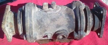

Picked up the CV hub that will become the center drive shaft adapter yesterday from the heat treater's
I had them anneal the bowl area so I can drill and tap it to fasten on a drive shaft flange on.
They were able to get it back to about 20 RC hardness, which will be within reason to drill and tap.

Here is a pic of one thats clean to see wassssssup.
A nice bracket on the cat sub frame will allow the pillow block to be located in the proper relationship to allow a nice drop using the Astro rear drive shaft.
The Astro uses the 3R GM u joints and an adapter joint is readily available that is 3R X 1350
A 1350 flange yoke accepts the 1350 side of the u joint that will go in the rear of the Astro drive shaft (Shaft may end up a bit shorter...not absolutely sure yet.
The flange yoke bolts right to the flange on the pillow block.
Then we can use a shorter CV shaft to connect to the rear flange of the pillow block and then to the pinion on the Weasel rear unit.
Depending on the final pinion angle and location of the diffy the CV may not be needed.
I have a lovely front shaft from a 95 Suburban that had a bad joint and it ended up in my pile of goodies.
This 3R jointed shaft can easily be fitted with a couple 3R to 1350 u joints and be used.
Again the length may require some pruning.
Been there done that many times over the years to make shafts for my 4x4 trucks.
These recent revelations are certainly not down to the final few thousands of an inch, but the time spent under the rig the past couple days yielded enough good dims to confirm the basics are in the ball park.
Being able to use the factory drive shaft from the van and the left over Burb shaft will save many $$$$ to use elsewhere...
AS mentioned, the piccy of the pillow block was one I scared up as mine needs a bath.
NOTICE THE FLANGES ARE NOT INDEXED CORRECTLY, AND THE ARE OFF.
Somebody had one or both flanges off the shaft and did not index them right.
The side thats on the bottom in the piccy has a machined flange and four 5/8" tapped holes to mount the beast.
Inside are two big ball bearings, two seals, big shaft and the two 1350 end flanges.
A ready made solution to my problem that was already paid for.
