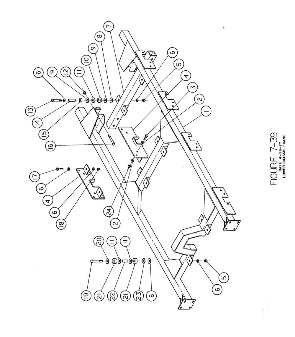

Here is the layout subframe of the 1200C.

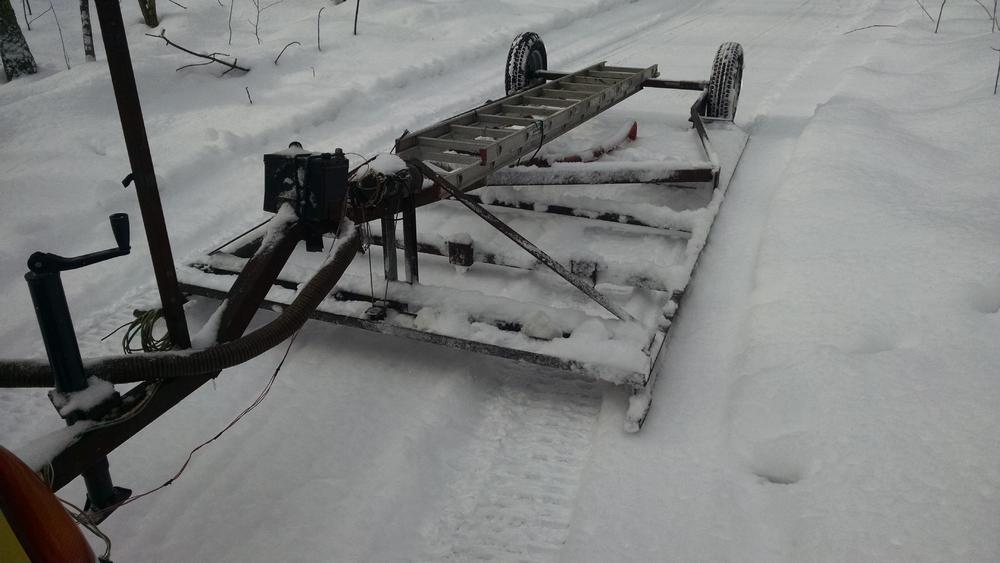

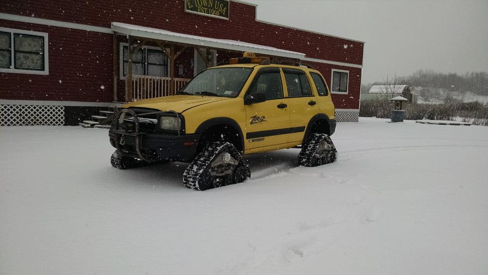

looks like you should go this way----ill be out today with the grandson and a few beers (he watches the in car cam on the drag/no beer) ----been out all winter riding around and grooming my trails a set of mattracks and 500 in a set of 2 plate wheel adapters (my shop builds)and go

Re: An introduction/hello and my project.
Mattracks are a sweet deal, but at what cost ????
I looked into a set for my Burb a few years ago and about choked on the $$$$$
