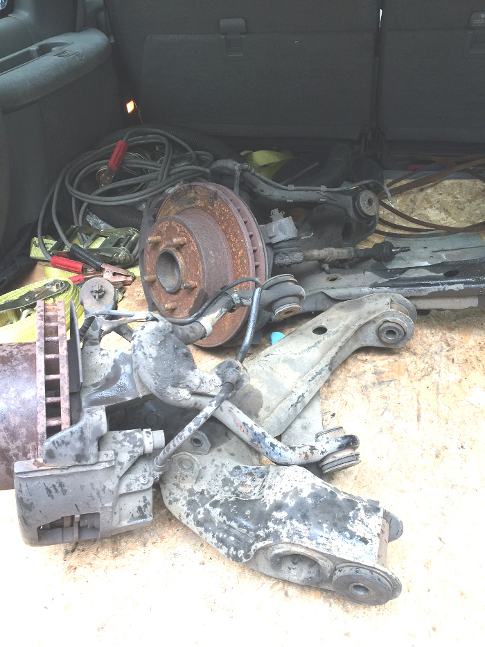

These two bad boys will quite easily mount in the rear to allow a very simple use of the lug stud flanges and nuts to secure the rear of the cat frame.
These were off of an AWD which is hear nor there but will allow an easier mounting than the Spring fronts on the 2WD
I found 4 of the factory Rally wheel caps with nuts to trim the finished assembly out and give it a nice look..
I HOPE :thumbup:
This little addition will give me 4 good attachment points for the cat sub frame to the van chassis that will be easy to deal with.
More re purposing :smile:

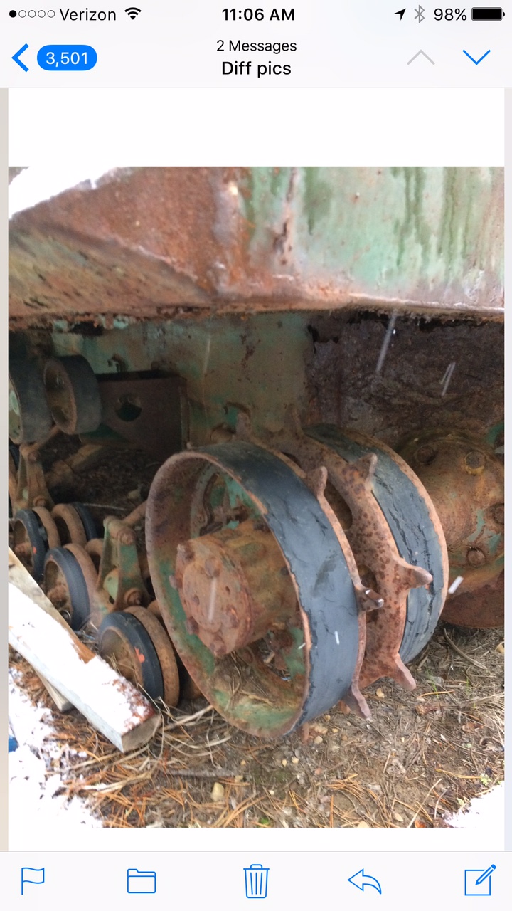

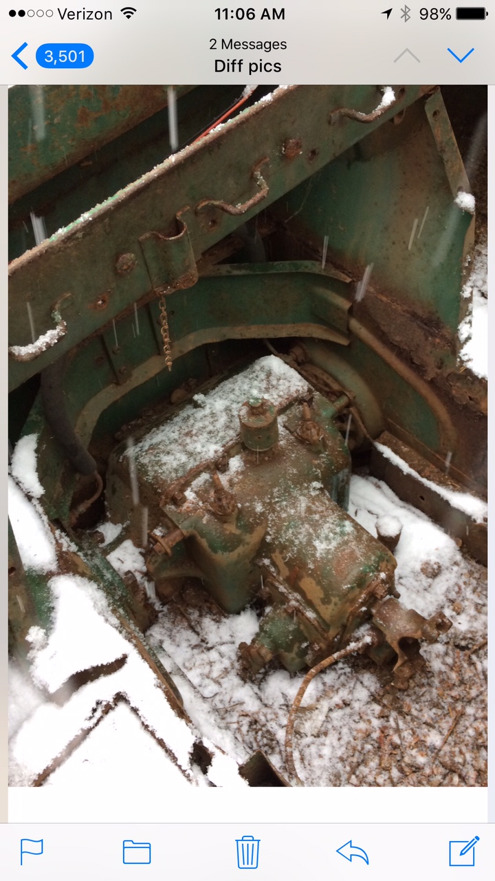

Some real pix of important things.
Pix of the Weasel taken this fall.
The diffy and the LH sprocket.
Should be easy to fab a good solid framework to hold the diffy in the location needed.
I will post pix of the retrieval when we head out and the loading and such.
Should be a fairly easy go to coax it onto the car hauler.

We spent several hours driving to look at the Weasel...
After chatting for a few minutes with the owner I decided to check the axle over.
Grabbed the pinion yoke and could not budge it.
I had a few tools along with us so grabbed a large pipe wrench and still no go on turning the pinion.
Decided to remove the oil plug on the front and LOTTSSA water poured out along with much rusty goop.
Chatted a few more minutes and left the Weasel right there in the dirt.
