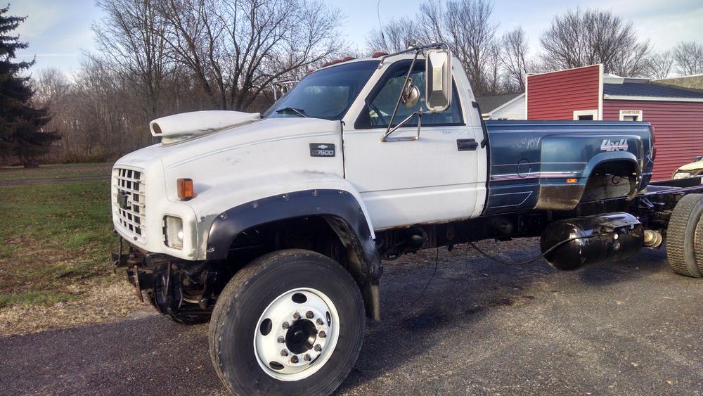

ROLLING THUNDER is bad asssssss---wheel adapters with 22.5---with 40 inch tires----6 inch lift-----gm crate motor---electric header cut outs ---molded in trans am shaker hood scoop ---old school gauges out on hood--bush wacker cut out wheel flares------all imron paint----stainless bumper----thunder is getting a big brother-------iam building a 7500 topkick----------there is a story why we call it rolling thunder
