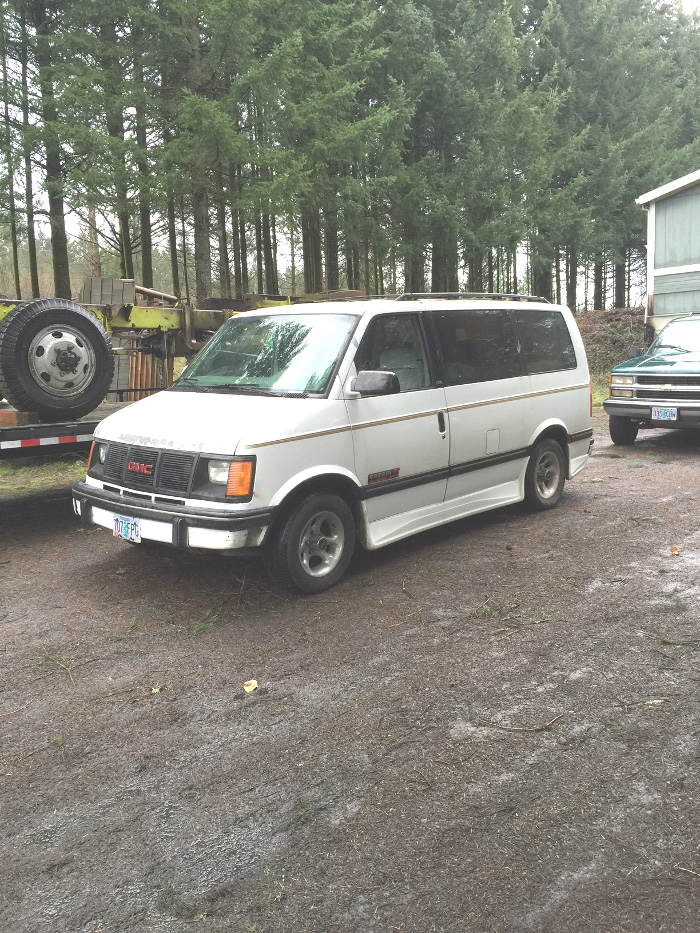

Finally, after several weeks of waiting we went out this morning and picked up the Safari van for the "Franken cat" project.
About a 20 mile trip home with no troubles.
Checked out as much of the on board systems as possible and everything seems to works as it's supposed to.
Glad to have the little prize home.
ONWARD we go.

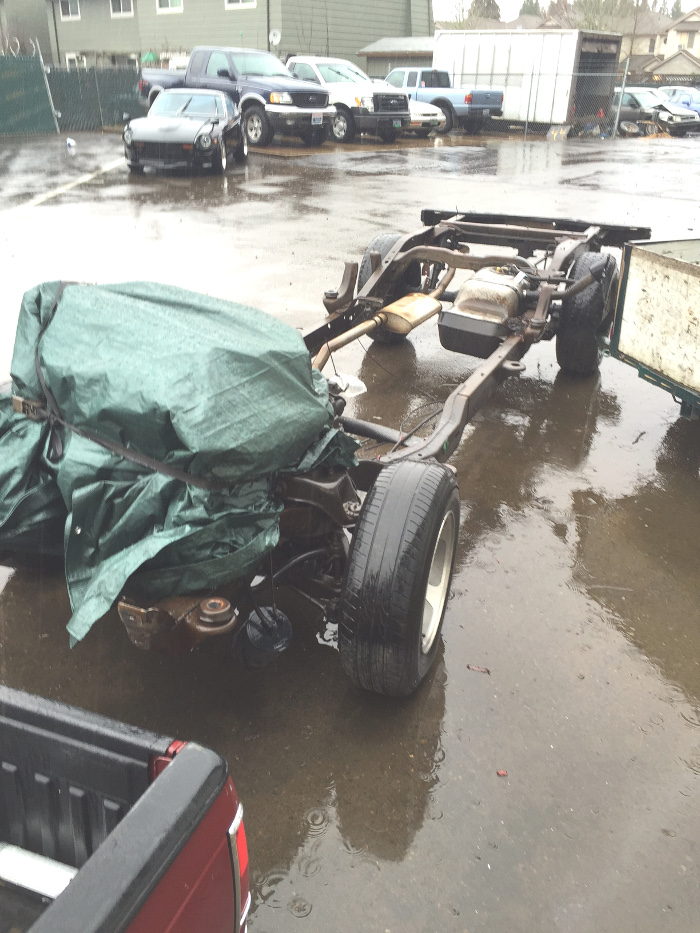

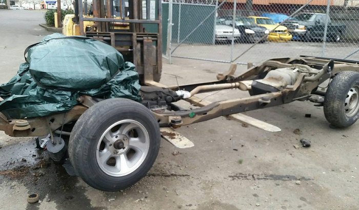

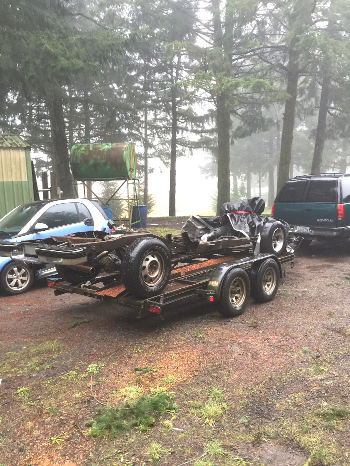

Re: An introduction/hello and my project.
Still gathering parts and pieces for the Franken Cat.
Scored a complete S10 frame with an engine and tranny yesterday.
Its a 2WD so the tranny will be perfect for the cat project and the tranny and transfer case from the van can get a new home and return some $$$$$ to the pot.
The front end of the frame has a lovely cross member/engine cradle that is ready made and will be a snap to remove and weld into the cat frame.
I much prefer adapting things that have already been designed to do a job rather than building totally from scratch with new materials (far cheaper too)
The S10 also provided a lovely air cleaner that fits the Edelbrock 4bbl carb thats going on the V6
The left exhaust manifold has the air Preheater shroud as well.
The rear tranny cross member can likely be used (in some form) for it's intended purpose.
The rear axle, front spindles and brakes will likely find their way onto Craig's list for a return of some $$$$$
Be a few days until we get the S10 frame home though as it's coming from a tow company/salvage yard and they are removing the cab and bed prior to selling me the frame, engine and tranny.

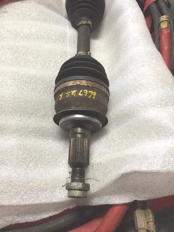

Some goodies showed up in the "Widdle brown truck" today :w00t2:
Got the CV shaft I ordered (Used) to scavenge and modify the first joint (Stub that goes through the hub) to create a center drive shaft support/ drive shaft brake.
Looks good outta the box.
Will rip into it soon and get it apart and ready to go in the lathe for some machining.

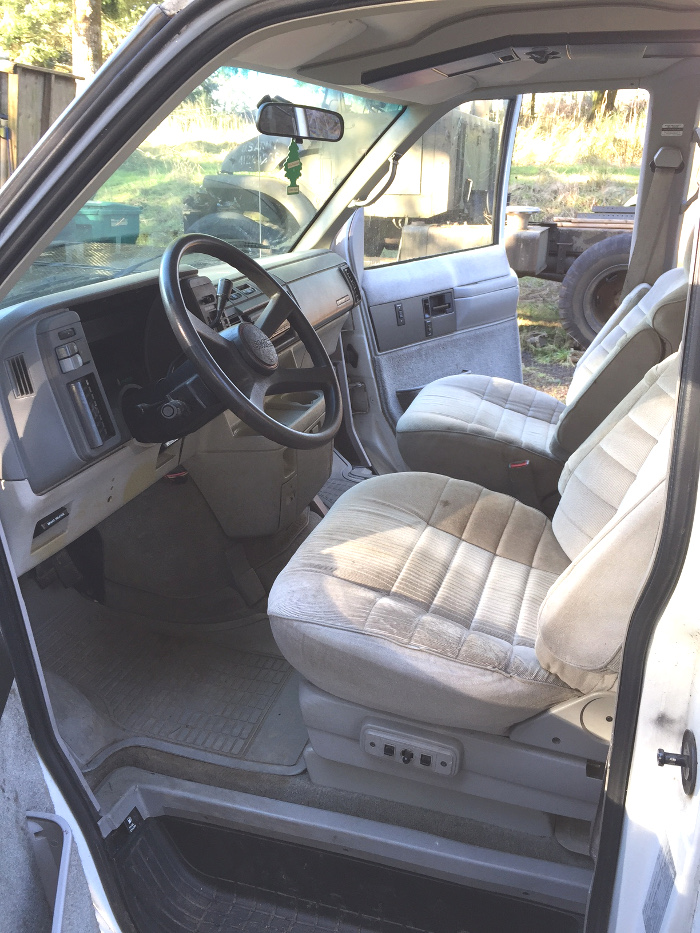

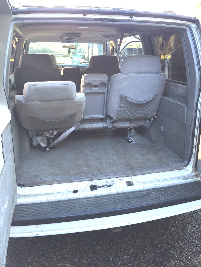

After giving the Safari a good Mucking out I took a few pix.
This is gonna be a sweet ride once we get rid of the tires and get the beast sitting up on a pair of 36 inch tracks.
Still needs a bit of cleaning inside, but still gonna make one comfy cat.

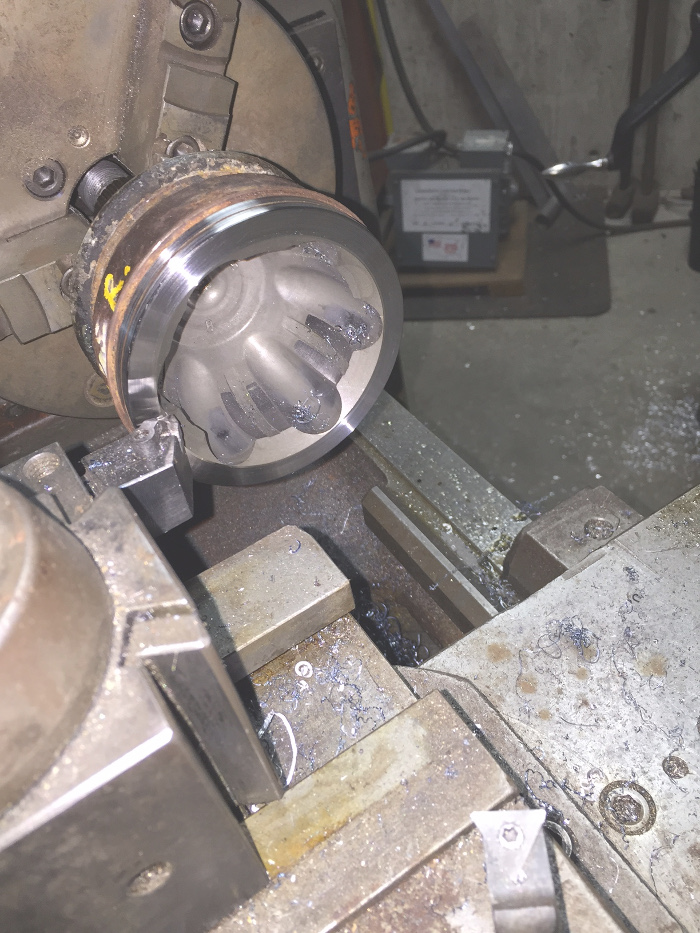

Yesterday I got after the CV shaft shown in the earlier piccy.
This stub shaft will become the center shaft of the drive shaft brake, going into the disc brake hub (usual position) except being modified to accept a U JOINT flange yoke.
Took some pix of the stub in the lathe between sessions of worrying off material.
These suckers are very very hard and the carbide tools were taxed a bit.
I machined off the outer edge enough to get a nice area to allow six evenly spaced 3/8" tapped holes to fasten the yoke adapter plate.
Even after chewing off a considerable amount of materials and getting down into the "core" of the part, the material is still harder than a whores heart, likely 40RC
Was thinking about using carbide drill and tap to get the bolt holes in, but decided to take the part to a local heat treat shop and have then pull the hardness back a bunch.
"Annealing" the beast will allow me to use standard drills and taps to get the holes finished.
Will stop by the heat treaters tomorrow and see what they can do as far as $$$$$
The cost of carbide taps is not at all Cheap, so a few bucks to anneal this bad boy is worth every penny.
The hub, rotor and other parts should be here tomorrow.
Glad to be making some chips and doing something other than make sketches and such.
For the application at hand the part does not need to be so ungodly hard.
Here are some pix.

Spent a fair amount of time researching u joints, yokes and flanges this afternoon and this entire plan is looking real good.
Will need a catalog list of all the strange combinations of U JOINTS and parts in the drive line:yum:
But as I have stated before, it is far easier and cheaper to modify and use off the shelf goodies than buy all new.
I gotta wait and see what I get with the S10 frame in the way of shafts and such.
Here are some pix of the shaft

Dropped the stub shaft off at the heat treat shop and they are going to anneal the bowl area back far enough that I can drill and tap the thing
$150 charge, but far cheaper than custom carbide tooling
Will be way cool to get that piece finished.

The heat treat shop called up and said that my stub shaft is done and ready to be picked up.

Got out yesterday and dragged home the S10 CHASSIS
Almost drowned doing it though.
Pouring down rain by the bucket load.
Only saving grace was the yard folks sat the chassis on my trailer with a big fork lift.
Got it all home safe and sound.
The rain let up a bit late in the afternoon and I got a chance to look things over a bit.
Several items that are readily salable and with any luck will bring back what I paid for the entire chassis.
The entire engine and accessories is there as is the 2wd 700R tranny.
The complete exhaust system is there too, and will likely serve well as a good starting point to build from.
Nice cross member for the rear of the transmission that can easily be used in the cat.
Decided on a Flowmaster single to dual muffler as they make the V6 sound nice and will easily fit right into the cat chassis.
Too wet to get a good look at the engine cradle, but from what I can see it will be a very easy adaptation into the cat frame.
Far easier than building all new from scratch.
There may be a few other goodies, but mostly I wanted the 2wd style tranny to save having to scare up an output shaft and tail housing.
I can part out the Van tranny and t case as a unit and likely recoup some good $$$$
Wanted the factory engine cradle, exhaust manifolds (has stove for carb heat)
Exhaust crossover and exhaust brackets.

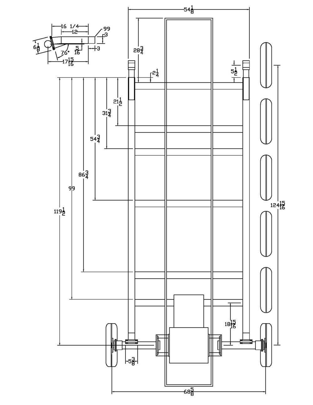

Robyn.. here you go with a little more than wood and cardboard. Sketch what you need and route it back as I'll add it for you. Looks like your cardboard mock up is not going to last in the northwest rain.:w00t2: The front bogie is on a slide tube and I do not have the exact travel run out. The width is to axle face as I've not measured my offset on rims. I'd get the torch out and start hacking that S-10.

Interesting little morsel
The Thiokol manual says that the track width center/center on the axles is 61"
Is yours wider for ????

Thanks for posting the drawing up here
