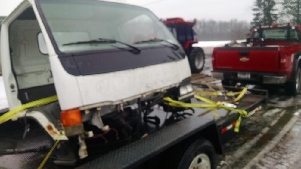

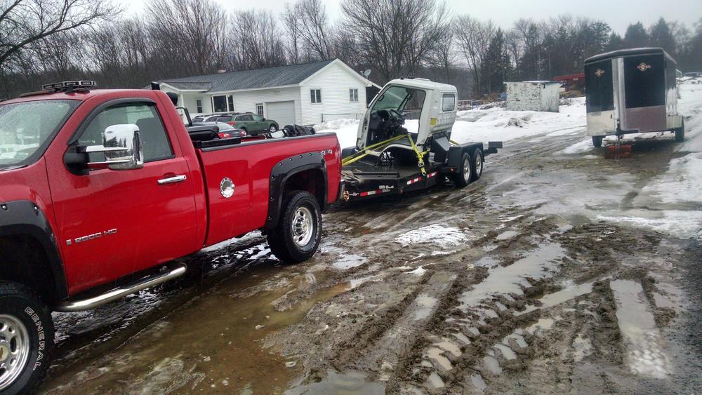

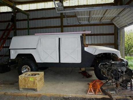

my sv-200 and the new/used cab and yes I have the doors---this will be one of my summer projects when I know iam done grooming

Re: An introduction/hello and my project.
So good of you to ask the question...
Mess OMG...Messss
Well it will be a beast for sure.
Everything that may need service will be accessible.
Already laying out the areas of the floor to get some access ports to be able to service the fuel pump from the top, fuel filter from the top, the area over the Weasel diffy and the pillow block.
The main drive line from the 4L60 back to the pillow block will be able to be removed from the pillow block from the top and the shaft slid out between the van chassis and the sub frame.
I am currently studying a plan for getting the starter out in a pinch.
A couple ideas are starting to form for this.

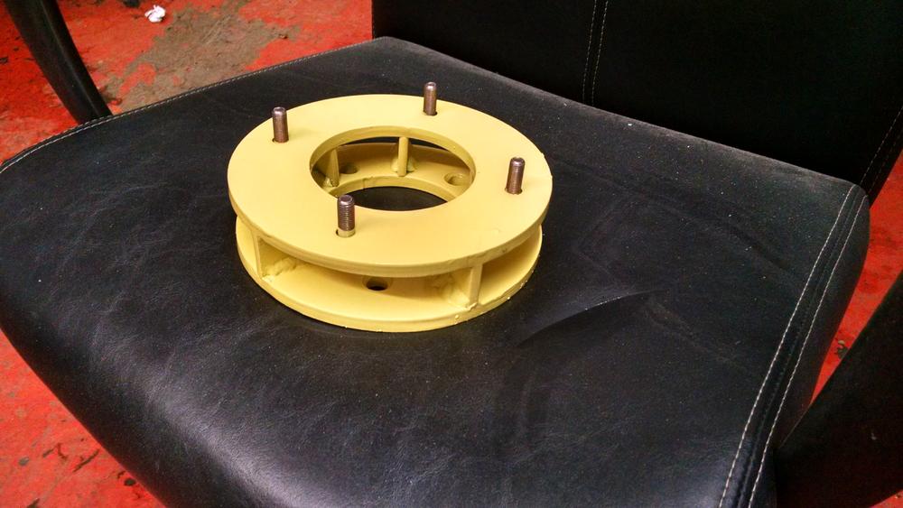

The van chassis will mount in the front using the original wheel hubs/lug studs and the rear will be two small frames that will bolt to the original rear spring hangers and have a single round boss on the bottom in the middle with a urethane bushing and a 1 inch bolt through.
This would allow the front attachment to be removed and the body jacked up off the "Track frame" and simply pivot on the rear attachments.
This will allow for some extra access room between the engine/tranny and the track frame.
I don't want a boat in a basement thing ya know.
The fuel pump is a beotch even with just tires and wheels.
The area above the spare tire can be opened up to allow a nice access to things.
Truth is that the ASTRO IS A PAIN TO WORK ON PERIOD.
With the easy mounting, if work like the tranny is needed the body can be jacked up and the track frame rolled out and the front wheels bolted back on and the rear end supported on stands.
I am going top keep this as simple as possible.
I am not spending $$$$ to replace anything that is already paid for and functional.
The front frame of the van will be anchored with either one large plate or possibly two smaller ones to prevent the original suspension from flexing and force the cat axles to do the flexing.
The idea is to keep the track frame from twisting.
Access for repair is right up front on the drawing board.
After repairing the heater and a couple other things that were not functioning it really reinforced my disgust for any mini van.
I though of other chassis that might work, but I love the forward seating of the Astros.
Just mod things to be able to get at stuff.
Make cover plates to cover the access ports/holes and roll with it.
My plan is to use nearly everything thats in the van.
The steering column is already there and has many controls, so it stays...(Remove the wheel and install one that has the spokes removed (air bag vehicle)
The control sticks will mount to a bracket on the floor and will use two HD PUSH PULL jacketed cables to operate the steering band control levers.
The cables can go under the drivers seat and lay on the carpet and then through the floor in the rear and connect to a bracket close to the Weasel diffy.
A local company made several of these types of cables for me over the years for our dump trucks (Hydraulic controls)
Simple and not spendy.
The rest of the ASTRO MESS will remain as it came from Ma General.
I have given thought to fabricating a complete light bar that will bolt to the cat frame and come up each side of the front fenders (Far enough forward so doors do not hit)
Room for super bright white off road lights and amber beacons and or amber LED flashers and maybe a long white LED in the center.
Way too soon to do more than think about possibilities as far as the light bar goes.
The biggy is getting the Weasel home..
Still under 6 feet of snow. Will be April/May before we can snag the Weasel.
The basic drawings are coming together but until the Weasel is sitting in the shop so I can get good dims off it there is little I can really do as far as the Frame goes.
I have a good supply of box tubing for the sub frame, but not gonna cut anything until I am sure of a few more dims.
Too miserable outside anyway..

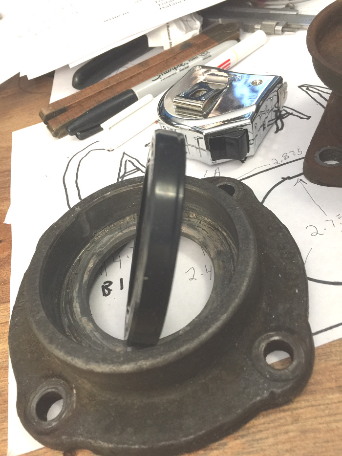

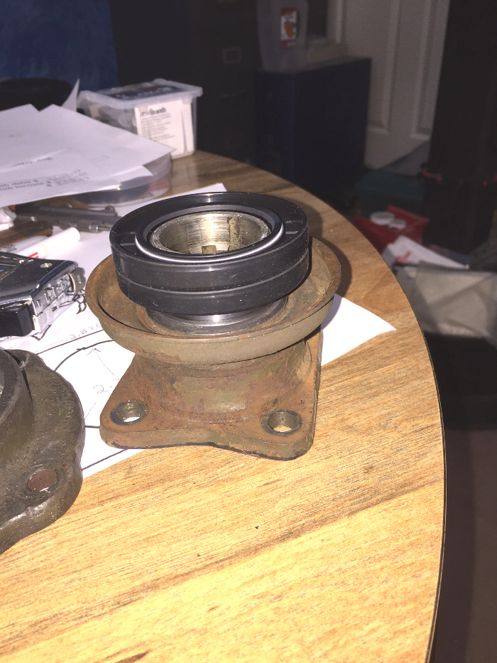

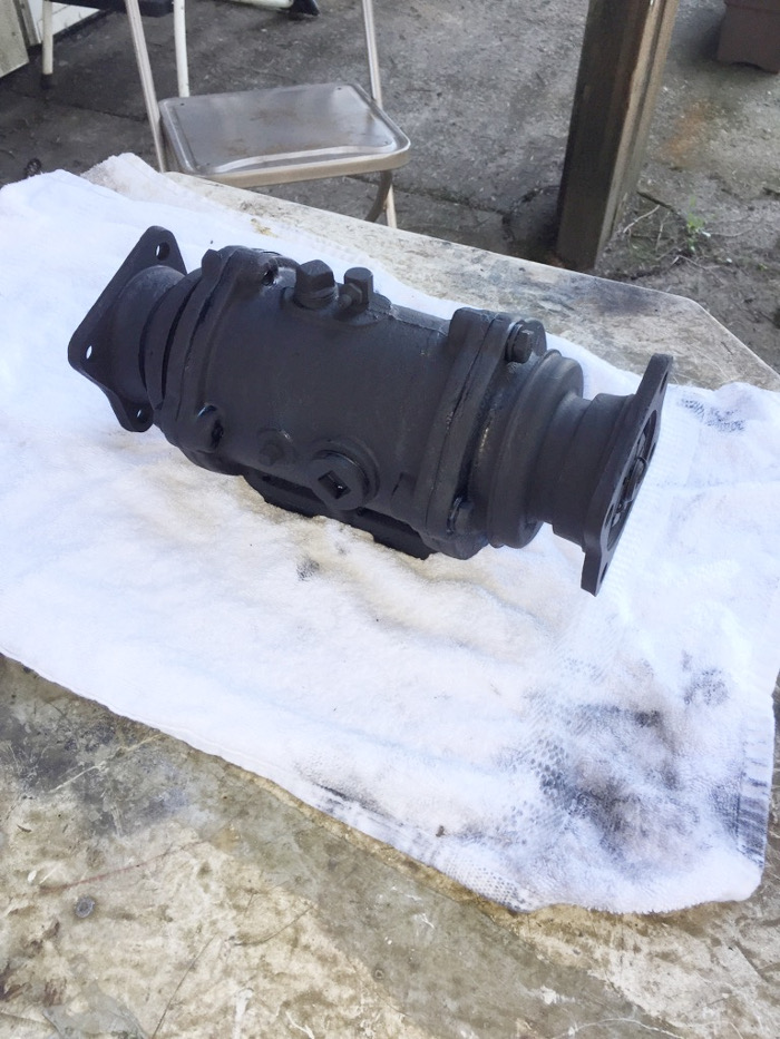

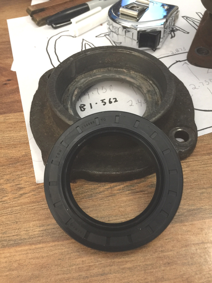

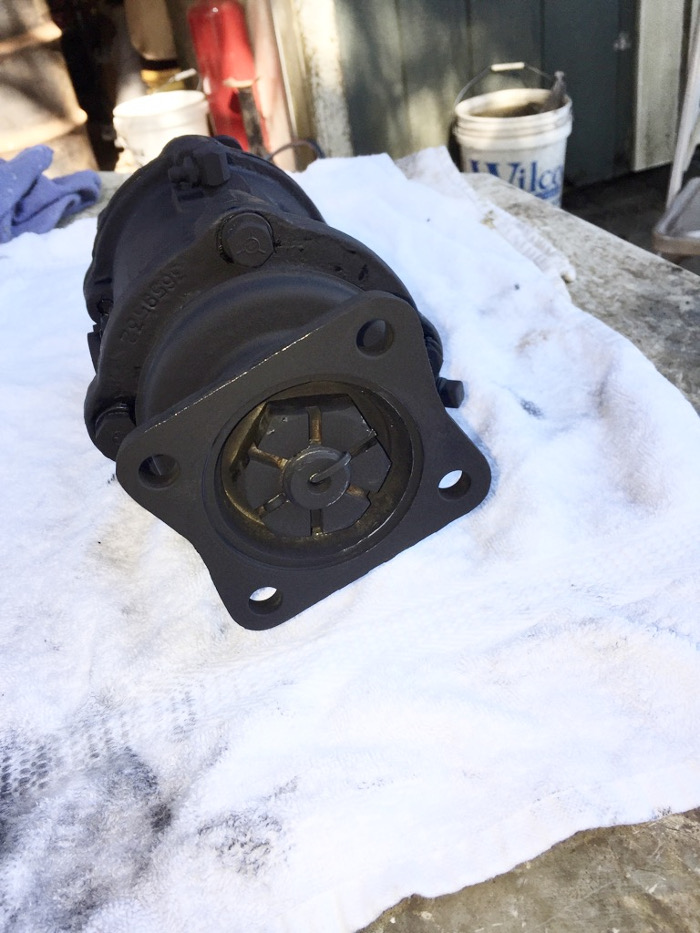

Got the new seals today for the M211 pillow block
I can clean the thing and put it back together.

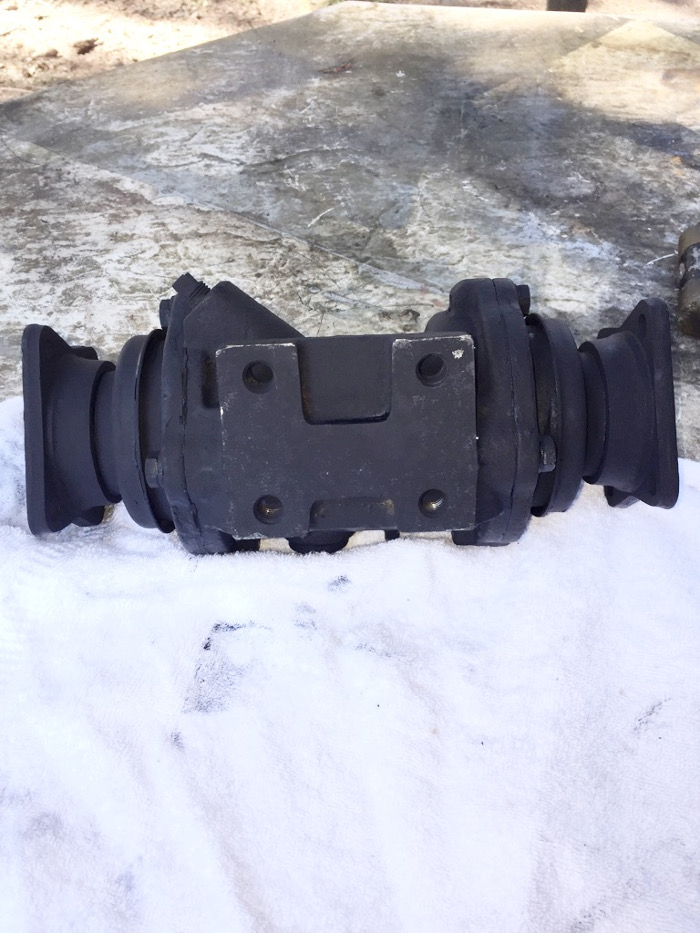

Got out this morning and cleaned the PILLOW BLOCK all up and got it ready to go back together.
Got the new seals, so things can go back together.

Here is the last BIG project I did.
Badlands HUMMER kit car.
82 Suburban frame with the KIT mounted.
A lot of work.
The kit was not bad, but left a lot to be desired.
Turned out OK
Fella caught me in a parking lot and made me an offer I had to take :smile:
This beast was an everything needed kit.
I had to do the fab work, the mechanical, the wiring for everything, the interior.
Gawd what a chore.
The fiberglass top was OK but the attachment was a tad flaky and took a lot of work to get it water tight and secure.
Other stuff like the radiator was a pain too.
The Kit spec'd out a 350 Chevy and I used a 6.2 Diesel and needed a much bigger radiator to cool the thing.
Just got tedious in some areas.
This is why I want the Van cat concept... Far less fooling about with the nick knack crap..

Got out today as the weather is finally lovely.
Decided to get the drive line idler pillow block reassembled.
For being 65 years old it's literally like new inside.
All cleaned up and reassembled now..
Decided that the OD green paint left from 1953 was just not gonna hack it, and a can of high heat header paint was sitting conspicuously on the edge of the shelf... so it's black now.

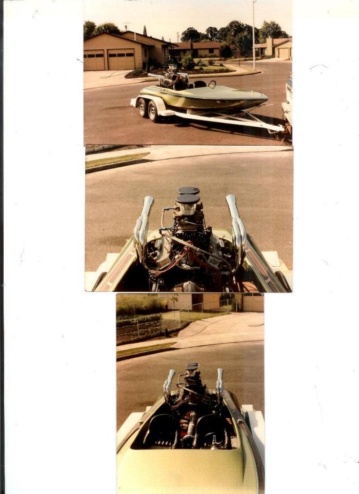

I was sifting through a couple Thumb drives looking for a piccy of some sledding from years past...did not find.
But found a few pics of some fun project from my past exploits.
Though someone might enjoy.
The GMC was a sweet little ride.
WE enjoyed it a lot, but when we built the new place here at the ranch we did not have a good place for it for far too long and I did not want the rodents finding their was in.
The Sanger boat was fast and, well I'm too old for that now.
Body took too much beating from that beast...
