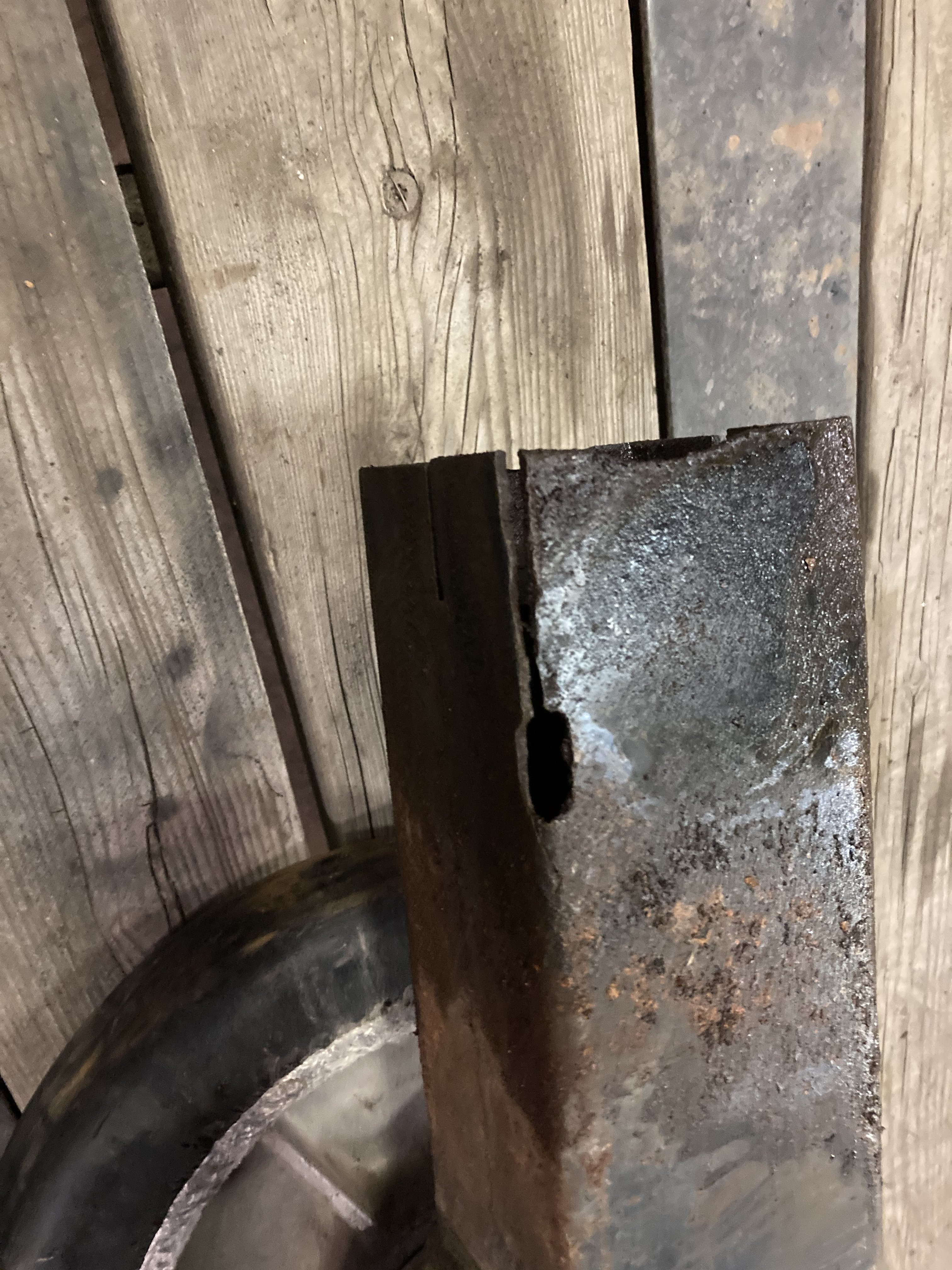

Here’s the right rear. Note the rust, the crack and the piece missing. All of that was of course fixed, and then thoroughly greased before reassembly. We also found the adjusting bolt was broken. Scott took some all-thread he had on hand and cut it to length, then turned down one end on his lathe and welded a new nut on the end. We still have the left rear carrier to do...

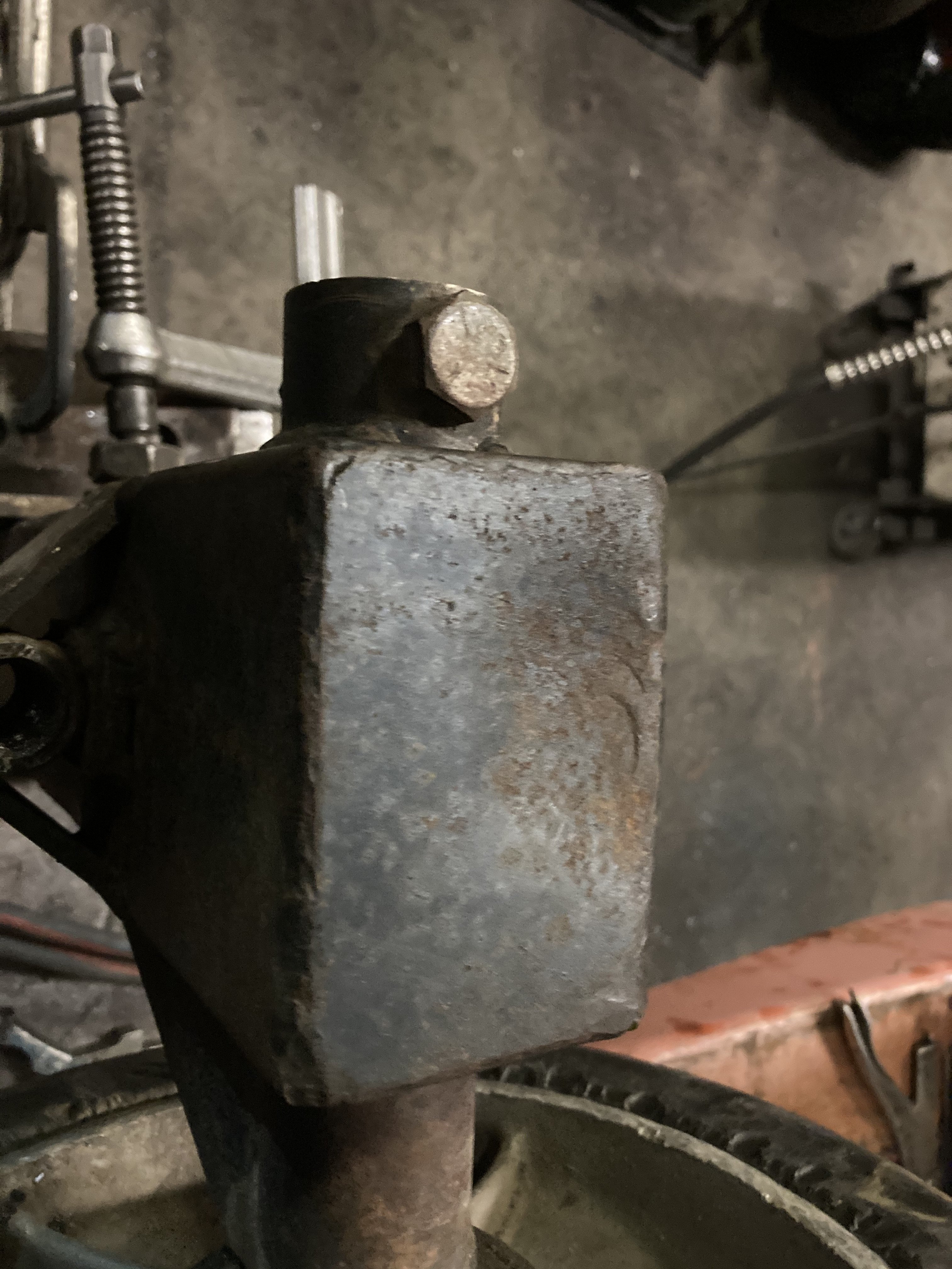

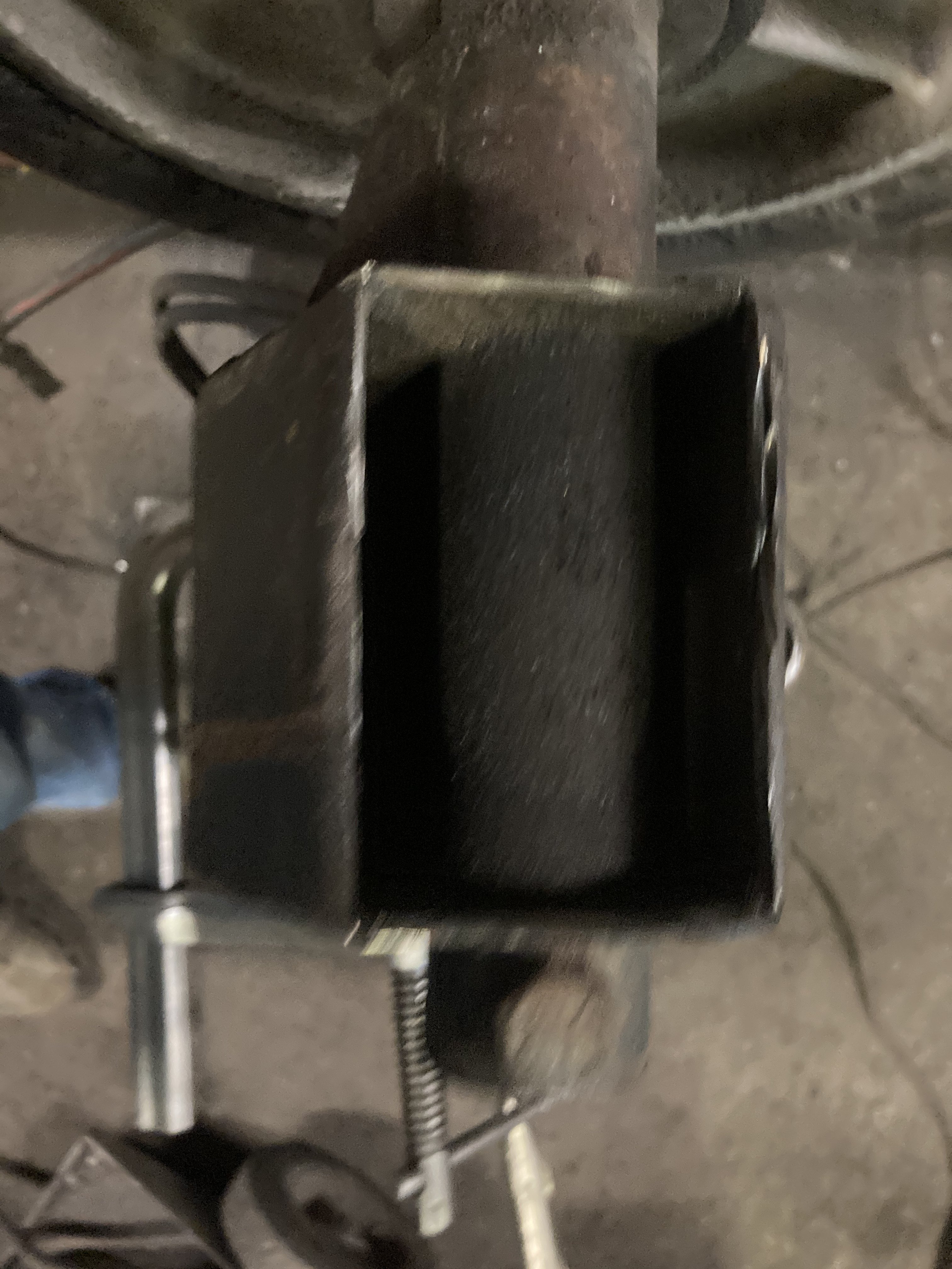

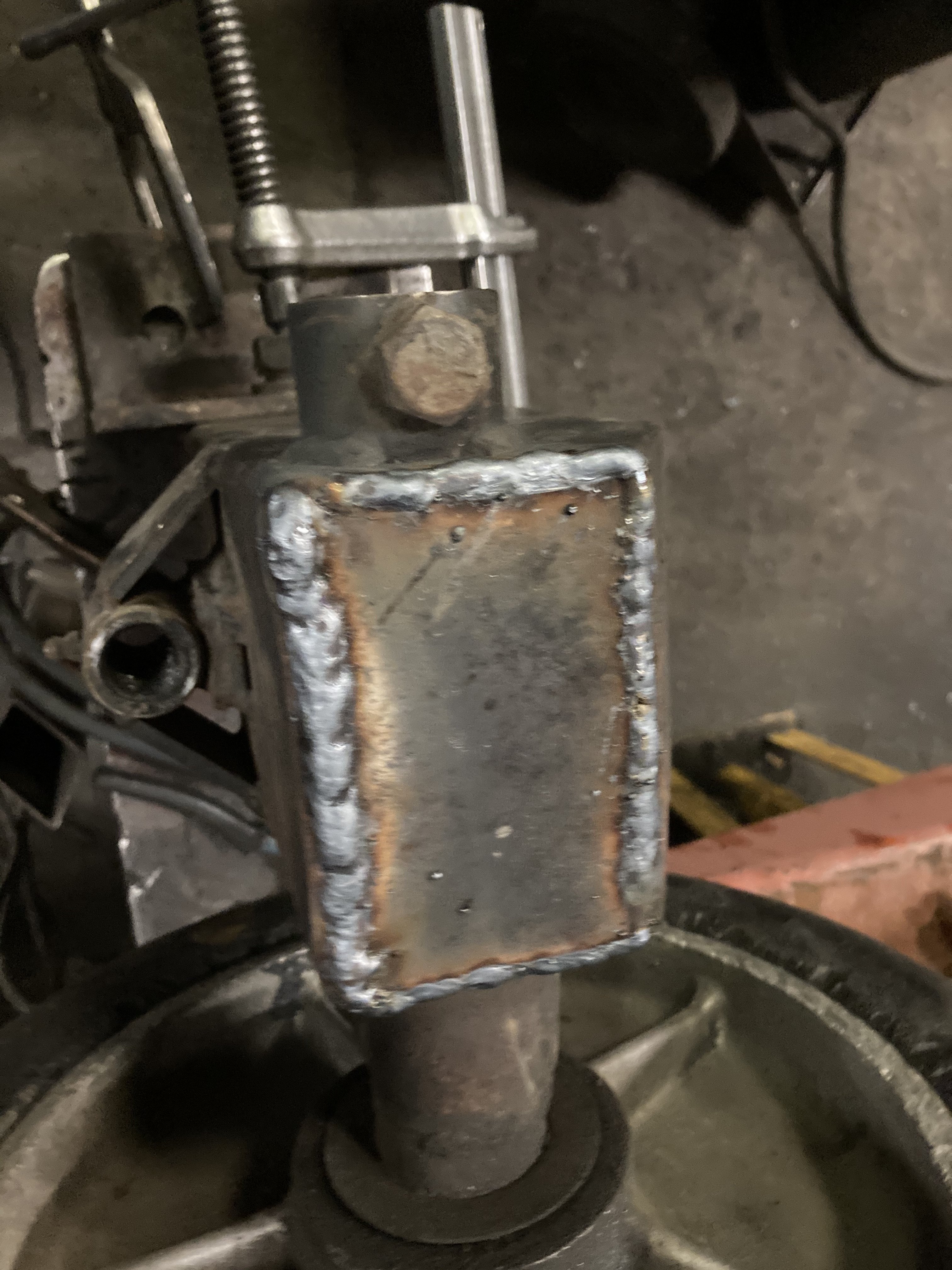

Here’s a pic of something that is all too commonly seen. The is a photo of the end of a carrier’s adjustable section. These are made from steel with only a 1/8” wall thickness, so they really aren’t that strong. But beating on the end with a hammer will damage the end. If it were properly maintained and greased periodically, the end would slide with hand pressure and no extra force would be required. But rather than investigate the problem and correct it, someone chose the “If it doesn’t fit…force it” method.

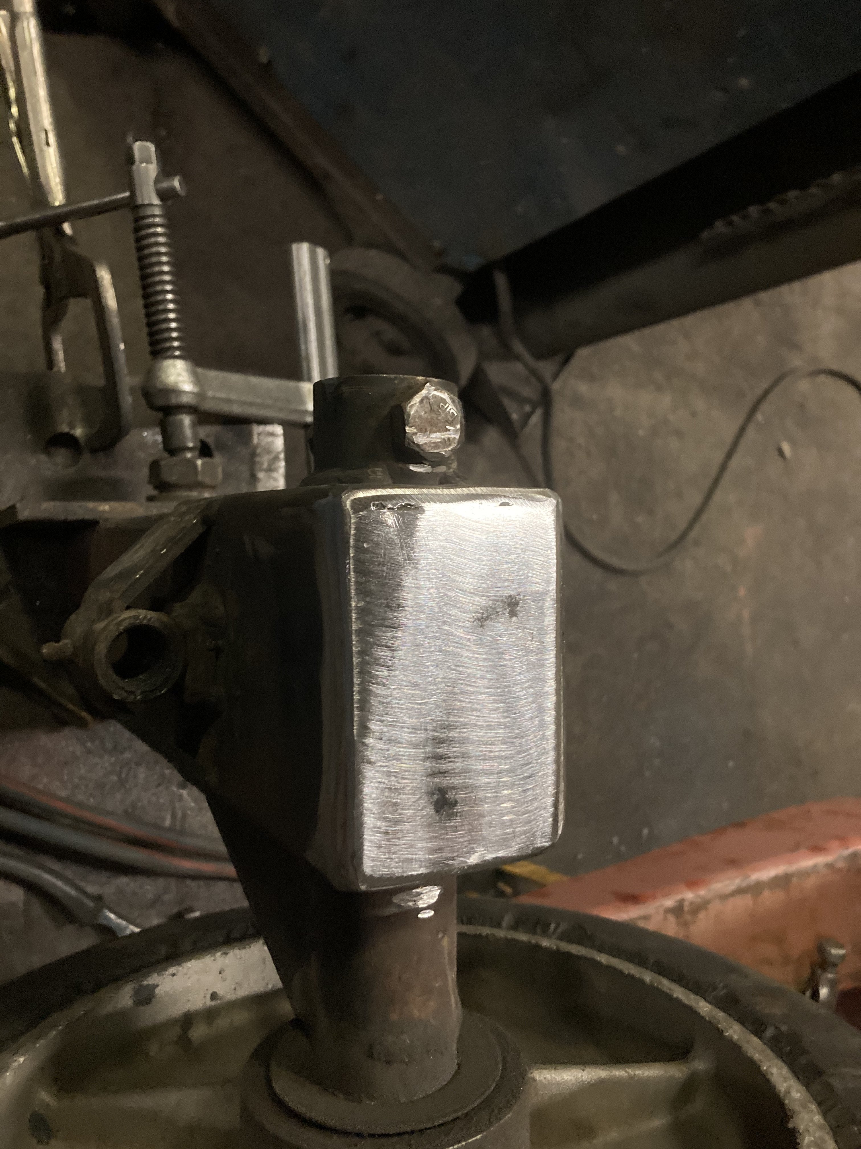

Just like the angled exhaust, the slightly caved in end bugged me. The fix was to cut the end cap off with an angle grinder and cut-off wheel, straighten it, weld it back on, clean up the welds, and then a little paint.

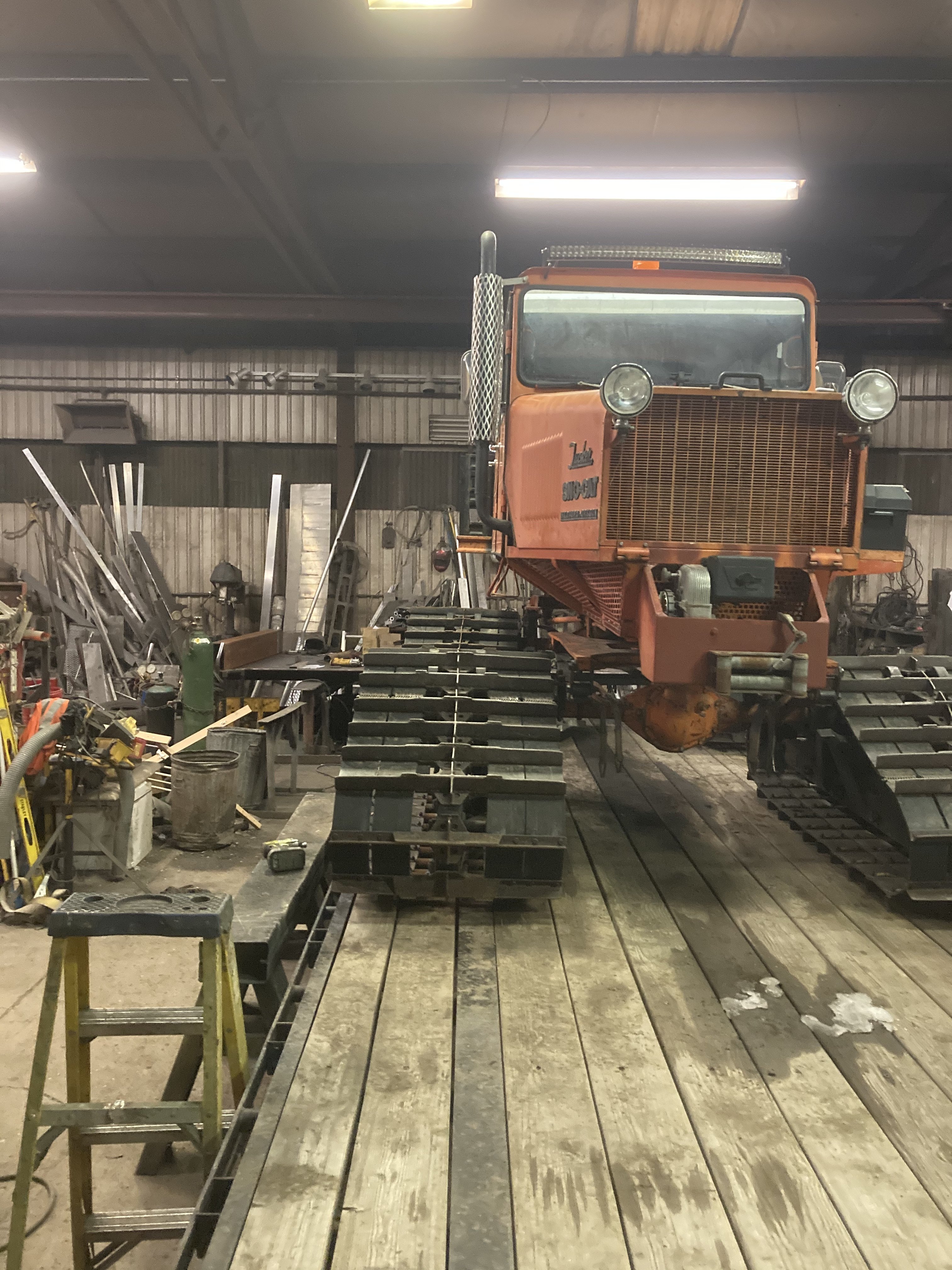

Perhaps unsurprisingly, when we dove into the left rear carrier we found some issues that needed to be addressed. Nothing serious, or that we hadn’t seen before, but it did require some time to get things in order. We replaced some wheel seals, the axle hub seal and re-tensioned all the tracks. In working on the machine, we both thought that it needed an alignment. Tucker detailed the procedure in their February 2010 newsletter, and we followed that document carefully. If you read it over, it sounds more involved than it really is. http://sno-cat.com/wp-content/uploads/2019/06/volume-2issue-2.pdf
In general terms, you start out by ensuring the hydraulic steering cylinder is positioned exactly in the middle of its stroke. This means that when the procedure is complete, the machine will turn the same amount in each direction. Okay, that’s pretty common-sensical. After the steering cylinder is positioned accordingly, you look at what Tucker calls the “center swing”. This is the part that the hydraulic steering cylinder attaches to, as well as both front and rear tie rods.
The center swing should be positioned so the tie rod attachment locations are perpendicular with the truss frame, and in a vertical line from the center swing’s pivot point. Adjustment is made by detaching the hydraulic cylinder’s yoke from the center swing and threading the yoke in or out as necessary to achieve the proper angular relationships. I’ll pause for a moment and say the hydraulic cylinder doesn’t get longer or shorter over the years, the center swing's pivot point doesn’t change and neither does the location where the fixed end of the hydraulic cylinder attaches. Yes, these positions could change with major frame damage, but in normal use… no.
Tucker paints the machine in an assembled state, so the paint they apply serves as a witness mark to where the yoke was positioned on the hydraulic cylinder’s shaft when it was assembled and left the factory. Imagine our surprise when Scott needed to move the yoke out a full 7/8” to get the prescribed angular relationship. (Okay, I was kidding about being surprised.)

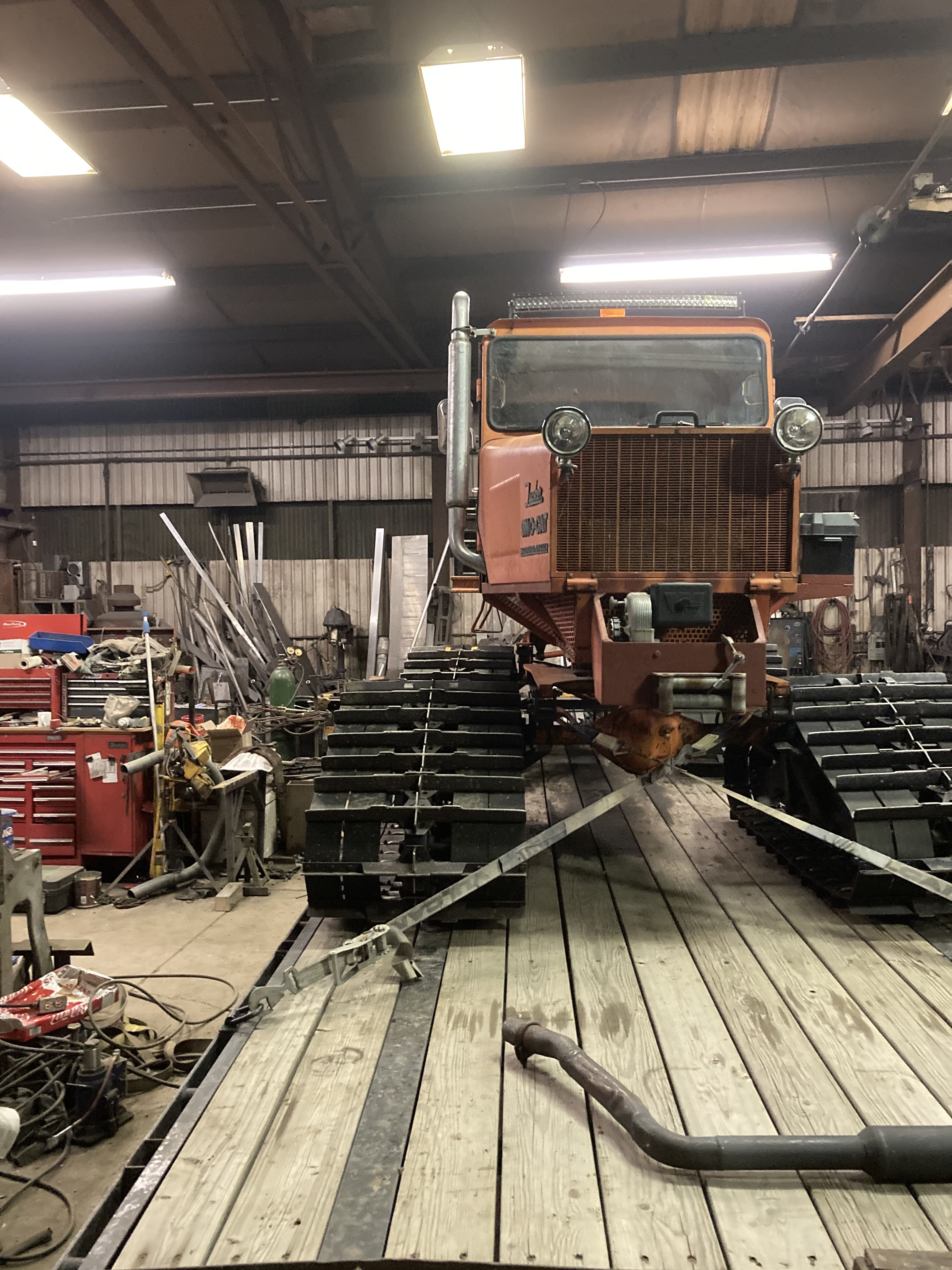

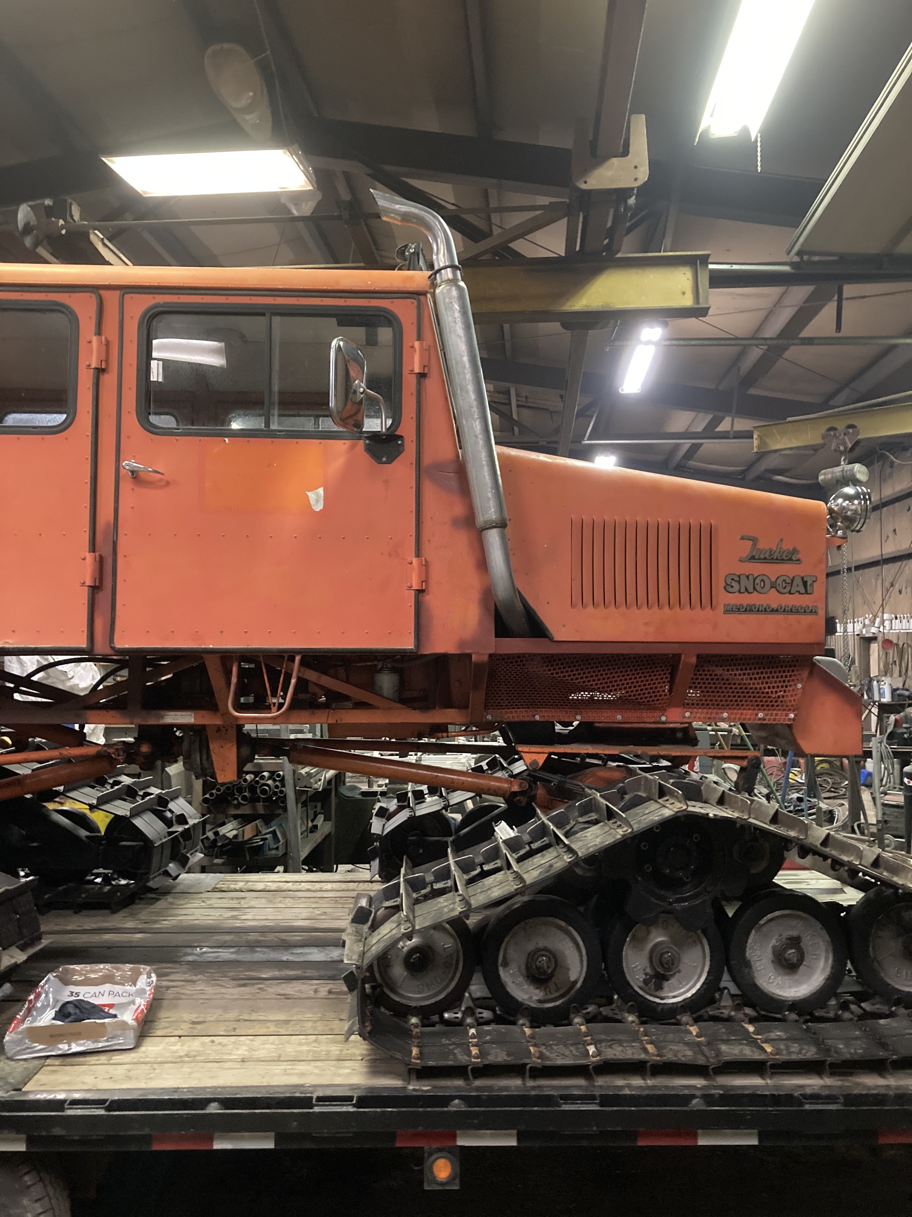

Here are pics after it was complete.
Front view. Note the old exhaust system laying on the trailer deck in the foreground. That’s what I took to the exhaust shop.
Side view.
What we were striving for, in terms of positioning and alignment, is for the system be parallel with the side of the cab in the first photo (doesn't angle in or out). In the second photo we wanted the angle of the system to parallel the windshield frame. There also had to be enough clearance for the door to open fully and not hit the muffler, or the yet-to be-installed heat shield.
If you're wondering what the Coca Cola packaging is doing laying on the trailer, I held that in position as Scott was doing some welding to prevent the sparks from hitting and damaging the glass. Instead... they landed on me.

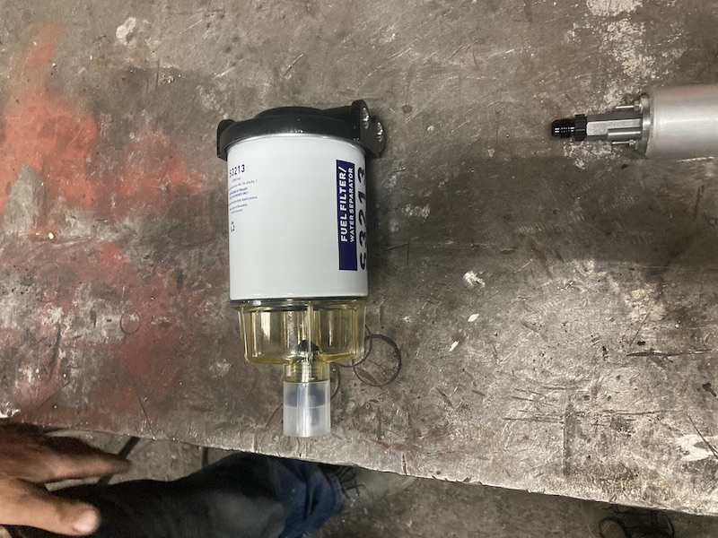

Scott and I like to use a marine style, water separating fuel filter that has both a larger spin-on filter element and a clear, drainable sediment bowl underneath. This filter is a 10 micron filter, which is the recommended filtration level for the second filter in Edelbrock's suggested setup, so we’ll use just the one filter in our system. We think having water separating capability is a good thing in a snowcat. Tuckers have large steel fuel tanks, and with a low level of fuel and certain atmospheric conditions, there is substantial concern about condensation inside the tank. Water is heavier than gasoline, so it would settle to the bottom of the tank…exactly where the fuel leaves to go to the engine. Having a clear sediment bowl that’s drainable allows one to check for water in the bowl as part of their snowcat "pre-flight” inspection, and drain it if present.

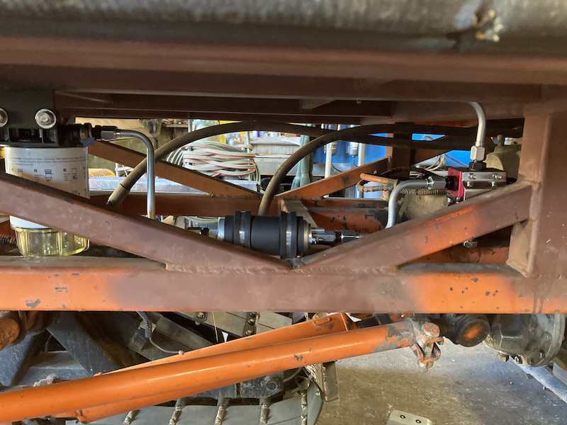

Work progresses on the 1544. Fuel system component installation and the hard line plumbing of the fuel system up to the fuel pressure regulator is complete. We could have mounted the filter, pump, and pressure regulator in essentially a horizontal alignment, but doing that would mean obstructing the view through the truss frame with a large steel mounting plate. Instead, we mounted the filter up high and the pump low, then the pressure regulator a little higher. We think it’s a better, less obtrusive look, even if it complicated the tube bending somewhat. Where the hard line stops short of the engine we’ll use a length of braided stainless steel hose to connect with the Edelbrock system. The connection port for the fuel line is on the right side front of the intake manifold, which would be logical if the fuel line was coming from the engine mounted mechanical fuel pump. But we like the idea of making the connection toward the rear of the engine, and plan to reconfigure Edelbrock’s setup accordingly. One benefit is keeping the fuel lines away from heat sources, such as the exhaust. system.
Scott sort-of stuck to his “I've bent my last fuel line” recalcitrance. I did the bending, but he did offer assistance as far as suggestions, and the usual tweaking, torquing and spiraling necessary for final adjustments. On the whole the plumbing went reasonably well. One must install the tube sleeves and tube nuts prior to flaring the tube ends. On previous projects we have forgotten to do this, and it’s a Homer Simpson Doh moment when you realize your mistake. Having been there and done that I wanted to make sure I didn’t forget… and promptly put a tube sleeve on the wrong side of a bend. Yup, another “oh darn” experience. I could have cut off the tube sleeve, but that might have meant a special trip to the hydraulic supply store, so I sacrificed about 1 1/2” of tubing. (I can just picture Bubba and Billy Bob laughing. “Hey genius, if you used rubber fuel line you wouldn’t have done that. Hah, Hah. Hey, Billy Bob pass me another beer.”)
It seems to be really difficult to get a line bent 100% correctly the first time, and the adjustment process takes a fair amount of time to make the necessary tweaks. The cardinal rule is don’t cut it too short. But even if a line with a 90º bend at the end is too long, it can be adjusted. You take out some of the bend closest to the end of the tube, and add some bend on the other side of the 90. That process shortens the overall length a bit, and lengthens the leg past the 90º bend. That’s not a big deal because you can cut the flare off and re flare the tube to shorten it. What is more difficult is when you have two tubes in fairly close proximity. You want the two lines to look good and that typically means running perfectly parallel with each other. Even though they both fit fine, and would work fine, that personal pride isn’t satisfied until they look right.

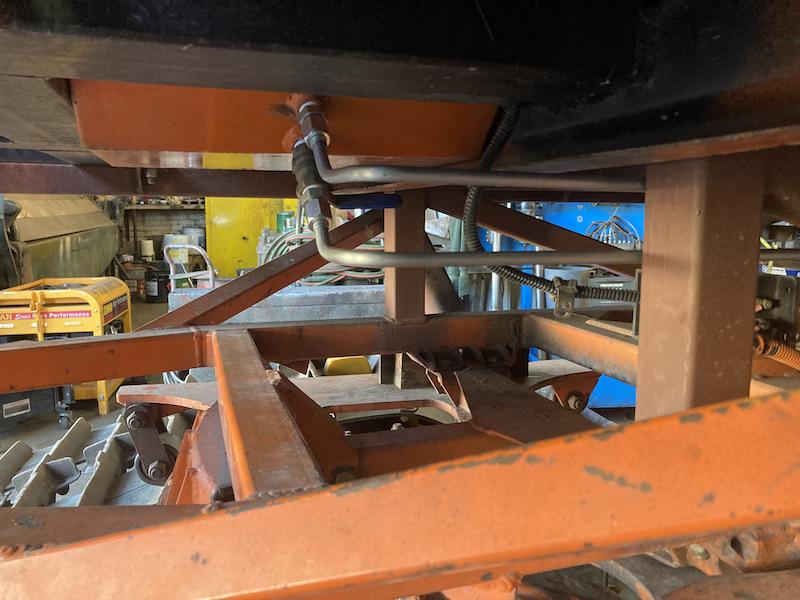

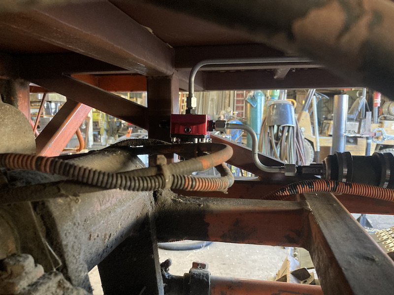

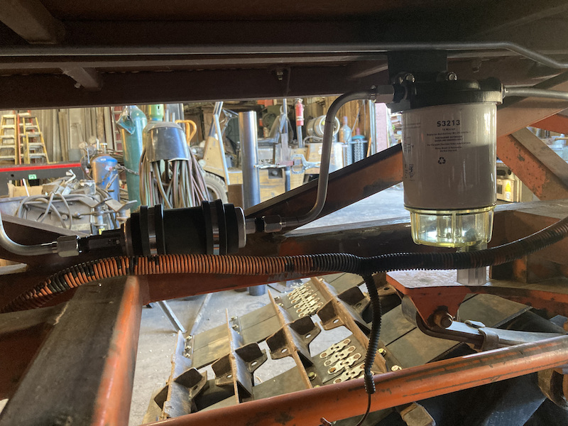

Some pics. Fuel supply line is at the bottom and the return to tank line is at the top.
Working forward you can see the filter, pump and pressure regulator.
A view from the other side.

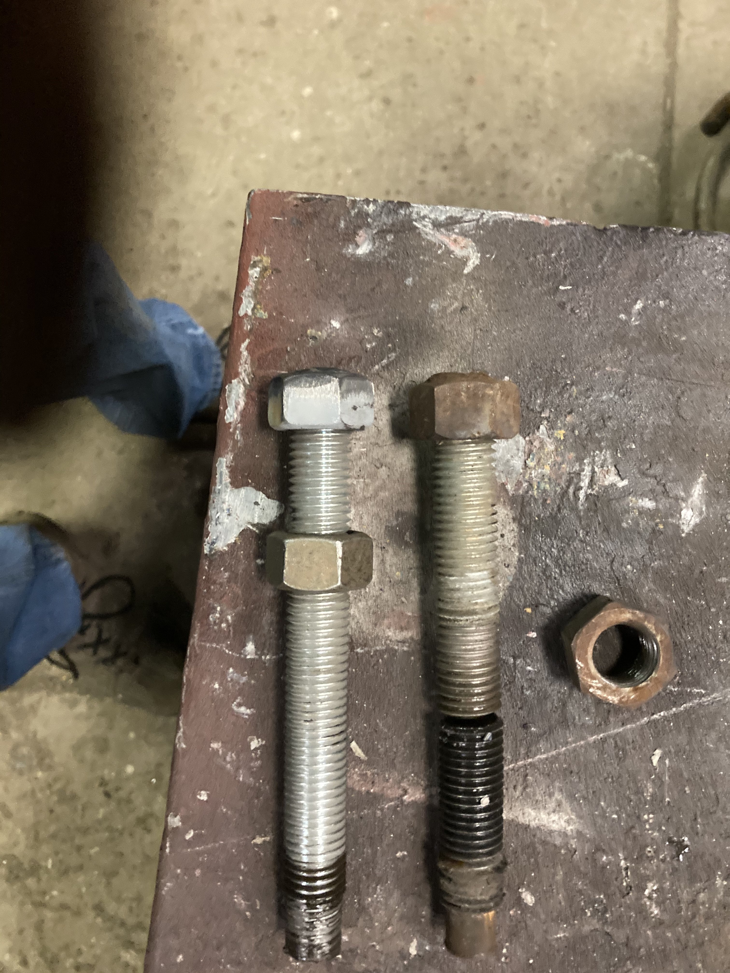

For threaded holes there are minimum thread engagement criteria, and in steel that is one times the bolt diameter; in our case 3/8”. We could have cut the bolt shorter and not had to break out the die grinder, but then the thread engagement would have been less than the accepted minimum. There is still plenty of thickness in the casting and we're sure the system will function fine. Edelbrock, that’s strike one.
Incidentally, I did some Googling and apparently this is a known issue. On at least one forum, several people have absolutely hammered Edelbrock for not fixing this problem, even though it had been reported several years ago. This guy pulled no punches "I thought that Edelbrock would have addressed such a simple design error... but no. As an engineer (although I don't work in this area) it is embarrassment to the profession to call this an engineered part.”
