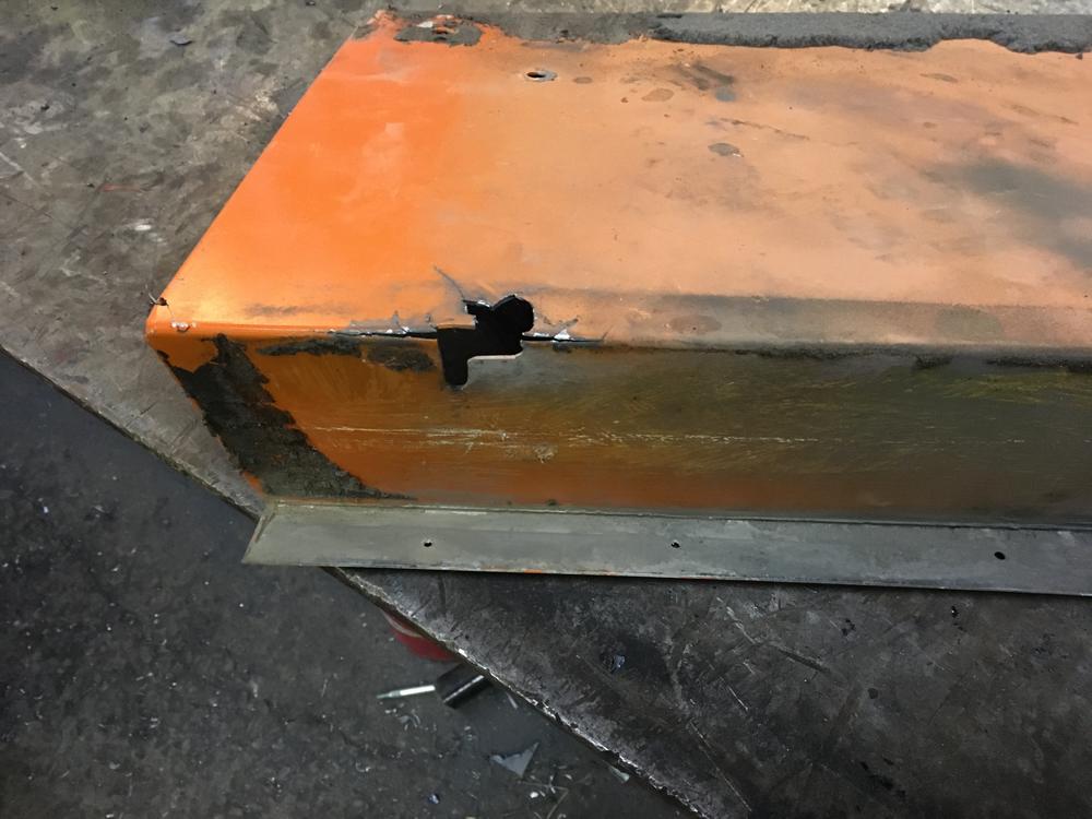

We had one more frame component to replace, the left front diagonal brace between the lower, inner frame and the upper, outer frame. Here are some before pics.
You can see the distorted “square” tube.
And where it was split by water that froze inside.
And here’s the new one installed.

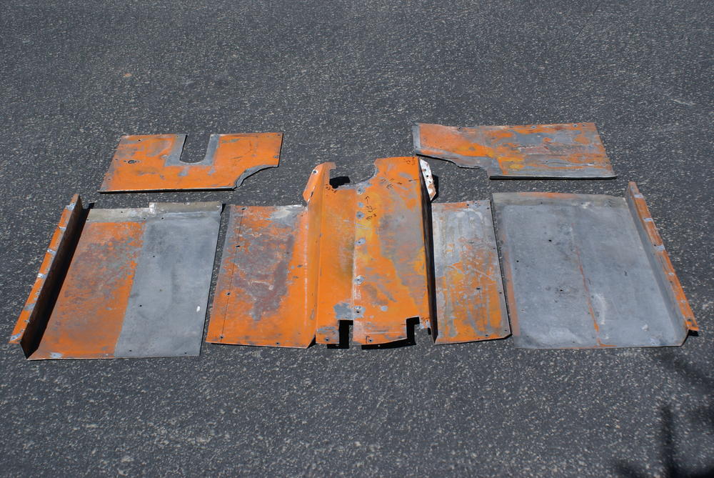

All previous Tuckers I’ve owned have had poorly designed, and poorly constructed floors. The same poor design and execution held true in 1986. On the Vail Cat we literally threw away the Tucker floor and started from scratch, which is pretty much exactly what we did with Thundercat, too.
Here are the original Tucker floor components from the Vail cat laid out on a driveway.
And the new one we made.
Here’s Thundercat; new rear and center floor sections.
And the front floor, complete with an enclosure for the blade system control valve. (We also added the trapezoidal bracket for the transmission shifter. It’s welded to the dash and bolts to the valve enclosure. Everything is tied together and is very solid.)

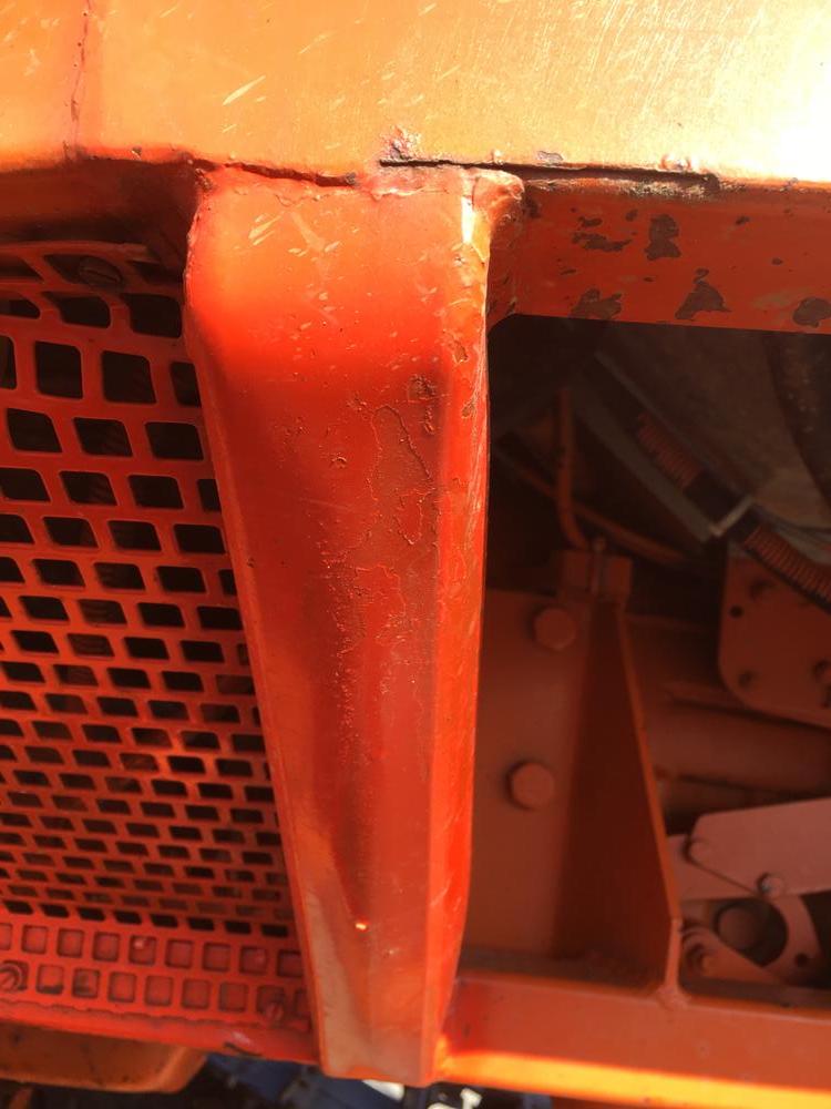

The floor in the ’86 had some serious shortcomings, as did the seat support structure for the front seats. Honestly, if this design were submitted as a college freshman engineering assignment I think the professor would give it an F, with a note to the student that his basic concepts of design and materials strength are so poor, perhaps he should consider a change in major to one of the humanities. You might think I’m exaggerating and/or trying to be funny, but I’m not. It really is that pathetic.
Tucker welded a piece of J-shaped steel between the rear door posts of the front doors. To that, they welded four roughly 15” lengths of 1" angle at 90º protruding forward. They drilled holes in the pieces of angle to attach the seat adjusting brackets, which in turn were bolted to the front seats. There were no supporting frame members under those lengths of 1" angle. None. Tucker then took some .062 aluminum sheet and bent it to attach to the support between the door posts and cut holes in the front of the sheet for the four pieces of 1” angle to penetrate. They bent the front of the aluminum sheet in a Z shape. The angle of the diagonal leg of the Z is so acute that you can’t get close to the diagonal leg to install a fastener through. And the bottom horizontal leg is so far forward it barely rests on the frame crossmember that, in theory anyway, should provide support. (The front floor panels overlap and sit on top of the horizontal Z leg.) Tucker then secured the aluminum sheet to the 1” angle pieces as "support” for the front of the seats with some small machine screws. All four locations where the aluminum sheet was attached to the pieces of angle were broken. Think about that for a second. That’s a 100% failure rate. And due to the shape of the Z, and minimal contact with the crossmember, there are no fasteners to secure it to the crossmember. This had to be obvious to the Tucker employee(s) who assembled this machine, but apparently they deemed it "good enough”. Pictures tell the tale.
Here’s a photo of the front seat support structure. You can see the J-shaped piece between the door posts, and the four front seat mounting pieces of angle protruding forward. (The E-brake handle is zip-tied to keep it out of the way, as we move the machine in and out of Scott’s shop to work on it.)
Here’s a shot from the right front door looking left. Note the total lack of support underneath the protruding lengths of angle. The small diameter holes behind the larger holes in the front are where the aluminum sheet was attached with machine screws. Note also how little of the front floor panel is resting on the crossmember. As you look along that crossmember you’ll see that contact area remains minimal, and that there are no holes for any fasteners from the floor to that crossmember. The floor just sat on top and could rattle away. Because it wasn’t securely attached, over time one piece of aluminum on top of the other caused pretty significant wear to the aluminum sheet at the contact points. Brilliant Tucker, brilliant...
Despite my best efforts, my powers of description fail in comparison to photos. This is the right side of the sheet metal floor section and seat bracket support. The holes on the unpainted horizontal leg of the Z are where the Z attached to the front floor sections. But this was forward of the frame crossmember.
This shows the piece of angle protruding through the sheetmetal, and you can see where the attachment point is broken out.
What made this mess extra frustrating was on the one hand we wanted to start from scratch and create something to be proud of, but we have a hard deadline to meet, and we have to draw the line somewhere, or we’ll blow through yet another deadline. (We’re good at that!)

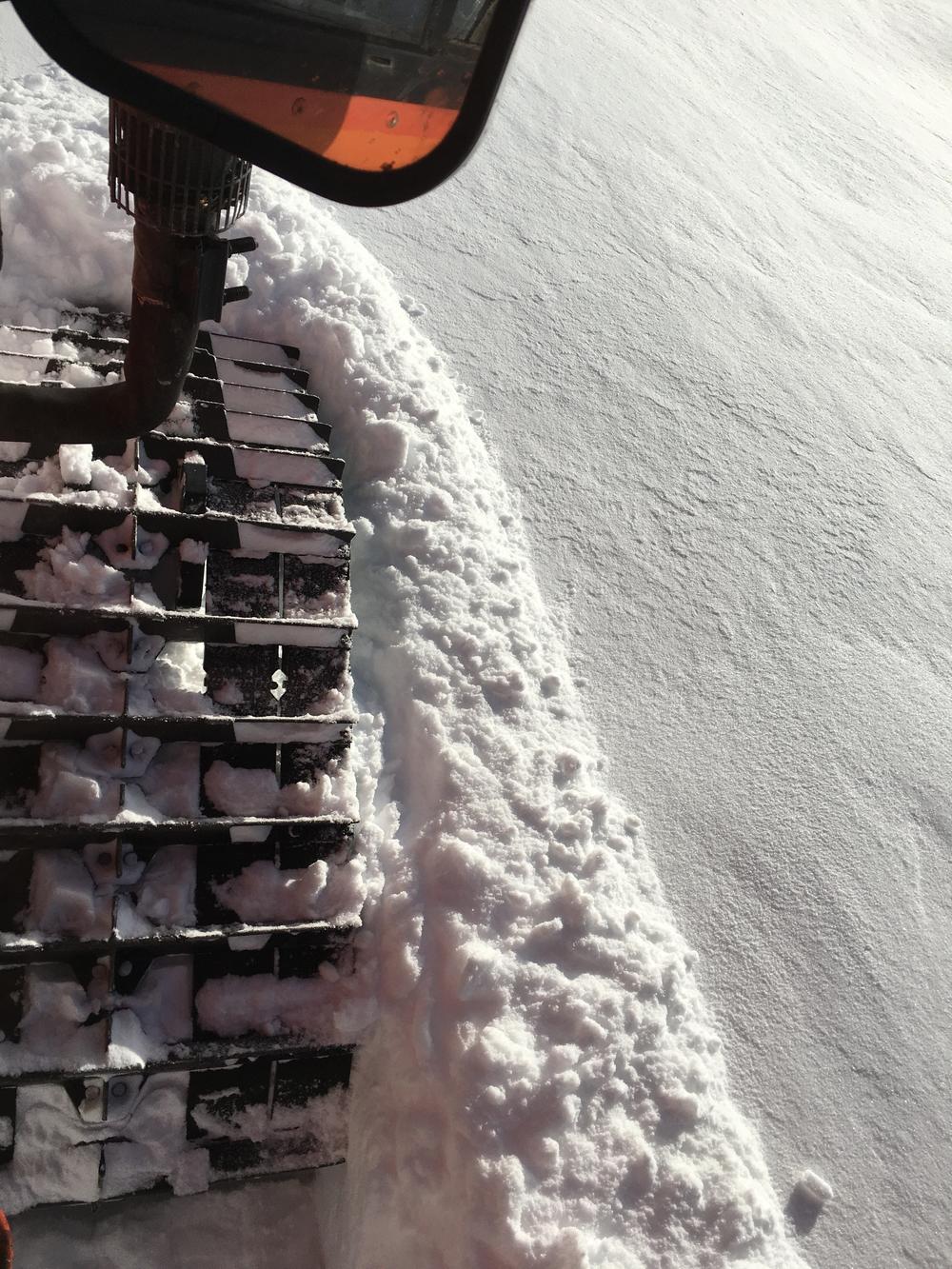

After we got about a mile in from the trailhead we were making “first tracks” everywhere we went. I took a bunch of photos but I’ll only provide a couple.
This gives you an idea of the snow depth and track penetration. For reference, with the machine on a flat surface the top of the grouser in the center is about 30” higher than the flat surface.
Perhaps this should be called “Where Snow Tracs Fear to Tread” (just kidding…maybe). Yes, the bent hood grab handle bugs me - Hugely. (A new one is on order).

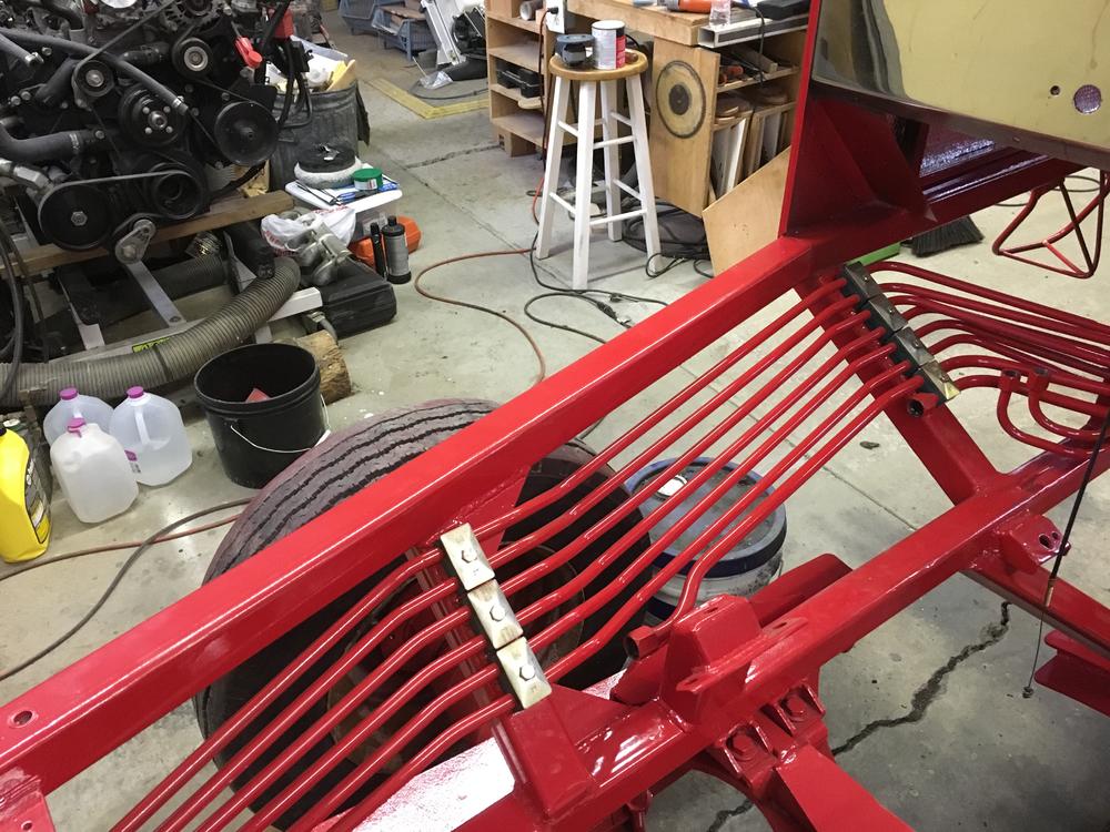

Here’s a photo of the frame area under the front floor. The shiny areas on the frame are where the new floor supports will be welded to the frame.
With the supports installed. Note the use of red oxide primer. It serves two functions; one being the prevention of rust, and the other is that it acts as a barrier between the steel frame and the aluminum floor components. This prevents the galvanic corrosion that Tucker is so infamous for. This step is not expensive and it’s not time consuming, but the benefits far outweigh the time and money involved….unfortunately, the factory doesn’t see it this way.
This is how Tucker did the floor support back in 1980. You can see the under floor support made from 3/4” angle. Note the hydraulic line setup that connects with the six way valve. If you look closely on the vertical floor support, you’ll see a short length of heater hose slit and secured to the vertical leg with zip ties. Then the multiple hydraulic lines are similarly secured to the frame with larger zip ties. Believe it or not, this was not a prototype effort made for testing. It was a production machine delivered to the customer in this configuration.
That was something that we changed on Thundercat. Yes, it was time consuming, but once you get it figured out one could make duplicate tubes for subsequent machines fairly easily. Look Ma: No zip ties! And this from a couple of knuckleheads... not a “professional” company. (Sorry for the tangent, but this is a pet peeve.)

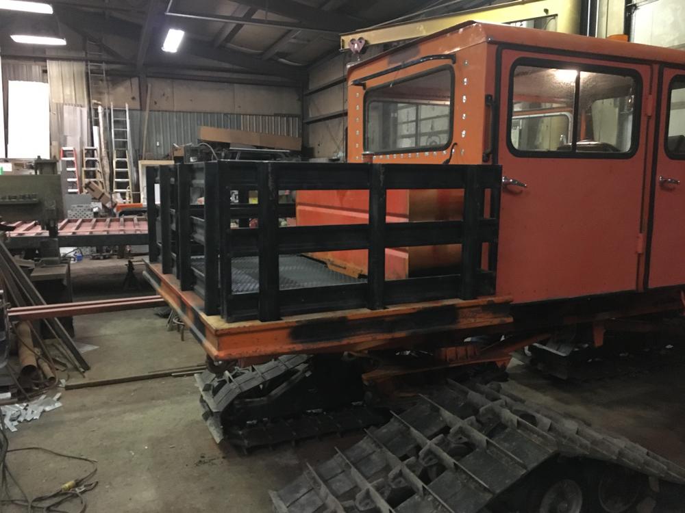

But here's the chapter on the bed, actually done a few weeks ago:

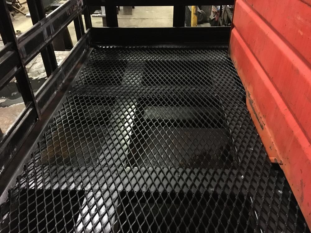

After getting the cab floors installed and the seats bolted back in place, it was time to move on to the bed. I suppose we could have cleaned up the areas where Scott had used an acetylene torch to cut the bed off, and re-welded the bed to the frame as Tucker did, but that would be kicking the can down the road in terms of not fixing the deficiencies of Tucker’s design and installation. Scott and I talked about different strategies for the bed, and weighed the various pros and cons. We decided to use the same type of expanded metal decking, and with the diamonds oriented the same way Tucker did! However, we would use both a different structural support member than the purlins Tucker used, and a different layout of those members, which is correct for the orientation of the expanded metal.
First though, we had to remove the existing expanded metal and the purlins. Then all the residual welds had to be removed in preparation for installing the new supports and decking. The rear bed frame rail was tweaked a fair bit. It looked like a previous owner had backed into something, and they had also badly bent the rear frame rail’s bottom flange in one spot. All of this needed to be sorted out before welding in any new pieces. We also decided to move the gas tank forward about four inches, which would would provide a little more useable bed space. Four inches doesn’t sound like much but the useable bed space is only about 42” front-to-back, so four inches is almost 10%. A 10% gain for not much work is an easy trade-off. Moving the bed that far forward also meant that the fuel tank would be used in place of stake body side boards. Note: a previous owner, for an unknown reason had cut the filler neck and it was held in place with some rubber hose and worm drive clamps. We removed the hose and Scott welded the filler neck back together.

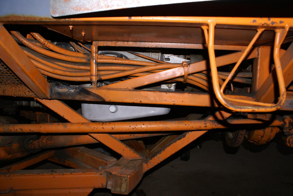

Gas tank- bed interface.
When it came to straightening the bed I think it would have been amusing to watch the back and forth discussion. Scott is all about function and strength, and I want it to look good, in addition to being functional. (You can think of me as the little white angel on his shoulder.) After the first attempt at straightening the rear frame rail we had taken out the bulk of the bend and now it was only about 1/4” out. Scott proclaimed that acceptable, but I thought there was room for improvement, and after all, we’d only tried once. “It’s not a piano” Scott protested. “Yeah, but we can do better” was my reply. And so it continued... as I badgered him to get the bed rail as straight as possible. It’s not perfect, but it turned out pretty well.
For the new support members we decided on 4" x 2” rectangular steel tubing in 14 gauge thickness. We installed four, full length pieces parallel with the Tucker's side frame rails (which makes them perpendicular to the long side of the diamonds on the expanded metal decking). All four members cantilever over the rear Tucker frame adding a lot of support to the rear of the bed. We also installed some additional sections perpendicular to these new frame members to support the side frame rail sides, the gas tank, and the expanded metal decking. When you look at the data plate and compare the machine's empty weight to the max GVW the difference is 1,900 lbs. Subtract fuel and people, and there’s still quite a payload. But our impression of the stock bed was that it was under-engineered for the potential load. The purlins Tucker used are basically a U-shape, and the legs of the U have inward flanges at 90º. But there’s an open section, and if you weld something perpendicular to the sides there is no strength at all; the side of the U just bends inward. By using rectangular (or square) tube, one can weld the perpendicular support members and they will have plenty of strength. We think our design is superior in terms of supporting the bed rails, as well as supporting the expanded metal decking. The newly re-configured bed is bolted to the Tucker frame with four Grade 8, 1/2-20 bolts and Nylon nuts. What a (obvious) concept!
Here’s a pic of the bed floor after the bed was reinstalled on the Tucker frame.
And an underside shot. If you look closely, you can see one of the bed to Tucker attachments.
We also decided to change the way the gas tank is secured to the bed. Tucker uses two straps of flat bar over the top of the gas tank that are welded to sections of threaded rod. That system works okay, but we’ve run into a problem when trying to remove them. On a couple of occasions the nut on the threaded rod has rusted in place. Gentle persuasion didn’t work, and the idea of using a torch to heat the nuts right next to a vented gas tank could qualify one for a Darwin Award. And, depending on the configuration of the bed’s frame, those nuts can be a bit of a challenge to access as well. We had run into this issue before (on Thundercat) and we decided to weld some lengths of angle (with holes for mounting bolts) to the gas tank's end plates fairly close to the bottom. Using the end plates makes for a very secure mounting. Welding gas tanks is very dangerous if you don’t know what you’re doing. Scott does it fairly often, and so he takes the appropriate precautions. (I think I discussed this in the Snowzilla thread, and therefore won’t repeat the details.) I’ll confess the first time I saw him do this (nonchalantly, I might add) I wanted to be far away. But that seemed to be hugely lame, and I “trusted" him. Now, it’s a non-issue, except he liked it better when I was “concerned” and squirmed a bunch.
When I bought this machine there were no side boards installed but there was a somewhat goofy rack system that bolted to the bed and the cab’s center roll bar. That was removed in pretty short order, but while working on the bed we had to weld the rack’s mounting bolt holes closed. Thundercat’s bed was originally similar in size to this one; 6’ wide and 4’ long. That seemed somewhat small and we made a new, larger bed for Thundercat that's 6 1/2’ wide and 5 1/2’ long. (The extra 18” length required stretching the Tucker frame 12”.) We still have the old bed and decided to use the sideboards from that on the 1544. Naturally, in true Tucker form, the layout of the pockets for the vertical posts was different, and the pockets for the vertical posts were slightly smaller. That meant a fair amount of extra work to get the vertical posts to fit in the pockets and modify the various parts for proper fit.
Another view.
