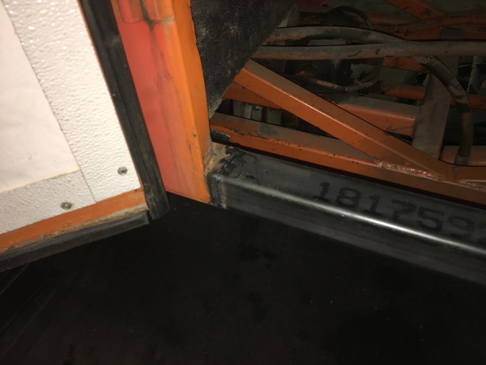

Okay, with that buildup.. I’ve got you curious and this picture tells the tale. What you see is the rear cab wall with the aluminum skin riveted to the framework. Note the vertical post and how it’s open at the top. Any rain water or melting snow or just water from washing the machine will flow down the cab wall and enter that tube. With no drain hole, the water has no place to go and will just sit there. When it gets cold enough, it will freeze. What moron thought that was a good idea?
Here’s another view from further out.
I know some Tucker employees visit this forum. This is your chance to call me wrong and explain how leaving a clear and open path for water to enter, and not leave, a structural frame member is a sound manufacturing process. Go ahead Tucker…

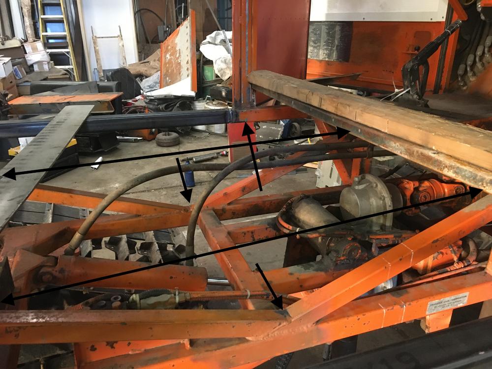

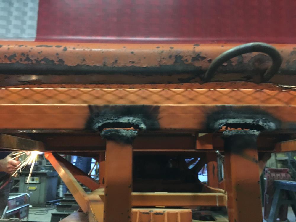

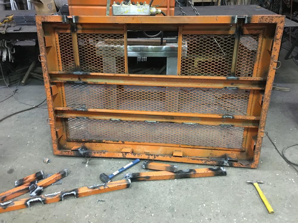

Here’s a pic of the bed after the frame sections had been cut off. You can see most of the frame remnants on the floor. We discovered a couple more Tucker boo-boos here as well. One of them you can see in this photo and the other you can't. Notice the way the frame is put together with two cross members supporting the expanded metal decking. Now look at the expanded metal and the orientation of the diamond shapes. The long side of the diamonds are parallel with the supports. WRONG! The supports should be parallel with the short side of the diamonds. If you’re thinking “Yeah, but this way you can use one piece of material and there’s no seam in the expanded metal mesh”, you’d almost have a point. I say “almost" because you can buy the mesh with the long side of the diamonds parallel with the long side of the sheet or perpendicular to them, though it’s not as easy to find. Alternatively, the sheets come in different sizes and one could cut the needed shape from a larger sheet (though that might cost a few bucks more).
The cross members are basically steel building C purlins. We think they were a good choice on Tucker’s part, but the execution was flawed.
Here’s a photo. Note how the purlin is short of the bed rail on top, and is not welded to the vertical leg. (The photo got rotated during upload.)
The purlins should extend all the way from one frame side rail to the other, and should be welded to the vertical leg of the side frame rails for maximum strength. (The vertical leg appears horizontal in the photo above.) To do that requires just a little forethought, because if you weld the perimeter together first, and also weld in the pockets for the sideboard vertical posts, you can’t then slide full width purlins into position past the bottom flange of the side rails and/or the pockets. You’d have to cut them to the proper length and put them in position before welding the second side frame rail to the front and rear frame rails. That rather basic concept eluded Tucker. We have no objection to their choice of expanded metal decking, or C purlins for the bed. But the way they installed the materials needlessly sacrificed strength, and it’s not like they saved any money by doing it this way.
I’ve been trying to come up with the right words to describe Tucker’s approach to the bed’s construction. To put it politely, it’s snatching defeat from the jaws of victory.

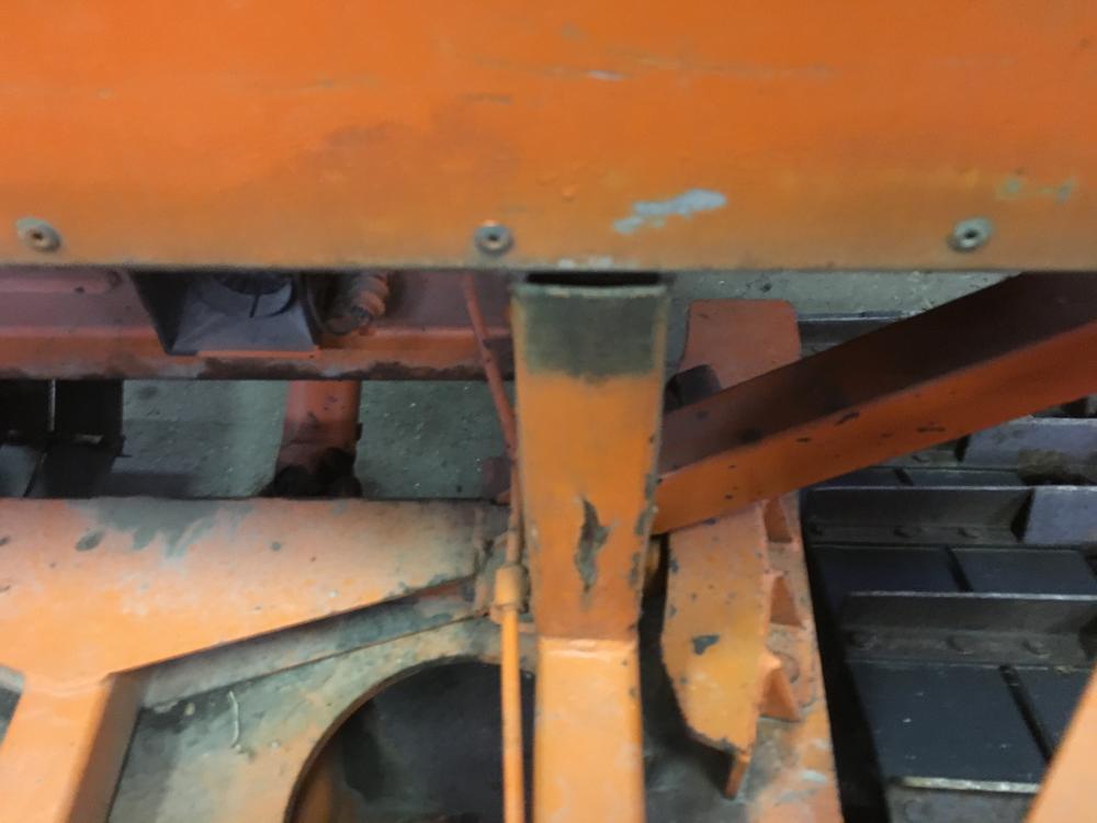

I never saw a square tube tube turn into a round tube until I worked on a Tucker. All natural hydroforming!

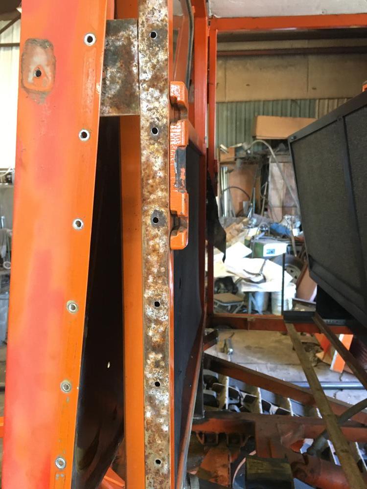

As part of the frame repair process we needed to remove the rear aluminum skin from the cab’s steel rear frame support structure for access to the frame to make repairs. To give Tucker some credit, we discovered that they were now using closed end blind rivets, which was a pleasant surprise. But the joy was short lived as once all the rivets were removed, and we peeled away the skin from the frame, we saw the usual galvanic corrosion caused when raw aluminum is riveted to raw steel. More sloppy Tucker workmanship. But…it got worse.
Here’s the needless galvanic corrosion.

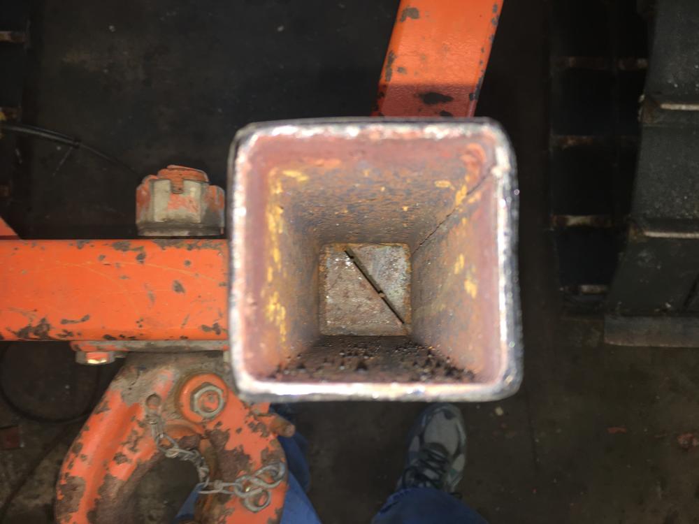

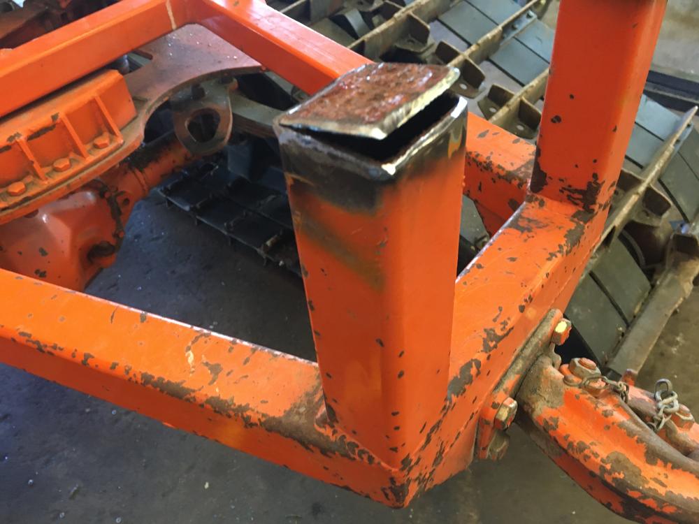

With the bed removed you can see the two vertical posts at the rear of the frame in the lower left of the photo. We needed to remove the parts of the rear horizontal crossmember that were welded to the two vertical posts which support the bed in the rear.

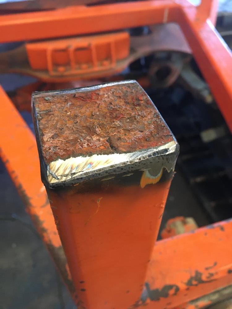

The technique is to carefully grind away the welds until you see a small line, which is where the two pieces of steel meet. You continue to carefully grind away to expose that line all the way around. At that point you can pry up the horizontal crossmember remnant leaving the vertical tube intact, and at the correct length.
At the left side you can see that small line that separates the horizontal crossmember from the vertical post.
After exposing the line all the way around and starting to pry off the horizontal crossmember's piece.

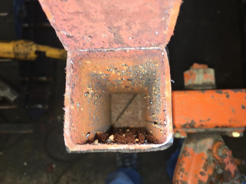

Once the horizontal crossmember parts had been removed, we could look down inside the vertical tubes. Notice in the photo above the configuration of the various frame members as well as some gussets for additional strength. You can also see the factory installed pintle hook, which is what one would tow something from. Presumably, one would want to make that area of the frame really strong. (Yes, I’m setting you up for something...)
Now let’s look down inside those tubes.
Here’s the left side (the last of the horizontal tube has been pried up to be vertical).
And the right.
The diagonal lines you see are where Tucker didn’t weld the frame components together. It’s welded on the other three sides that you can see, but not on the top. Like the situation with the bed, this seems to needlessly sacrifice strength. Scott suggested maybe they put all the parts in a jig and weld them up there, but would it really be that hard to add the two vertical posts after you’ve welded the joint on top? I have a hard time understanding Tucker’s rationale. Scott and I are far from perfect, but we genuinely strive for excellence. Sometimes we don’t achieve it, but it’s not for a lack of trying. Sometimes too, we’re not satisfied with our work product - and we’ll throw it away and start over. But the concept of accepting mediocrity is one we can’t abide by. I think it’s the manufacturing equivalent of “everyone gets a trophy”.

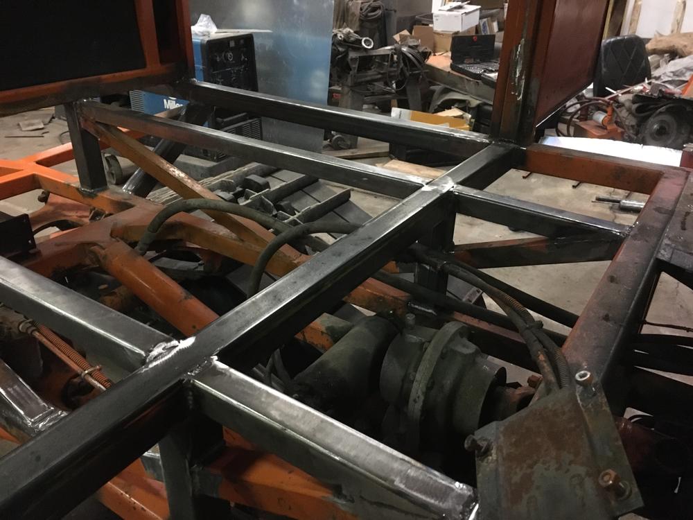

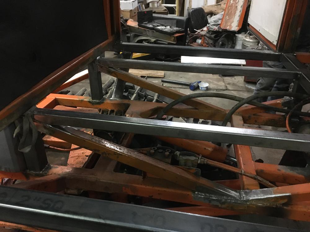

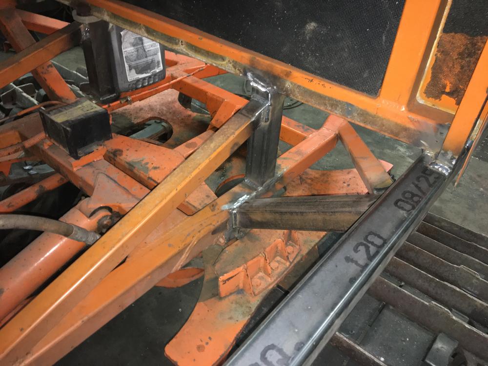

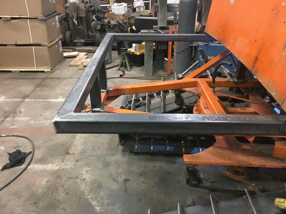

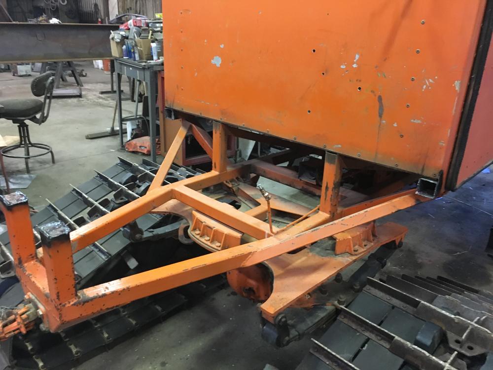

Next, it was time to get serious about frame repairs. Scott had cut the left rear diagonal frame member (split due to water intrusion) from the upper, outer frame, the lower, inner frame and the long diagonal brace. The upper, outer frame square tubing was going to be replaced anyway - so there was no need to clean up the residual weld and slag from it, but we did need to remove it from the other two components. On the lower, inner frame, access for both grinding away the previous tube's remnants, as well as being able to weld the bottom of the replacement tube, was limited by the rear fifth wheel plate assembly. We needed to remove the six bolts holding that to the Tucker’s frame so we could lift the machine up in the back and away from everything. This removal process re-highlighted, Tucker's decision to weld the bed to the frame. With the bed removed, we had much better access, but it was still a bit sporty. With the bed in position it would have been even less fun (a PITA). The bolts were very tight. One of the two long ones in the rear simply did not want to come out, and it put up a valiant fight. What won the battle was me holding the end of a three foot length of 1” steel round bar against the bolt (nut removed) and Scott wielding a ten pound sledge hammer to persuade the bolt to cooperate.
I’ll pause for a moment and explain one of Scott’s nicknames is “The Gorilla”. He got this on the golf course, due to the way he (mis)treats a golf ball in the tee box. He can literally whack the cr*p out of a golf ball…to the point you almost feel sorry for the ball (note the word "almost"). I can drive a ball pretty far, north of 250 yards, but Scott is routinely fifty yards closer to the flag. So once Scott started swinging the sledge hammer, the bolt was going to lose…no two ways about it.
Here’s Scott blasting his way out of a sand trap.
And a picture of Scott in his younger days.

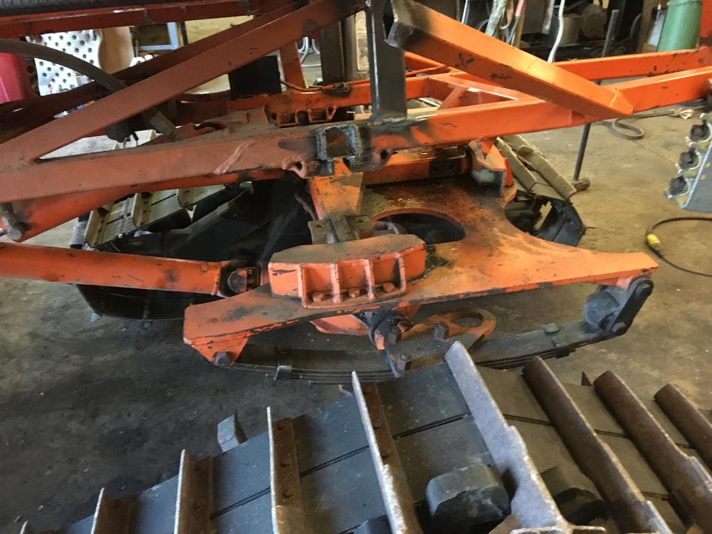

Here’s a photo of the last vestiges of the damaged diagonal frame member on the lower frame with the Tucker lifted away from the fifth wheel plate assembly.
Prior to installing the replacement diagonal support member, Scott removed all the material from the lower frame. He also cut the outside upper frame member 1/2” behind the rear door’s front door post and removed it. To get a full penetration weld between the old and new 2” square tube frame sections, Scott inserted a small piece of 1 3/4” square tube inside the two 2” pieces of square tube. He left a small gap between the two 2” tubes so he could weld all three pieces together creating a very strong welded joint.
Once that was done, the replacement diagonal support member was tack welded in position, as was the rear cab’s rear door post. Once positioning was checked for accuracy, it was welded completely.
Where the new upper, outer frame section is welded to the original frame just behind the center door post/roll bar.
Here are the new upper, outer frame rail and the rear diagonal frame piece welded in position. (The rear cab wall vertical support tubes have also been replaced.) We’ve lowered the machine back onto the fifth wheel plate and temporarily bolted it all back together.

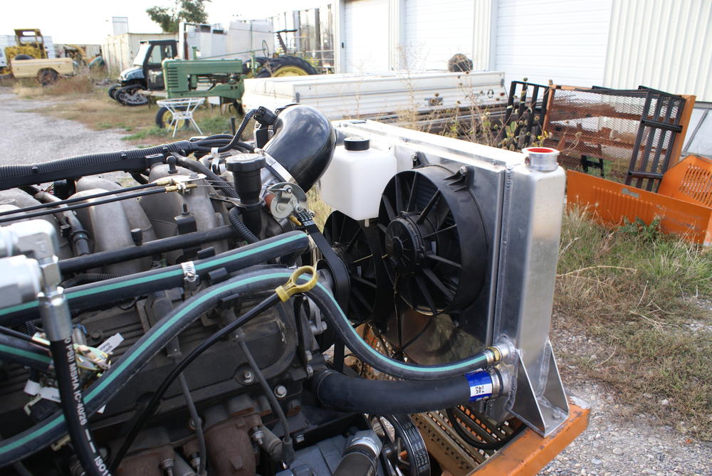

All I can add at this time is if the swedes would have access to the Subaru family of opposed four bangers I believe they would have used them.
I just measured up a 2.5 L subaru engine and it clears the chains handily. VW transaxles handle torque and horsepower just fine behind many different power plants in sand rails and over worked VW camper-vans.

The engine in Thundercat (8.1L Vortec) used a drive-by-wire throttle body which requires a special accelerator pedal assembly and electronic module. We chose to install a cable actuated throttle body and purchased a Lokar pedal setup and a custom cable made locally in SLC. Easy.
This is an old photo, but at present the installation is the same. If you look at the throttle body you can actually see two cables that attach. One is from the accelerator pedal and the other is from a vernier style hand throttle.
Snowzilla though, will be using the drive-by-wire throttle body and pedal setup on its GM L94 engine (6.2L Vortec).

Blackfoot Tucker
I suspect some forum members are put off by my long-winded explanations and detail-oriented descriptions. Some also may not appreciate my unvarnished opinion of the Tucker factory’s product. (I have no sympathy for Tucker in this regard.) Believe me, it would be a lot easier and faster to post a few photos, add a few words and call it good. I go to the time and effort to provide the information for people who either may be considering a used Tucker that might have these issues, or already own one and aren’t sure of what’s involved to repair it properly. That same philosophy applies to other threads, like Snowzilla, regarding comprehensive modifications such a powertrain swap. Essentially sharing how we addressed an issue so someone else doesn’t have to "reinvent the wheel”, though perhaps they’ll come up with a better solution... which hopefully they’ll also share.
I had hoped Scott could use a fairly long welding rod and stick weld the joints Tucker left un-welded at the rear of the frame. While the rod length was okay, there was so much smoke from the welding process inside the vertical tube Scott couldn’t see well enough to do the weld satisfactorily. As a result, he cut the tubes off and we started over. Incidentally, out of curiosity I counted while Scott welded some of the 2” square tube welds. It took him an average of about 11 seconds to weld one side of a 2” square tube.
We replaced both the vertical posts in the rear, the rear frame rail as well as the other (right side) upper, outer frame rail up to just behind the rear door’s front door post.
Tucker had changed the frame's design and we didn’t like some of the changes. The frame configuration can be thought of as a truss, and Scott and I felt there were some inherent problems with Tucker’s interpretation. For example, a parallel chord truss has upper and lower chords and usually has triangular bracing between them. Under the rear floor there was the bottom chord of the truss, which was the lower, inner frame, and there were some triangular braces attached, but the upper chord was apparently the upper, outer frame member. That was in a different vertical plane and the triangular bracing didn’t attach to it. We felt adding an additional frame member between the triangular bracing would effectively be the “missing” top chord, and would provide more frame strength and rigidity. We added two 1 1/2”, 1/8” wall square tubes. These were cut and partially welded in place when we found some other issues. (Somewhat embarrassing we didn’t find them earlier….)
We discovered the frame had a pretty significant sag to it. Placing a long straightedge on the lower, inner frame rail showed it bowed down enough that we wanted to correct it. But making the decision to commit to repairing the problem, and reinforcing the frame to prevent recurrence, is basically going down a rabbit hole. You don’t know what you’ll find, and what lengths you'll have to go to, in order to rectify the problem. It also meant (once again) moving backward before moving forward. To spare you some of the painful process details, we cut both newly welded upper outer, frame rails, removed the partially welded new frame top chord members and cut the frame’s triangular braces free from their vertical frame member attachment points. We used two large hydraulic jacks, a 10-ton hydraulic porta-power unit, and about 500 pounds of dead weight to get the frame straight. The jacks were placed under the lower, inner frame on both sides and were used to lift the rear of the Tucker off the ground. That effectively added the weight of the rear of the machine which included the carriers, tracks, grousers, rear axle, etc; maybe 1,500 lbs of additional weight? Then we jacked and pushed in several places and moved the hydraulic jacks toward the rear as we progressively got the longitudinal frame members straight. Before we started the process, all four doors shut beautifully, and once we had the frame straight, the rear doors didn’t shut well at all. (That lends credence to the theory that perhaps the machine left the factory with at least some sag.) Once the frame was straight, we had to weld it back together. But before doing so we added some additional frame components, which we believe improve occupant safety in the event of a rollover, as well as the “missing" top chord I alluded to above.
The photo below illustrates what I’m trying to describe (I’ve added some arrows to direct your attention). There are two basically horizontal long, two-way arrows. Those arrows point to the areas of what I’m calling the “missing" top chord. The two downward pointing arrows show where stress is focused on the existing frame without that top chord. If you look at the two sides and compare them, you’ll see they were done differently. (We don’t know why.) The single arrow pointing up is directed to the center door post/roll bar area. We think this is important to the structural integrity of the cab, and believe it should have more reinforcement.
To achieve our objectives, we added an additional 2” x 2” x 1/8” wall square tube horizontally between the left and right side center door posts/roll bars. We also added two vertical posts of the same material between the new crossmember and the lower inner frame. That required cutting out sections of the front diagonal braces in the photo above. (You can see soapstone marks where those new vertical posts were to be installed. We cut out the right side rear diagonal brace, re cut it to match the left side, and welded it back in. We also reinstalled the 1 1/2” x 1/8” wall square tubes that comprise our new top chord, though they too had to be cut out for the new 2” x 2” crossmember. All of the components were tack welded in position, their placement re-checked for accuracy, and then fully welded. Only then did we remove the jacks, the 500 pounds of weight and the porta-power. The result is a straighter frame with significantly enhanced strength and rigidity, as well as added robustness to the center door post/roll bar structure.
These photos show the straightened and reinforced frame. You can also see the modified right side rear triangular brace, and that we removed the front seat mounting bracket (more on that in a later post).
Rear details.
Front view.
It was very gratifying to get the frame straightened and the damaged frame components in the rear cut-out and replaced. We still had more work to do before we could start putting it back together, but this was a significant milestone in the overall game plan.
