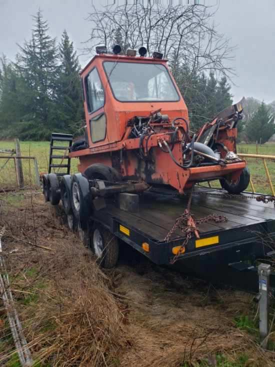

Scored a 2100 Packmaster that's only 30 miles away.
Sealed up the deal this morning.
Very pleasant fellow to deal with.
Area is very sloppy right now, so will wait to drag it out in a few weeks or at least when things are much less wet.
It is on a trailer and will be a breeze to move.
The van cat project is still the goal.
I am also helping and old friend fix his 2100.
Some materials from this cat will go to fix his unit.
CAT VAN project has been refined a bit...
Going to narrow the 2100 up a bunch.
shooting for 102" OVERALL WIDTH.
Looking like narrowing the tub, the frame, the axles and go from there.
No engine.
No hood or radiator.
THE BEAST LOOKS PRETTY GOOD the chassis has not been thrashed.
Came from a ski resort not all that far away....
Been a long dry spell and finally a good score.
Something to work with.
After we get it home I will get more pixs as I get going on the beast.

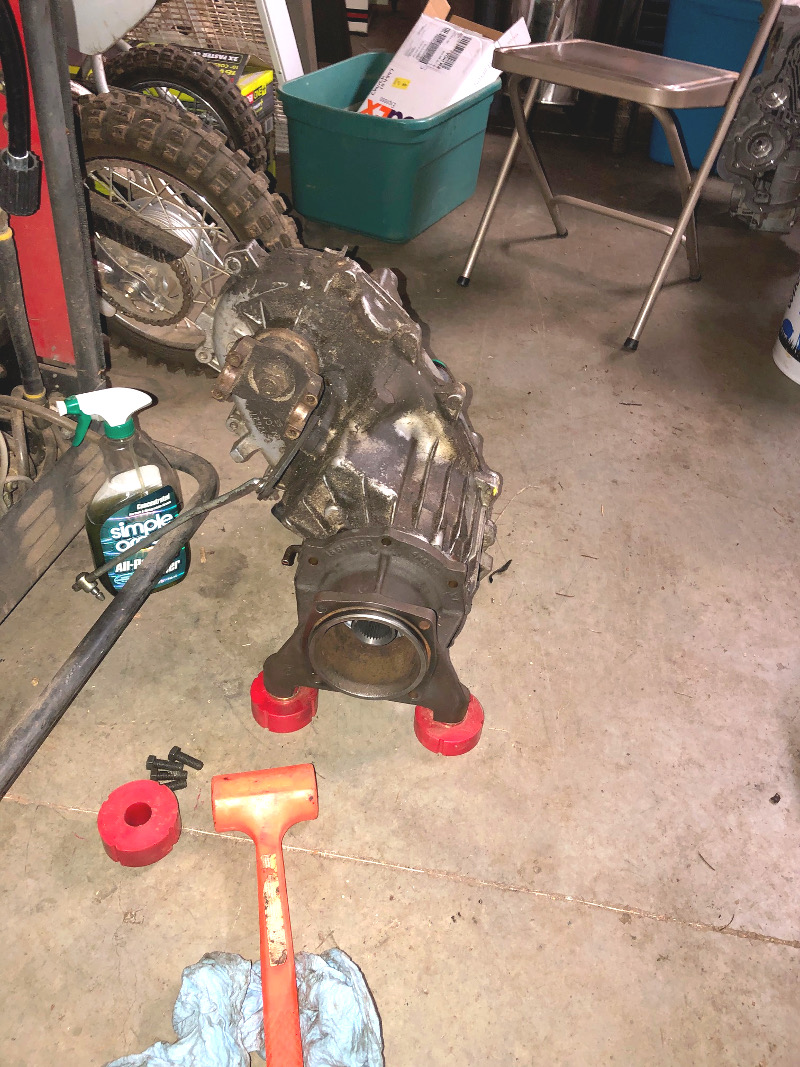

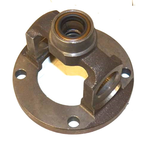

Here is the NP241 with the adapter turned to place the (What will be the input)
at 5.750 inches to the right
(Astro drive train is offset 5-3/4" to the right to allow foot room for the driver.
Already been working on the clocking ring to fasten the Adapter to the Tcase.
None made to do what I want/need...so we make one.
I am using the adapter for a 4L60 tranny....cheaper and it will get a bracket bolted to the 4 bolt end to allow a second mount.
Third mount under the rear output housing to assure the case will stay stable...

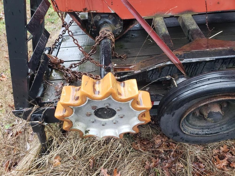

Hey
back in the day when I ran a groomer on the Mt.... I did run a 2100 a few times.
How do the track adjusters work ????
The 2100 is different than the Spryte.
Does the 2100 use a cylinder with grease in it to adjust the front axle ????
I can't see any adjusting bolt ??????
Any manuals available for a 2100B ??????

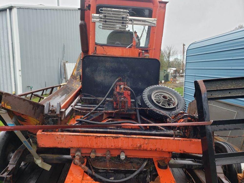

Re: An introduction/hello and my project.
A real pile of scrap iron.....
But after crawling around it things look pretty good.
There is not the usual weld upon welds upon cracks.
The engine likely went away...as it's not there.
The tires are sketchy.
Front foam filled units seem like we can get some use out of them.
One hub lost the bearings, but the spindle seems fine....not chewed and somebody slathered it with grease (not all rusted)
Rear end is empty.
Likely had a cooler on it and was drained.
Going to get the diffy out and take a peek inside.
I hope that I can use it as is for a while....
Time will tell.
Yes....I real pile of goodies :thumbup:
But I am just happy as a clam to get it..
I have been snooping for nearly 5 years to find a cat close by and affordable....
This old codger is about as happy as can be.
Like a kid at Christmas time.
JUST LOOK AT MY PILE OF SCRAP IRON :clap:

YES INDEED ON THE PARTS LIST..
Since the van is providing the controls, power train (Except the rear diffy) the list of parts is greatly reduced.
I have the bulk of the drive shaft parts to connect the vans tranny to the OC12
BIG JOB is narrowing up the tub, track frame and axles.
The tires are pretty sketchy.
Front filled ones will likely get us running.
The mid tires are mostly crap.
Sprockets will get us up through the maiden voyage...gonna need to be recovered sooner or later..
I will know a lot more once we get the beast home and tear all the unnecessary crap off it.
With a bit of luck maybe the blade, hydraulics, tilt cab and other goodies can find new homes and get back some of the $$$$ spent.
GONNA BE A DIRTY JOB STRIPPING THE CRITTER APART.
Fair weather stuff.
But...I knew what I was getting into when I decided to do this thing....

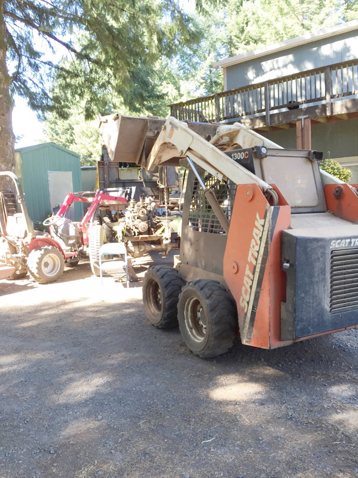

We have a Scat Trak 1300 with a big bucket.
Use it mostly for carrying horse poop to the pile and sawdust to the stable
Specs say the 4400 is 1150 capacity
Our Scat is 1300.....
That will make life much better.
I have not been able to get right up into the 2100 yet as its all lashed down on a trailer.
I figure that after getting the cab off, fuel and hyd tank, tranny and everything else off that a wrench can get loose it should be fairly easy to handle.
Gonna set up ( 4) 24.5 truck wheels and shoot them in with the level scope..
Sit the tub down on top of the wheels.
Upside down.
Jig the tub using the axle and track frame holes with an extra set of holes 4 inches narrower.
Probably build the jigs out of flat bar or ????? thats handy.
Go after the tub with the Plasma and knock 4 inches out.
Realign the tub using the jigs and stitch it back up.
Do basically the same with the axles and track frame and then reassemble things using the tub as a build jig.
Be far easier in a shop with an overhead crane like I used back when I was in the machinery bizz.
We also have a WEEEEEE Tractor with a bucket..
Very handy...will lift 500 pounds ???

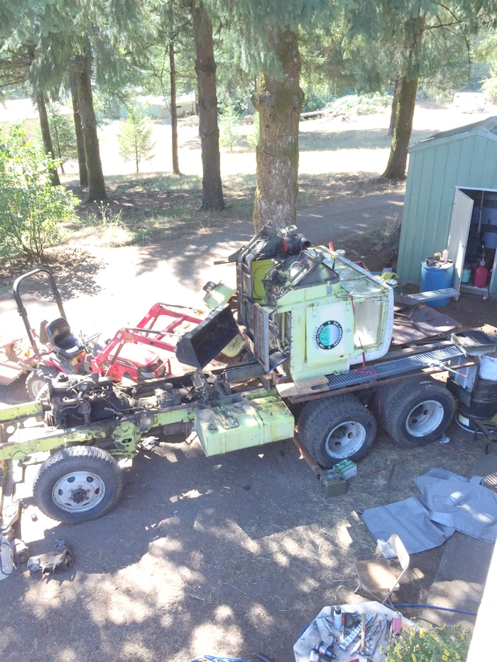

Some pix using the Scat and Little Red dismantling an M211 Deuce N 1/2
I have used the Scat to lift several pickup diesels out with my air chain fall.
I think the cat is gonna be a fairly easy go after we prune it down.
The cab on the Deuce was a pain to get off.
My neighbor came over with his "Widdle Excavator" and we grabbed the cab with some straps and it came right off.
Mostly the elevation was the issue...
I was not cozy with having that cab as far out away from me and as high as it was and maybe UPSET things.
The roll up door behind the truck is my little machine shop and right where that truck is sitting is where the cat will sit during the tear down and refit.
Actually the cat will be stripped behind where the truck was and then after the tub and frame are separated....we will get the tub over by the front of the shop.
The cat will not fit in the one building with a slab floor

There is a hefty frame assembly on the rear of the cat that has a big cylinder on it.
Must have been for a groomer/drag/tiller
That bad boy looks heavy too.
I want to remove the sprockets before we unload the cat...the sprockets are usable...and I don't want to booger one up during the unloading.
The guys trailer is narrow and one set of wheels are hanging over the side and he stuffed timbers under the axles to rest it on.
I can just see a trashed sprocket happening real quick.

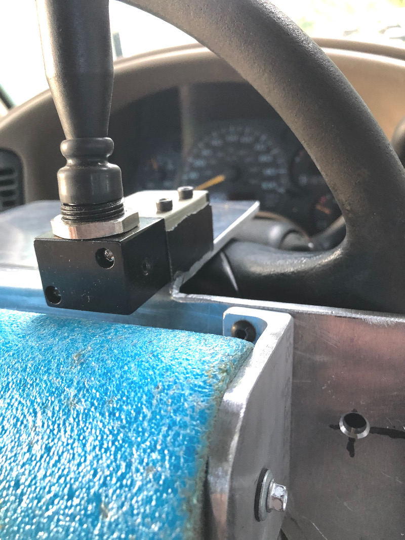

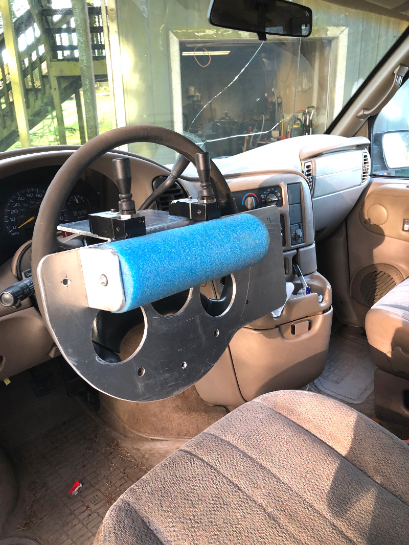

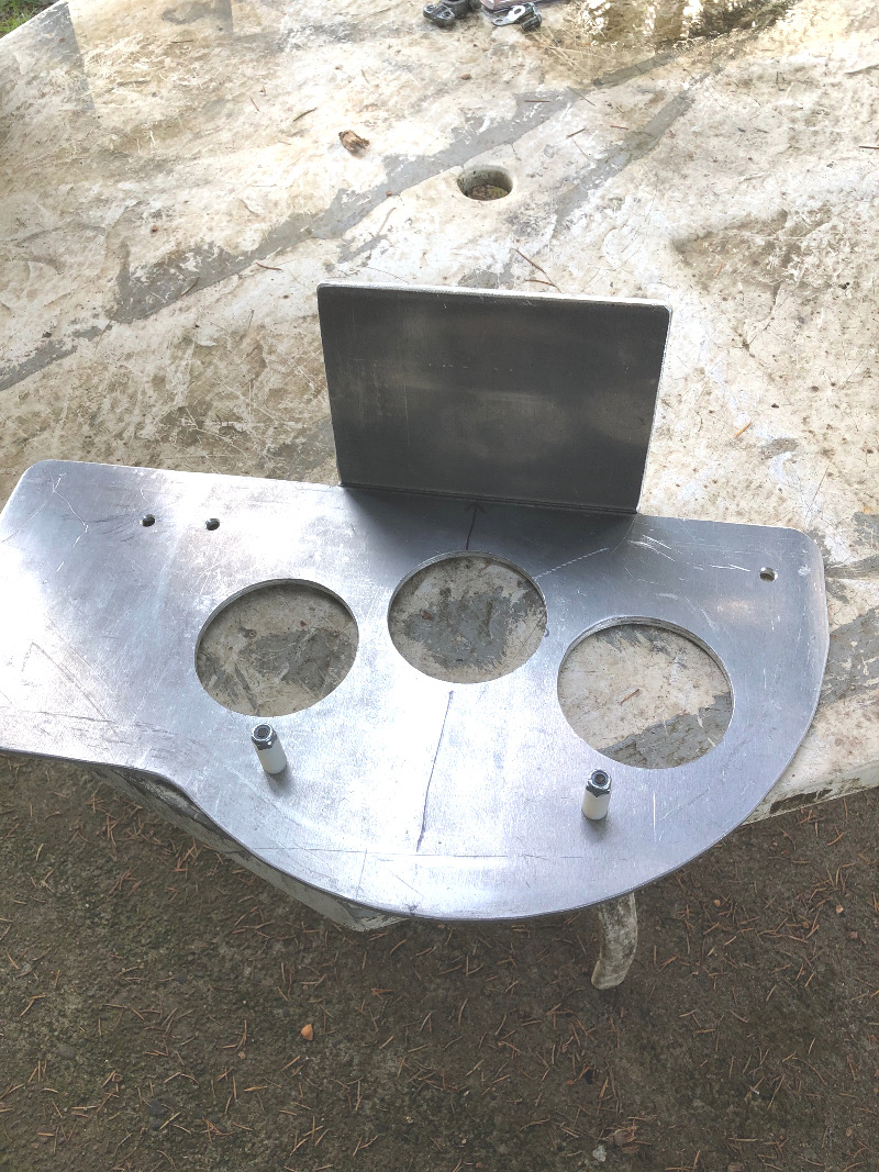

Here is a picture of the steering control interface....
Simple alloy bracket that fastens easily to the steering wheel
****For the question....what about the air bag*****
It gets unplugged during CAT OPERATIONS
There was no real good way to get an air pump on the engine in an Astro
VIAIR makes some very nice 12 volt 100% duty cycle air pumps that are more than capable of supplying the air needed.
The interface fastens to the wheel with 3 heavy zip ties (Yes...hinky...but simple and easy on/off)
Nylon DOT air lines run from the front to the rear of the van.
The two spring loaded joy sticks control the air to the chambers/bands
Each delivery line will have a flow control to stop the bands from SLAMMING on.
A quick release valve will allow fast release.
There will be two pressure regulators on the pump/tank valve control panel (Behind the rear most seat)
The one regulator will deliver 45 psi to the pressure select valve (Not shown in piccy)
The second regulator will be adjusted to allow a lower pressure to the joy stick for making small steering corrections at speed (Adjust after the build to get the sweet spot)
The idea of a foot brake had always bothered me.
A neophyte driver could readily mash the brake and panic when nothing happens.
Decided to add a single circuit air brake treadle on a little bracket alongside the vans brake pedal arm (There is room in there )
A small bracket that fastens to the pedal arm will activate the treadle to allow the existing pedal travel to apply air to the air chambers through a pair of double check valves.
All other equipment will operate normally (Brake lights..yada yada yada)
This equipment can be removed within minutes when non cat operation is desired.

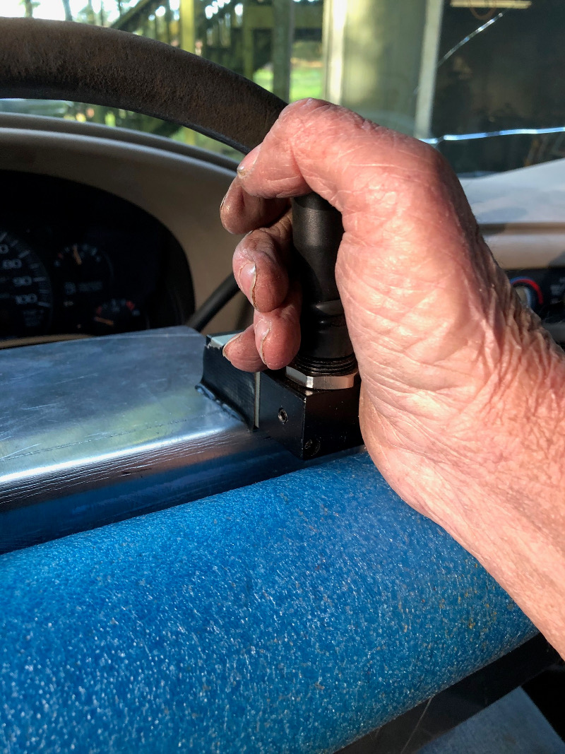

OH AND FOR THE QUESTION "WHATS THE BLUE THING"
It's a pool noodle Charlie Brown....
I hacked that chunk off one laying in the corner...A black one will replace it when I finish the Interface assembly.
ITS A HAND REST TO TO MAKE OPERATIONS COMFORTABLE.
The next question asked will be.
What about the ABS on the van and what will happen with the drive shaft running and the wheels not moving ????
Pull the ABS fuse and go on about the Cat'n business.
The ABS and air bag lights will come on the dash...BIG DEAL..

The green brush rig is the same one pictured earlier being dismantled.
The sucker was heavy too.
We hauled it down here from Sumner Washington
We wanted it because it had a viable title that matched the serial # on the truck.(Some get dummied up)
The Son in law is working on a repower with later model diesel power and modifying the cab...take two cabs and make a quad cab...
That's his toy.
The Pickup, trailer and the brush rig was way more weight than we thought......
The big dog handled it well though (08 with the 6.7)

I have flirted with that thought....
Look at the piccy.
This is the NOW drop box.
The 700R4 adapter is only there to be used as a mounting point.
The has been a plan to simply bolt a plate over the opening.
The normal input internal spline is standard TH400 4L80
Be very easy to machine the plate to fit the register and add a flange bearing to it
Mount a twin cylinder compressor (Craig's list) ahead of the drop box.
Should be an easy do.

I did get some more peeks into the rear frame/tub area ahead of the OC12
My Micky mouse drop box will be able to sit down in the tub just ahead of the OC12
Looks very promising that there will be enough room on the LH side of the tub right alongside the drop box to mount the compressor.
May need to do some rearranging of the frame work in that area though.
The Cat has a heavy tube platform/frame that a big azz cylinder is mounted bolted to the rear area.
Since my application is only for a cruiser....all the heavy rigging in the rear is not needed.
Should be plenty of room to get things snuggled in there.
I am thinking that we are going to need to butch some fairly large round access holes in the tub near the area where the drop box will mount and up near where the vans tranny (Rear output) is located to allow access to the drive shaft.
THE PLAN is top be able to run the van up a pair of temporary channel ramps and locate it on the cat frame....
Until I can get the van and the packer close to each other and do some measuring I can't do much more than speculate....but the idea looks good.

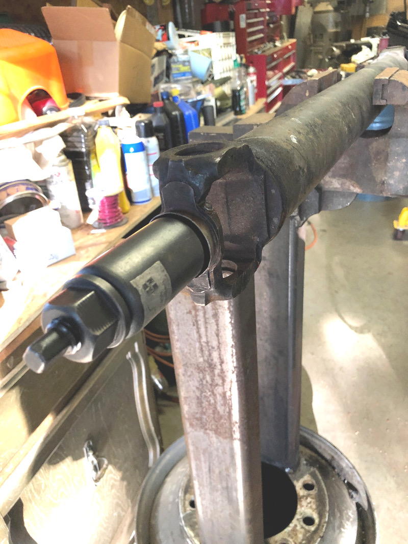

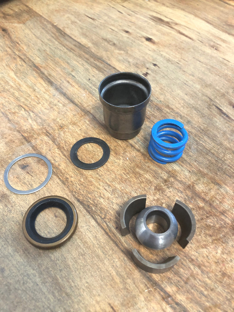

I have a complete two piece drive shaft from an S10 Extended cab with double cardan joints on both ends of the rear shaft..
Thinking seriously about adding another double cardan joint where the front shaft plugs into the 4L60 tranny....
This menagerie of goodies called a drive shaft will allow rules to be broken in a big way.
GM used the "Double Double" setup to fix issues with the layout on the extended pickup..
They were a failure....
Issue being that the center ball of the CV unit was usually never greased..
Once the ball wears out the CV started to wobble and will vibrate badly...
The shaft I got was bad, but not destroyed.
The centering ball was shot and the grease passage was totally devoid of grease....not one bit..and the ball and its socket were dusted dry.
I have the rear shaft all repaired and ready to go.

The Astro drive train is offset to the RIGHT 5.750" this creates issues...hence the drop box and the weird shaft set up.
I am still trying to stay with as much off the shelf parts as possible
The OC12 uses a 1410 u joint on it's input yoke.
The plan is a short shaft plugged into the slip yoke on the output of the drop box (NP241) with a 1350 slip yoke and u joint at the case end
(Setup maybe a foot long max)
If all goes as planned the drop box may wind up being just ahead of the vans rear diffy.

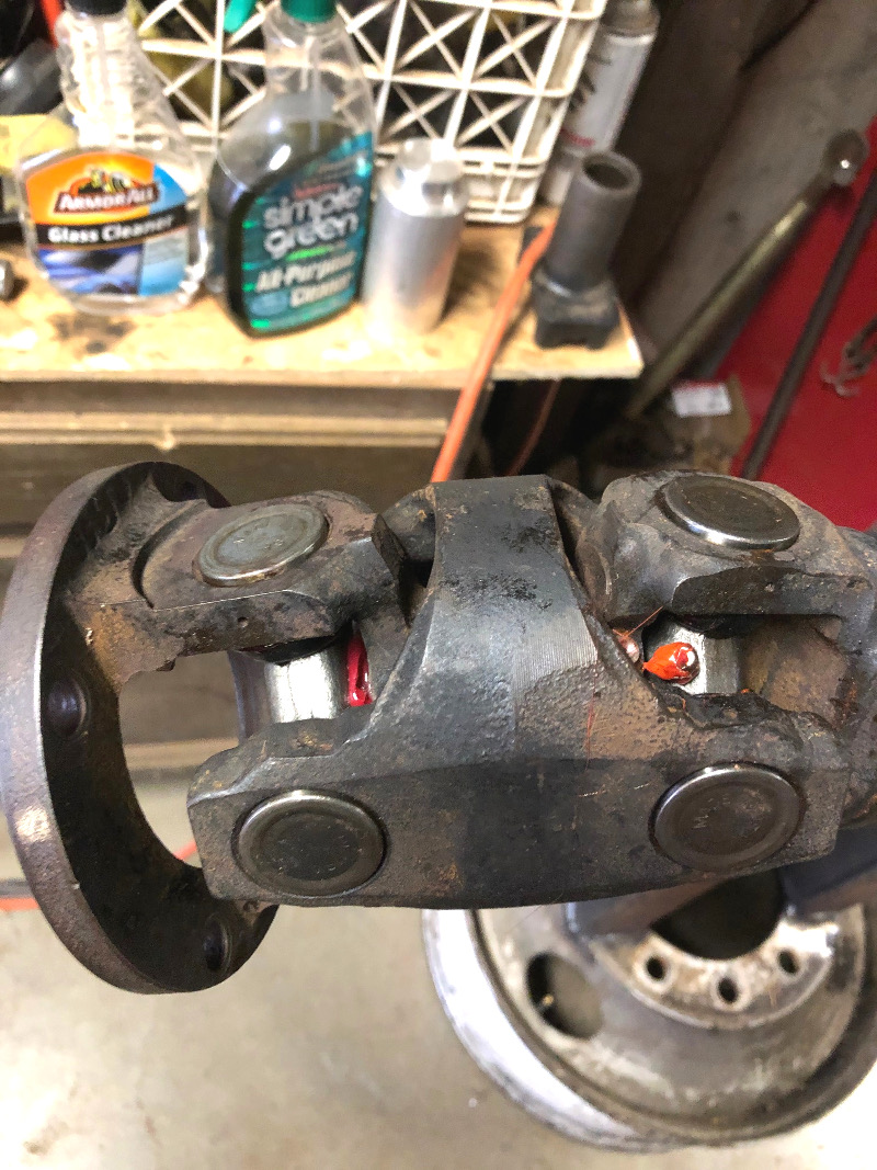

Pix of the Doble double shaft.
Getting the centering ball off the little stub requires a special tool.....
$300 special Kent Moore tool... remover and installer
Found one on ebay for $12 :clap:
The shaft uses readily available Saginaw 3R CV JOINTS/PARTS
With the proper tools these bad boys are a snap to rebuild.
The one shot of the ball that LOOKS LIKE A PEAR Supposed to be round
No grease being the cause.
With some care in locating the shaft it should run smooth.
Luckily the shaft was still in factory trim and had not had the plastic melted to remove the u joints...marked everything well before the tear down...
Balance should be fine.
The front shaft tube will need to be cut and a CV installed...so it may need to be balanced.
We can get this RUBE GOLDBERG together and do some testing and react accordingly.
Sort of like building a boat in a basement I guess...need to be sure we can get it out the door.. :hammer:
Couple pix of the Slam bang We had up until I retired in 2012
