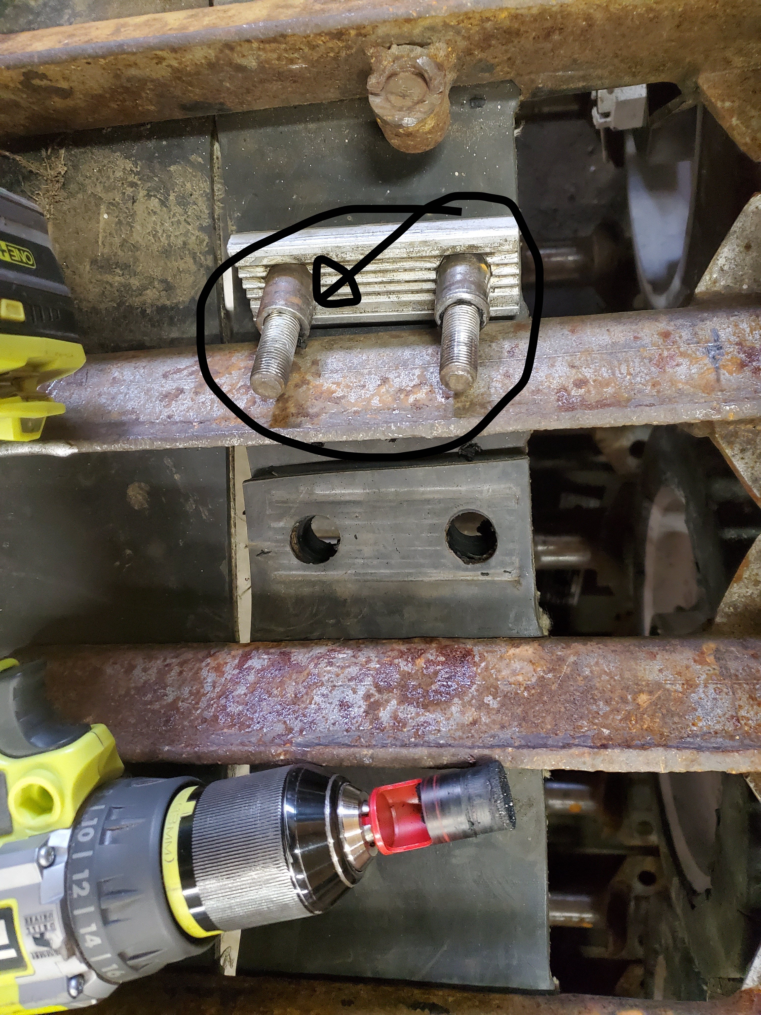

I've read that some people found the o-ring style seal spacers in their tracks on machines that are older than 1989, but all of mine were the early version non o-ring style so replacing them all along with seals, bearings and dirt covers.

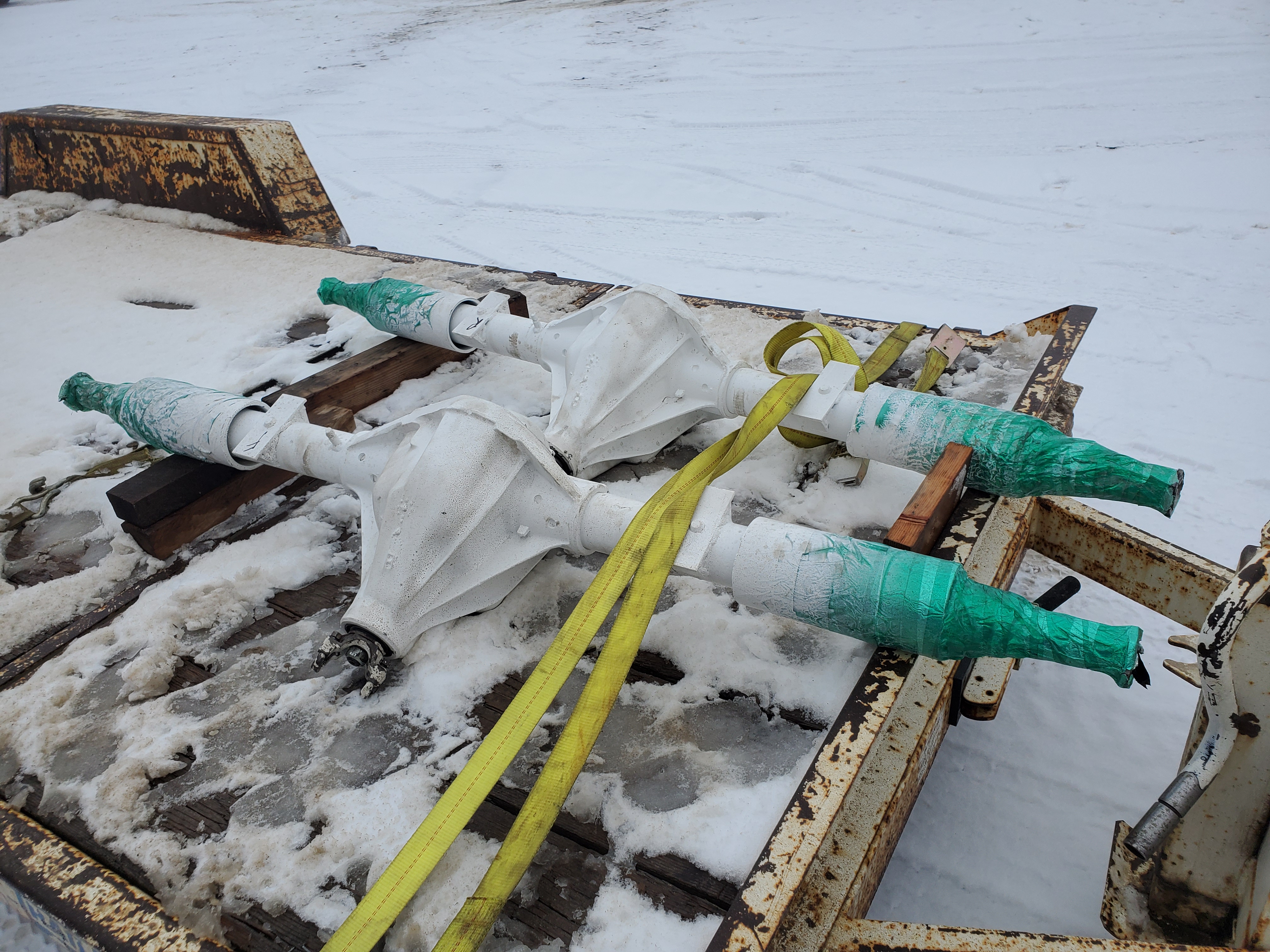

Diffs back, rebearinged just because its 30 years old, the rest looked great inside. No lockers, a decision more or less made for me. My gear shop says Eaton, makers of the e-lockers, recently listed a part number for e-lockers for the Spicer 70s, but apparently there are none to be had at this point and because of Covid slowdowns and backlog for more high demand parts, it might be a year or two or more before a person could get them. I believe redsqwrl said he preferred air lockers but I decided not to go that route because I've owned trucks with airbrakes for 40 years, and my gearshop said the snowwheelers that have them are cusing them. Air dryer, deicer fluid, ect. a guy can deal with it, I just didn't want to, so I'll wait and see. Did put the parts in to make the rear diff open for now.
Disassembled the transfer case to check it out too. All looked good, so reassembled it.

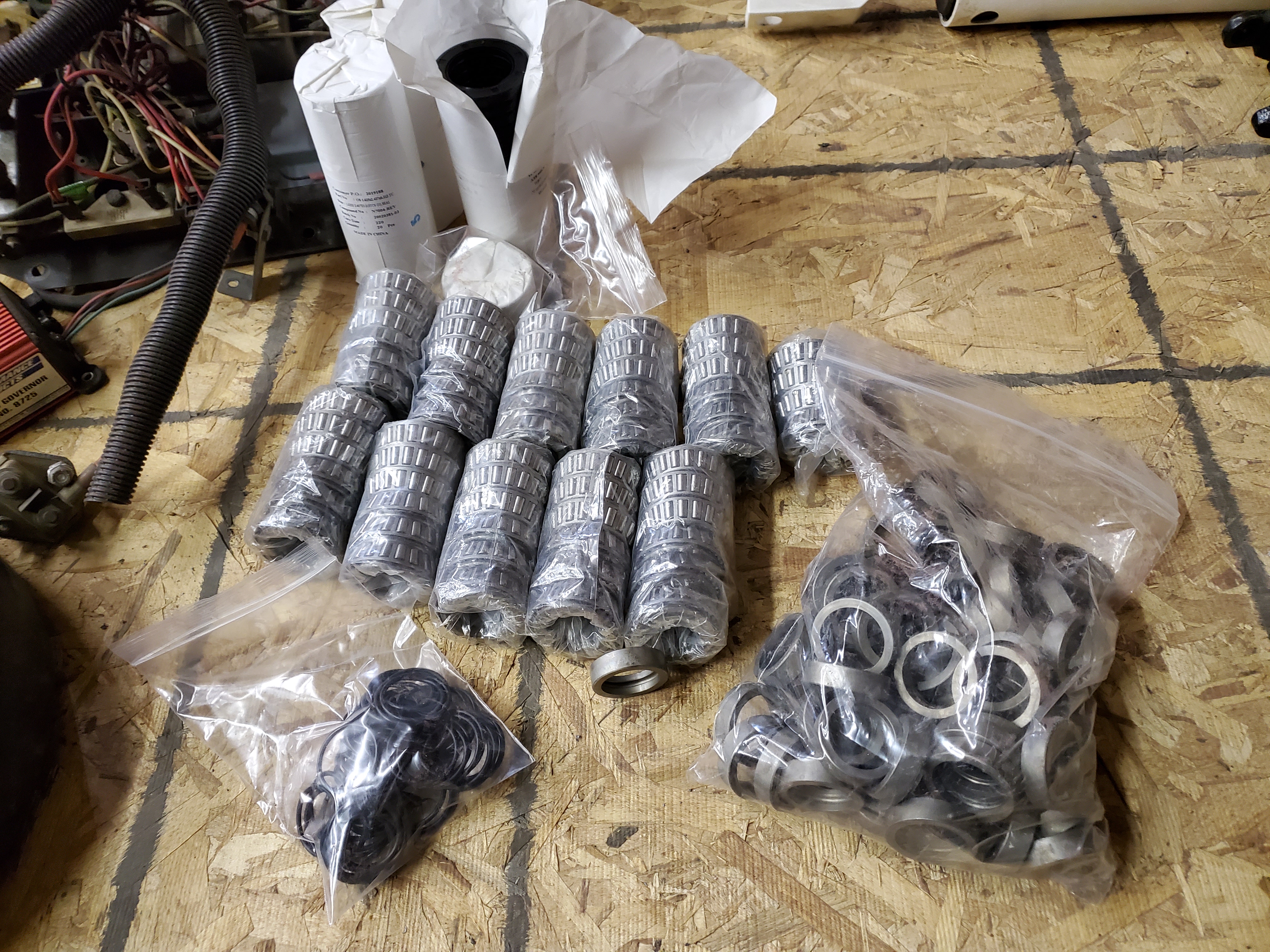

1BG,

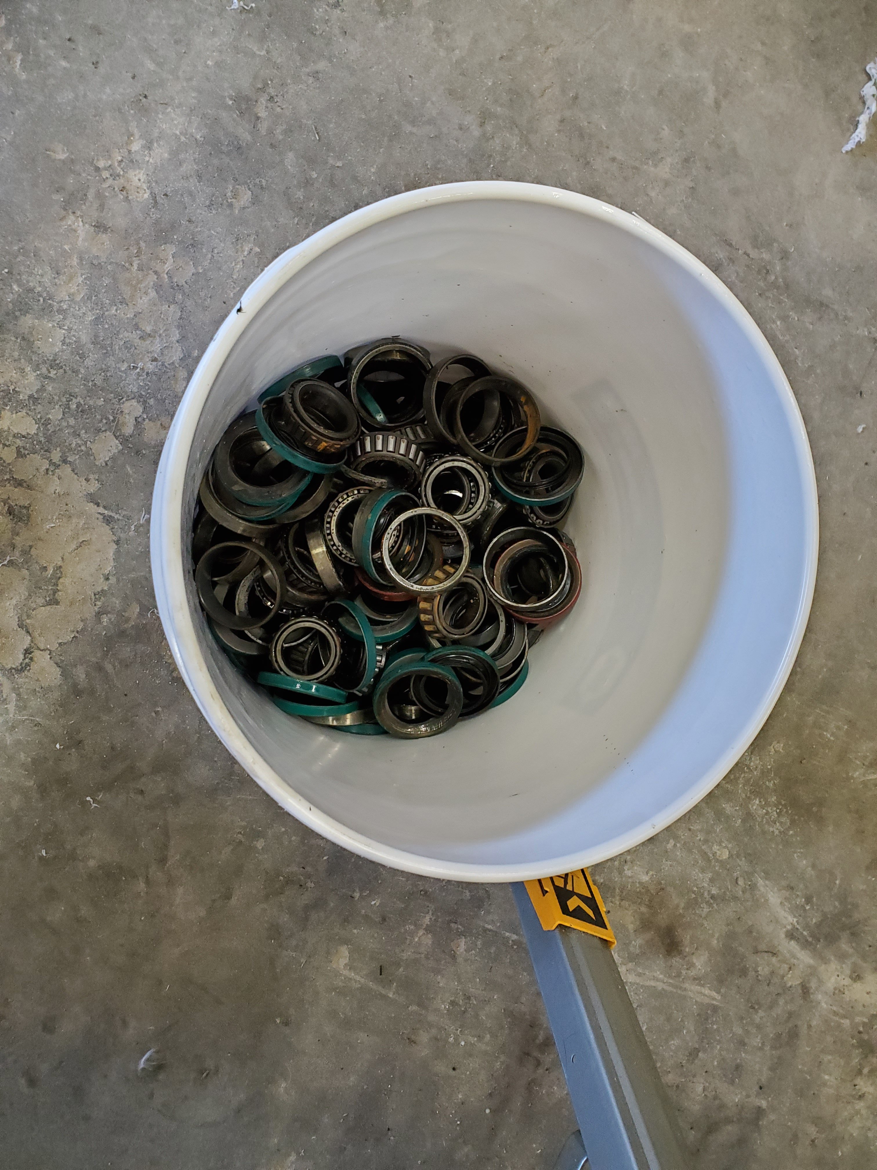

My wallet quivered at the sight of this photo of parts bought from Tucker, Inc. But wallet pain aside, good on 'ya for doing it right!
1BG,
Lol, yea that photo looks like I have a little in common with a silver stacker right?
Actually the bearings were competitive, common to oem parts that are non-captive. Avaliable at numerous retailers, economy of scale, all that. The captive parts can be a little different story. No economy of scale, ect. and manufacturers have stay in business on something. And perhaps heavy equipment owners are a bit more acclimated to it. I just replaced a hydraulic hose on a Deere excavator that cost $600.00, and Cat or Perterbilt are no different. I like saving a buck, or in some cases a lot of bucks, but I also need the manufacturer/dealer to remain in business as well.

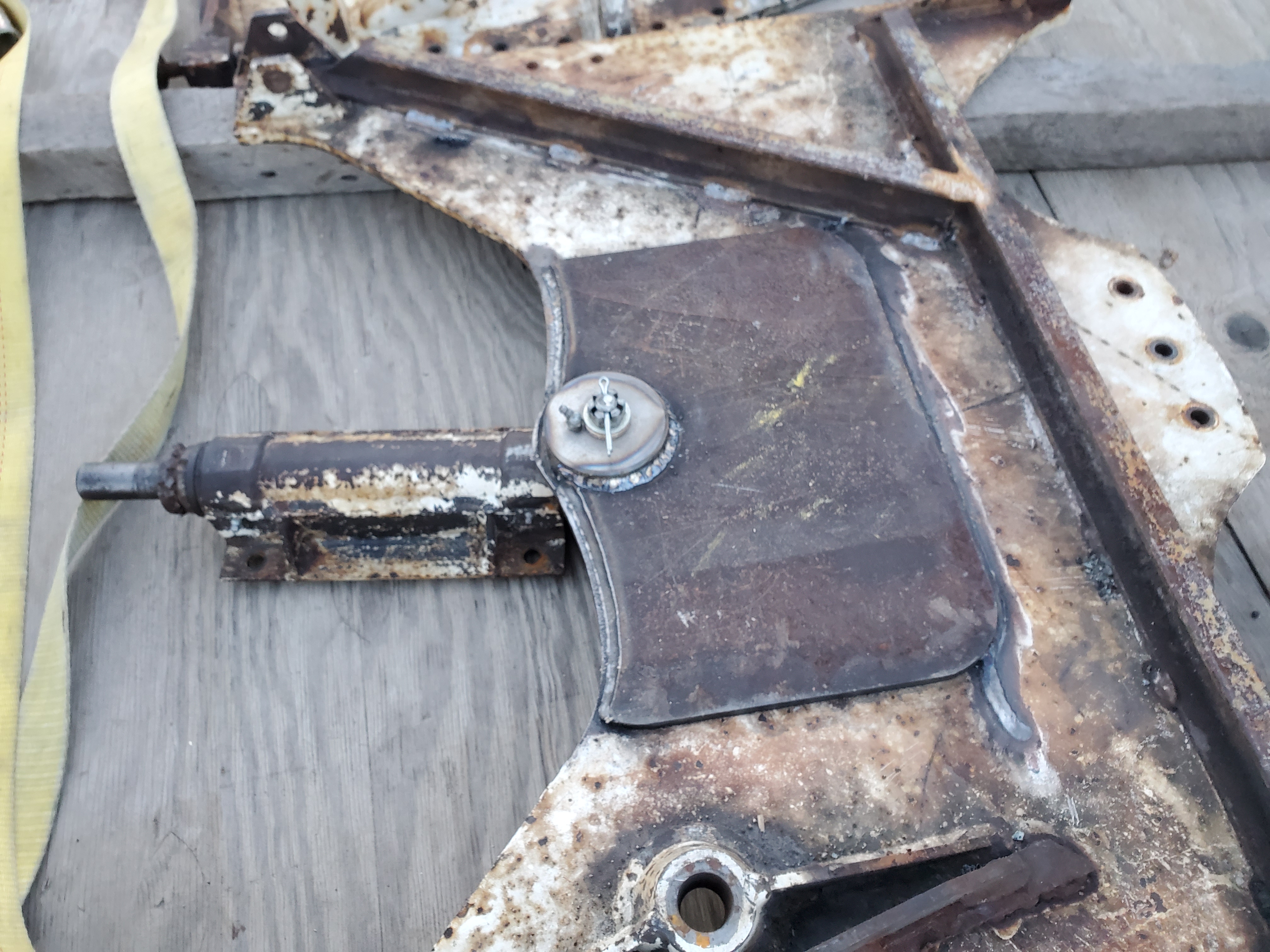

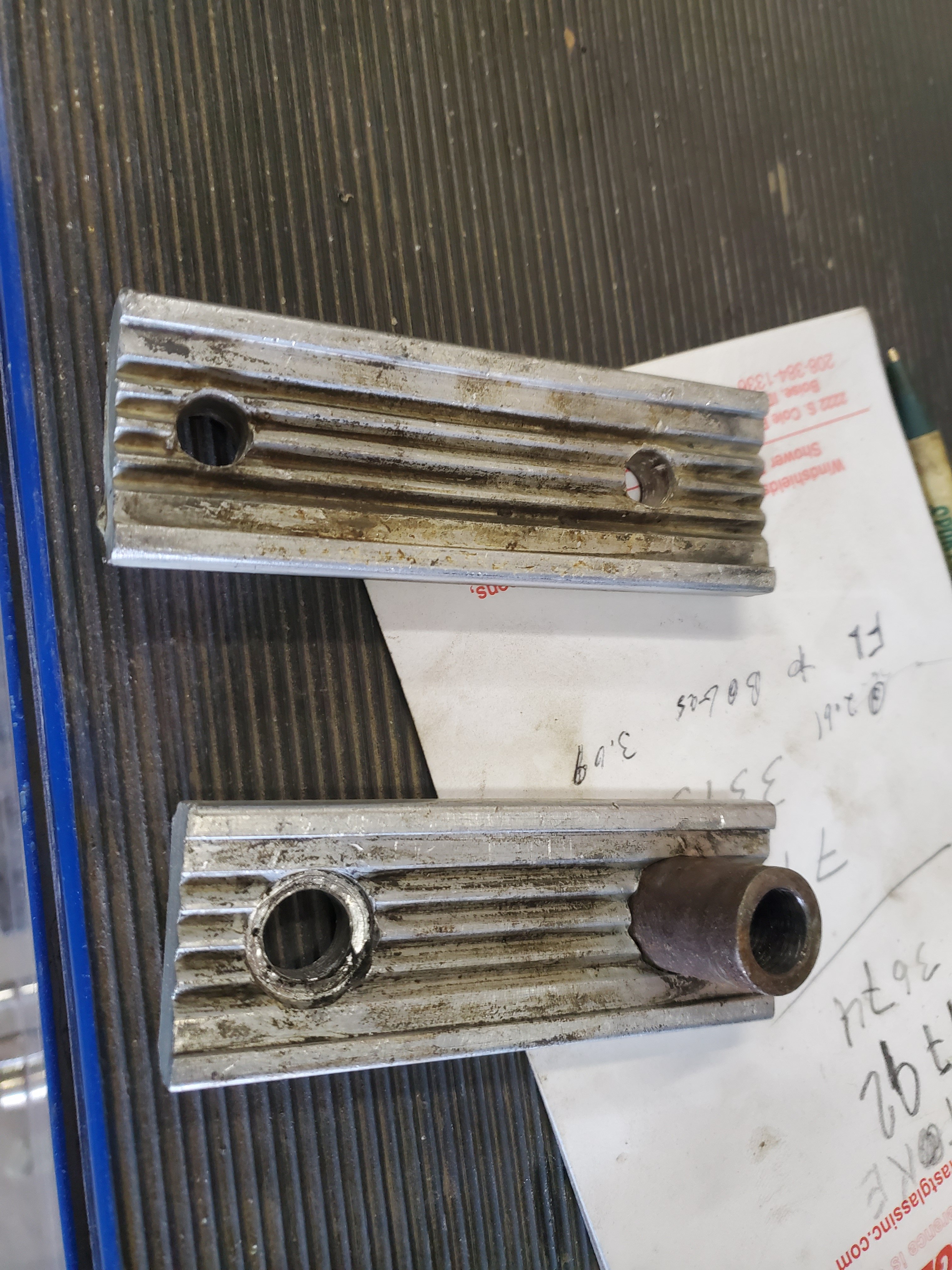

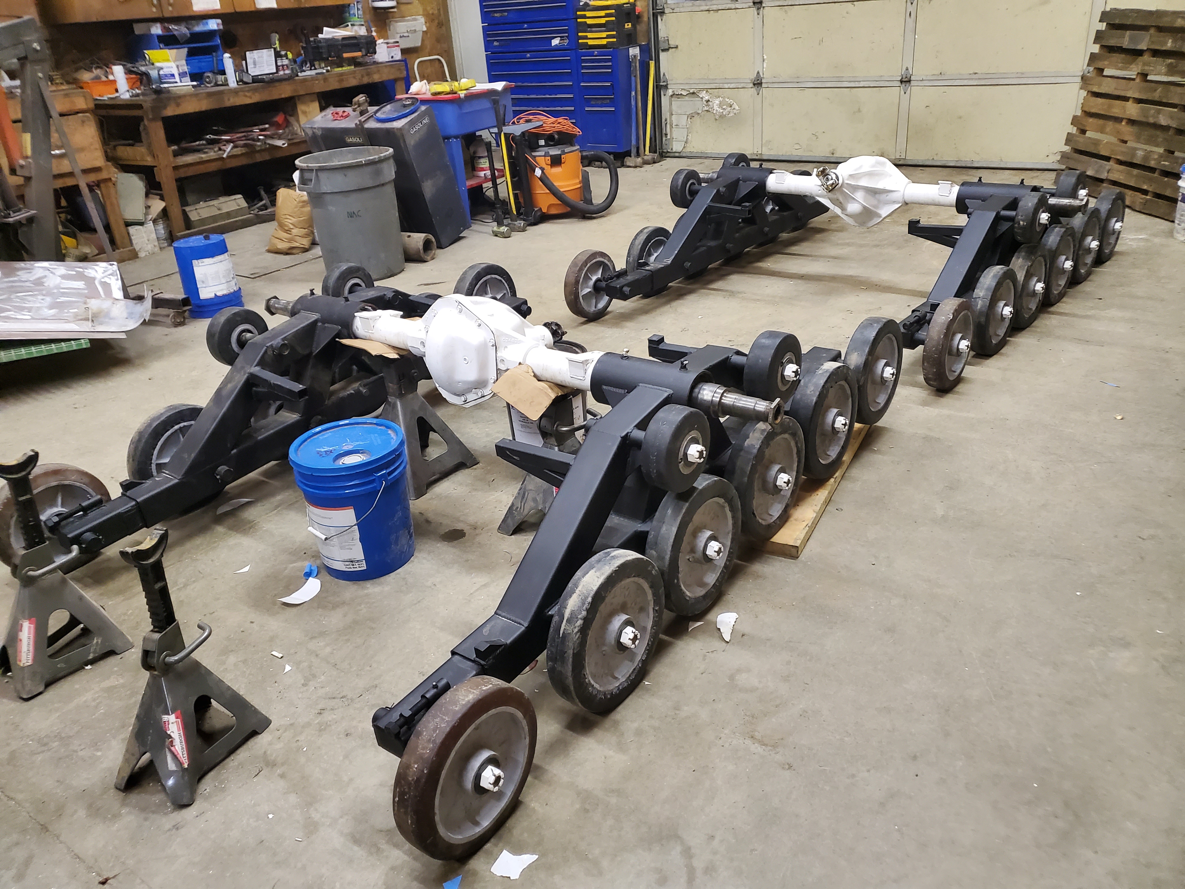

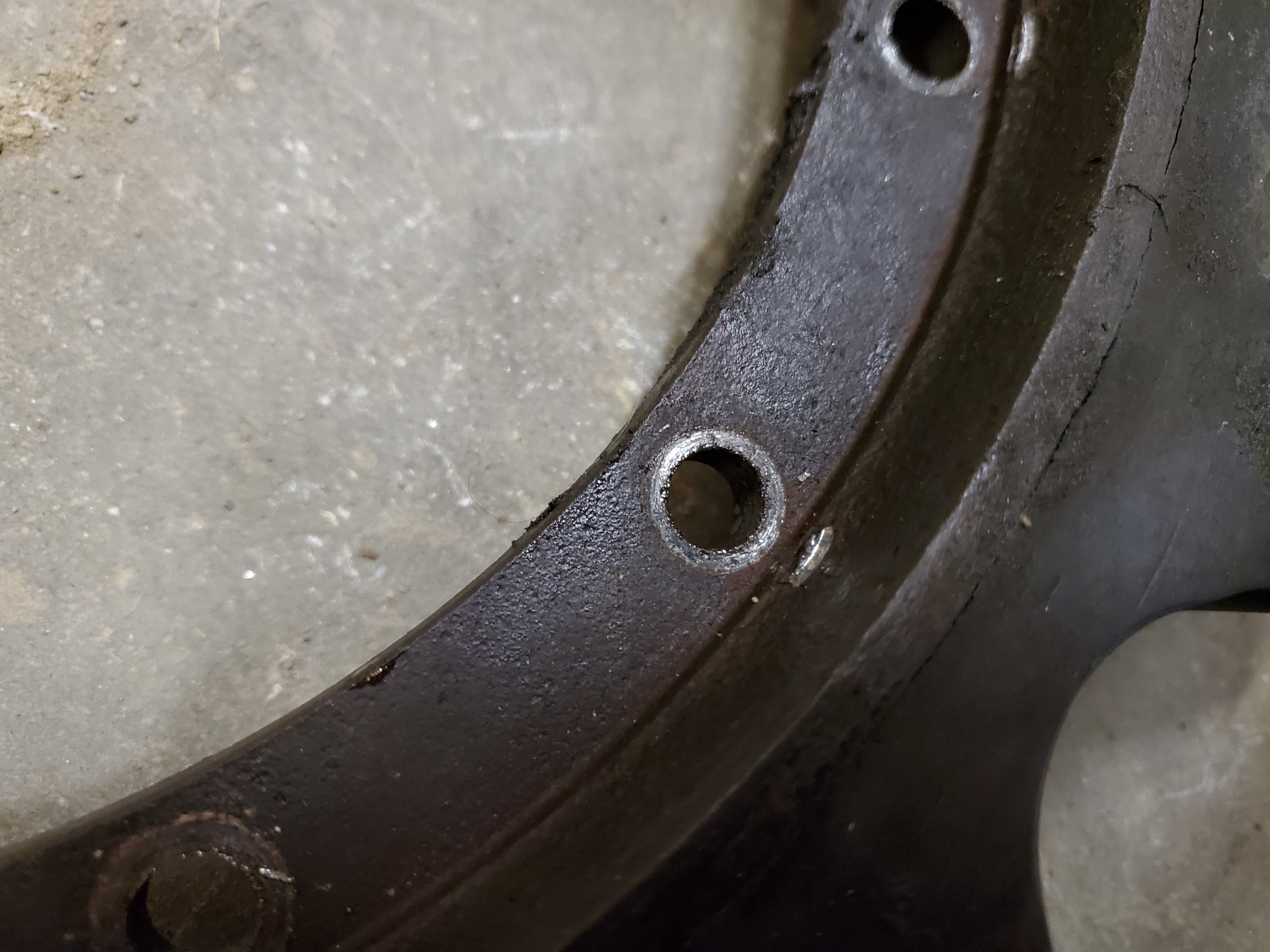

5th wheel plates back from machine shop. I use we somewhat loosely, meaning I get to be involved in deciding the course of the work and I get to pay, otherwise the skilled part of 'we' gets the work done. So 'we' decided if we turned the plate end out to accommodate a bronze bushing between the worn parts it didn't leave a lot of wall thickness, so we made a new piece for the plate and some bronze washers for friction reduction. Not sure thats a big deal, but we did.
On the rear plate we v'd the crack out, welded, and also double plated the back side.
On the rear we trued up the stud end on the pivot, the front stud end is larger and didn't need it. Don't know if it should have been tighter but fit was made to .005
Well its nice to be to the point of going back together with some things anyway.

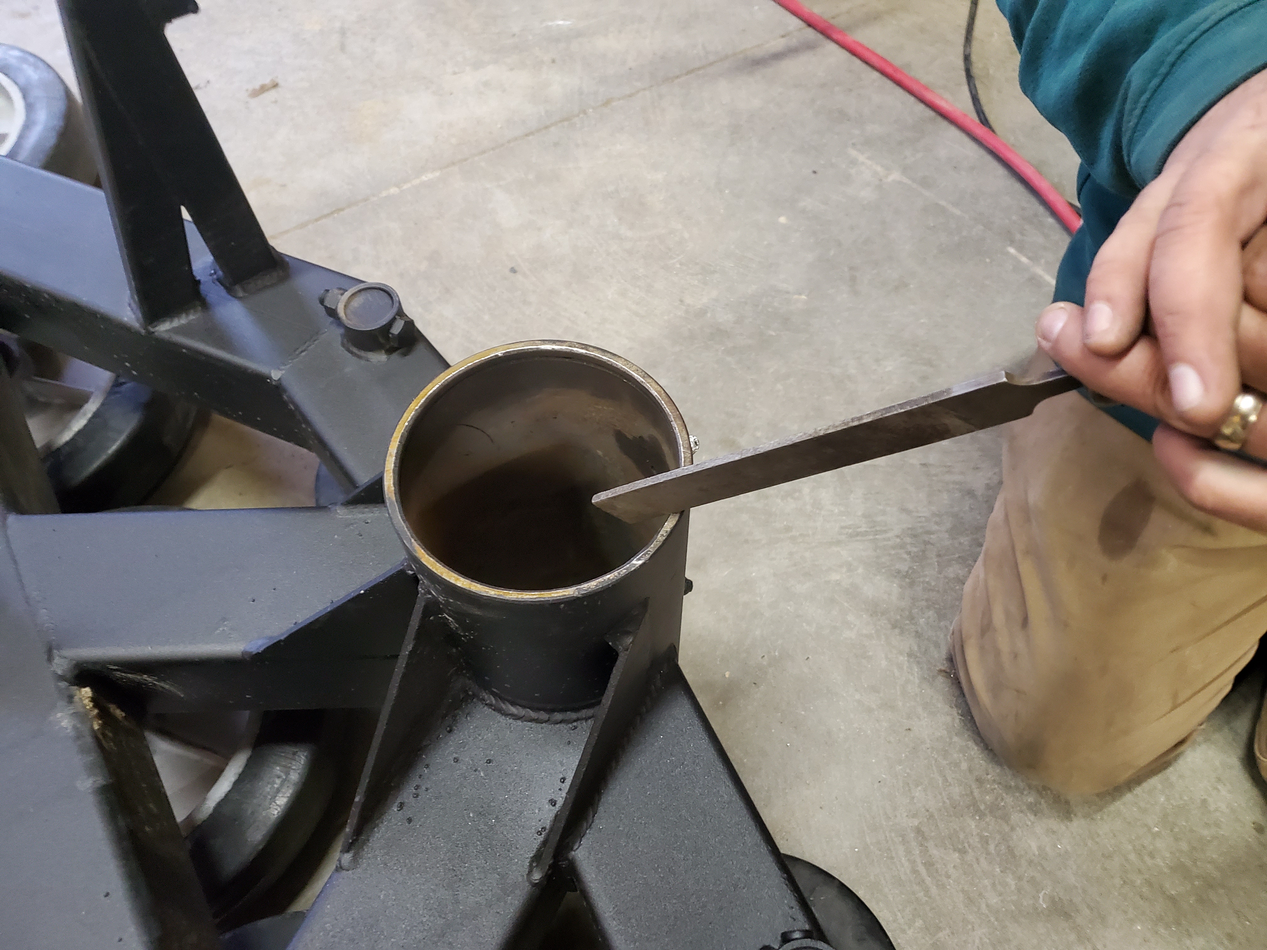

Tried to put the carriers on the journals with .0065 uhmw over the wear spots and the wrapped all the way around with .035. This should still have given about .010 clearance but fought it for awhile (quite awhile) and couldn't get it to go. The .035 just wanted the buckle up and couldn't get it started. Ended up just putting various thickness over the wear areas and had to go with that. ☹ Had really hoped to take up the gap all the way around, but still took 75% of the slop out of it. Could have maybe wrapped all the way around with .0065 or .0045 but thought material that thin would just get beat out pretty quickly anyway, and then might be more harm than good. These pictures are before adding lots of grease.

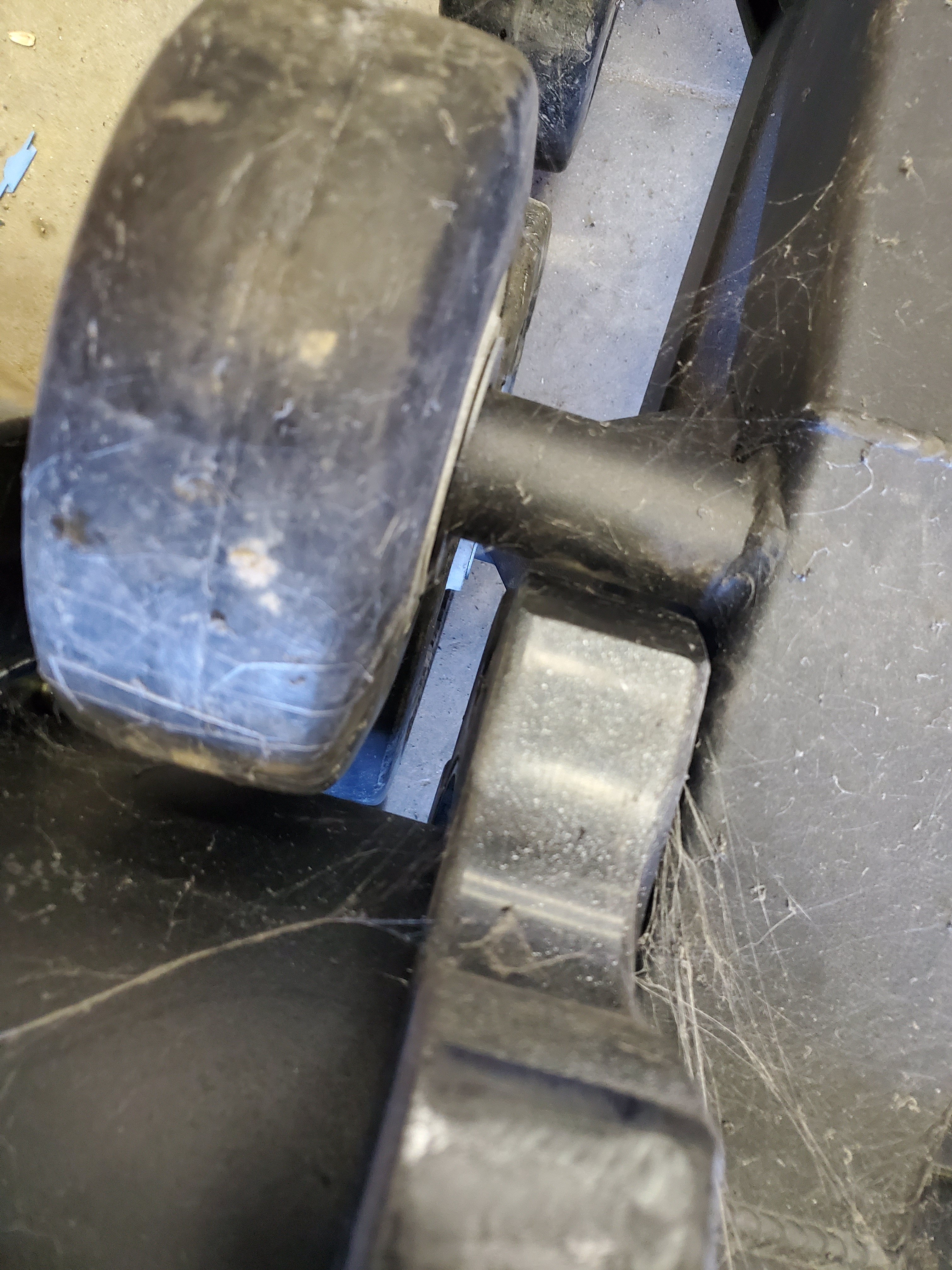

So finally had the time to get the tracks mounted. A couple of the 9 tooth sprockets rubbed the damper wheel mount. Just by a few thousands, could just be manufacturing tolerance that was acceptable as my 7 tooth sprockets didn't rub. Anyway just shaved them slightly with a grinder to eliminate the rubbing. Funny the stuff collects off the grinder wheel like cotton candy as its spun, or a spiderweb.

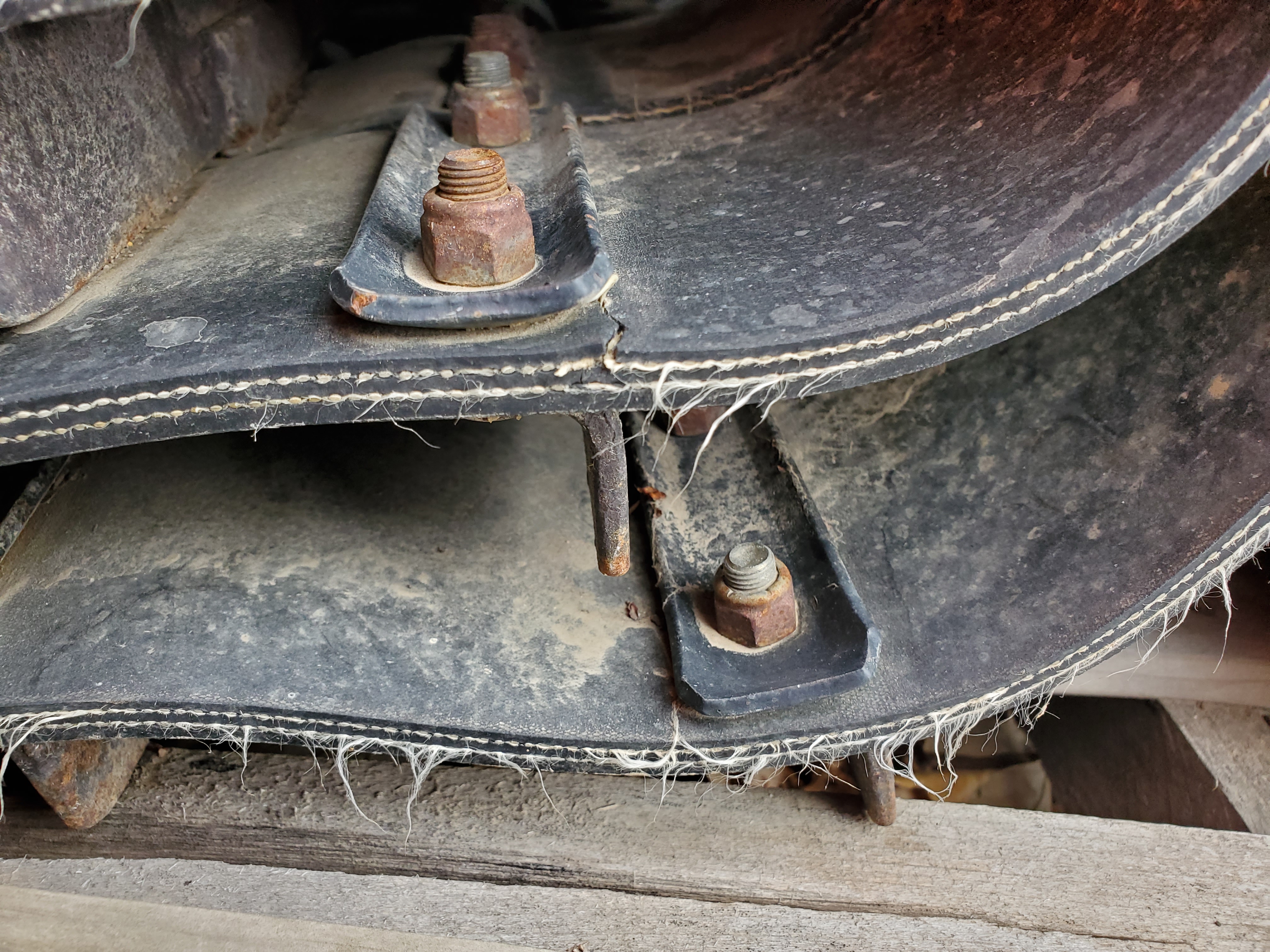

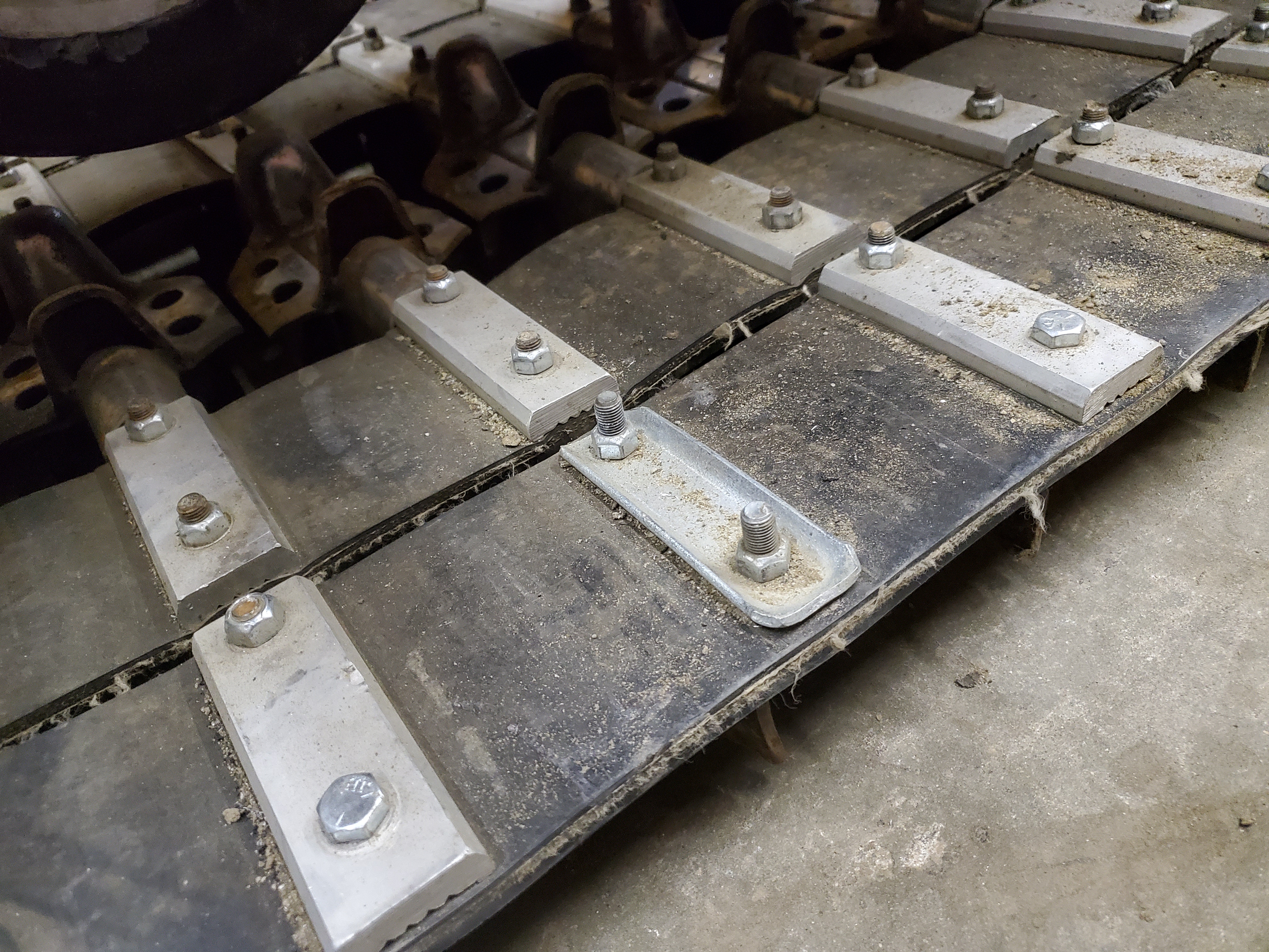

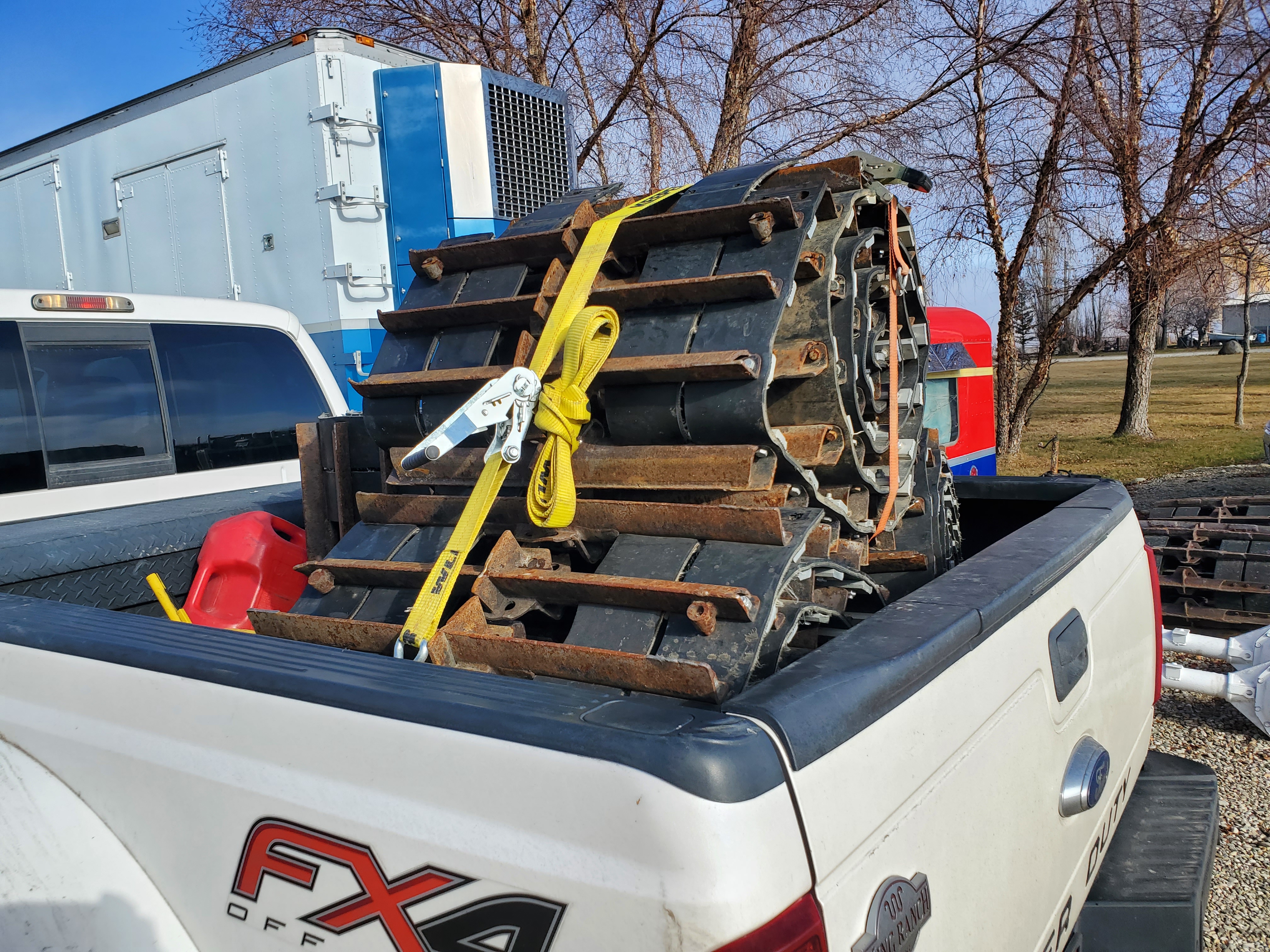

Since I have pieces and pics at hand thought I would also share a little of what I think I've learned about belted Tucker tracks. First there is some good information in this post and this thread; Post in thread 'Tucker Tracks Info' https://www.forumsforums.com/threads/tucker-tracks-info.7118/post-69648
The earlier 7 tooth sprockets have 6.06" grouser spacing, the later 9 tooth sprockets have 4.88" grouser spacing. My old and new to me tracks show three of the different backing plates.
Also a couple different versions of splices.
And the difference in backing plates for grousers and splices. Splices take a bigger bolt and have the recess for the spacer.
Although the track carriers are supposed to be the same from mine, 1989, to present, there must be some small differences because I had to drop two grousers from these newer tracks to fit my carriers. Per Tuckers direction, a 3/4 diamond bit hole saw works great for drilling the new holes in the rubber for the spacers.

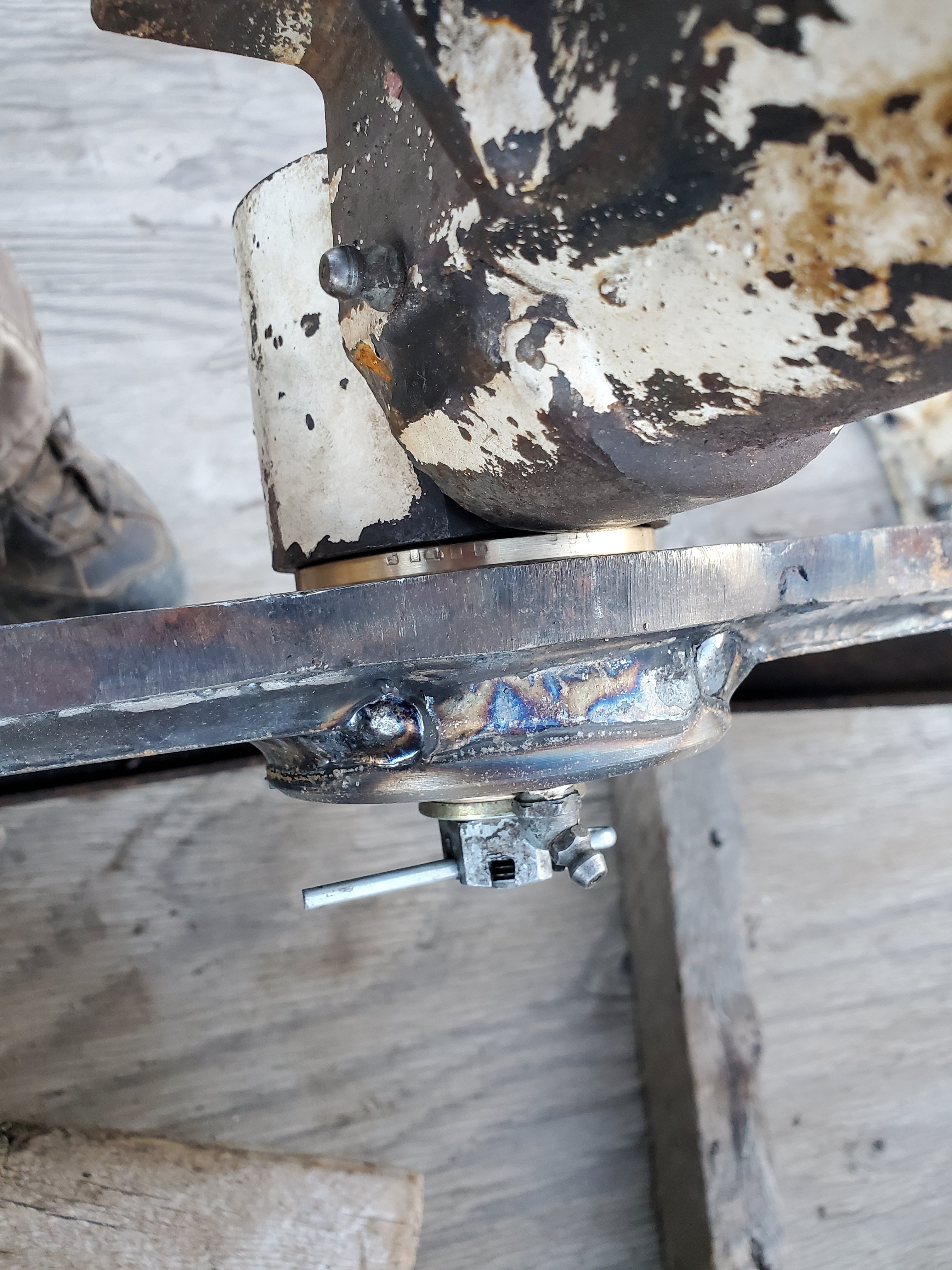

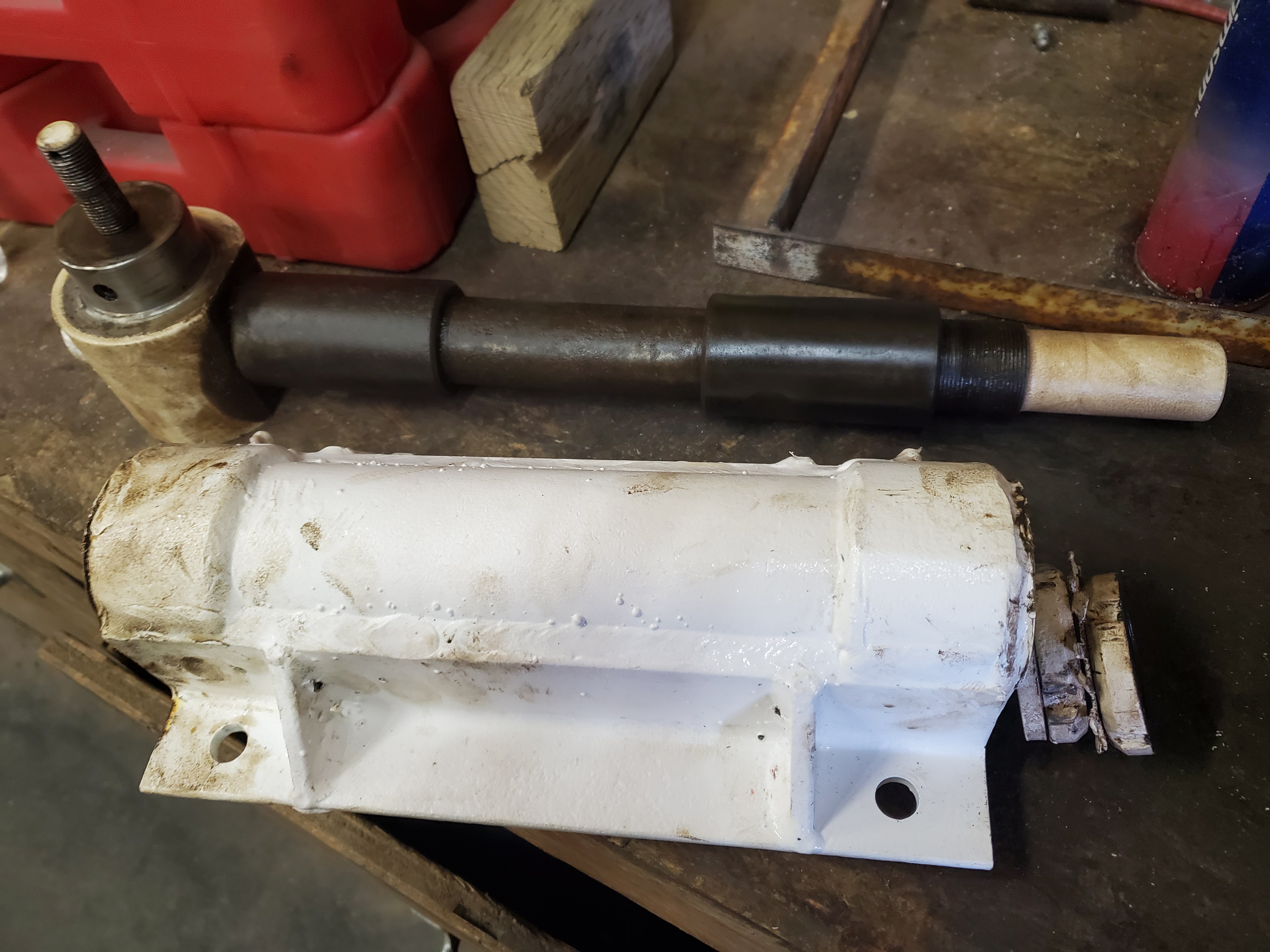

Got to worrying that there were tapered bearings in this so decided I just had to check. Just post a pic in case someone's curious in the future. View attachment 134233
wow, this part has not changed since the very first one in 1950, no bearings,

If it's basically unchanged since 1950, it must work pretty good just like it is ?

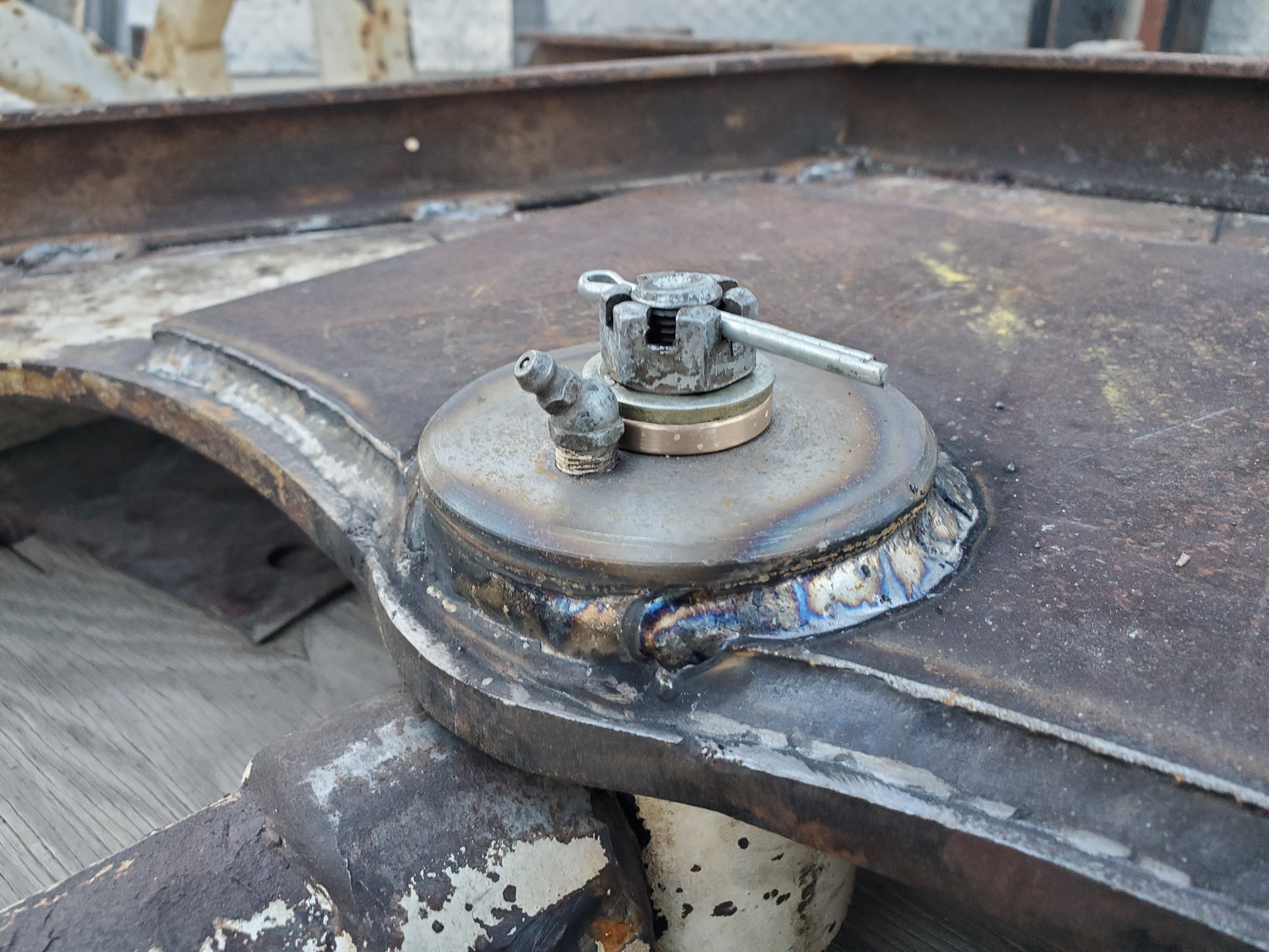

If there is any opportunity to add grease zerks to better grease that's a win on the trunion.
I see a few other cats in the background look ready to rock worst case although they are missing a set of tracks for some.
Good thought TA since there is no grease groove around either part internally, and pretty easy at the moment to add a couple zerks at 180° to the existing ones.
