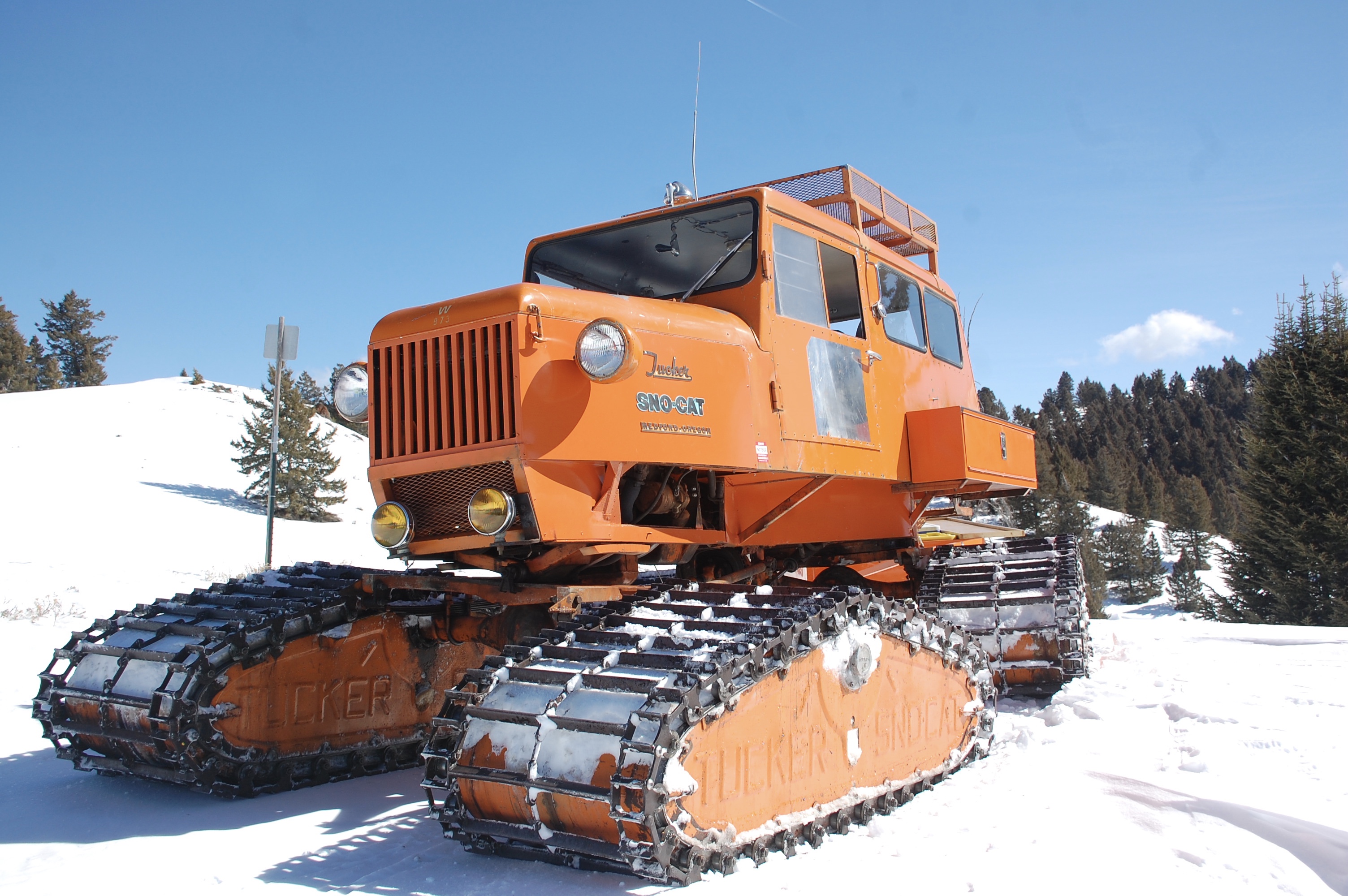

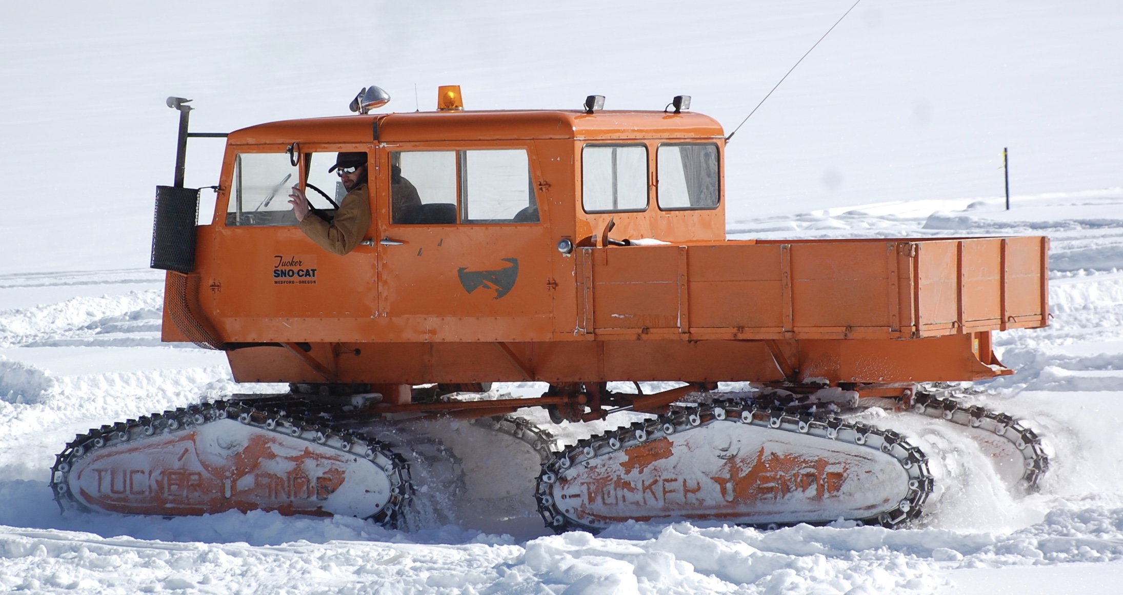

300 series tucker used dodge 1/2 pickup axles, weighs approx 3800 lb
400 series tucker used dodge 1/2 pickup axles, weighs approx 4500 lb
500 series tucker used International 3/4 ton axles, weighs approx 5500lb
700 series tucker used dodge 1 & 1/2 ton truck axles, weighs approx 8000lb
the best overall pontoon machine was the 500 series machine, with the expception of the 420, Torpedo, because of superiority of the pontoon machine in the snow, they did not need such aids like lockers and or much heavier/bigger axles, let alone engine swaps of 400 plus hp engines
during the mid seventies when you could buy either a pontoon or rubber track machines, these machines could be bought with either set up, using the same axle, pretty much applied to the 500 series machines. tucker was moving away from pontoon machines quickly, as they were cheaper to build,
to this day, a pontoon machine is still king of the mountain...

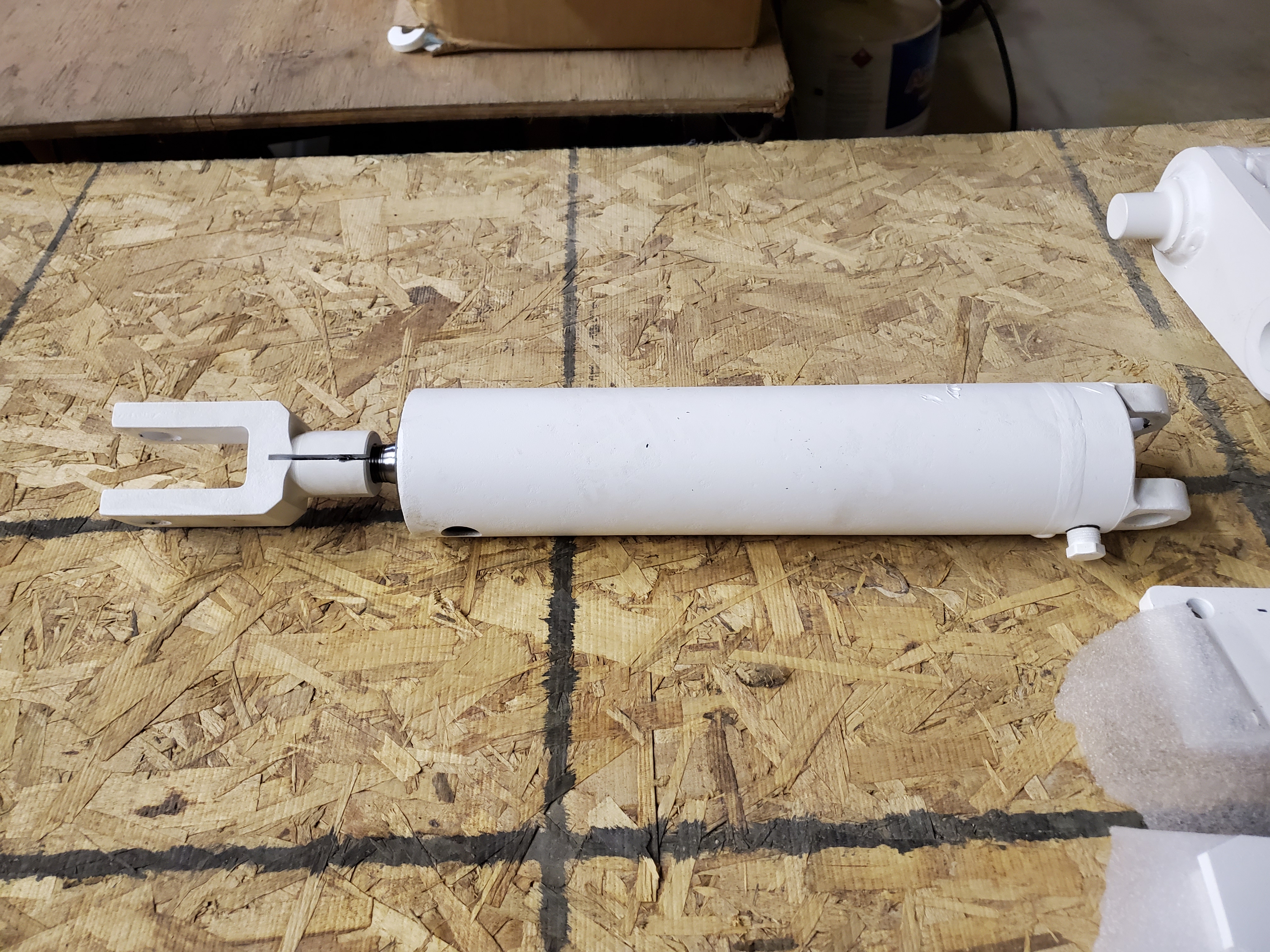

Back to bussiness. Had the steering cylinder rebuilt since the rod had a large pit in it and seals seeped slightly. The rod was 7/8" but my hydraulic shop said 7/8" isn't all that common and they would have to order everything for that size. So we decided to go out to 1" rod size, for ease now and in the future. According to my calculations it's amounts to only about 3% difference in force when cylinder is being drawn/pushed inward. Doubt if that will be to noticeable when steering. As evidenced by the bare parts of the cylinder, as much as I would like to have everything possible powdercoated, some things just don't lend themselves to that because of heat intolerance or not ending up with areas coated that shouldn't be. Some spots will just have to be painted to match.

The shop said my piston had odd sizing on it also which I inquired about replacement. Luckily good shape for hone polish and repack.
Key is figuring out the throw and centering the pivot. Build sheet had the specs that match my measuring.
Yes I'm sure when I get to the assembly stage I'll have some questions about getting everything aligned properly. I think I recall seeing around here somewhere, where sno-drifter had posted some Tucker manufacturer info about alignment. Got a bit to do before I get there, but I'm gaining.
