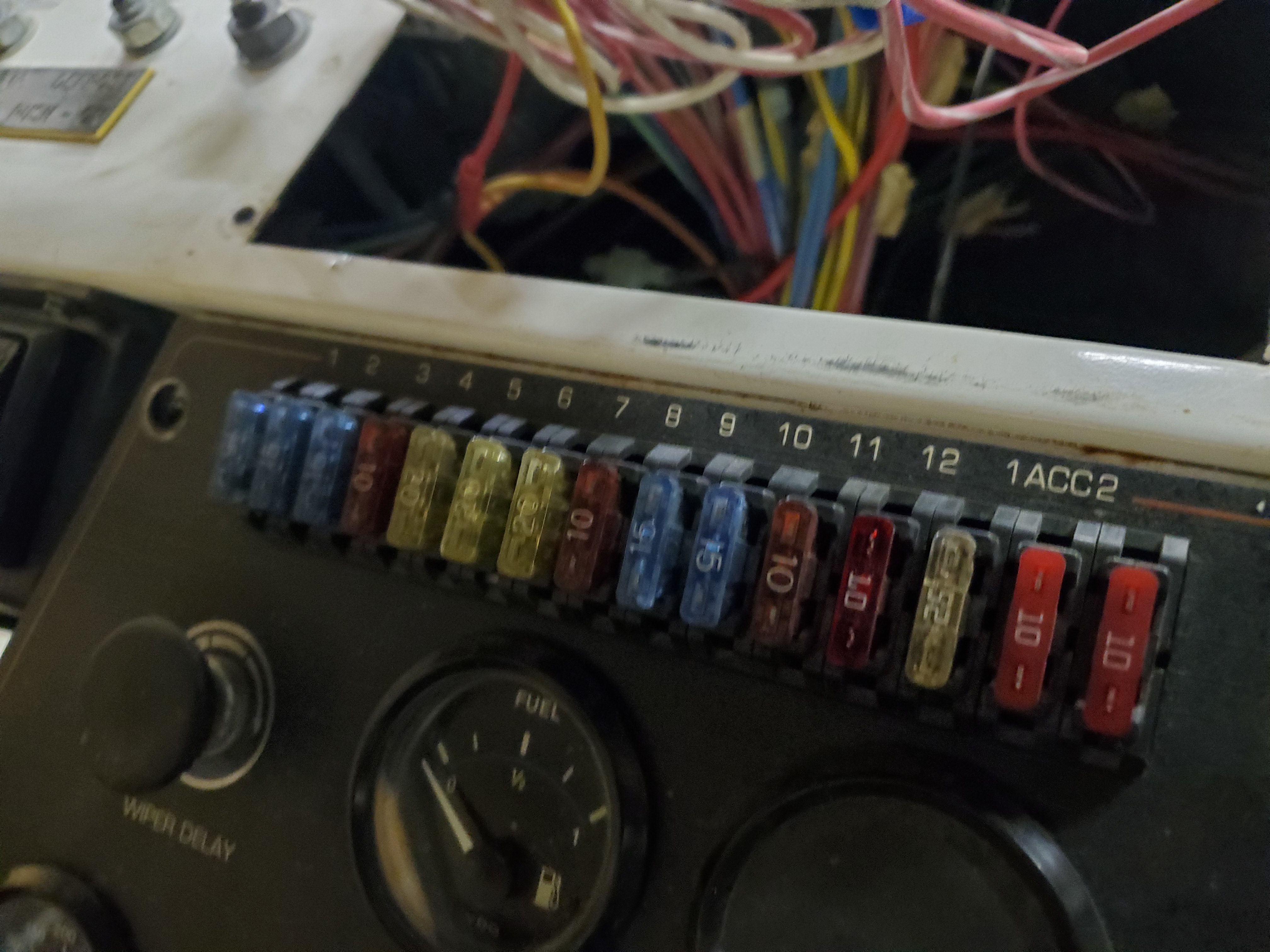

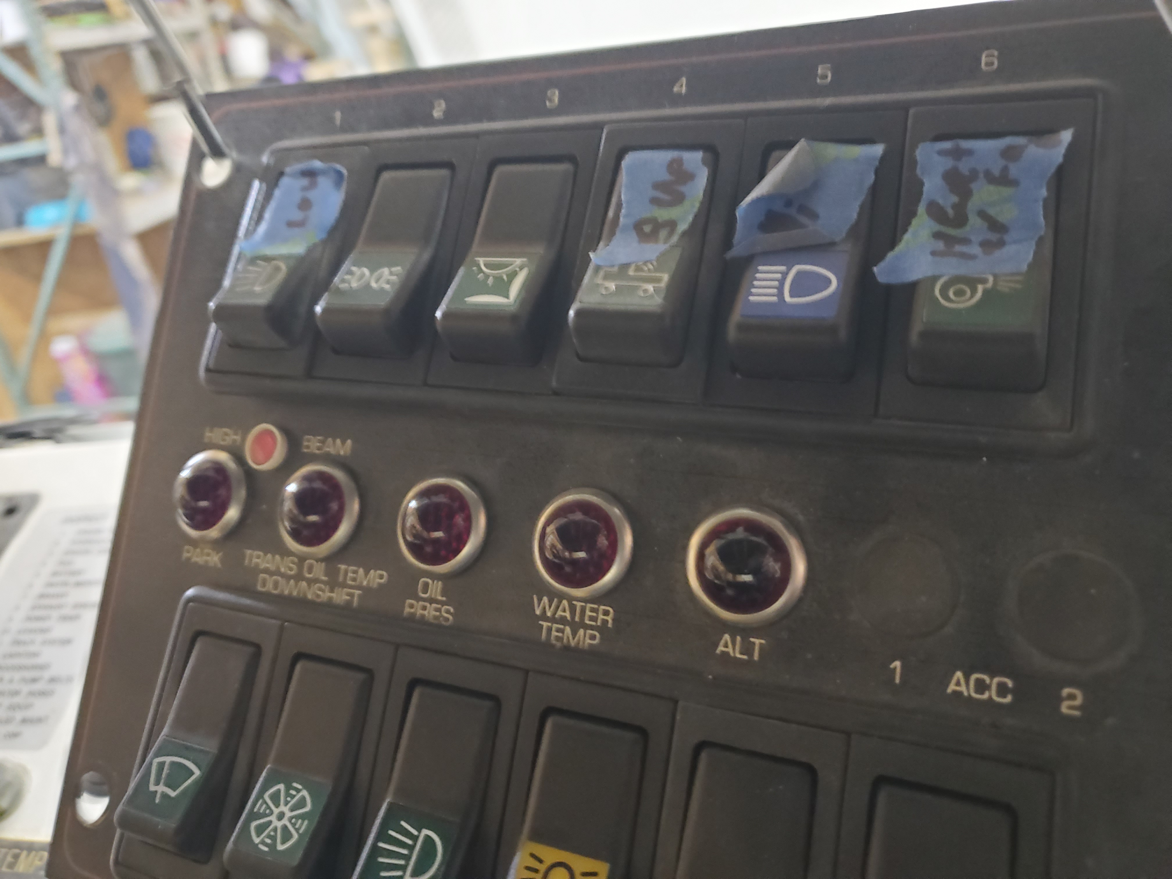

All the panel switches are numbered and correspond to the numbered fuse panel. Wiring that plugs into each switch is also numbered and is there even if not used in my application. I had several empty/blocked switch spots, so I ordered a few switches from Tucker (originals still available) to fill the holes, instead of the blanks, and for use in the future. Probably need to add about 33 more led lights to keep up with Wbj1 😉
I called Tucker, but they didn't have a wiring diagram applicable to my machine, so I started heating a wire at the numbered switch and looking for the outcome with a test light. Some I couldn't find anything heated, and other places I still have wires that I can't determine their function, but here's what I did find.
1. Low beam head lights, tail lights, and unused wire overhead front of cab interior.
2. Unused, overhead front of cab interior, and front of hood at the frame.
3. Could not find.
4. Cargo light.
5. High beam headlights.
6. Heater blower.
7. Wipers.
8. Could not find. Someone after factory, wired this to aux blower in cab.
9. Unused, rear cab door overhead interior.
10. Overhead interior above back seat center.
11. Electric fuel pump.
12. Unused plug near backup alarm, rear of frame exterior, and front of hood on the frame.
Aux 1. Not used.
Aux 2. Not used.

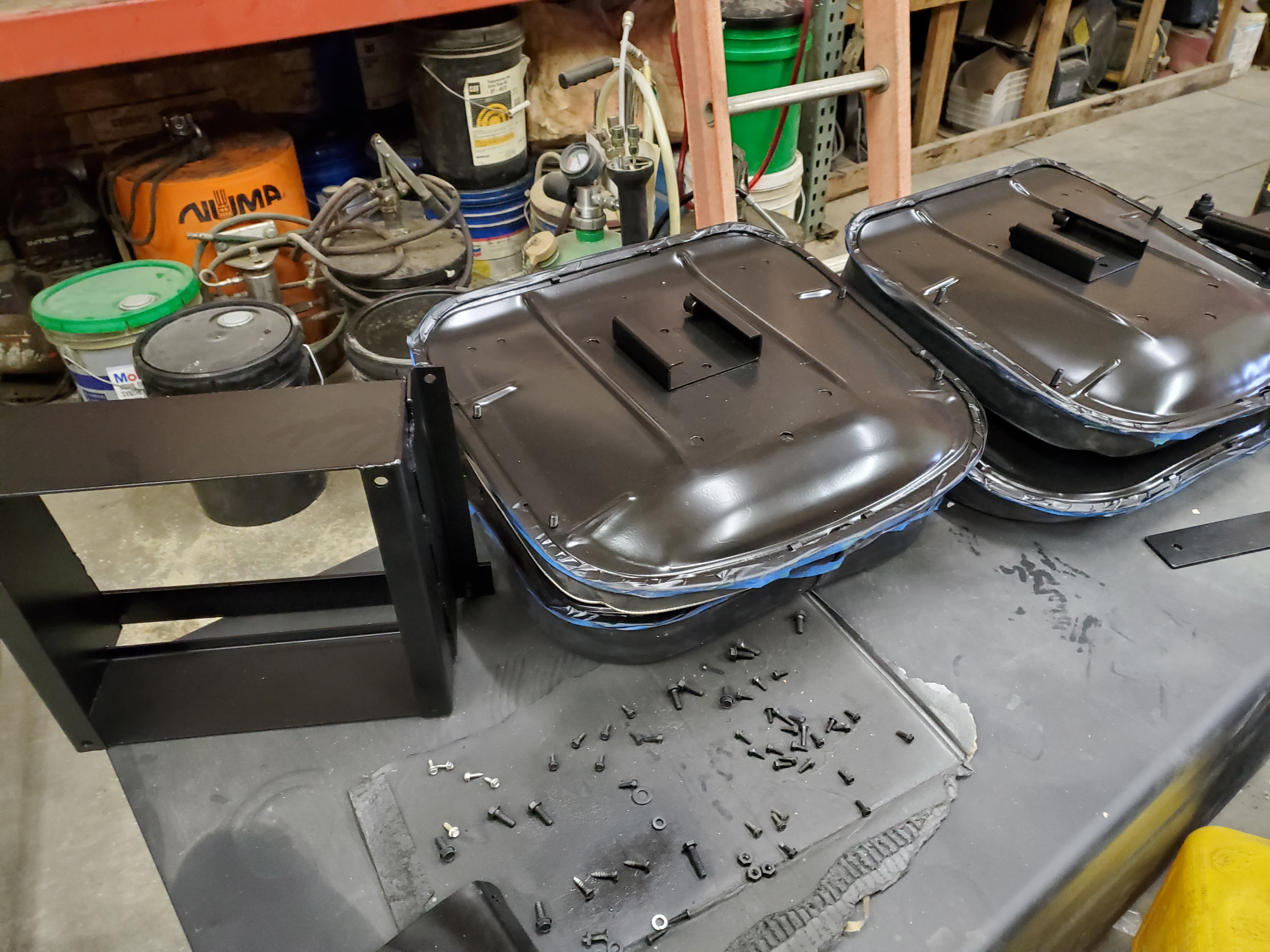

Also repainted the seat frames. I swear these mechanical spring ride Bostrom seats must weigh 50 pounds each.

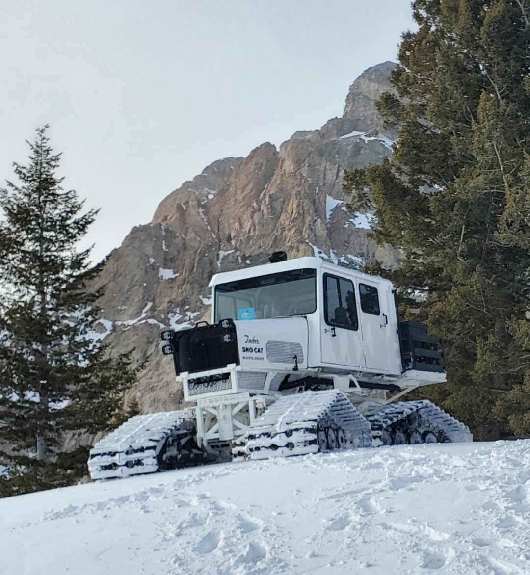

Well everyone who has looked through the SV2022 has probably already noticed that I managed to get running up and down the mountain the last couple days of the Sun Valley get together.
I still have a number of small items to finish up, but was thankful to get to test the general mechanical soundness before the end of the snow year around here. The take away from those two days is that I may want to change some springs in the trans valve body that controls the shift points, and I have a feedback through the sound system and the auxiliary battery. Not to big of issues. Anyway mostly moving forward with it, and hope to have a long season next year.
I'll post some more as I finish up some things like the exhaust, but for now just the proverbial before and after pics.
