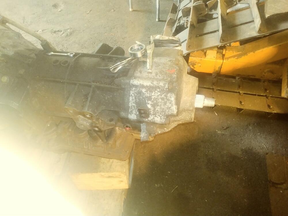

……….. roger that,... hope it's just a solenoid. that would be a bummer to ''side-step'' the gameplan,... but the Isuzu manual tranny would be a ''synchro'' ,... so you could shift ''on the fly'',... but putting the clutch pedal , hyd. clutch master , etc.... would add more space ''eating'' components. hope you get the auto to work,...

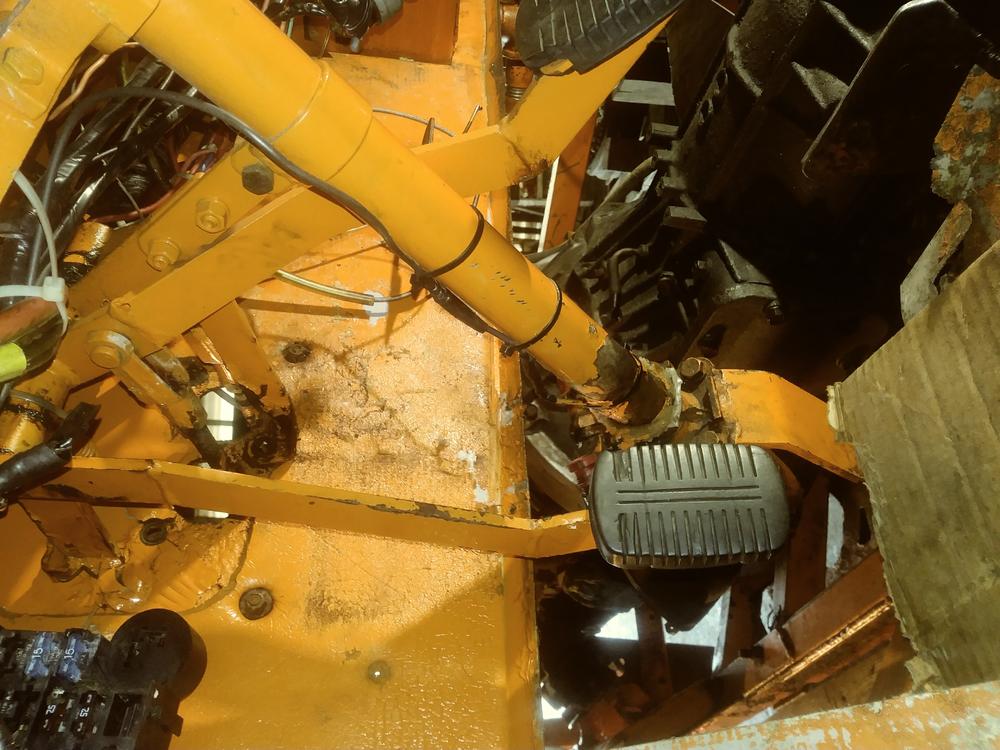

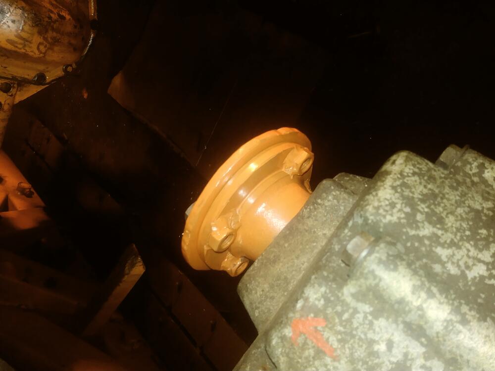

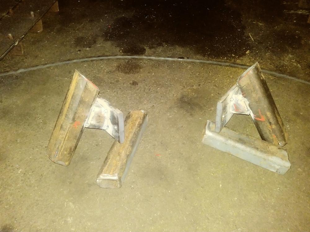

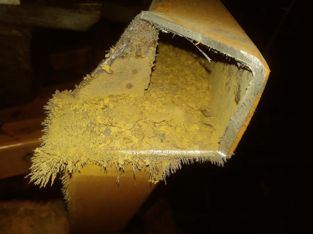

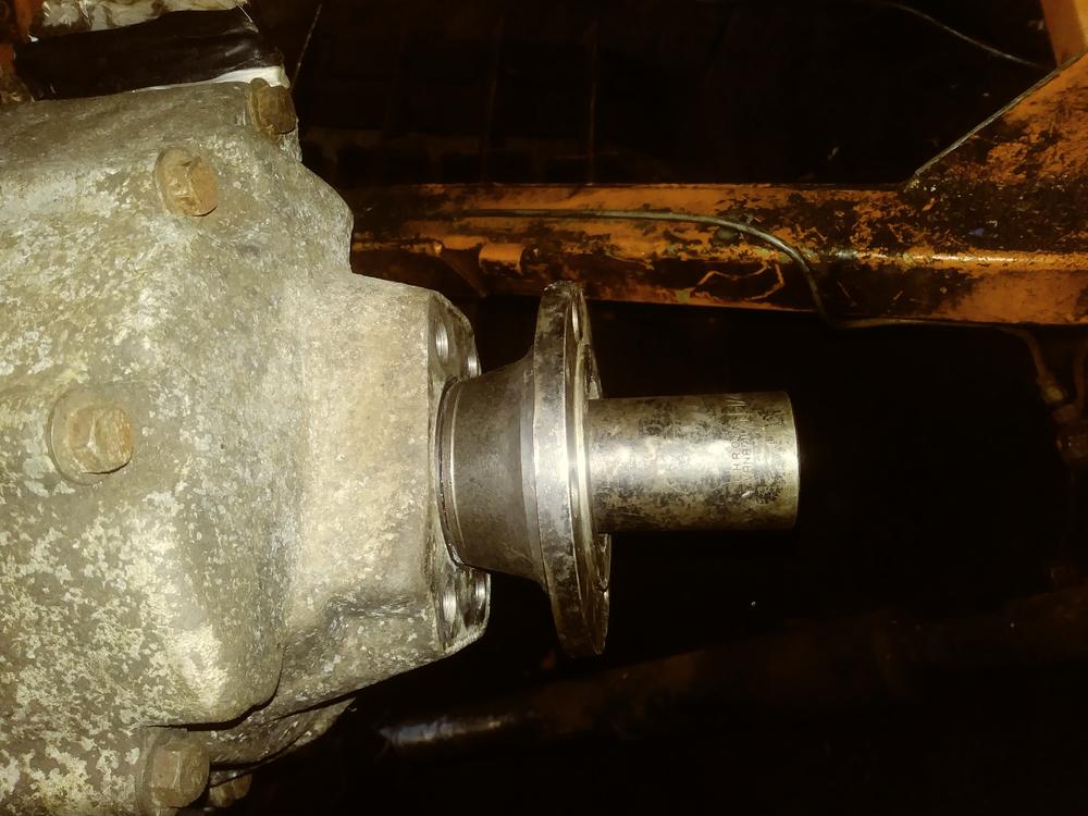

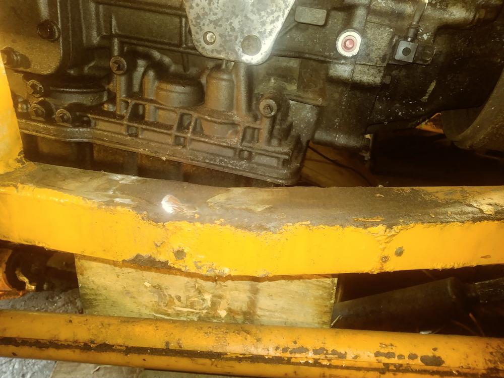

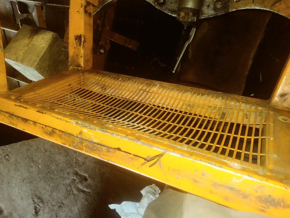

…….. frame modification; assembled rear trans. yolk, seal, spacer, lock-nut,... removed frt. screen & crossmember ''tube'',... the infamous ''Tucker Rust'',...

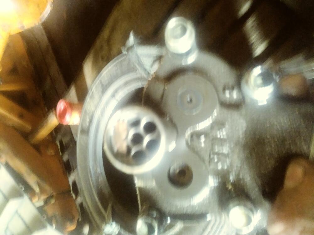

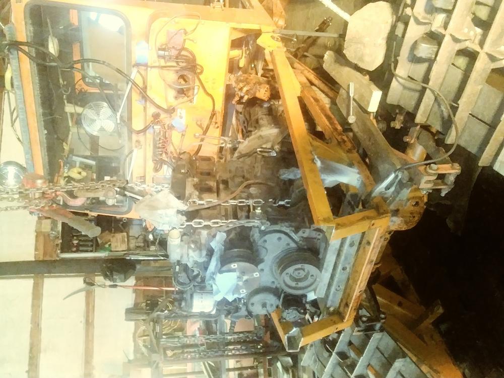

………. started the ''alignment'' of eng./trans. in chassis,... fab/cut/drill front engine mounts,... after installing the ''intermediate '' shaft assy.,...….

These re-powers can certainly stretch ones imagination a lot while trying to get things to fit where ya want them.
Looking good.

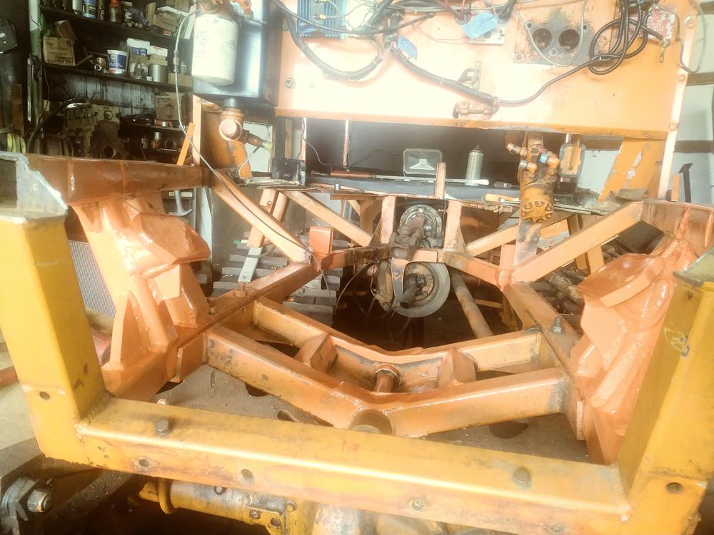

..……….. '' gusseted'' and ''glued'' the front engine mounts ,...and reinstalled back into place,...''tacked'',.... 75% complete,... a few more gussets & welding to do,.....

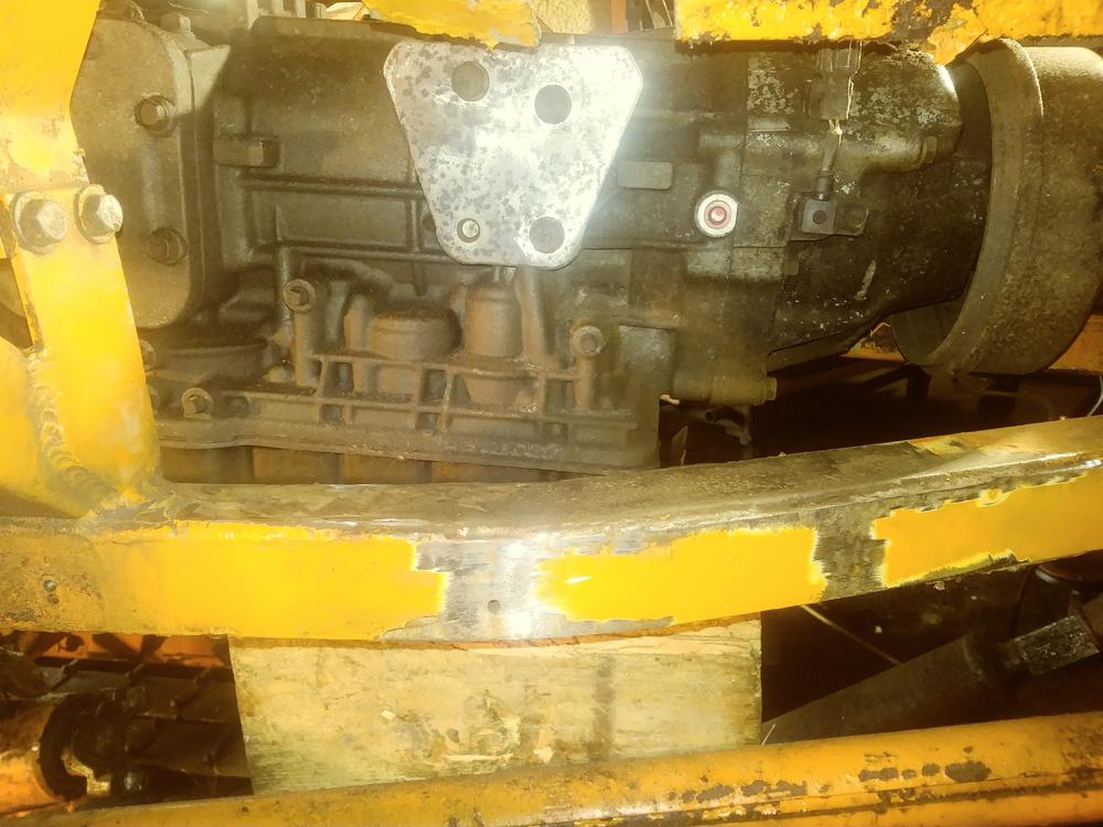

……… onto the transmission mounts; fabricating the mounting plates to tranny & chassis/frame , attaching components between the two, etc. drilled, cut, welded , etc. I like to use the Cummins ''B'' series isolators, for engines & tranny's . have to relocate the ''floorboard'' braces, on both sides. the leaking old master cyl. , on the left side, sure did a number on the paint job. got most of the R/S completed today,.....

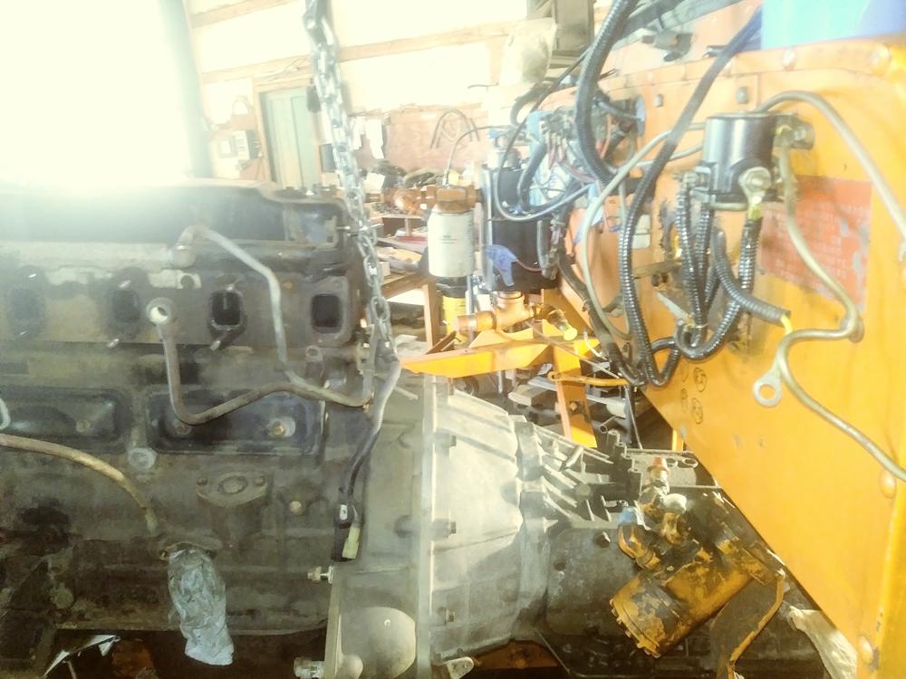

…… didn't get to Tucker Lake today, dang it …. got the 2.9L out of a JD240.... but soon as the L/S tranny mount is completed,... going to do 1BG's favorite mode,...''zipper'' time ….. yup....out with the eng/trans. to finish the welding on all 4 mounts,...:thumbup:
………. ''zipper'' mode,.... finished the welds,... ''mocked'' up a temporary radiator for testing purposes, ( keep a few around , with different orientations of inlets, outlets, offsets , dia.'s ,...etc.). next is to remove a broken trans. mount bolt , from previous. also on the list is to ''revamp'' the intermediate shaft hardware, attaching to the output yolk, from studs ; to bolts /threads....
….. freefloating on its own supports...…….

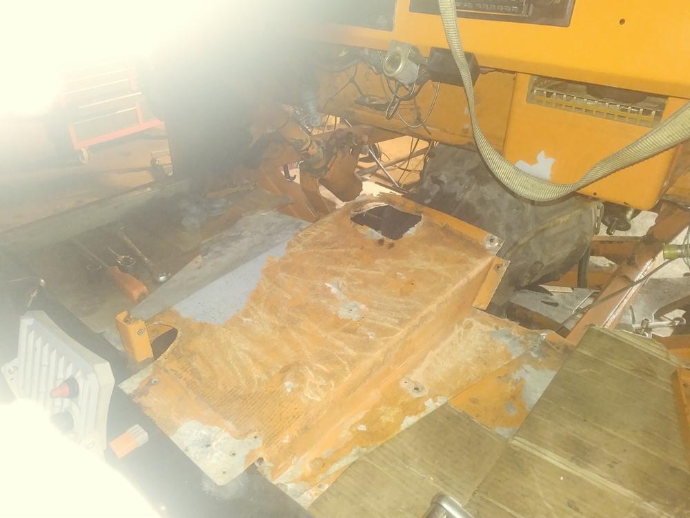

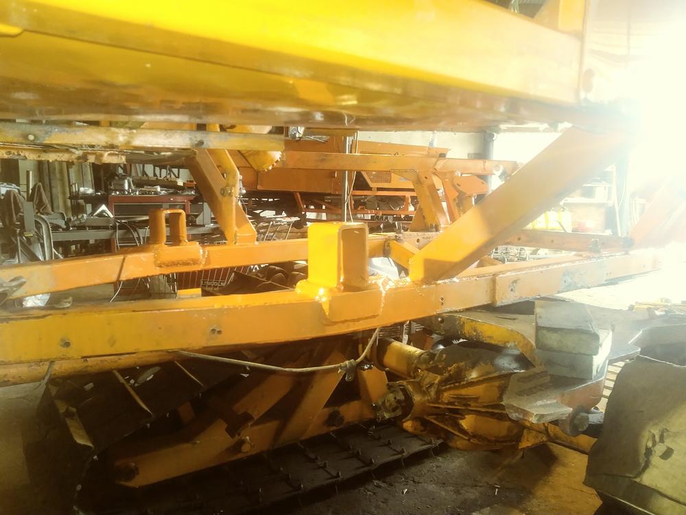

,...… ''touch-up'' time …. on the chassis, new mounts, upper brackets, spacer/yolk , trunnion, etc.... fab'd the ''counter-sunk'' spacer for the rear yolk & ''intermediate'' shaft,.... for the ''shoulders '' to set into . also welded the hardware onto the back of the yolk ,... instead of ''studs'' . for removal of the intermediate shaft if needed.

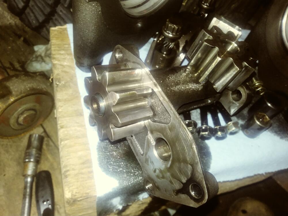

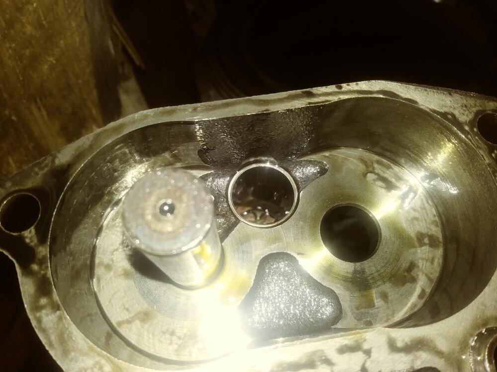

…… so, one of many projects this week ,... oil pump removal & inspection,..... considering ,...… not bad ….

………. now that the oil in bottom of pan has dried up,....looks like more investigation is needed,...

Yeow !!!looks like gold in a sluicebox !!!! man thats a bummer. Whats bronze in that engine? hope something obvious shows up for you. Don
