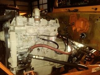

...... possibly when the intent is to unload such a project, instead of keeping it ,could be a motive . or just not knowing any better,...or lazy. yes, the little 4BT is quite proven. just about the same HP as the 318 industrial, but a lot more lower end torque. and the fuel economy is amazing. I ran mine this winter , to the shows,all over Tucker Lake, as normal..... and never burnt up the first tank of oil. would have been 5 tanks of gas,.... nothing like a diesel,...:thumbup:
..... Cummins,....

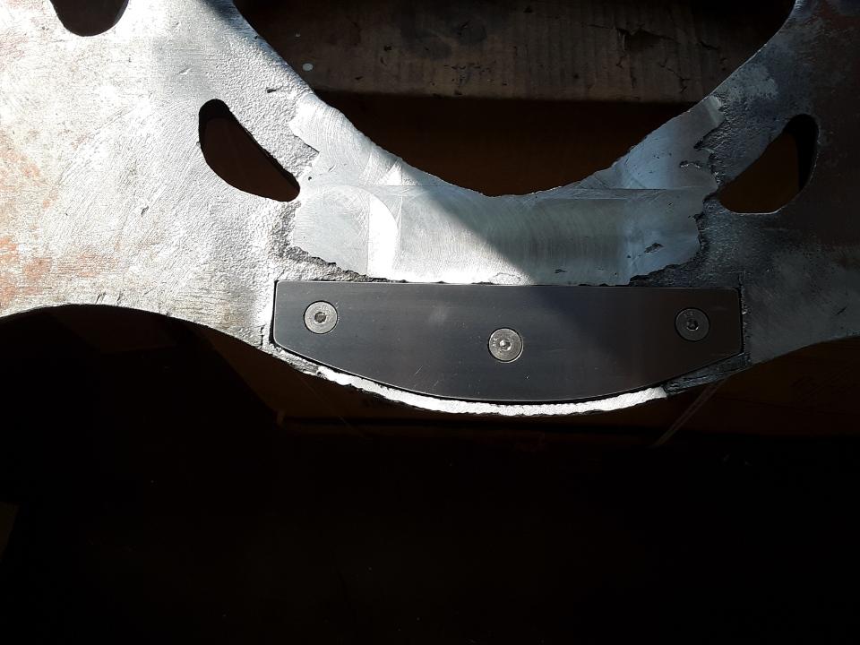

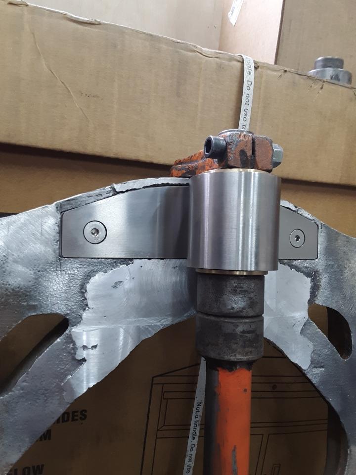

……. front fifth wheel repaired,...
……….. yes, hardened components,.. bronze ''step '' bushing … stainless hardware,.. ''decked the plate'' ,... no shortcuts for the high speed tucker ,... all 5 mph ,... or maybe 12... :smile:

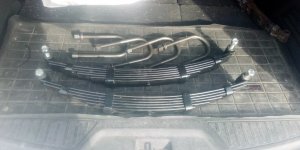

had new front leafs ''forged'' from the local spring shop. they make them for track inc. also. these are the ''beefier'' style the c/o m.e. units use.... now just time to fit into schedule,...
OO,
Just curious, new springs because the old ones had issues or just to accommodate the weight?
OO,

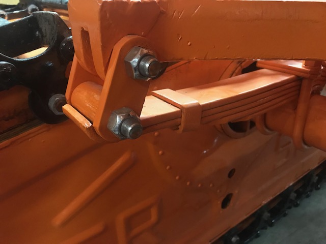

If those springs were going on my snocat, I would take them back to your shop and have a new second leaf made. There's a lot of stress on the first leaf between the end of the second leaf and the bolt. If you don't go for the wrap like this, at least extend the second leaf to just past the centerline of the bolt. Check first that there is adequate clearance for the second leaf at the other end not shown here.
S/D ; great point . and I love upgrades & overkill. so , what we decided to do was ''mimick'' the original design, but upgrade the type/rating of the ''leafs'' composite material. something like '''3014 to 3136'' (CRS) .,... the increased weight difference was 250-300LBS. from the 318/np ,... to the 3.9L/AT545,... these mimick the newer 1000/2000 design leafs . considering the application of this snocat,... in it's future job duties, I believe they will do their job. thx my man....
