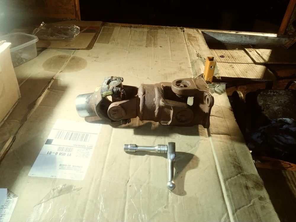

THAT IS A 1350 SERIES JOINT.
A good stout joint.
The Thiokols use a 1410 (Next size bigger) at the diffy.
Project is looking great.
……….. installed the t/f case yolk , had to build up the u-joint ''knubs'' on yolk. had to slide engine & tranny forward to install,.... also for future removal access room...

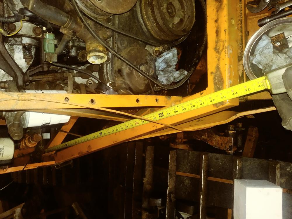

……. well , many thanks to Nikson , for his help,.... we did a comparison... and it appears that the newer 1500 series have a longer front frame ( probably a good chance , all the newer models , from the 80's on...) than the 70's models. by 4 inches... ( radiator space)… I was wondering why it looked like most everyone else had more space up front,... now we know... hmmmm

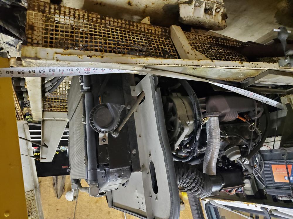

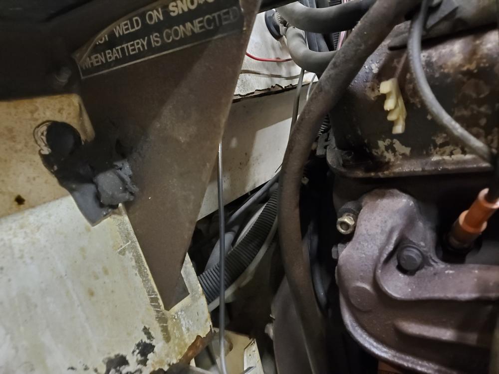

Just curiosity sake, were you guys measuring from the firewall forward? And do those years have a recess into the cab floor for the bellhousing? Got me thinking mine seems to have a bit of room there if I decided to make a change. First pic from the firewall, second pic from the recessed area. And sorry, have to turn your phone over, I can't seem to get those pics right side up.

…… 1BG, … thanks for adding pics , most helpful...anyone else plz share also.... so we were measuring from the 45 degree ''short'' crossmember under the cab firewall,,...to the front cross frame. quite a bit of difference in length s. what year is your tucker you're measuring . C/T ,... there is a service brake , operating by foot pedal,... located at the front output of the T/F case yolk ( disc brake/caliper). the p/b at the end of tranny is an (emergency) backup mechanical brake , and... a parking brake (p/b) when stopped . a lot of the Allison's don't have a park pawl inside of trans. housing . so like on mine, it's a necessity . thanks K/M for helping with pics ….:thumbup:
OO,
Measured and mine was 48" from that brace.
It's an '89 1644C. I really don't know where to find some Tucker info so I'm most of the time just guessing from pieces. This cab style, thus the designation C?, started around 87?, maybe the frame was made a couple inches longer when that body style started. Or maybe when a factory blade was ordered, as mine was, the front end frame got a couple more inches to accommodate hydraulic fittings up front? Idk, just thought I'd share the difference.
