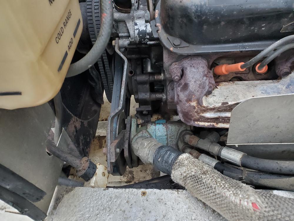

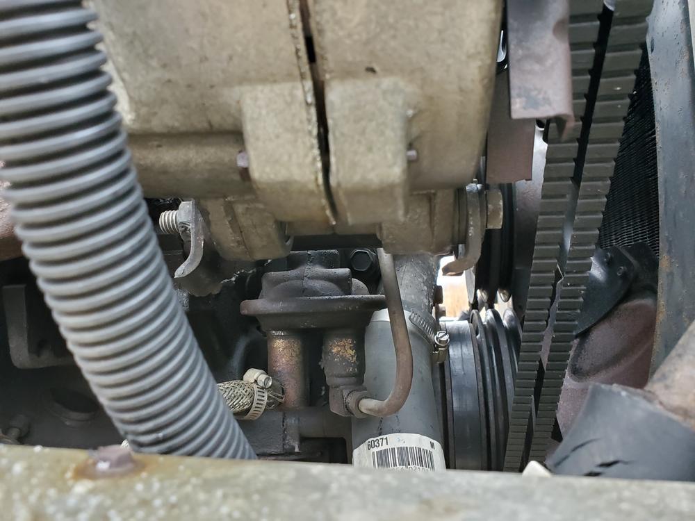

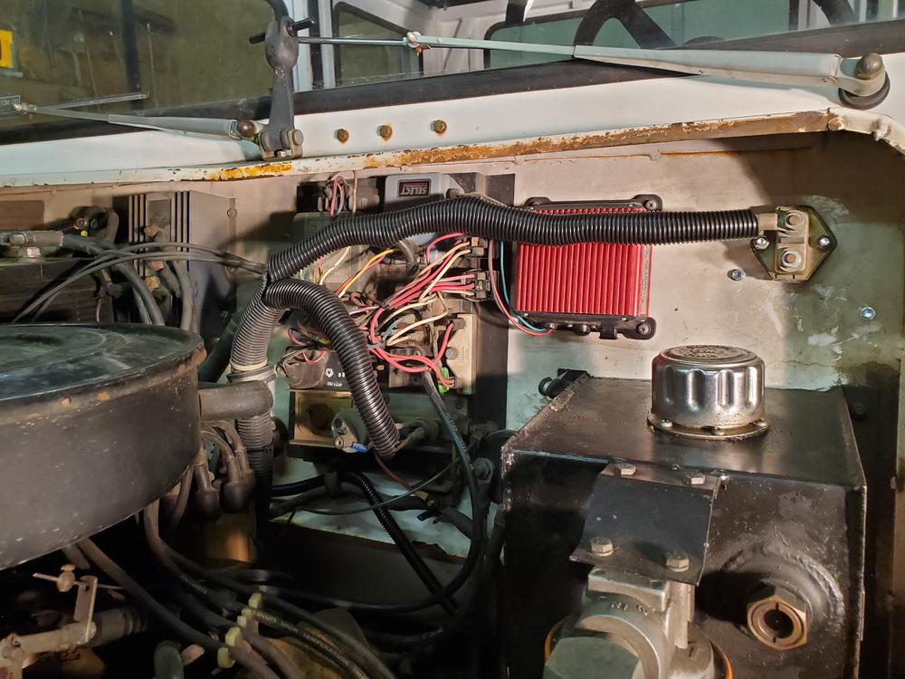

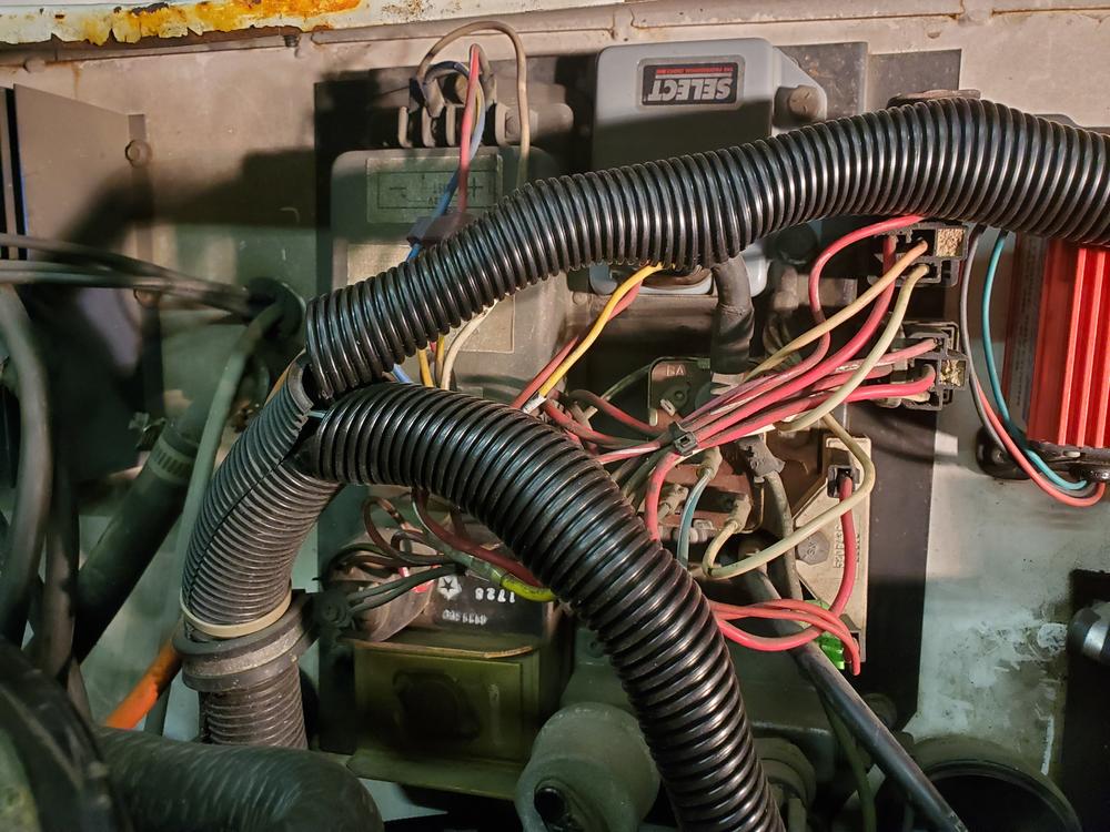

Couple pics. The firewall in the engine compartment, and the dash as it's ended short to allow for the door handles. Also when BFT asked if my engine had the governor/rev limiter, I said no since it's not under the carb. and I assumed the red box that was an aftermarket add on was an electronic ignition, but I see it's an electronic governor.

nice package grouping on the firewall... thx . yes, your ICU is on the lower left side. the EGC does look like the ICU. everything is nicely accessible; ballast resistor , V/R, relays, etc. does the primary power relay (C/B) , on the left side of cab still function. it has only one cable attached to it. so I wonder what year they swapped the hyd. tank to the drivers side?? is the hyd. pump still mounted on the R/S of engine , or did they swap that over to the L/S also. having 5 extra inches of cab width , on each side is a huge asset . I would guess that the width of your dash is the same as the older models , we have ,... the larger windows in your doors are a nice feature also.... I can barely stick my elbow out the window to stretch.... :thumbup:
Yes, belt driven hydraulic pump on drivers side as well. Alt, fuel pump, and radiator hose on passenger side. Perhaps changes in engine/waterpump necessitated moving the hydraulic pump?
This machine was speced from the factory with dual batteries. The isolator can handle 3, two in use and one cable goes to that relay on the drivers side. You can see where BC Tel (Telus) had some of their, I'm guessing, job related equipment mounted in the cat. Perhaps they had some onboard equipment wired to that relay that they only wanted powered with the engine running, or perhaps another battery in that equipment? Anyway I'll leave it installed since it was part of that factory installed option. One can imagine the factory options on this cat being well suited the a telephone company operation. Suppose by 1989 they had a pretty good idea what they needed, since it seems they have had a long relationship with Tucker by then. The pic below is from the Tucker FB page.

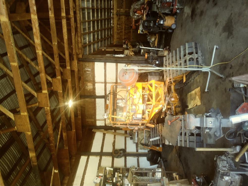

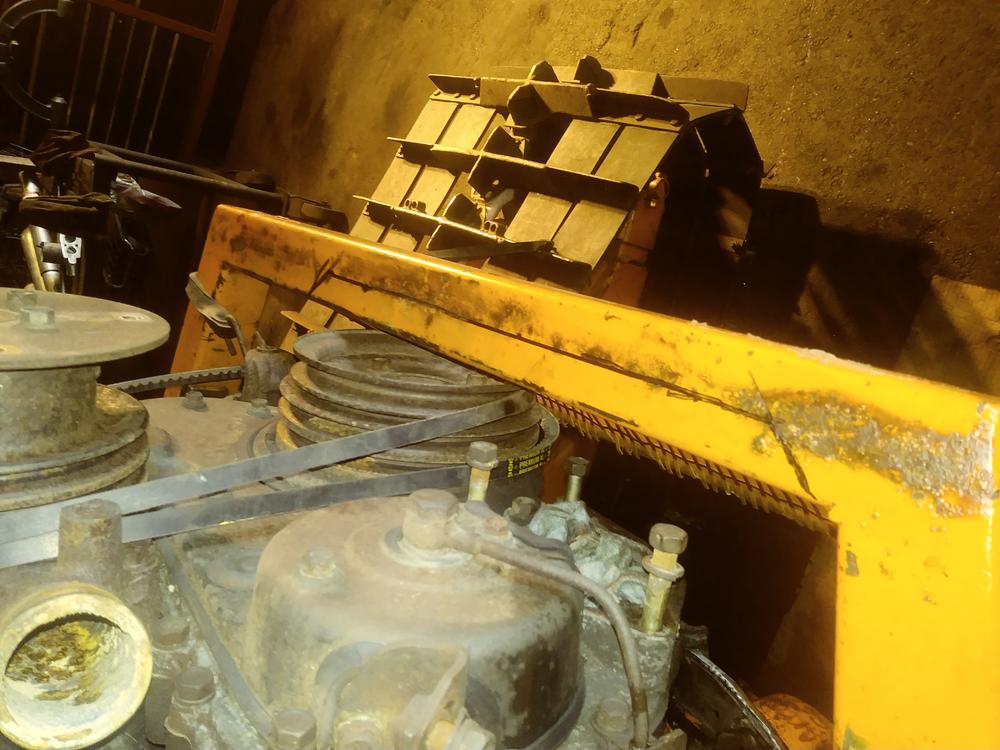

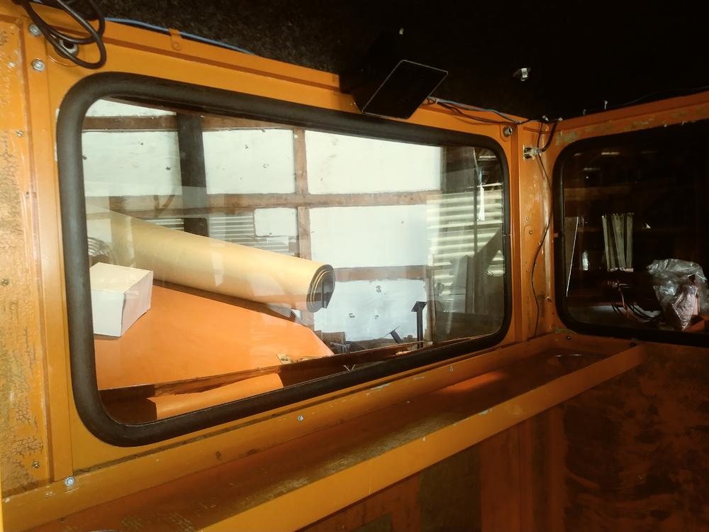

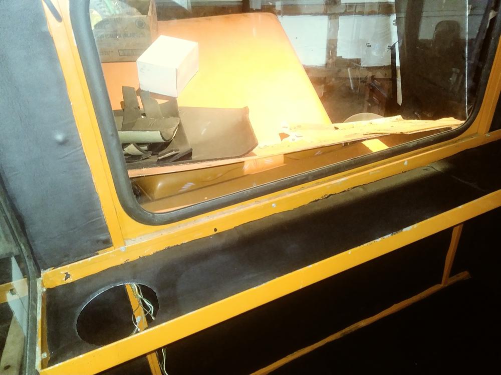

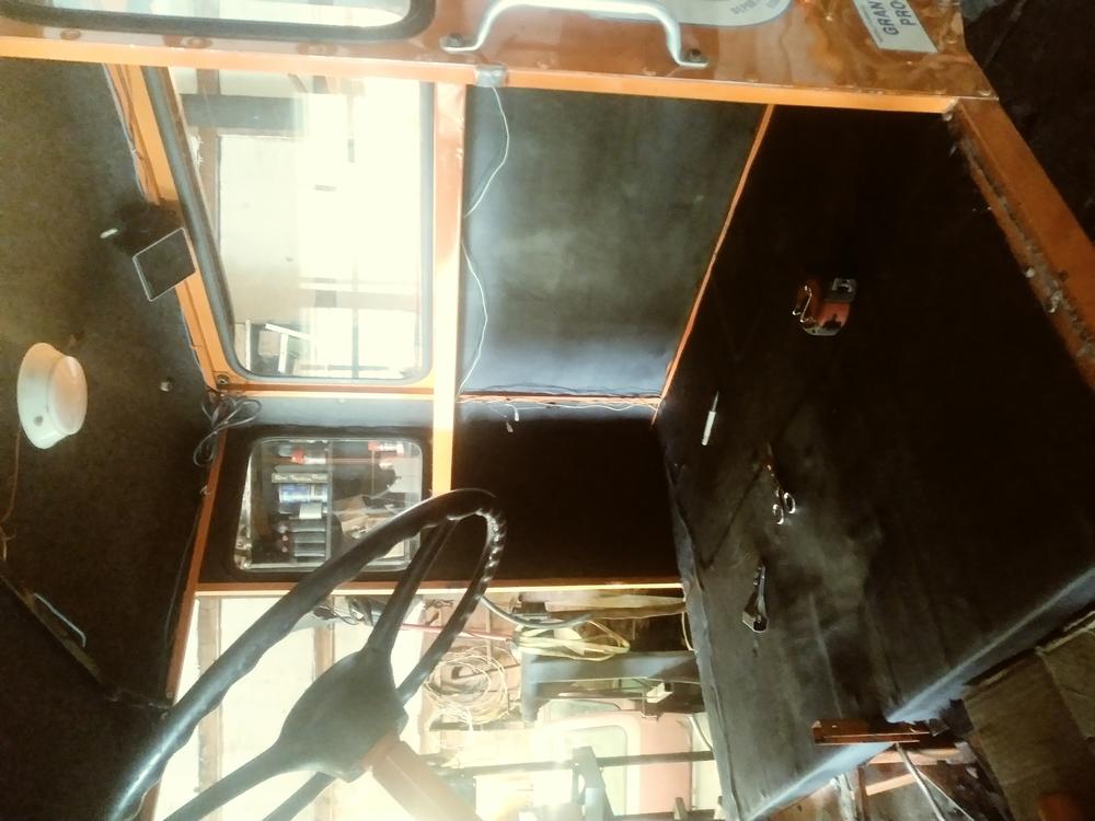

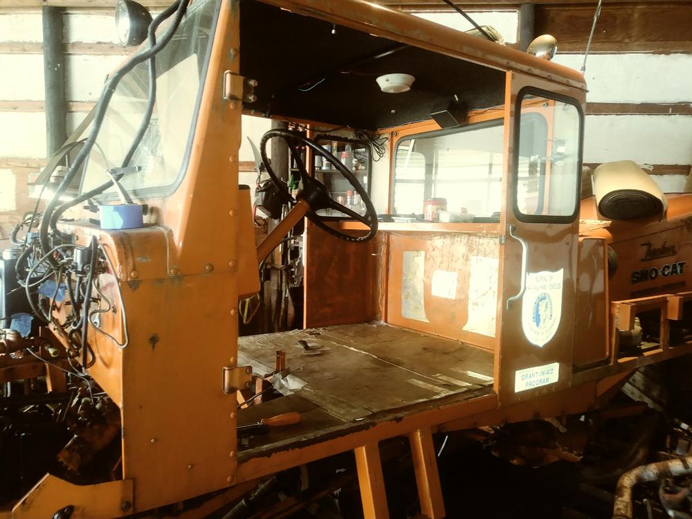

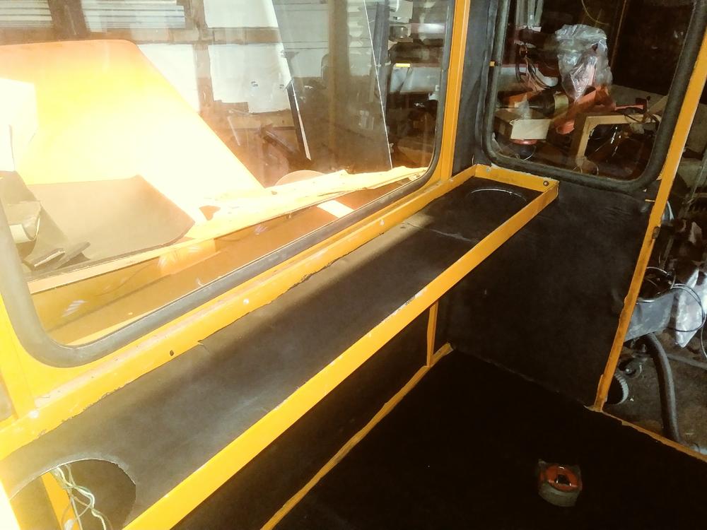

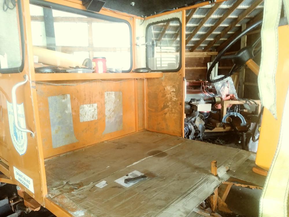

……… so, finally got to get back onto 'ol Nellie ,.... ( been having withdrawls) ,..... feb. is always crazy. did some interior cab /walls cleaning prepping for sound suppression material. nice material to work with,... some ''sticky''. was so involved , forgot the pics,... will take pics 2mrw,... unless we get the big one ……… :thumbup:
…….. here's a few from last week,..also finished pulling the carpet out of the cab corners & tray. installed the sound suppression ,.... it was like spring here today,...:smile:

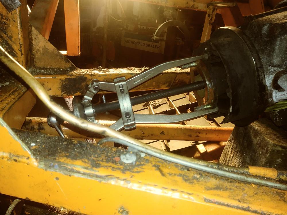

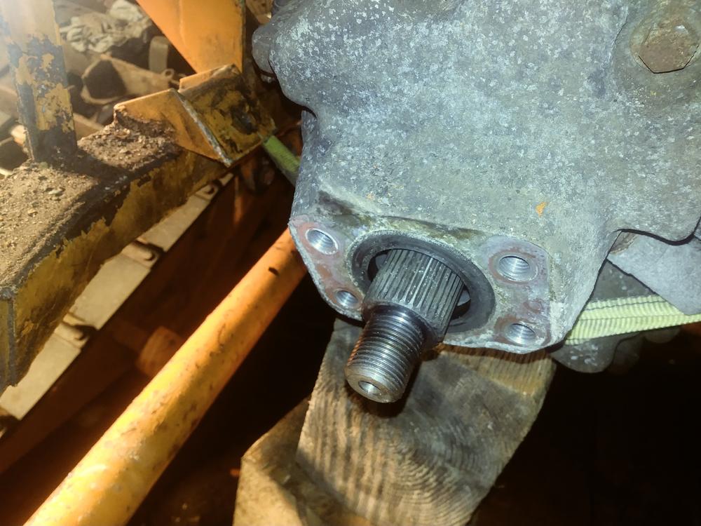

………. back to the transmission , P/B assy. , output yolk , removal ,.... to address the ''intermediate '' shaft assy. next is to reinstall eng./trans. , back into position,..... :thumbup:

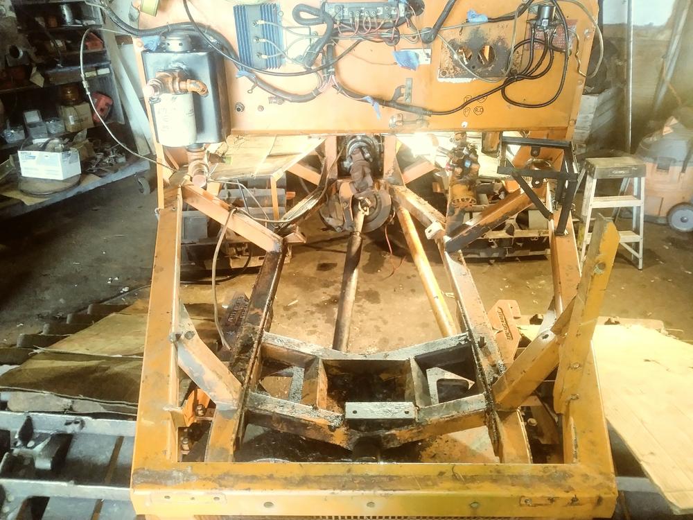

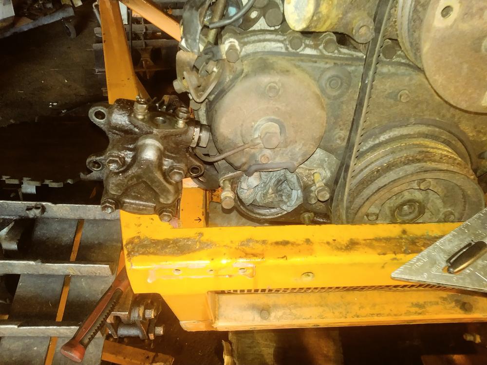

…… re-check eng./trans. fitment again,... so a few gas items need to be removed next,... removed eng./trans. assy., cleaned/degreased front frame/trunnion areas, etc. removed rad. brackets, frt. gas eng. mount, batt. box , etc... also old fuel line ( not sure how it ever ran/starved for fuel, damage from last engine overhaul). some grinding required,....

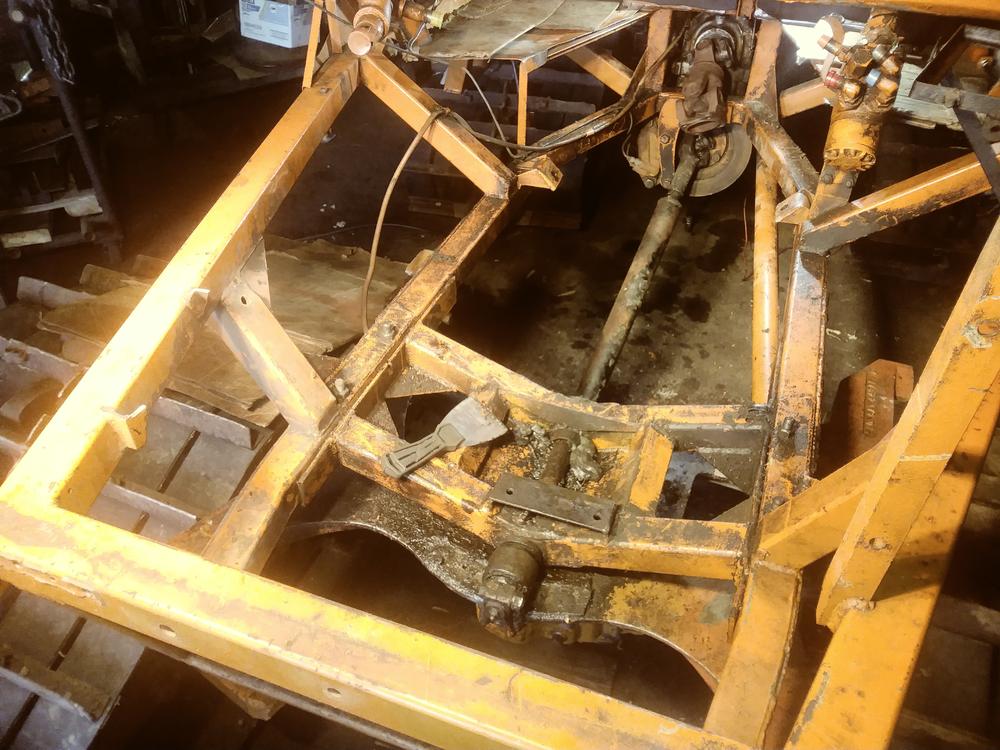

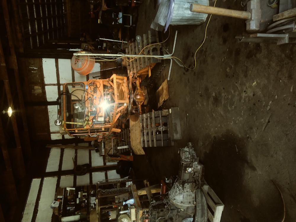

…….. finished up the grinding process, and cleaning the main frame assy . up front,… mock up #3 ,..next,...…...

hello 1BG, … lol... yes, all part of the process to ''mock up'' , when doing an update/conversion. things don't fit ''dead nutz'' the first time or so,... unlike taking the original powerunit out & and putting the same . but different one in it's place. even the simplest swap has a lot of little pieces.... gotta be the ''kool-aide'' :thumbup:

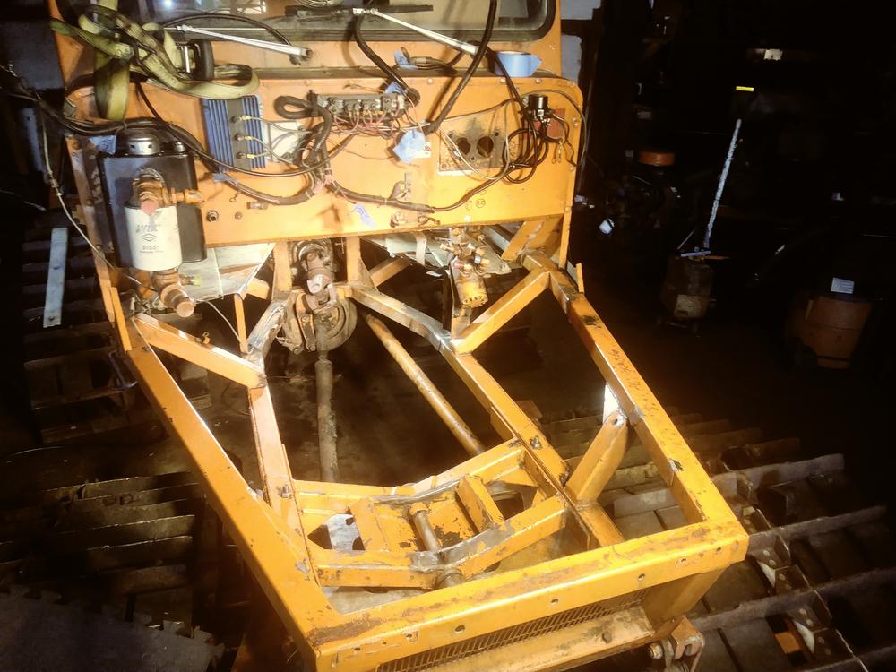

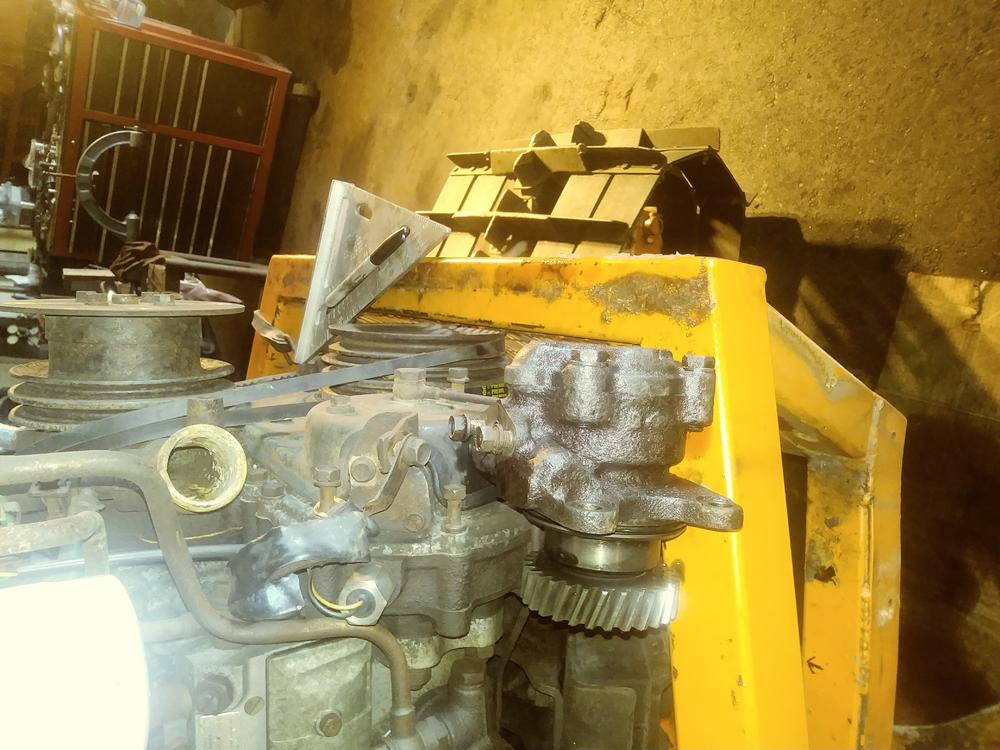

……. Mock #3 ,.. install,... unit sits lower in chassis,... remeasure ,... interference fit with frt. of engine, crossframe….. mounting radiator in bed (BAJA style) vetoed,... :smile: no room for powersteering pump , so gameplan is to extend frt. frame to accept engine, p/s pump, radiator, etc... hood extension ,removed p/s lines from pump, removed yolk again to have machined, etc...… :thumbup:

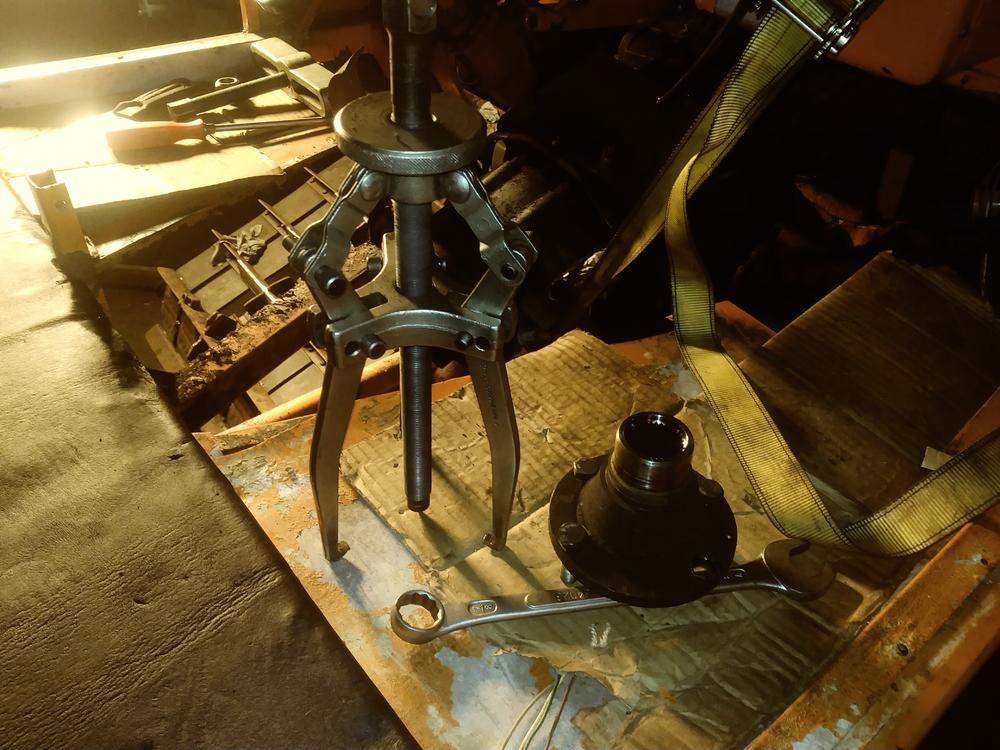

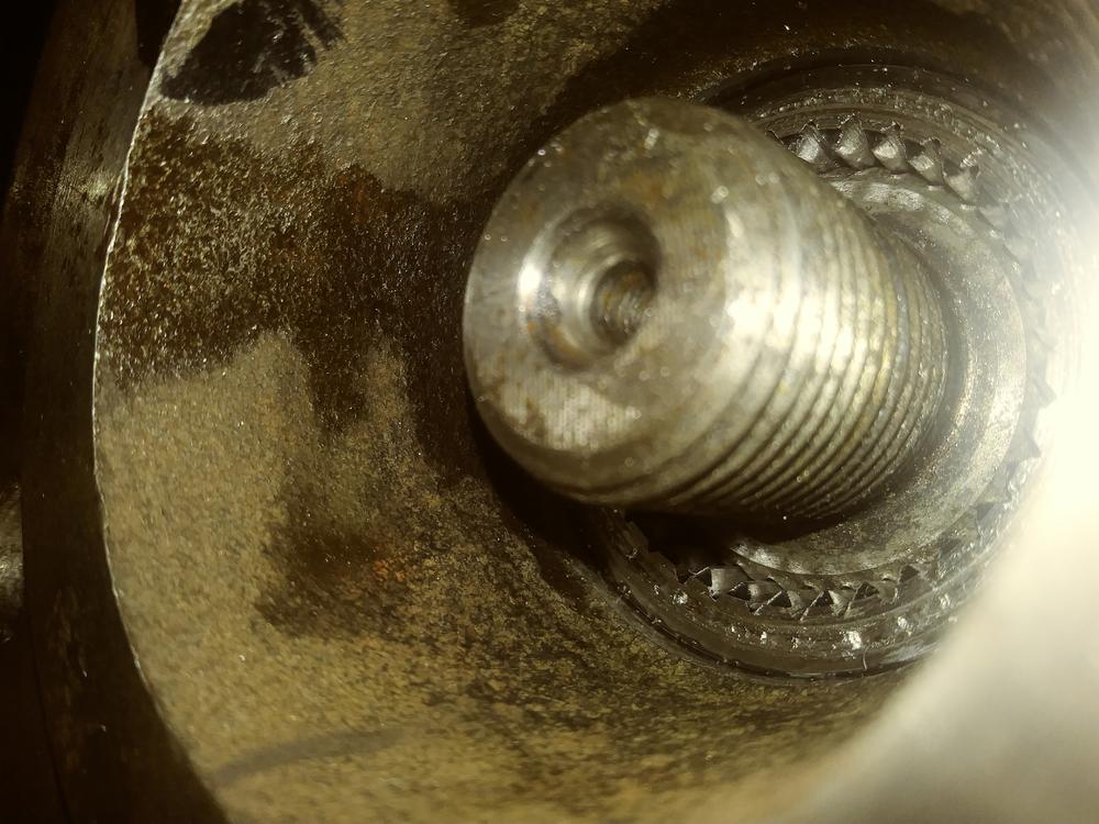

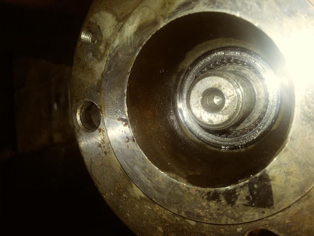

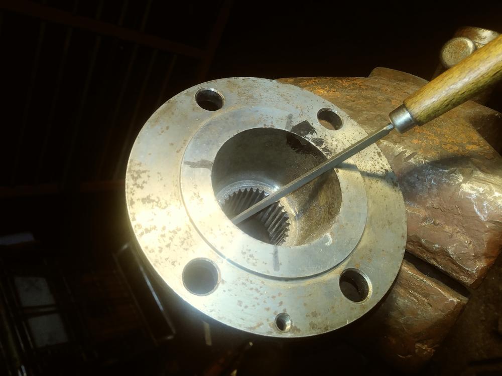

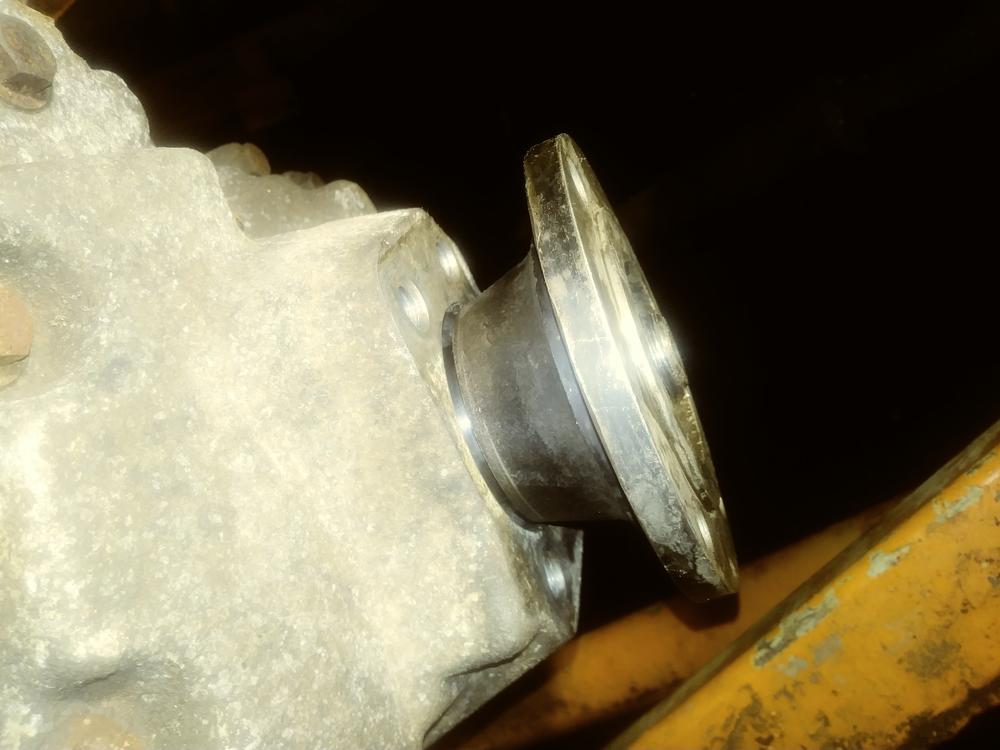

….. fresh back from the machine shop,... machined seal area deeper onto yolk, shortened yolk about an inch, the ''cut-off'' piece will be used on the other end as a spacer , to tighten yolk to shaft,....

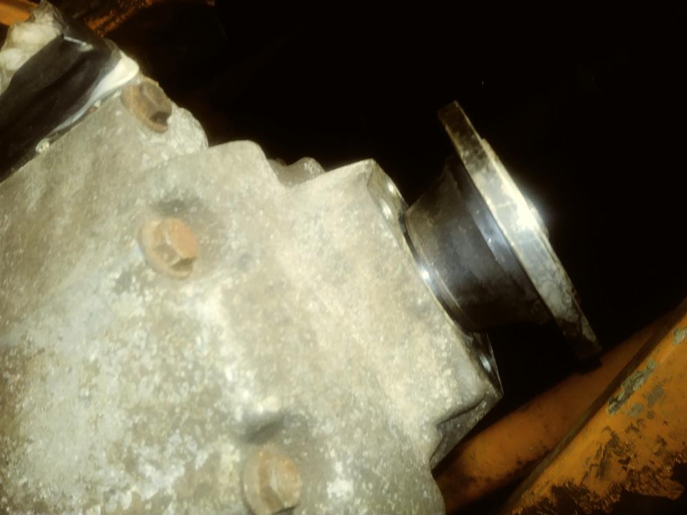

…… back on it, alittle ''prep'' work on the output yolk. problem was always too tight a fit onto the output shaft,...always needed to be ''pressed off & onto'' the shaft. not a good setup due to the ''lack'' of room /access , once everything is in place,...to remove for any future service/repairs , of any kind. a 120 mins. of filing & buffing, good to go now,.....:thumbup:

So with all the work you are doing with "hardware side" of things like driveline hook up to the tranny - did you get to figure on the transmission controller (TCU)?

……… so, the major hangup from the ''get-go'' ,... has been the lack of ''axial'' room ; from the ''intermediate '' shaft to the front crankshaft pulley & front frame crossmember. both were '' maxed'' out at each end. simply meaning ; that the ''intermediate'' shaft was slid into transfer case all the way, & the crank pulley was wedged up against the crossmember. no room what so ever. so, after talking with ''Sandy'' , about the different options, he authorized the ''lengthening'' of the front frame assy. to fit engine, and room for the radiator. didn't want to take up room in the ''cargo'' area for the relocation of the rad. so basically going to update the frame like the 80's models; much like yours, & 1BG'S, BFT'S, etc.... which will mean ; sliding the hood ahead & making a ''skirt'' to take up the difference , between the hood & firewall. so, right now working on the tranny & engine mounts /locations, etc. couldn't do any progress in that area , due to lack of room & locations. so, not at that point yet, to hook up eng./tranny, and fire up to test operations,... but coming soon. so, with the ''added room'' up front, that will allow the use of the original p/s pump to be bolted back onto the front of the engine timing cover again. which will be solely only for the p/s system. much like what I did on the Cummins ''B'' project. that was clean & easy, no brackets, belts, etc. …. so, do you think you have an issue with the new tranny controller you incorporated, or an internal issue with the trans. itself. did you drive the donor in which you used the power plant from,..... any pics of controller …..thx
