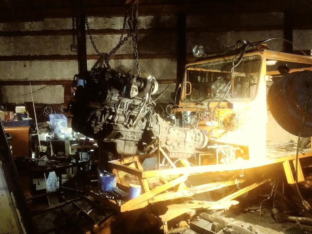

…….. the donor transplant arrived safe & sound today, courtesy of Alex,.... nice job A.R.,.....

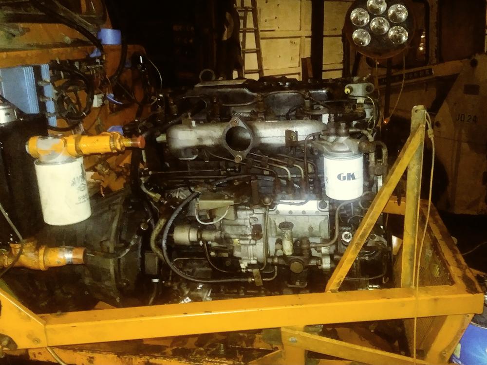

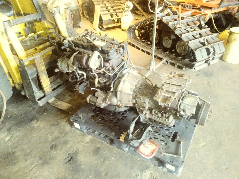

First I told Orville then I told Wilbur, a 4BD Isuzu will not work in a Sno-Cat.
…………. LOL,.. I knew if I waited long enough, you would post a picture of the 'ol girl in place … pm me a pic of the motor mounts,.. I would love to employ ( copy sounds wrong),... like the placement of the hyd. tank, air to air plumbing,.. this one has a different exh. man./turbo set-up... than yours,... thanks scott, :weneedpic:thumbup:
I see you have a belt driven hyd. pump, did your engine have the option of a gear driven power steering pump mounted to the r/s of timing gear housing,.. thx again,... :smile:

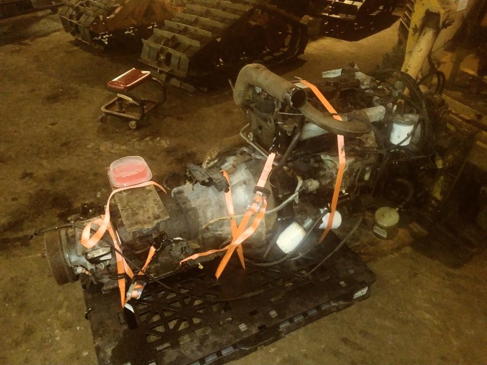

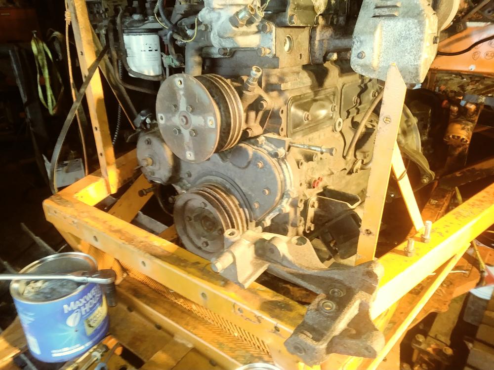

………. so, today...…. was ''lighten the load'' day , ( so my poor old jd24 can lift it /lol),.. and remove the ''truck'' stuff,.... found out where the ''blue smoke'' in video , of engine, was coming from.... the turbo was trying to eat itself. and one of the oil filters spun off with the ''thimble''.... lucky it hadn't fallen off … addition to list...

Those are great motors for any style cat , I installed the big brother 6cyl (non turbo) to this motor in my muskeg, It has been trouble free, and the trans cable shift linkage was easy to adapt into the new cab. The ability to clock the starter allowed for a tight squeeze into the tunnel. Wish more popped up locally, I would love to put one in a J5.
J5 Bombardier:hammer:
….. I totally agree,... Isuzu makes one of the toughest engines on the market. ive got some customers with Isuzu's, Kobelco's, etc.... they do nothing to them, I don't think they even change the oil, just beat them every minute.... tough. love the ''oil burners'',... they look cool, sound cool, smell cool, ….oops... diesel in the veins.... post some pics of your Isuzu, thx my man,... :thumbup::thumbup:
Having no luck with the search for my old thread, ended up going to posts by J5 Bombardier page 7 , " Muskeg Hull Rebuild ". My Isuzu is there, it was a long 5-6 year project.

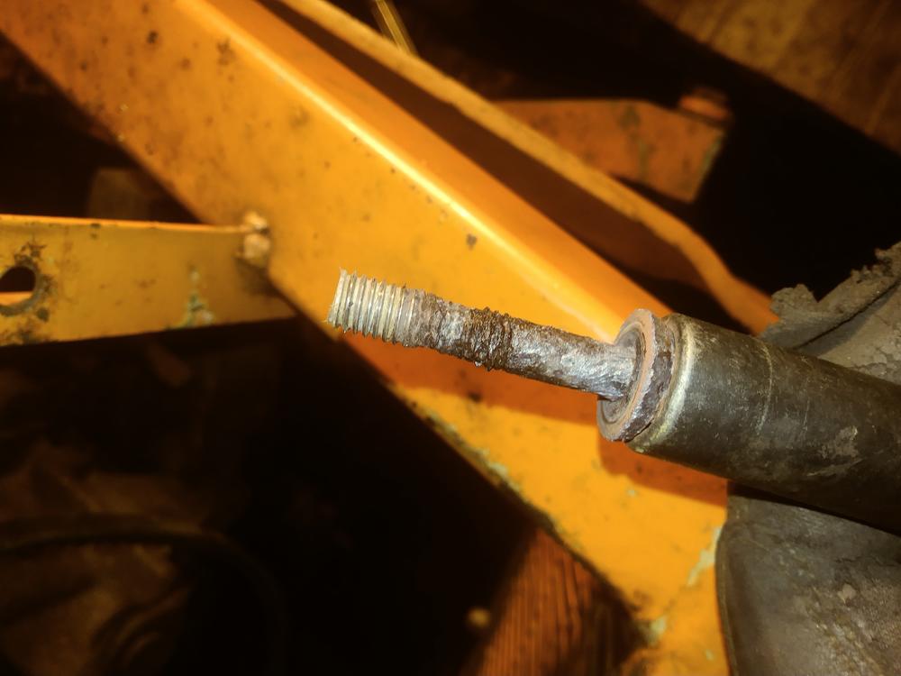

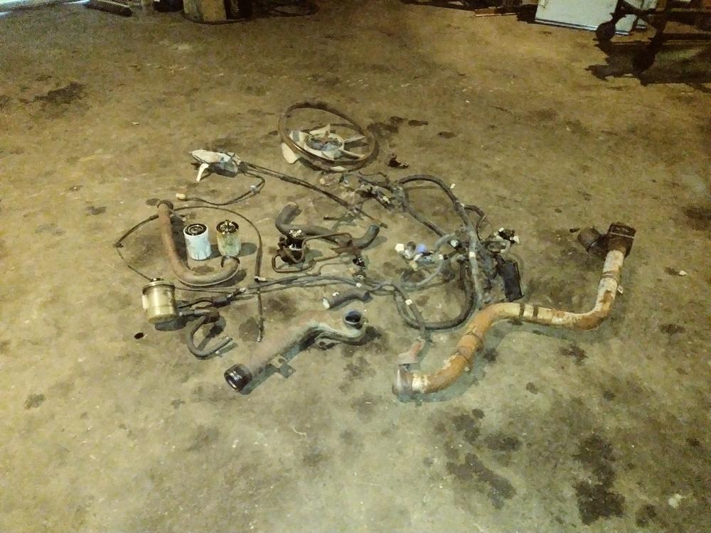

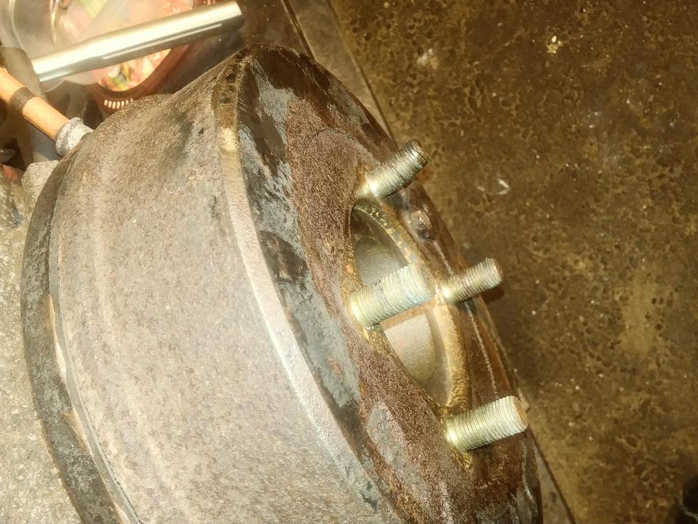

…… finished with removal of ''truck'' items, damaged driveshaft bolt, trans. mount , starter ( have to chuckle, the hardware is as rugged as a CAT 425) ,... alt./bracket, p.b. drum, misc. brackets & cables (cut off), etc..... then onto the cat; removed; hyd. hoses ( shot/brittle/ outer sheathing flaking, etc),.. that ''crusty/leaking Master Cyl. assy..... brake/clutch lines, steering hoses, wiring, ,misc., etc.....

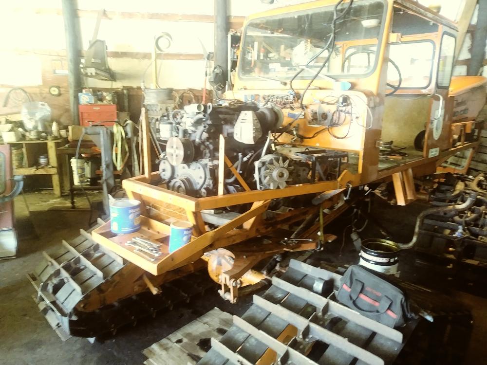

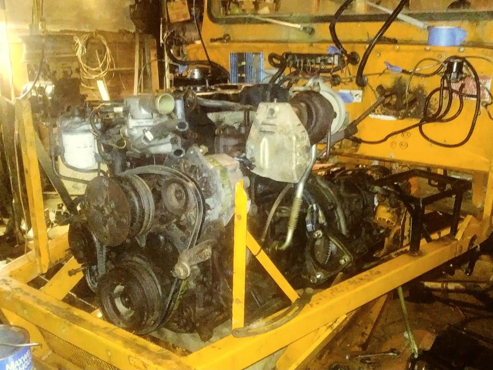

….. first mock-up ,... looks like no fan interference issues, rad. will be in the back... longer than dads....

The electric fan works great , went with an adjustable switch (sensing bulb in the rad fins ) . I have to jack the rad for a pump install on my current muskeg project, the gas 318 will get the same setup.
Keep those pics coming , nice work.
….. nice to hear that , certain applications can function properly.... what's the usual ambient range that you use it in,... :thumbup:

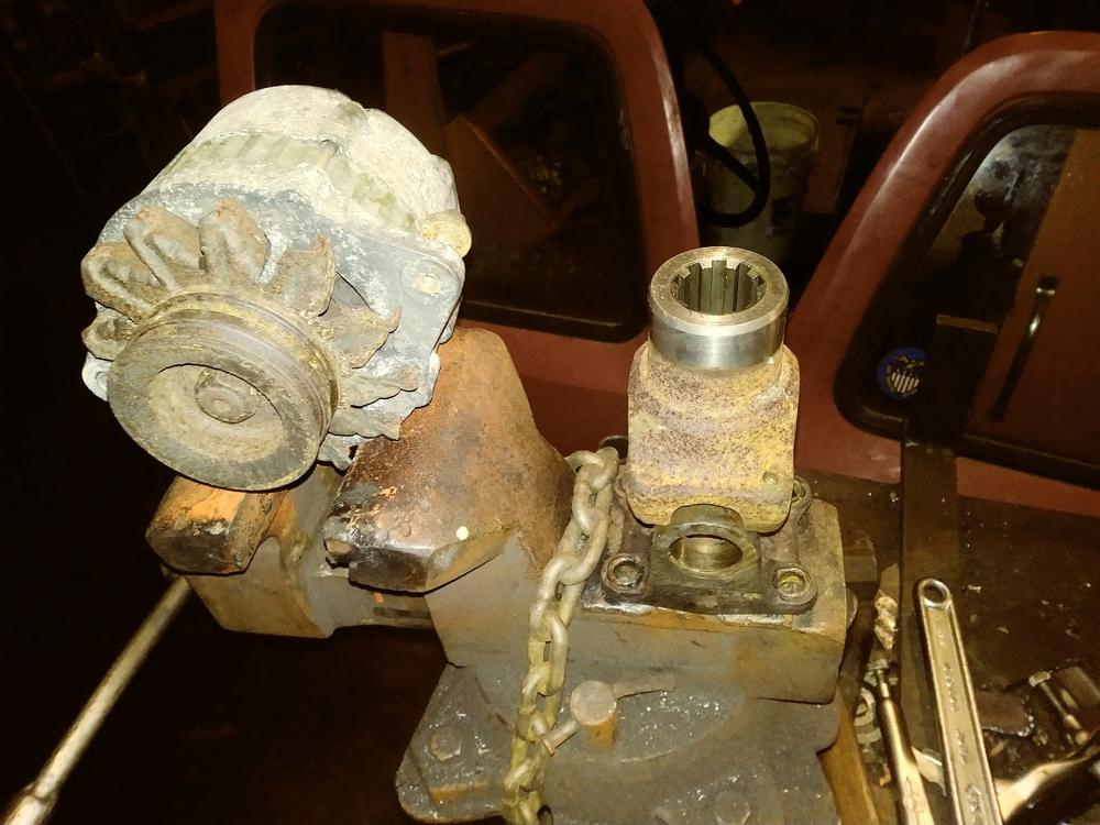

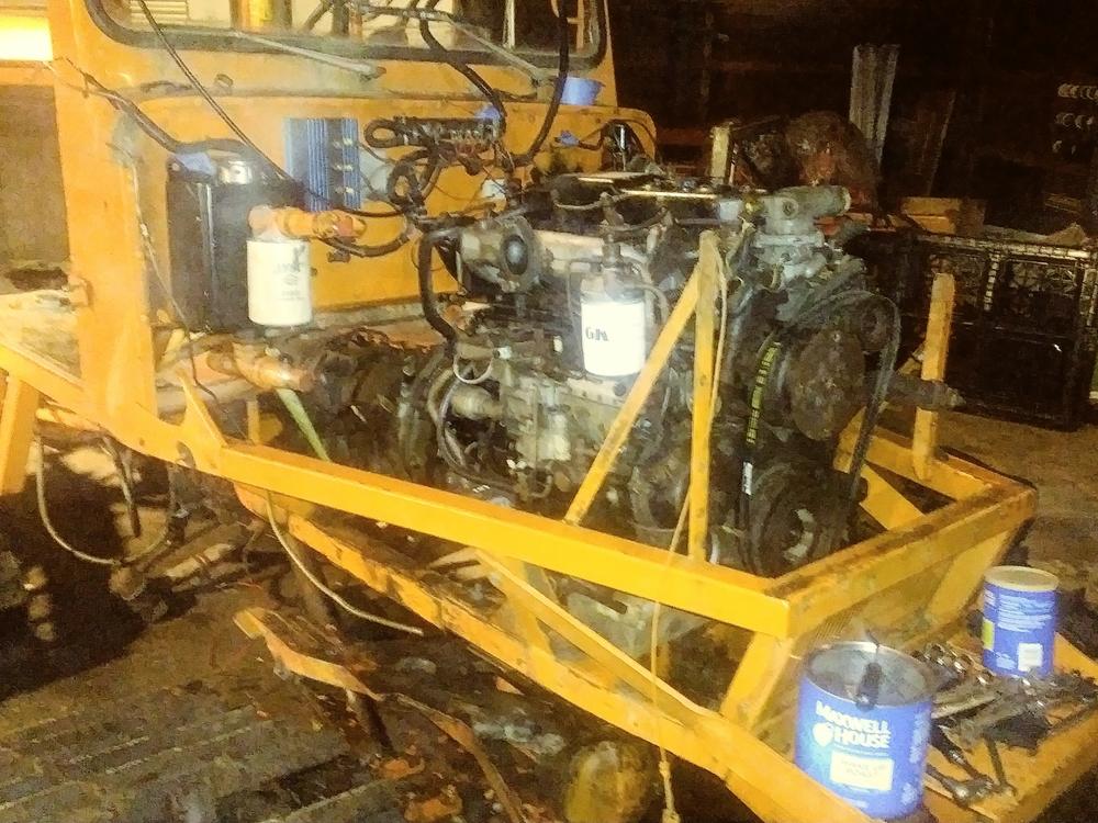

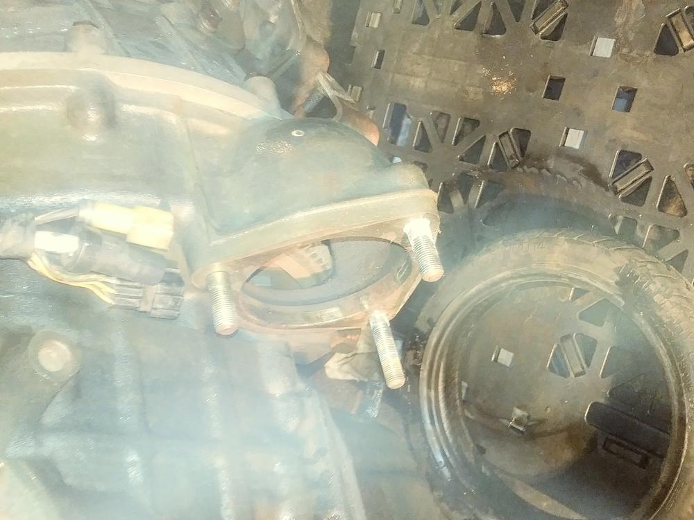

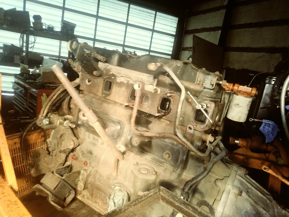

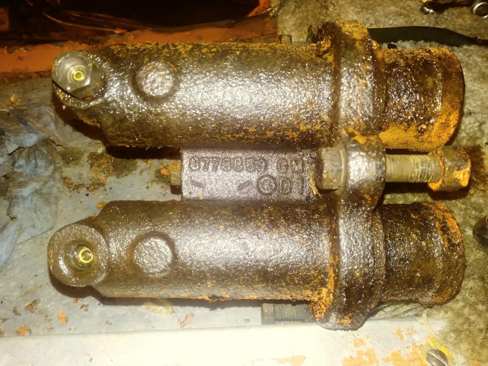

……..…. pulled alt. to get assess for multiple cooling fans,... disassembled the driveline components to fab. ''intermediate '' shaft... 2 missing manifold studs,....

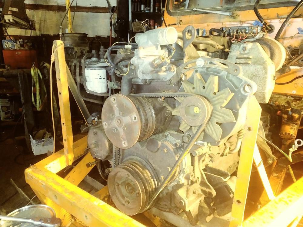

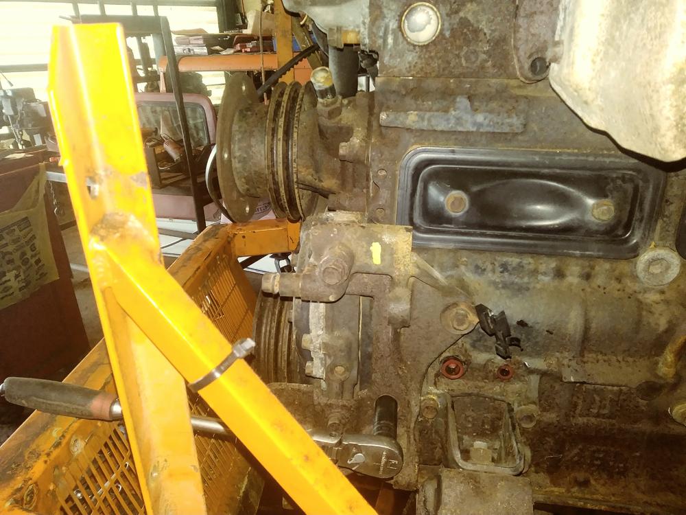

…. snuck in alittle ''modification'' time ; onto the alternator mounting brackets. had to go with the original ''ambulance'' alt., rather than the Isuzu. the Isuzu unit couldn't be ''bumped'' up any more; maxed out at 74 amps. the 150 amp alt. will handle the electrical loads. had them both inspected & ''spruced'' up on the ''amb' unit.... also started on turbo removal. this one happens to be ''coolant'' assisted cooled, which means scrutinizing the engine brgs. will be even more important....'

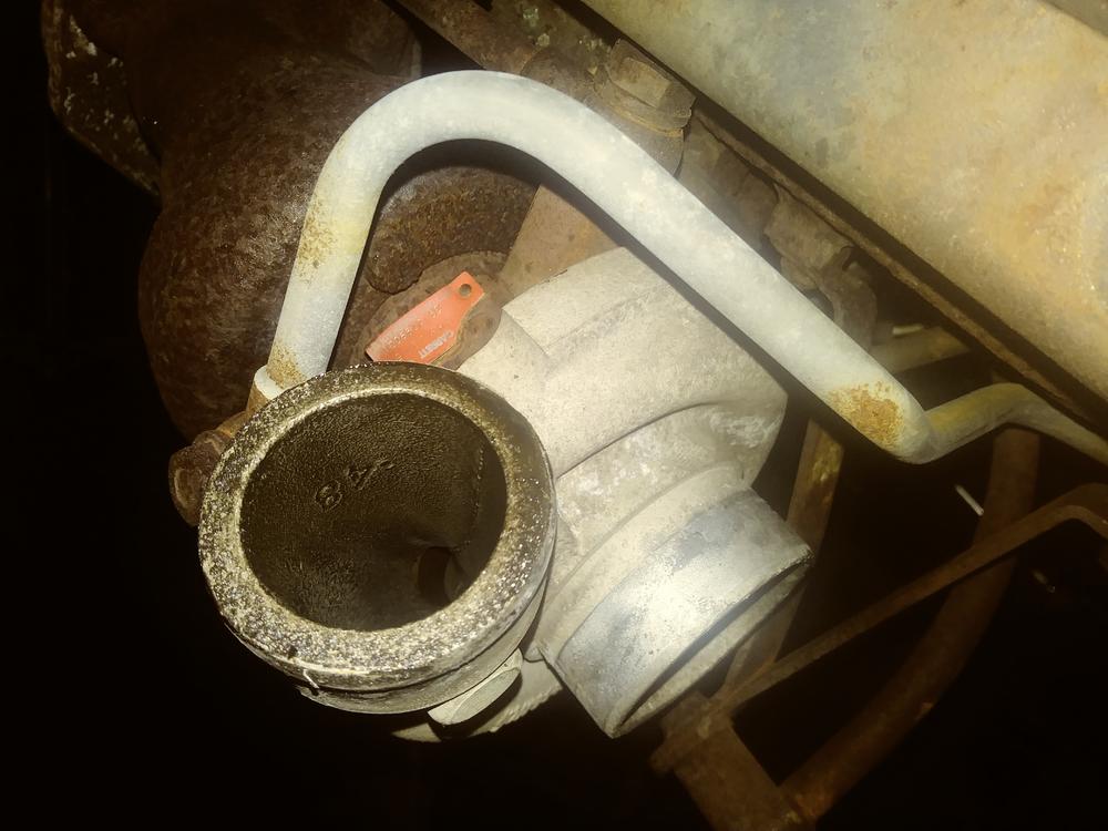

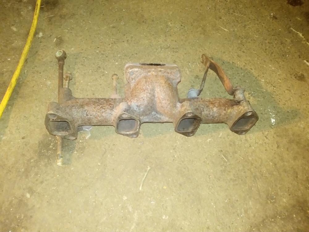

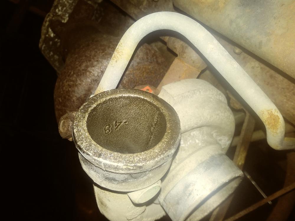

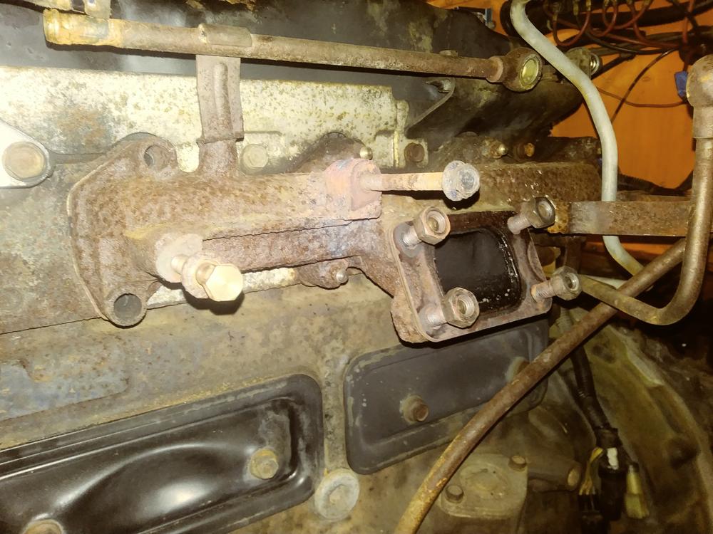

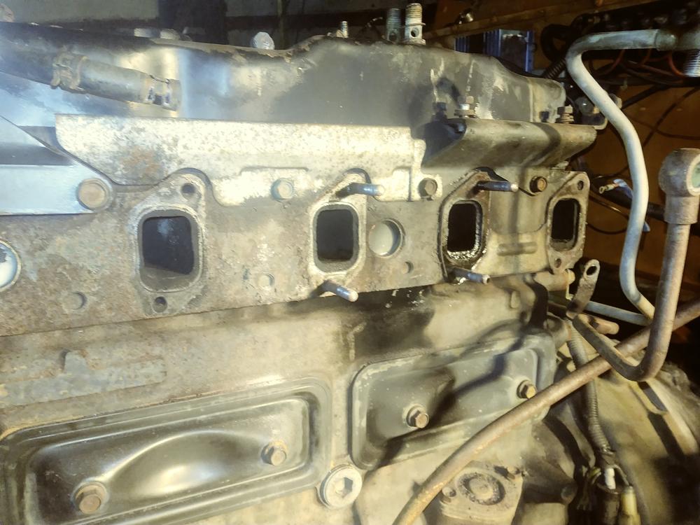

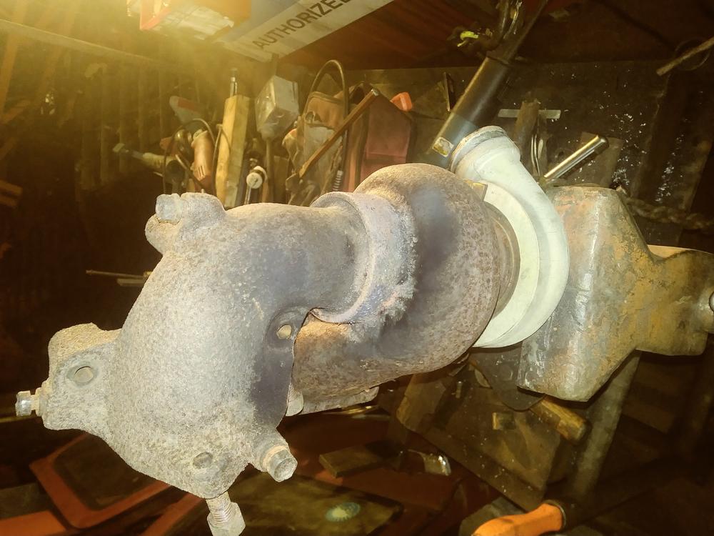

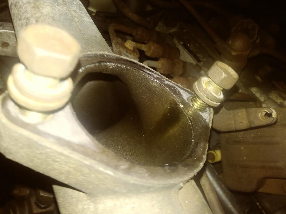

.….. finished exhaust manifold removal, drilled/tapped broken hardware for manifold, freed-up misc. brackets hardware, ''some heat required''... soaking exhaust elbow...
