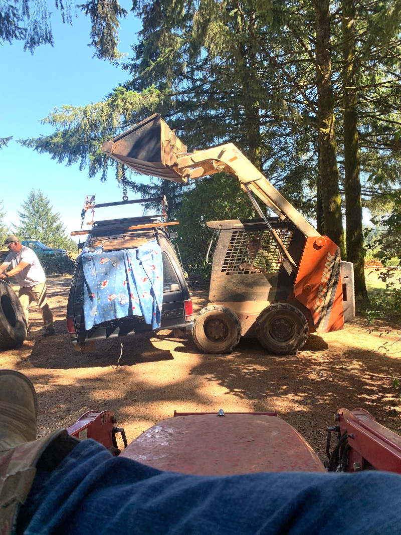

The Kids came up and grabbed the faithful little Scat Trak and loaded the Dirt bike rack on the Big Dog..

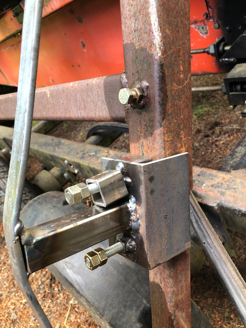

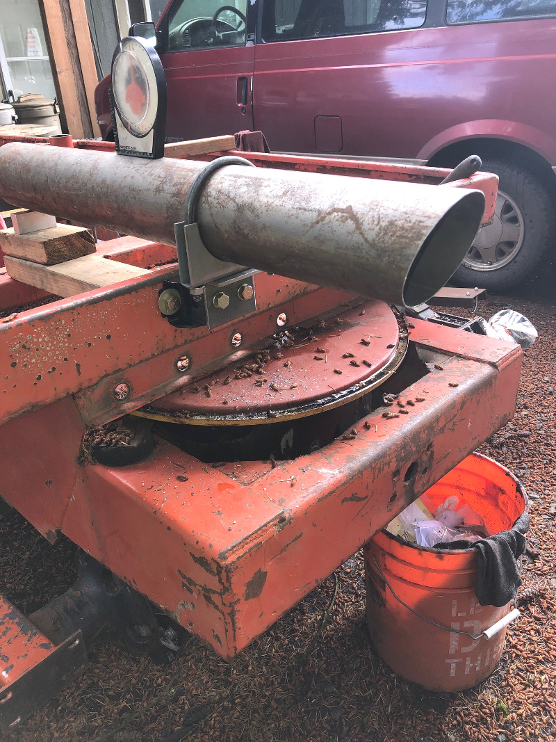

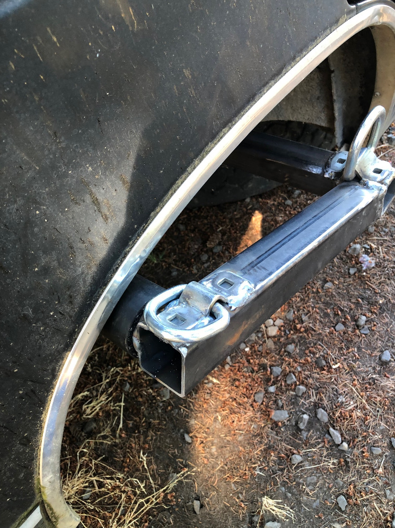

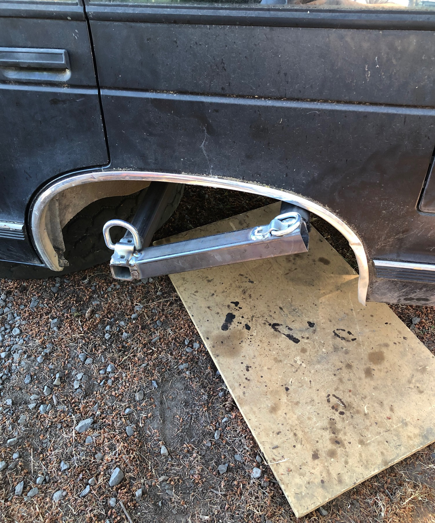

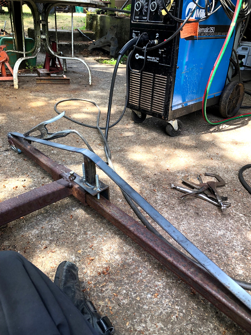

I was busy putting the finishing touches on the Body lifting rig so the Family model can be lifted into place on the cat....
The lift rig is the same unit I used to get the standard cab up into place on the cat.
Added a truss over the lengthwise tubes to handle the extra weight of the family model.
The center beam can be slid back and forth a lot to get the balance point spot on....Once in place the set screw is tightened.
The truss king pin has two threaded rods to allow the center beam to pass under the truss and then spacers are slipped under the threaded rods and the rods snugged up.....Sort of a McGyver....(Rube Goldberg) But it should work fine.....
Not real sure that the truss was totally necessary ....But I really do not want to have the lift go south just as the body is going up onto the CAT CHASSIS....That would SUCK....
The rig is really basic and not pretty....Added materials from what was in the short stock rack and a couple pieces of 3/16 x 1 inch flat bar new materials....
Just want it simple and strong....we will need it to place the body as well as remove it for some service work in the future....
If all goes well....May go for a test lift tomorrow and get a feel for things.....
I need to carry the family model out of it's current location and turn it around.....
Need to remove the single cab and get it out of the way....
Then the family model can be placed on the cat chassis. For the time being on wood blocks until the radiator location and height can be sorted out.

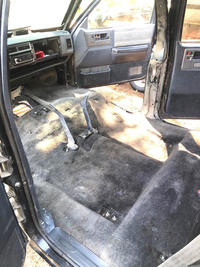

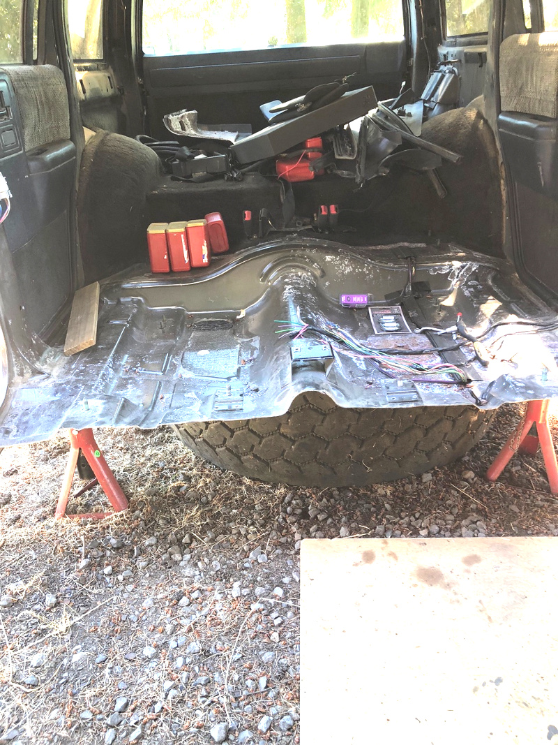

Decided to prepare the Family model to remove the seats...(WEIGHT THING FOR THE LIFT)
Grabbed the shop vac and really sucked the beast out.
Carpet is not stellar.....But I think that removing it and doing a good shampoo will give it a renewed lease on life..
No tears or any serious damage....just normal wear.....
No sense in tossing it out....After a good cleaning and letting the summer sun dry it good....It should do fine for this duty assignment....
Some nice rubber mats in each area....Good to go.....

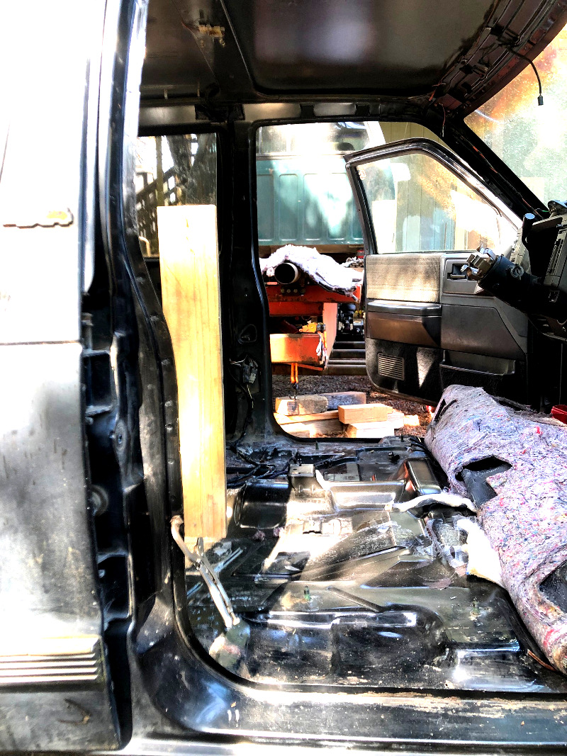

Back at it.
Ordered up new outer door rubber seals....31 years on the originals....They are shot
Got after getting the seats out and all the trim panels off so the new door seals can be installed when they get here next week.
Unlike all the newer rigs that have all the plastic interior trim SNAP into little holdown clips....These older rigs used phillips screws to mount all the trim pieces.....
The lower kick panels and sill plates especially can be a real PITA to get the screws out due to the fact that they penetrate the floor...
Some skunk piss helps a lot.....
Most of the interior trim is in great shape....A few screw holes have had the screws over tightened and the plastic areas damaged a bit.....Not a big deal....
Went after the rear full fold down seat.....This beast was like arguing with a pissed off Octopus.... :evil:
I finally wrapped it up with a ratchet strap and snugged it up.... Then got it out of rig.
Front seats were pretty easy.....Overall the seats are quite usable.....A bit of repair on the drivers seat cushion and a pair of Camo covers.....Good to go......

Tomorrow the plan is to get a small carpet/furniture shampoo machine and give the carpet a good DOUCHE.....
A good cleaning of the carpet will do wonders to stop the bad odors that always seem to creep in during the long wet winters
Got the front passenger area of the carpet blocked up so it can dry out.....Once it is dry (Not long in this heat) Will fix the hole the other folks hacked in the lower cowl for power cables to feed their boom box speakers....
Gonna leave the seats out until I can try a lift and see how that goes....
A few picks.....The piccys make the carpet look better than it actually is.......Rubber mats in the foot areas will definitely help a lot....
The giant azz hole in the floor left from the T case shifter has got to get a cover on it.
I am thinking that a piece of 1/8" aluminum sheet and a bit of massaging with a soft hammer around The O2 Bottle on the torch set should make a nice cover.
I can get under the rig easily to mark the holes in the cover.
This cover/opening may be a welcome thing to allow access to connect the shifter cable to the tranny.....?????? We shall see....

Weather is hot now.....Pad under the carpeting is WET
No wonder....Previous owners had punched a hole through the lower edge of the cowl at the floor to run a heavy power wire inside to feed their big stereo box....No grommet and lots of room to leak water from right behind the RF tire.....Another big azz gash at the inner edge of the heater box.....Clean this up and fill the holes with silicone......They do not hurt anything....
The glove box door hinges (Little pivot bosses) were in the glove box....Some idiot likely tried to pry the glove box door off.....Broke the bosses off....
JB Weld and a little massaging.....Good as new....A used door the right color was $70....No way....
This dash is the dark blue and tough to find here.....

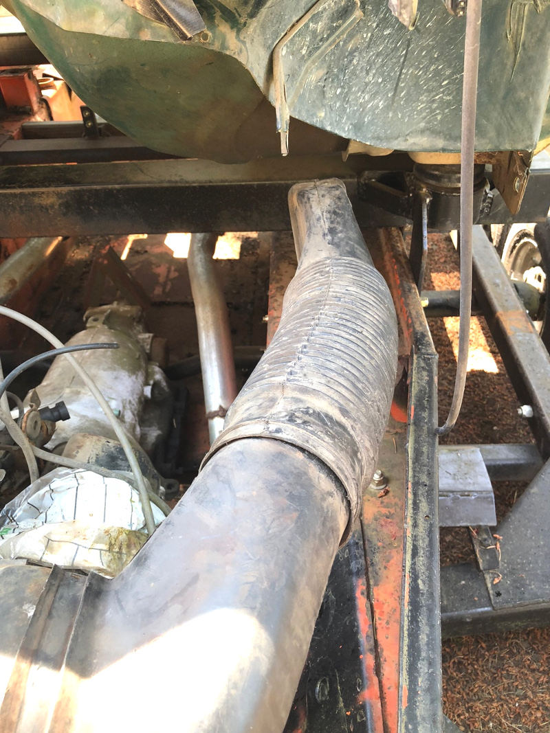

I have been looking at the Exhaust pipes....Thinking seriously about running them up the rear sides and then doing Bullhorn tips 4" or 5"....I want the noise UP and away from the chassis......

Looking at the exhaust system that I had left heading out the back of the cat......With the "Family model" things are such that a nice 90 degree pipe welded to the existing rear pipes can be run out each side and then connected to a tall 4" stack with the Bullhorn tips up top.....I want the exhaust and noise up and away from the cat.....I do not want fumes getting into the cab and really want the bark and rumble from that 400 inch engine away from the creature comforts...
Granted....I want to hear the Mouse that roars.....just not to the point that it is annoying...
The piccy shows the 4" pipe slipped over the 2-1/2" pipe.....Adapter rings pilot the 4"
These are not welded yet.....Easy job to remove these and change the routing to any overhead position....
A bracket that bolts to the outer portion of the tub rail and extends up the side of the body (An inch or two away from the body) will work sweet to mount the 4" stacks on rubber type hangers.......
The rear urethane mounts can come around to the sides and hold the outer ends of the short rear 2-1/2" pipes.
The system has the ball and socket type connections to allow ease of assembly/disassembly.
So far the switch to the FAMILY MODEL is not going to entail a lot of work...
Actually there are many benefits.....not including the passenger room.....

Waiting for the kids to get here and lend a hand for the lift.
I got the Skid steer and did a trial rig on the lifting bar
Looks good.....Just need a second body to keep the S-Wagon from swaying around and hitting the Scat AND DENTING THE BODY.....(n) While it gets moved to behind the cat for the next few days......
I will get pics during the lift and post later.......(With any luck)

Well now....
Yesterday afternoon was interesting to say the least.
Son in law and I rigged the S_Wagon up and went for a lift.....
We had to change the pick point and get the center of the lift back a bit before we could get the beast to leave the dirt...
Still a tad off center even with the rig in the air.
We did not have the extended lifting device on the Scat during this pick.....(Metal frame that give 2 feet more out in front of the Skid steer)
The lift went fairly smooth....WITH ONE CAVEAT......Damned S-Wagon is too heavy for the Scat to lift even without the extra extension........The picture shows the rear tires almost off the ground.....
During the move (We did two lifts...one to set the rig out away from the cat and then a second to re-rig to get the Scat Trak lifting from the passenger side) During both lifts the rear tires were bouncing on and off the dirt.....BAD JU JU....
In order to get the Body on the cat we need the extension and be able to lift to the maximum and get in over the frame of the cat......

I went out this morning....took a deep breath...crawled into the S-Wagon and took a good look at things......
Ah hell....Grabbed the tools and started gutting the beast....Tossing all the screws and such in small containers.....
All the inner trim is off in a pile.
Headliner is laying on the floor ready to head up to the spare bedroom for safe keeping until this debacle is sorted out.
Just before I quite for dinner THE DATA IS IN....The choice has been made....GONNA CUT THIS CRITTER IN HALF JUST AHEAD OF THE B PILLAR......
Got a couple pics.....The roof has a great stiffener across the top at the B pillar.....The pillars are stout and there is lots of places to anchor square tube and build a bulkhead......

The front door latch pins holes can be reinforced and a single bolt D ring added to be a permanent lift point....Both sides.
The rear lift points are also going to be permanent.......
Exactly where ....not sure yet....May have something to do with the rear cab mounts ?????
Needs to be a simple set up that will not interfere with mounting and or removing the cabin...and be permanent...
When I need to lift....I do not want to have to go looking for them.....
Single bolt D ring....May end up using the tube that we used on the recent lift.....No need to waste it....We will see....

Got the Cabin all marked for the rough cuts......Went at it like we were killing snakes....
Took about 30 minutes to get "Separation"
Dragged the forward section off and out of my way....I need to get the heater box off of it and get it on the Original cab.
I cut LONG on the rear section to give materials to be able to trim up exactly where it needs to be.......
The rear doors fit sweet....The rear structure is very sound.

A bit of welding on the rear lift bracket is today's little ditty.....

Lift rigging complete now....All the final tid bits to be able to SECURELY hook up the cabin to the skid steer is here....
These lift point should give us the ability to lift things evenly......

With the rear side windows being electric and also electric door locks too......Looking over the wiring diagrams last night
(Wire harness cut ahead of the body cut to give us something to work with..
Going to wire the windows and door locks such the the windows can be operated from the rear.....Door locks will be lock/unlock capable from the front cab.......Doors lock from the rear manually only (That was factory)

Grabbed the Scat Trak and hooked up the Spreader bar lift rig.
Hooked up the S-Wagon and did a quick test pick.....Needed to adjust the slider adjustment Waaaaaaaaaaaay back to the rear...
Took 3-4 fine adjustments to get it level.....Sweeeeeeeeeeeeet.
I did a low level lift and romped the scat a bit to see how well it was going to handle the load.... :thumbup:
Raised the bucket all the way to the stops and .....Definitely OK
The rig swiveled around with the tail gate facing the Scat.....Then it became clear.....We will likely not need to worry about using the extension to set the cabin on the cat.....
The rear section can go on over the back end of the cat with ease.....

Not a great deal going on...
Doing a lot of disassembly on the remaining front section of the S- wagon.
Getting the switches for the electric windows, the door locks and the attendant wiring and relays.
All this stuff will be needed to connect the windows and door locks on the rear cabin......
Grabbed a break and dragged out the carpet from the rear seat area and laid it out on the patio and soaked it up well ....added some good soap and scrubbed the hell out of it.....Flushed out a ton of nasty dirt...
Hung that bad boy out to drip dry in the sun.....All put away now...Actually looks pretty good......
Back to the Remains of the front half....Yarded out the tilt column (That should sell quick)
Figured I might as well strip all the goodies off the old carcass before it goes to the bone heap...
Also got all the wiring, relay and switches to run the electric mirrors.....
These items will be a real plus with a set of big AZZ tow type mirrors ..
The stock mirrors on the front cab are a joke......
I want to be able to see the tracks all the way back and a good deal to the sides....
Still need to remove the front inner seat brackets from the floor (Spot welded in) The two inner rear ones came out easy.....
These will make getting the bucket seats in the front cab a breeze....
So.....The rear cabin area will get the original carpet back in place and some rubber mats over it to help manage slush and stuff.
The front cab is going to get a full rubber mat....The carpet is trashed anyway.....

Then there is the Veranda across the back of the cat to allow access to the tail gate/hatch area.
