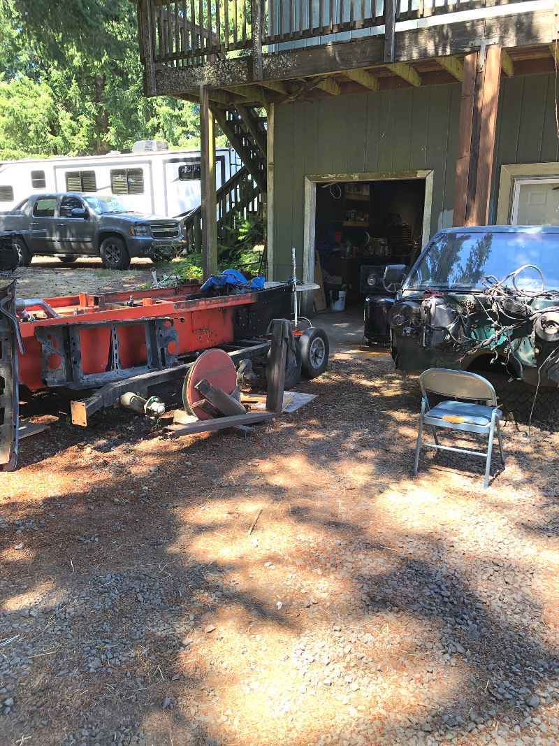

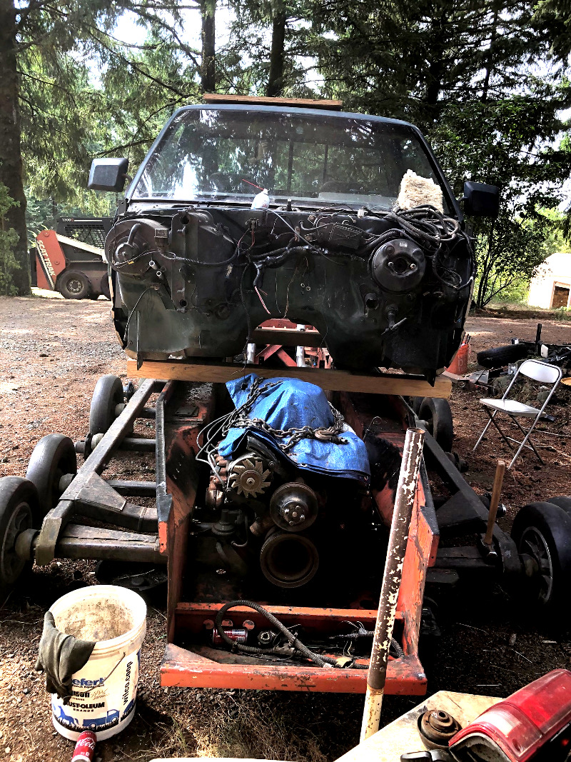

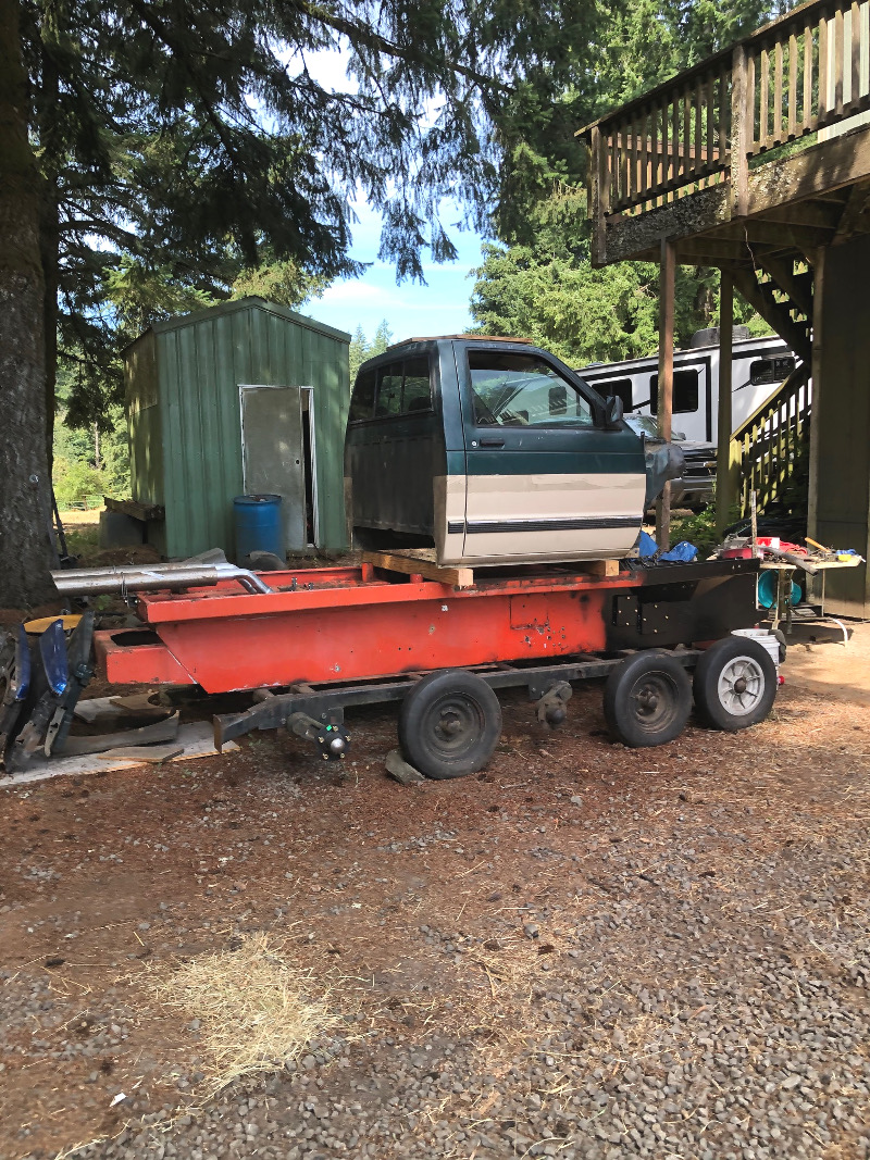

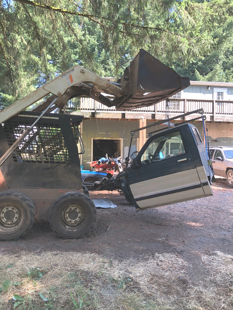

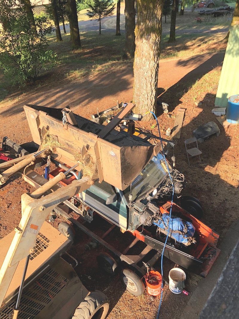

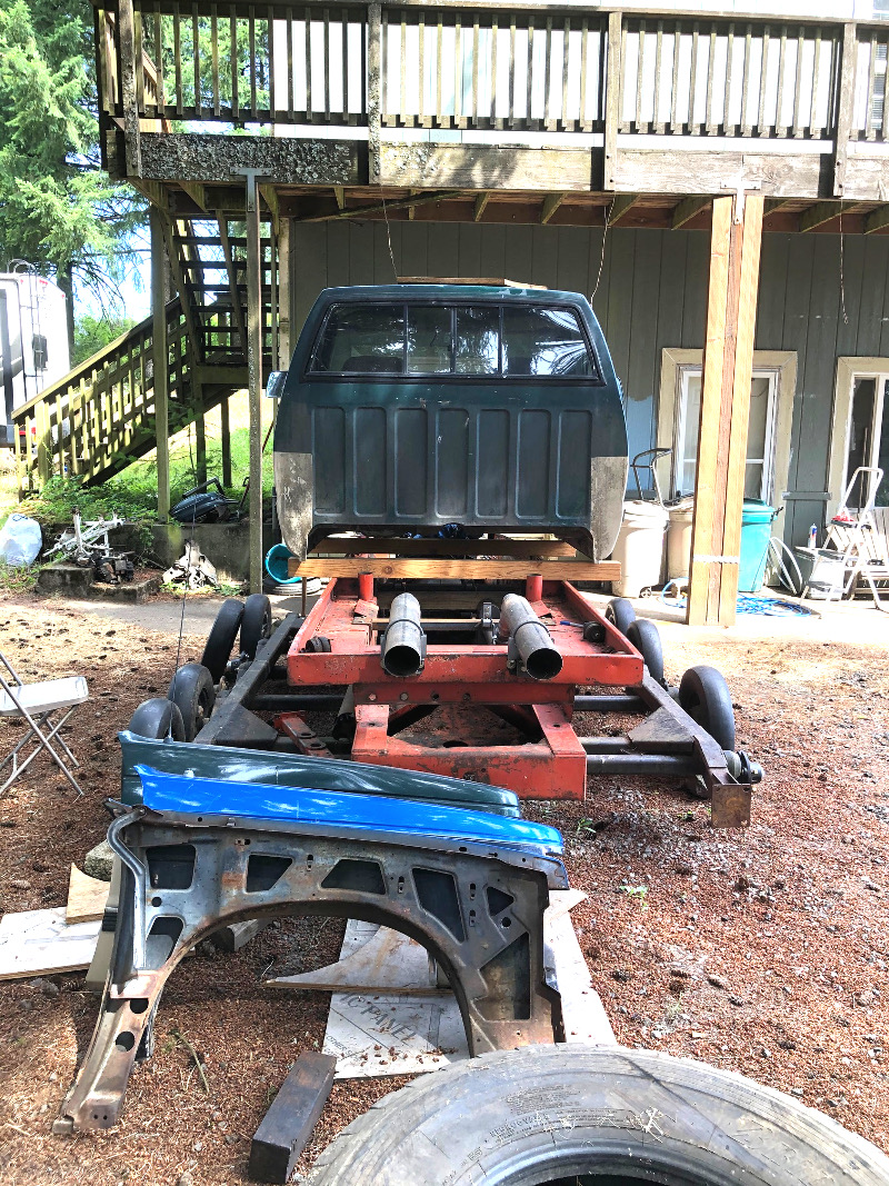

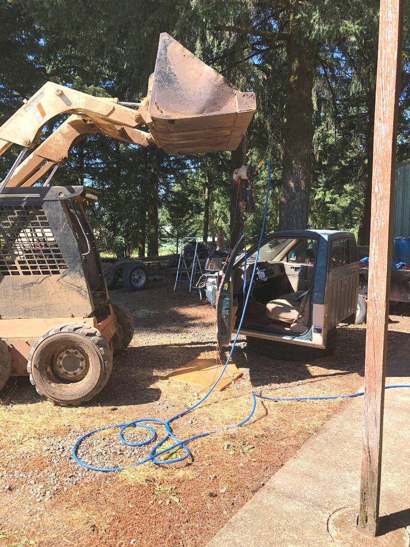

Finished welding up the rear grab hooks to lift the cab off the WLT
Things went very very well.

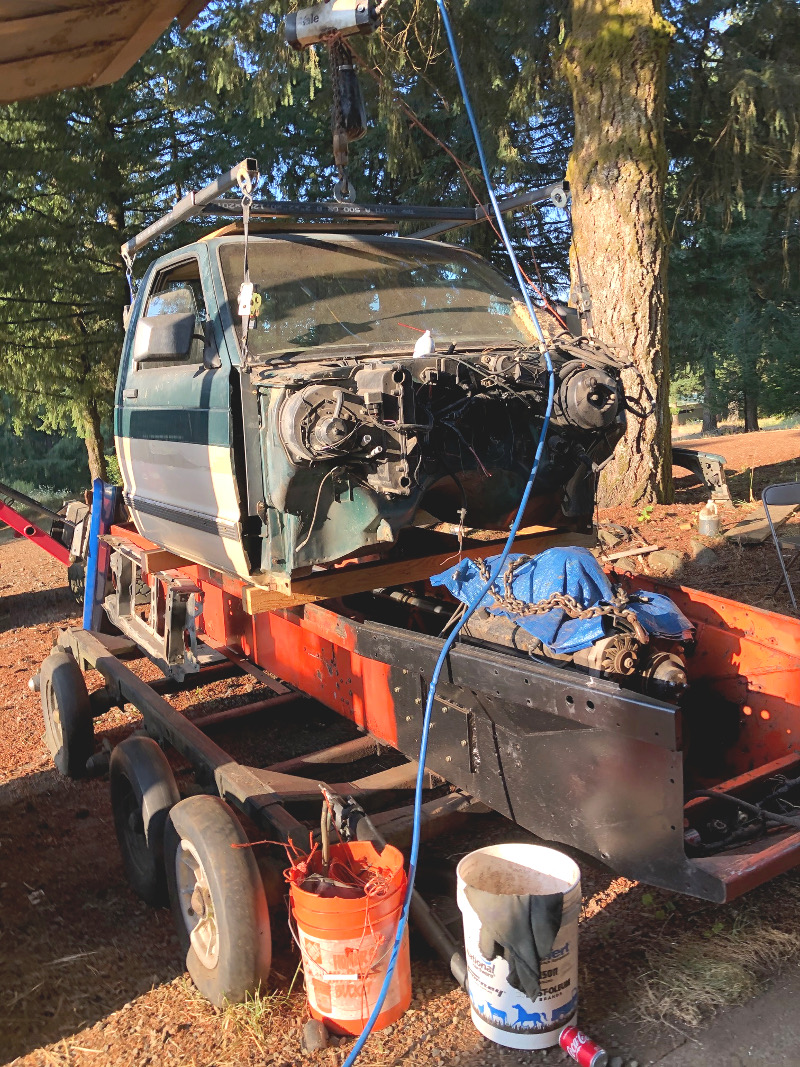

Got the lift frame positioned on the ground and sat the skid steer bucket over the top of the frame.
Rigged up a chain to the D RING on the bucket and raised the lift and placed the frame over the cab.
Hung the ratchet straps on the 4 lift points and tightened things up.
Went for a little pressure on the lift and the back came up about a foot before the front came off the frame.....GOOD ENOUGH FOR THIS LIFT....
Had one hidden ground strap that had to be dealt with.....OFF IT CAME.

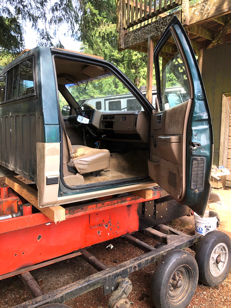

Scared up a big tire to sit the cab on.....plop....good to go.

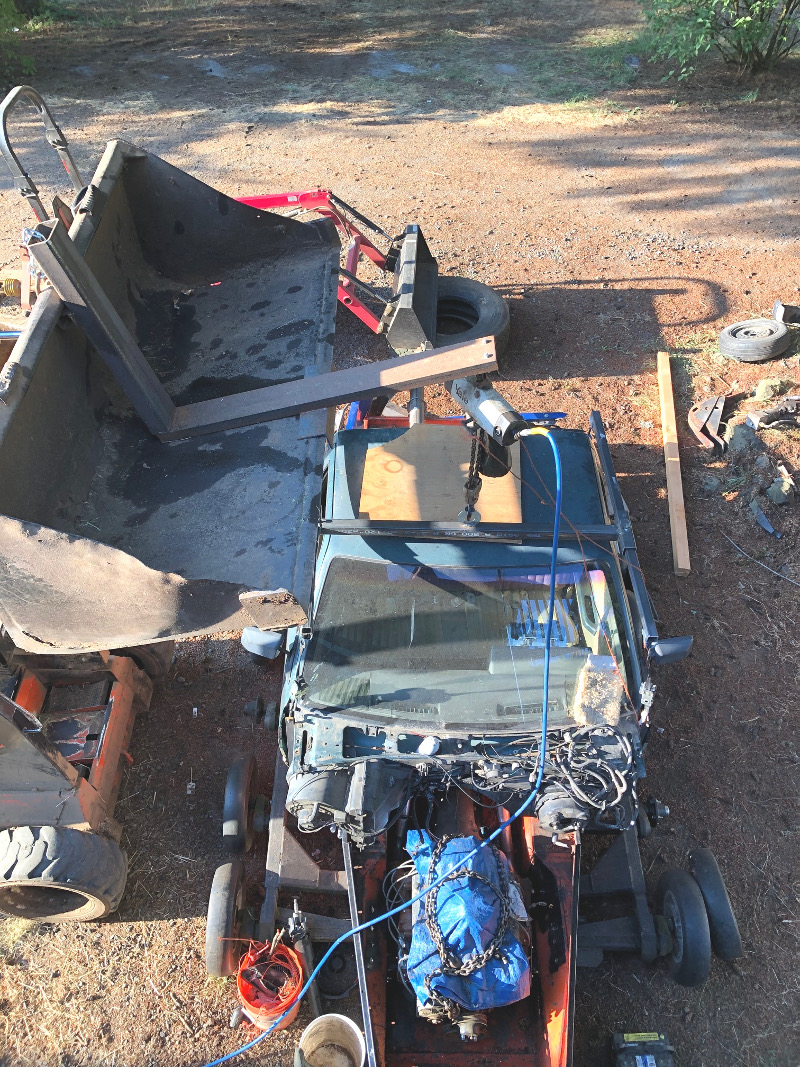

I can wrangle all the systems out with the cab on the TIRE and then be able to get at everything to fix anything that needs it.
I saved all wires to the rear for LIGHTS. FUEL GAUGE YADA YADA YADA.

This cab looks like it will be a nice fit on the 2100 frame.
Cab sitting all snug on that big tire for now.

Next thing is to get the WLT corpse on it's way to it's new home....
Sounds like near the end of the week it will go away

Sitting here sucking down coffee this morning and wrangling on a plan to test out the entire CAB WIRING.
Now is a great time to work through all the wiring in the cab/engine bay and make sure EVERYTHING WORKS
Since finding the shorted wires at the starter and the purple solenoid wire broken off/cut waaaaaaaaaaay up in the harness and other cobbled up stuff......
A great time to mock up all the wiring harnesses and connect grounds, hot leads etc.... to a battery and then wring it all out.

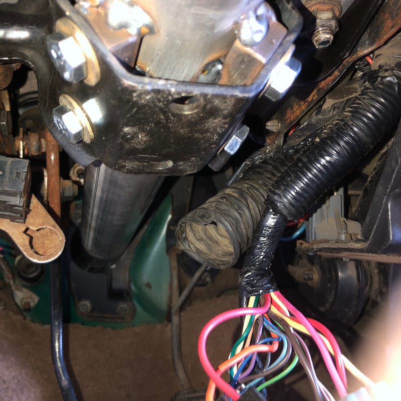

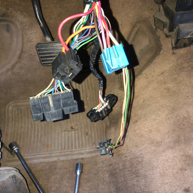

TODAY STARTED OUT GOOD....THEN WENT DOWN HILL.

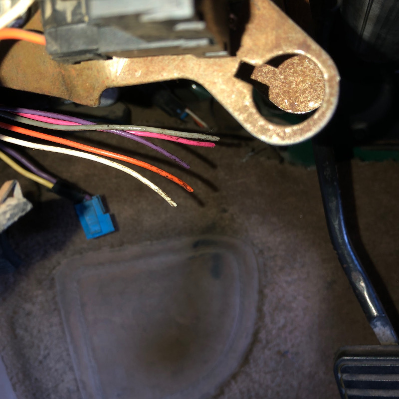

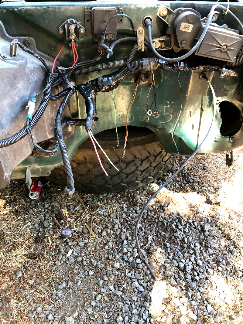

Decided to clean up the wiring on the front of the cab and get everything sorted out that will be needed to run the 305 once the cab is mounted.
Picture shows everything
Far right side of pic FROM Right to left
Throttle cable....looks long enough to gitterdone...and has the proper fitting on the end.
Green wire.....Engine temp gauge wire
Batch of ground wires
Oil pressure sender (Plug cut off)
Green/blue Backup lamp (Had switch on 5 spped trans)
Purple and Red (Barely visible) Starter solenoid and power feed from starter main lug.
Pink/white Coil HOT lead and white for tach if used
Purple plug hanging low.....with orange wire....Alternator leads.
Got this stuff all sorted out and then decided to clean out the rodent nest in the heater fan......
Then came the mess of pine needles in the AC evaporator box.
Tore that apart.
Took the core out...do not need it.
Discovered that the heater core was leaking....ARRRRRRRRRRRRRRRRRGH
Ended up pulling the dash off...the previous crew had been in there too...
MORE ARRRRRRRGH....
Heat box cover has two broken screw lugs on the cover at the top...need to scare up a cover and a core.

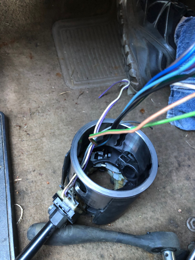

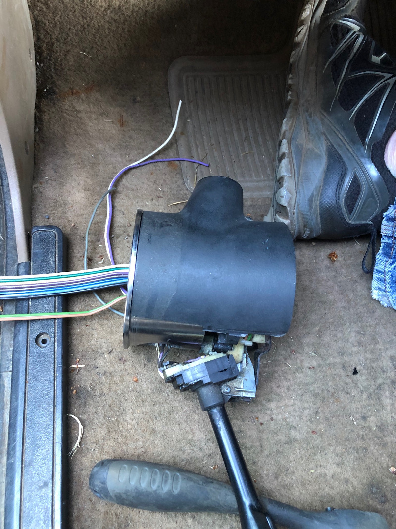

Column out on the ground too.
Gotta scare up a good column.
Bone yard u pull it tomorrow.
What a mess.
Better to fix this stuff now than later on when things will be far tougher to get to....
A bag of worms....
If good fortune favors the foolish....maybe snag a column and a heater box cover...tomorrow.....

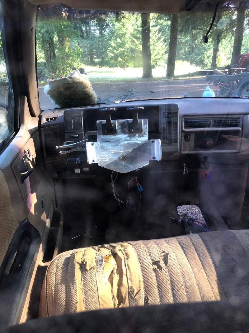

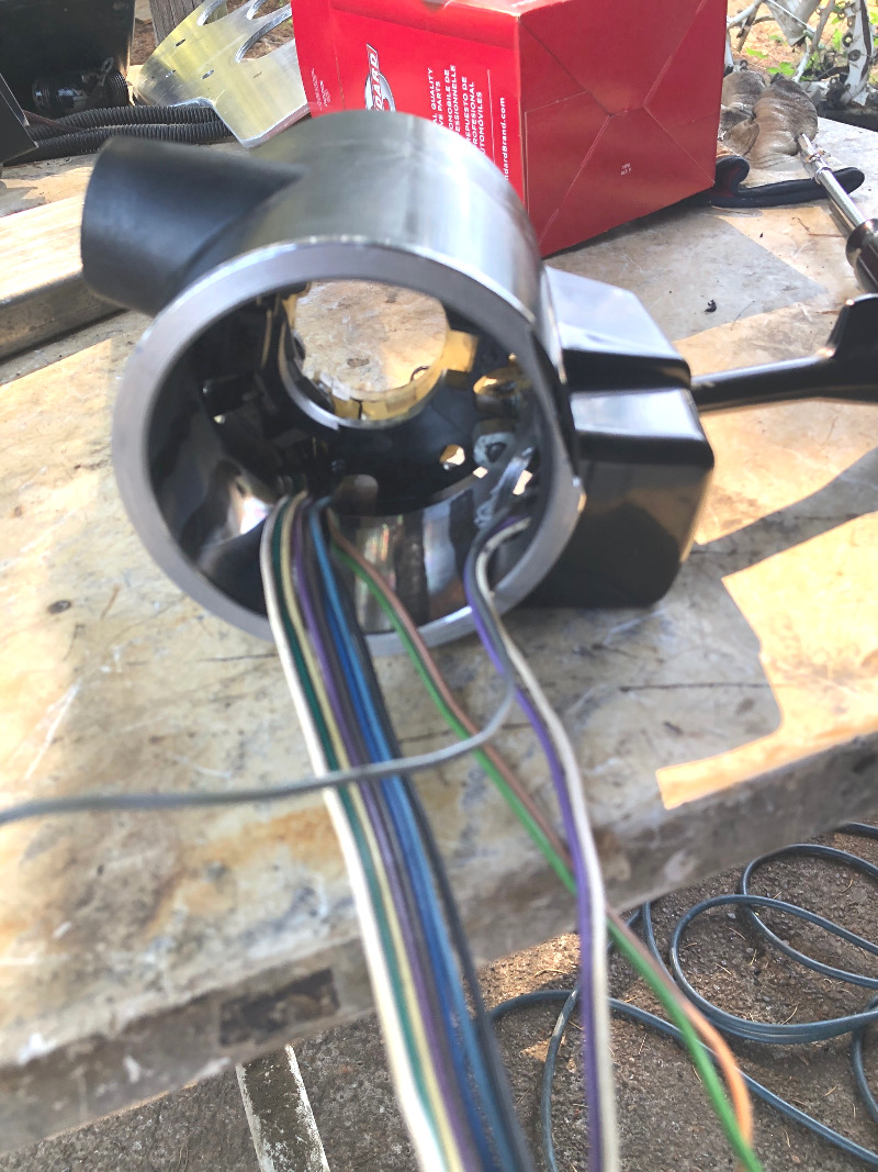

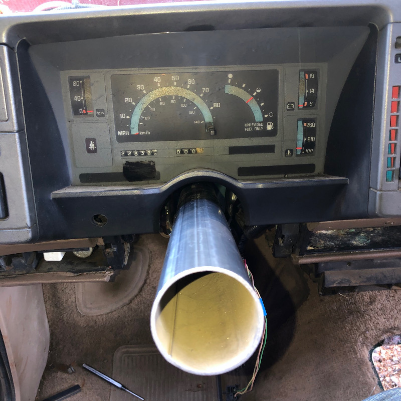

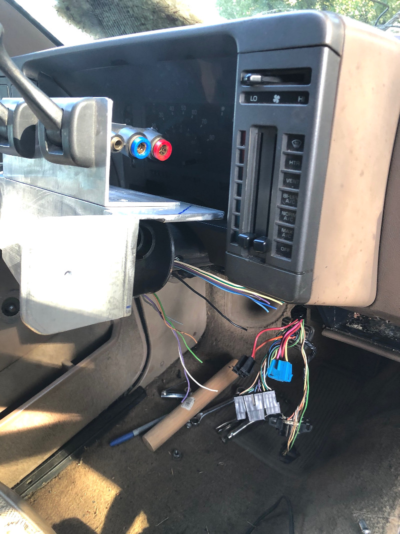

Butttttttttttttttttttttt.....Took the old column apart and looked the entire thing over well.
The Windshield wiper switch seems to be the big hangup....but there are other glitch's too....
Decided that this mess is a bridge too far.

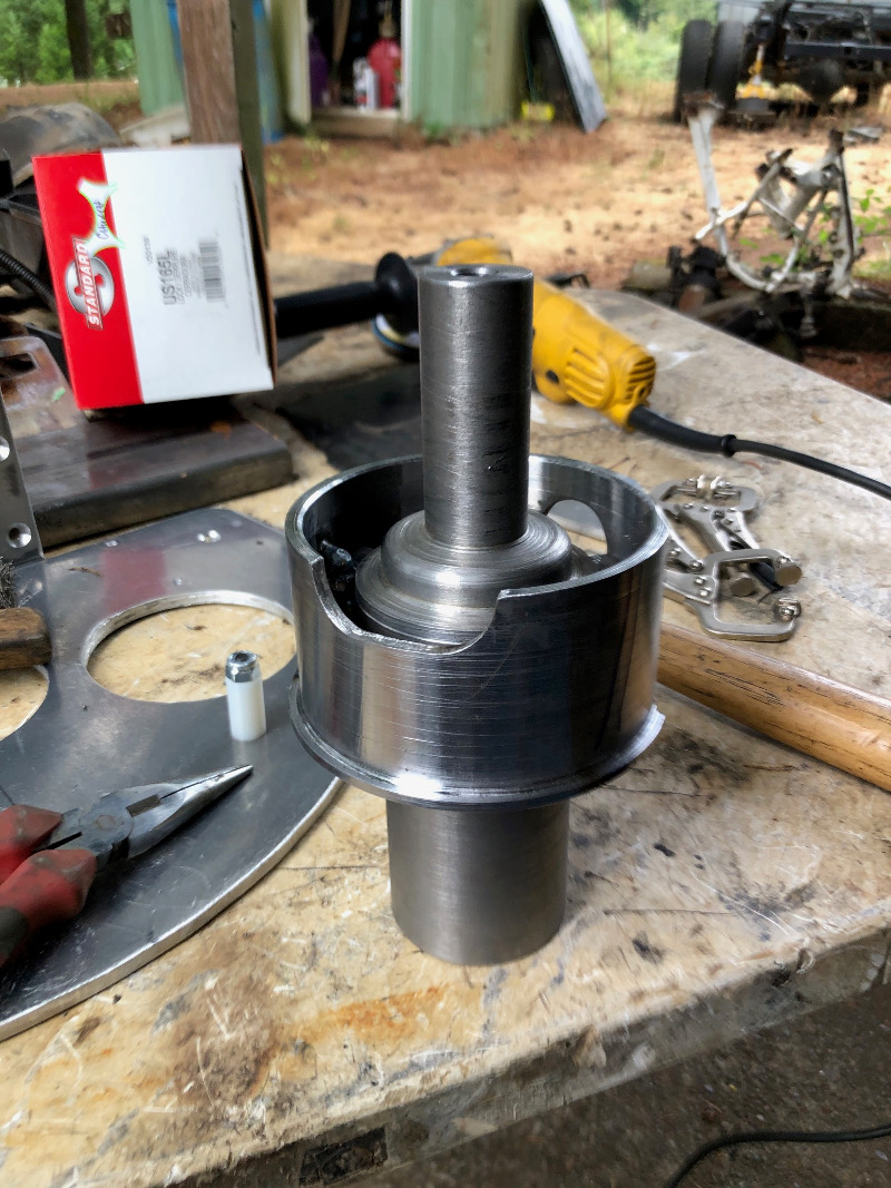

Cut the base of the old column off and tossed the rest in the scrap.

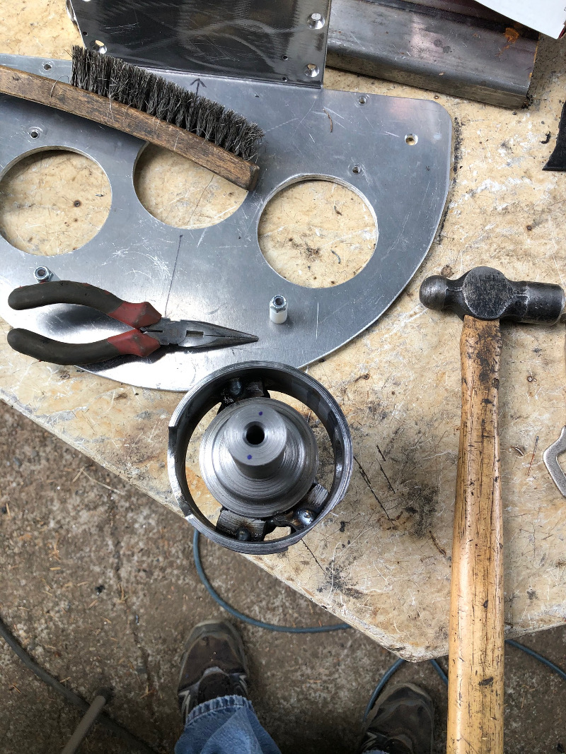

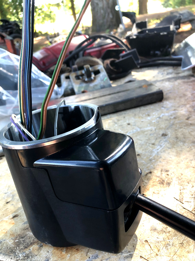

Plan is as follows.
Add a hollow tube to the old base and then fabricate a flange for the top (Where the wheel would be)
Add needed area to mount a heavy duty truck type ignition switch.
Add short round pedestal to mount a big truck universal turn signal switch unit (Has lever and 4 way flasher lock)
Add a small appendage to mount the needed wiper switch stalk.....

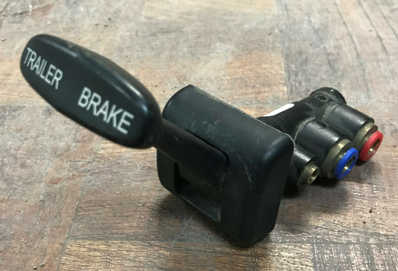

The hollow pseudo column will allow the air lines to feed up through from the front to the control valves and then back out....Will keep clutter to a minimum

Sorting through the schematic on the cab and the connectors DO NOT match whats in the real world (IN THE CAB)
The WLT is a late 92 production titled as a 93 and the switches are different.
The wiper switch had bare spots and other damage to the wires up close to the switch.....needs a fresh one before I install it.
Got to looking at the plug that goes into the dash harness and it is totally different than the 93 switch.
Some snooping and then discovered the issue.
Tilt wheel/With pulse wiper/ Without cruise control.

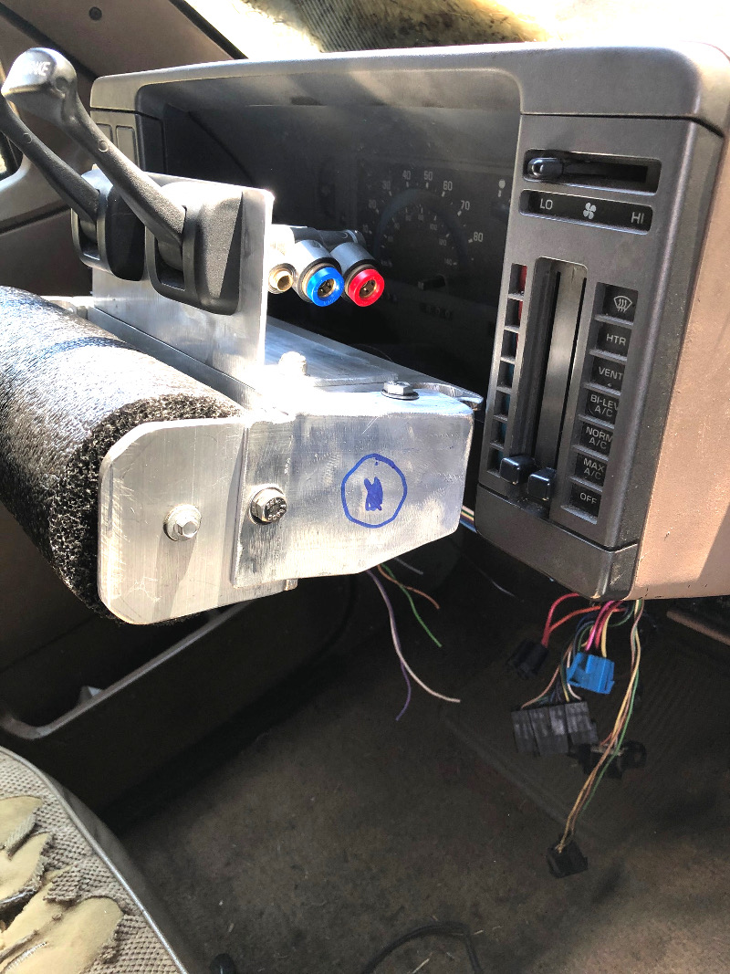

Anyway....I am not popping for several hundred $$$$ for a wretched column that may or may not be worth a !@#T.......
Custom stalk with the air valve levers and custom signal and wiper switch.
I have seen mid run and transition model rigs that can drive ya nuts with stuff that is not in any parts book...at least and fit......
Sucking up coffee and looking at the original steering wheel mounted arrangement I had for use in the van....
Cannibalize that setup and use the valves/bracket and the hand rest bar.
Be easy to fashion a plate to go onto the new "Column....control stalk" and mount the steering controls.....signal switch, wiper switch, ignition switch... all right handy....

Wiring to connect all the existing wires to the engine will need to follow after the cab is mounted....
Need to use all the S10 sending units....
GAWD I HOPE THOSE ARE NOT BASTARDS TOO....:bolt:

Got busy this morning and wrangled the dash back into place in the cab.
Seeing these done in video's of the factory building the rigs makes it look easy.....
Well, a hydraulic jack and a chunk of 2 X 4 (WOOD) really goes a long way to helping get that bad boy positioned and hold it so the bolts/screws can be installed.

Hope to be able to rig up and do a trial fit on the cat here soon.
Some 4x4 wood posts across the cat tub will work OK for a mock up.....
I am excited about seeing the cab on the cat.

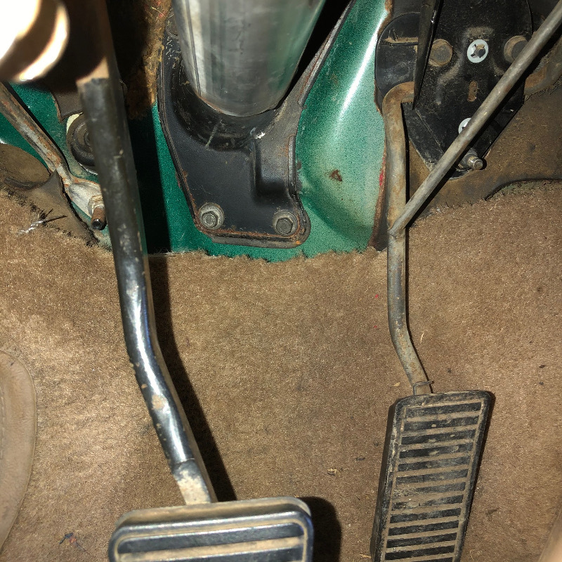

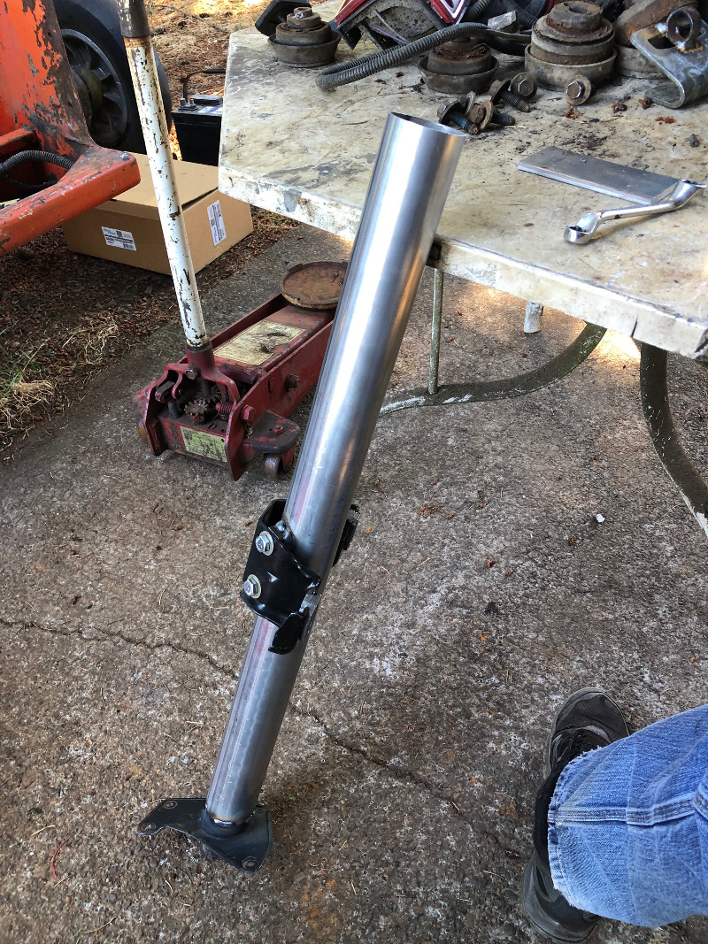

Today the new Pseudo column came into being.
With the lower 6" of the original column cut off and a piece of 2-1/4" heavy wall exhaust tube pressed onto the original stub....things started to grow.
Drilled and tapped 2 pieces of 3/4" x 1/2" bar stock and bolted them to the column cradle....
Tack welded things up and did a trial fit....SWEEEEEEEEEEEEET
Actually fit back in easier than the original column did.....:thumbup:
Yanked it out and welded things up good.
The tube is quite a bit too long at present.
Going to scare up a piece of 4" aluminum round stock tomorrow and start whittling on it.
I need the aluminum bar to fit inside the column tube and then back to about 3-3/4" so the turn signal switch housing (Multi switch) will slip over the aluminum.
The bar will protrude through the switch housing enough to allow a cover plate to go over the signal switch.
Then the mount for the steering valves and the rest of the operator station will bolt to the end of the aluminum stub.
Should end up with a very compact operator station that will be easy to service if need be.

The new column in flux....
All bolted in....

Ignition wiring, Wiper wiring cut off due to the other crew trashing the plug.
Going to rewire the ignition to use a panel mount rotary switch and so the big plugs go bye bye....
The dimmer switch will get swapped to a big toggle switch or ????/

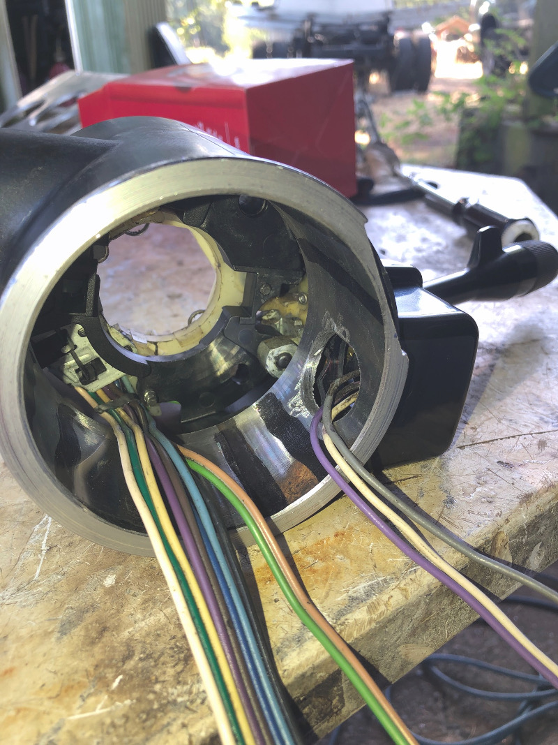

Yarded the column back out and trimmed it to the needed length.
Look closely at the one pic looking in the top end of the column and you can see the milled hole on the right hand side just above the column saddle.
This is to allow the air tubing to come up the column and out and feed the air valves that mount on top of the operator station.....

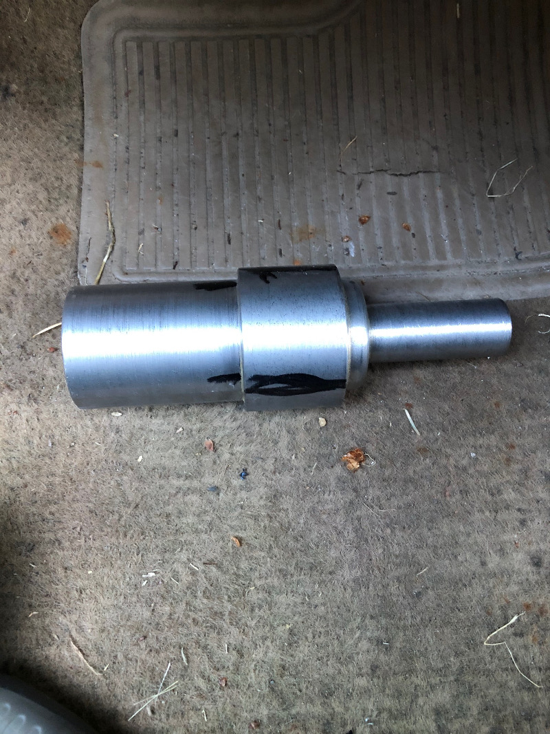

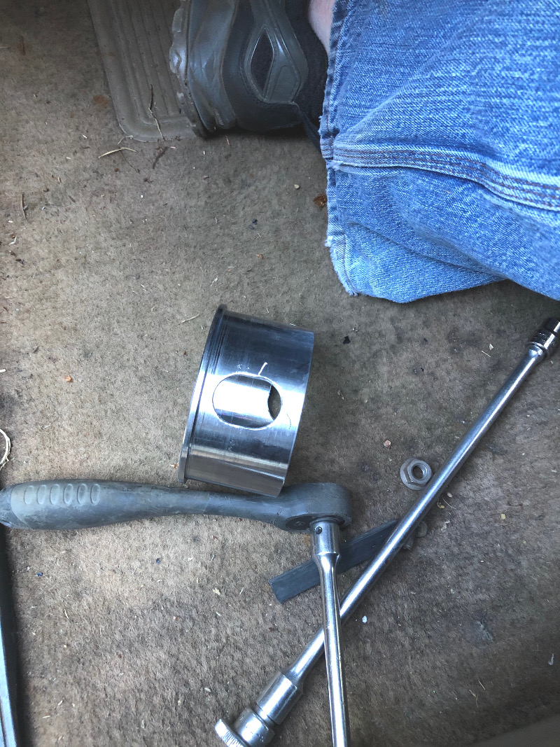

Turned up a "Spud shaft" to weld into the top of the column and allow the Signal switch and multi function switch to mount.
The sleeve collar that will end up being welded to the spud shaft.....need to weld 3 pieces of bar stock to the spud shaft and then get that unit back in the lathe and machine the unit to allow the sleeve collar to be welded on.
The slots past the bar stock will allow wiring to pass down through the area and connect to the dash harness......
The one piccy shows the upper column switch housing hanging on the spud shaft.
When complete the spud shaft will stick past the Signal switch housing by 1/16" or so.

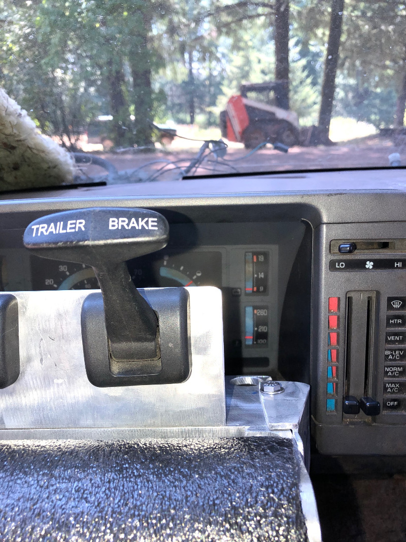

The angle operator station will fasten to the spud with one 3/8" grade 8 bolt on center and one 1/4" bolt near the top edge of the spud to keep the assembly from rotating...
The completed operator area will have the two air steering valves, the signal switch and the multi function switch, the dimmer switch and a rotary ignition switch to the right side....
Quite a bag of goodies to cram into the area.
After mocking things up it still allows good visual of the Fuel gauge, Oil pressure gauge, Volt meter and engine temp gauge...
Speedo was/is a waste of time....A tach mounted above the head lamp switch on the far left of the dash will be far more useful .....
One might ask about WHY SUCH A CONVOLUTED LASH UP to get the switch housing mounted...
I wanted a chunk of 4" aluminum bar to whittle down.
Nobody in the area had a short chunk of 4" alloy.....and they would not cut a bar.....
So I designed the thing again and made it a fabricated part....
Machined the spud shaft, the sleeve collar and then weld them together....
Cost was far and away cheaper to do it with a machined fabrication......
A bit heavier.....but such is life.

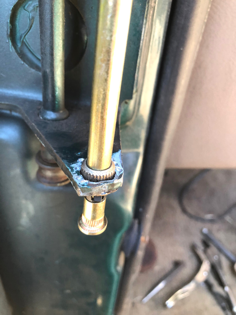

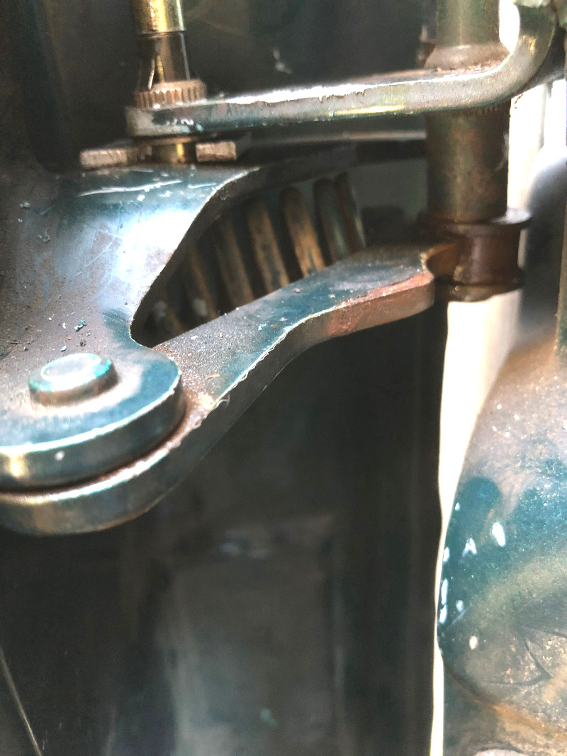

This morning while sitting in the cab...the light was right to see that the the driver door hinge is shot.
Going to need to remove the door and weld up the outer part of the hinge pin holes on the top hinge and the massage them a bit and install new pins and bushings....
These bad boys are in bad shape....
Having the door fall off would suck....
Now is a great time to gitterdone.....
Very easy to grab the door by the widow casing and lift it off.....
The hinges on these older S10 are welded to the door and thew body....not serviceable as a part.....
Pins and bushings, but when they wear this far....:shitHitFan: Arrrrrrrrrrrrrrrrrrrgh

I waited on finishing the column housing adapter until the new one got here today...Glad I did.....
The new one was made on the left side of the pond.....and the internal dimension was a tad different.
Had to stick the sleeve back in the lathe and take about .030" off the OD
Also had to make a mill cut where the bottom cap around the signal switch lever slides in...
Tad bit of mods to the inside of the lower cover to allow the sleeve to fit.
All good to go
Tomorrow the Spud shaft gets mated to the sleeve and things will come together........
A few pics.
Really nice having all the parts fitting up together to make a complete package......
With a bit of luck we may see some major progress tomorrow to the operator station...

A great day today
The operators station is definitely coming together.
Finished the machining on the spud shaft and bored the bottom portion out to lighten the part (Portion that plugs into the column)
Decided to make the spud shaft a bolt in item.....
Getting the metal head assembly all cozy with the switch head assembly is not hard....but does take a bit of finesse to snake the wires down into the metal part....and having the ability to get it in your lap to fool with it seemed like a plan.
The aluminum valve mounting plate fastens to the end of the spud shaft with a bolt.....
The steering valve assembly bolts to the top of the valve plate.
There is a nice spot just slightly out from the original Key location to mount the new ignition switch.
Be close to the heater controls....sort of on and angle in the corner.......
I took the hand rest assembly and shortened it about 1-1/4" and it fastens to the valve mounting plate.
The soft foam noodle and dowel will be back between the brackets.
The S10 dash is a tad more compact than the original setup that I had for the Van.
Getting to use all the parts....Well.... most of them :hammer::hammer:
A bit of trimming has to be done on the right side of the valve plate where it slips into the dash gauge recessed area.
The nylon air line will sneak up out of the column and curve around and into the valve ports... (Push in type/quick release)
The Orange hammer is sitting on a perfect spot to mount a tach....Right above the head light switch assembly.....Easy to remove the switch panel and access nuts/screws to hold the tach base to the dash....
Tomorrow the hand rest center dowel gets cut and then reinstalled with the black foam pad....
These little projects definitely take time.
Still waiting for a couple bearings....Coming out of Macedonia....(Super deal off ebay....hurry up and wait.....Two 6014 ball bearings)
Once these are here the dop boxes and gears can go back into the OC12
What a job these Franken rigs can be.....

Pretty well wrapped up the operator station .
Will need to install the new switches into the column head and do the final fit on the new ignition switch. (The original switches were used as mock up's)
Got the ignition switch mounting plate done today and installed the foam pad.....
Pretty happy with the layout and overall feel of this set up....
Getting the air tubing into the valves will not be at all bad either....
The one caveat was getting the head lamp dimmer switch to operate as it did in the original layout.
The original rod was missing....so not going to sweat it.
Likely add a single pole double throw toggle switch just to the left of the LH steering valve.....
Don't figure I will need to worry about much traffic..... :th_lmao:
Gotta get the ignition switch and install it.....
Some pix

Got the Skid steer over by the cab and rigged to hang the air hoist on...
A little lift on the door and tap out the old hinge pins and then see what we have to work with.
From what I can see it is going to involve some serious fooling to get this fixed.
I hope it is only the top hinge.
The bushings are gone and the hole is totally elongated to the point of NOTHING LEFT.
Likely make a new piece to replace the old end where the hole is and use the remaining side of the hole to locate the hole in the new part.
Machine a slab off the new piece to allow it to blend with where the old part was.
Bolt the pieces together before drilling the new hole.
Once things are fit and aligned....cut off the old chunk and lay ion the new pieces.....weld in place.
Sounds good....WE SHALL SEE....
Good news.
After getting the driver door off the cab (Little skid steer holding the load)
The hinge bushing holes were not as bad looking as I originally thought.
Worn ????? YES...But not nearly as bad as I thought they were.....
Peened the holes after getting the new bushings in.....
Not spiffy new looking....but quite usable..
The pins were the ones the cab came new with back in 93.
The lower bushing in the upper hinge was a tad sketchy.....there was concern that the bushing could slip down as there is no "thrust" on the bushing head.
I decided to make an aluminum "C" SPACER.....and pinch it closed to keep the bushing from dropping......
Door closes nicely...WITHOUT having to swing it from Montana to get it latched.
A gentle shove and "CLICK" all good.
With the door repaired I am looking at a trial fit onto the cat chassis....Maybe tomorrow.....

Had certainly hoped for the Astro van....but the S10 cab is going to make the build and subsequent servicing much much easier.....

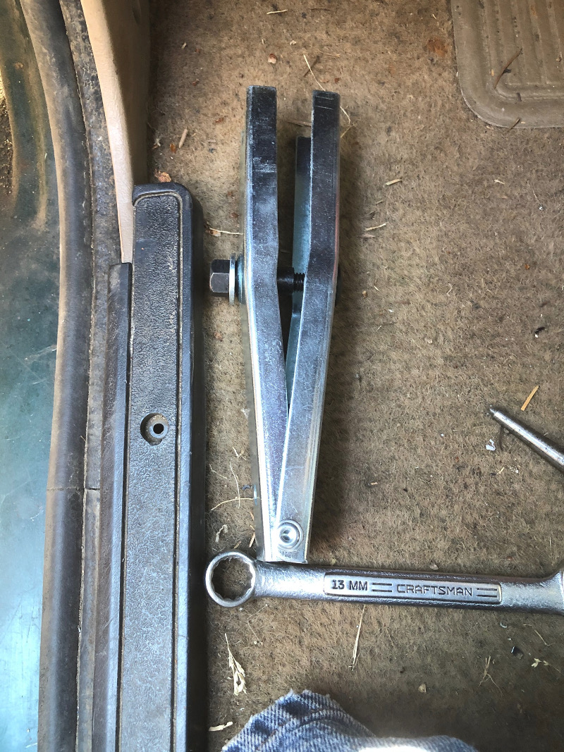

Ahhhhhh....the little silver tool......SPRING COMPRESSOR
Worth every penny of the $20 it cost.
The door detent spring is a beotch to deal with....this tool makes it a snap.
GM used this spring in many vehicles.
Some folks use 3 zip ties and a C clamp ...../clamp the spring and then zip tie it....insert and cut the ties...
The tool is much easier........

Oil pressure sender, Temp gauge sender and the original master cylinder....
The gauge senders mostly to be able to make sure the new ones I get are correct.....and the originals will likely be fine to do my initial testing of the wiring and all the systems before mounting things permanently.
The master cylinder will give up it's bolt flange to allow adaptation of the air treadle valve that operates off the original brake pedal.. (I want the original brake pedal to operate as a safety in case an inexperienced operator is at the controls and wants to STOP NOW and panics)
The master cylinder flange will slip right up onto the vacuum booster as it always did.....but simply make adaptation of a E3 valve easy.....
Grabbed the S10 frame and hauled it out to the back lot and parked it pending the arrival of it's new owner......

Out at the Buttcrack of dawn this morning....very very warm last night.
Got the skid steer into position, lashed on the lift extension and hung the air hoist.
Hooked on the lifting rig and got things all set up.
Made a few preliminary picks to get the cab level (Adjusted the slider beam to get it just right)
Picked the cab up and with the Skid steer boom all the way up I had to curl the bucket some in order to get enough overall lift.
There is still a little bit of elevation left for a pinch....but not much.
Cut some 4x4 posts 5 feet long and tossed them across the tub to set the cab on.
Fiddled about to get the cab set on center.......
The Fore/aft setting appears good.
Plenty of room aft of the cab to fit the factory 2100 fuel tank back into the stock location......
3'-5" to the bottom of the doors from the ground... Tall drink of water for sure.
Gonna need some good steps to mount this beast.....Even when stepping up off the top of the tracks...:thumbup:
I am just amazed at how much room around the engine there is.....
The elevation on the cab is great, and the cab is located nearly identical to the 2100 stock cab Fore/aft.....
Took about an hour after rigging to get the cab situated by myself.
Lowered it onto the 4x4
Decided after spending another hour or so fooling with adjusting the location that I am going to fabricate the cab mount beams on location before removing the cab again.
Going to use 3-1/2" x 1/8" box tubing and add the platforms for the mounting biscuits.
A flange on the outside of the tub rail and an angle on the inside with bolts to fasten the beams to the tub rail.
Be easy to locate once there are drilled holes......
I need to get the tubing and a set of urethane body mounts.
So far the jury is out on the throttle cable.....probably about a foot longer than stock.
The shifter for the tranny is also still a big ????????? A cable shifter.....possibly the Lokar tranny mounted unit.....
Plenty of room to service the engine and do other things needed for the build.
Been a great step forward today.....

Spent the morning cleaning up the cab mounting hardware.
The upper/lower steel cups and the bolts.
The front cups were a tad groady.....a fair amount of rust and such were the dirt had collected around the rubber biscuits.
Parts are not cherry, but quite serviceable.

Back to more way too mundane things....
Engineering the front cowl cover box (Or whatever we want to call it)
The box will sit down right where the rear of the truck hood used to sit in the water drain area in the air inlet cover by the windshield.
I want this fabrication to trim out the adaptation between the S10 cab and the new custom "Anteater" hood
The issue of keeping water from drizzling down over the top of the engine came to mind.
