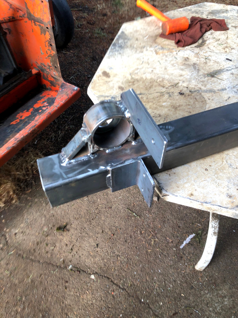

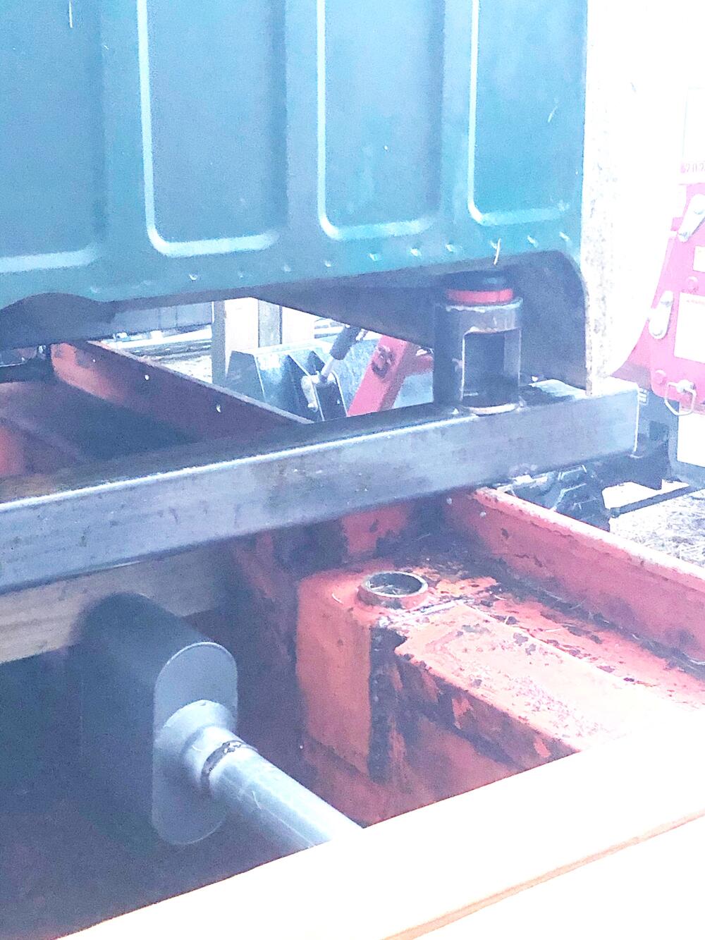

Had a good heavy mist this morning....Decided to weld the front mounts in.
Still need to get them out and finish the welds....but we are getting closer.

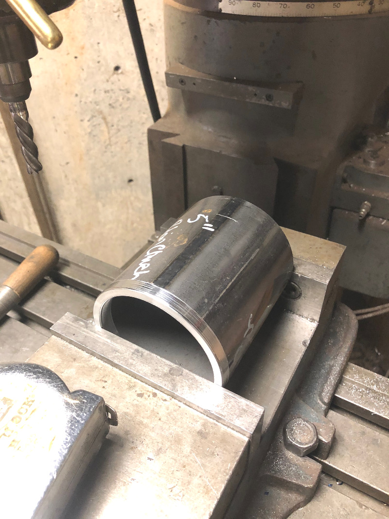

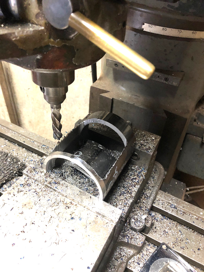

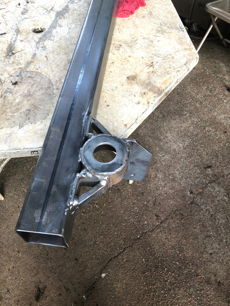

Got the piece of tube for the second rear mount this morning and milled the side out of it.
Ready to weld the top plate on that holds the urethane biscuit....
Almost ready to finish the rear mount beam.

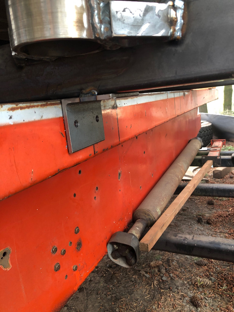

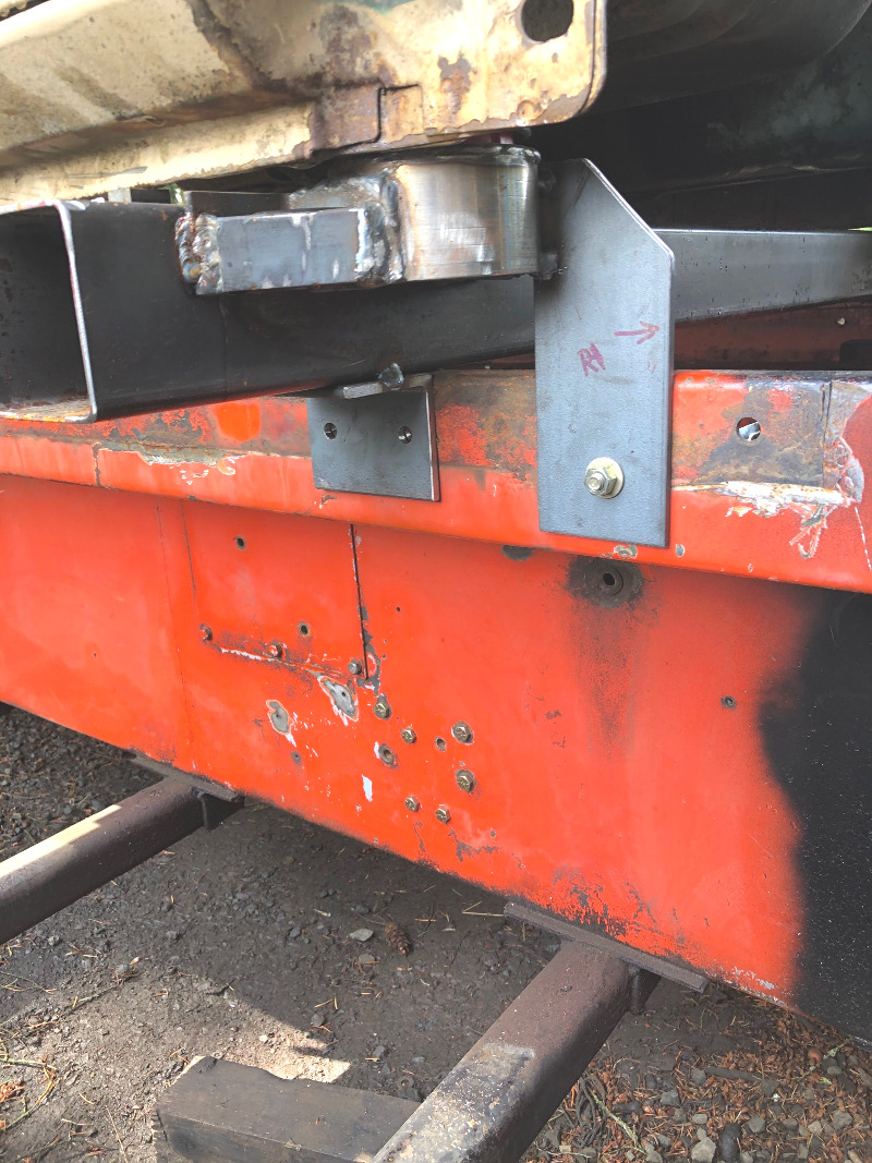

Grabbed the tools and went after getting the rear cab mounts finished and welded to the beam (At least partially until I can get the beams out and get at them well)
Brackets welded to the beam too where it fastens to the tub.

Good pictures of how you made the longer tube isolator. I was wondering how you made it. Very nice work!!
Thank you Bear
I was not really happy about that plan.
I wanted to use the factory brackets off the S10 FRAME.....BUT that would have left the frame a bit trashed for the guy who bought it.
I ended up getting my cab for free plus I still have the box too. :thumbup:
Ah well
Plan B :hammer:
The 4" tube worked OK
The front mount are cantilevered off the beam, so I am going to add a front brace to stop the Torque action.
I want the ability to be able to get the cab off easily so the engine and tranny can be removed for repairs or ??????
So far the plan is going well "I Think" :thumbup:

Looks like something a millwright would dream up. Clean and simple,
I worked for a millwright in an old big log mill for 2 years. He was a man of few words. I got my hand stuck in a chipper infeed chute and had to just about dislocate my shoulder to shut if off. My hand was really not hurt badly, just looked like it got run over by a dozer. He walked up and said, looks broke, and walked off. That’s the only thing he said to me in 2 years.
I worked in the mill machinery building biz for 20 years.
Ended my career in that field after I messed up my back racing boats....
My last position was as a field service engineer. (Fancy term for a McGyver)
Simple, work well and last a long time......:hammer::thumbup:

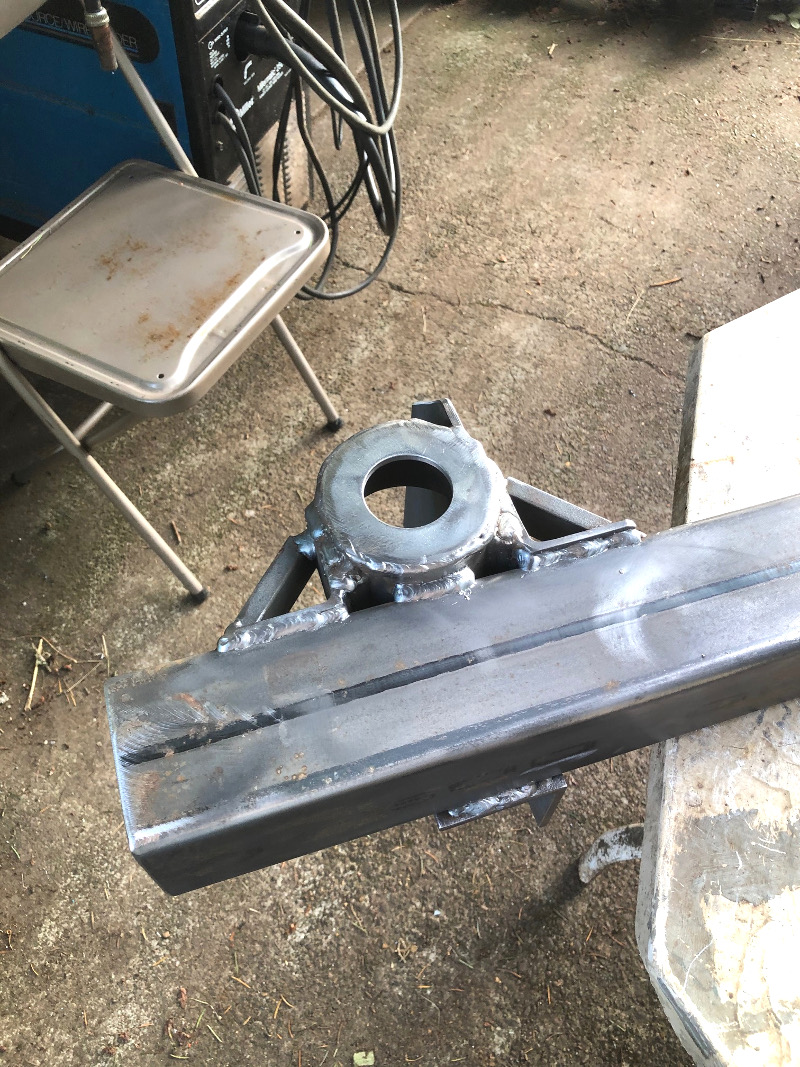

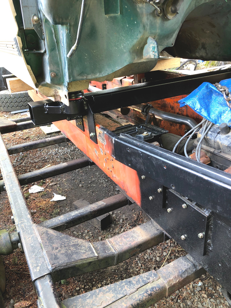

Went after a little add on to the front mounts a bit ago.
They all need to be final welded now....but far easier out on the table.....:thumbup:
A straddle support was definitely a good idea considering the cantilevered setup on the front mounts.

The RH saddle mount uses the same bolt as the battery tray corner.....Why not....it was right in the way....Drill a hole and call it good.
I inserted a thin piece of cardboard between the brackets and the side of rthe tub to allow a tiny bit of room to be able to get things apart....:hammer:

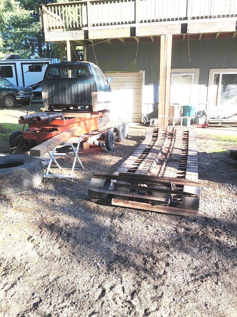

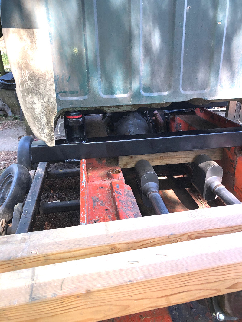

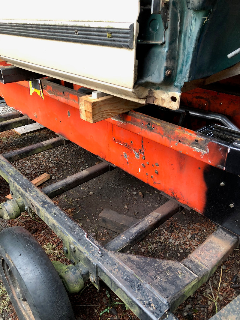

Weather is great and things went together perfectly.
Got the cab back up on the timbers and the mounting beams out of the cat.
The front one was a sweeet treat...came right out and up over the distributor and carburetor without any issues (As it should be able to do)
Got all the welding done and things cleaned up...wiped off with prep solution and painted a black satin color.
Let the paint dry good in the sun and carefully stuffed these bad boys back in.
Realigning the cab took a few minutes to get the mount bolts spot on (They have about 1/2" slop in the heavy captured nut in the body pocket)
All the bolt holes in the beams line up perfect with the holes in the tub..... (They were drilled on location)
All snugged down now so I can build the steps and get those finished up......
Then the cab comes off for the winter.

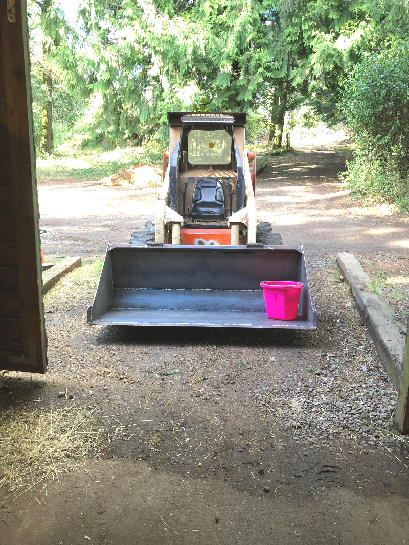

A bit of a side track for the next couple days
WE finally got some rain and can use the torch and welder without setting our little world on fire.

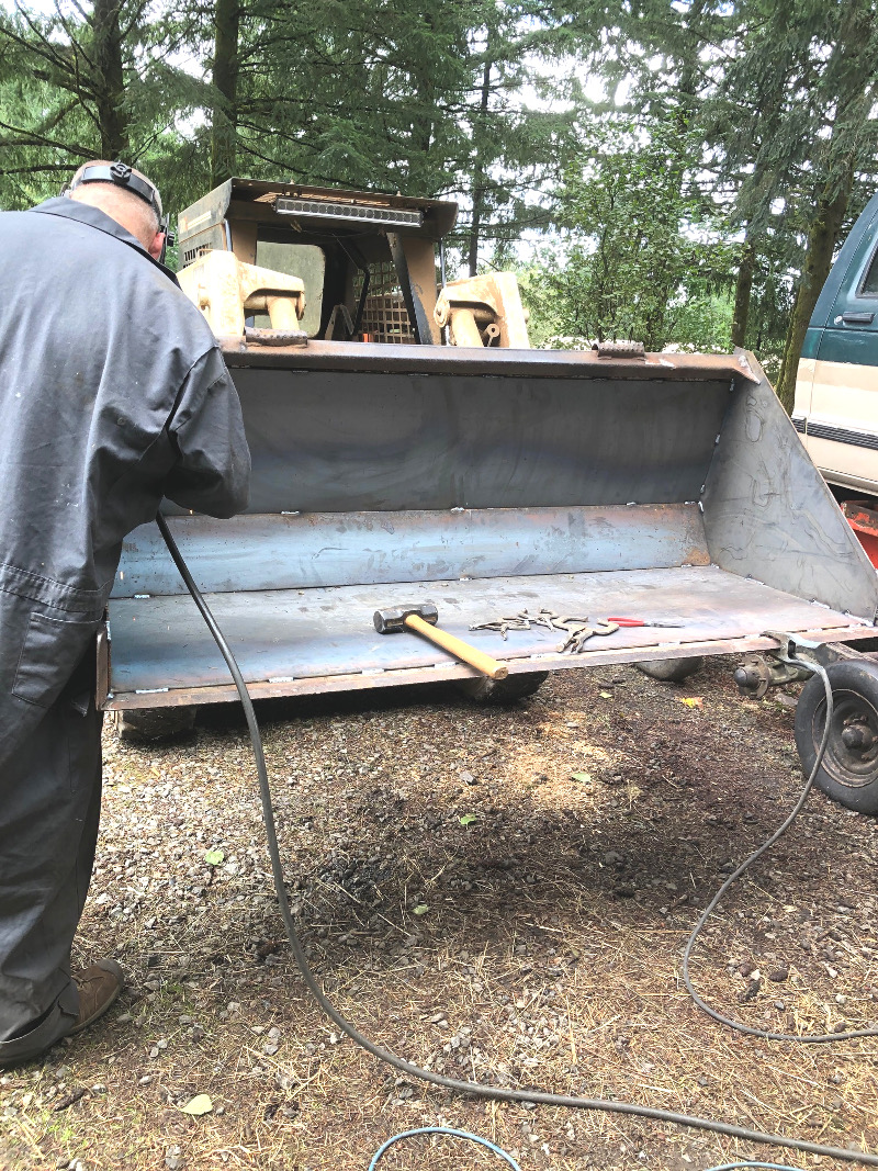

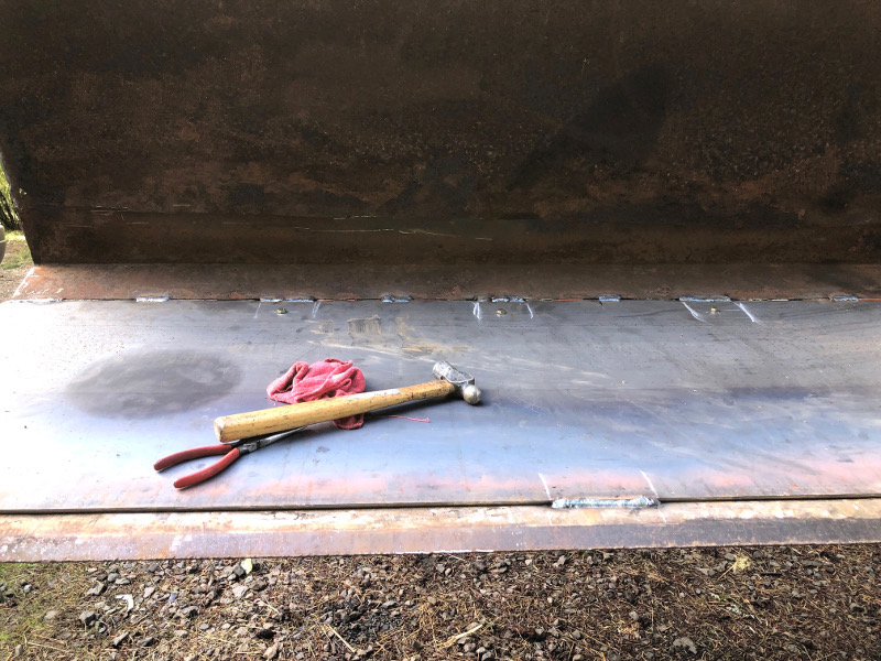

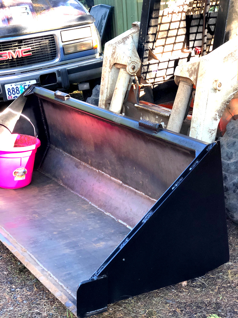

The bucket on the skid steer HAS TO GET REPAIRED
Yesterday I started cutting the floor of the bucket out....today the son in law is gonna take over....
The plan is to get the demolition done and the new parts fit and tacked in place.
We have a pretty good early fall storm heading towards us and tomorrow will be WET
The Bucket on the skid steer was just used up...
I need that machine to lift the cab back off the cat....and the barn uses the machine daily to haul horse poop out.
Gotta gitterdone.......
I am pretty close to the point that I will need to lift the cab back off the cat.....
So gotta play fabricator on a dirty old bucket......:shitHitFan: LITERALLY
CLOUD MT CO.

We got the skid steer bucket nearly ready to put in the new steel floor, ends and an added thickness to the back wall.
Original was 10 gauge floor, 3/16 ends.
Decided to go 3/16" thick on the floor as well as the ends and then went with an added 3/16" piece partially up the back wall.....
24 years of very salty poop and urine from the horse stalls took their toll.
But the frame and the rear portion are still great shape.
A tad bit of cleanup where the old ends came off still to do.....and the cutting bar had been bent up a bit on the ends during some hard usage over the years.
Pics of the new steel pieces all cut and ready to weld in.
I will be happy to have my fav tool back on line to do my heavy lifting.

The RH end was damaged when we bought the rig new in 1996....some clown backed a semi into the end and tweaked it.
We got a screaming deal on the bucket... It is a 1 cubic yard light material unit....The standard buckets are too small for our needs.
But 24 years of absolute abuse.....damned good return on the investment.

Worked on the skid steer bucket yesterday for a couple hours....
All ready to stuff the new steel in and stitch it up.

Pix of the bucket rebuild...
Pretty well done....just have the bottom to finish is all.
A bit of skip welds on the frame to floor pan and the bottom seams of the bucket ends
We had to tweak the hell outta the frame as it had been bent a bit over the years..
Hydraulic jack and some serious oooooomph to gitterdone....Then weld things up.....

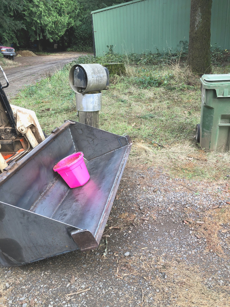

Decided to add a heavy bar to the top edge of each end of the bucket on the skid steer.
Easy go
Tossed some paint on the ends to keep the PATINA from showing up so quick...:th_lmao:
Very happy that this pig is done.....
Made a major decision on the tracks for the FrankenCat
I have found ZIP NADA in the way of a 2100 track ....
Going to build a complete set of new tracks from the ground up.
I have the one track I got with the machine to cannibalize for parts.
The tire guides are all there and usable...
The 4 belt laces can be reworked to use with (2) 12" wide belts on each track.
Got the 3 ply belting lined up fairly close by at a reasonable price.
Decided to fabricate my own grousers.
Seems that thiokol has used a lot of different materials over the years from Steel angle to steel tubing to formed steel channel and extruded aluminum.
Tucker used/uses a steel angle fabrication on their tracks.
Decided to go with 1-1/2" X 1-1/2" X 3/16" angle 3 feet long
About 5 pounds per grouser.
Bolt in the original tire guides and add a center section to the grouser to keep the tire guide stable ( Similar to the grousers on the 2100 track) Will look at a few options.
(2) 12" belts with the 12" center span like factory = 36" tracks
These will be bastards all the way.....no symmetry to factory anything other than the stock tire guides will bolt in....
Round over the outer corners of the angle upright to help the machine turn on non snow surfaces......
The 8" stock lacers can be modified to end up with enough pieces to buckle the four 12" belts
12" belts will help stabilize the angle grousers too..
The numbers say that the grousers for 1 track will weigh about 500 lbs
3 foot angle plus the added center support that will weld on.
I am thinking that a completed weight of 750 lbs each on the tracks is reasonable guess at this point.
We shall see.
I found one parts track for sale (Stock 57") but the sucker is 600 miles away ONE WAY
The belts are junk and the grousers are pretty beat.
Basically just buying tire guides......
NOOOOOOOOOOOOOOOOO....
Going to make a jig set up to assemble the tracks on the deck of the Big Tex trailer.... (It's flat and plenty long.....we need 287" we have 360" deck)
Gawd this is gonna be a JOB.....May have to have a track building work party :clap::clap::smilelove: PIZZA AND BEER....:th_lmao:

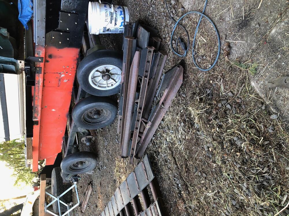

I decided to grab the track and get this bad boy up to the shop area and get the tire guides off and to save one belt.
I contacted 3 different people about the length of the belts on a 2100 with 72 grousers.....
I got 3 different answers.....:idea: ????????????????????
Decided to pull one belt off..let it flatten out on the trailer deck and get a REAL TIME MEASUREMENT ON THAT BAD BOY.....
Got the impact wrench and tools in hand.
NO WAY IN HELL WERE THESE 7/16 BOLTS COMING LOOSE....
Almost 50 years and the bolts were just not gonna move.
Grabbed the hot wrench and installed a "Flushing tip" and started blowing the bolt heads off :bolt: Just about like that.....
Kept the hose running on the area to keep belt burning to a minimum.
Still a stinky job.
Did get the cat on the tracks though.....well sort of.
Boots came to see wasssssup....
Decided to use the Sawzall and cut the other 3 belts to get the grousers off and into the mill to remove the two bolts that hold the tire guide onto the grouser.

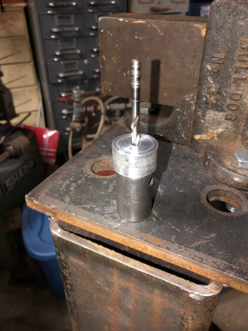

Ended up making a drill jig by pressing a little aluminum slug into an impact socket and drilling a 3/16 hole in it in the lathe.
Stick the socket on the bolt head and drill the pilot hole.
Swap in the 7/16 drill bit and remove the bolt head.
Quick, easy and zero damage to the grouser or the tire guide.....

Drilling out the bolts on each tire guide is a breeze.
I am heading over town in a bit to look at the Flexco belt lace units.
30 minute drive......
The company is a distributor for Flexco.
I want to get eyes on the new ones and see what they cost......
Here is a piccy of the drill jig to remove the tire guide bolts.....
