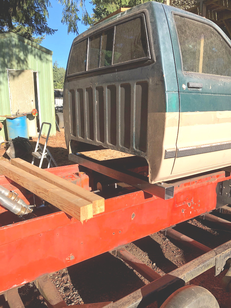

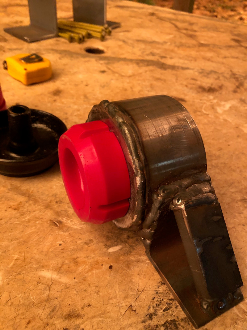

The biggest plan after the diffy is to get the cab mount beams finished before the cab comes back off for other work that's still needed down in the tub....

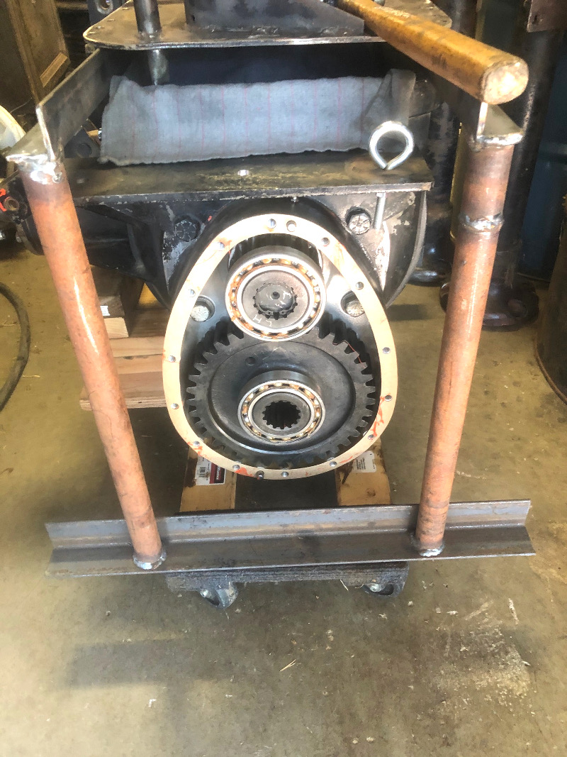

Grabbed the box of bearings and went after getting the drop box gears in and the covers back on.
A NOTE.....THE TOP GEAR WITH ONLY THE INNER BEARING GOES IN FIRST....
Then the big bull gear with both bearings....and the long hub on the gears faces the case cover.
When this came apart some months back it was a mess and the bearings were in pieces.....
The new bearings (In piccy) many different brands with boxes that looked like a war zone......
Some of the bearings I got were either double shielded or double sealed.....just popped them out and into the trash.
All open bearings needed....
Bearings tapped onto the gears quite easily using a dead blow and a medium sized driver......
Stuck the gaskets to the case with some grease in spots around the periphery of the case.
Greased the cover bearing bores and GENTLY tapped the cover onto the bearings that were on the gears.
One of the service books I read some time ago mentioned jack bolt holes..?????
My gear box must be old as there is not any jack screw holes to remove the covers.....
Just a bit of wiggle and a putty knife got them off...
The covers went on extremely easy with zero issues.....
Installed the bolts and we are good to go.
Everything turns very smooth.....Far better than the first time I tried to move this beast. (When it came home) ....TOOK A BIG BAR ON THE AXLE AND A 4 FOOT PIPE WITH SERIOUS OOOOOOOMPH TO GET IT TO MOVE....
Amazing what clean gears and new bearings can do.....
I measured the register flange on the axle tubes and they fit into the lower bearing bore and just contact the bearing....With the gasket in place things will have a tiny bit of clearance (End play)
Looking good.

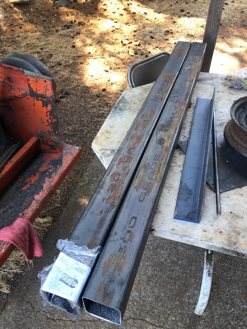

The steel tube (3-1/2" square x 1/8" wall) will be in at the steel yard today.
Have them this afternoon. (Cab mount beams)

I wanted to do the dive shaft back earlier this summer, but the pinion flange had to be changed to the new piece I machined that mates to the CV shaft.
Then came the nasty mess in the diffy and the condition of the diffy was then an unknown quantity......
As it turned out it is OK

Got a call from the steel yard about an hour ago....the steel tube for the cab mount beams was there.
Tooled into town and picked them up.
Not much else happening...and its HOT OUTSIDE...
Ordered the pinion seal....be here about the 10th.
The urethane mounts be here about the same time.
Hurry up and wait......
The tube steel has been a hangup ....3-1/2 square is not a normal size for the local guys to stock.....the owner was in the other day and he ordered in a stick./
I got two 62" pieces.....I think somebody else wanted the rest....that works.
IF/WHEN another cab comes home I will worry about two more chunks.

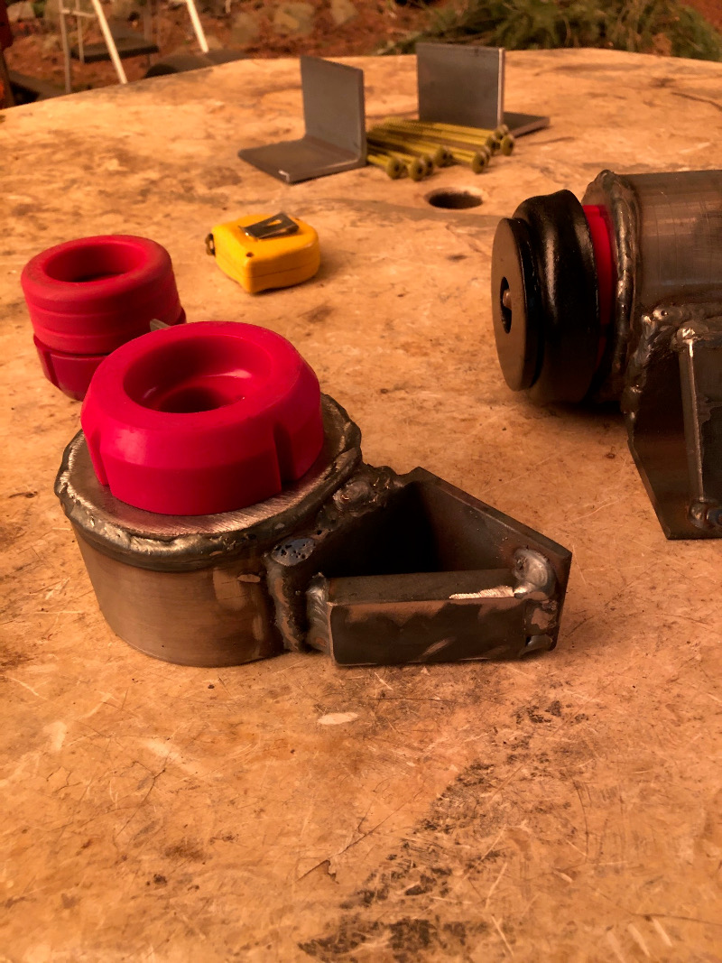

Got some much needed work done today.

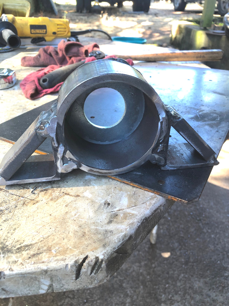

Fab'd up the two front cab mounts.......
I had some big azz heavy washers that were just the right size to support the urethane biscuits.
Welded the washers onto some schedule 80 pipe.
Added some angle pieces and some braces.
Good and stout..
I can't bore the hole for the biscuit pilot until I get the new parts.
I have a set of biscuits from a Square body Suburban....I can't be sure the pilot is the same size.
Take only a couple minutes per unit to bore them to size.
Assemble them and then get the square tube set correctly and then weld them in place.
Add a angle under the tube and bolt it to the Cat tub.....
The stand off for the biscuits in the rear of the cab will be different.
Same schedule 80 pipe.....Longer as the rear mounts are higher off the frame due to the floor of the cab raising up.
The plan is to use the schedule 80 pipe and mill a big slot in it to get the biscuits inside and to tighten the bolts....then weld the pipe to the square tube

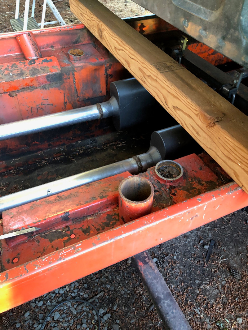

With this wretched weather (TOO HOT)
I got out and onto things at the BUTTCRACK A DAWN this morning.
The old stubs from the original roll bar were in the way.
Out with the SAWZALL :clap:
Very short job to hack those bad boys off at a very low level....Still need a bit of grinding to make them sort of even ....No big deal...just useless baggage now....
Cleaned up the new tubing, deburring the ends and washing off the pickling goop they spray on the stuff.
Jacked up the cab slightly to get the wood 4x4 out.
Slid the steel tubes in and added a 1/2" spacer to allow the front biscuit mounts to have a bit of clearance above the tube after the biscuits are all in.
Tubes adjusted for location (Final and exact position will be done just before welding the mounts to the tube.
The tube/beams extend far enough out from the cab to allow step/steps to be added as things progress..
At present....getting up into the cab is a bit of a stretch.....
The design seems to be working fine. The rear mounts will sit right on top of the tube/beam.... Slotted schedule 80 pipe with the big washer welded to the top will be the basis.
Facing the open slot of the tube rearward will allow easy access to the biscuits/bolts and such.
Gotta wait for the new biscuits to be able to stack things together and get the correct measurements to cut and machine the parts...

The pinion seal showed up today....
Sweet....
Now I can finish up getting the diffy box together.
Just the axles is all that's left now.
Get the bearing retainers machined and the new bearings on the axles.....be good to go.

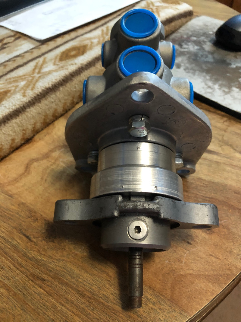

The Air control valve to allow the brake pedal to run both bands came.

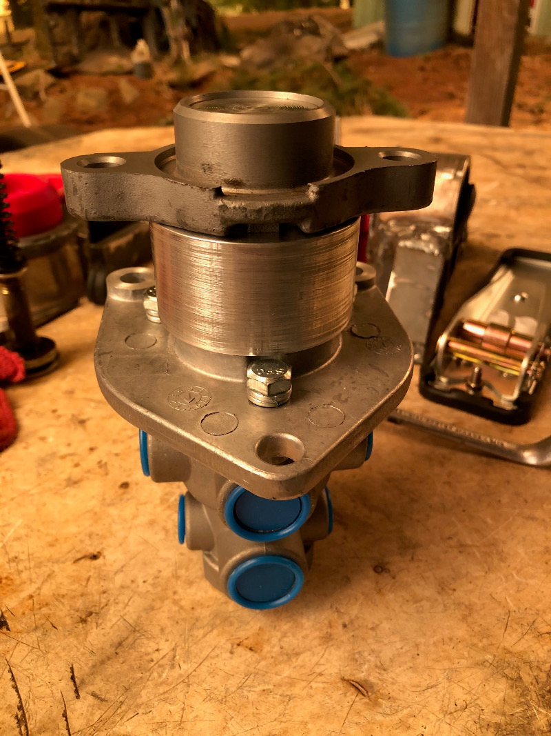

BUILDING PARTS THAT WERE NEVER MEANT TO FIT TOGETHER AND NEVER DESIGNED TO DO WHAT THEY ARE NOW GOING TO DO.
Took the old master cylinder from the S10 and cut the flange off the end.
Tossed it in the lathe and trued up the end.
Grabbed a chunk of 2-1/2" aluminum bar and whittled it down to form the adapter section to mate the air valve bracket to the master cylinder flange.
Had to machine off the foot pedal bosses to get a suitable flange so everything will mate up.
Some drilling and tapping yet to get the adapter to connect to the master cylinder flange and the foot pedal base.
The E3 valve bolts to the pedal base.
Pictures show the morphology.
Coming together.

Yeah buddy.
Got busy this evening and finished the mount.
Only need to check to actuator rod length and possibly lengthen (New little rod) or shorten a touch so the pedal is at rest and the valve actuator has a bit of clearance.
Rod is the one that came in the S10 power booster.
Gawd I love it when a plan comes together :thumbup:
Just need to take it back apart and wash it all up.....Loctite the 4 screws ( Hidden under where the valve fits against the plate) and the 2 countersunk screws on the old mast cylinder flange as seen in the pics.

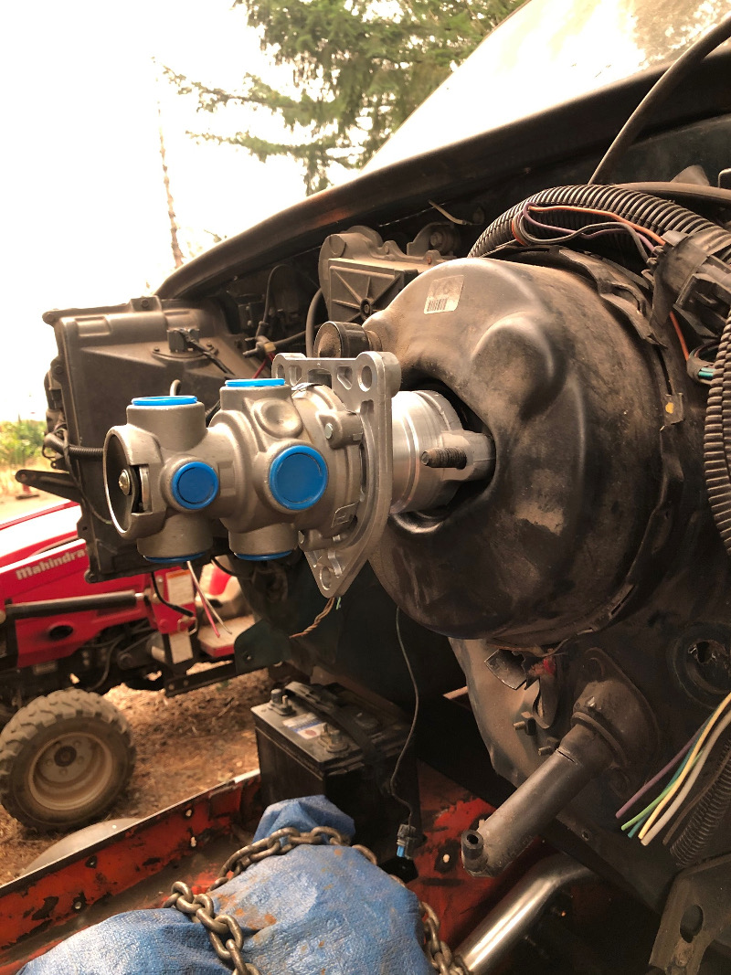

I did get out and do a trial fit of the new valve assembly :thumbup:
I just need to make a new actuator rod.
The stock one is waaaaaaaaaaaaay too short...1-5/8" too short

I gave the new air valve unit a quicky trial fit on the booster :thumbup:
I just need to cut and machine the longer actuator rod to go into the booster unit and that bad boy will be ready for prime time.....

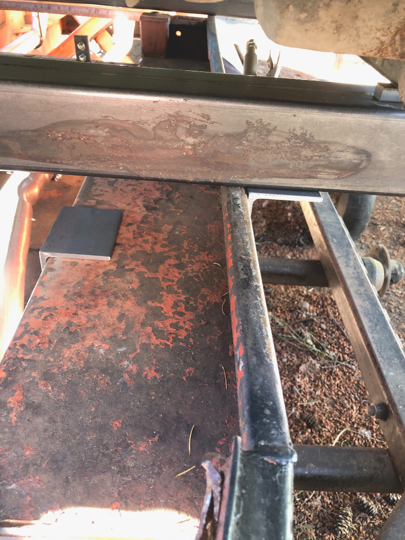

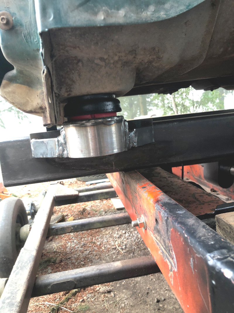

Got after some work on the cat....
Got the cab mounts bolted on and the alignment within 1/16" for the cross beam.
Drilled the angle bracket that will end up bolting the beams to the cat tub.
Fooled around with the actuator rod on the foot brake valve......
Made the new rod.....got the length cut right and the inner sleeve in the boosted modified so the pedal travels far enough to activate the brake light switch and the air valve.
Still way too dry to weld anything outdoors......
But at least something got done.
Rain maybe by tomorrow night.
A bit of dampness and I want to get the mounts welded to the beams.
Then get them back out....finish weld and then get a coat of black paint on them before they rust up.......

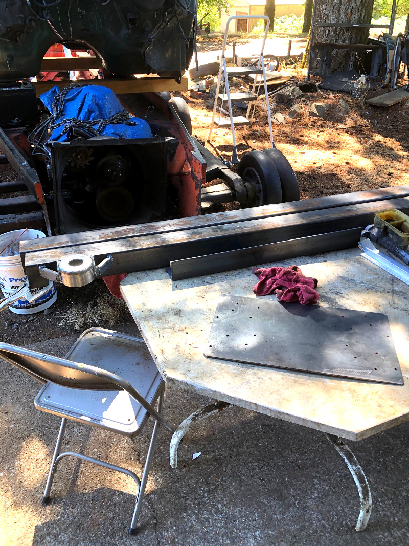

Weather still sucks
Smokey as all get out.....but I decided to go downstairs to the machine shop and start machining on the rear cab mounts.
A lot different than the front ones due mostly to the height the mount needs to be off the cross beam. (Rear of cab floor has a step up)
Discovered I do not have enough large tube to make both rear mounts..
OFF THE THE STEEL YARD after breakfast :hammer:
I will get some pics in a while.....
