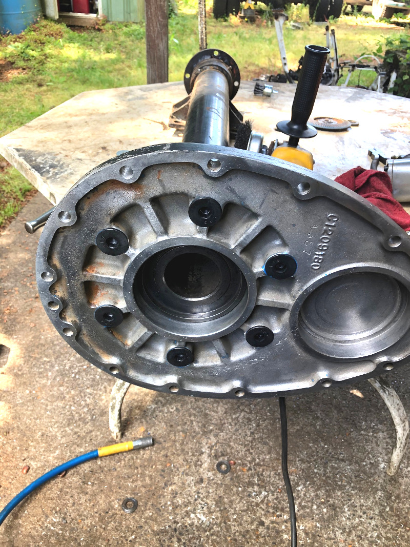

Had to go to two different bolt companies (Less than 1/2 mile apart) to get the 12 ...5/8"-11 Flat head Allen bolts 2-1/2" long (Full threaded)

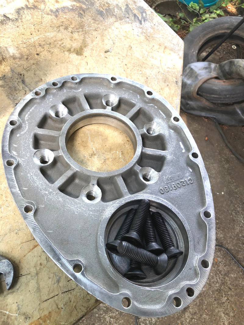

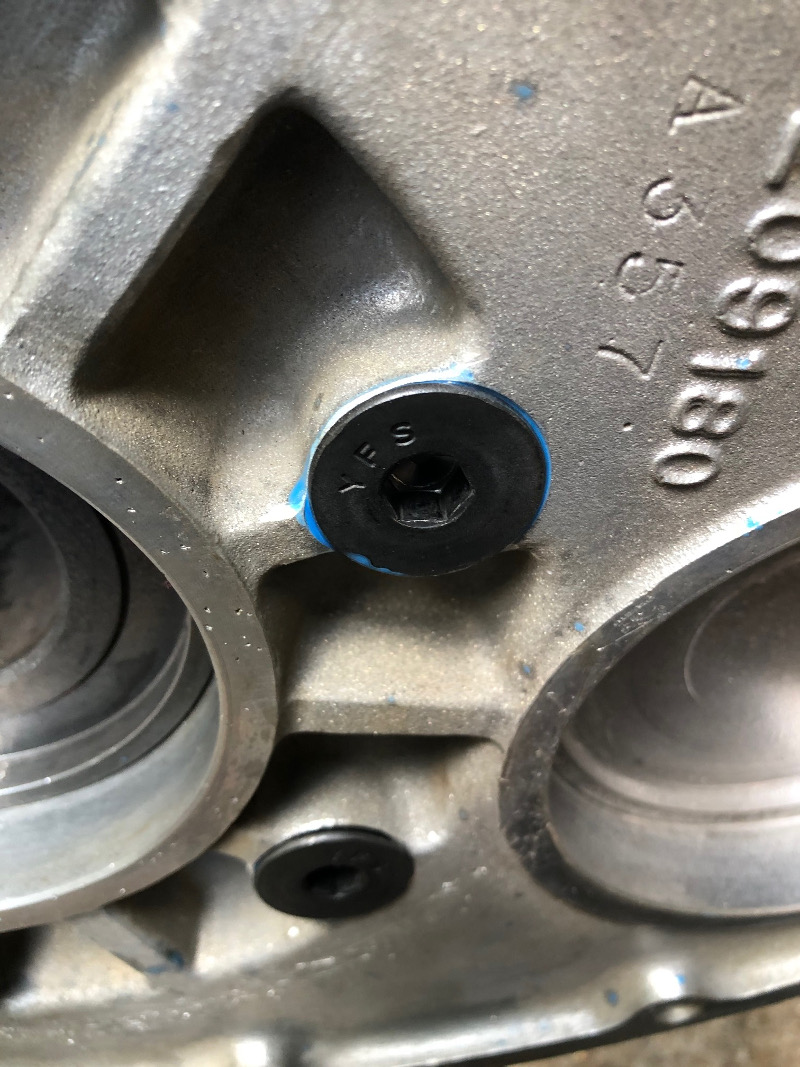

Stuck the one cover in the mill and dug up a big azz countersink.
Dropped that bad boy into the inside of the 6 holes that fasten the axle tube on.
Got the holes all ready for the big bolts to thread in.
Gonna wash up the axle tube now (Very grungy with a huge amount of blue silicone on it and nasty goop left from the water oil mix left behind..
Then will come the acid test.....SEE IF IT ALL WORKS.....
Gonna fit the bolts with Nylock nuts and the original washers..
With the flat heads sealed with blue locktite they will not leak oil....
Pictures in a bit....
YES INDEED.
Never had one of those rattle loose.....
Well...

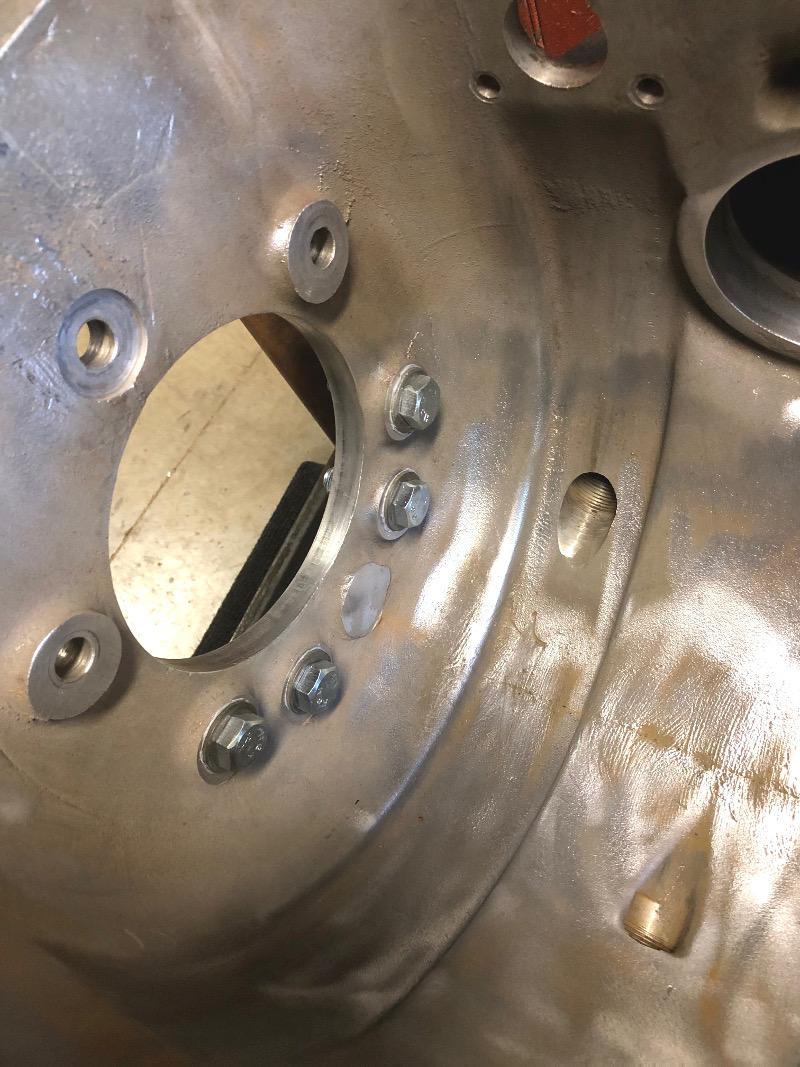

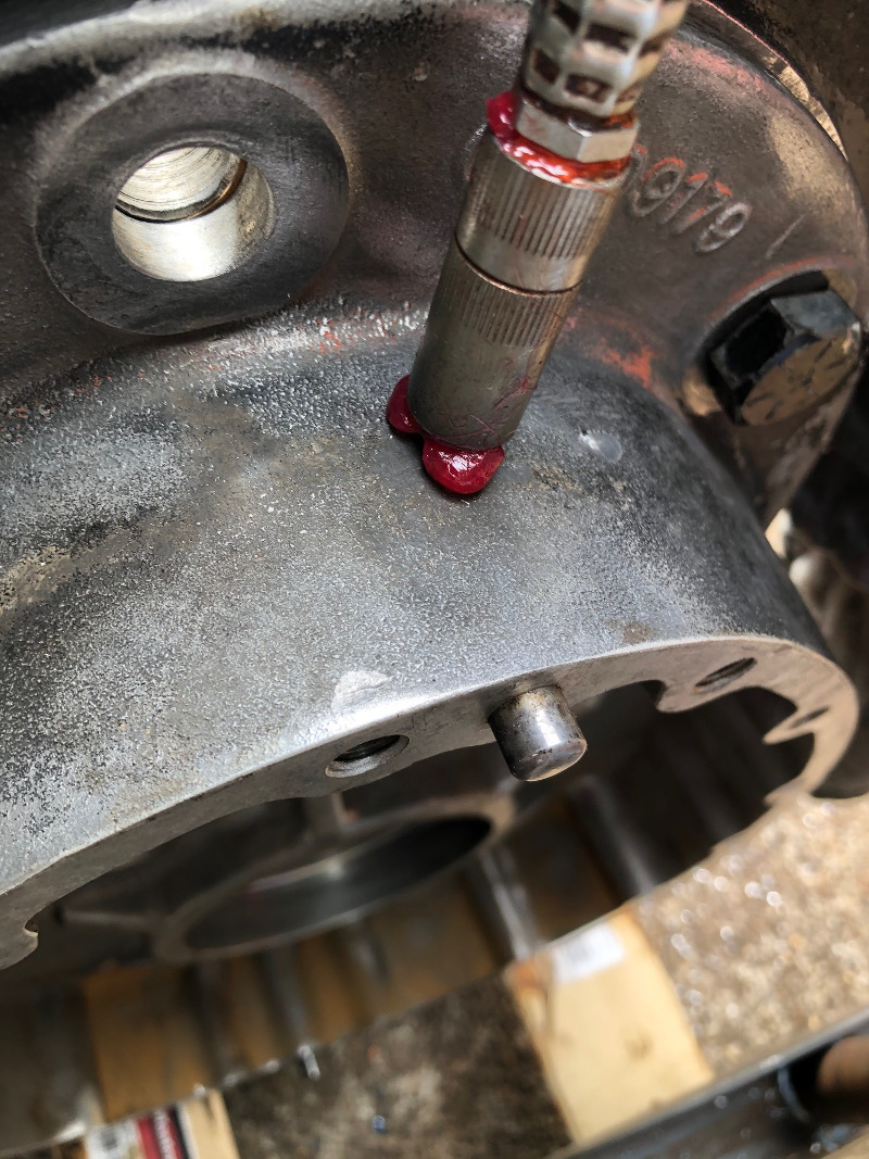

To start with...the previous crew was consistent....and this is not a compliment either.
The fools crammed a standard washer under the bolts that held the axle tubes on...
Sadly there is a spot face in the axle tube that will not allow the washer to seat....
RATTLE THE BOLTS DOWN UNTIL THE WASHER FITS....OMG
The threads were tore up in several holes.
One had a fine threaded bolt run in and it was a bitch to get out....
Cleaned up the hole with a tap as best I could.
The threads ended up a tad out of square....but things fit OK.
PIX
Counter sinking the holes.
Holes done.
Locktite added.
Washed the threads with brakekleen to degrease well first..
All done.
Ready to go back together...

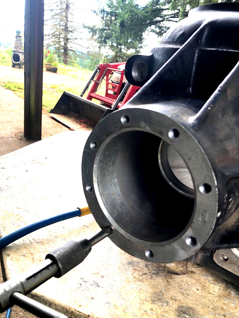

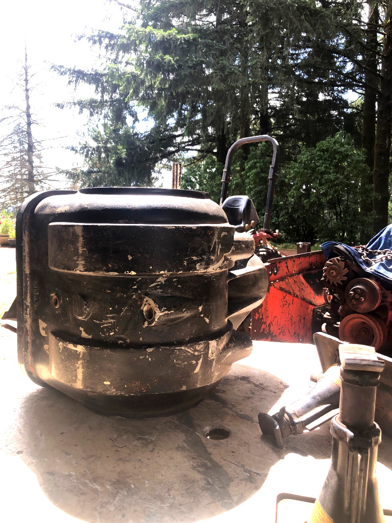

The drop boxes did not come off the same cat either.
One had a soft green paint under the black.
The other one does not have the green paint..
A cat of many colors.

Not a real Gung ho day today.
Got the other axle tube cleaned up.
Both drop boxes are all spiffy now too.

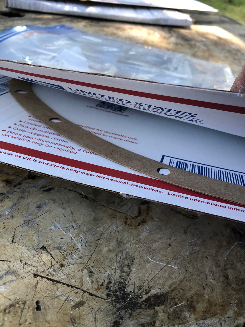

Ordered the gaskets from Snowcat Pat....
His lovely wife got things all handled....
THANKS FOLKS....

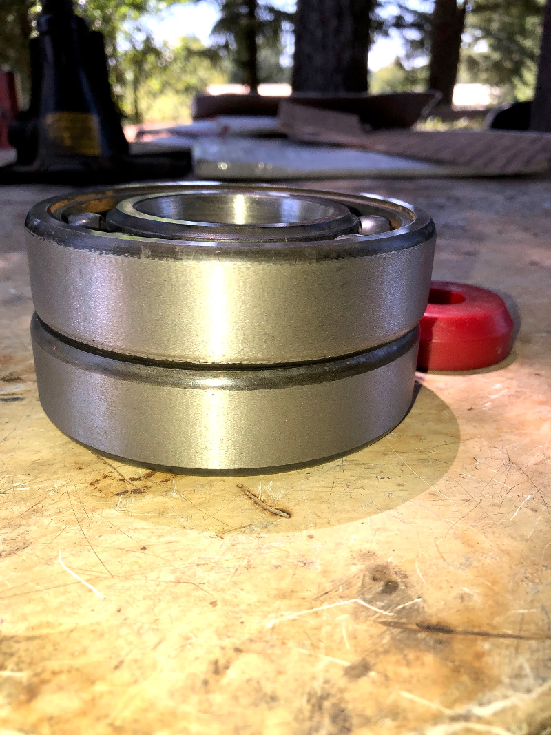

A pix of the one pinion bearing to stay away from.
These are called "FULL COMPLIMENT" type and will carry a bigger load...but the RPM rating is less due to MORE INTERNAL FRICTION
Just an FYI
I ordered the full compliment bearing by the number only...then got to looking at the bearing when it got here...then asked What is the difference and why.
Reading bearing specs books will make you crazy.....and make ya want to chew the tracks off your cat...

Tomorrow gotta wash out the main diffy case and go get a 9/16" hex tool to get the drop box oil plugs out.
The small 1/8" pipe drain plugs were stuck tighter than a bulls azz in fly time.
The hex striped out..
Drilled them and used an easy out.
Re tapped the threads to clean them up..
Will install new hex head plugs there...

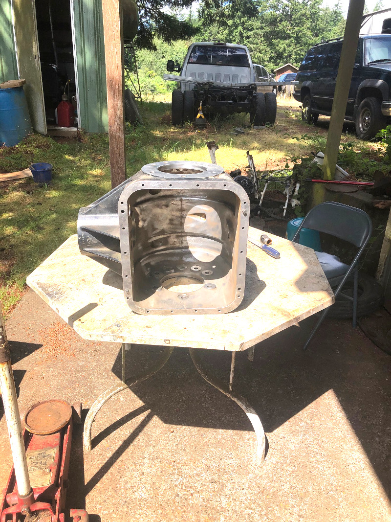

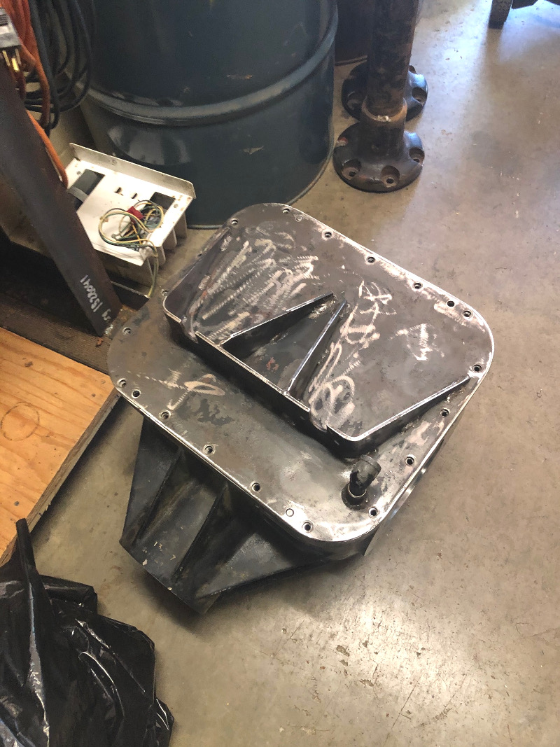

OK
The diffy case finally got the washout and clean up.
The case lid was really grungy too.
All spiffy.

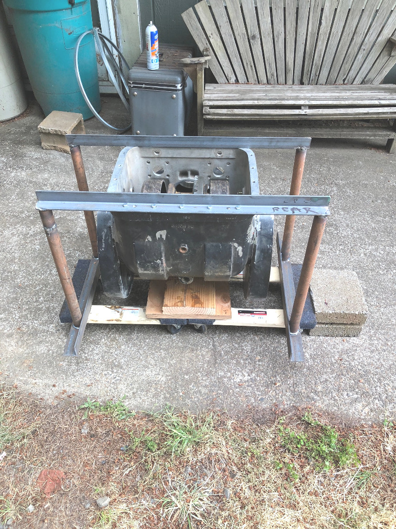

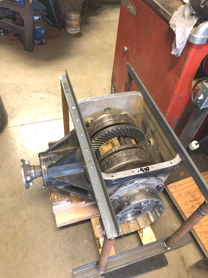

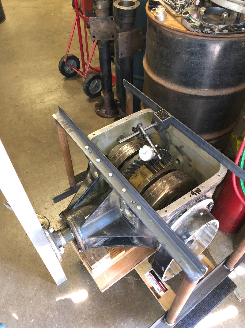

While looking for something in the shop I spotted two screw jacks that likely came from the old square body Suburbans.
These will work great to hold the Compensator case in the center of the bores of the main case while the drop boxes are tapped into place.
I picked up some steel angle that can be used to build a pair of holding fixtures.
The rusty pipe in the one piccy will be cut to length and welded to the angle.
The angle bolts to the top rail of the case and this will allow the case to stand free with access to allow the drop boxes to be fit easily.
A pair of tubes (Not shown yet) will slip inside the compensator case and then rest on the jacks.
SPECIAL TOOLS YA KNOW
I picked up another 15/16" box wrench to modify and make an opposite hand wrench to the one I already made..
This is needed to get onto the very bottom bolts in the drop box.....
(Flat head 5/8" bolt)
These two wrenches are a real help....

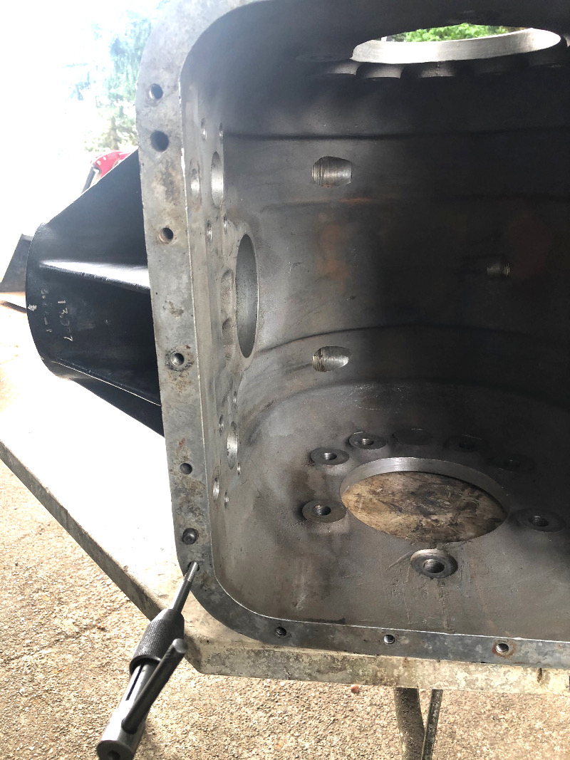

Pics of the case.
All threaded holes tapped to clean the threads.
Happily all the holes are in good shape...
I WOULD NOT HAVE BET ANY $$$$ ON THIS ONE...CONSIDERING WHAT HAS BEEN THE NORM...
As the jigs and fixtures come together I will post pictures.
I like things easy....especially when the stuff is heavy.....
Keeping the compensator centered will make getting the drop boxes on real easy.....
:hammer::hammer::hammer::hammer: with a soft dead blow hammer.....
No steel hammer on this maneuver ....:thumbup:
At present...the plan is to install Allen set screws in the 5/16" threaded holes in the top of the case, then fasten the top using Nylock nuts.
This will save the threads in the case and make a better overall fastening of the cover.....
I may use blue locktite on the pseudo studs....not sure yet.
Best part is the Allen set screws have a hex in them and can be removed easily...

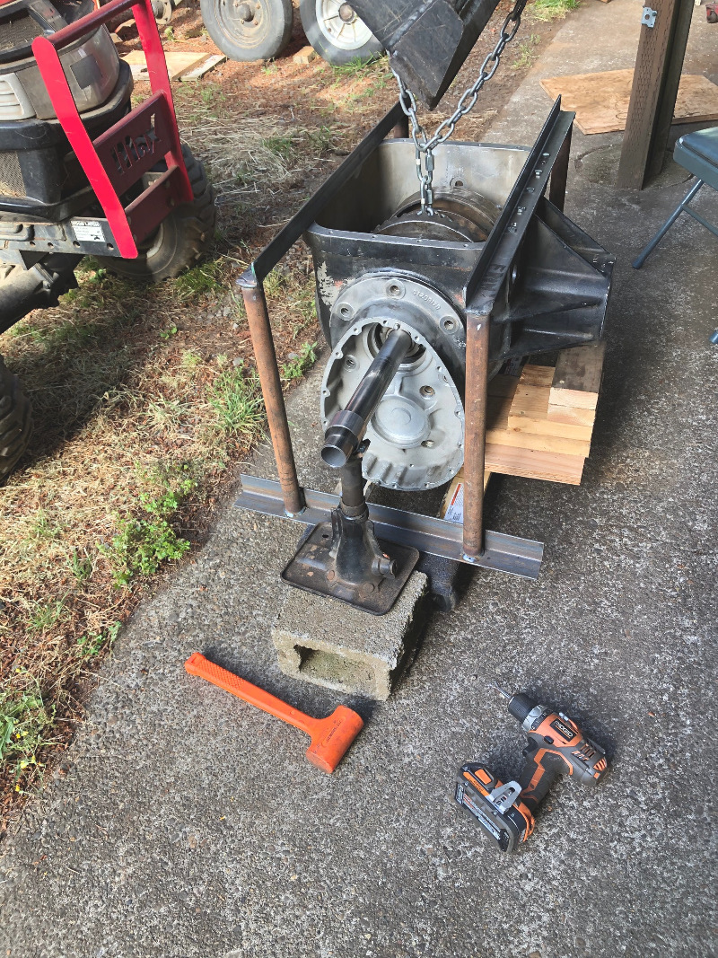

Got my Saturday work done....
The Adapters to hold the compensator all cut to length and machined so they will slip into the center tube on the comp.
Two jacks got a tubular piece welded on to make sure things don't fall off.
Fabricated the set up stand.
All drilled to be able to bolt to the top rail of the main case.

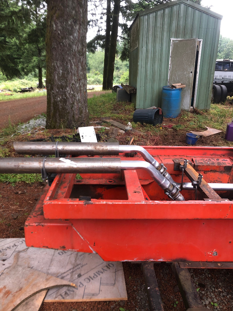

Measured up the cab inside.
2 buckets seats can easily fit in that cab....
Now.....after measuring the S10 cab it looks like the cab will fit fine with the rear of the cab far enough forward to allow the original 2100 fuel tank to fasten in it's original location.....AND the factory 2100 cab (LESS ALL THE CRAP BOLTED TO IT) can fit behind the fuel tank over the BOOM BOOM exhaust pipes......
More measurements of real time variety still need to be done though.
The 2100 cab is 52" long front to back....that will put the cab about 6 inches forward of the current location of the pipes (Not finish welded yet)
This idea is looking very promising :smile::smile:
The 2100 cab has a nice joy ride bar across the front....
I can remove the old instrument panel up top....
I can easily remove a few hundred pounds of crap still bolted to the cab...
The valves for the blade and the groomer, the seat and steering controls, tool box and sundry other junk.....
Mounting the original cab above the exhaust pipes should give the rear occupants a fair view out the original front windshield.
Gonna need to replace the windows....no biggy.
I can use the original windshield for a pattern
The side sliders are junk.....MAYBE scare up some universal windows from canopy usage to be grafted into the holes in the door and RH side.
May need to add a bit of sheet metal to modify the shape of the door and side opening...
Best part....I own the cab and fuel tank......
This is indeed going to be A FRANKENCAT....:clap:

Finished up the "Holding fixture" to allow easy assembly of the OC12 Compensator case fit into the main box and the drop boxes fit onto the carrier bearings....

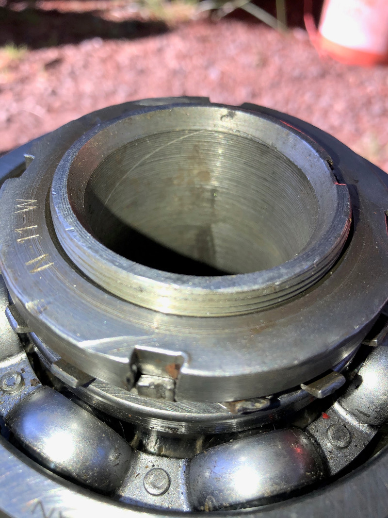

A couple pics of removing a shield from a bearing.
Many time you may need an open bearing and all you can find are shielded or sealed (ZZ ...Shielded both sides) (RS ... Rubber seal)
These parts can easily be popped out using a screw driver or a pocket knife.
Carefully slip the blade into the joint between the seal/shield at the inner race and pry the seal/shield out..

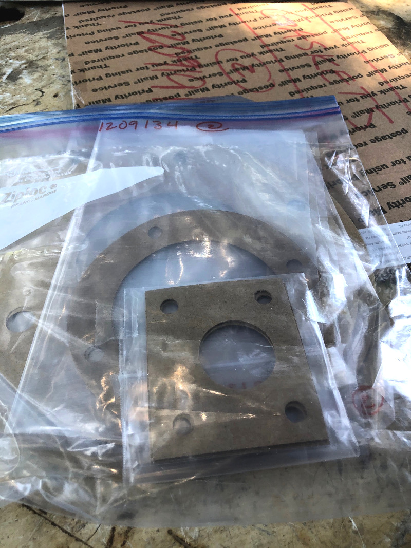

The Gaskets arrived from Spryte improvement today:clap:....
Top notch gaskets....Extremely well packaged
Thanks to the folks at Spryte improvement....:thumbup::thumbup:

The new gaskets that go between the main case and the drop boxes are .016" thick out of the package....
The old ones were .010" when they came out at disassembly.....

Going to use the old bearings (Not perfect but not roached either) and OD and ID grind them so they will JUST slip onto the diffy center section, and into the drop box bore without having to get vicious with things...
"Special tools if you will"
Then I can slip things together and check the fit....make any shim adjustments if need be (All original stuff is in it's original sets)
Do I want to trust the other crew...NOT EVEN..../
Royal PITA....But it will work well to get the job done without having to pull bearings and cases apart with force....
Gotta figure out how I am going to grind the old bearings to do this...
Gonna call a couple shops and see wassssssup...Or I may make a little fixture and do it in my lathe.....
I have a rig that allows my air die grinder to fasten to the tool post......we shall see.
I want this assembly correct.....
Busy morning...
Called a couple shops that do grinding.....Waaaaaaaaaaaaaaaaay too much $$$$ to get the two old bearings ID & OD ground to make them usable as set up tools.
Sooooo
Headed down to the shop...
****WARNING****
DO NOT TRY THIS AT HOME.......
Grabbed up my air die grinder and sorted through the lathe tools to find the extra quick change tool holder that I had used to hold the die grinder before...
Yessssssssssss
Got the grinder all set up...had to run to town and pick up a couple stones...
The setup is not nearly heavy enough to get a really really smooth finish....BUT good enough to get the bearing OD & ID where they will slip over the carrier and into the drop box upper bearing bore
So after a couple hours of fooling about....these two bad boys are done....
They fit sweet.
Now the carrier can be fitted and the backlash can be checked and the overall bearing position can be set correctly......
With a bit of luck the original shims will be good to go.....But I am not counting on anything with this beast....
A few pix
The red gizmo's are urethane body mounts from something ????? found on the shelf....
Stuck between the bearing race and the chuck allowed good traction to be able to get the inner race to be turned while grabbing the outer race.
Grabbing the inner race I added a piece of rubber sheet between the outer race and step in the chuck jaw to drive the outer race...
WHAT A LASHUP.....
I hope nobody here is a precision machinist.....but ya gotta do what ya gotta do to gitterdone.
Gonna be great to get things stuffed into the box and actually see where we are at on this thing.....
I am definitely gonna put these "Tools" in a box on the shelf JUST IN CASE THERE IS EVER ANOTHER NEED DOWN THE ROAD....
The two bent wrenches, filler button to pull the carrier bearings off, the holding frame and the two modified besarings.
Don't want to make this stuff again.....
Inventions were a blessing for sure.......
All good to go now

Did some final checking, and my theory about the one drop box having been replaced is likely true.
Aside from the Strange paint scheme, there is not a dimension stamped into the top edge of the drop box near the flange where is bolts to the main case.
The one has .9060 stamped quite conspicuously on the top...between the main box flange and the edge where the cover bolts on.....
This sure would make me believe that the drop box has been replaced....
Could have been a factory new one at one time....????????????????
The factory stamps all the critical dims. on the case and drop boxes when they are assembled to aid in the process of replacing bearings, gear sets and such and being able to calculate the shims needed....

Was finally able to worry the Oil plugs on the drop boxes out.
The drain plugs were both Fubar'd (1/8" pipe) hex stripped out....Drilled them suckers and use an easyout...)
The larger plugs on drop boxes were also in bad shape...fought them out too... with a bit of FORCE.
Need to replace all the plugs.....

Got the old "Modified" carrier bearings back on the compensator case and rolled it outside.
Got the main case on the rollaround gizmo and outside.
Lifted the assembly with the tractor and snaked it into the main case.
Got the modified screw jacks in place and a large cotter pin in my 18 volt drill to operate the jacks...... (Last minute idea)
Got the drop cases in position on the pipe adapter holding tubes.
Jacks working to get the center section up into position to allow bearings to go into the drop box bores.
Stupid Mickey mouse idea worked really well.
Started the drop boxes onto the bearings using my Dead blow hammer and almost immediately I swat the top dowel pin with the club...../and the pin goes in flush with the case lip...../Arrrrrrrrgh !@#$%^
The pins are harder than a whores heart....no drilling them to tap a thread to pull it out....
This sucks......
Soooooooooooooooooo...finish getting the assembly together to check the end to end to be sure the carrier is not gonna slop back and forth.....
That went well..
I still need to measure things and bang on the compensator to be sure it is indeed tight in the case......
Now....What the hell to do about getting the pin out.
Decided to try Hydraulics......
Measured in 1-3/8" from the edge of case flange (By pin head that's flush now) and drilled a suitable hole to try and intersect the pin bore.....
Bingo......intersected the pin hole.
Tapped the drilled hole 1/4"- 28 thrd and screwed in a 1/4 28 zirk fitting..
Grabbed the grease gun and gave it 3 pumps and then the little critter popped back out.
Cleaned up the grease....GONNA LEAVE THE GREASE AND THE ZIRK IN THERE......:thumbup:
I need to go measure things and get the pinion ready to go back in and then check the back lash.....
Once these things are done the carrier needs to come back out, the old modified bearings come off and the new bearings go on....
Put the bands on and secure them with zip ties and drop the unit back in.
This time the assembly is for keeps (I HOPE)

Put the new pinion bearings on the pinion and snugged up the nut.
Stuffed the assembly in the box and snugged up a couple bolts.
The carrier appears to be just fine from side to side......measured the position with a depth mic and no matter if I bang the carrier one way or the other using a big azz club against my aluminum spud that fits into the carrier end journal the measurement stays the same at .910" off the inside machined pad in the drop box..... (Measured from machined pad to adjusting nut face as a reference point....same spot after banging the carrier either way)
No matter.....the sucker seems fine.
Checked the backlash ..... .007" on the low and .015" on the high
The Mickey mouse ground bearings could be a skosh off and cause the carrier to sit goofy, but I don't think that's the case as they ran true in the lathe.

Last night we stopped by the post office and four more of the 6014 bearings were in a parcel locker for me :clap:
Two still inbound......
The bearings are from all over the world.
USA, Japan, China, Hungary .....Franken parts :thumbup:
Today started off with getting the bolts out of the box holding the drop boxes on for the temporary setup and checks.
Removed the pinion assembly and the unit is now ready to roll outside and the carrier removed.
Going to do a temp with the lower 4 bolts and washers....Going to add a dab of silicone to the washers and fasten them snug to the inside of the case and let them cure overnight.
Those lower bolts are a paint to fetch the washers in place and not be fishing them out from under the unit after ya drop them ...... Arrrrrrgh
Going to get the new bearings on the carrier today and the big N11 nuts tightened up and locked in place....
Then we wait until tomorrow to allow the silicone to GLUE the washers to the case.
Probably go ahead and get the bands wrapped around the drums and secured with tie wraps today as well.
Gonna be glad when this BIG PIG IS HANGING BACK IN THE CHASSIS....:smile:

Got the diffy back apart now.
Modified bearings pulled off and things are ready for the new bearings to go on.
Wiped the bolt bosses in the case down with a good de-greasing solvent as well as the washers.
Added some silicone to the side of the washer that goes against the case and snugged things up with some bolts and nuts.
By tomorrow these bad boys will be STUCK to the case well.
Then it's just a matter of installing the new bearings onto the carrier and dropping the assembly into the case....the misery of fooling with the loose washers down in the case will hopefully not be an issue.
The top 3 bolts are pretty easy to deal with.....as a hand can reach in there.
The bottom nuts can be inserted into the box wrench and Gorilla tape applied to the outside to hold things until the bolt is threaded in a bit.....
So for this afternoon....Chill time....

OK TROOPS
Time for truth on this bad boy........
Got out before the sun was beating down on the slab......
Some pics of things.
For anyone who has not done one of these gear boxes before...some things to keep in mind when you work on them.
Mark everything as to where it came from....Positions of shims and such is paramount.
If it is just a re-bearing, band and seal job everything can go right back in without any hastle....just mark it....
Words like....
Gently
With care
Patience
Cleanliness....are all ones to keep in mind.
Rarely will a big azz club be needed.....RARELY.
Installing roller/ball bearings is NOT a job for a big club....
HEAT IS YOUR FRIEND
Warm up bearings until they are hot enough that you do not want to touch them....A propane torch in moderate weather is all that's needed (Likely a minute is plenty) NO BLUE COLOR ON THE BEARINGS....WAAAAAAAY TOO HOT.
Just hot enough that your grubby's will not touch them.
Good leather hand shoes and carefully slip the bearing onto the journal...PLOP
NOW you will notice the 5 pound club and a piece of pipe.
The pipe fits over the journal and hits ONLY the inner race..
In the event things stick.....QUICK....BLAM...GITTERDOWN WHILE ITS HOT..
The size difference between the bearing journal and the ID of the bearing is between .0003" and .0009" (3/10 to 9/10 of a thousandth) Not much...But handling the job wrong can reduce bearing life A LOT......
OK
Bearings on and N11 nuts tightened up well, lock tabs bent over.....
Band ends strapped together with big zip tie......
Chain installed.....
Li'll Red called up to do the lifting.
Carrier in the case.
Centering pipes and the drop boxes in place.
Custom jacks in place and adjusted up close.
The little 2 pound dead blow hammer at the ready. (Harbor freight item)
Tap tap tap "Gently" to get the drop boxes onto the bearings.
As the boxes get well onto the carrier bearings .....insert the box machined hub into the main case and more tap tap....Get one top bolt in to hold the drop box that is partially in the case.....do the other side.
Each jack can be adjusted as needed with a large screw driver to put things spot on......NO NEED FOR BIG BLOCKS OF WOOD AND BAD AZZ HAMMERS...
That stuff breaks chit is all....and then costs $$$$$$$
Boxes installed all the way.....
Careful inspection reveals that the washers are still nice and snug where they need to be
Just and FYI
After the silicone has cured (Overnight) DO NOT TAP THE BOLTS OUT.
Remove the nuts and unscrew the temporary bolts..
Screw in the original bolts GENTLY and then add GORILLA TAPE to the box wrench to hold the nut in place until the bolt is threaded into the nut.
LIFE IS GOOD.
Bottom two bolts first.....then the next two
The three bolts and washers on top can be accessed easily and WITH CARE to get the washers and nuts in place.
Snug things up....then tighten down the entire group of 7 on each side.
So...After the case was assembled...it was getting hotter than BILLY HELL out on the slab and this old critter was soaked with sweat....
Put the stuff inside and came in to relax until Old Sol moves over behind the trees this afternoon.
All in all...took me about 2 hours to get the bearings in place, N11 NUTS TIGHT and the locks set......then the carrier set into the main case with the drop boxes in place and held firm...In there somewhere we had breakfast.....
Man that assembly turns free.....Took a 5 foot bar on the pinion when I got the cat.....:thumbup:
Life is good....
