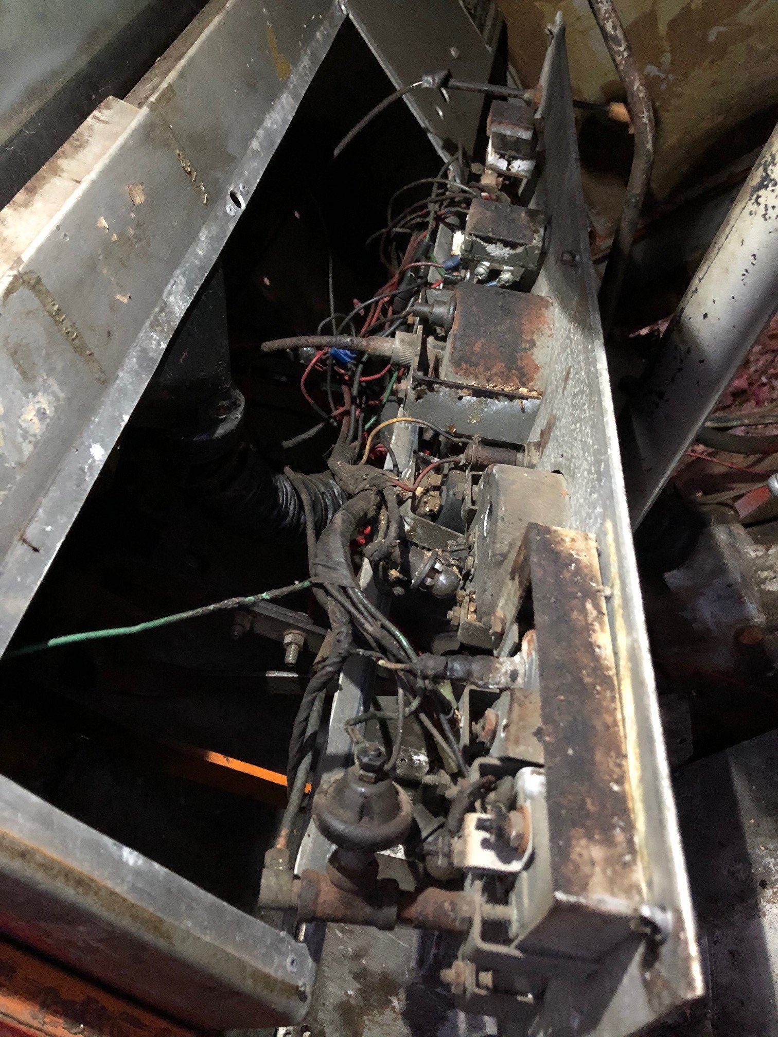

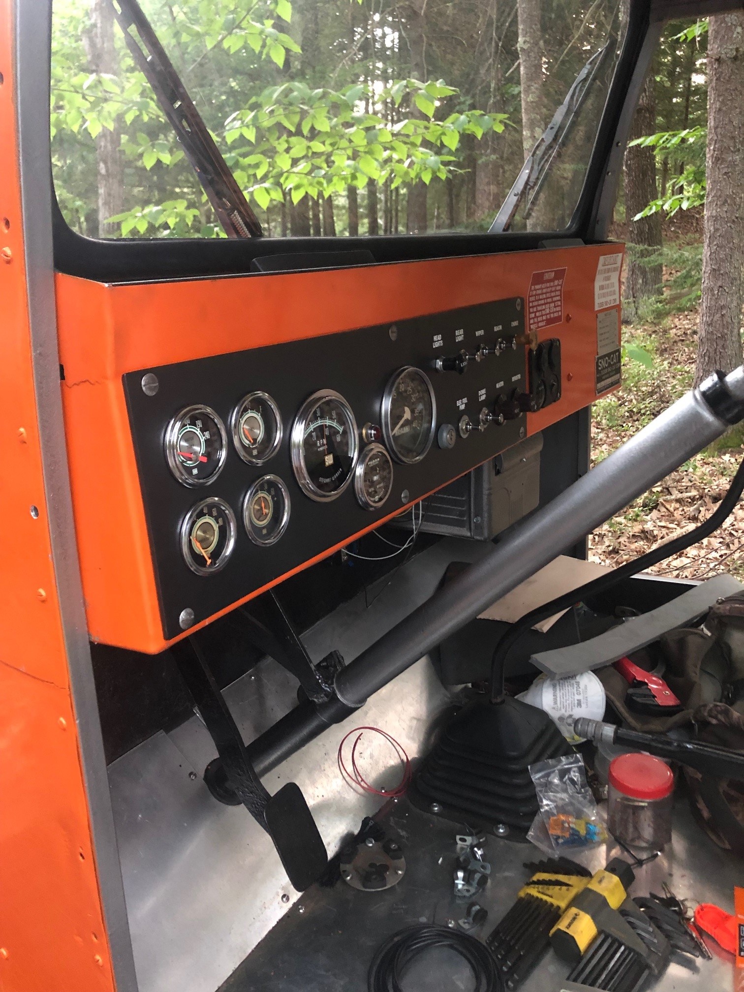

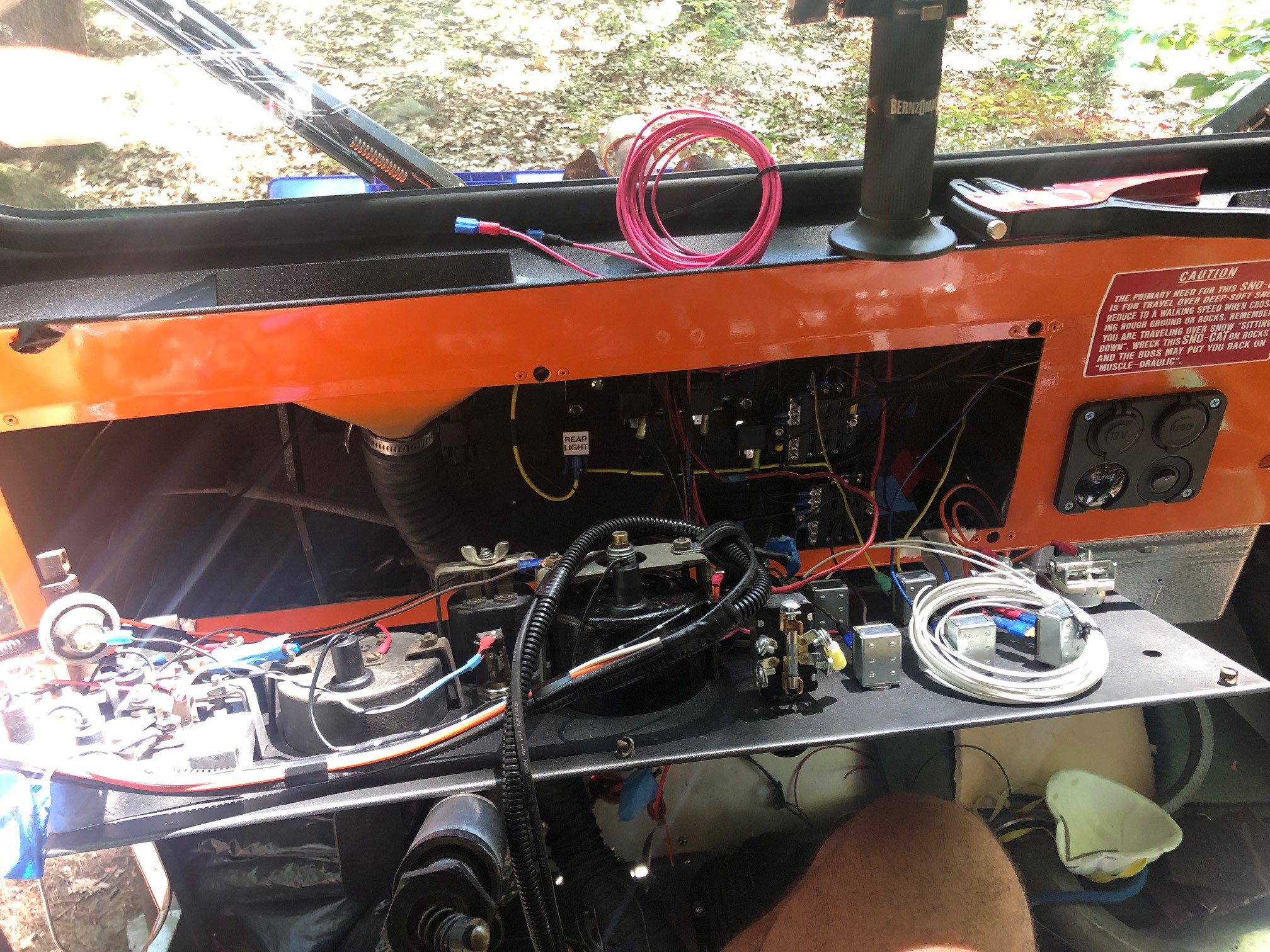

Busy week & weekend now that the heat finally broke. True hillbilly sh!t out front with an extension cord thru the woods to run a fan to make it bearable before that! Lifted both ends so everything could move freely. Hydraulic cylinder centered and draglinks adjusted to get front and rear running inline again. All tightened back up. Electrical dash work 98% complete. And by the grace of the Sweet Baby Jesus it all works as it should. Had a glitch with the 'auto park' feature on the wipers. I had run them multiple times without the dash in place to make sure everything was set. Of course, after reinstalling the dash the LH side sweeps half way and stops. Yank dash, cuss, test motor, cuss a little, check harness, cuss some more. Leave auto park unplugged and all is good. Screw it- I know how to push the switch to stop them at the edge. Cuss and reinstall dash, again. (Whoever got that task at Tucker when they were being built was being punished). The faceplate support brackets designed by the masters (Scott & BFT) worked brilliantly. Reinstalled radiator and all plumbing to start rehydrating.

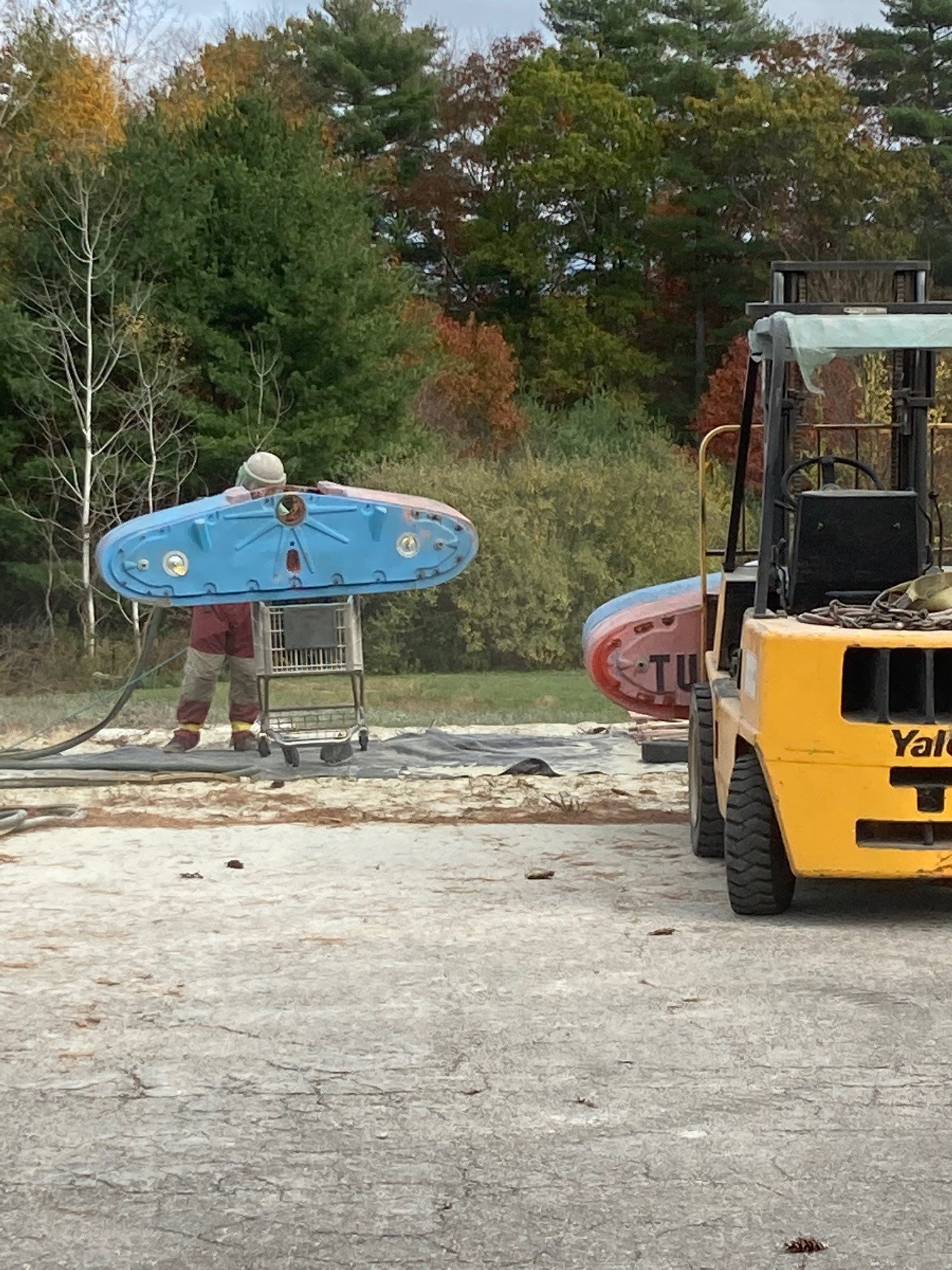

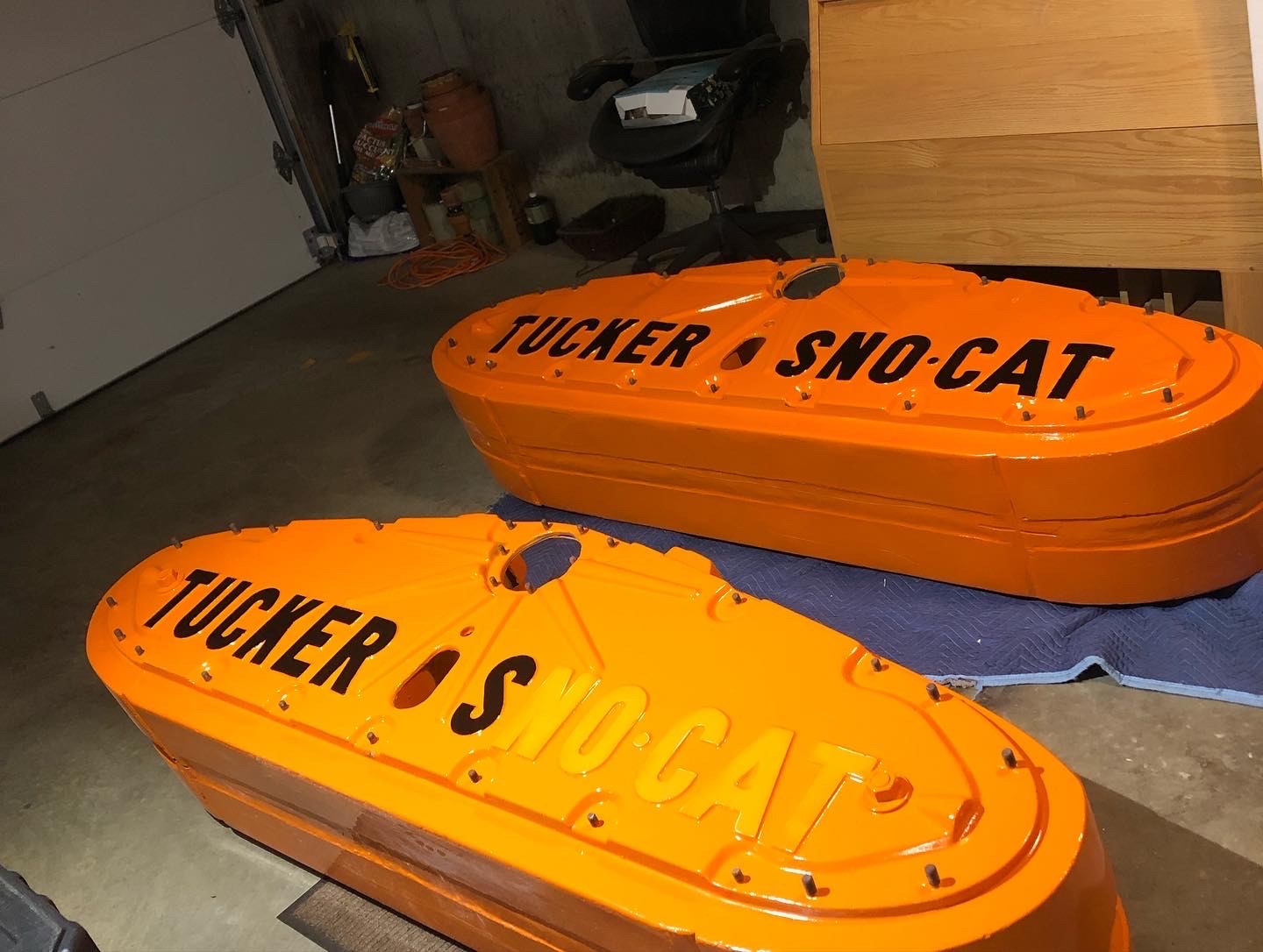

Tooned up

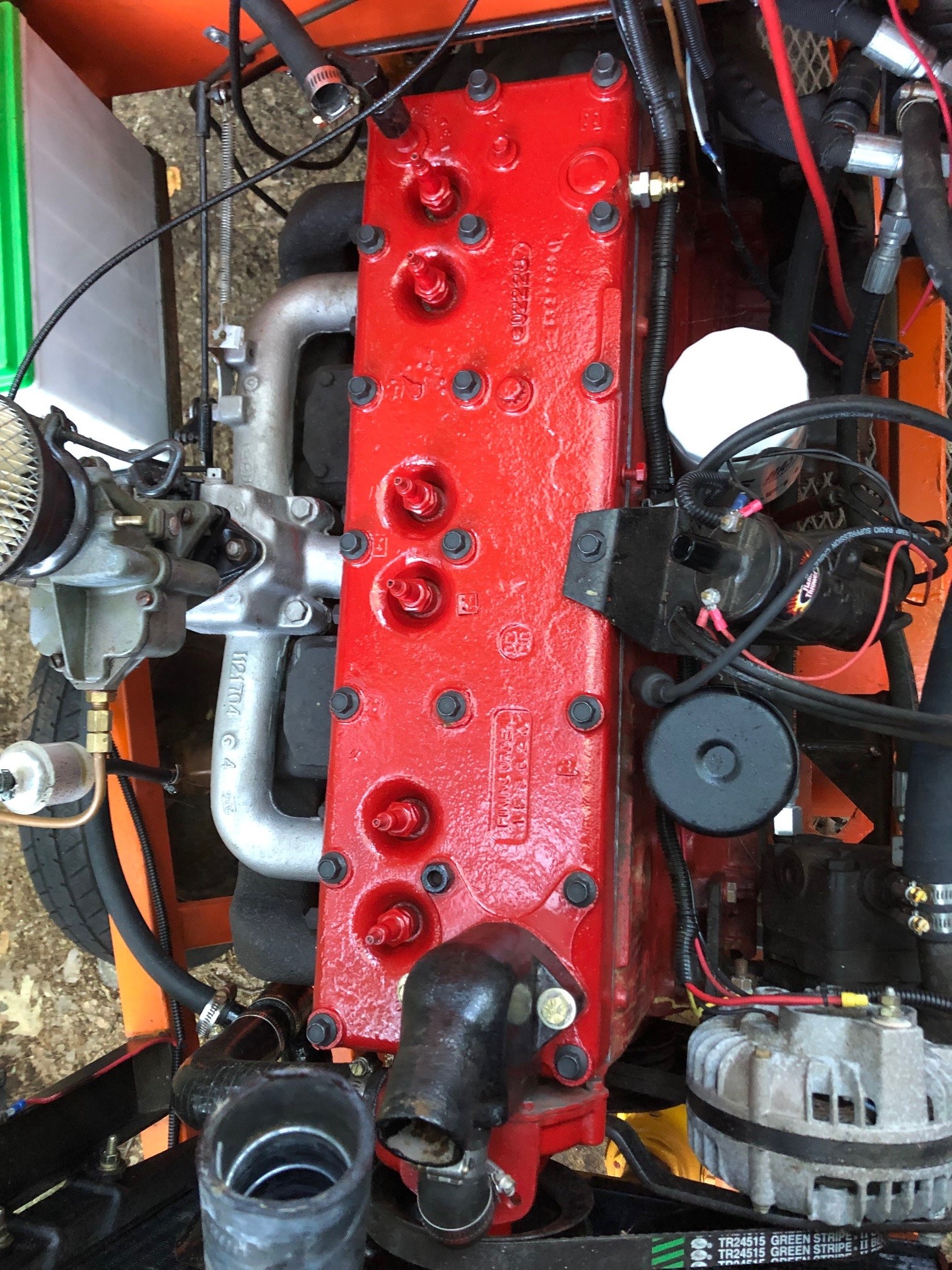

Labor Day gave the first run in 6+ years since I really started ripping stuff off. Front water bypass hole leak prompted multiple cuss sessions trying to figure out where it was coming from since it appeared to be the back of the water pump. New (correct!) head gasket installed and problem solved.

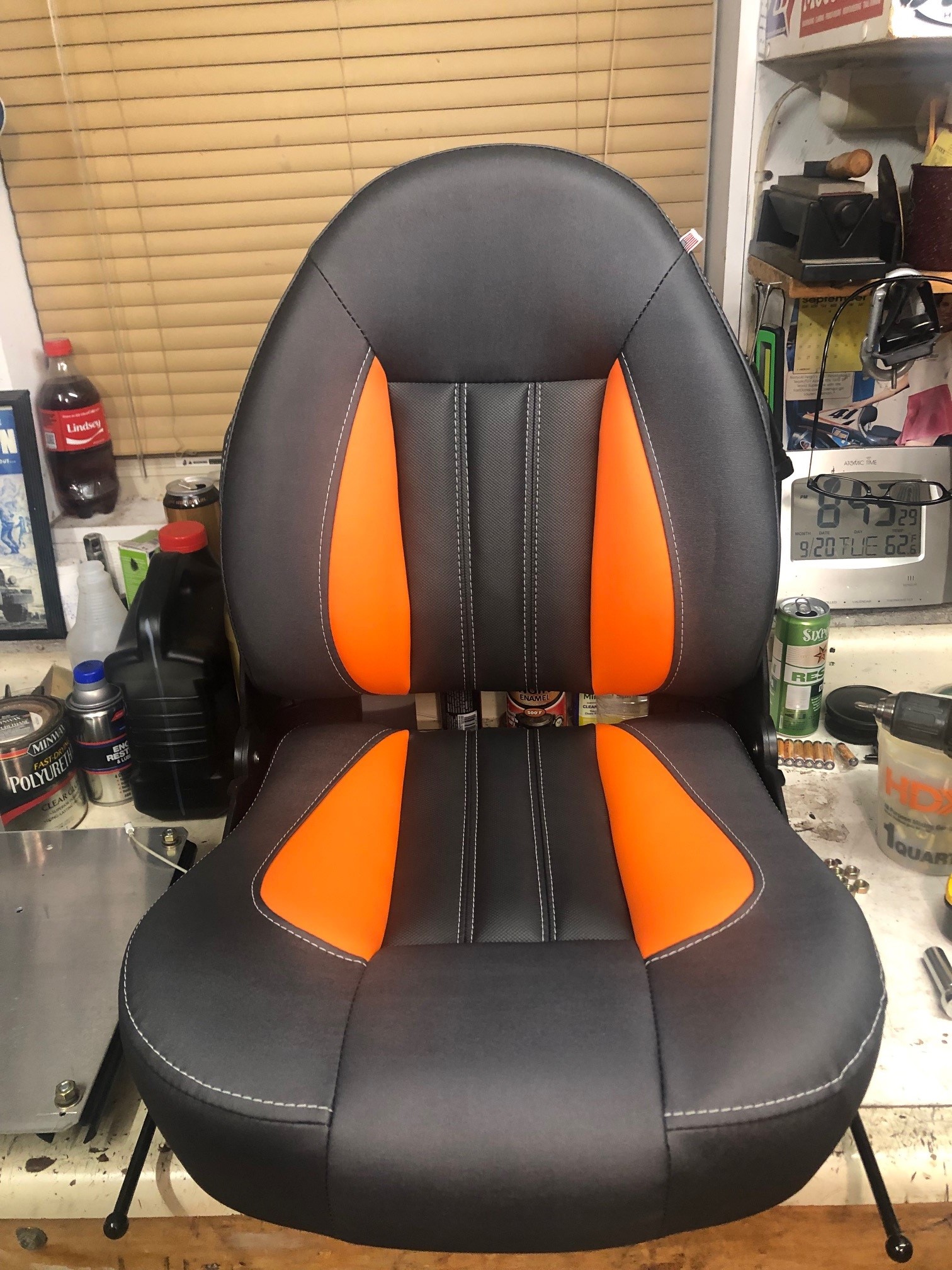

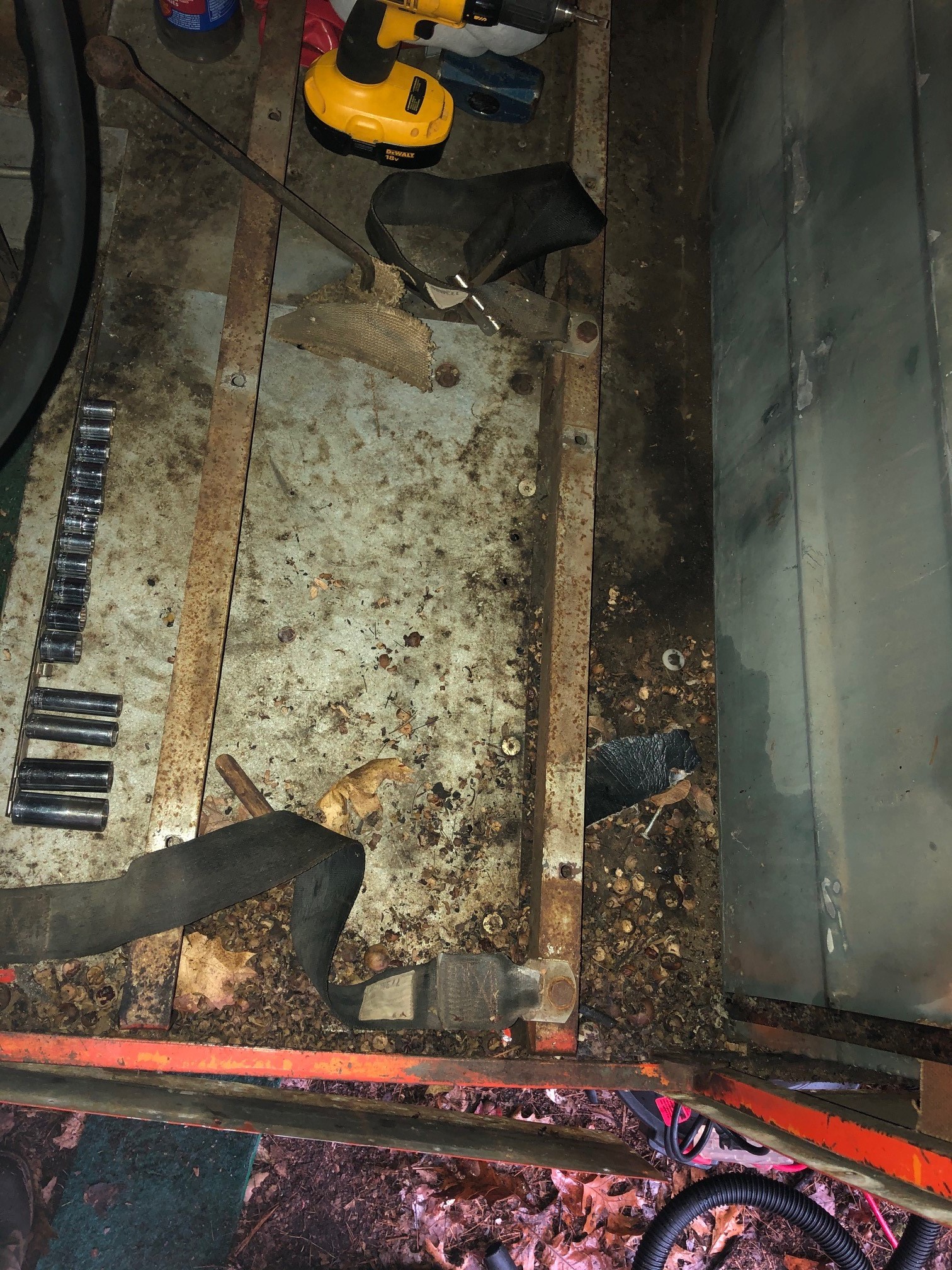

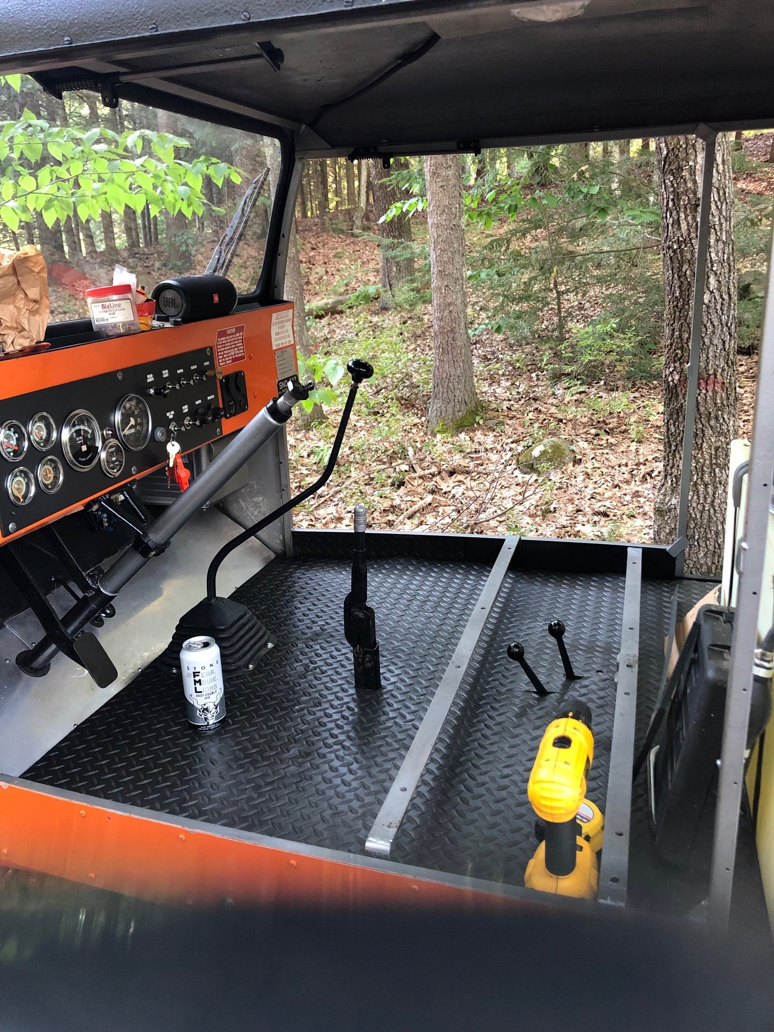

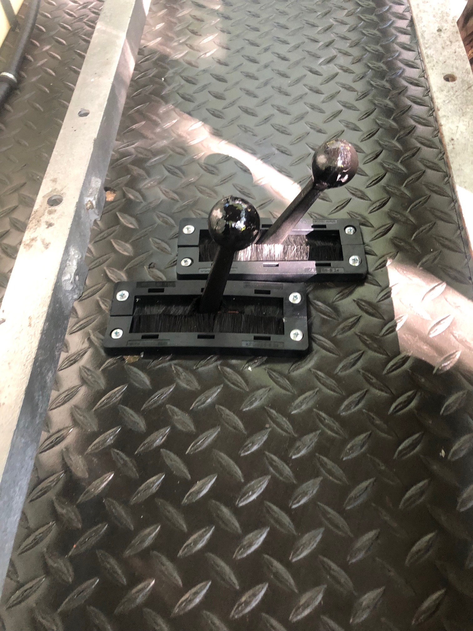

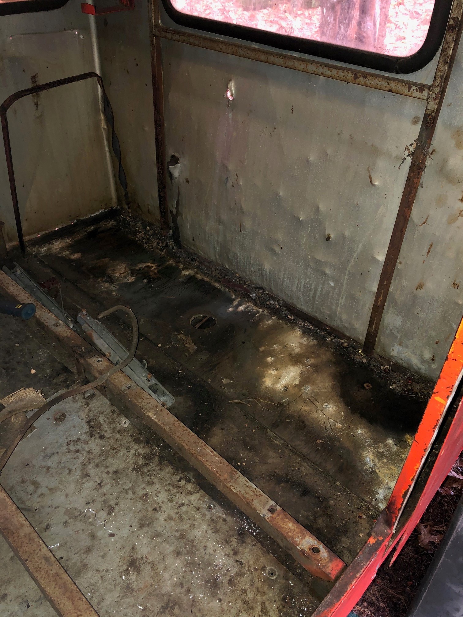

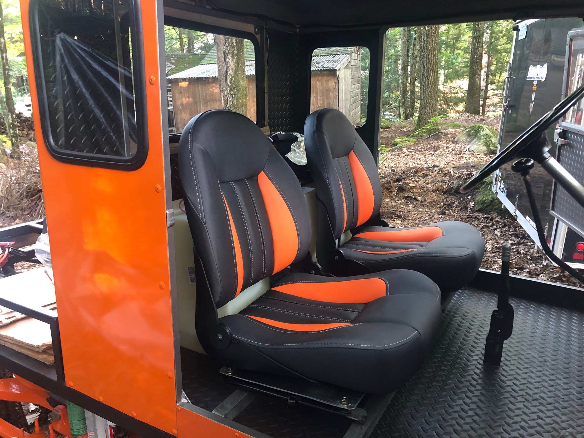

Got the mouse deterrent panels (doors) hung just in time for the fall nesting period. Seats installed. All glass installed. Back wall attached.
Round 2

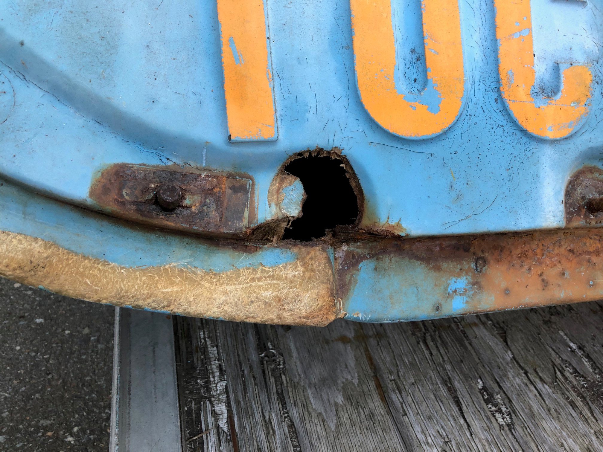

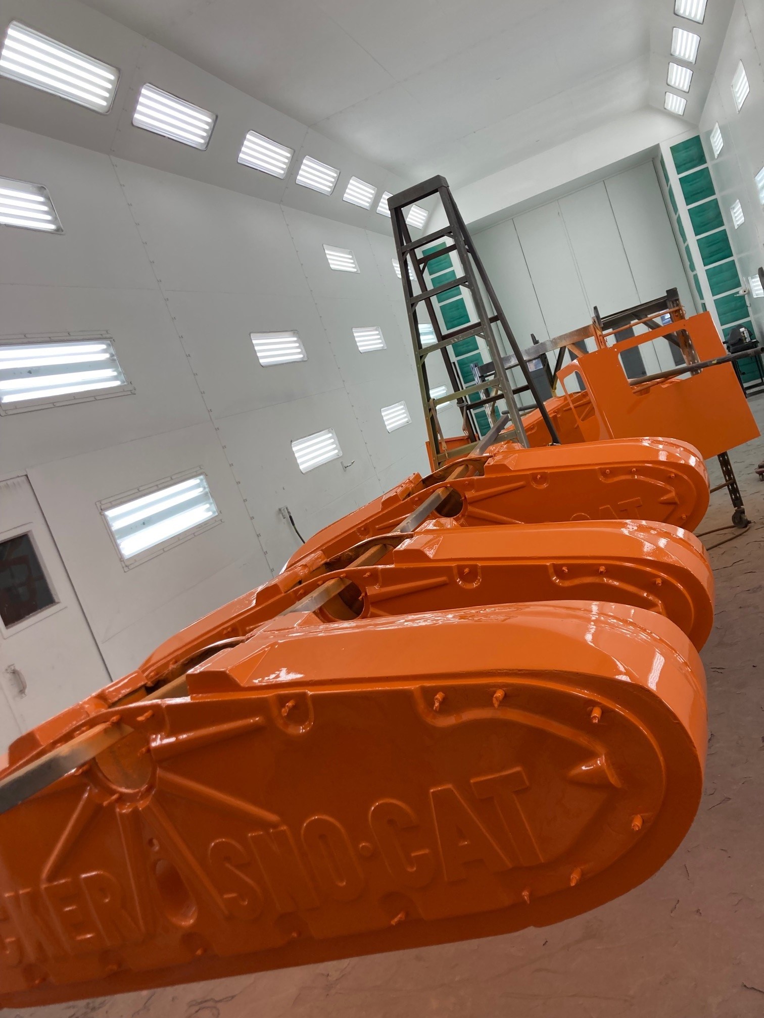

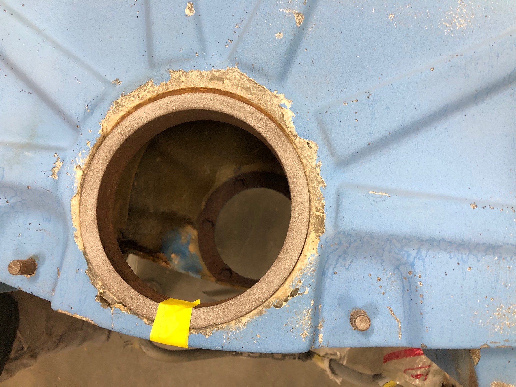

Did you have to replace any of the studs on your pontoons, this one looks like it was a goner. Did you just weld some stock threaded rod to a plate and sandwich? Curious how much of a paint the repair was :D
To quote, "a complete pain in the ass". It was accessed from the back side of the pontoon. A bolt and shaved fender washer were glassed in. You can see the plugs in this pic. Two needed to be repaired like this.

Spent yesterday getting the pontoon shoes cut and bent to match the template. Glad I had the day off! Took a little while to figure out the 'cheats'.

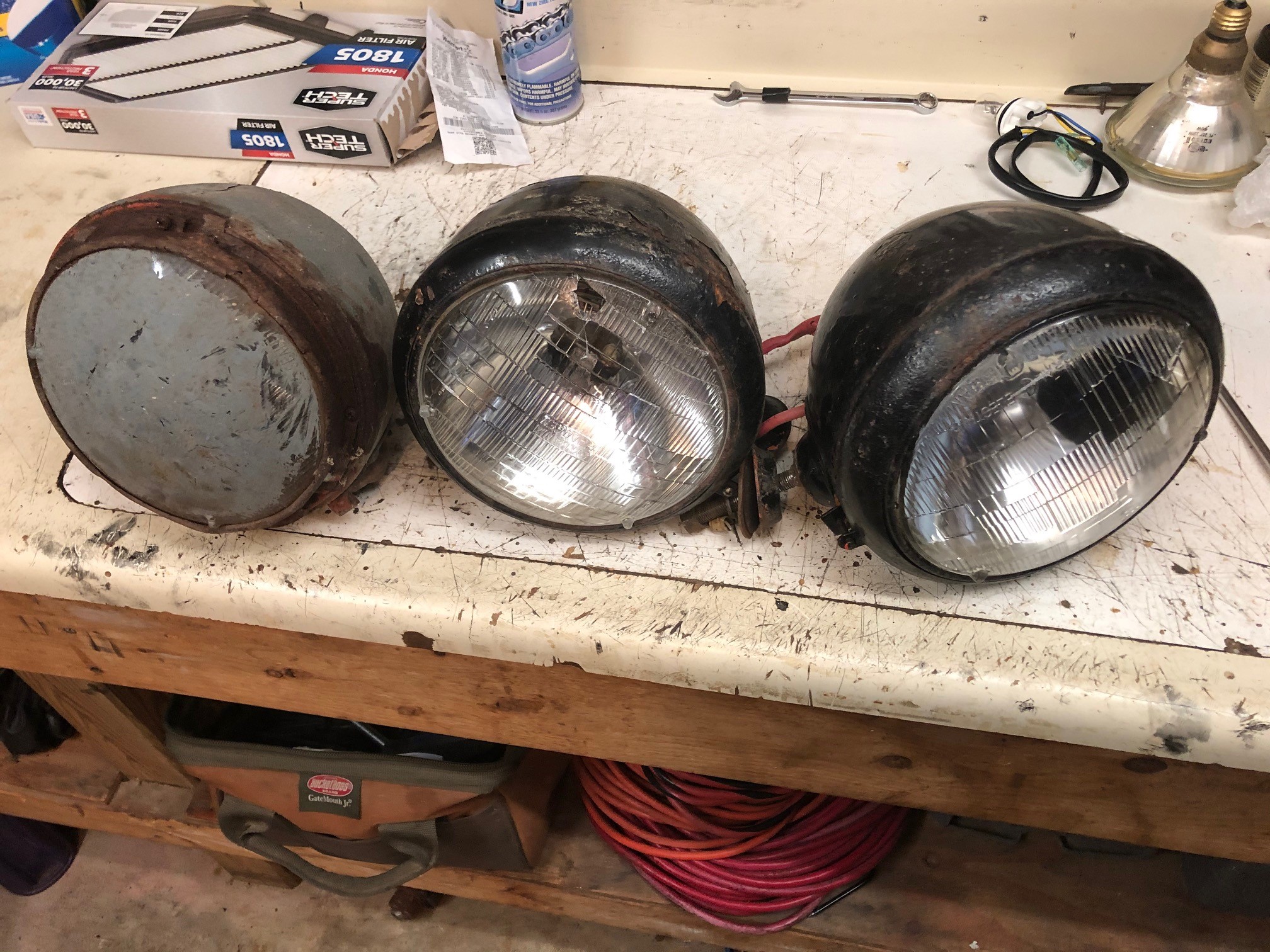

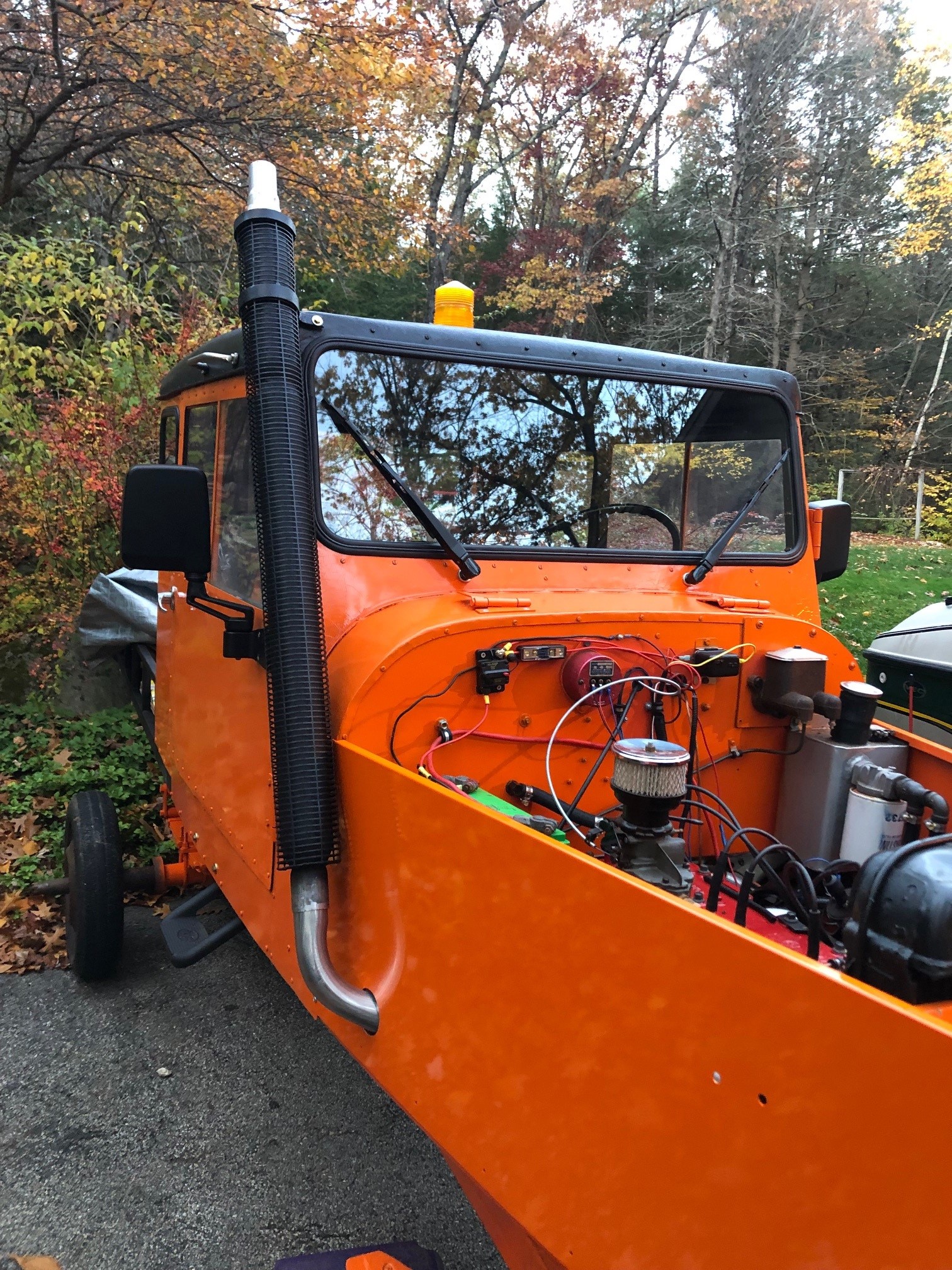

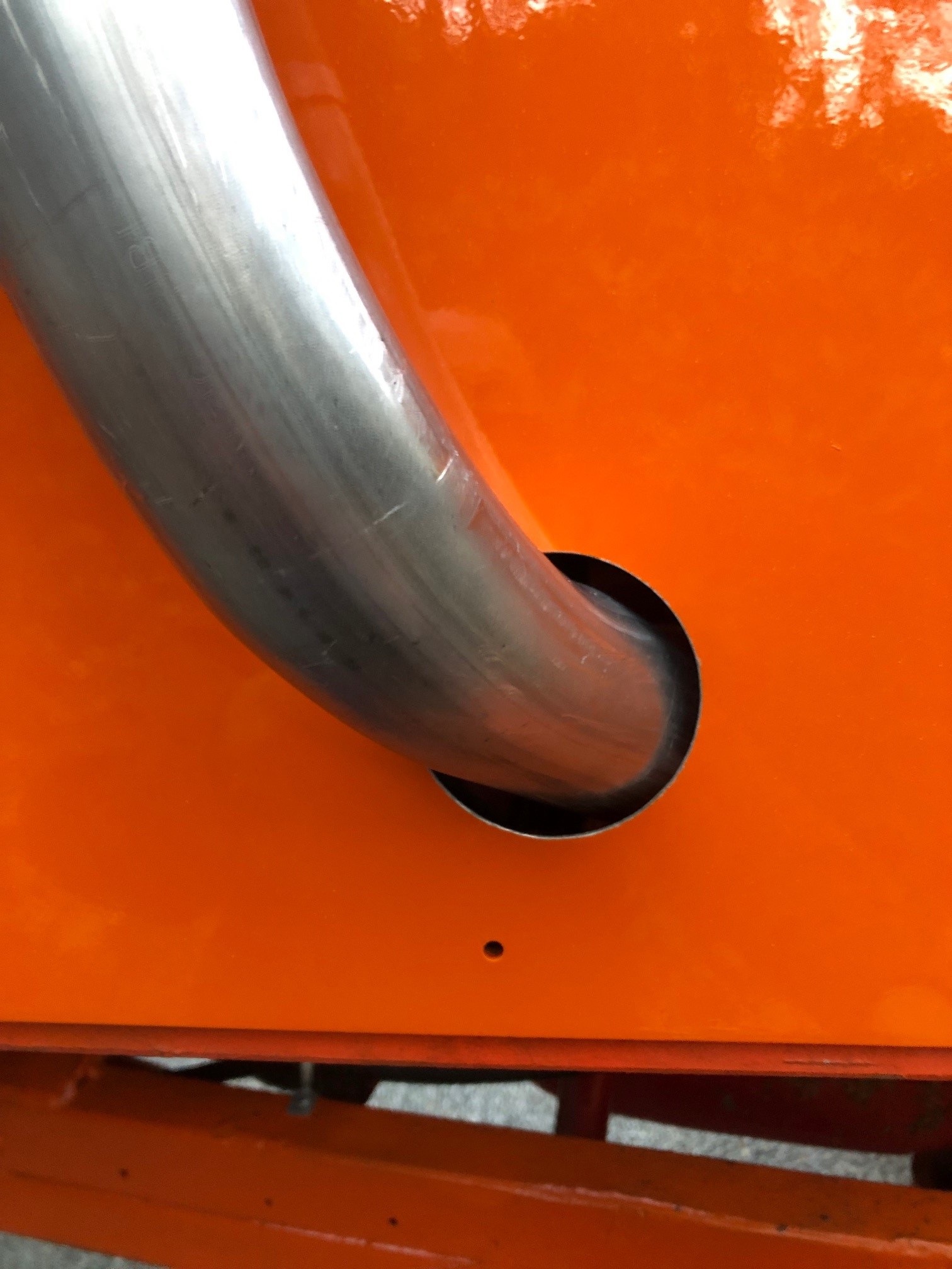

Mild update. All front panels & grill attached, exhaust run, headlights hung and lights providing illumination.
BFT: I was going to revamp the lower exhaust tube on the muffler section you gave me to try to make it workable, but no easy way for it to happen. PP realized this going in and gave me an intact OEM setup that slid right into place once I had the new outlet pipe bent. So, to pay it forward, if someone needs a muffler section (2" inlet / 2" outlet) let me know and we'll work out how to get it to you.
