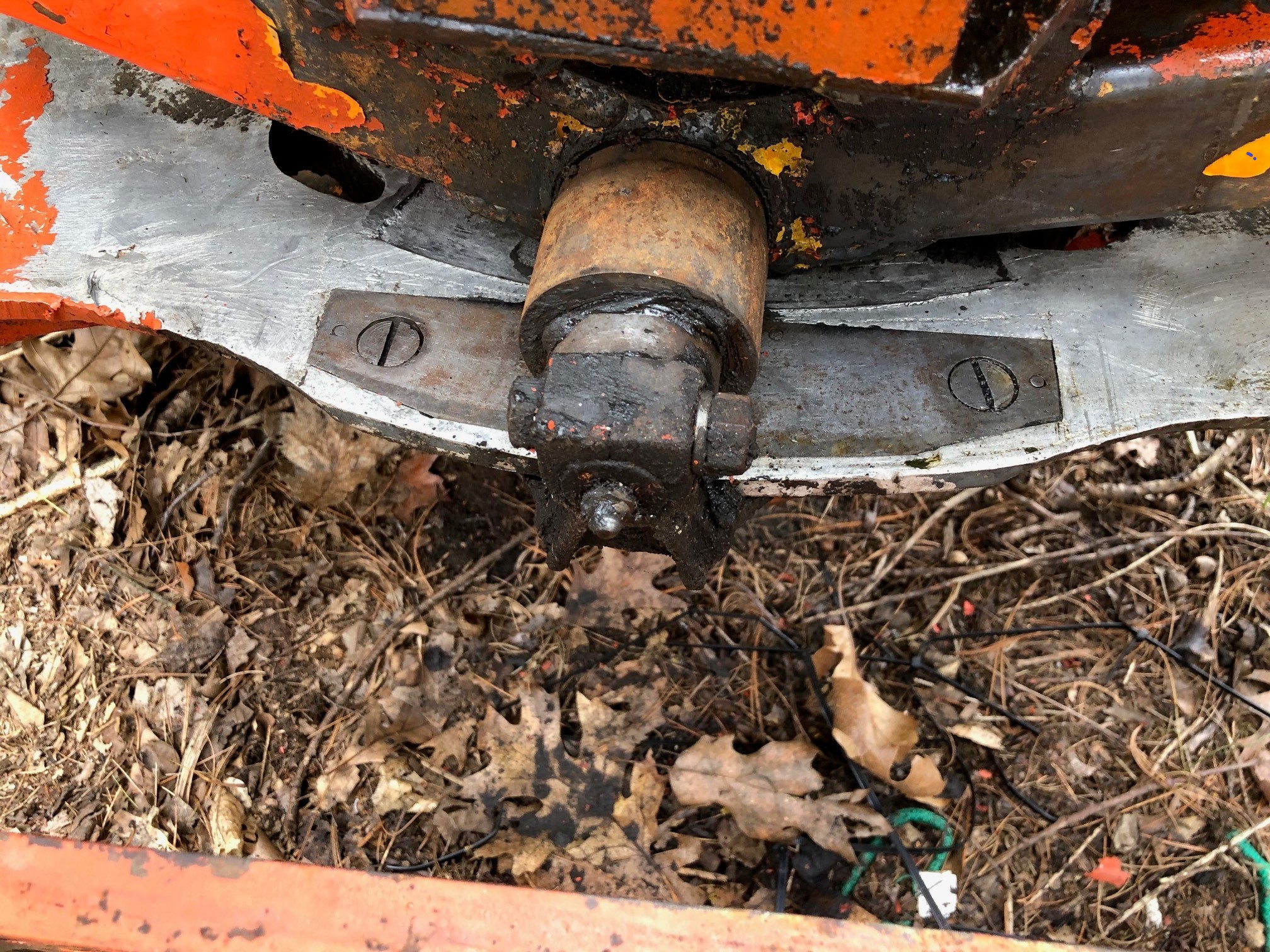

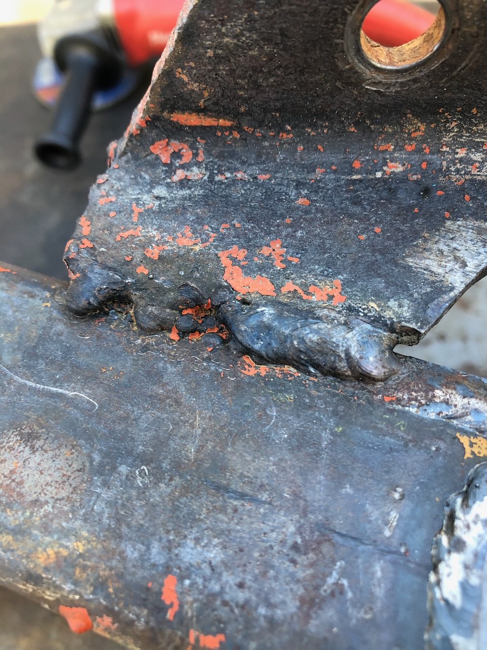

Hard to see in the picture, but there are bolts on top of the collar. The other end of the flat stock goes up to the master cylinder mount plate.

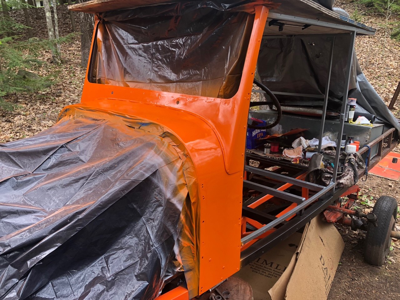

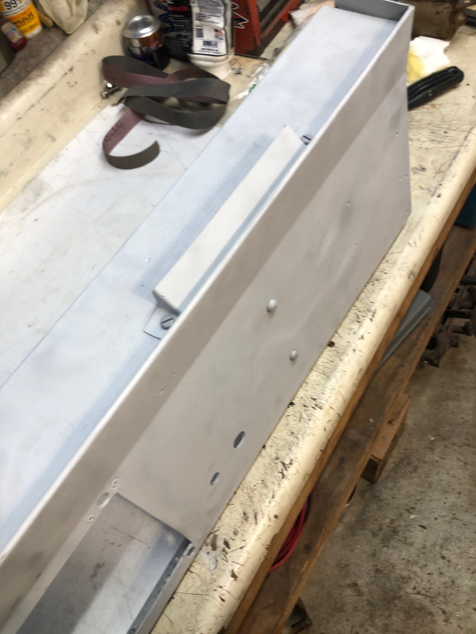

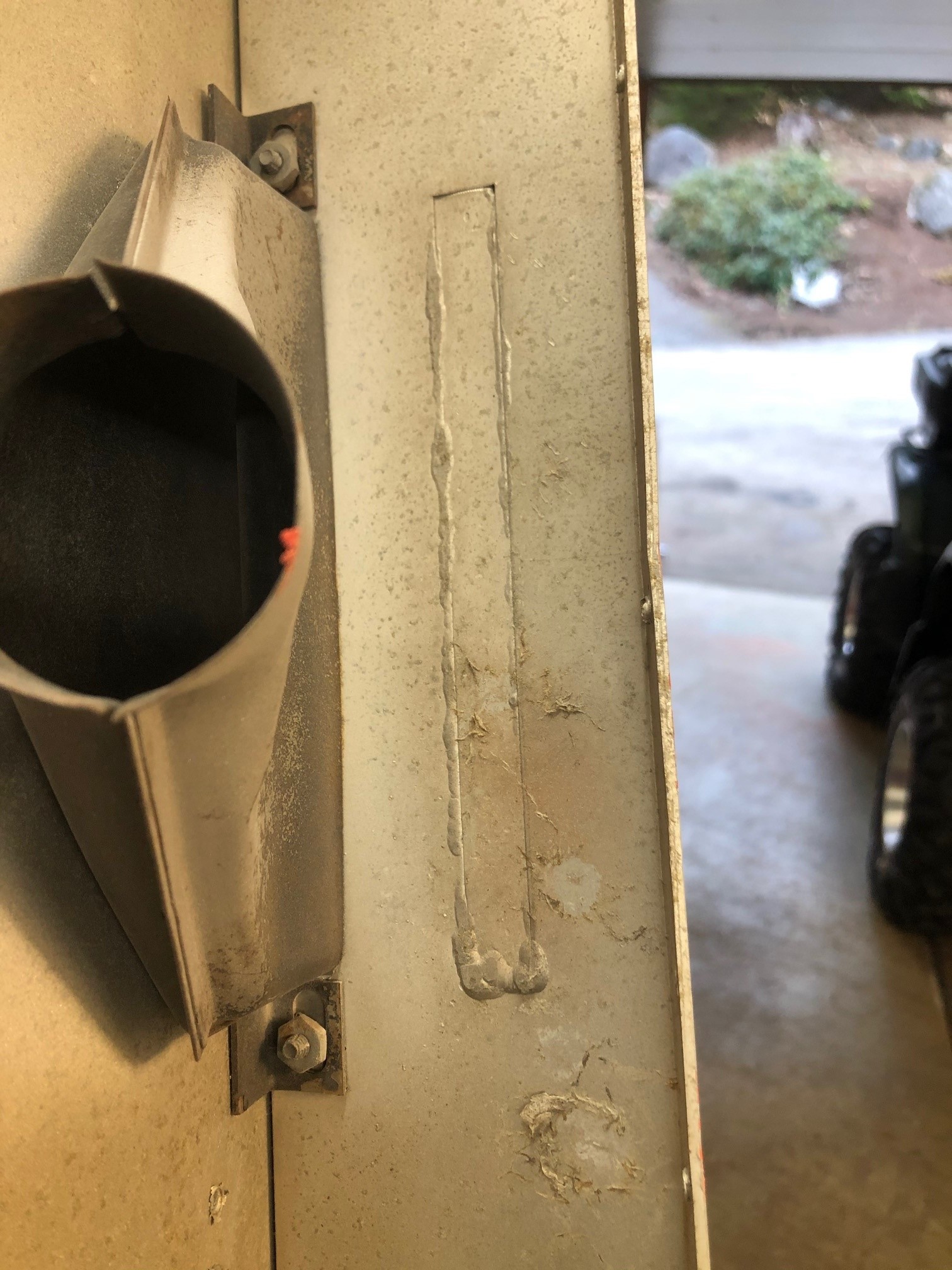

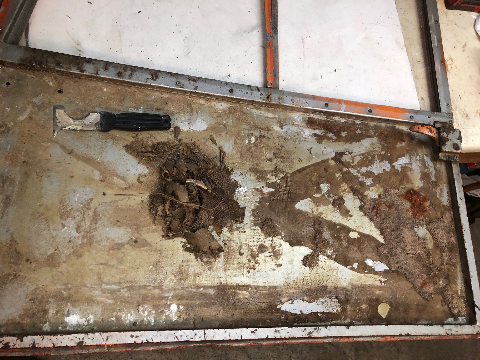

Apprentice mishap? I was bead blasting the dash frame yesterday and came across something interesting under the layers of mouse piss on top by the louvers. In the cabinet it didn't look uniform and thought I was missing spots. Turns out 53 years ago someone cut holes in the wrong spot on both sides. The correct ones got cut and patches were added in to fill the ones in the wrong locations.

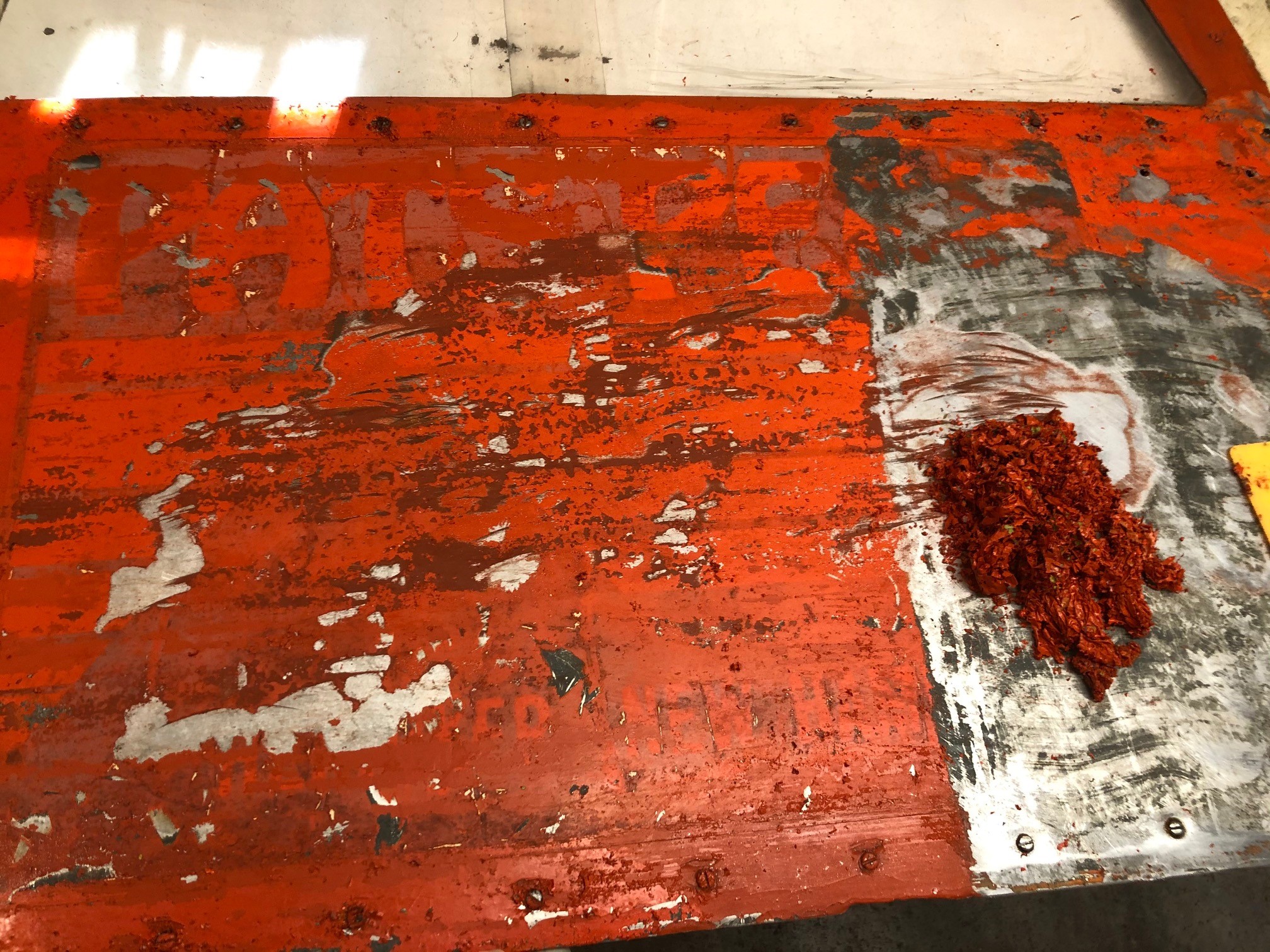

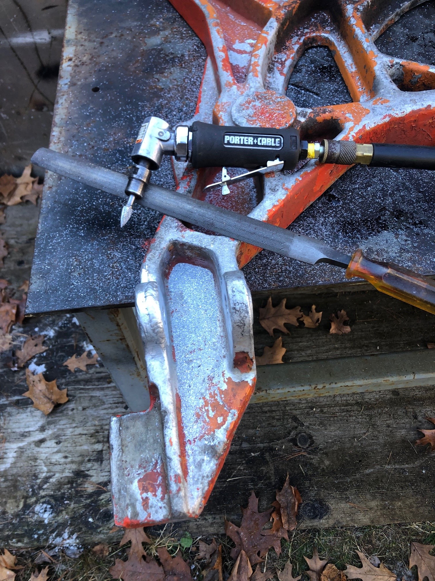

Using a grinder on decals Hmmmm ... sort of like using a Howitzer to kill a mouse ????
The are some very nice bomb can spray on goods to remove decals....

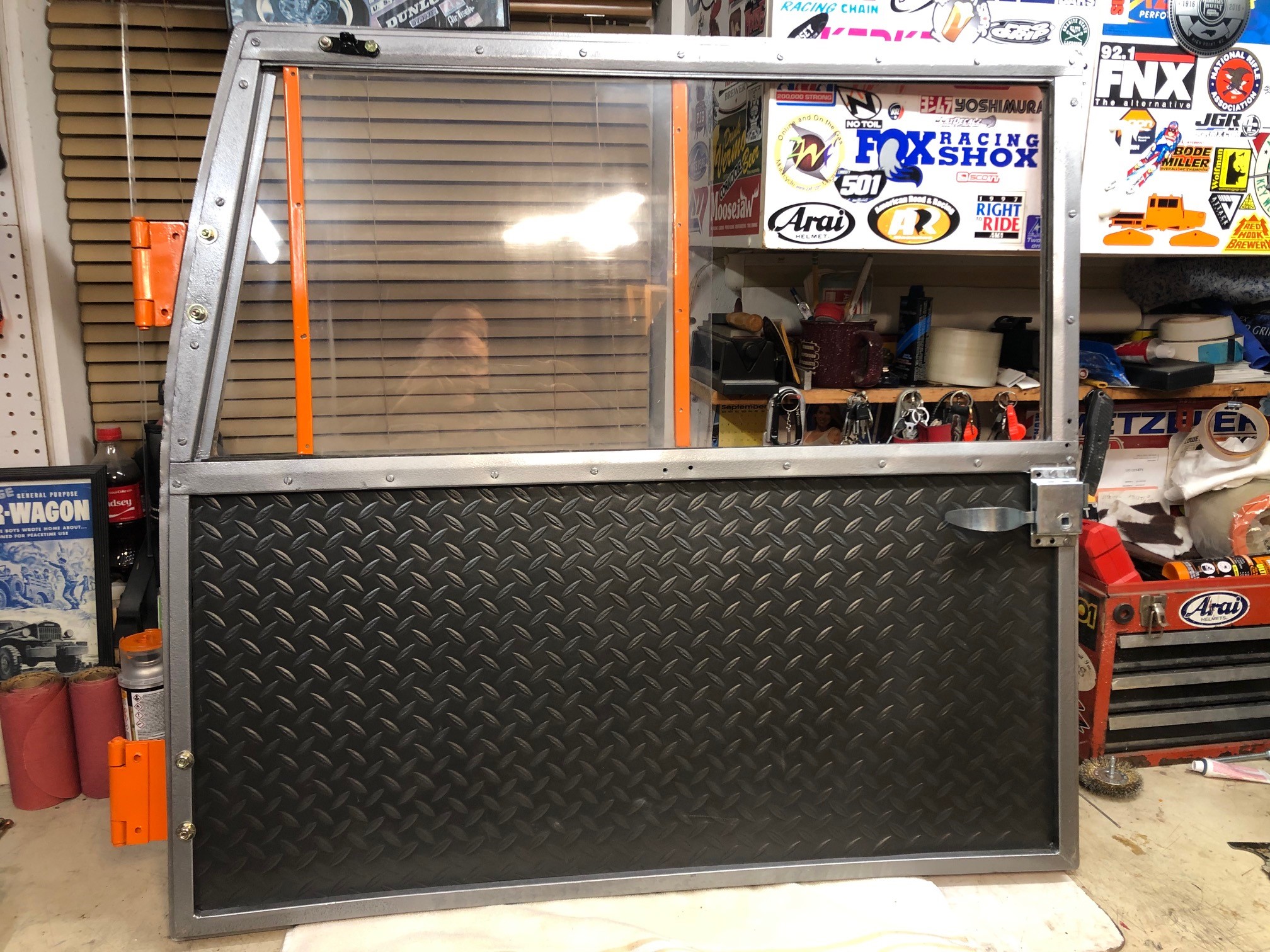

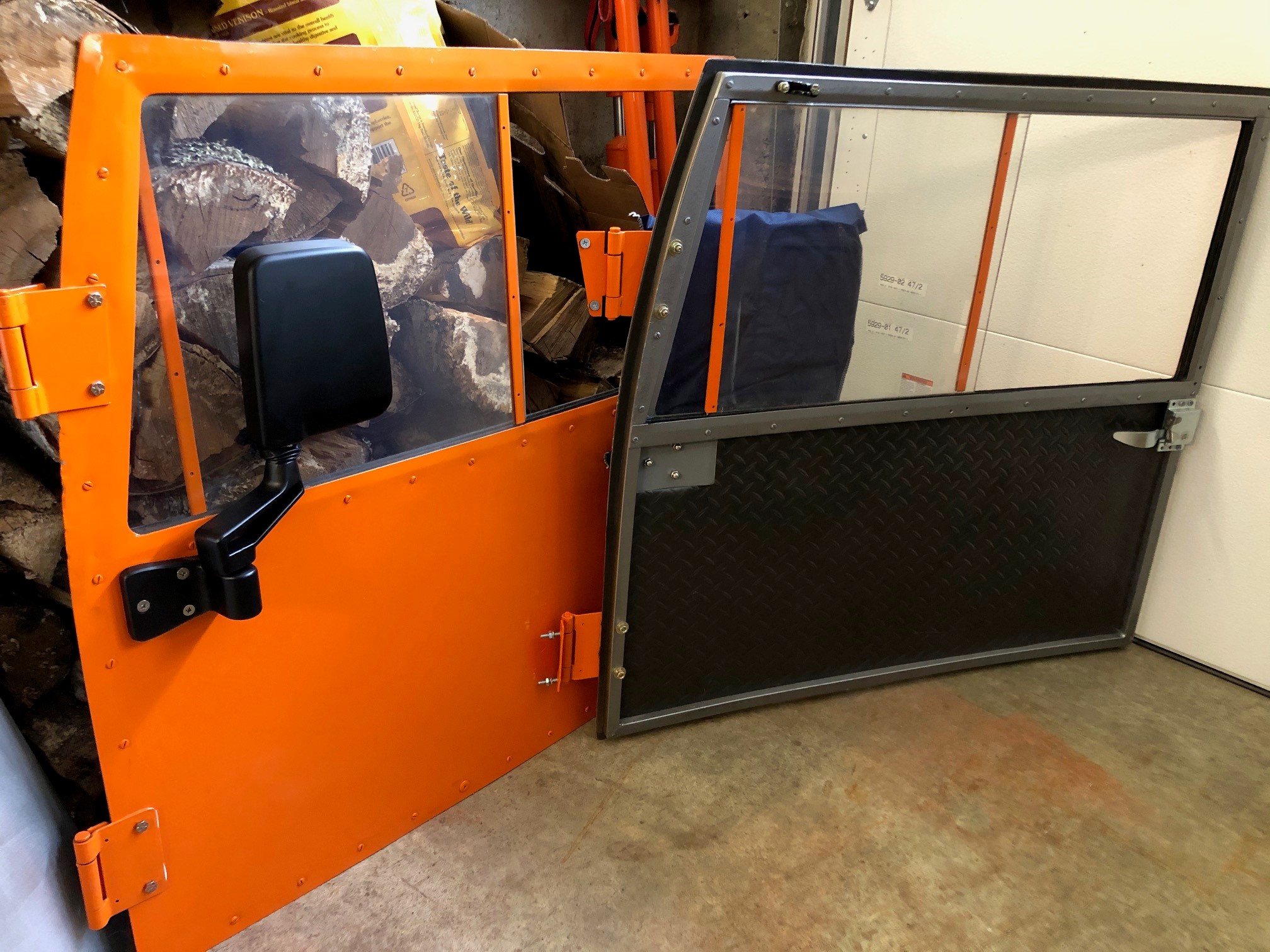

Doors looking very nice.

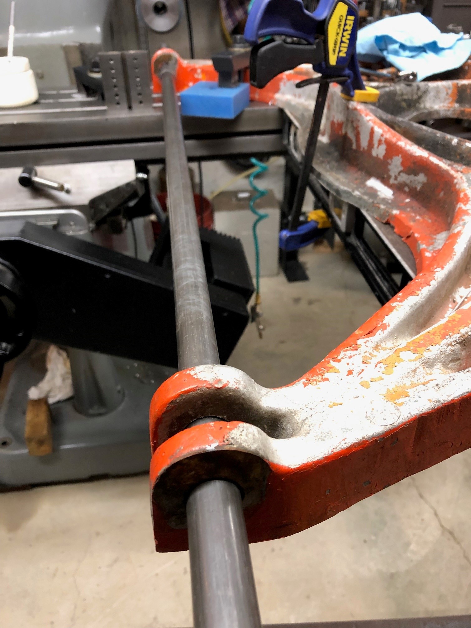

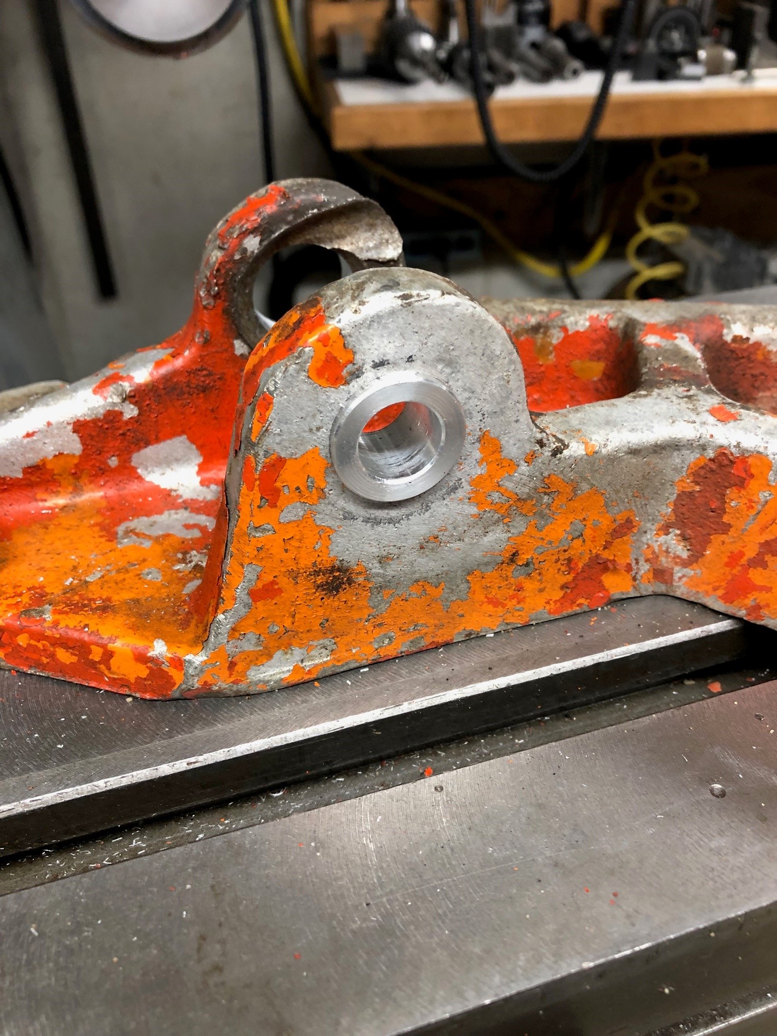

Between springs rubbing and nuts without washers (WTF??) it was pretty ugly. Bored, bushed, filled and welded.

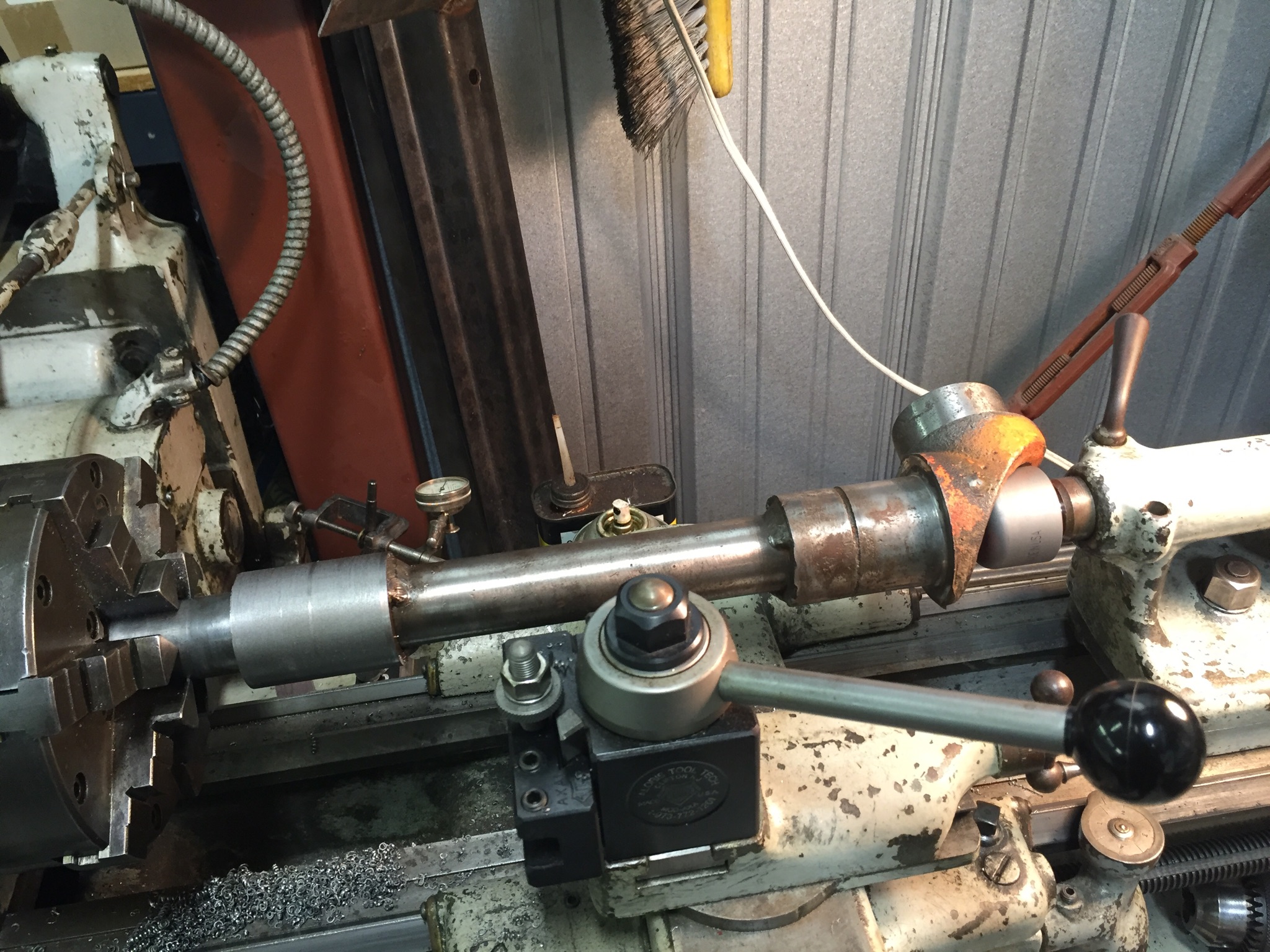

Trunion pin was all out of round and pitted from over greasing ;). Turned everything down, re-sleeved and turned back to specs. More to come on this as work is still in progress.

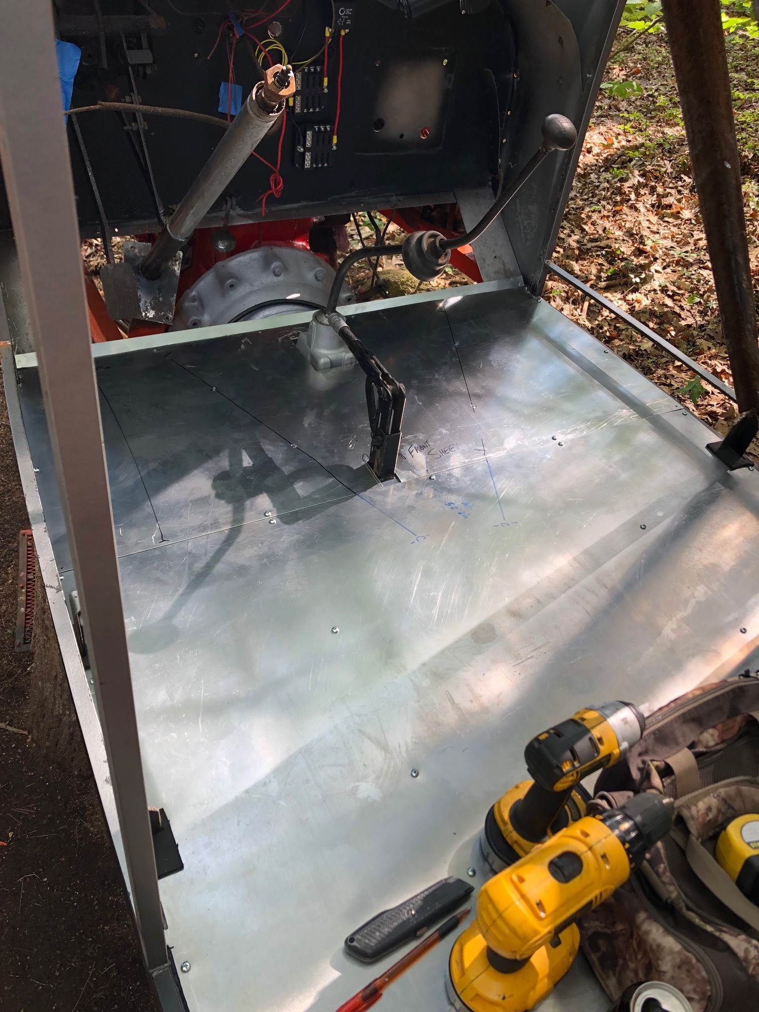

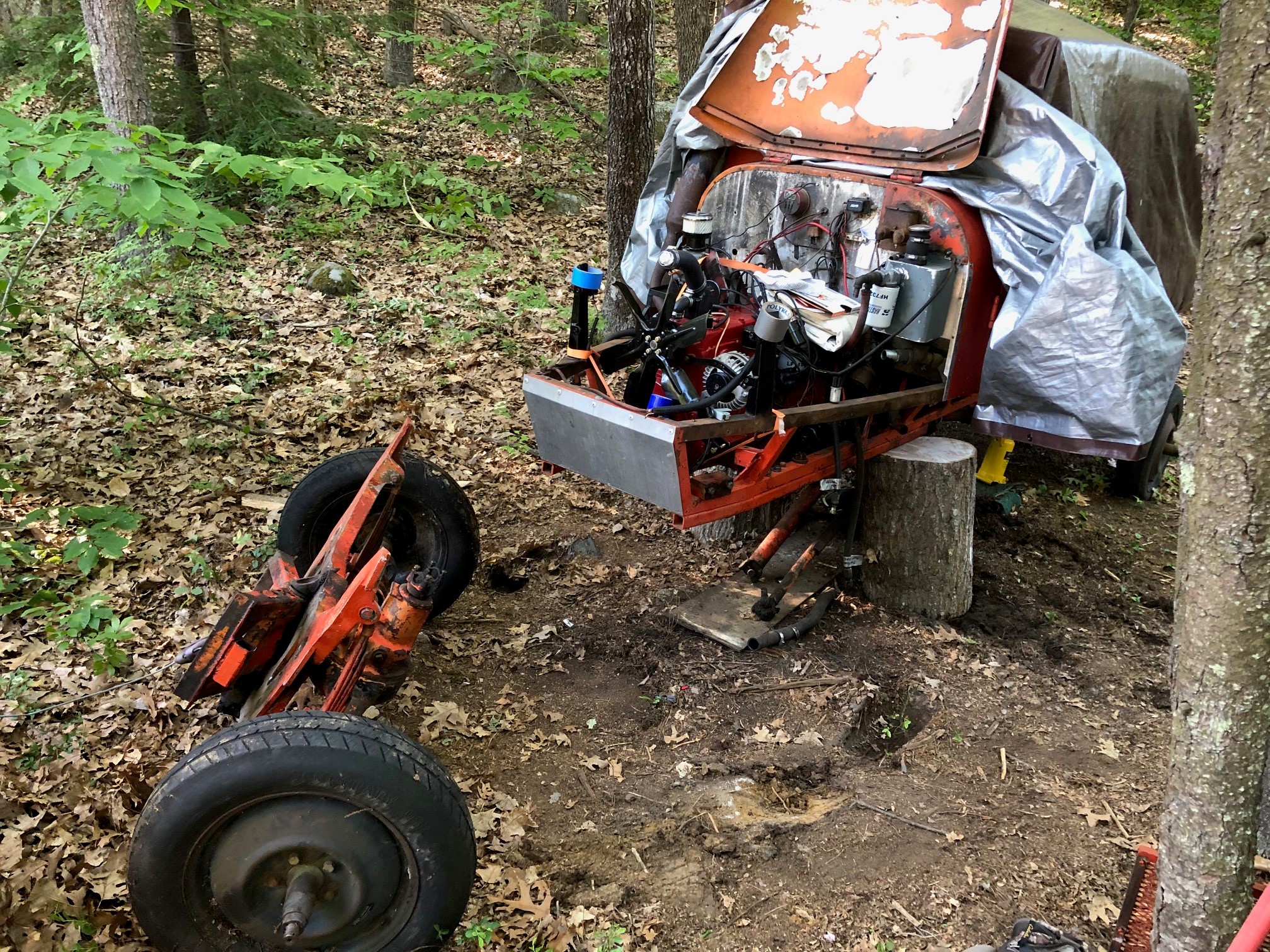

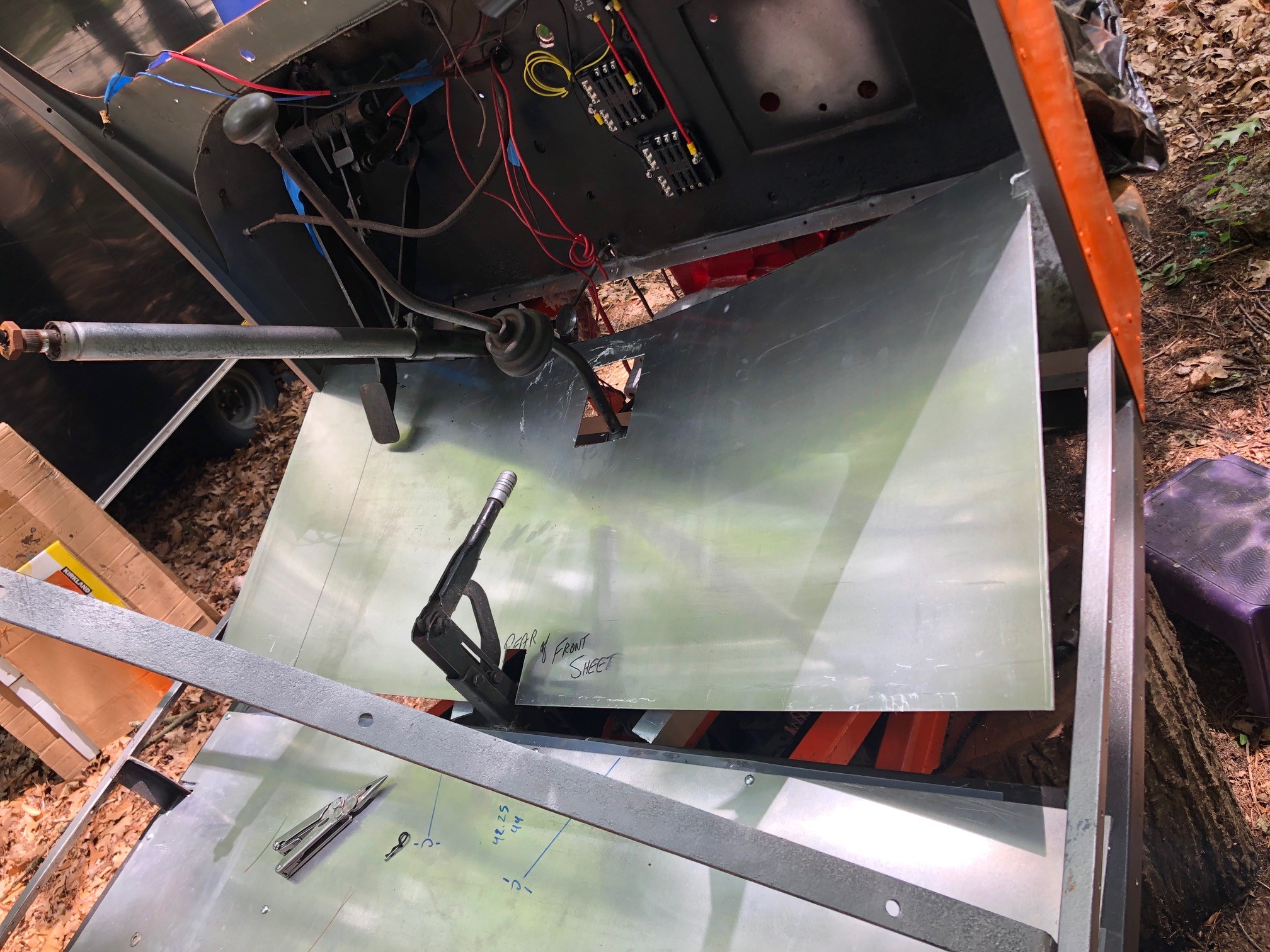

Slow going in the NE with the tropical weather in place for July (unlike the rest of the country). Rain 20 out of 23 days. Already the rainiest July and the 5th wettest month in recorded history. But, floors cut, installed, supported and screwed. Teflon tape applied between frame and sheets to stop galvanic corrosion and deaden any metal to metal contact. The .090 will certainly hold up better than the .063 I pulled out. The old floorboards were completely distorted.

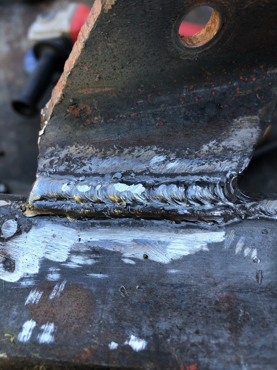

Finishing up work on the front (finally). Had tons of repair work to do to get it back to right. Springs and bolt threads had hammered the spring hanger holes, so everything had to be realigned, straightened, bored, bushed, welded. A complete shit show. Thank goodness I have friends with tools.

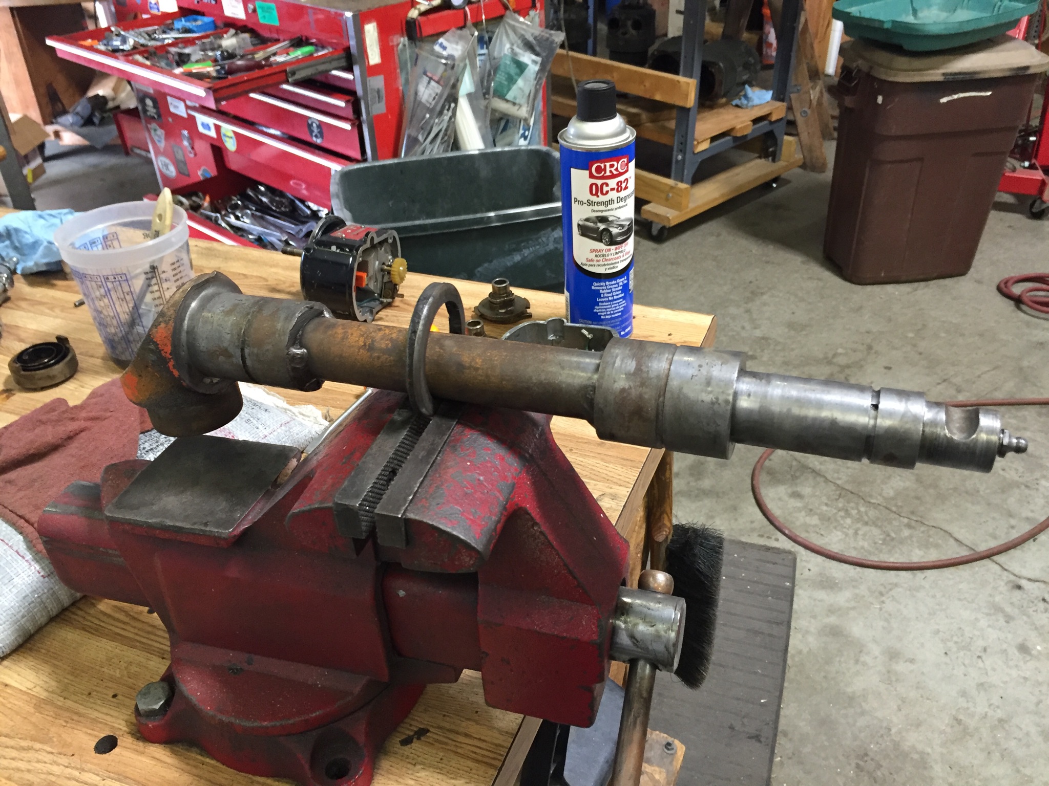

Thanks to TA and Drifter providing their wisdom ahead of time to guide the way (https://www.forumsforums.com/threads/1973-tucker-sno-cat-1443-new-to-me.75566/page-24#post-20679068). The trunnion was only slightly out of round, so it got a light pass to make true again. The pin was a different issue. The only real solution was up in post 168. Take it down, sleeve it, weld it, turn again to specs. The front roller was a mess. It was installed incorrectly at some point which explains why it was farther to the rear than it should have been. As you can see in the first pic, it may have been moved back to potentially increase the angle and keep the trunnion and turntable from making contact. Either way, a 1/16th needed to be added front & rear to keep the two from kissing. And like TA's, there was plenty of slop front to rear (1/8") on it as well. So, the pin taken down so that a .062 top hat sleeve could be pressed on and a flat 'shim' added to the bottom. This will ride in a bronze wear sleeve in the turntable (no pic). Shims added to stop the linear slop as well.
