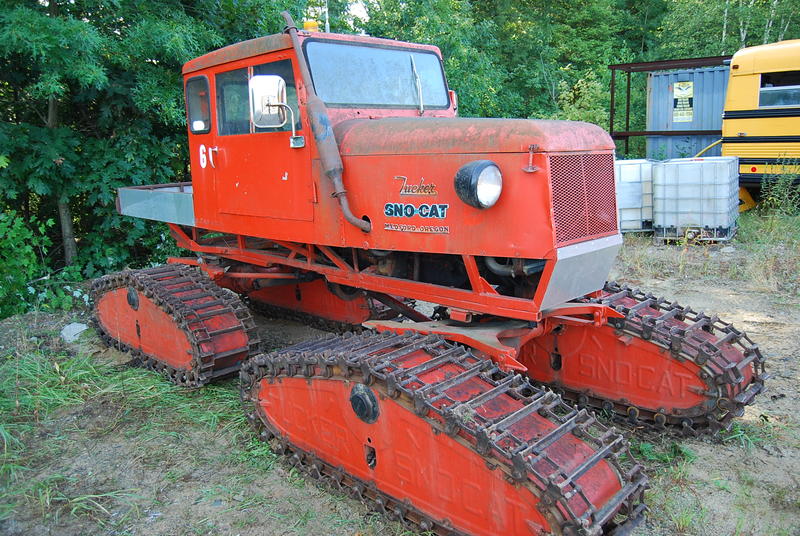

It’s tough to figure out where to start. My buddy Dave had wanted a steel track Tucker since I’ve known him. There was one for sale in Colton, NY by our camp several years ago, but I just thought he was nuts. So many parts = so many problems. (And still may be!!) I told him he was out of his mind and I wasn’t jumping on his loony wagon!
Five years pass and my kids are now at an age (7 & 9) where they can enjoy the winter outside on their own. Another buddy of ours sends me a link for a 5 man 252 Ski-dozer that is being sold by a religious camp up in Maine. Now this gets my wheels turning thinking that it would be great to utilize our camp all thru the winter, not just one special weekend trip in February to X-C ski and snowshoe. All of a sudden I’m the one that is looking around for snow cats. I try to find info on the Ski-dozer (which is out of my price range anyway) and cross paths with this forum. I proceed to lurk for a year just reading and taking it all in.
Dave must have planted the Tucker seed in my head all of those years ago because I’m being drawn back to them over & over. And with Cook’s only a state over, help’s not too far away. Then it happens. Stu (Mtn-Track) decides to show details of his Tucker: ‘An Old Cat’s Tail’. :w00t2: Well that was the kick in the ass I needed to really start looking. In December 2010 I buy from Stu the last two brand new 400 series pontoons made. Since he switched to the 1500 series tracks, he didn’t need them. Now realize I don’t even own a sno-cat of any type at this point. I’m just going on the assumption that whatever I find will probably need help on at least two of the pontoons.
Forward to August 2011. I’ve been looking pretty hard for something in my price range that’s close. There is even a Tucker 442 in an old museum near me that I was working on acquiring, but the eccentric old coot will probably let the building collapse (literally) around it instead of selling it to be used again :hammer:(we’ll see what happens with that in the future). I just happened to check Craig’s List for Tuckers one hot sunny day. Now I’m already thinking that I’m going to have to retrieve something from several states away if something is listed. A 1967 442 pops up in Groveland, MA only about 30 miles from where I work for $3500. I call and set up a time to go look at it. It’s dirty and has some issues, but for the money it’s ok. The previous owner bought a group of 4 as a package deal from Pat’s Peak in NH; three 442’s and one 443. He has a camp in Maine twenty miles off the main trail corridor. His family and the other 10 families that have camps in the area wanted the local snowmobile club (of which they were all members) to groom just once a month out to their location. The club wouldn’t do it. They bought an Alpine, but kept having troubles with it. So the Tuckers were purchased. One was immediately designated the primary groomer (the one I bought) and all of the best parts from the others were put on this machine so they could groom with limited issues. The 443 also received a total restore and was run for a few years, before someone stole it off the trail after they had left for the weekend. It still hasn’t been found. The 442 worked for a couple more years then in 2009 was brought back to Mass to be replaced with a Tucker 1000. So, when I bought it, it hadn’t run in a couple of years. But it did drive onto the trailer under its own power. So I wasn’t too worried about the old flathead.

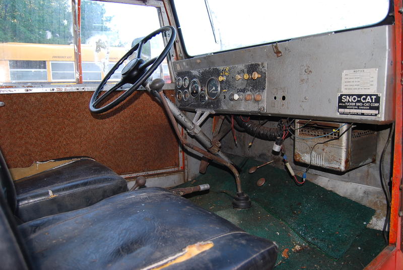

The interior needing some TLC:

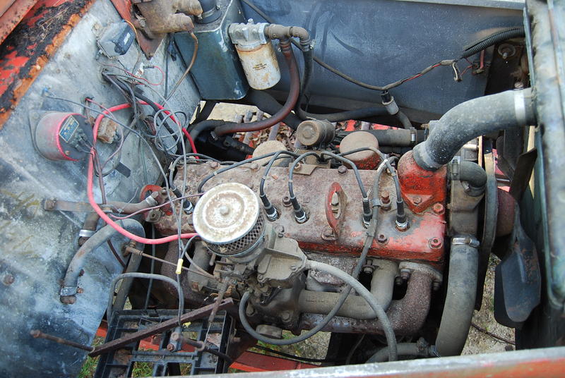

I didn't even want to start it since it had been sitting for 2-3 years. So we hooked the pindal to a tree with a chain and just pulled it off of the trailer. I put in a new battery, pulled the plugs and added a touch of Marvel Mystery. I let that sit for a day, then came back and spun it over with the fuel line disconnected before the fuel pump. The fuel stunk to high heavens, so glad I didn't try to start it. It was free spinning and with no odd noises.:biggrin: Once the bad gas was out, I dumped in 2 gallons of acetone and sloshed it around a couple of times a day for 2 days. I drained that out, dumped in 5 fresh gallons w/ some Sea Foam added, and primed the fuel pump and carb. Hit the key and after about three seconds it fires up and goes into a rough idle (because of the mystery oil). She smokes for a few minutes, clears out, and then purrs like a kitten. I was psyched!:w00t2:

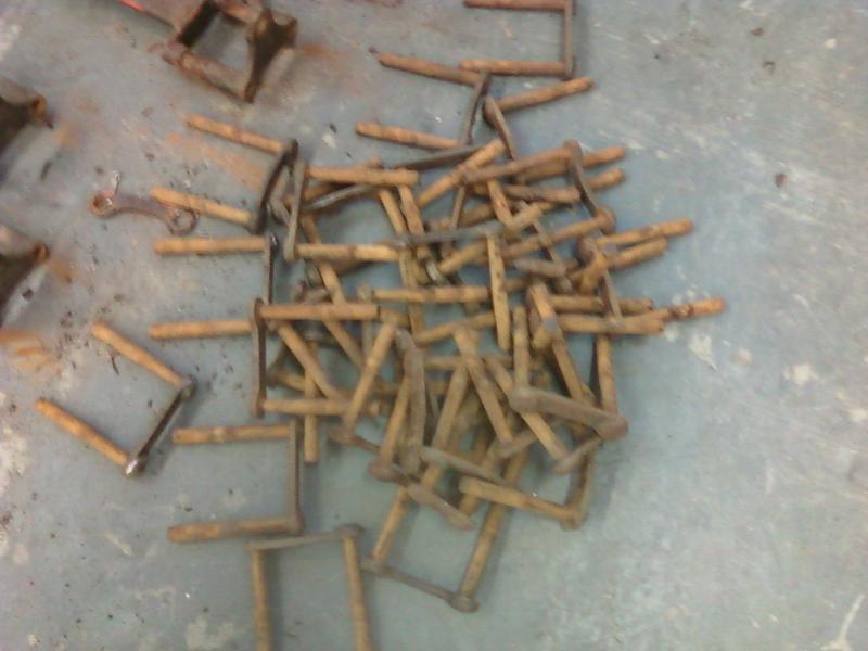

DAVENET

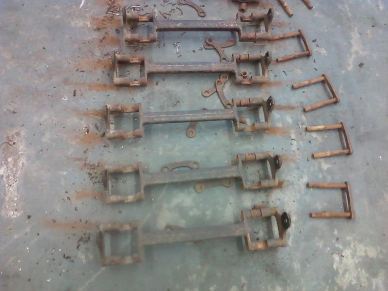

To reload Thursdays upload-
I started the disassembly of the first track. I'm already sick of cotterpins. Crap there's a lot of them. And some of the rollers are in dire need of attention (thank goodness I got some of Muley180's).
I'm sure the tracks originally came with some sort of lube from the factory, but that was probably gone after a thousand miles. And that was nine thousand ago! So, I wanted to get everything apart to clean and lube prior to putting them back on the cat. Also with all of that metal on metal action squeeking like crazy, being amplified by big steel drums, this should quiet down the machine quite a bit. So, after a trip thru the sandblaster, a coating of POR-15, and some grease I'll start putting it all back together.

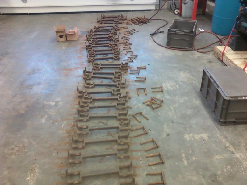

DAVENET
Sorry for crappy cell phone pictures. All I had with me that day. What's the friction coeffecient of rust dust?

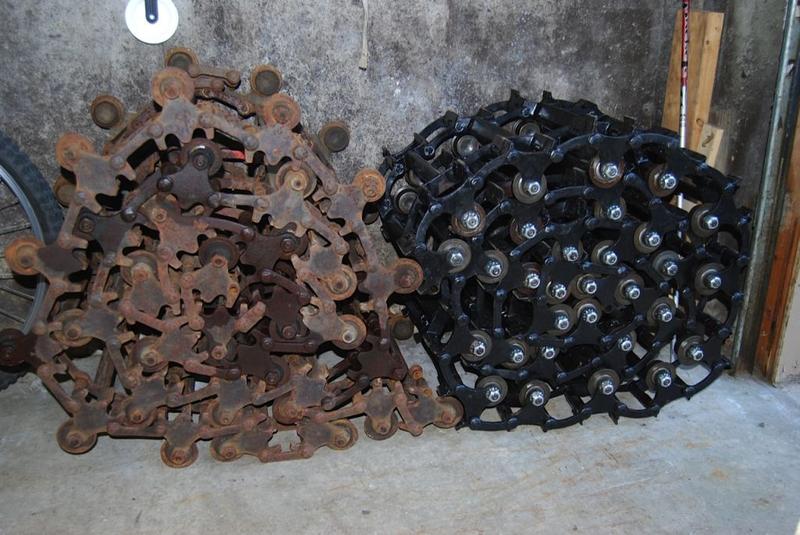

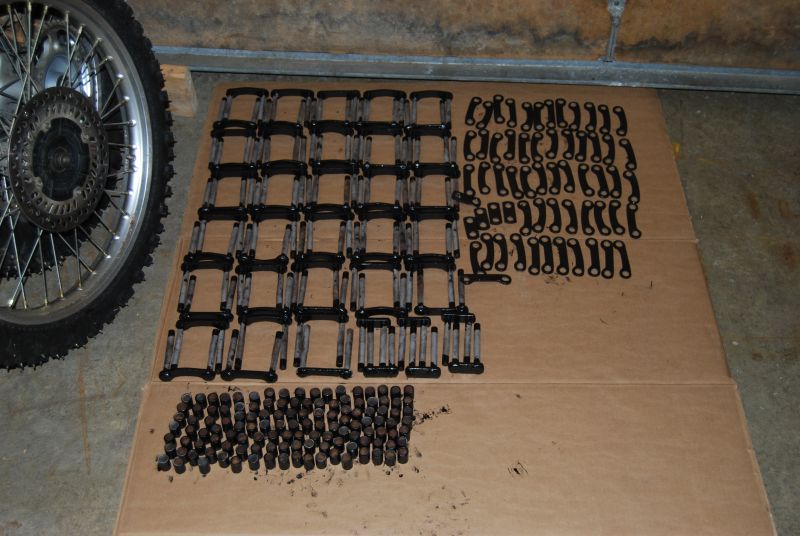

I have worked myself into quite a conundrum. As you can see in the prior posts, I completely disassembled the tracks to check for issues and to reapply grease that has been missing for the past 40 years (I’m assuming the lube held for the first three years). There is no doubt that it needed to be done and should knock the noise WAY down.
Now that everything (from the first track) is sandblasted, cleaned, coated with POR-15 (more on this later) and rollers checked and completely greased, I’m to the step of reassembly. Now at first glance this may not seem like such a problem, right? ‘Just look at the other three tracks that are together and rebuild them the same way’. There’s only one teeny tiny problem. Every track cross bar and every connector link have worn together to work with the one it’s hooked to. Just like your feet and your favorite pair of slippers. Well the problem I’ve created is now I have no way of knowing where the matching ‘feet & slippers’ are. :smileywac One third of my connectors are worn, but the bar is flat, which means the outside to outside distance on the pins is 3 1/2 inches. One third have had the bars arched slightly to make the distance roughly 3 7/16th inches to compensate for wear and the last third are arched slightly more to measure around 3 3/8th inches. :hammer:
Now those 16ths may not sound like much, but depending on which way you mix them it could be like your kid wearing your shoes, or you trying to cram into ballerina slippers . And having it the wrong way will create excessive wear on parts that may as well be made out of unobtainium. All of the rollers need to be ‘wear corrected’ to 3.5” to hit the sprocket valleys perfectly each time.

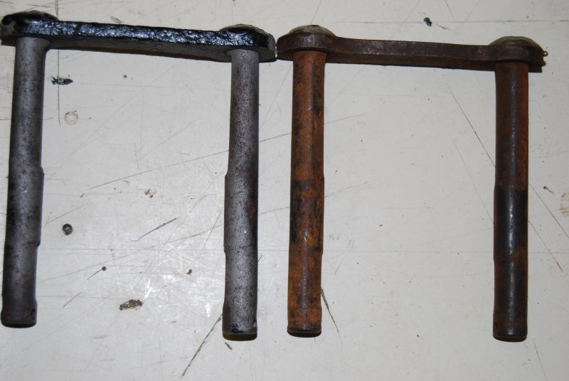

DAVENET
This is the root of the problem. On the left is one of my more worn connecting links, on the right is Muley180's I bought. The high spot just over half way down is where the roller goes that makes contact with the drive sprocket. I expected this area to have the most wear prior to disassembly, but just the opposite is the case. The roller only has heavy pressure when it is in contact with the sprocket each time around the pontoon. The rest of time it is just 'floating' on the pin. Not the case for the other areas of the pin. As this area wears, and the corresponding surface on the cross links, the metal at the top has to be arched up to compensate. This is luckily one of the worst ones to show as an example, but still shows the problem getting them back into close to the right location.

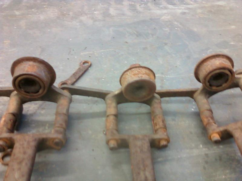

DAVENET

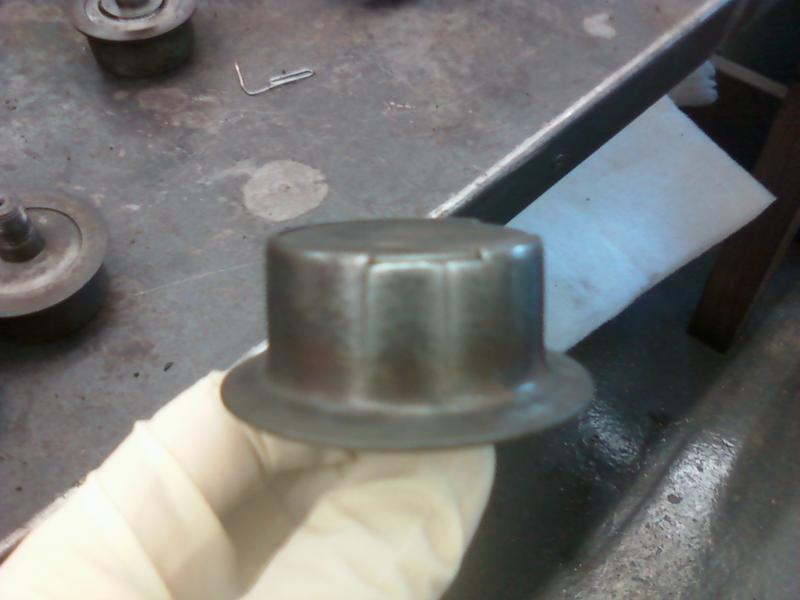

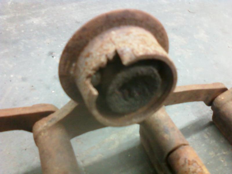

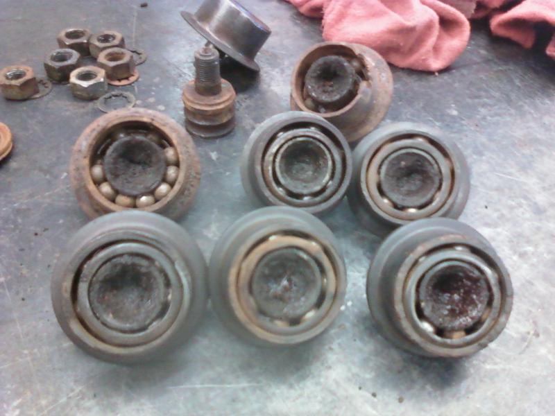

I cleaned & greased all of the rollers while they were off. I bought 40 used ones from Muley180 and now I’m just hoping they will be enough. I burned thru 10 of them on this first track replacing four that were blown apart and 6 that had the bearings, but the dirt shield was worn /ripped off exposing them to the elements. They still roll, but can only realistically be used in an emergency. The third pic shows one just prior to failure with multiple cracks in the shell. I’m really amazed at how much grease I had to put into each of the others before it started showing.

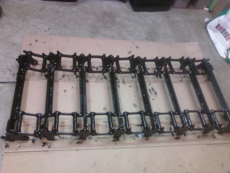

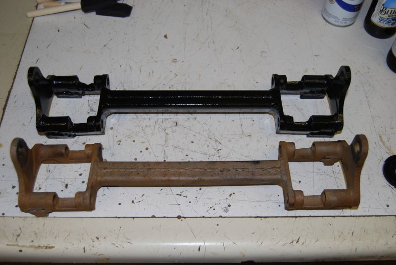

Work stopage ends. The first track was finished early spring.

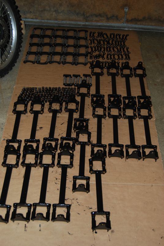

DAVENET
Work on track two started last week. Doing this track (and the next two) in smaller, bite sized segments so I can pull it apart, clean it, paint it, grease it and reassemble all pieces to the same spot they came from.
