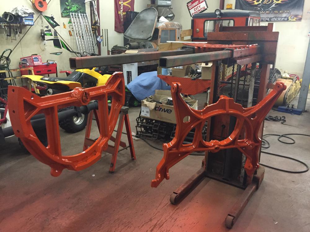

mean while back in the tucker bat cave, lots of tracks/grousers are being restored, well over 1500 grousers are being done. lots of machines waiting for their restored tracks

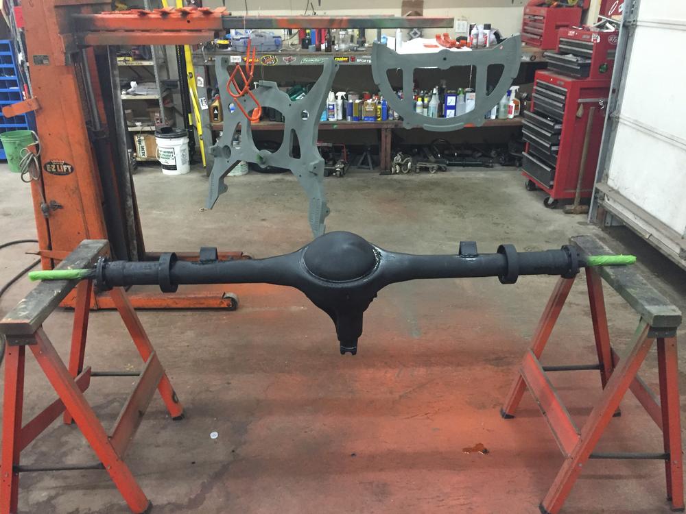

On track for assembly next week. Committed to current design. Good news is I can swap the uhmw out on the cat easily while keeping in service . I'm interested to see how this goes.
That should be plenty of griusers with a few left over.
