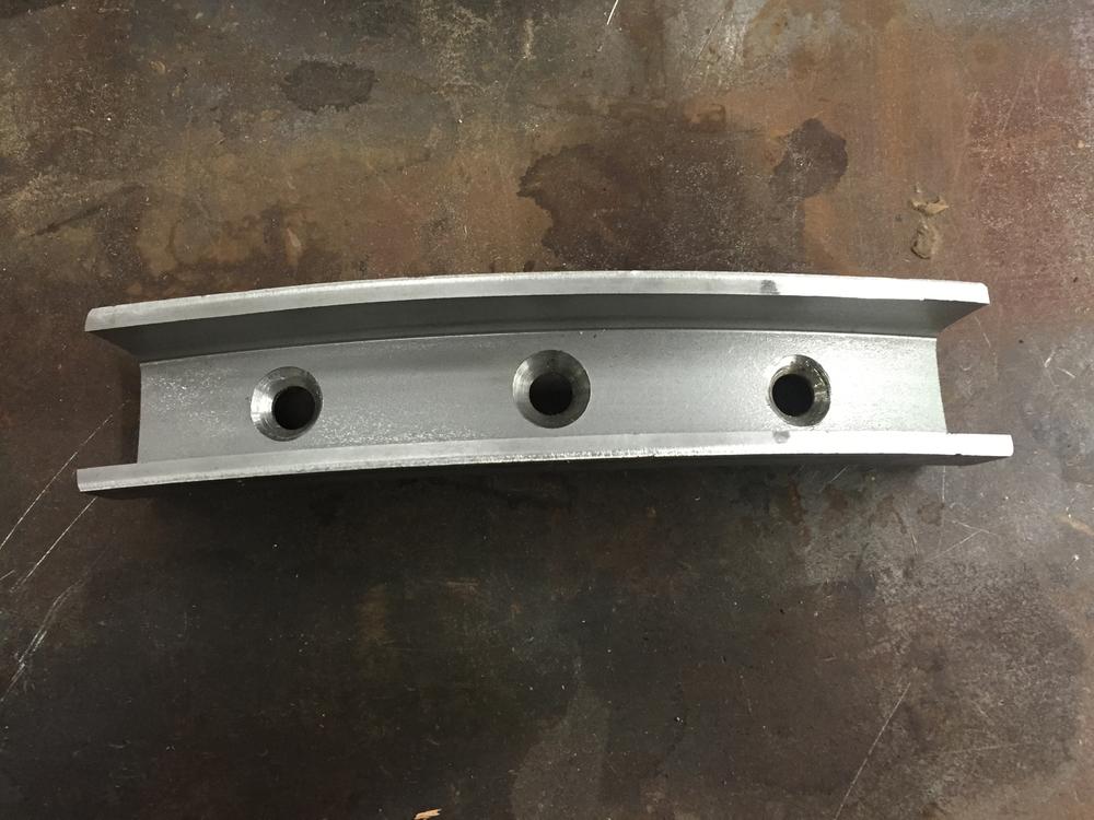

First and last stainless Tucker turn table channel probably know to man.
316 sucks. Was free and that's what I had access to for forming but what a kristi to work with.
In hindsight 1/4" square steel rolled and cut face off to spec with plasma cutter garnished with a touch of grind could have got it done.
Will last and looks nice anyway. Tool companies like this stuff because it eats them.

Apparently the Bronze Age ended. The table sliders are being remade out of UHMW. Material in route.
Thanks for the suggestions. Better late than never I guess.
