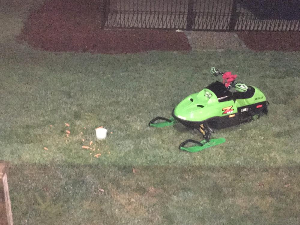

Santa came. I know it's a few hours early for some of you. Said he was out of stock on snow but don't worry!
Reindeer missed the keep of the grass sign.
