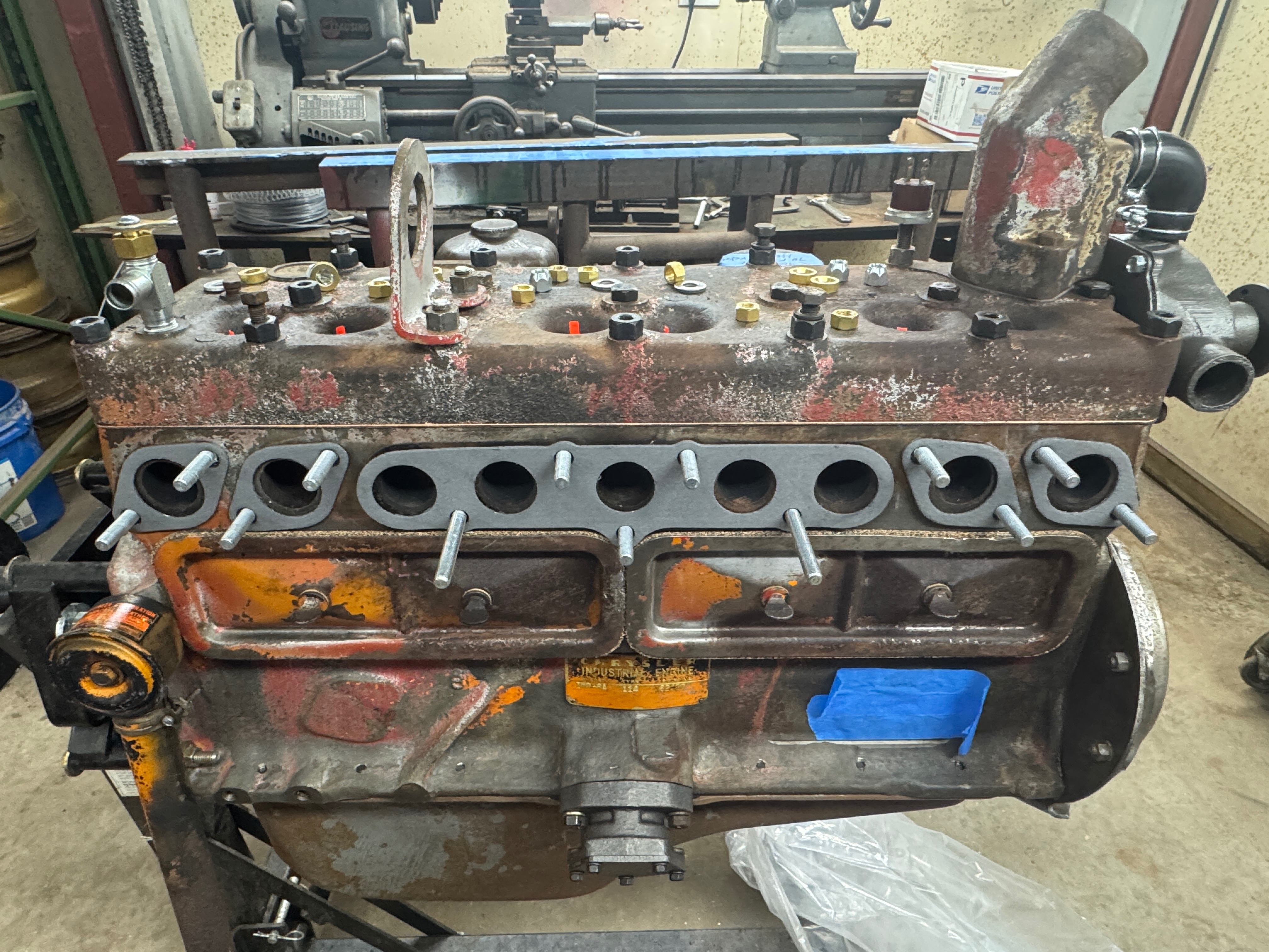

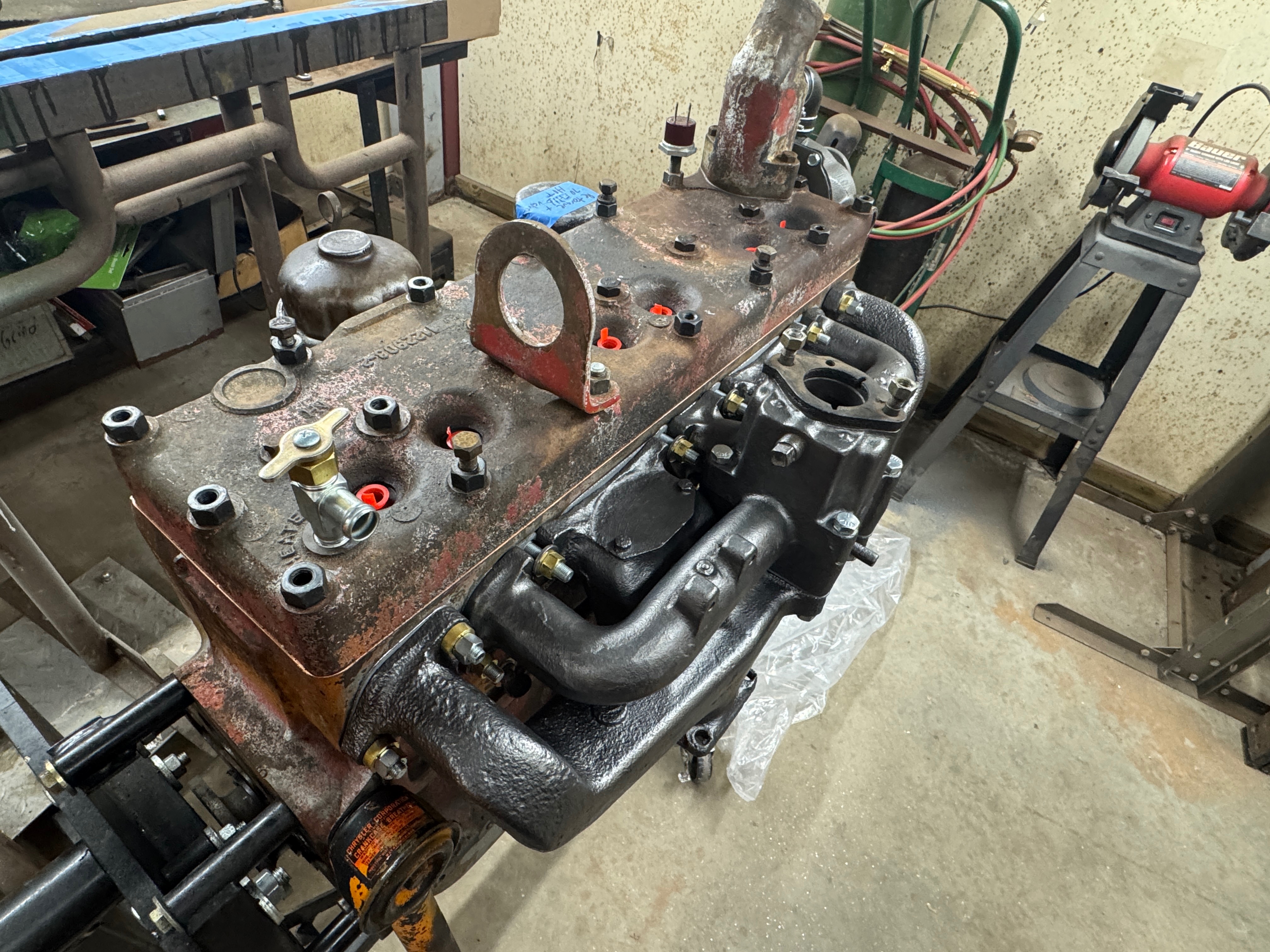

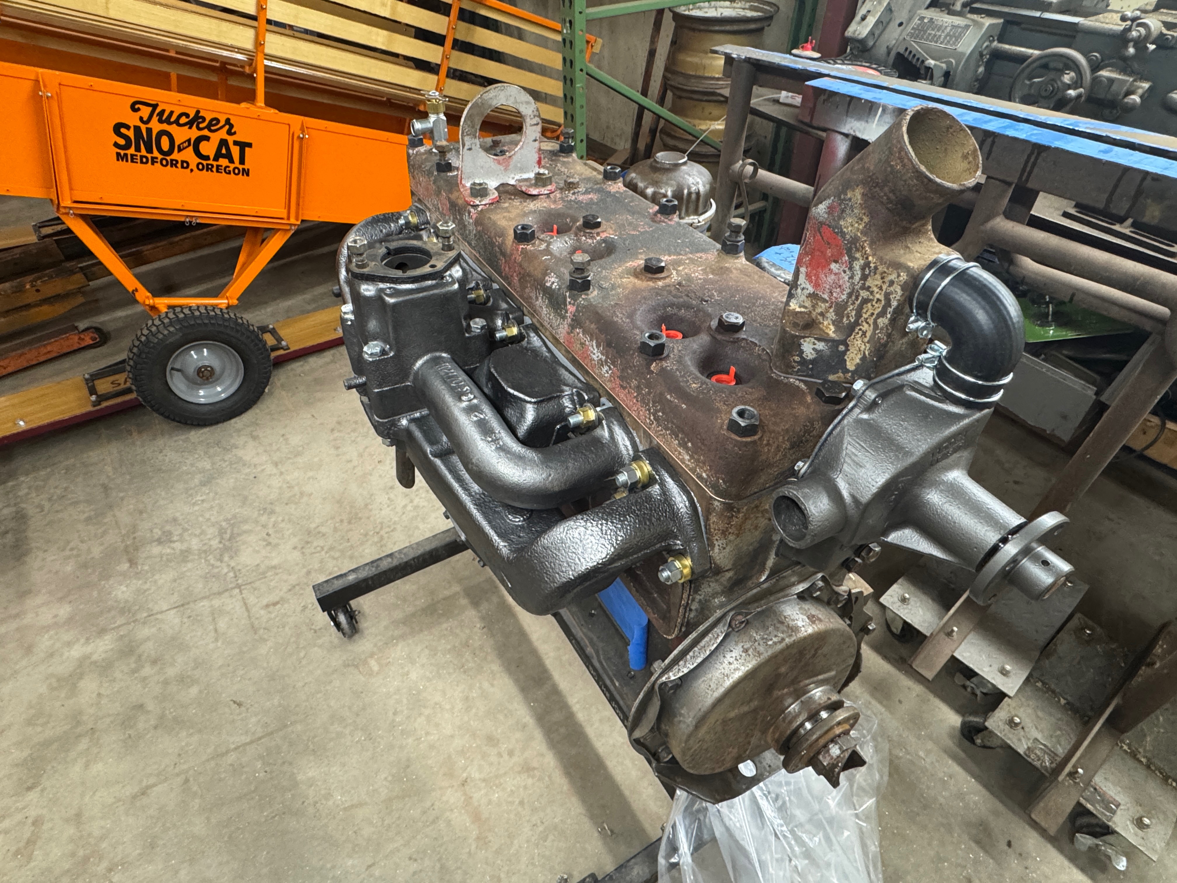

Intake and exhaust manifolds installed.
Procedure for installation is to gently snug the Intake to exhaust manifold bolts after applying antisieze to the shanks and threads. This allows the flanges on the block to align first.
Install the manifolds on the block then slowly tighten the nuts from center out slowly in many steps to 20 ft/lbs.
Then tighten the intake to exhaust manifolds slowly in many steps to 25 ft/lbs.
You can certainly see how much these manifolds suck in and conform under load.
Cast is a blast!

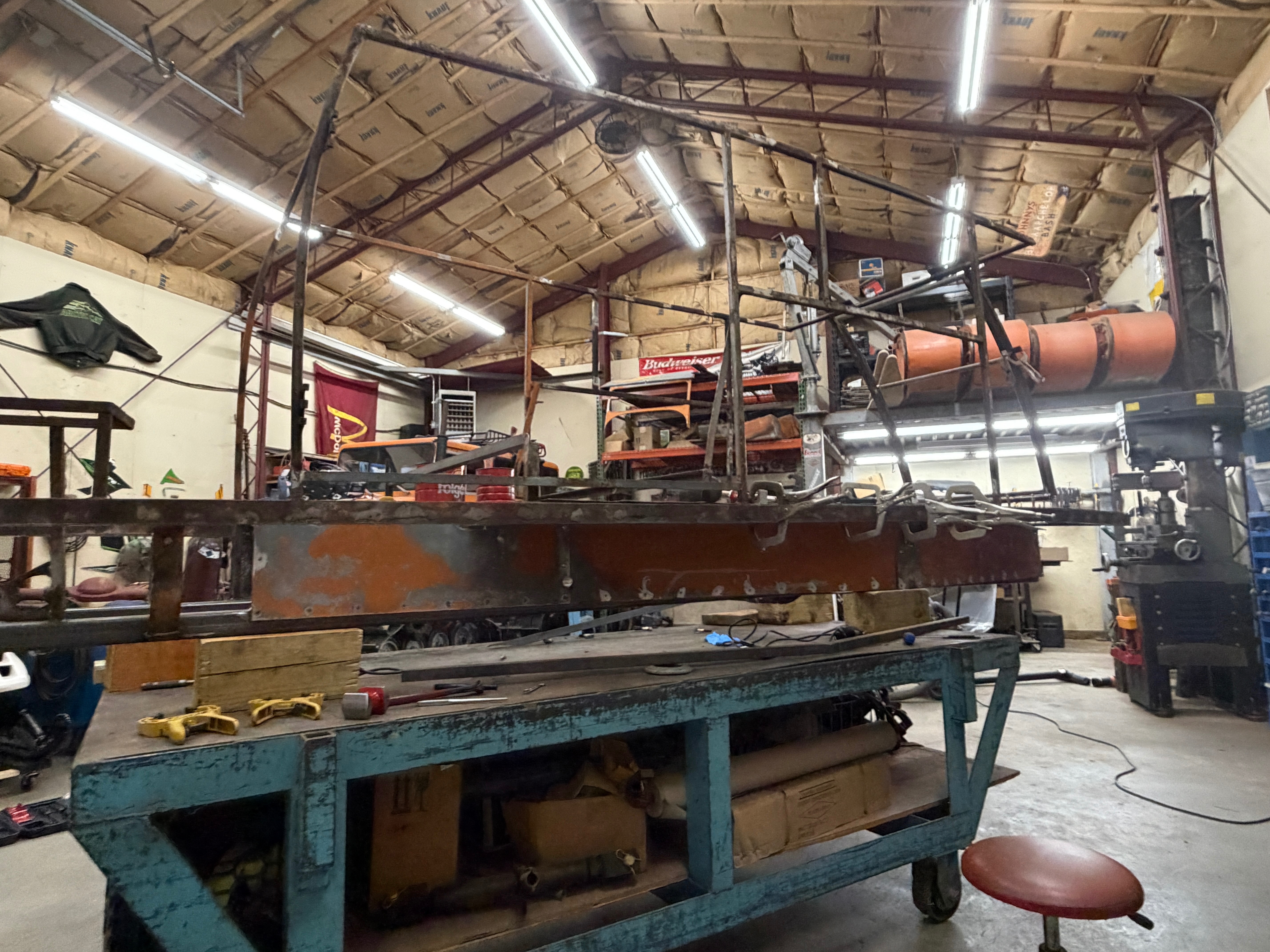

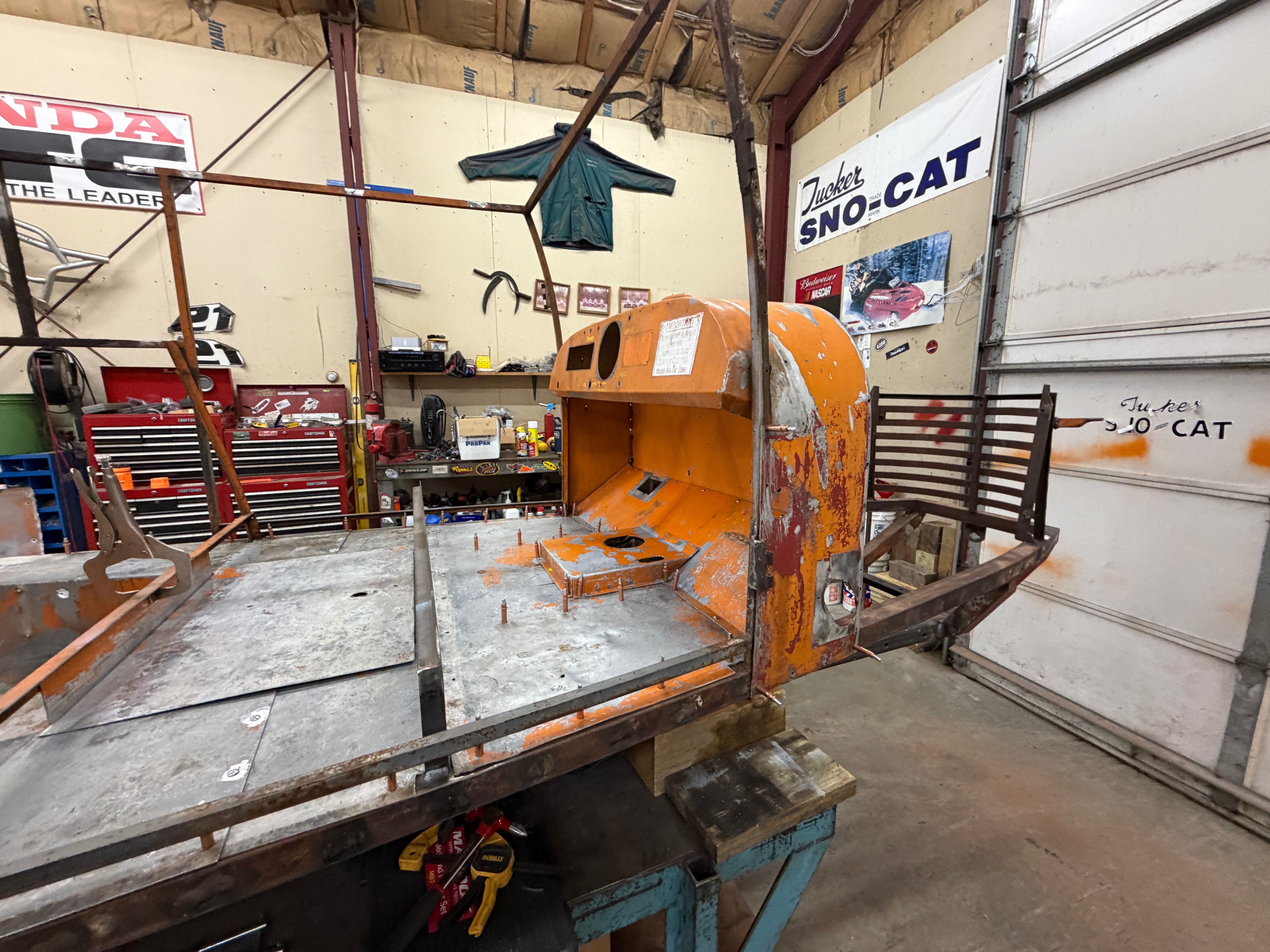

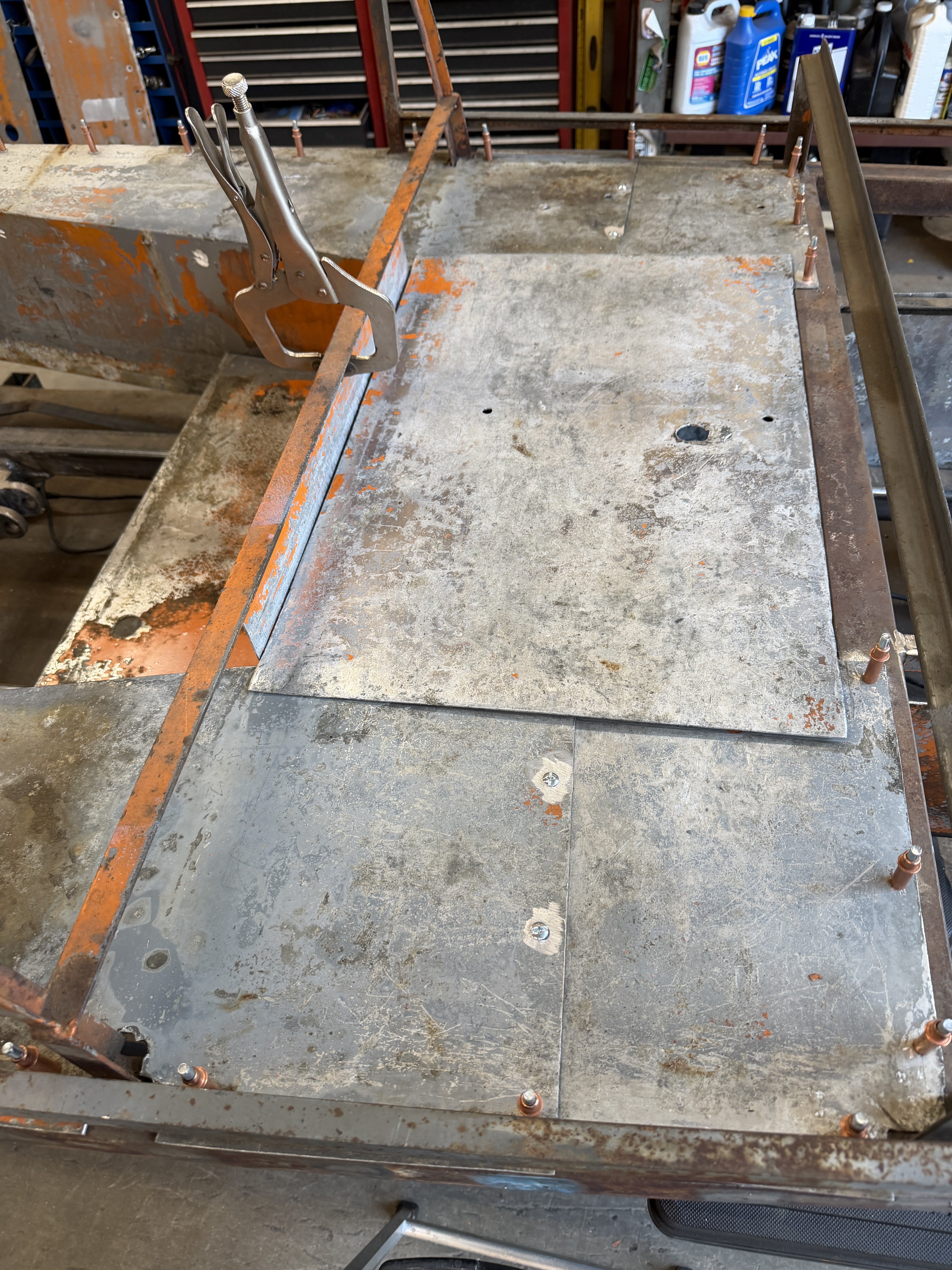

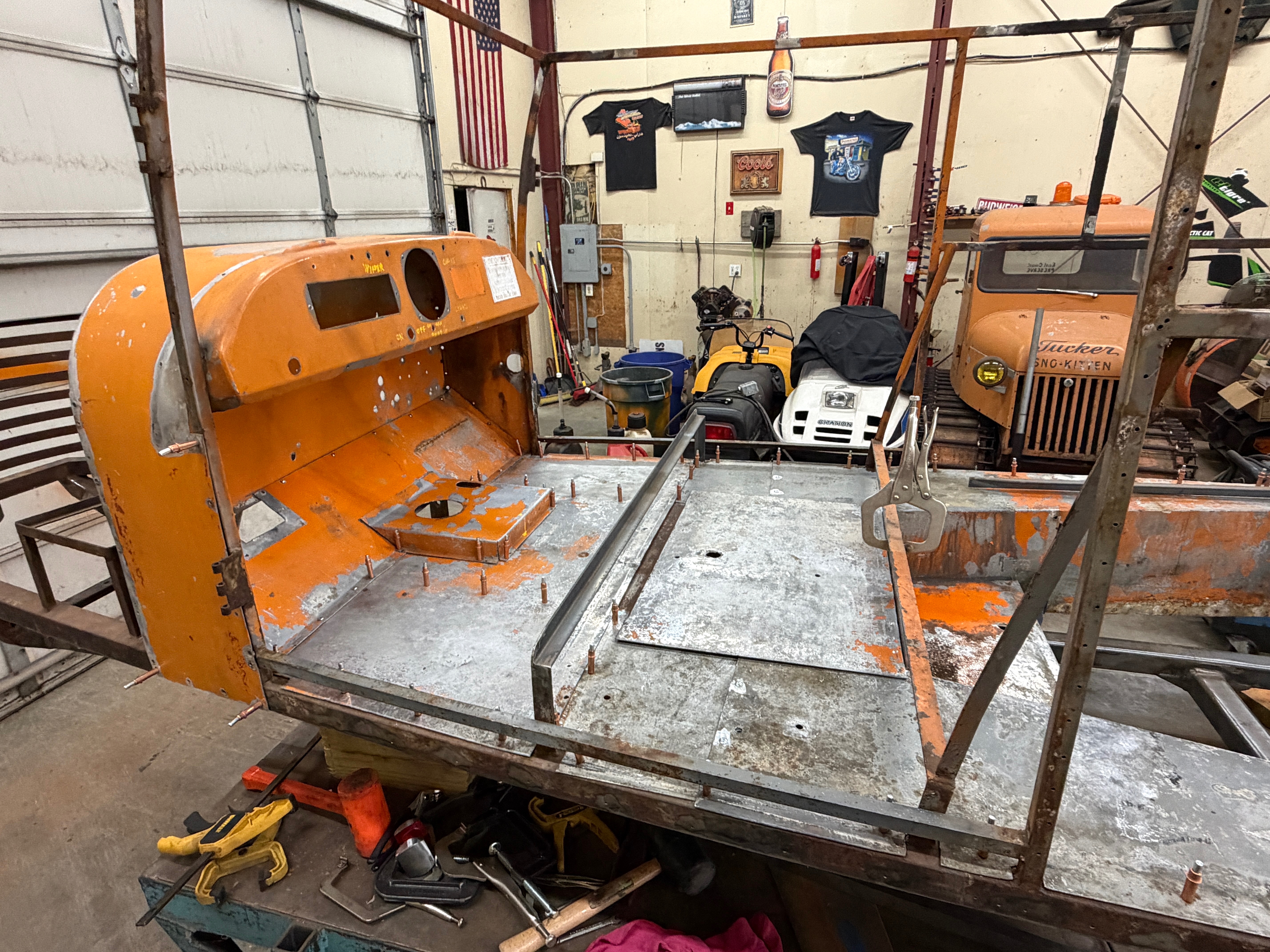

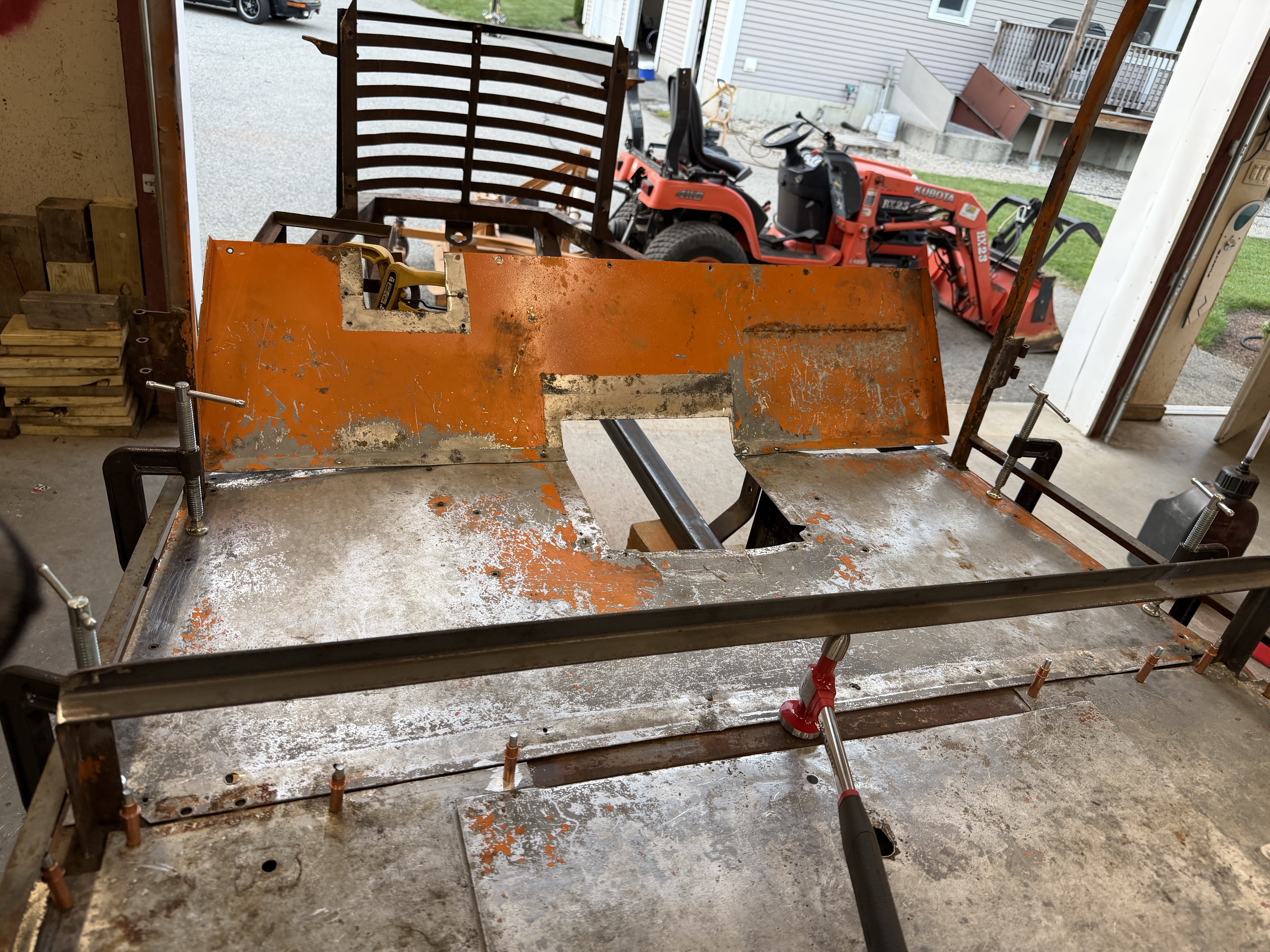

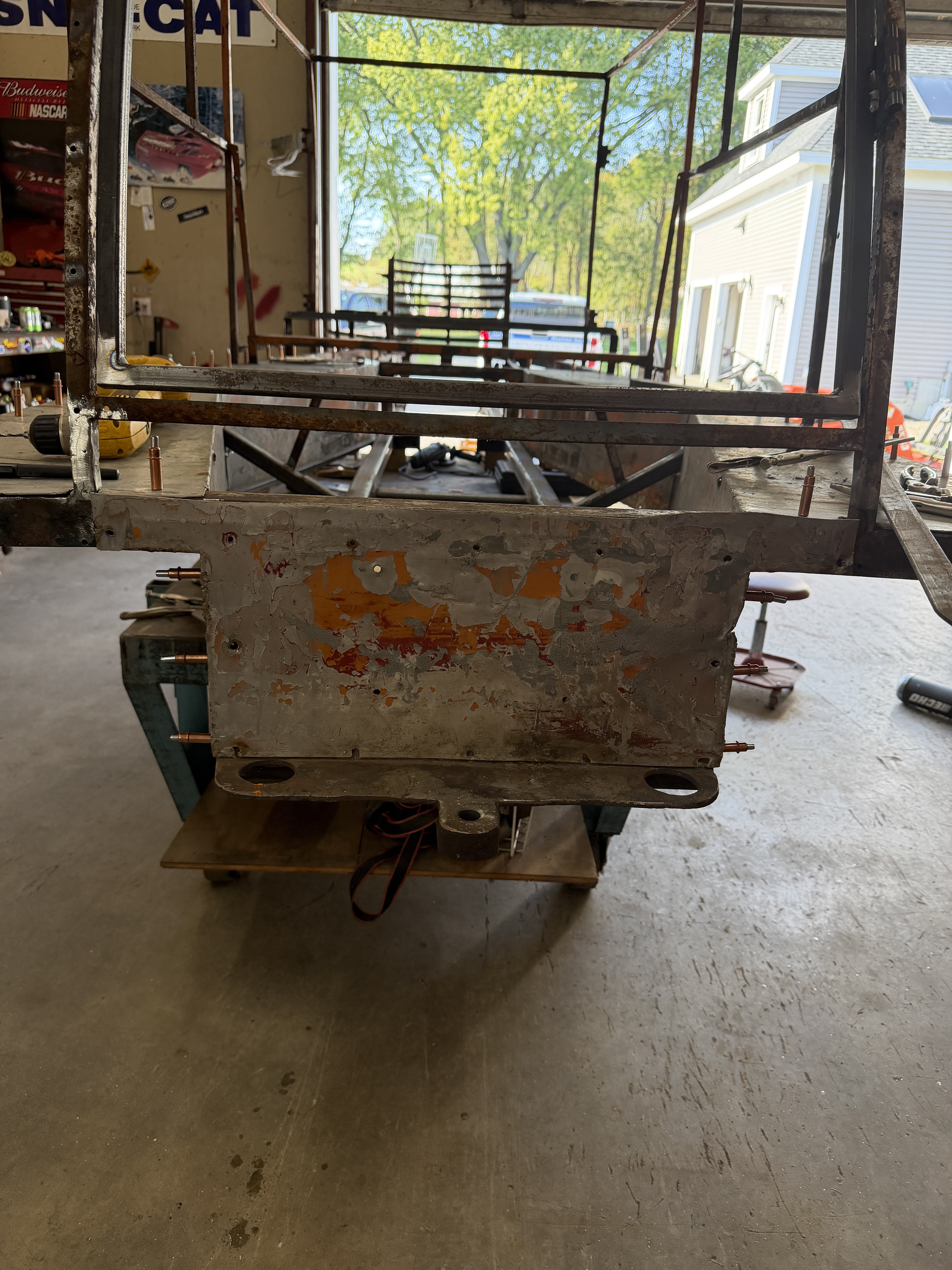

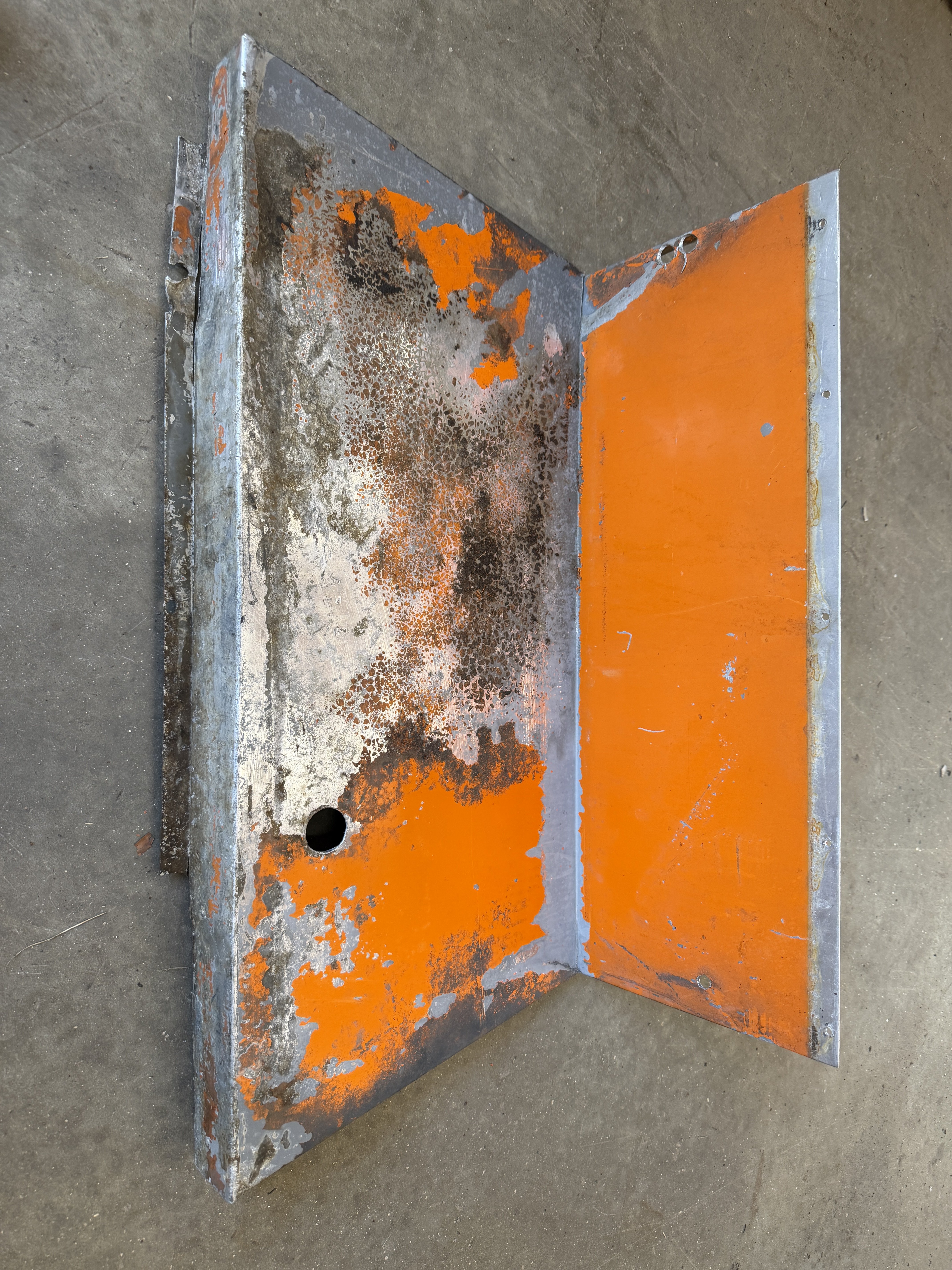

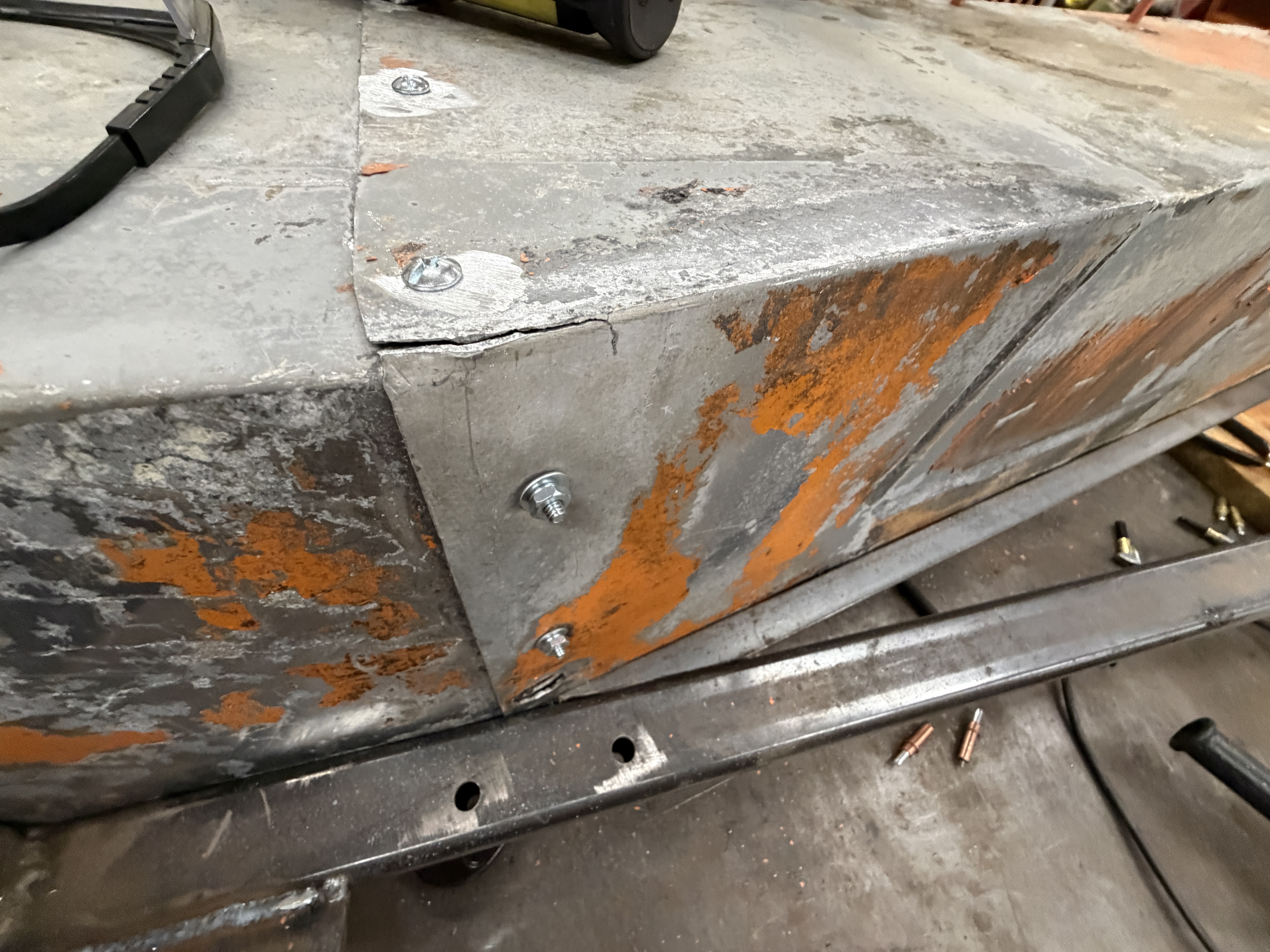

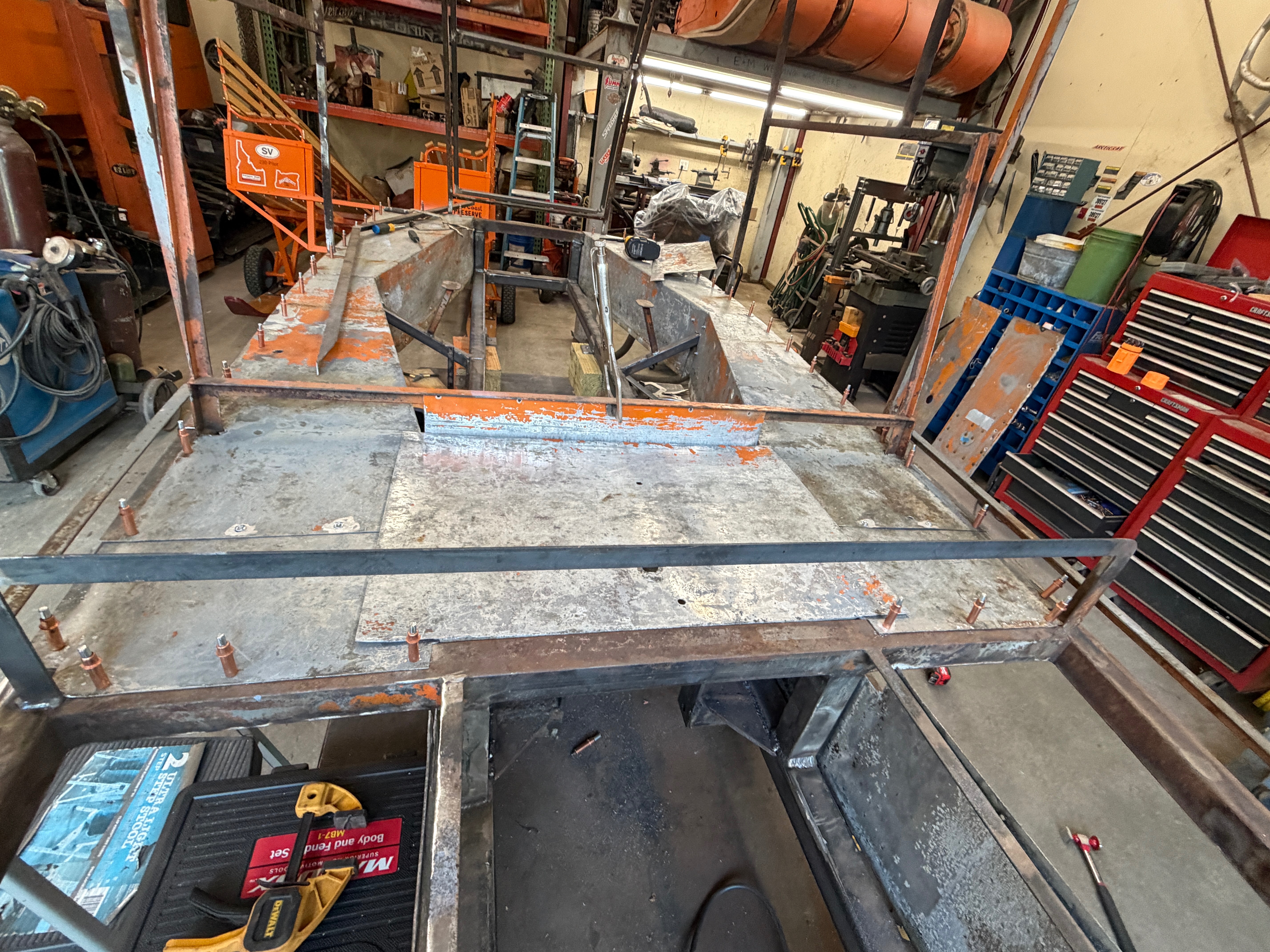

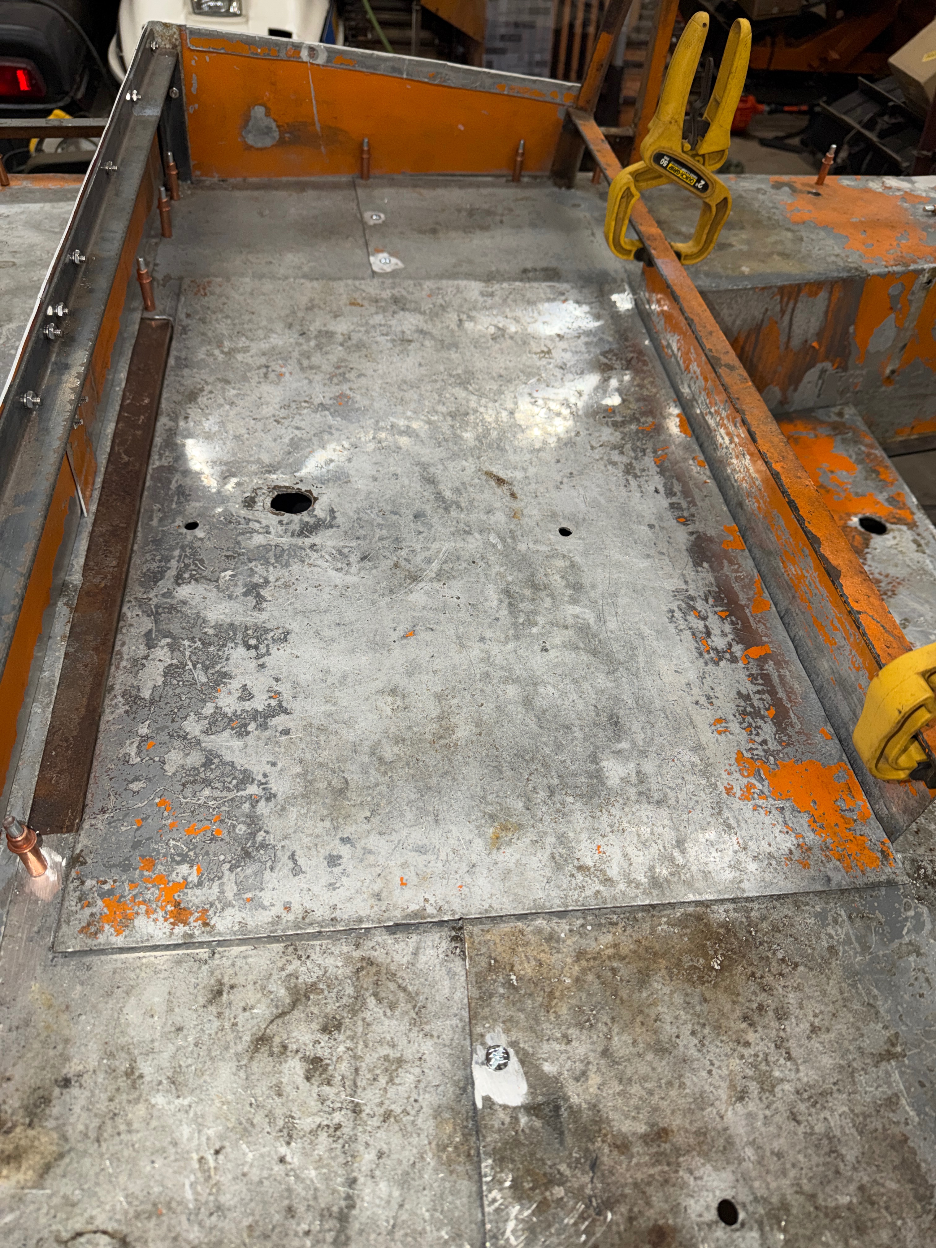

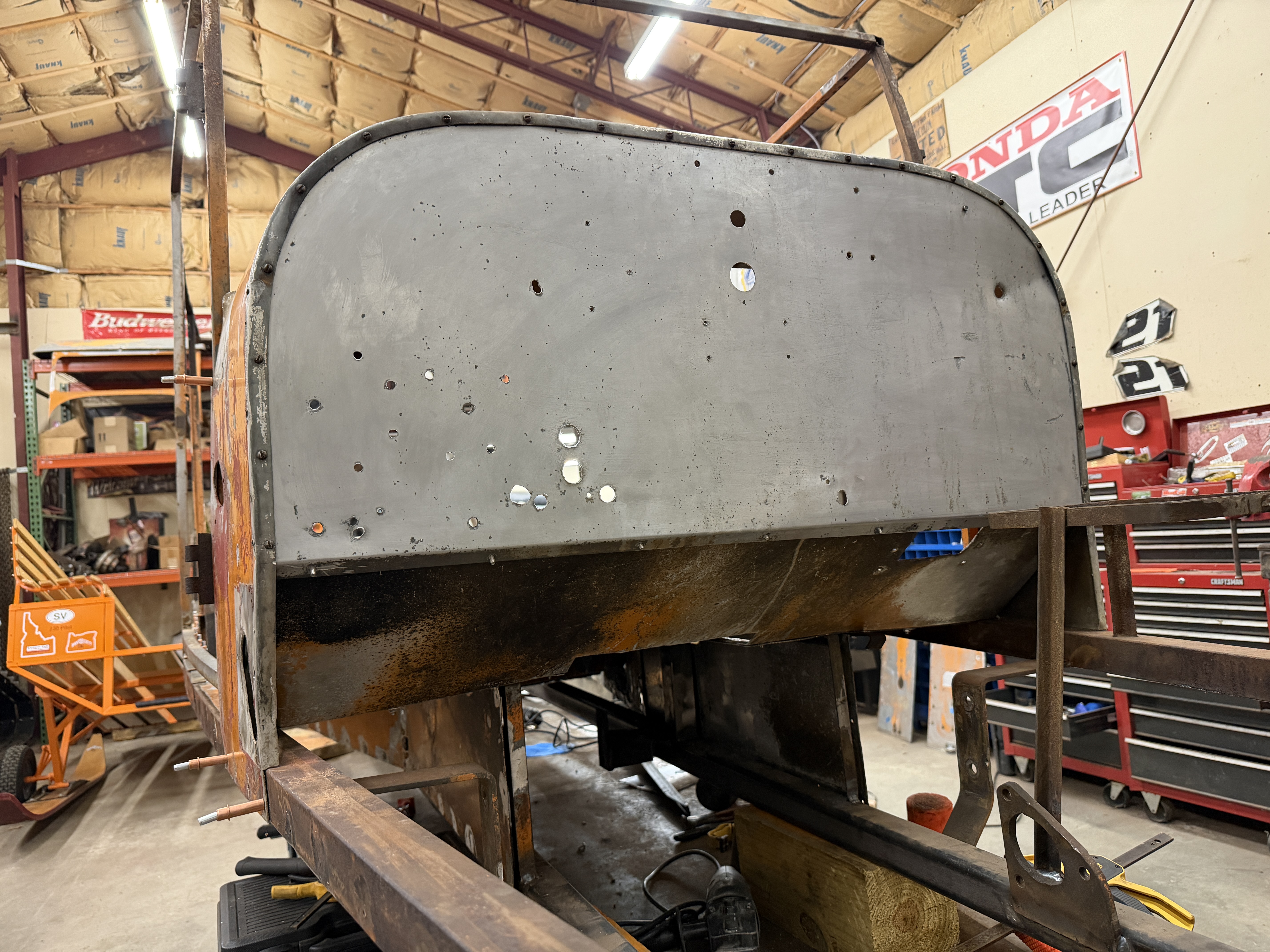

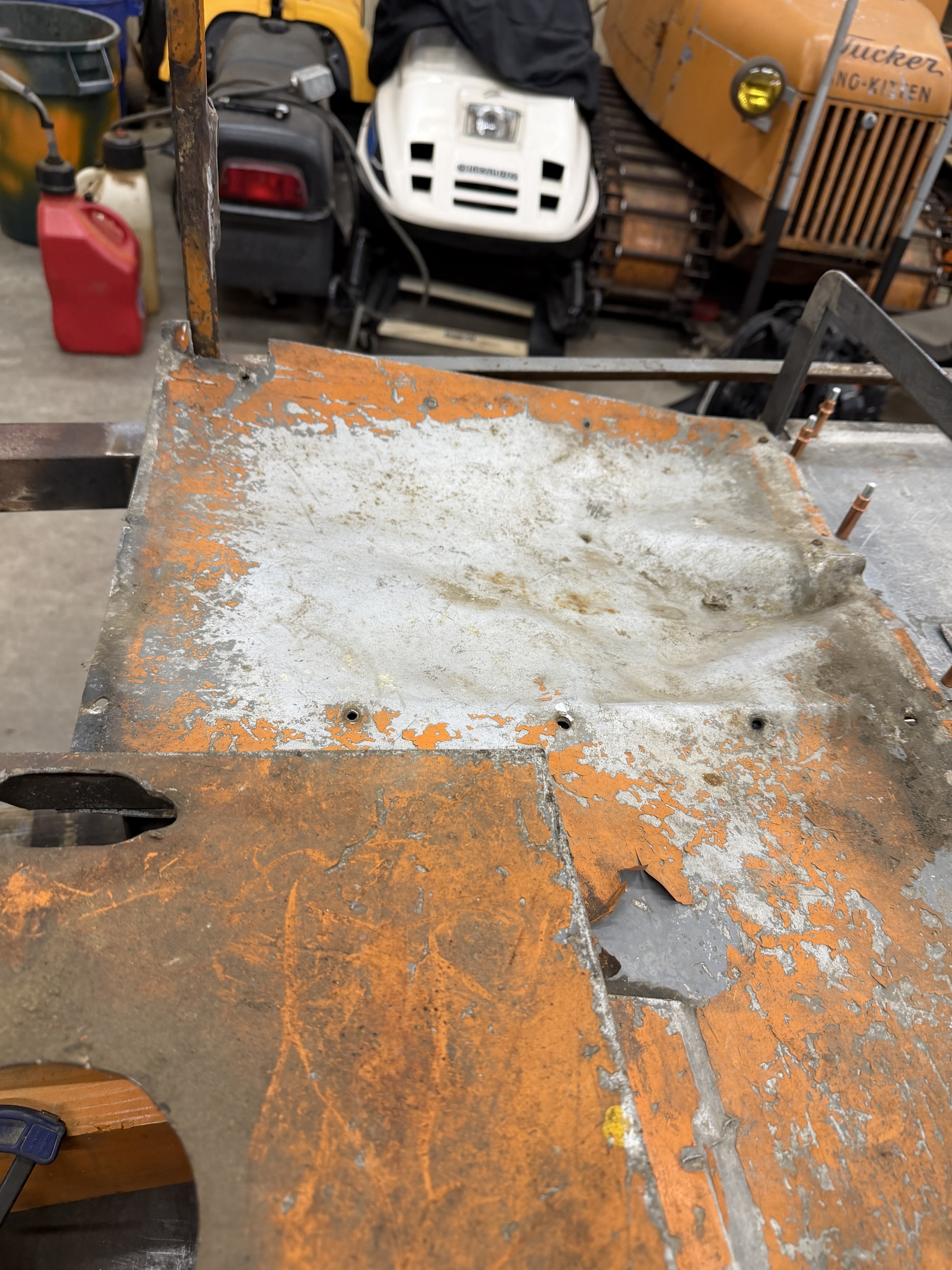

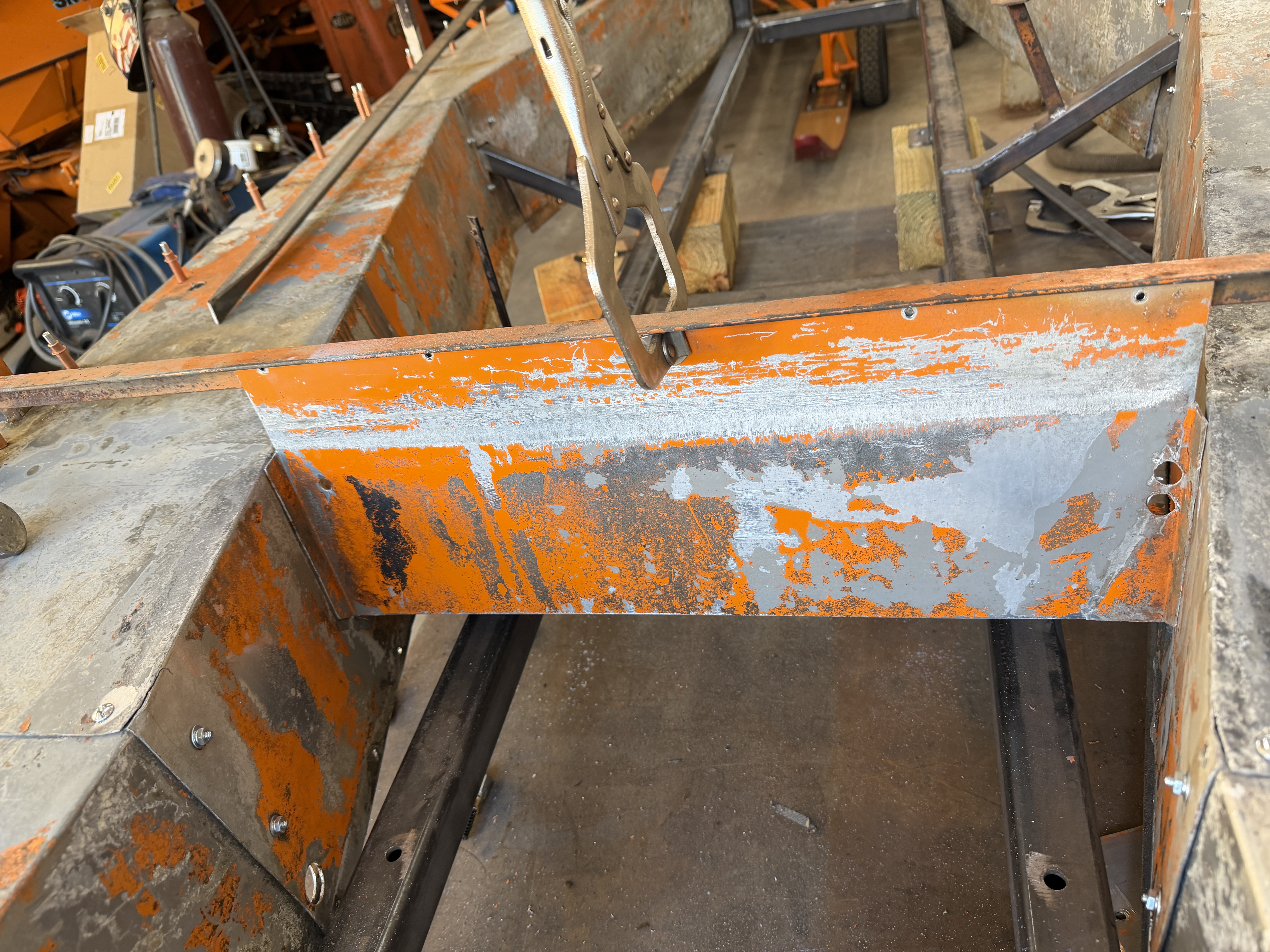

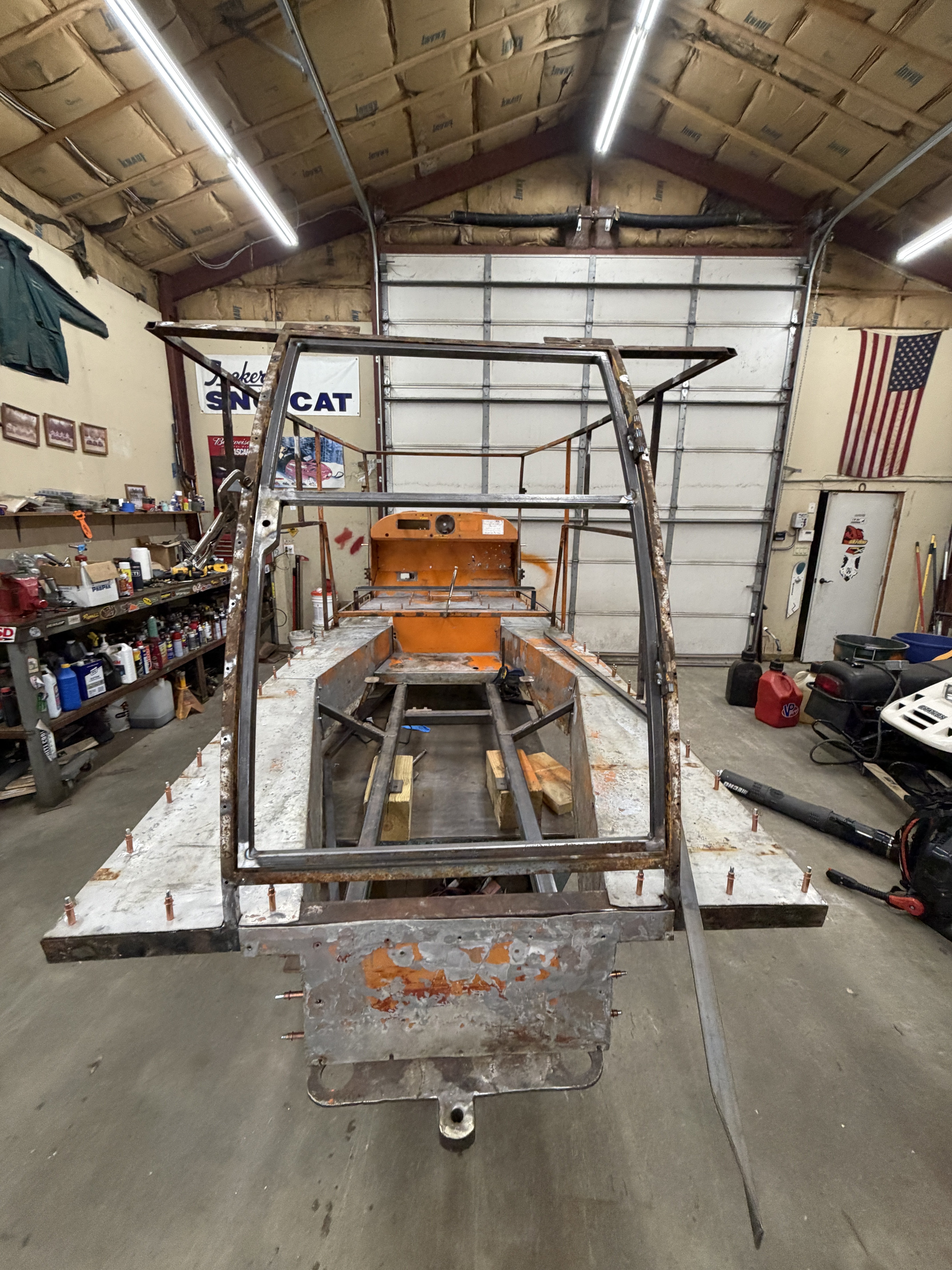

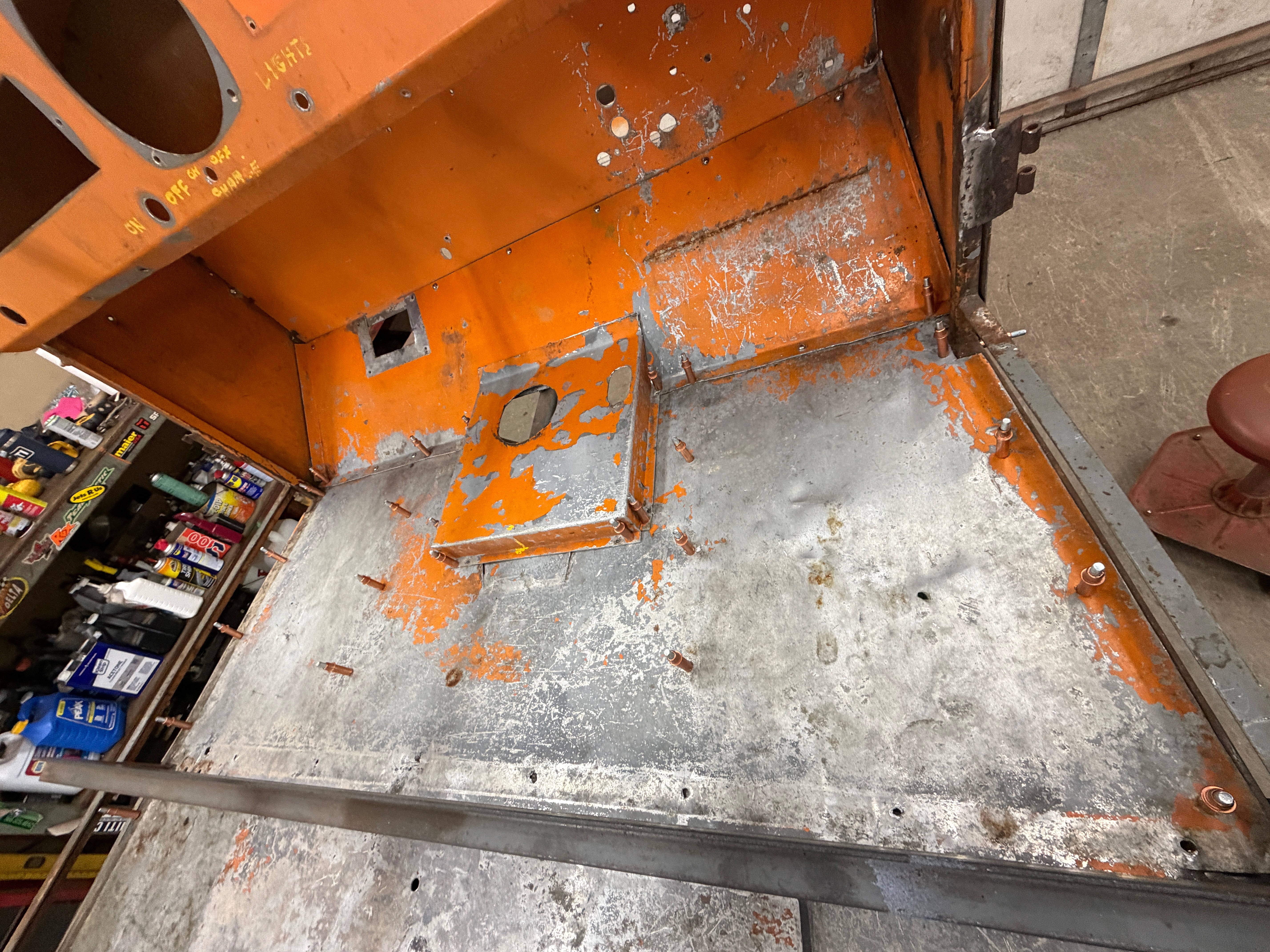

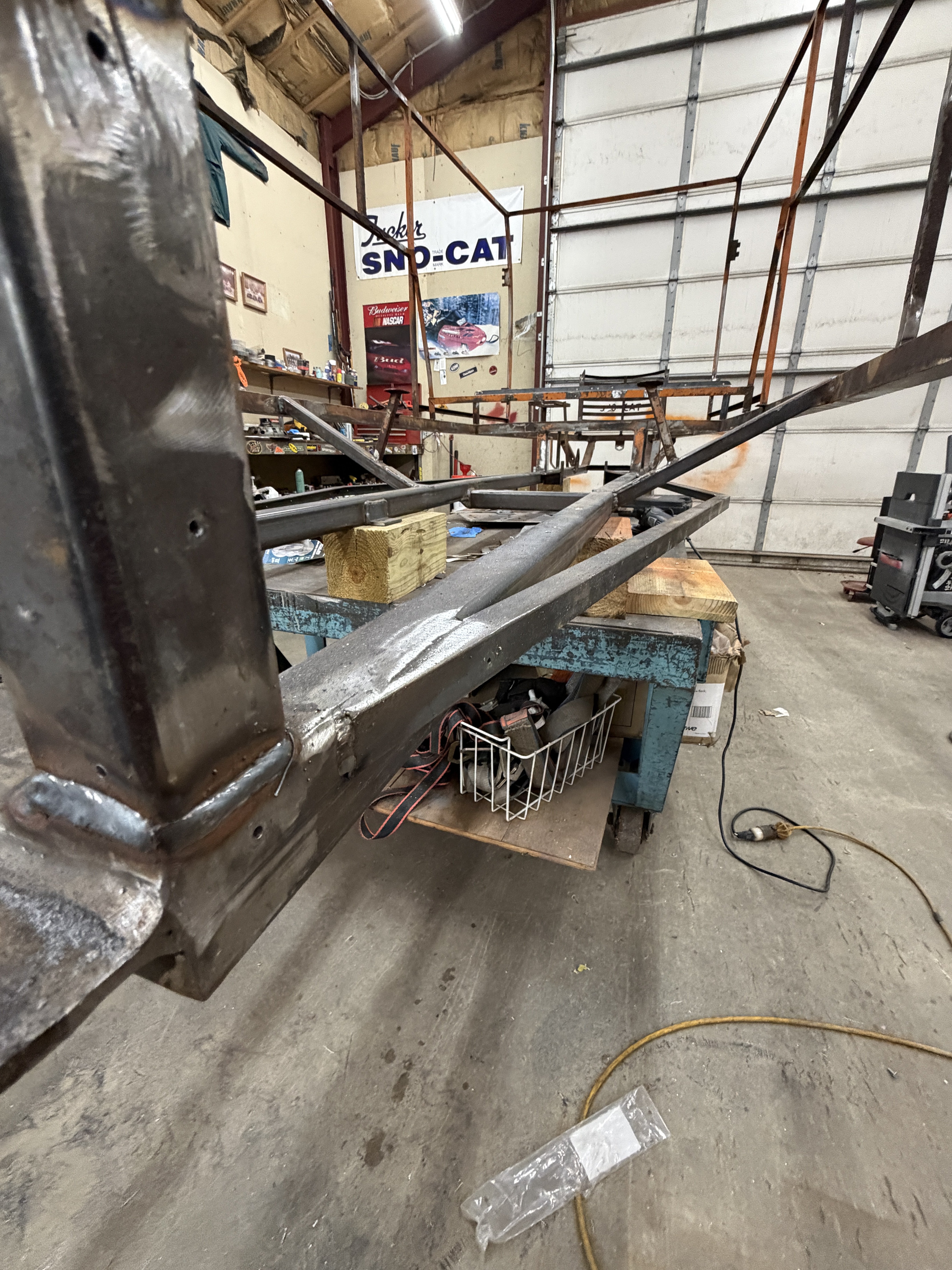

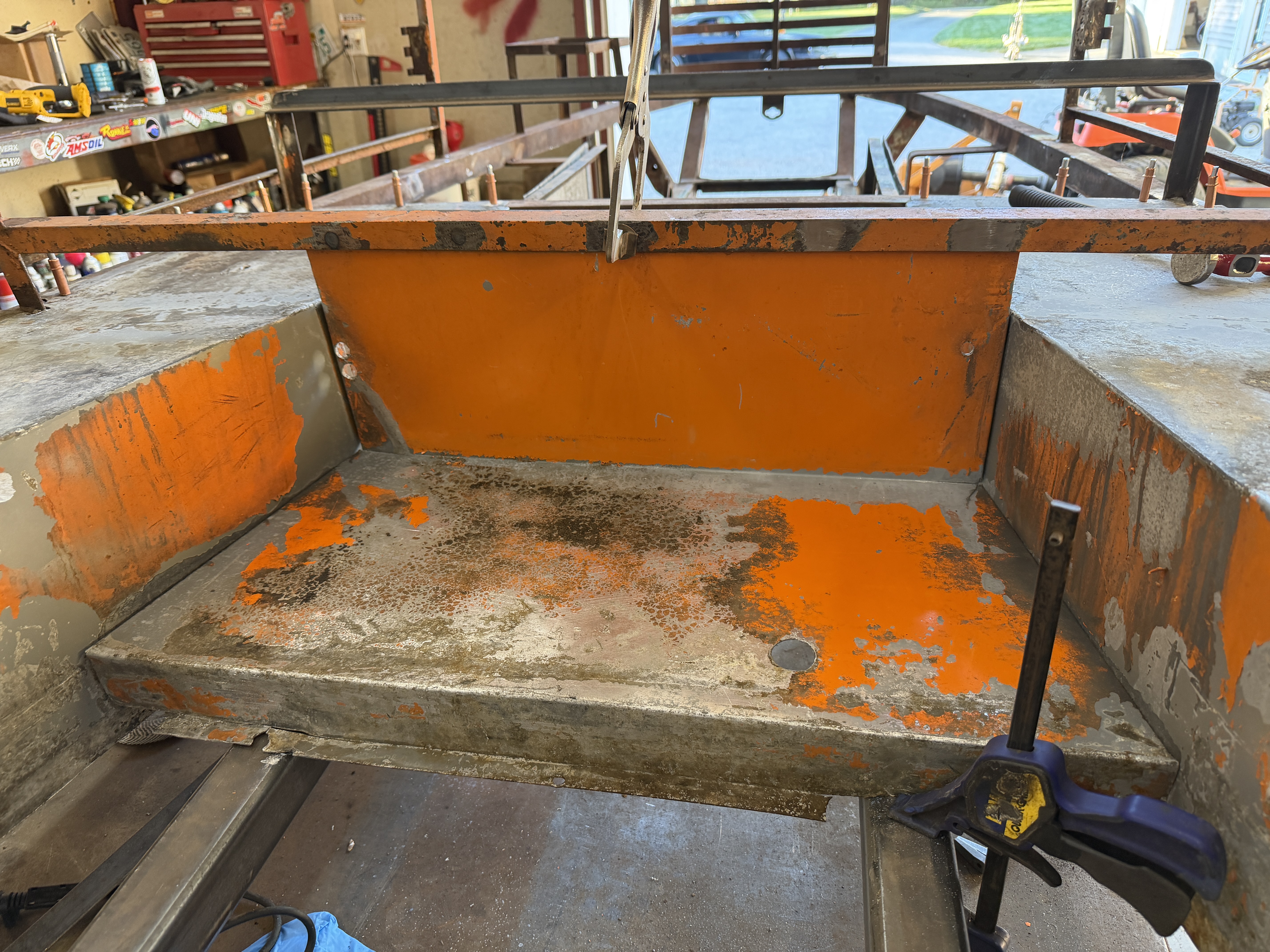

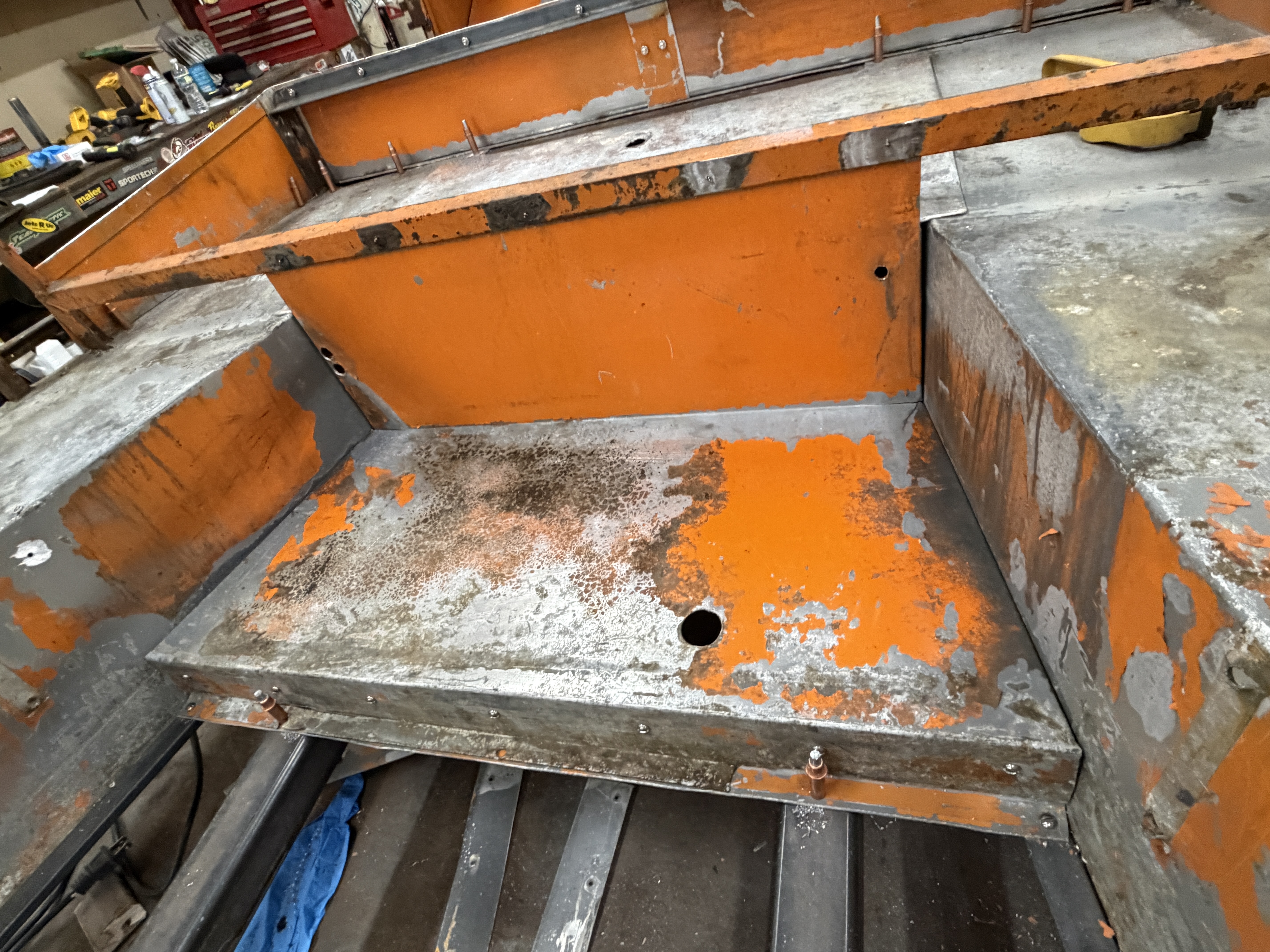

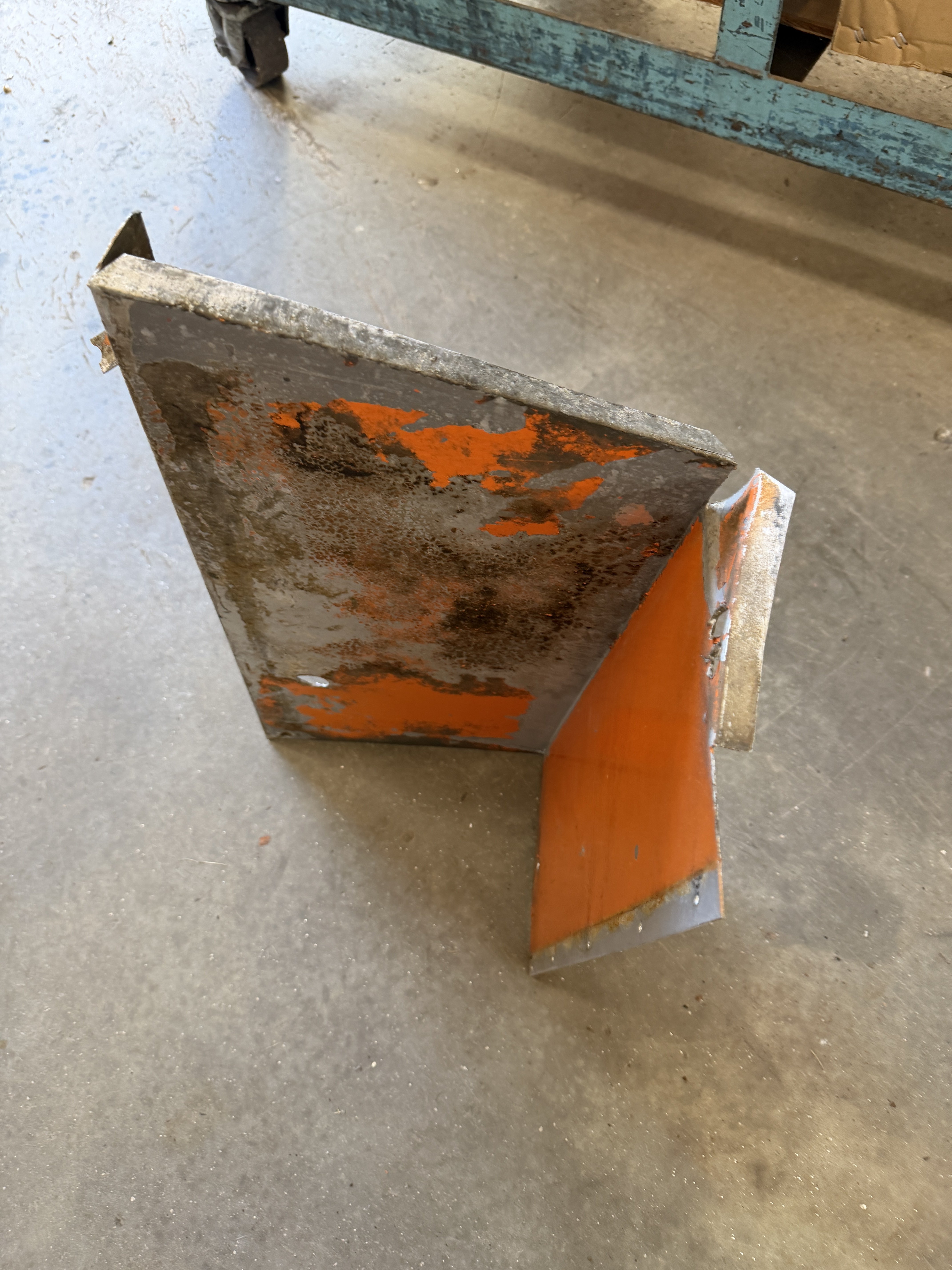

Build no two the same continues. Panels lap on one side but on another. Different lengths cut angles notches.
Crude awesome!

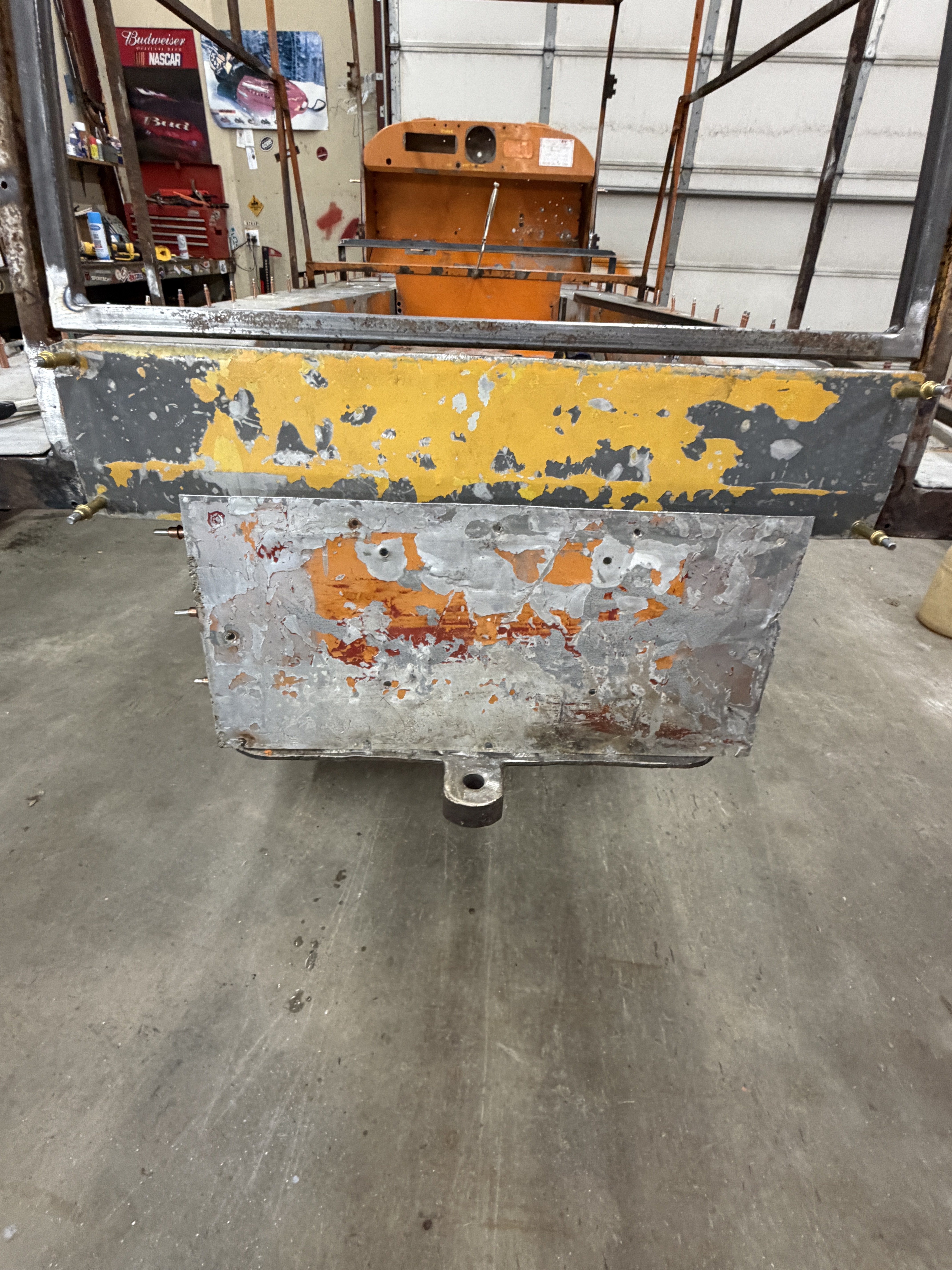

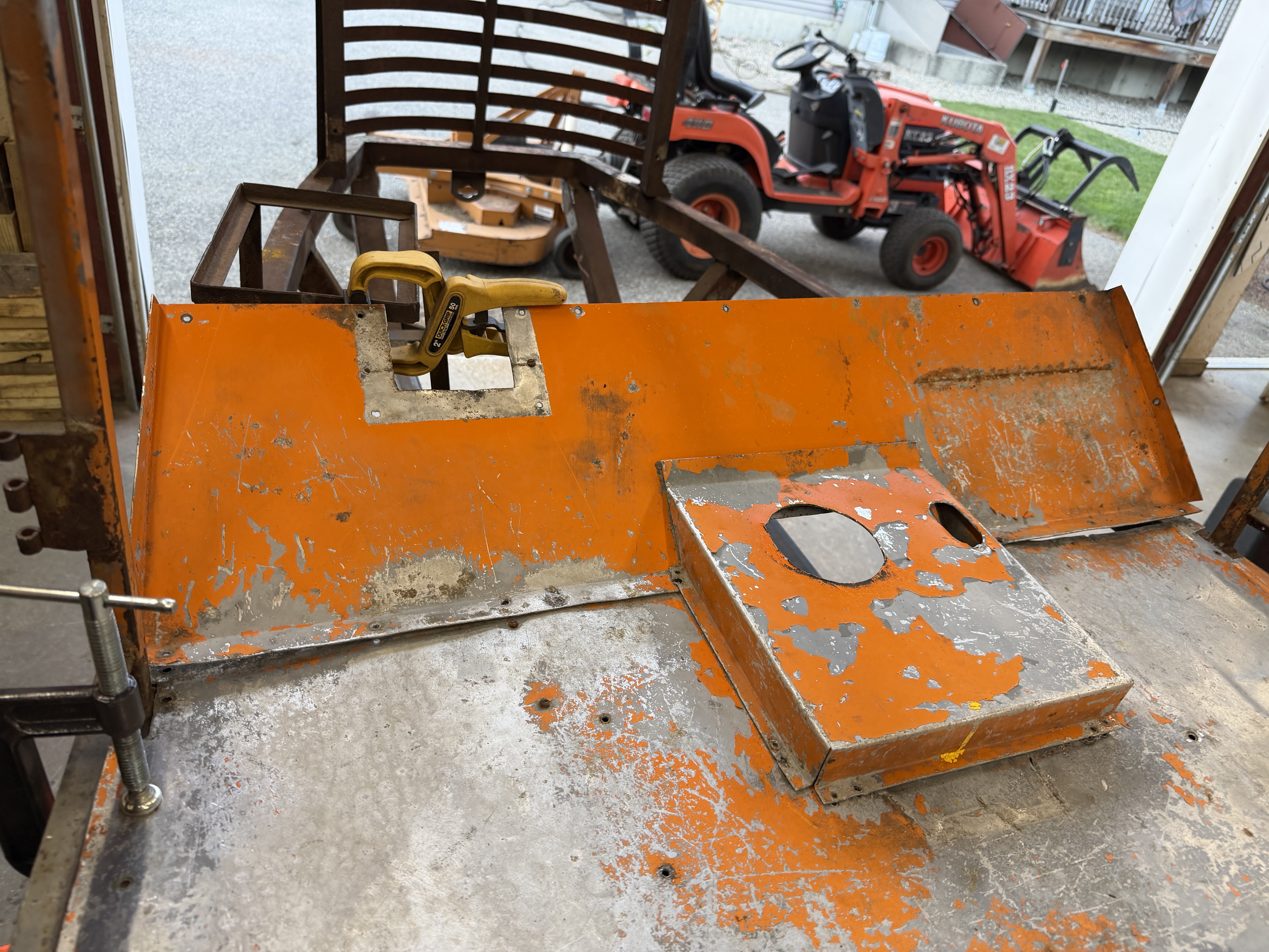

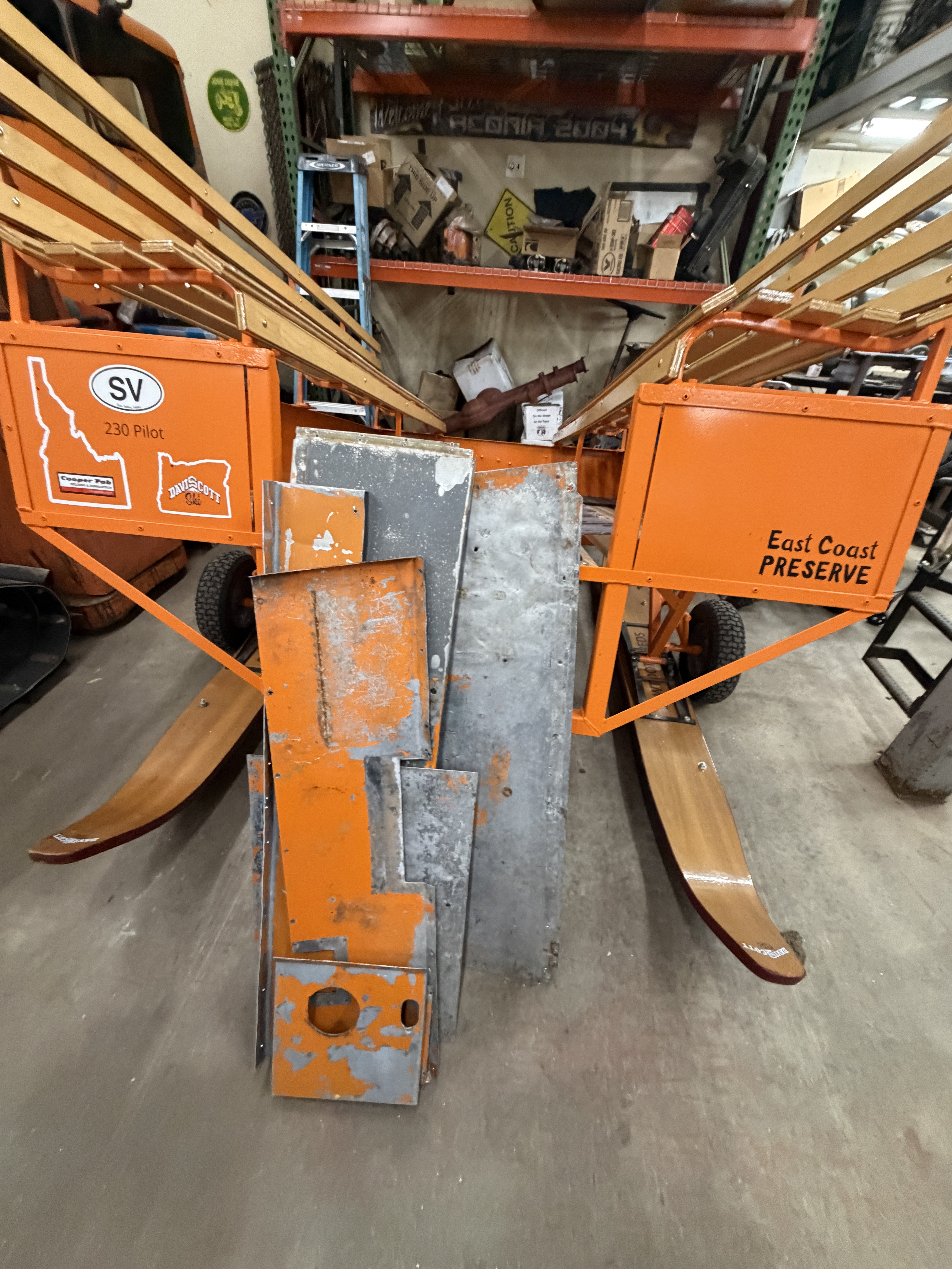

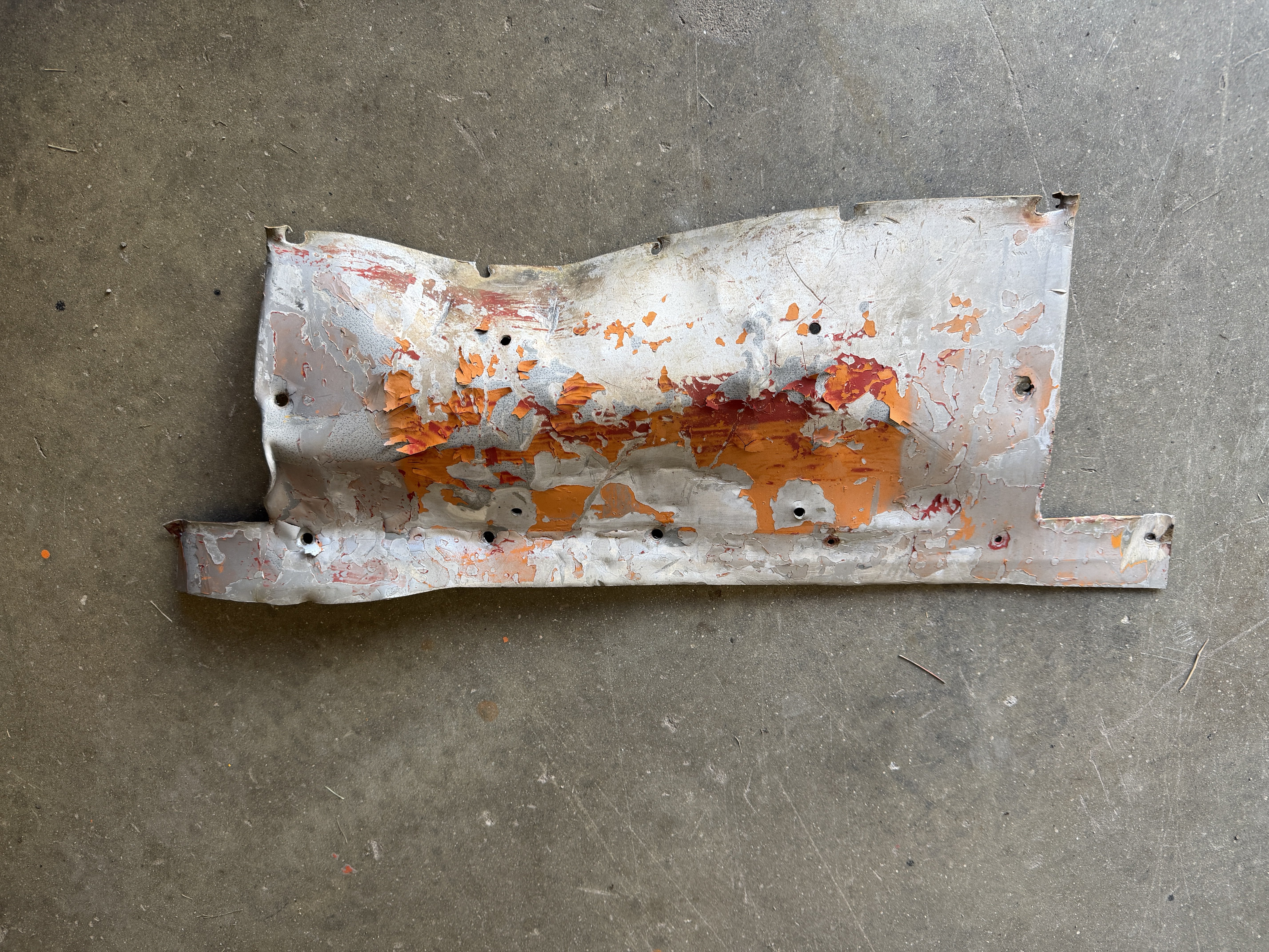

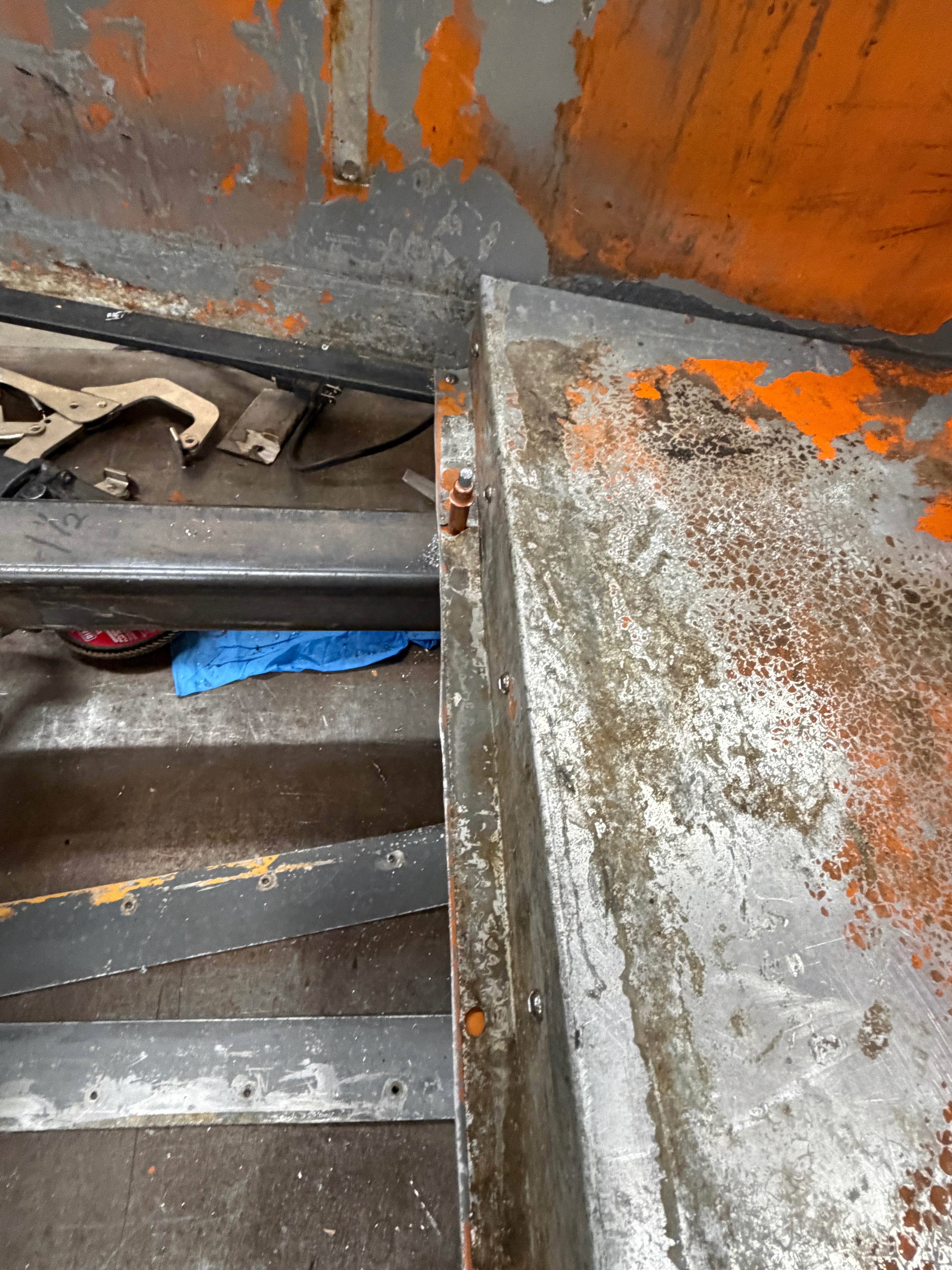

The driver side needed a little hammer action. This seemed to be the carry all side of the junkyard runner hammering the aluminum flat deck with the parts bounty it hauled in life.

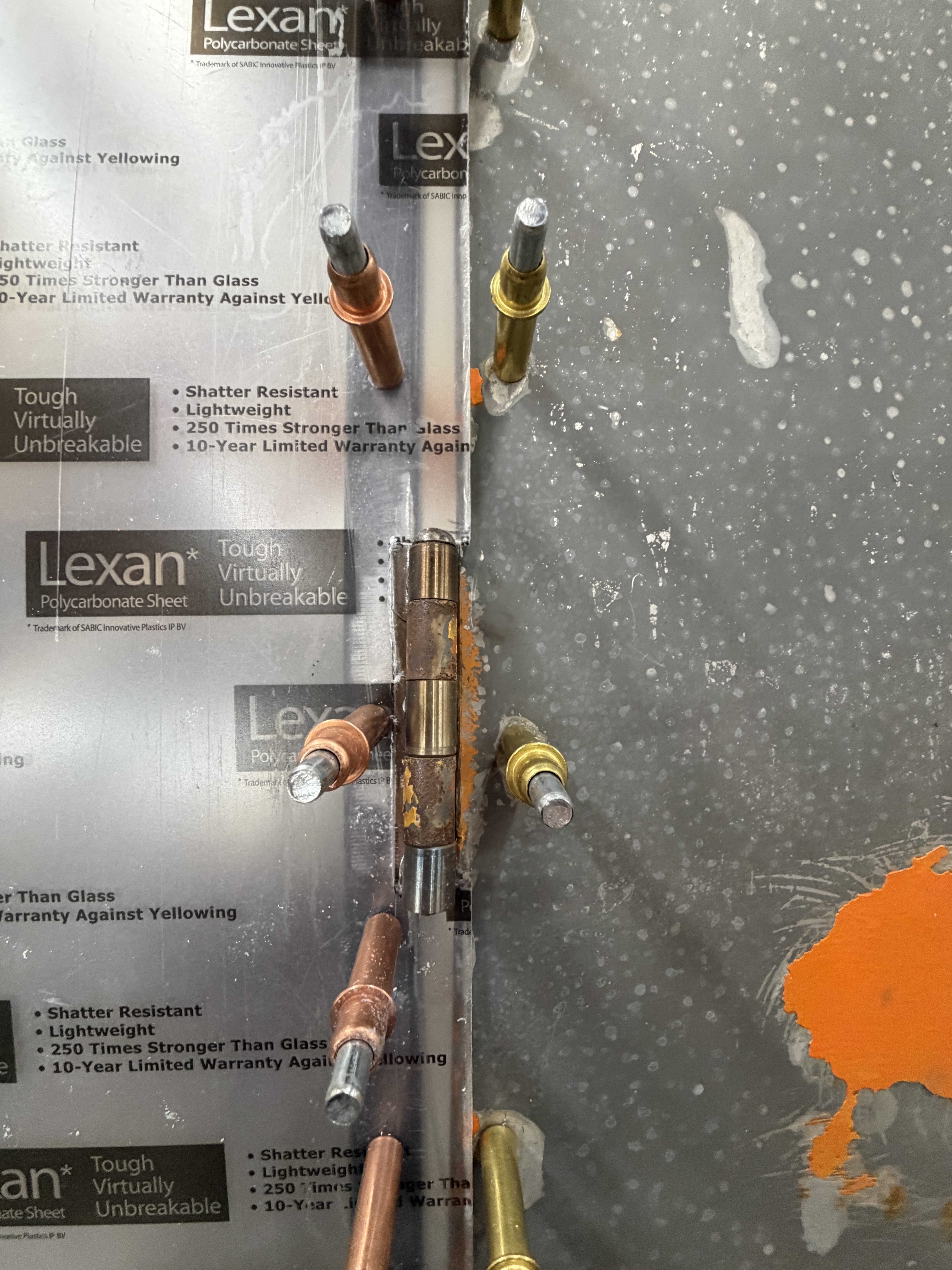

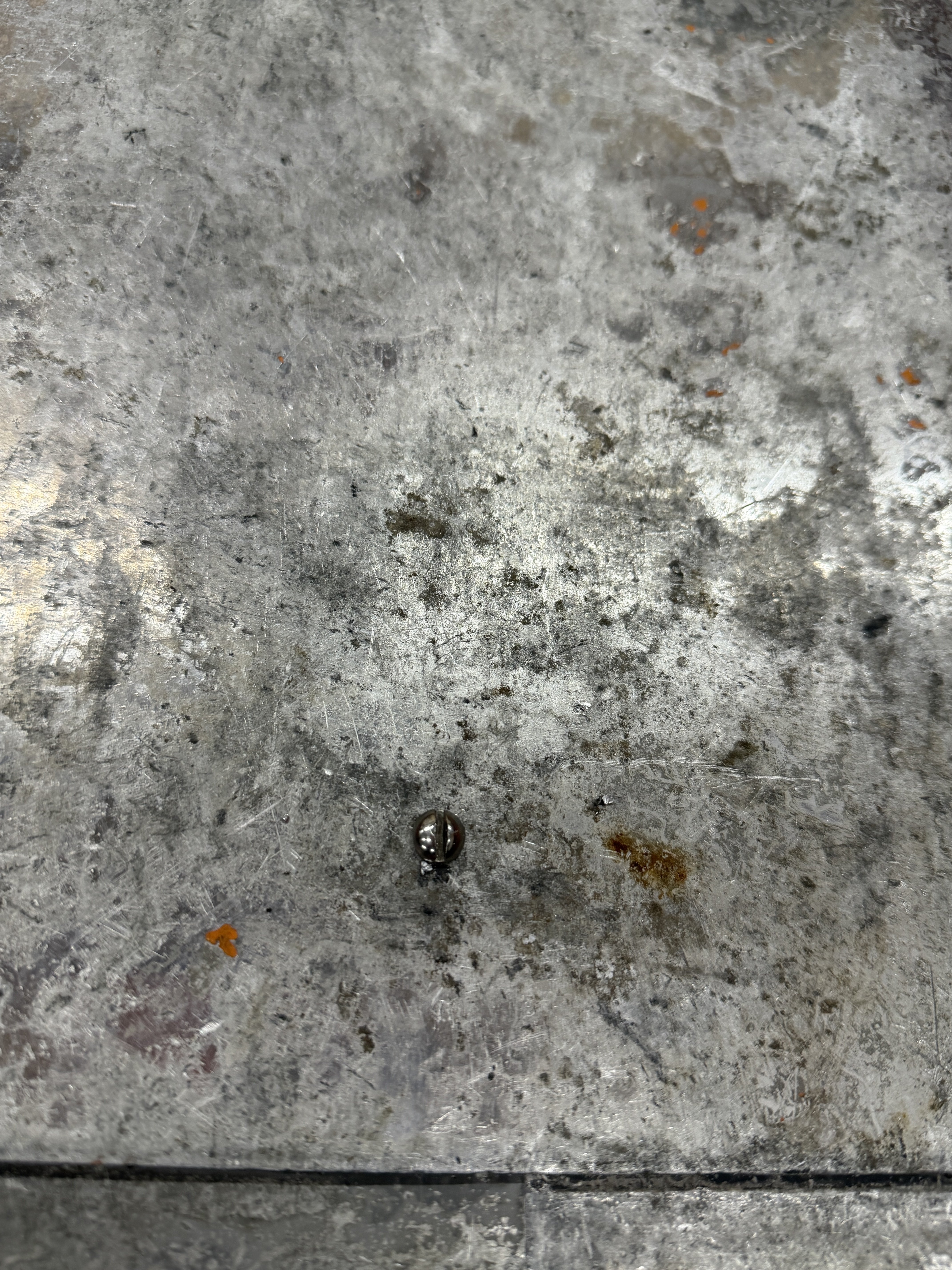

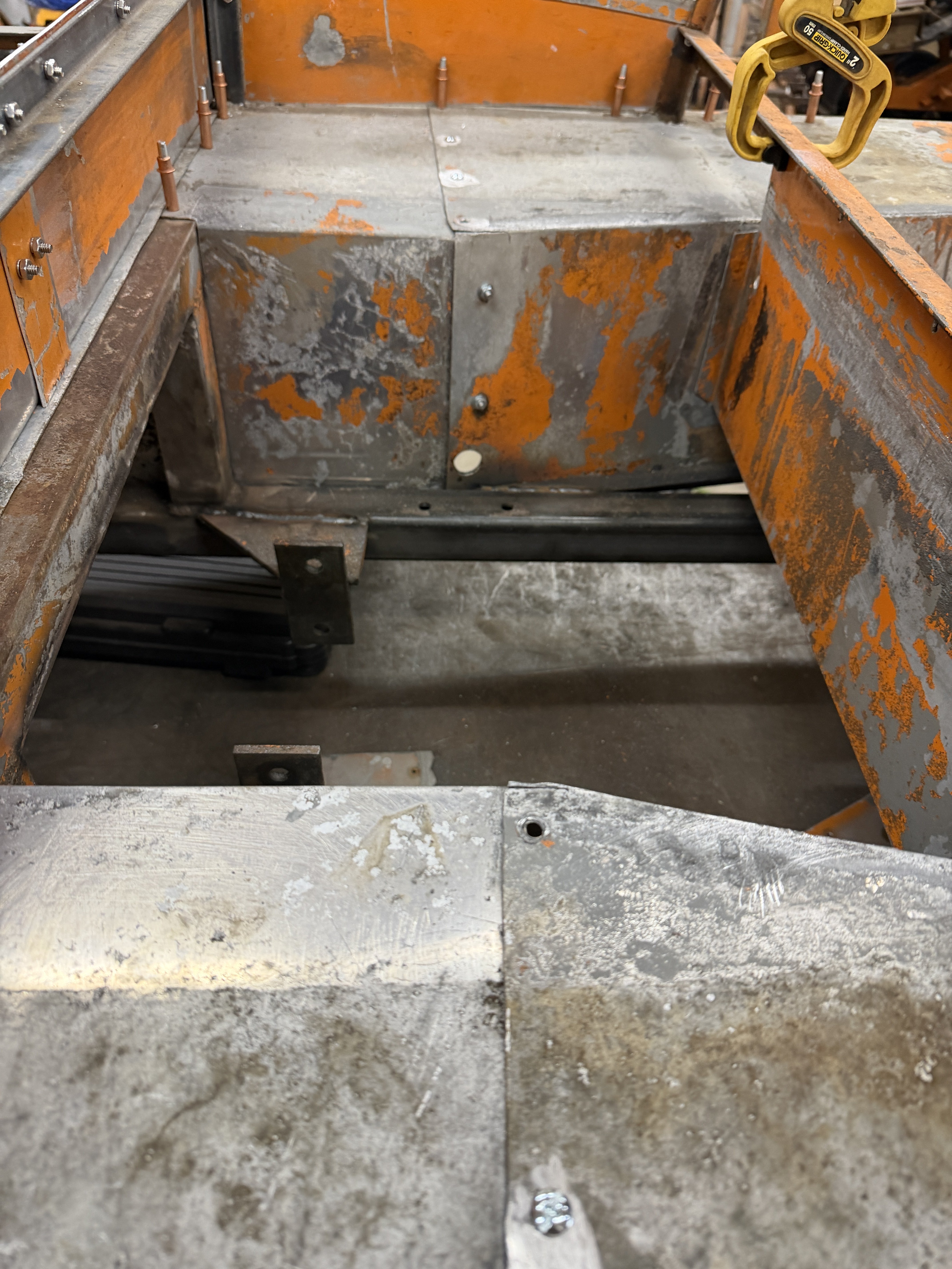

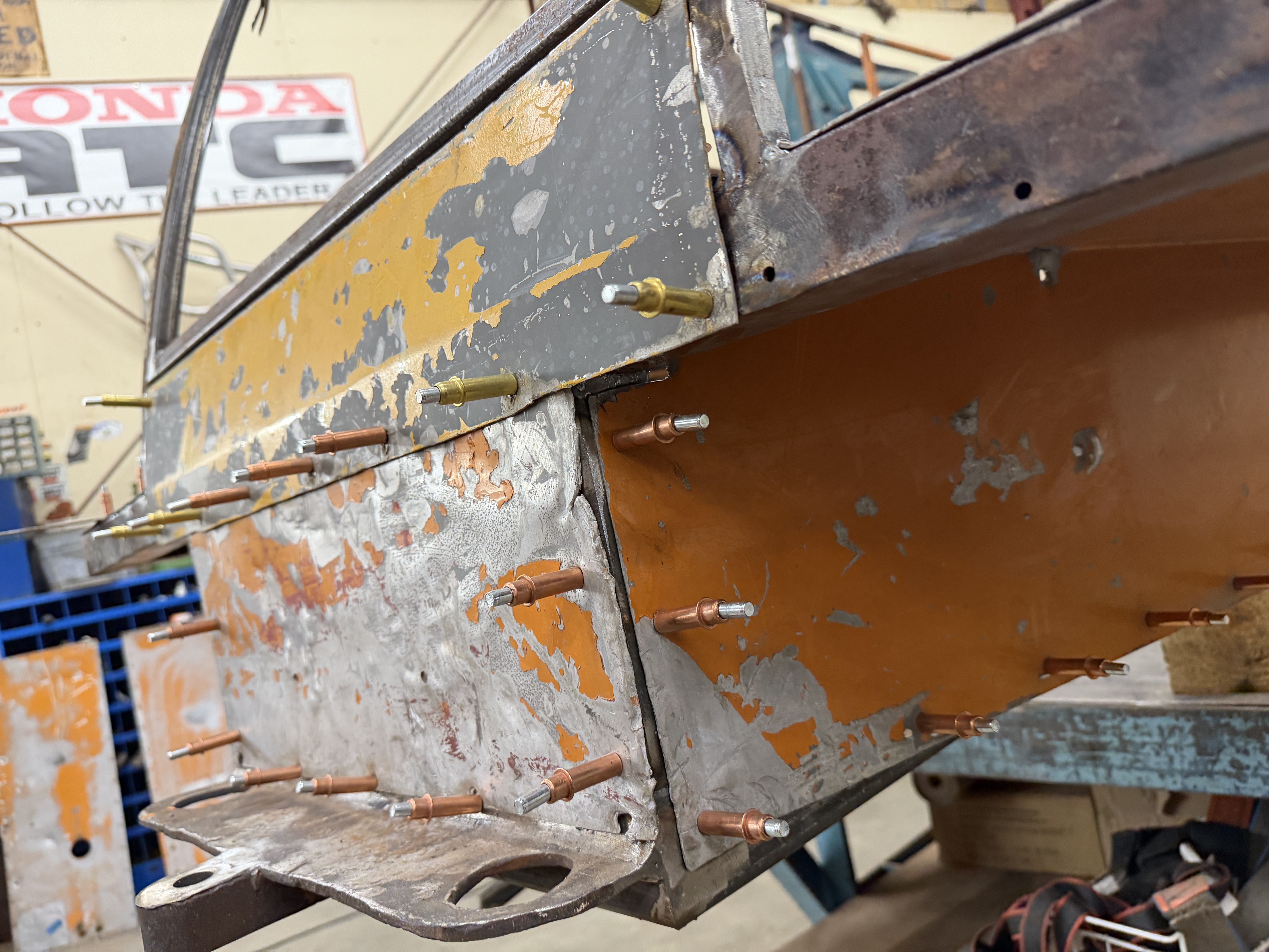

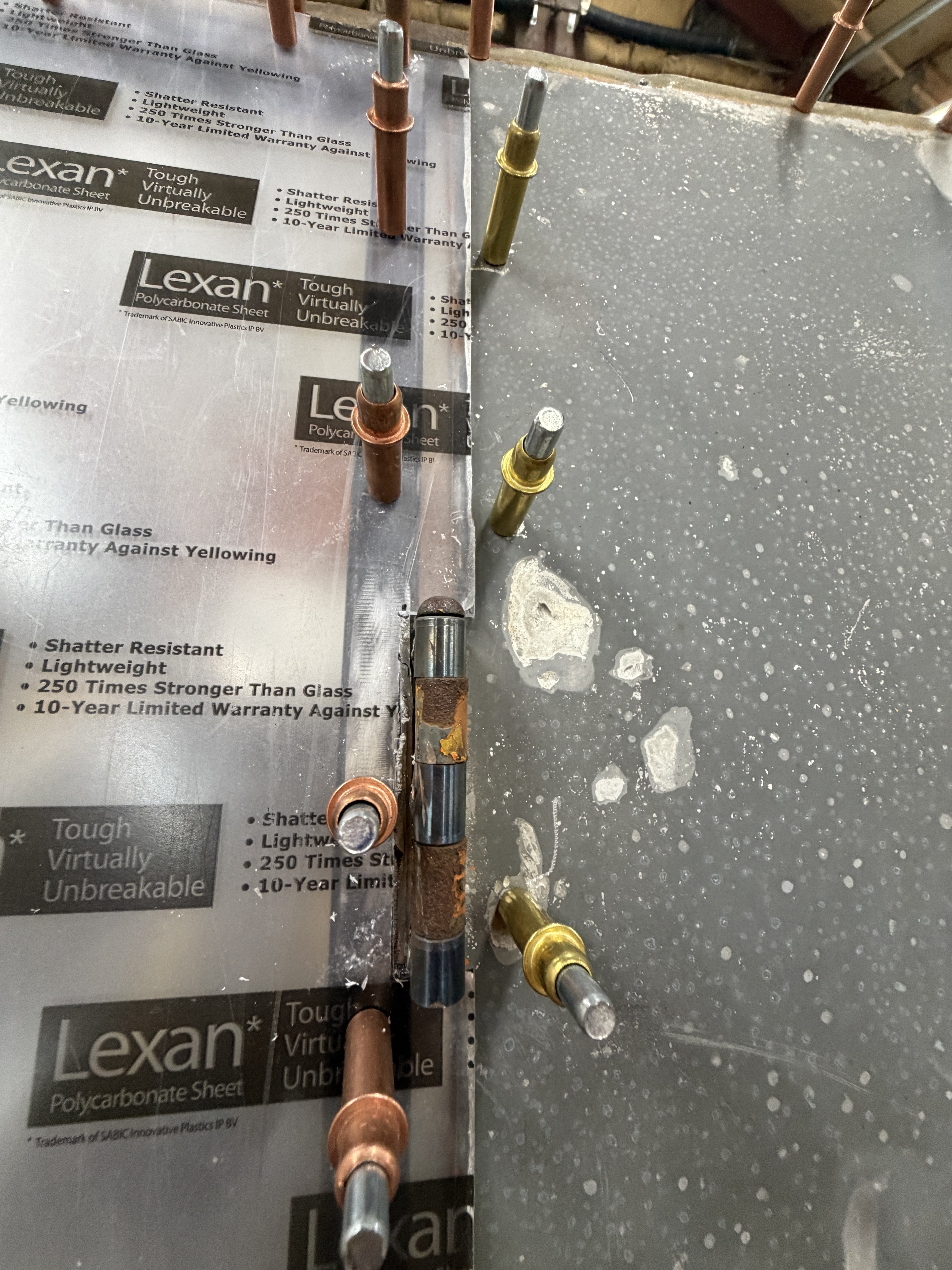

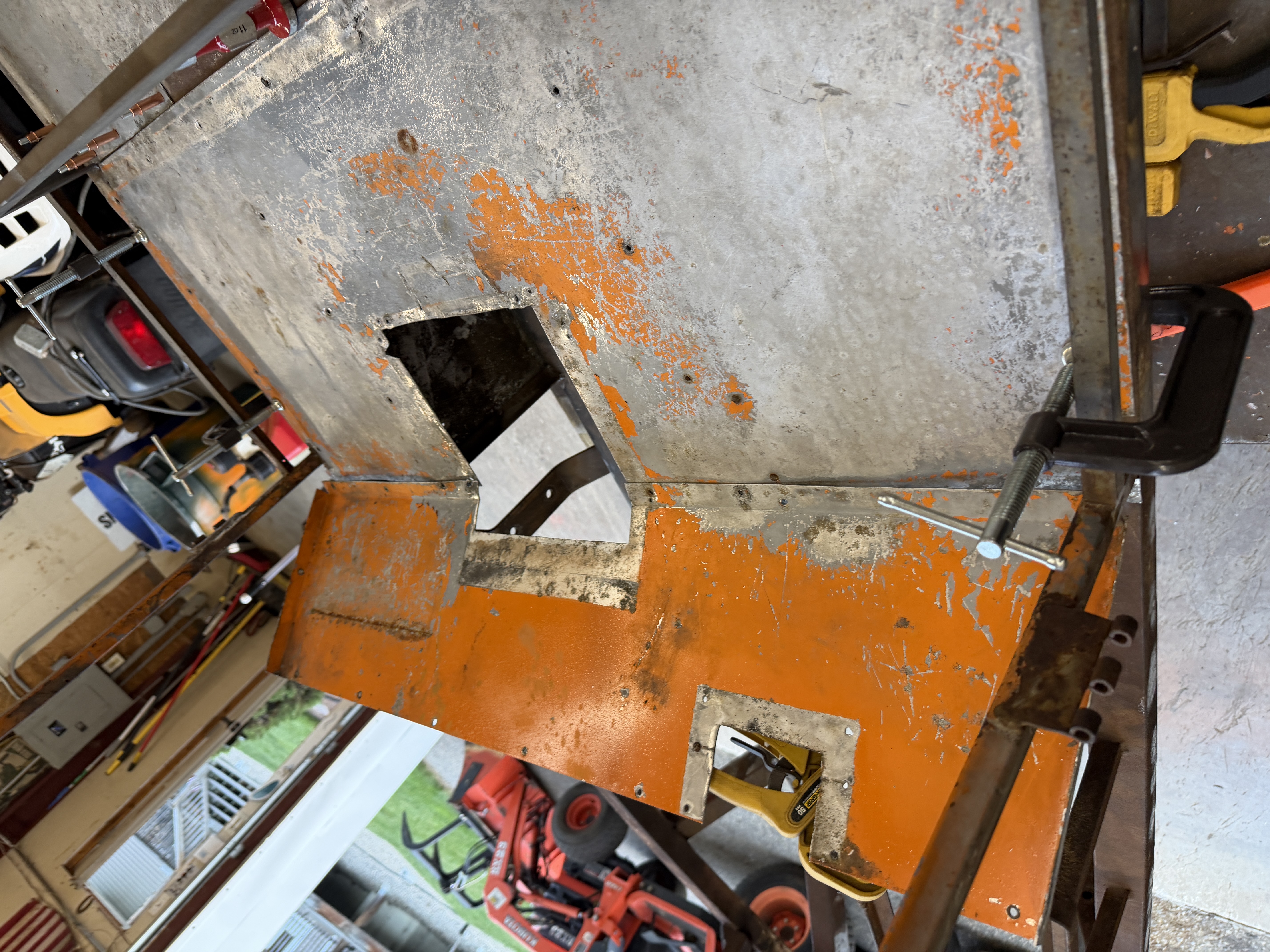

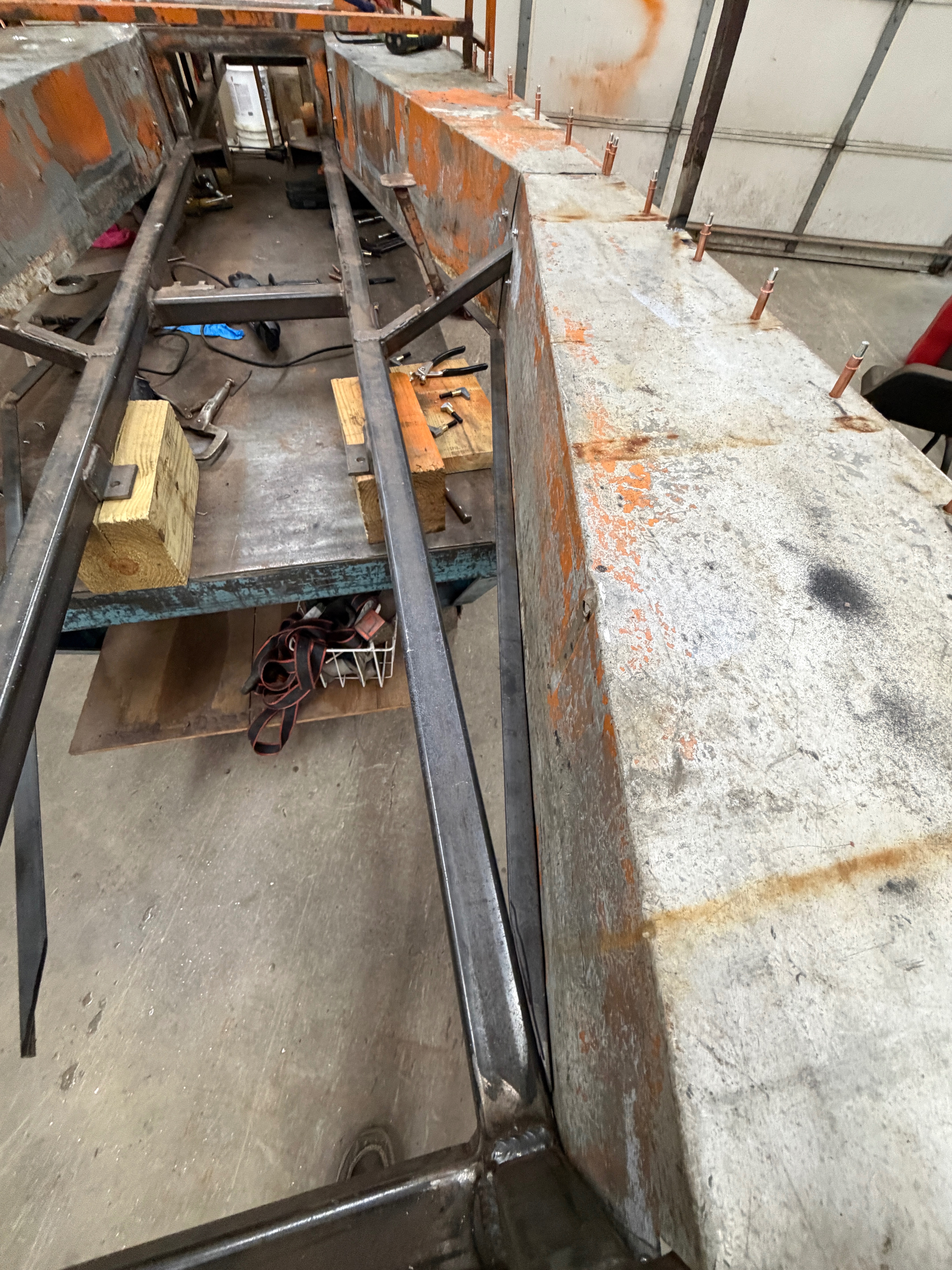

Truss-head stainless #10 flathead machine screws will be used on the aluminum body panels that thu bolt without steel frame.
Stainless closed rivets will be used on aluminum to steel OE frame for better structural integrity. Lower new frame and coffin supports could use screws but i’m not.
Galvanic corrosion was most likely not a design factor back in the day and if it was machines were not designed to last long enough to care.
Stainless is the best choice and as much as I want to put screw back l, rivets are more secure due to the load bearing nature of Tucker Tolerance!
