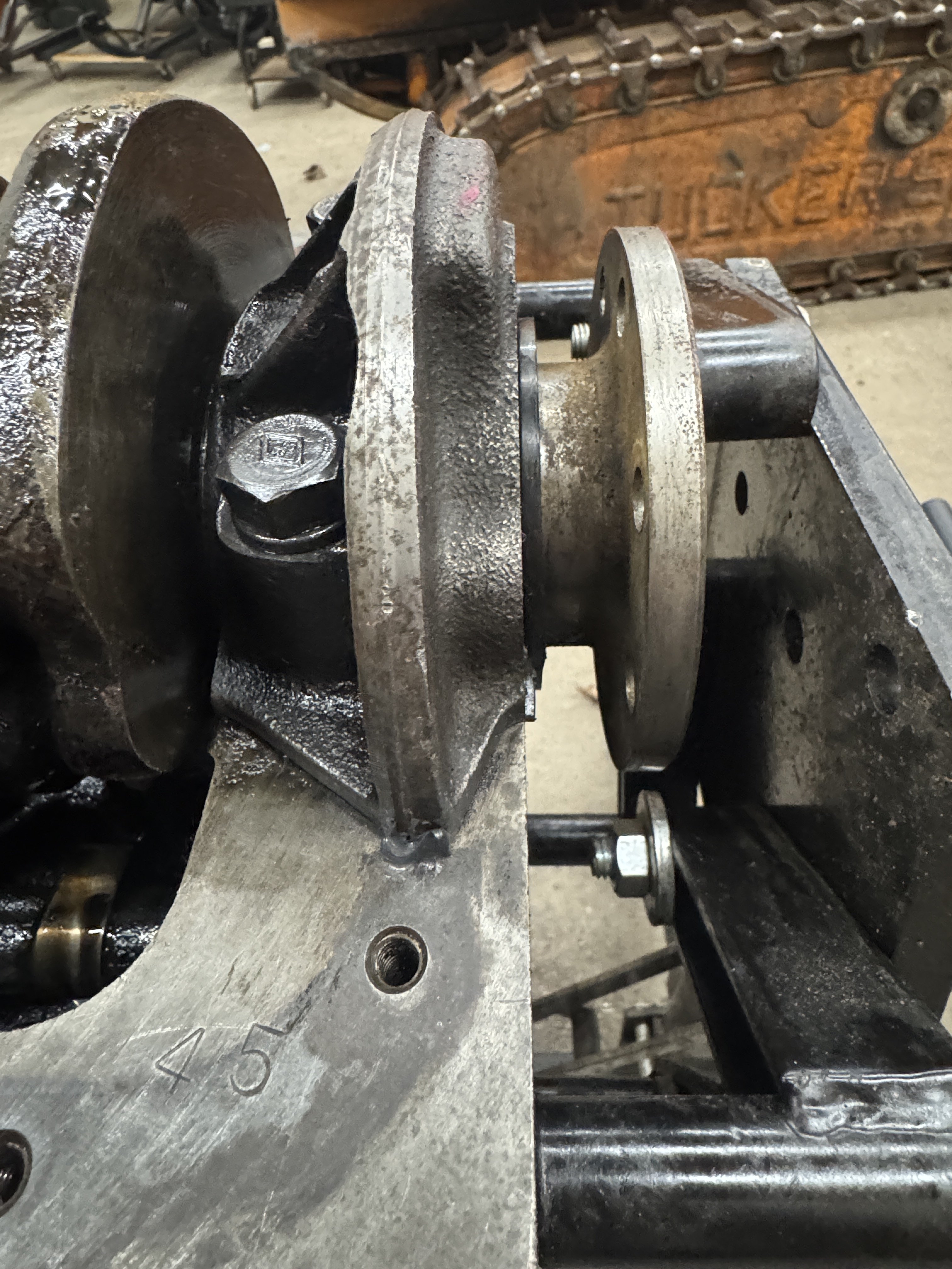

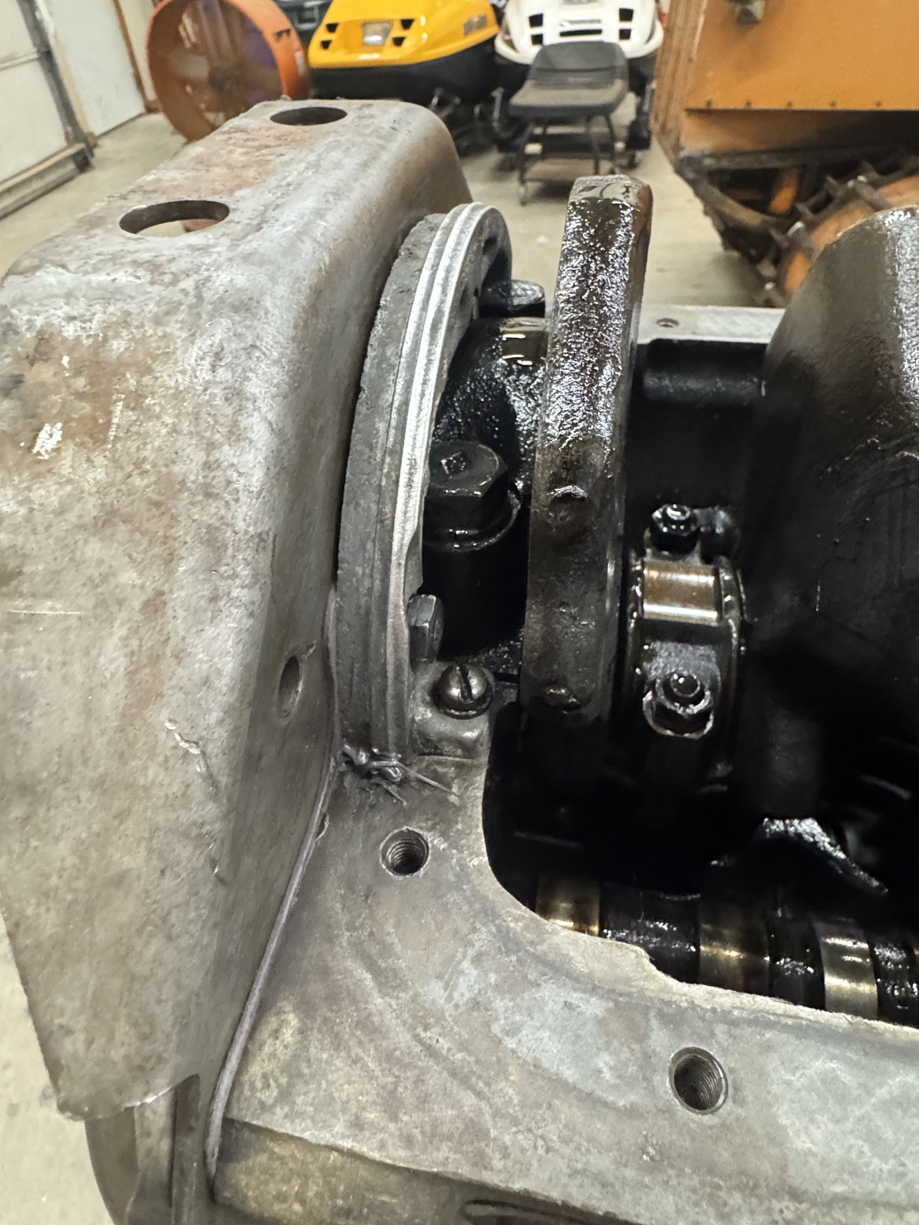

at this stage based on what i see id just bite the bullet and rebuild that thing properly, crank looks terrible, block deck is beat, all that sludge is trapping debris etc, at the very least hot tank, deck, hone rings bearings and a quick bump on the seats grind valves
Well within Tucker Tolerance for this preservation.
I pray my crank bearings look this good at 72 years

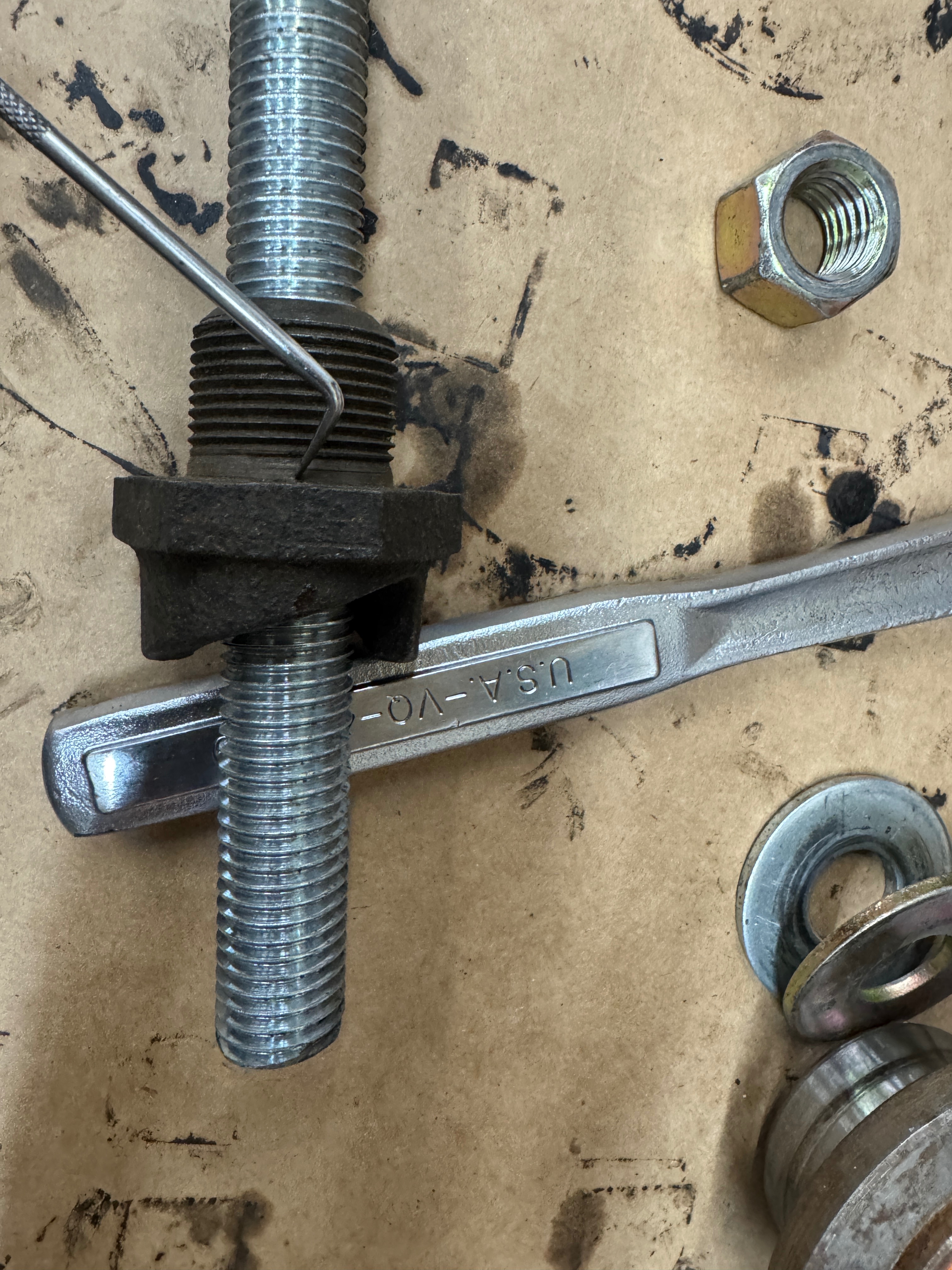

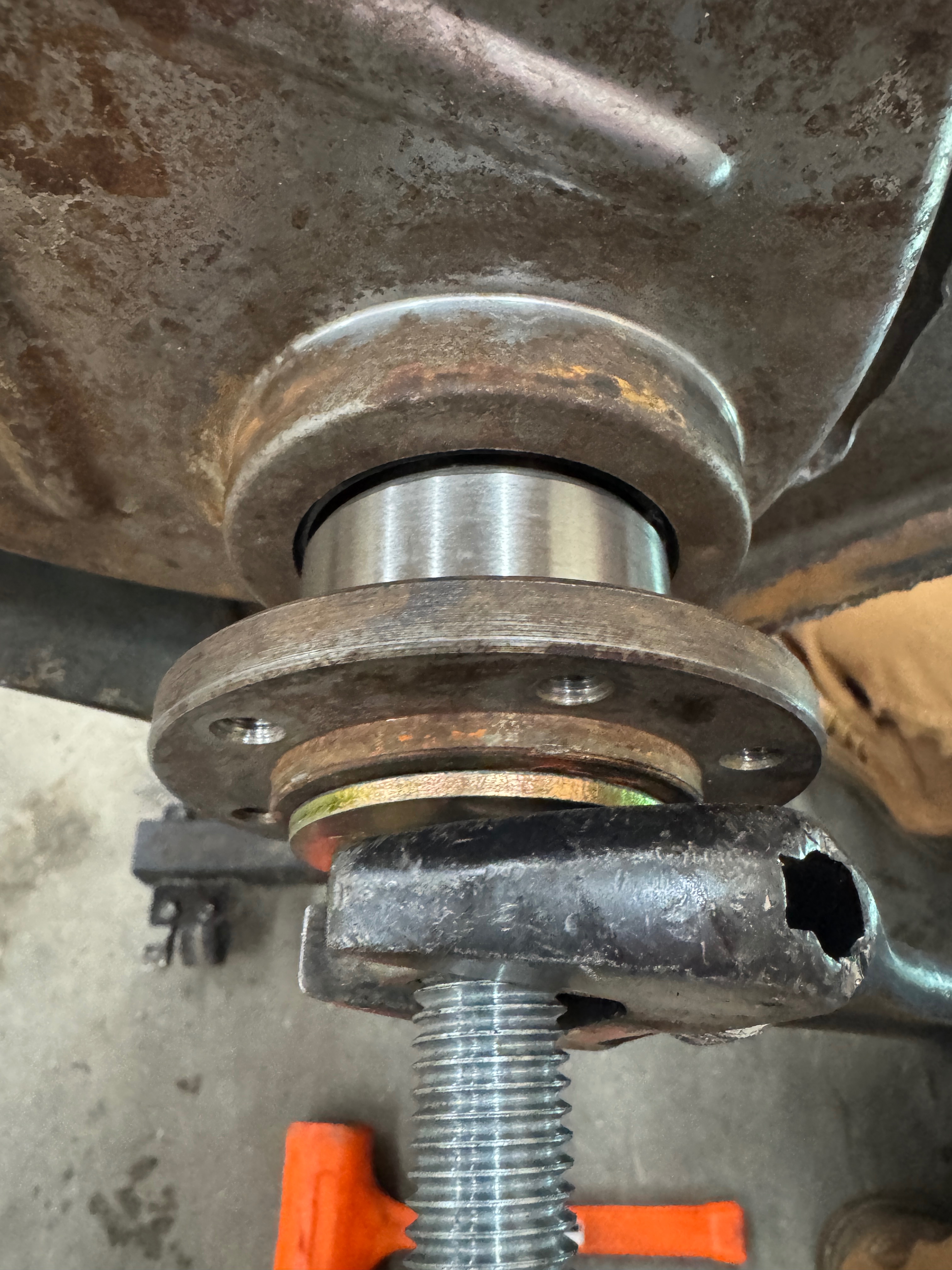

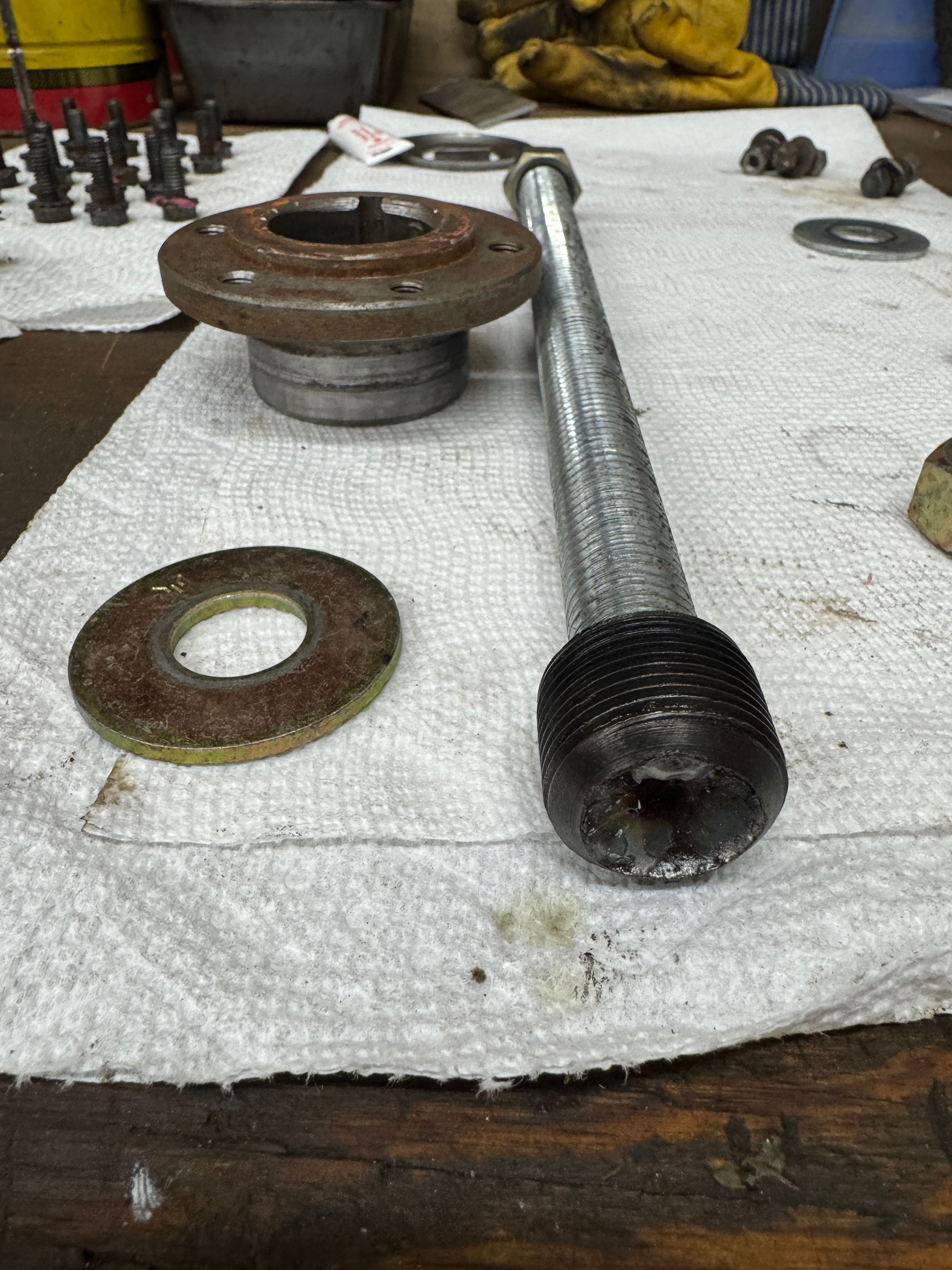

Can’t find a crank pulley install tool so we will fabricate one out of another hand crank nut.
Will cut the crank jaw off and weld on the threaded rod. This will allow proper draw and alignment.

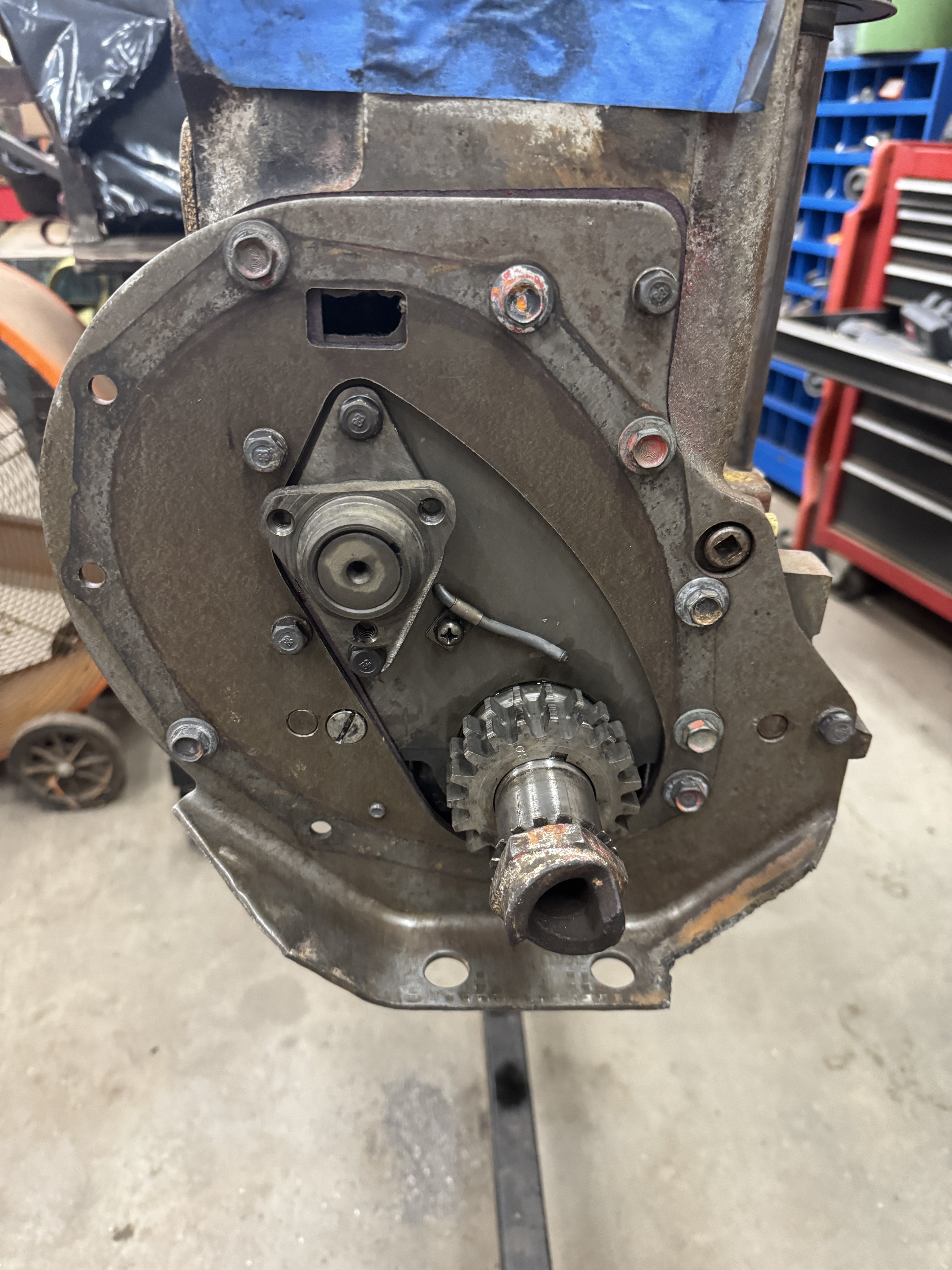

Timing cover plate/engine mount back on regasketed and torqued. Will have to remove and thread seal a number of the fasteners when the timing cover goes on.

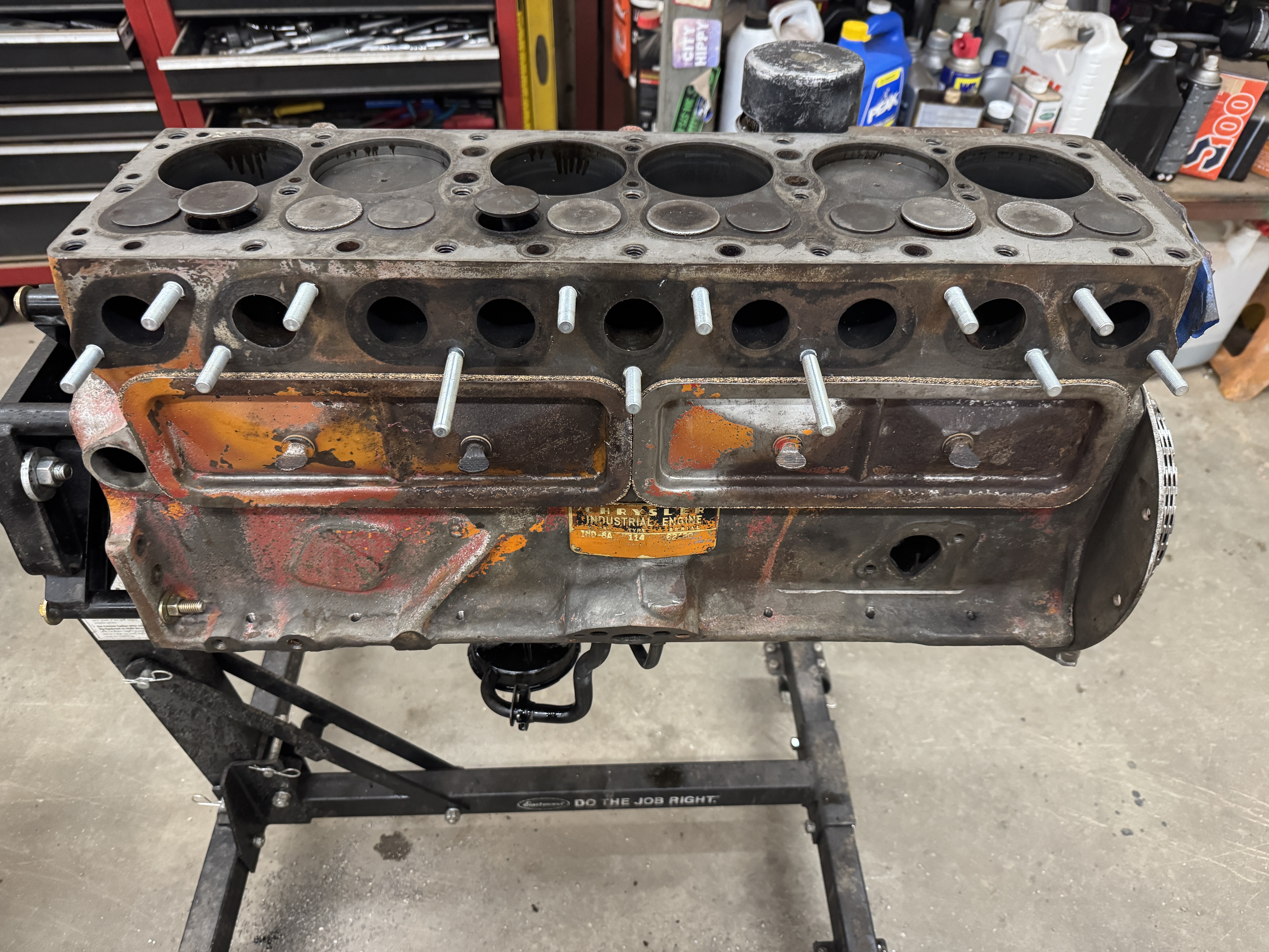

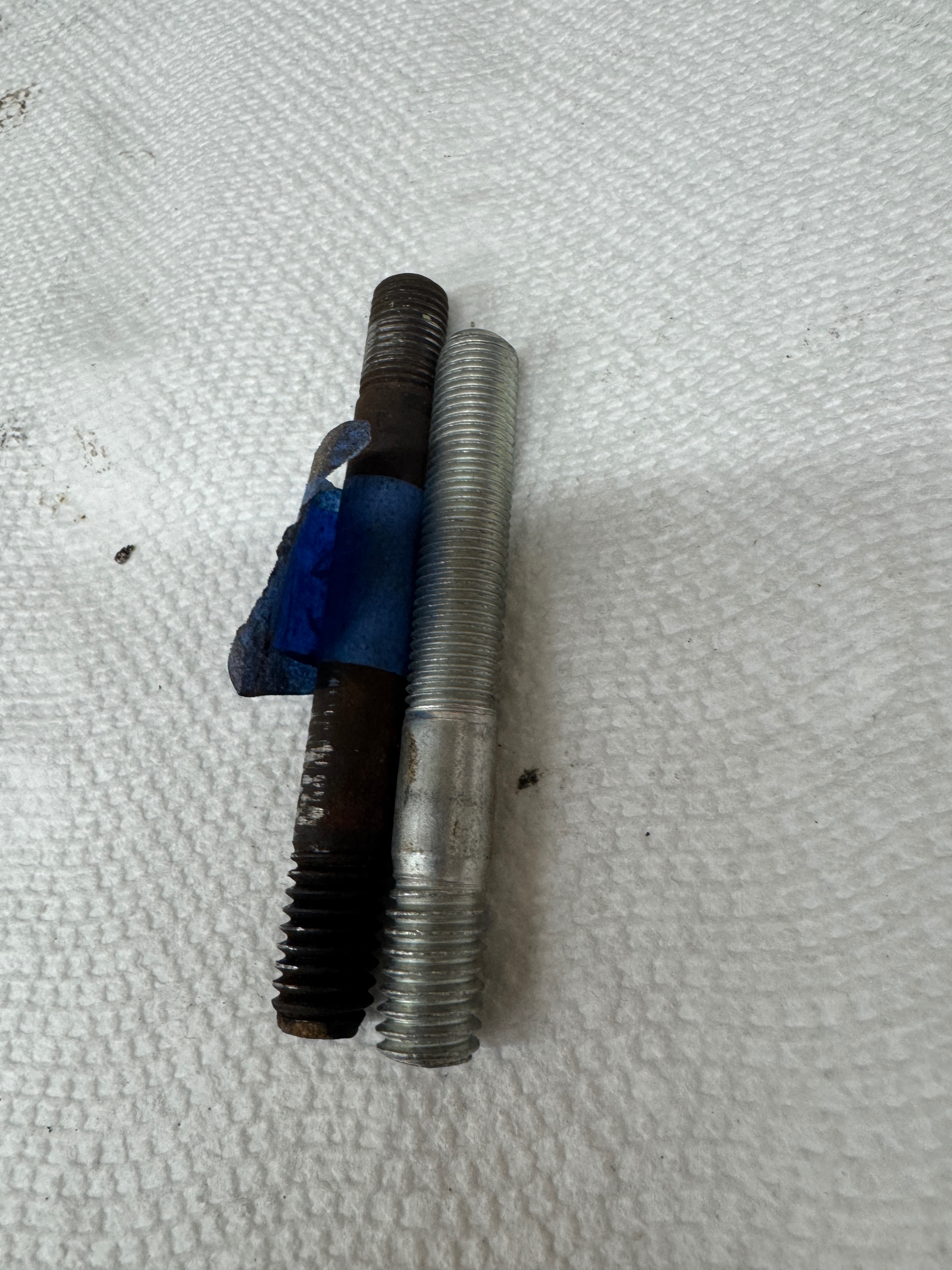

New intake/exhaust studs installed. Most of these are in the water jacket so Permatex high temp thread sealant was used. 3/4 a turn is all you need which is plenty of sealant.
For stud install, I like to jam two nuts then tighten until the nuts start to slip on the stud for torque spec.
Fabricated the crank pulley installation tool out of hand crank not cutting of the jaw and welding in a rod.

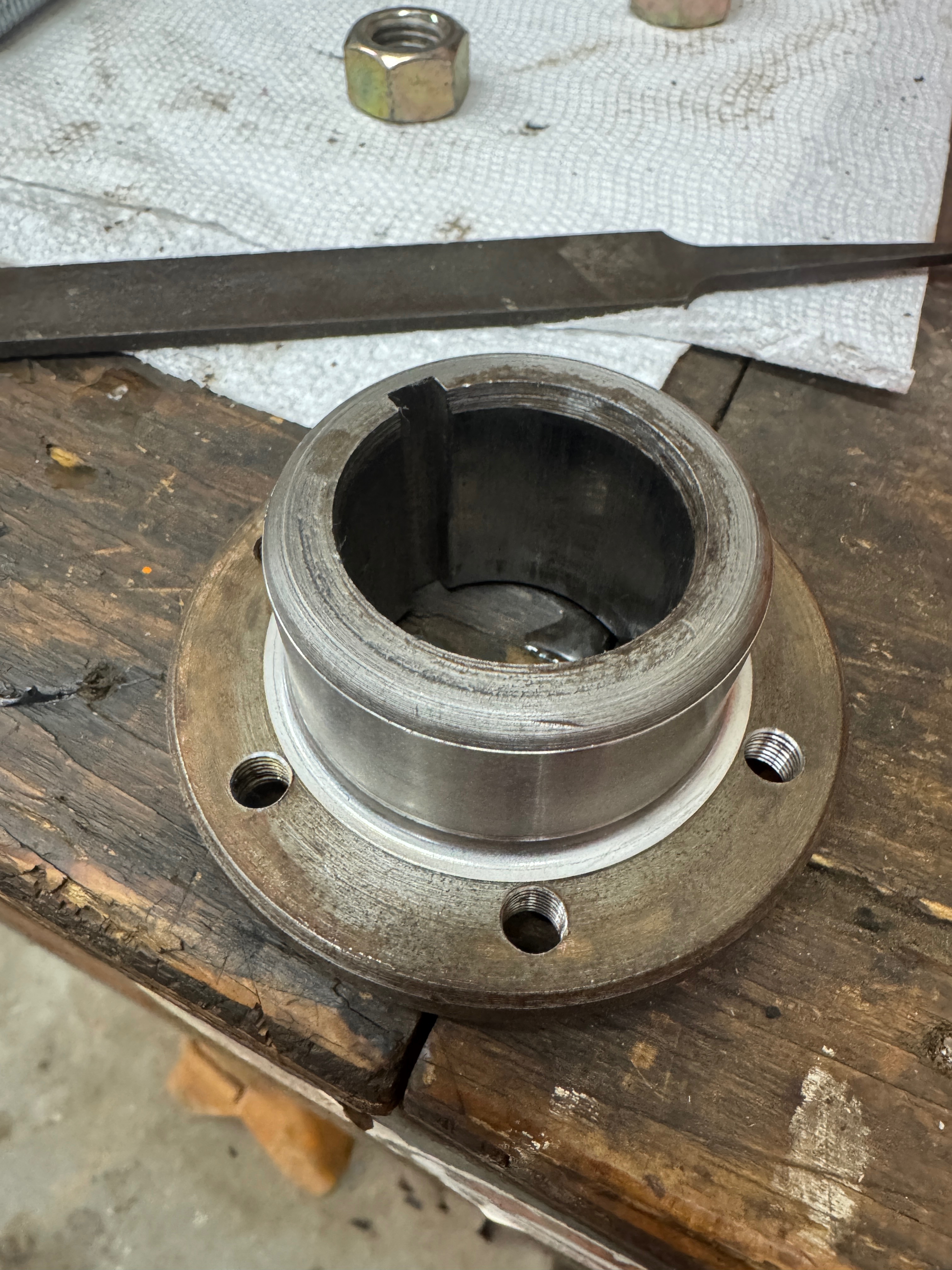

Hand filed the key, key ways, and crank hub to clean up the burrs for a smooth install while waiting on parts and pieces.

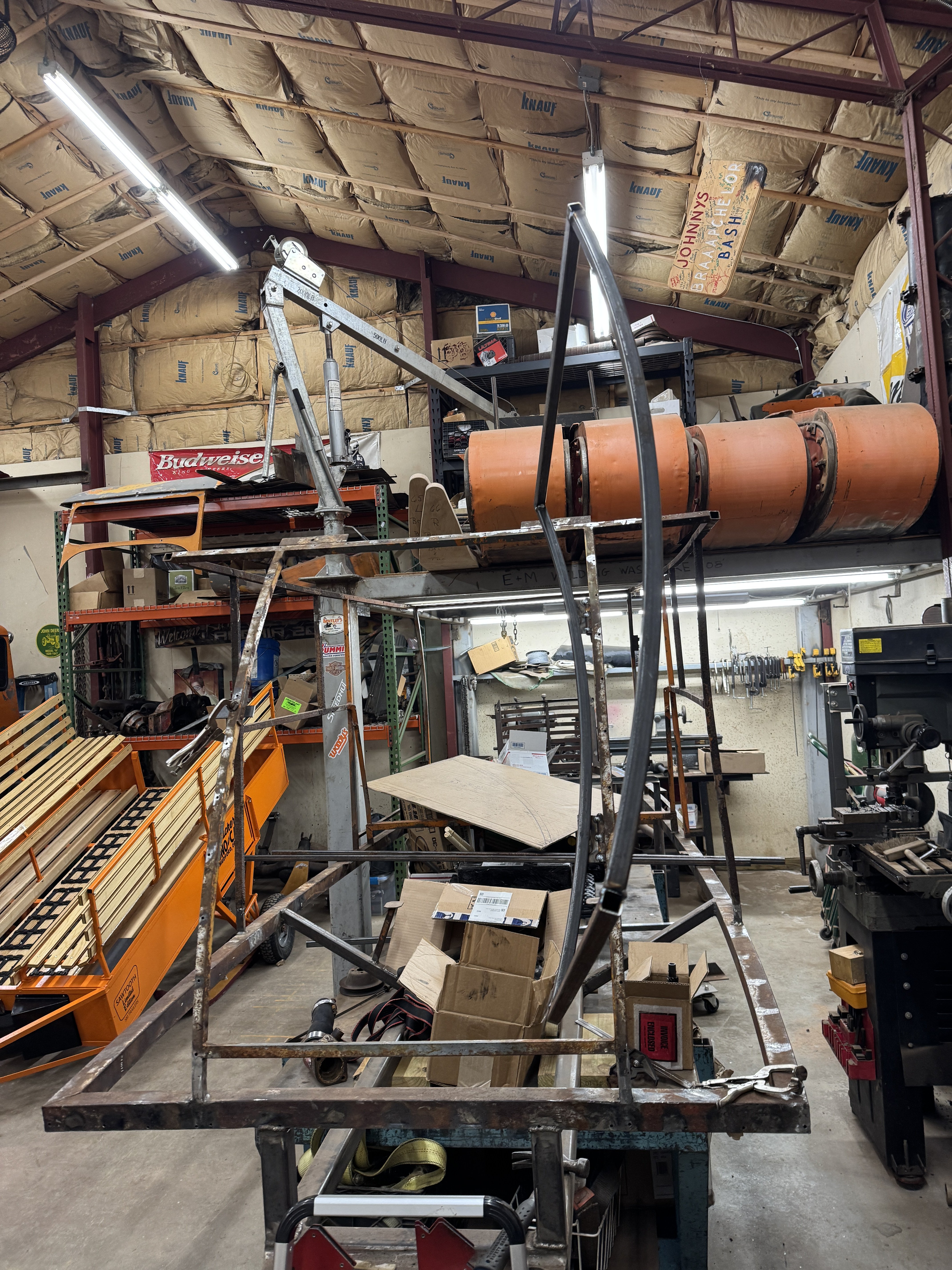

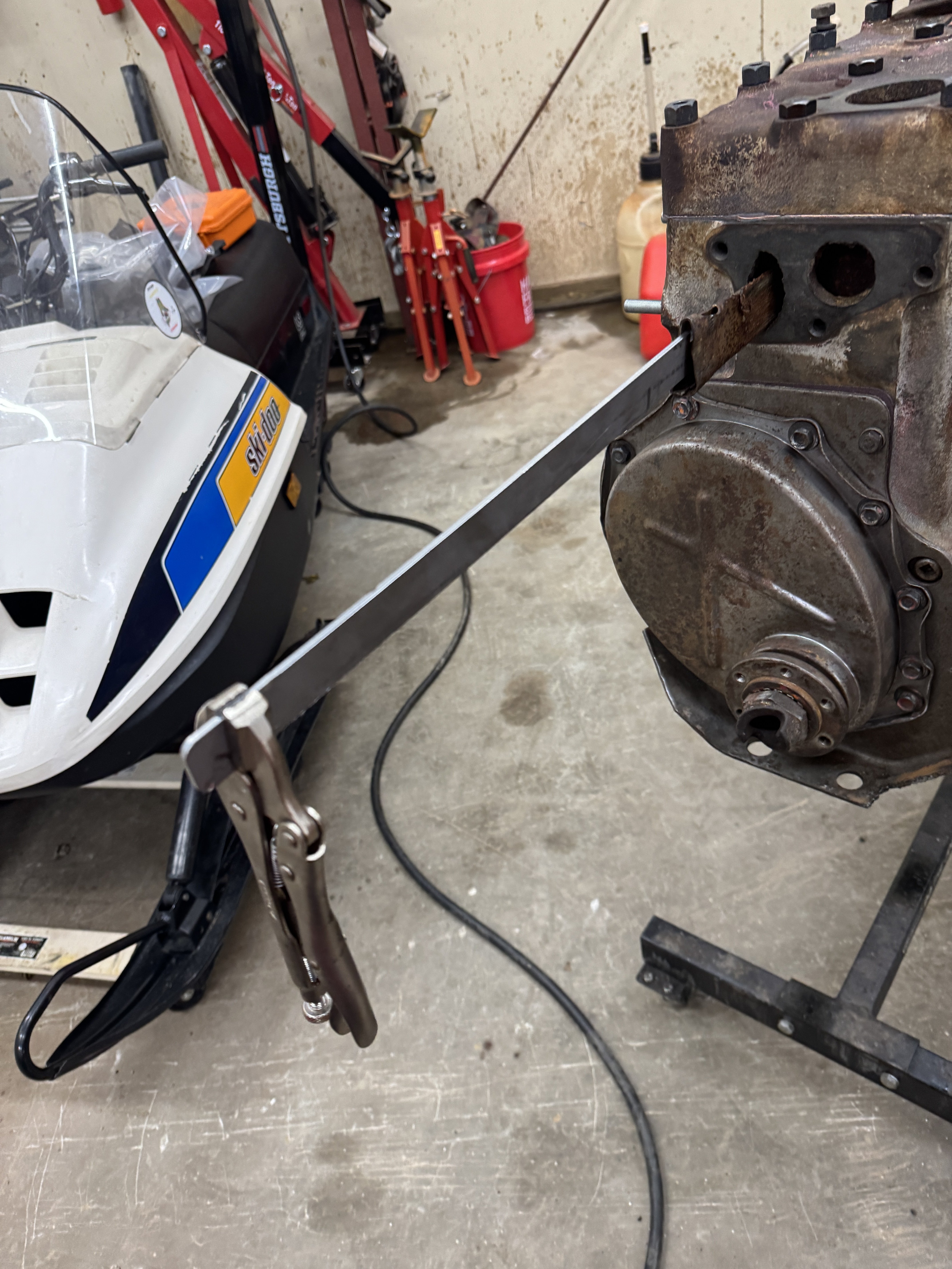

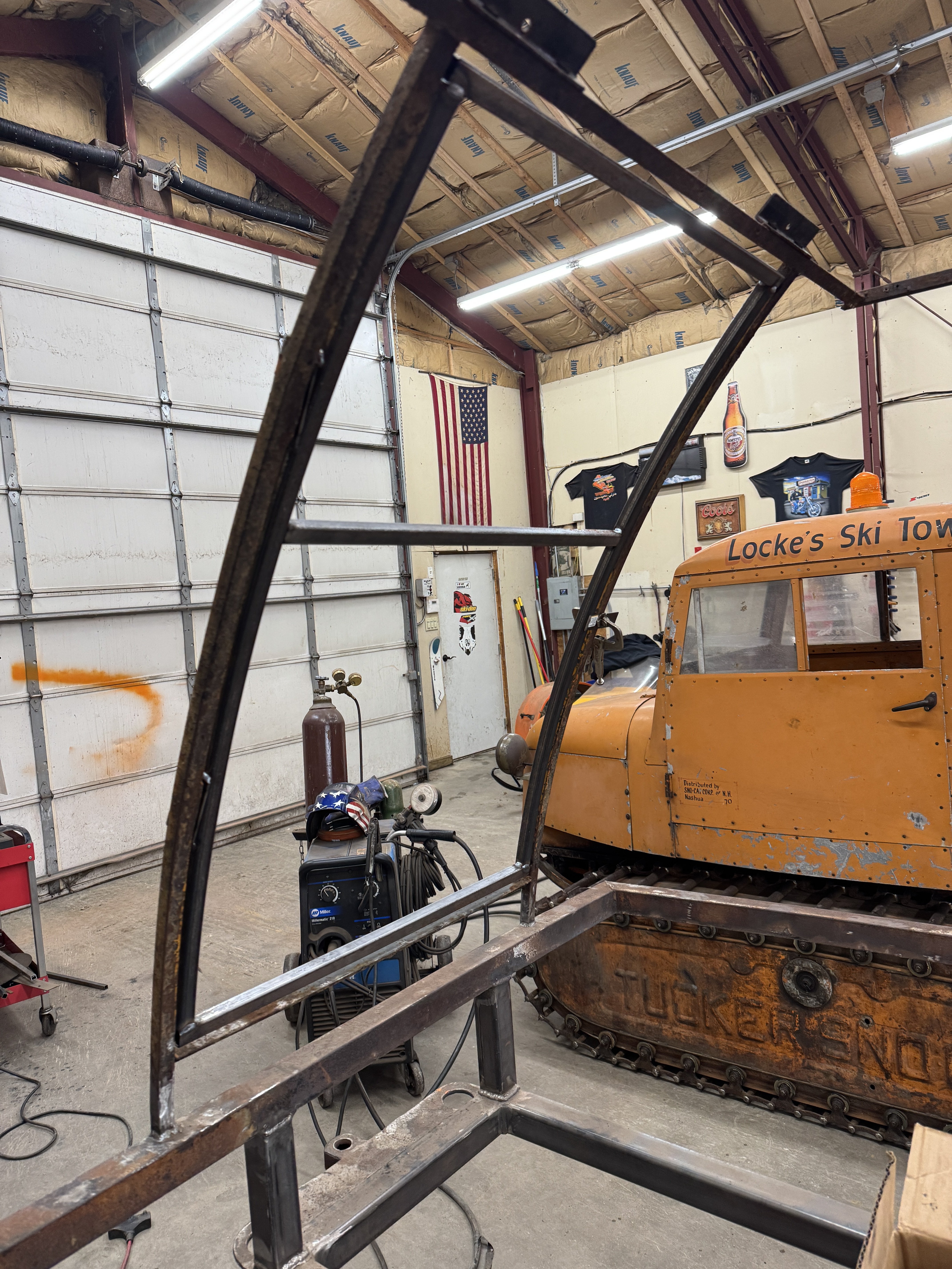

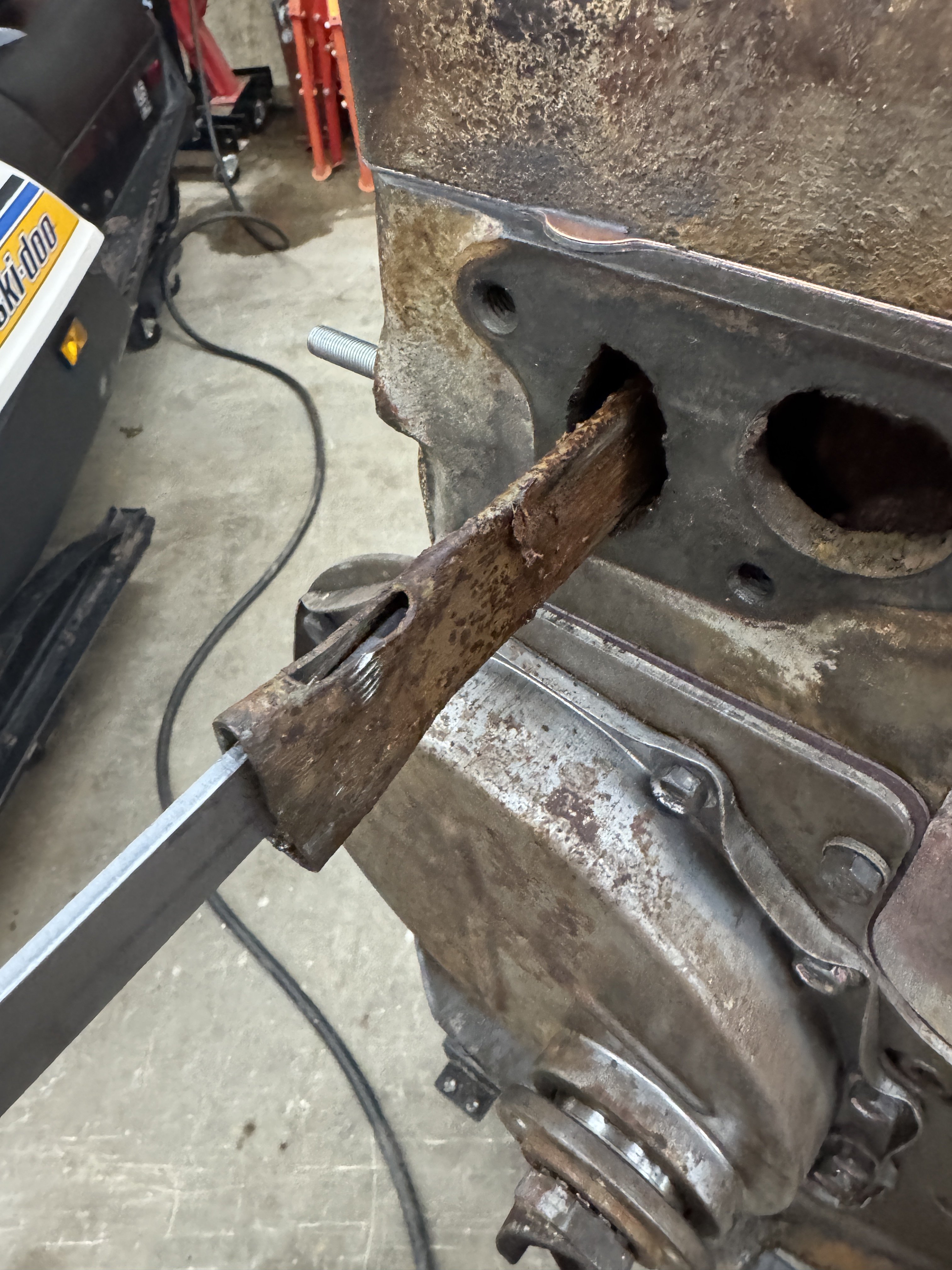

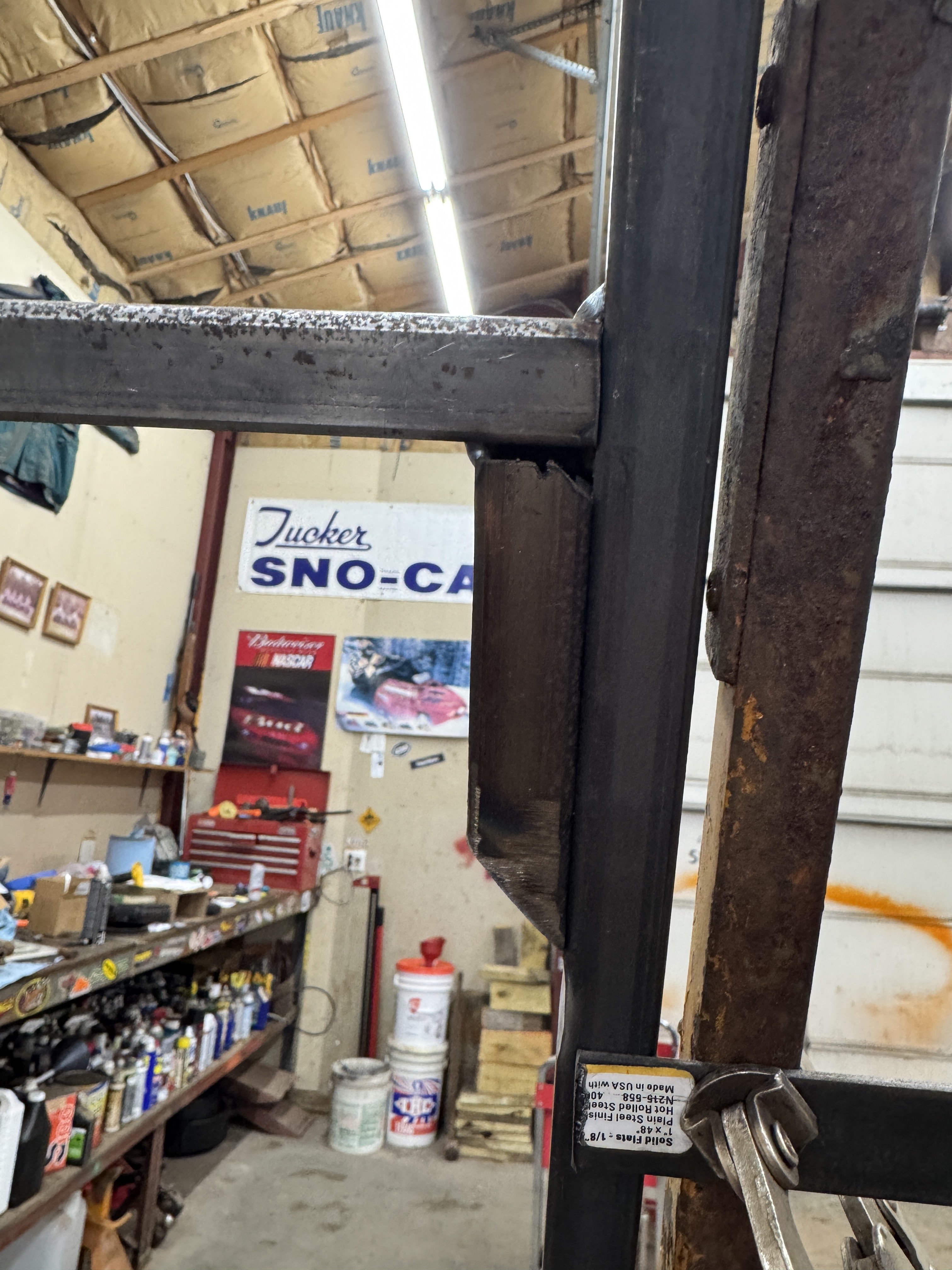

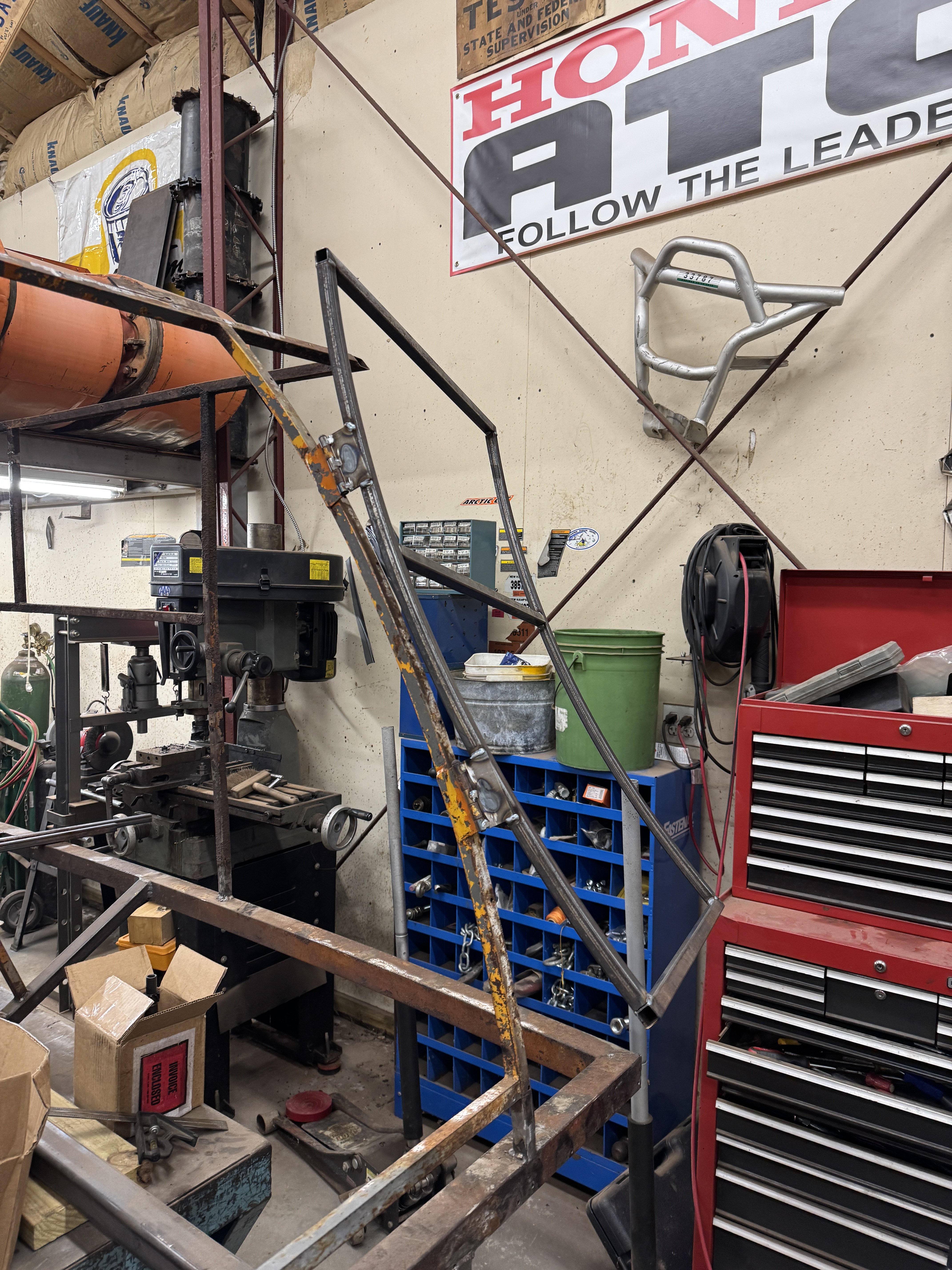

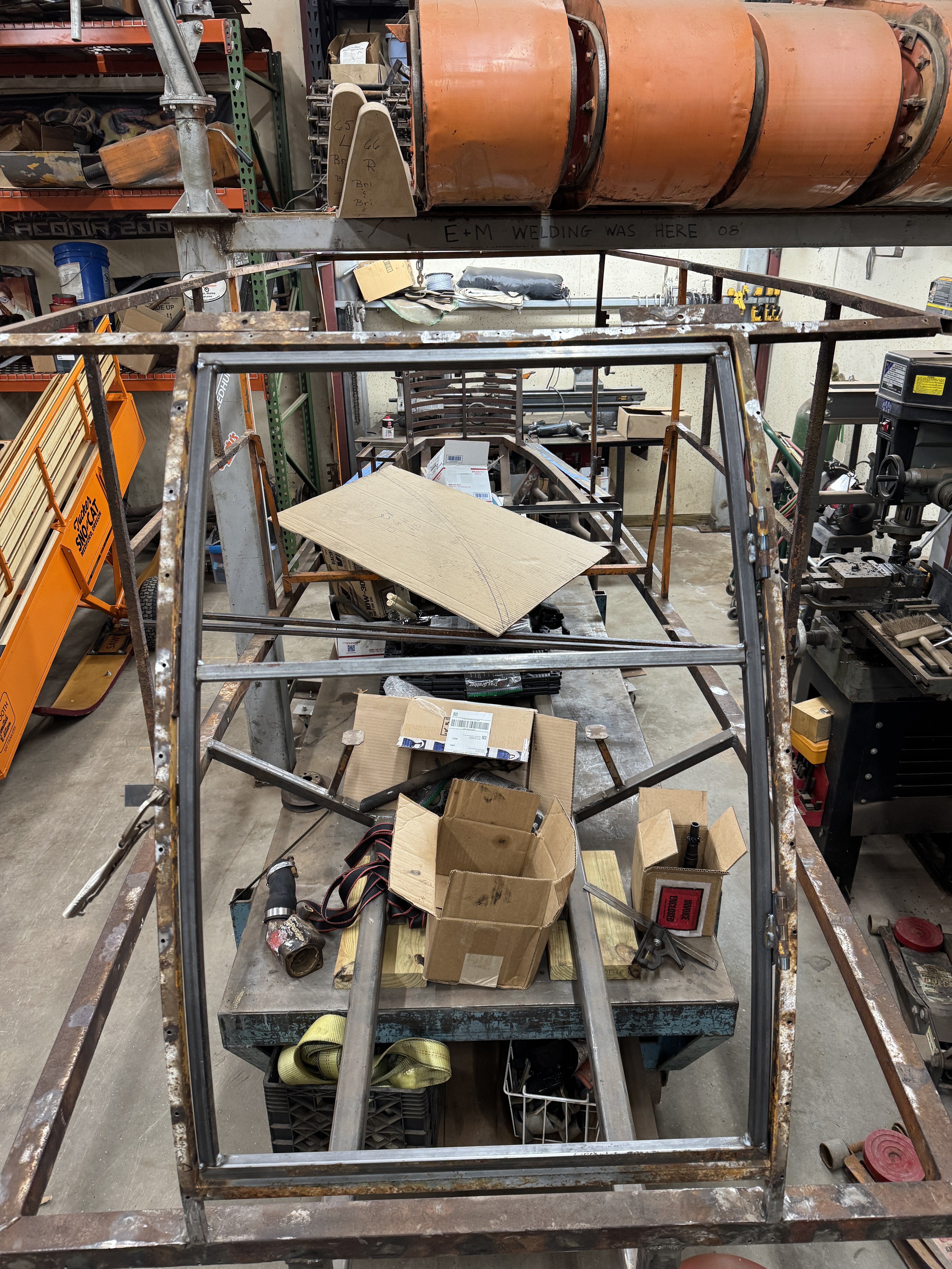

Template for the missing door using high strength thick wall 14 gauge square tube like

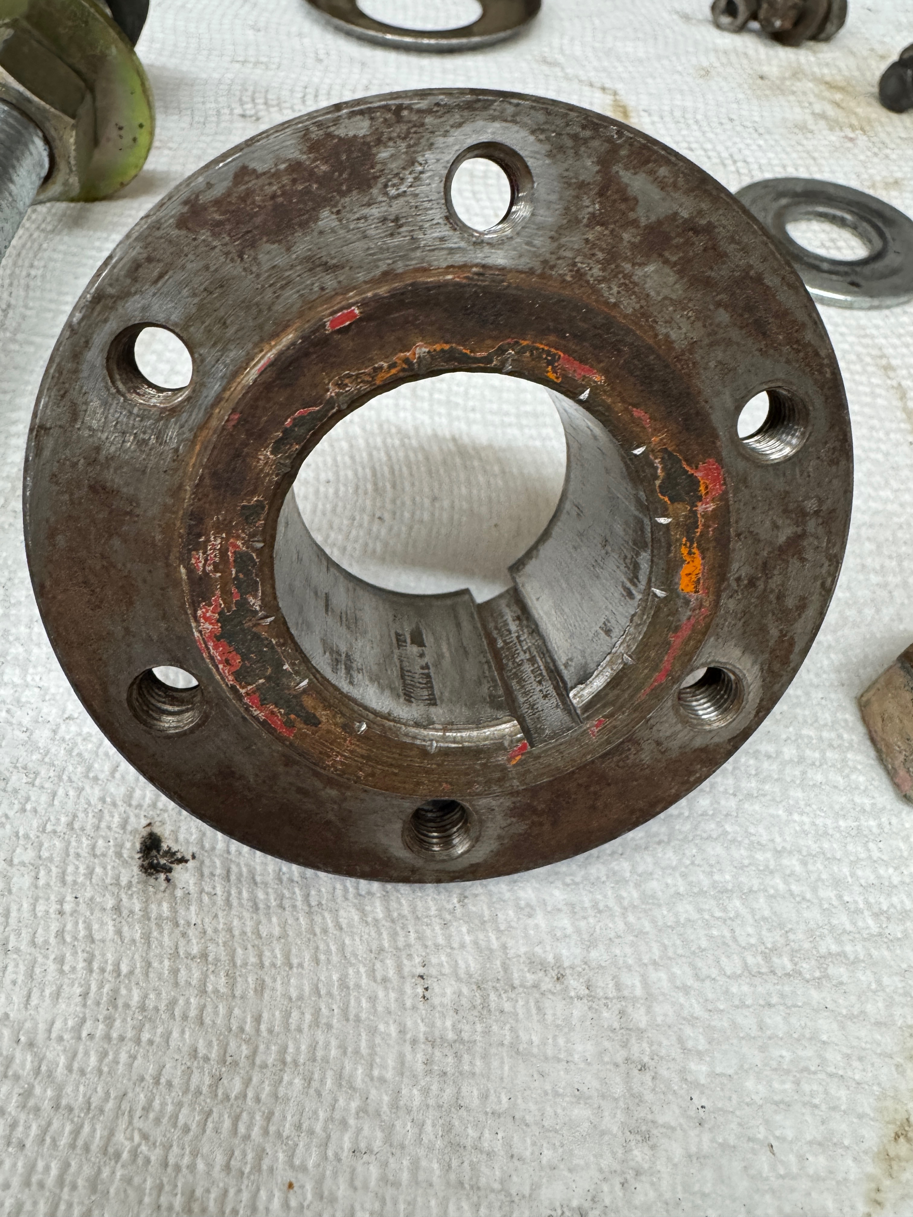

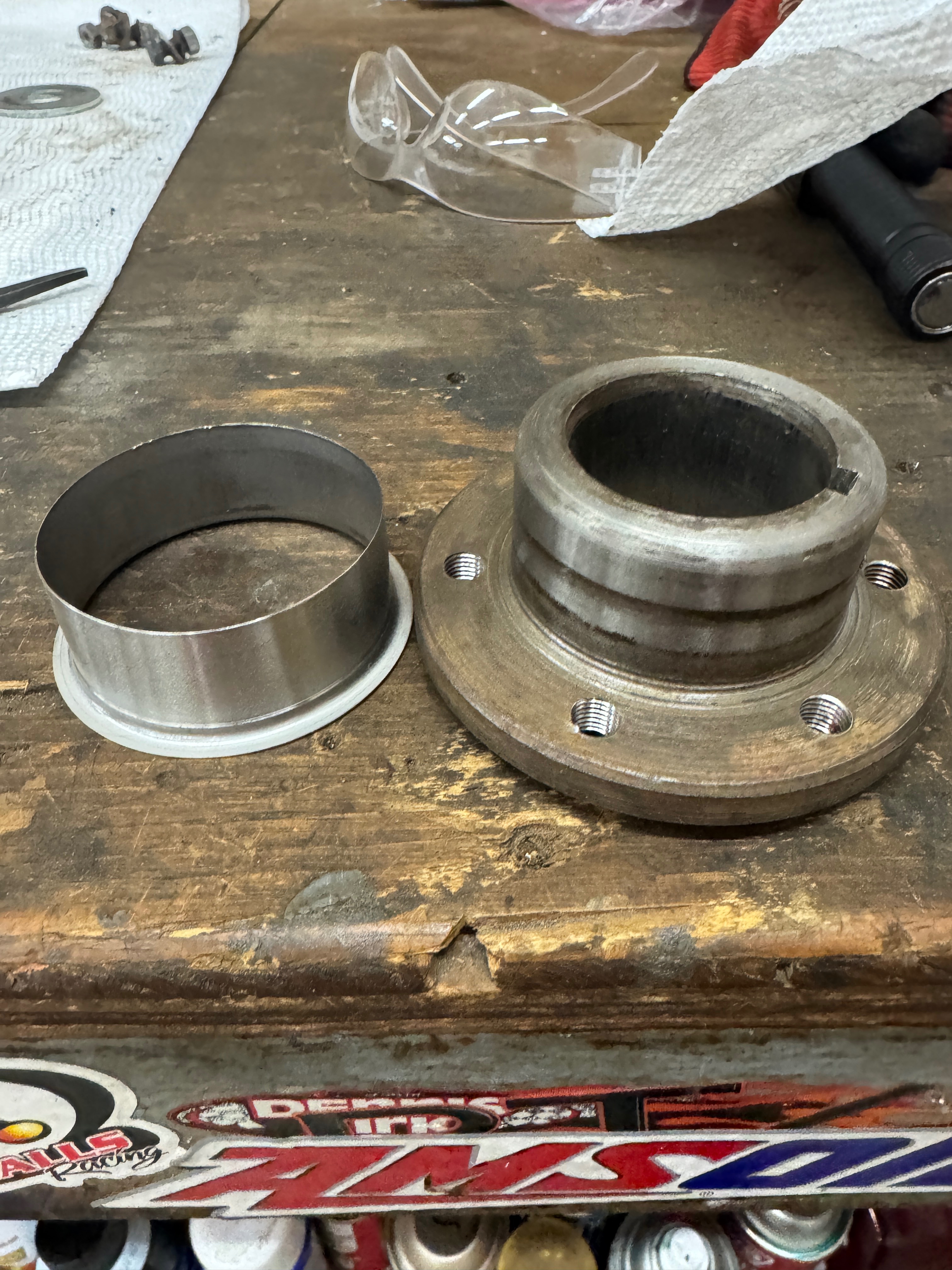

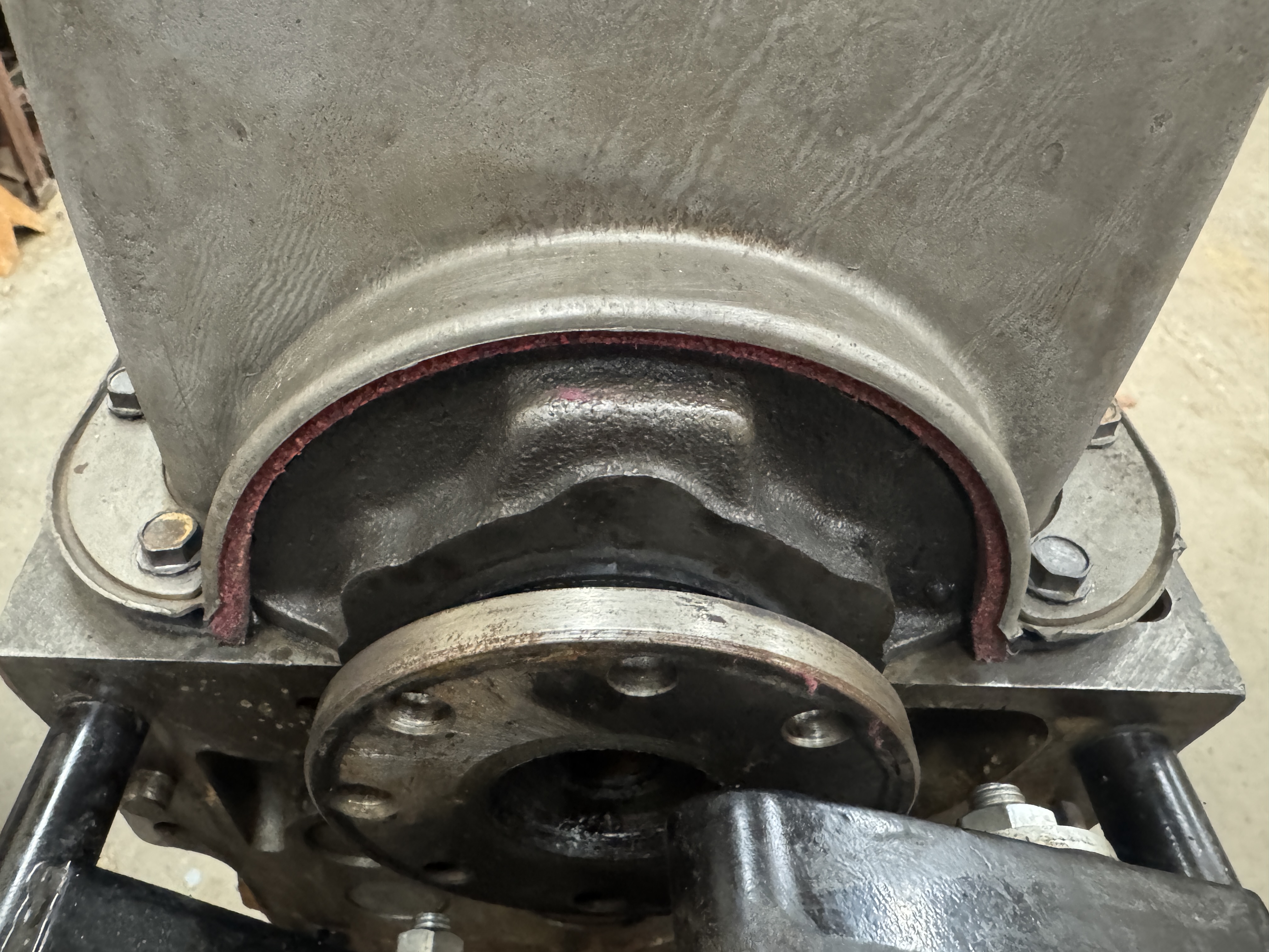

Speedy sleeve installed in the crank hub and installed on the crank. Permatex black for extra leak guard.

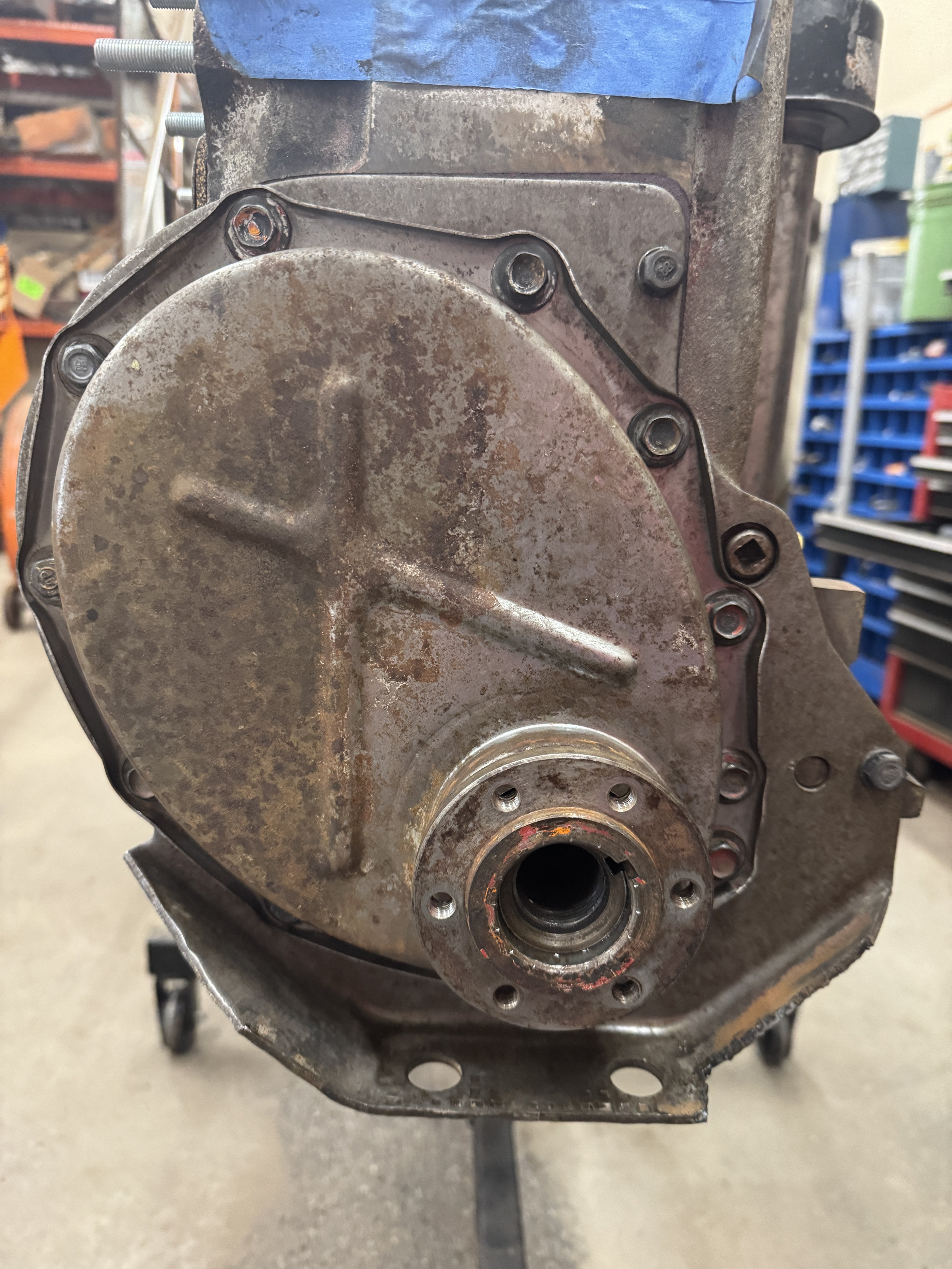

Manual refers to a seal alignment tool to tighten the timing cover on first. Here I left the timing cover loose while installing and let the hub center when I tighten the bolts.
Installation tool a must to draw on. Do not pound it on.
Timing cover torqued to 15 ft/lbs. Used thread sealant for most of these are in the water jacket.

Installed the two studs for the engine lifting bracket which need the long accessory studs for not the shorter head studs.

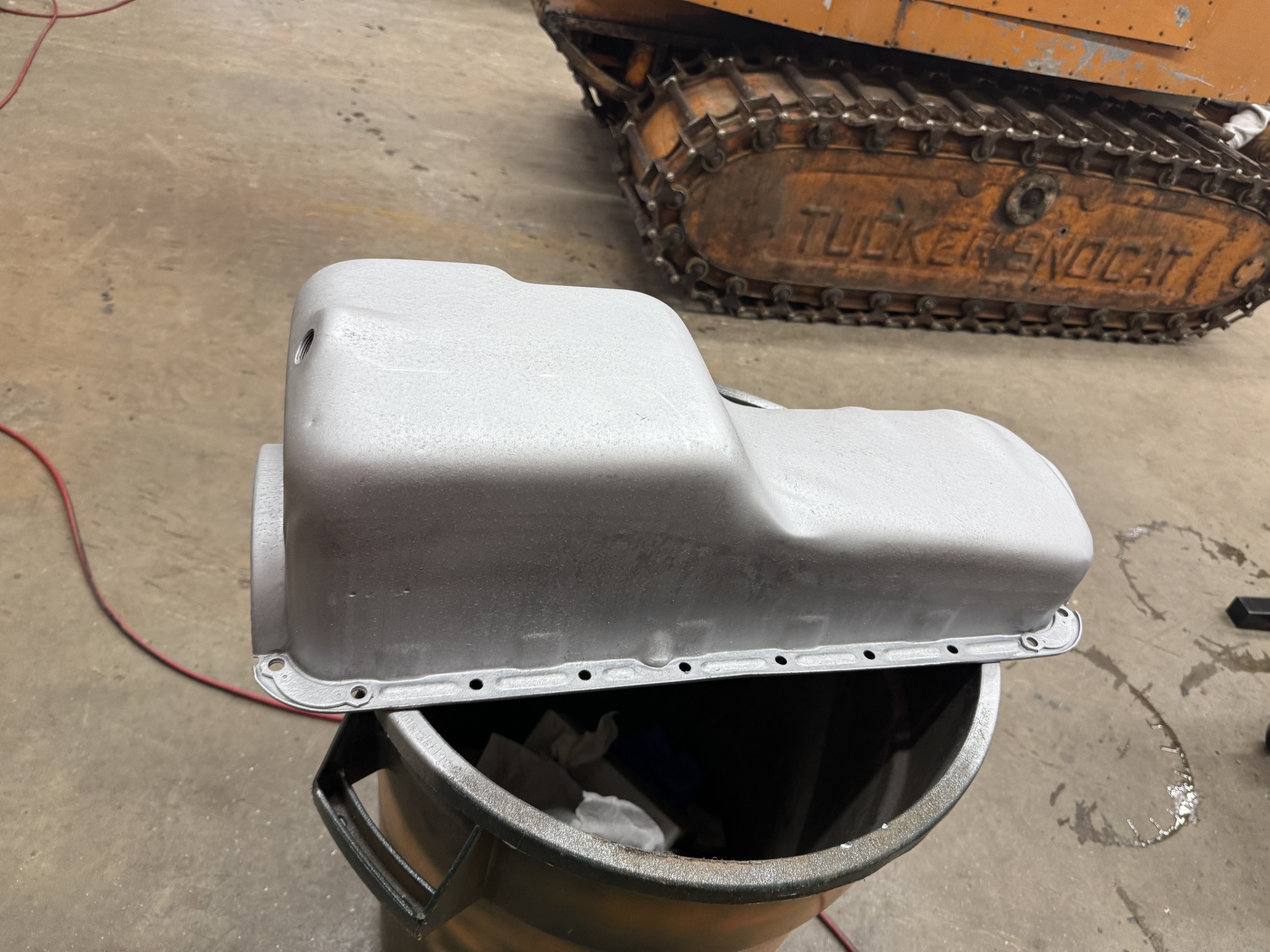

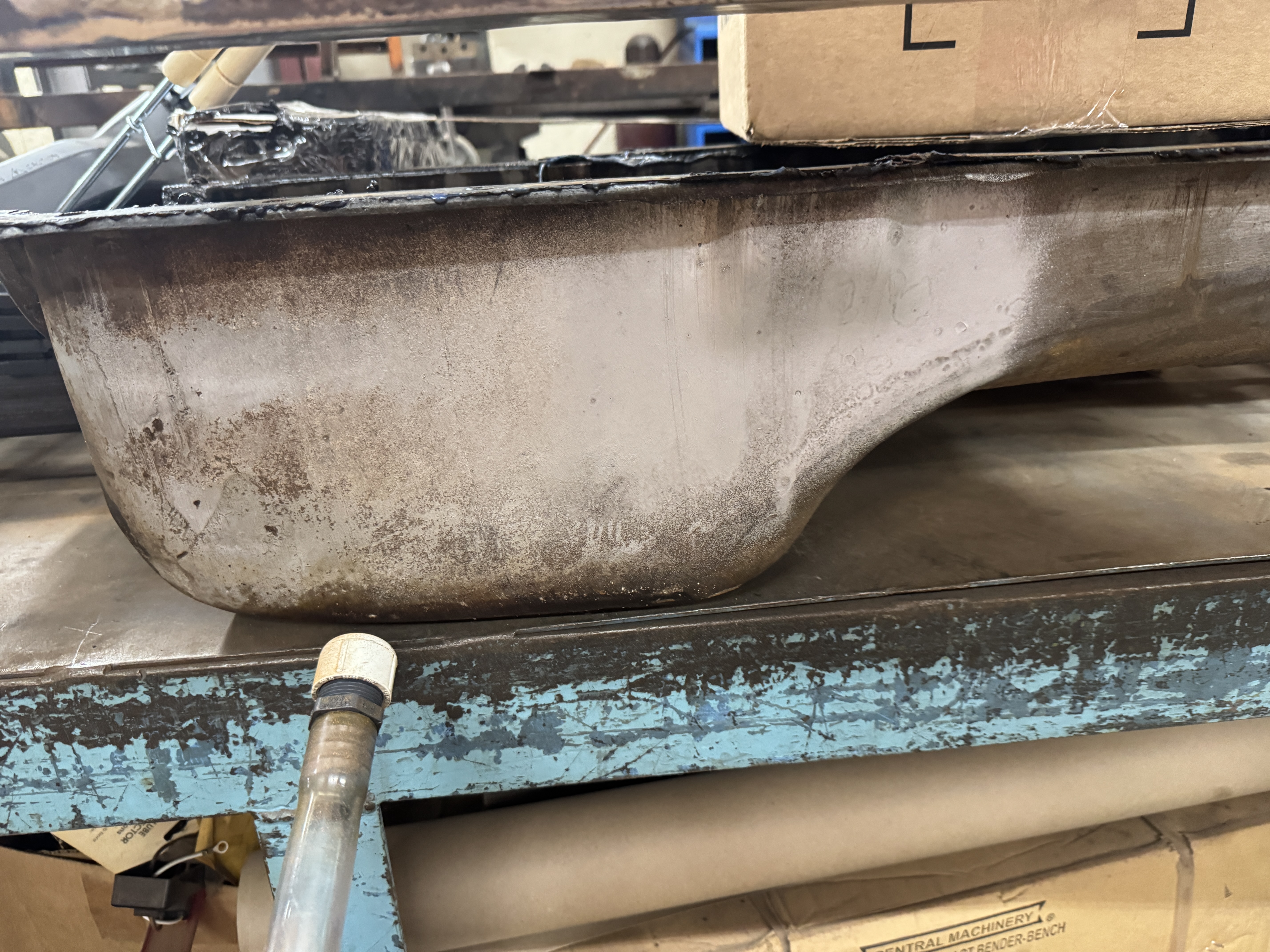

Sourced an oil pan for a 251 and found a nice Rustoleum Silver Aluminum engine paint that blends in nicely pictured here on the OE Pan.
So I painted the new one only to find many 251 variations and this one doesn’t fit.

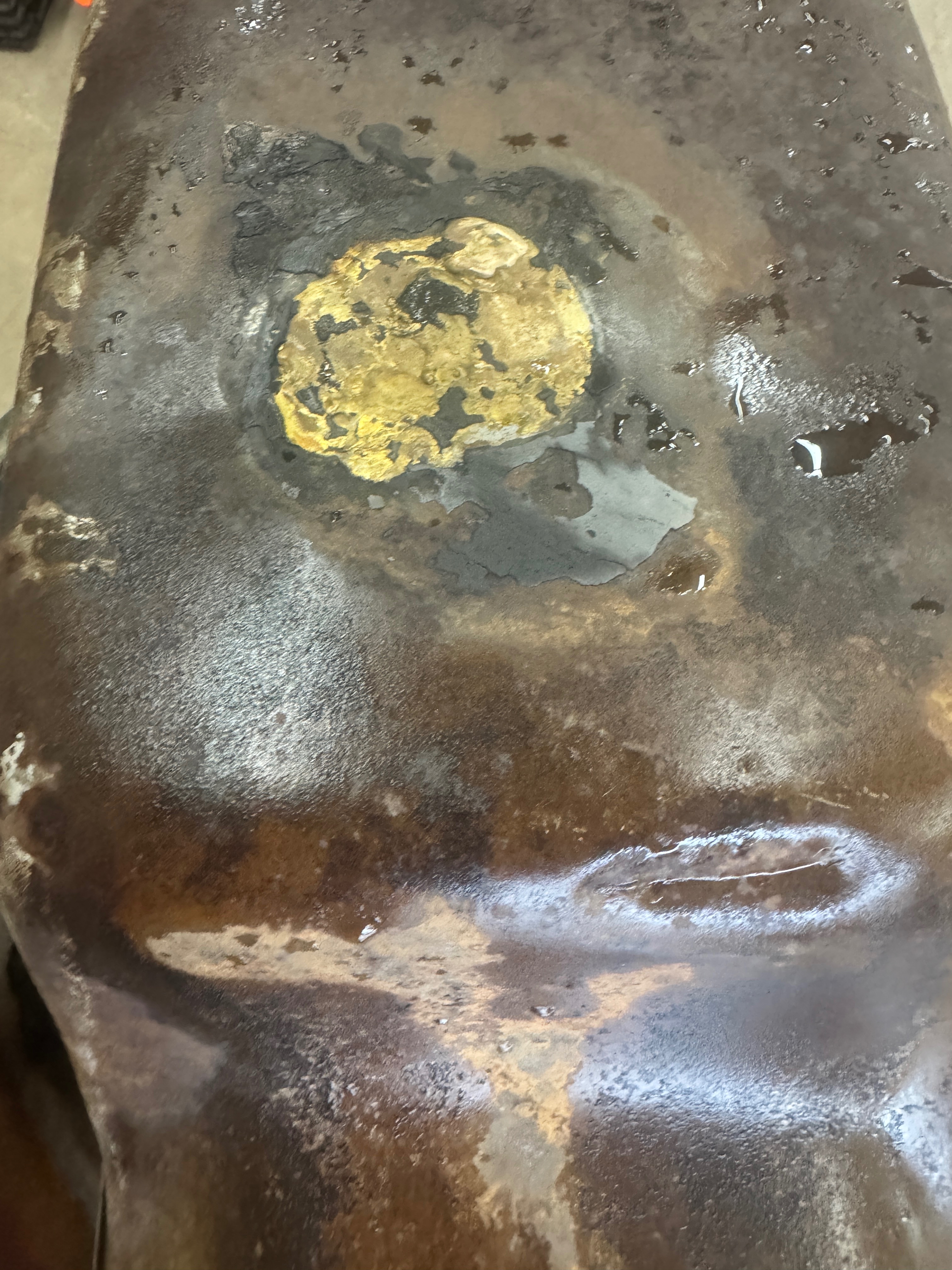

Considered repairing the OE pan for the patina but it has lots of dents and puncture damage. Copper braise and JB weld dressing. Good news is I sourced another nice pan. Marty deserves better.

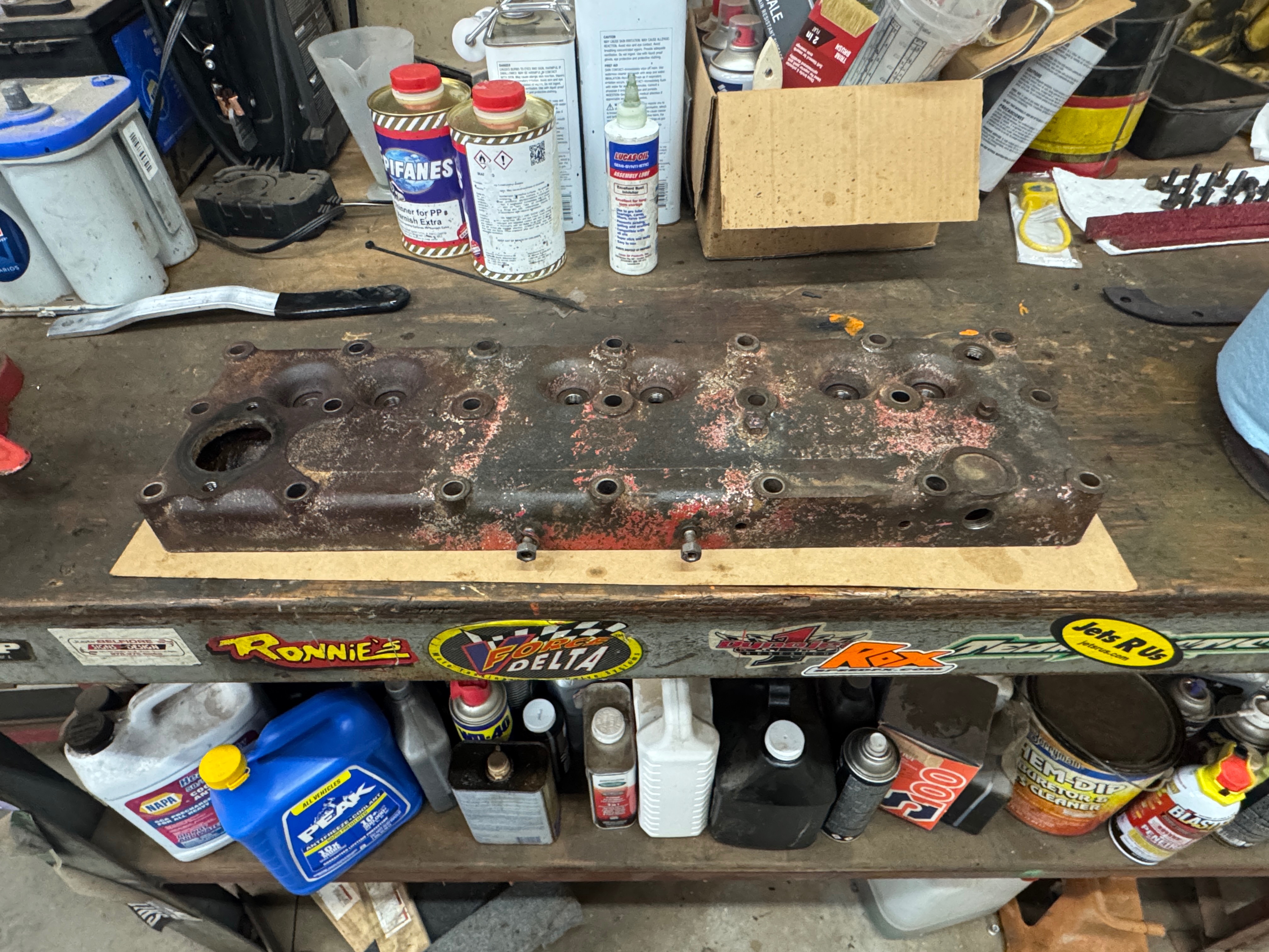

Head cleaned up and flushed the internals for final install.
New head hardware. Brake cleaner, paper towels, and a brush makes fairly quick work of the cosmoline.
Midwest Military and Vintage Power Wagons collectively had the hardware.
The Industrial motors had a buffet of mopar hardware unlike on automotive flathead variants which would usually be all studs or all bolts.
This Industrial 251 has a tapped headbolt perimeter to support mounting accessories, two accessory studs for engine lifting hook, and the rest traditional head bolts center.
Marty also features an aftermarket headbolt engine warmer stud which would have been added after production from Chrysler.
Ready for install.

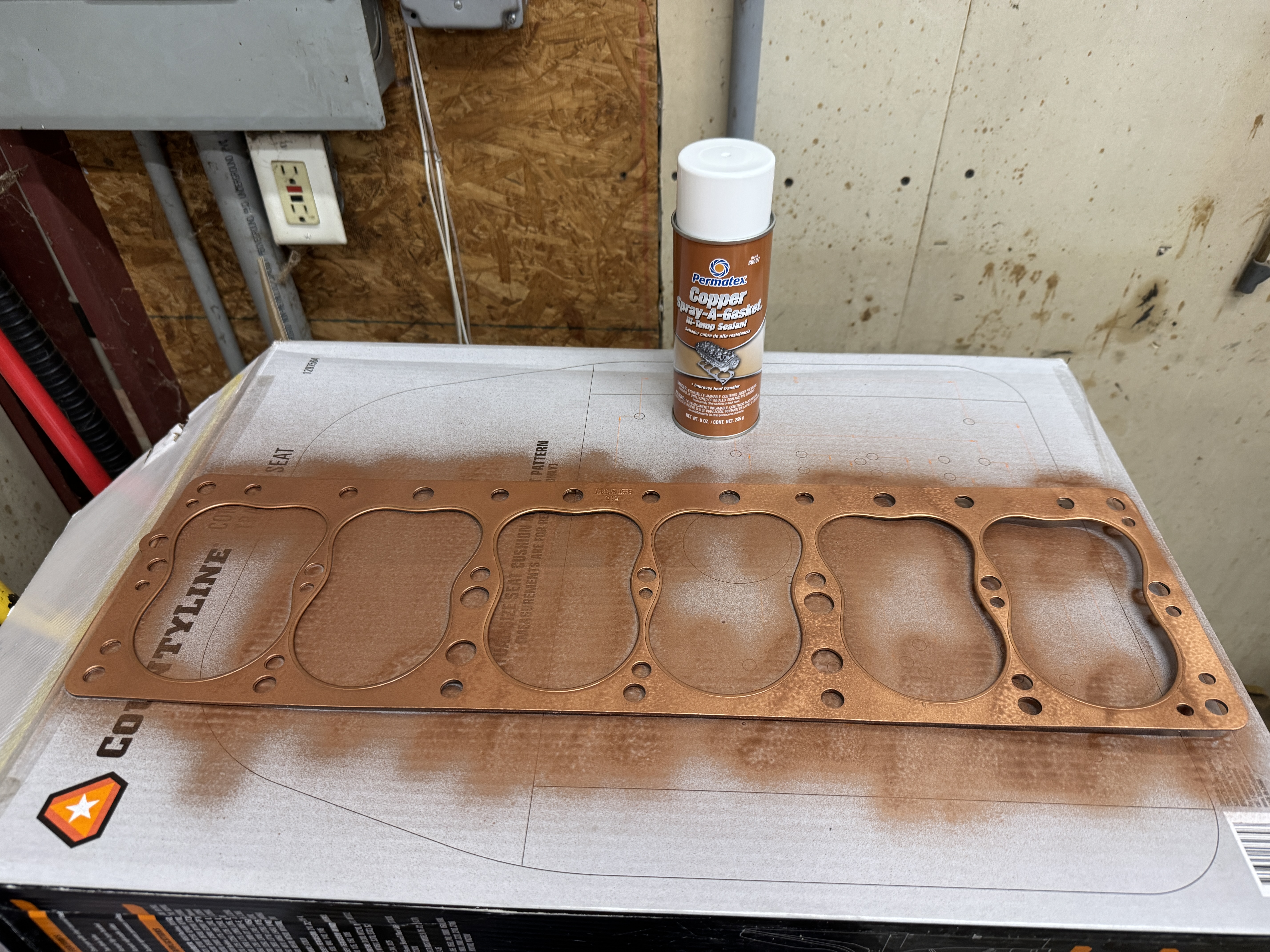

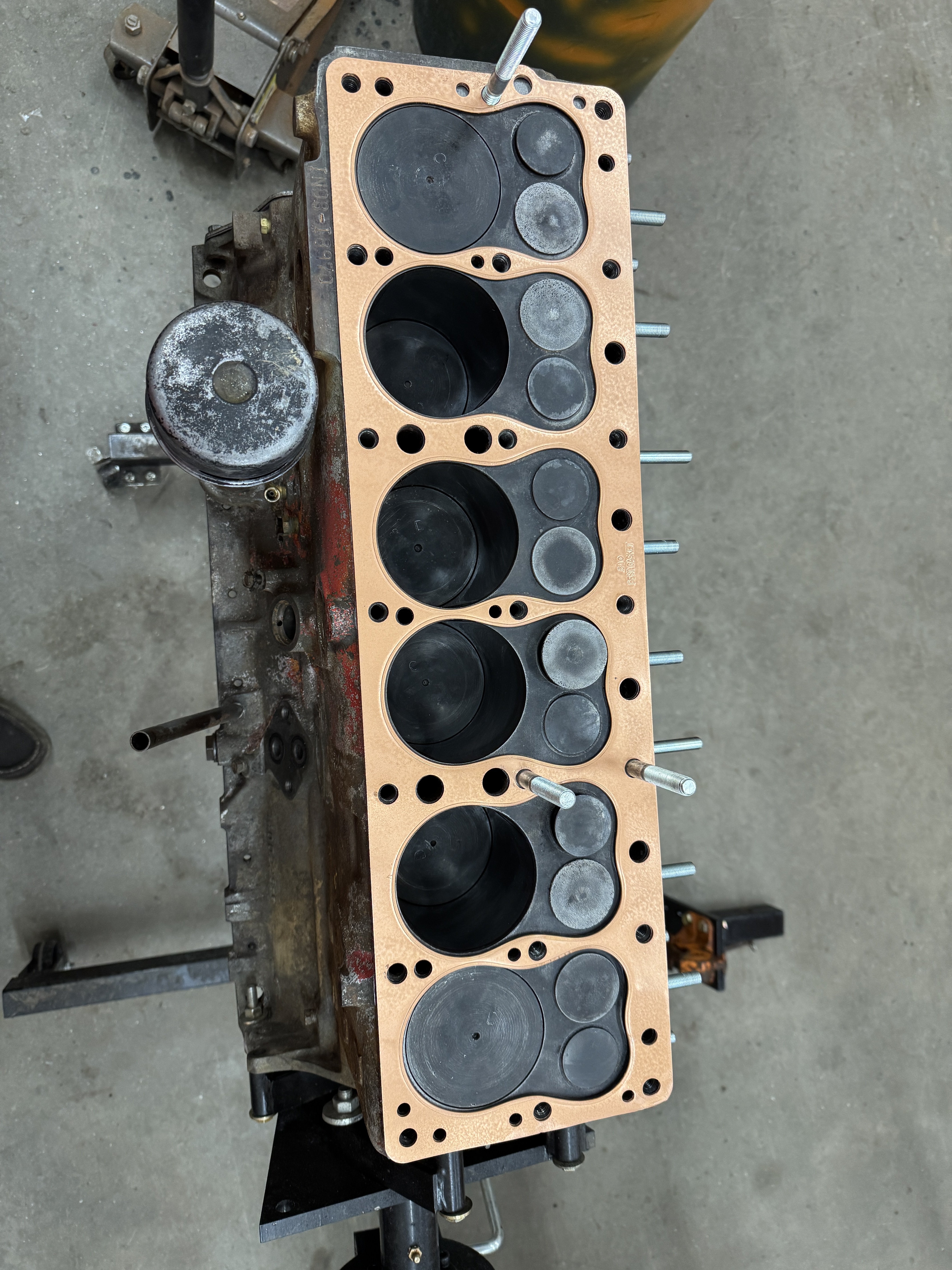

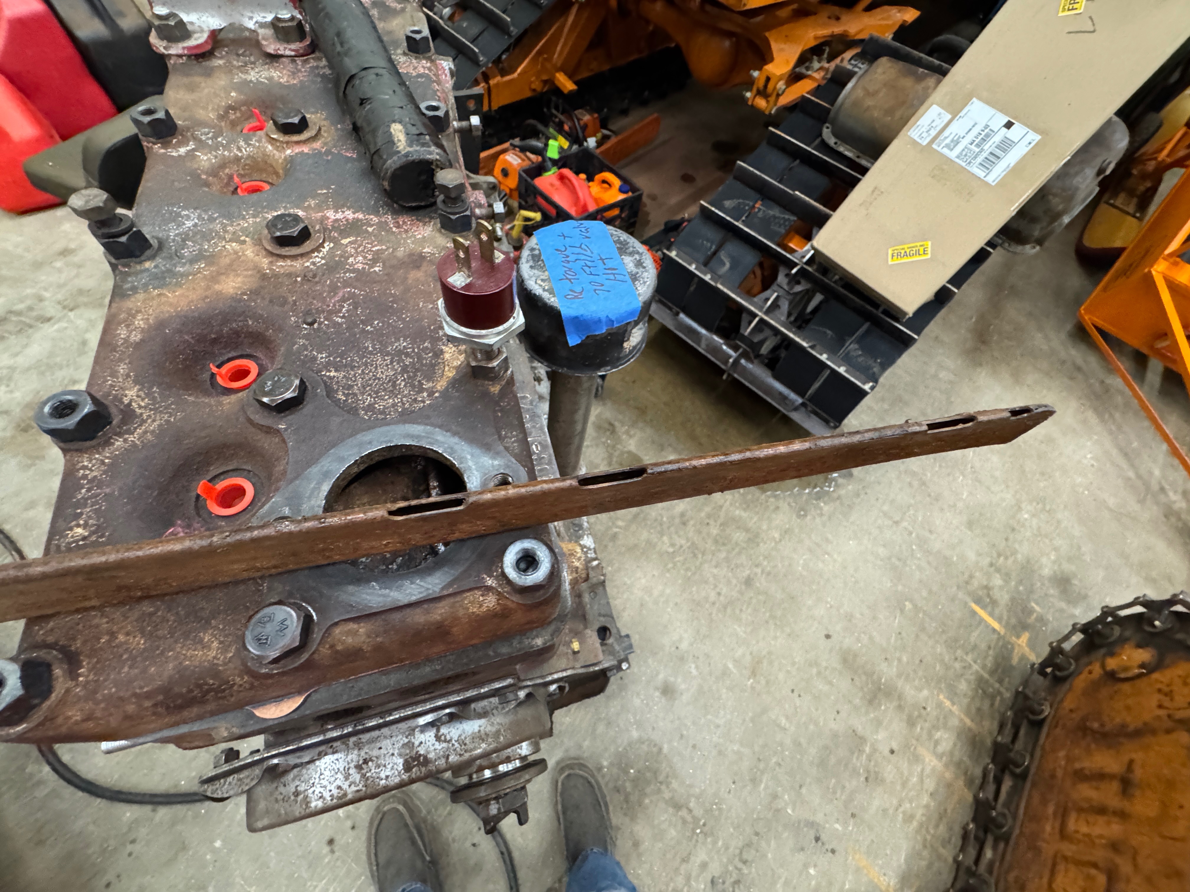

Installed the head this evening. Gasket coated in Permatex Copper Sealant which is recommended. Used a temp stud up front to get the head aligned when dropped on.
Many of the available gaskets are for a “hump head” which has an additional cooling port. This engine does not but the gasket works fine on the non hump heads.
Torqued in 4 steps following the pattern to 70 ft/lb then confirmed the final torque. Manual calls for a final torque when hot so added a reminder.

Oil pan I sourced is in excellent shape with a nice finish as is. While not OE to the machine paint is correct for Mopar flathead period prior to the Tucker tolerance overspray finish.
Compliments Marty’s storyline as a talking point as to the finish variations.
Material arrived to fab up the missing door #3 enhancement….

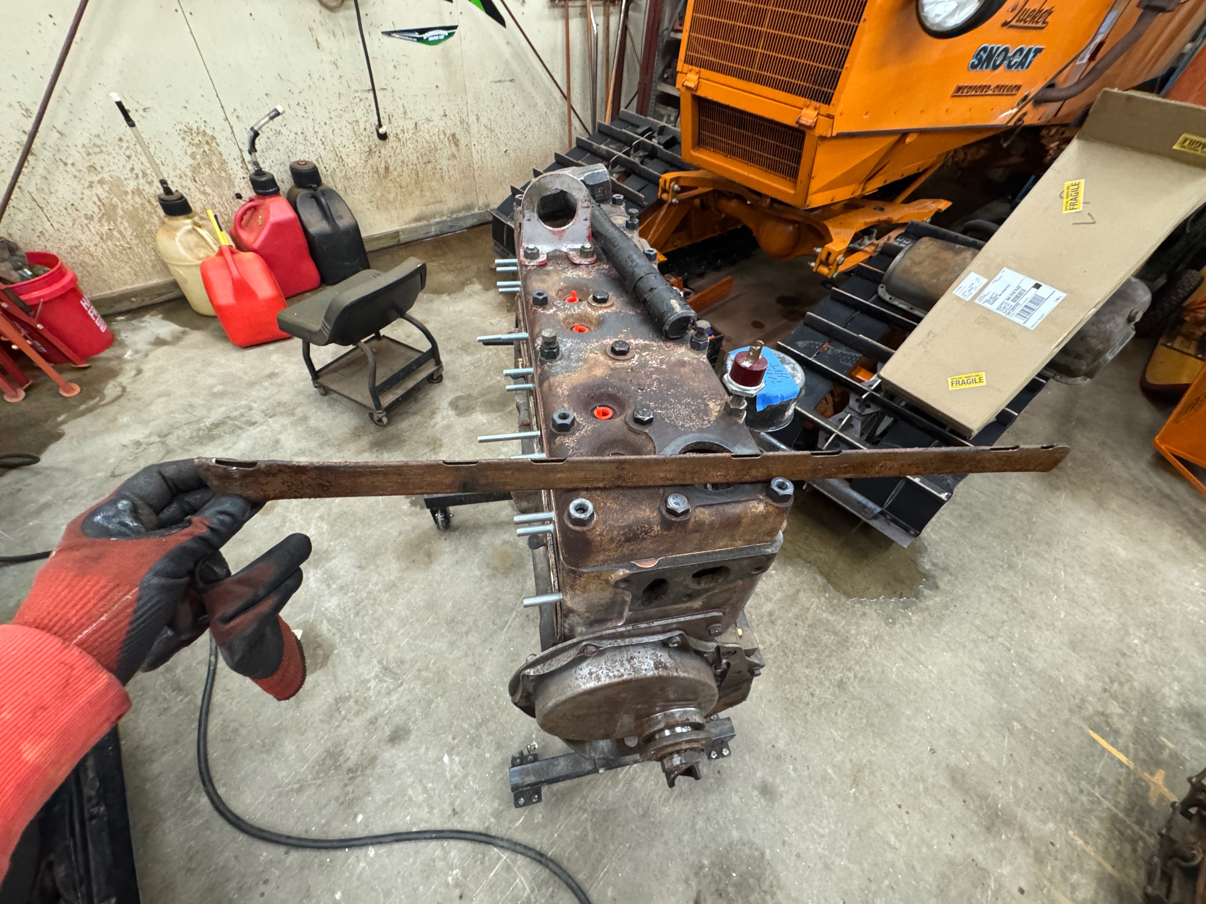

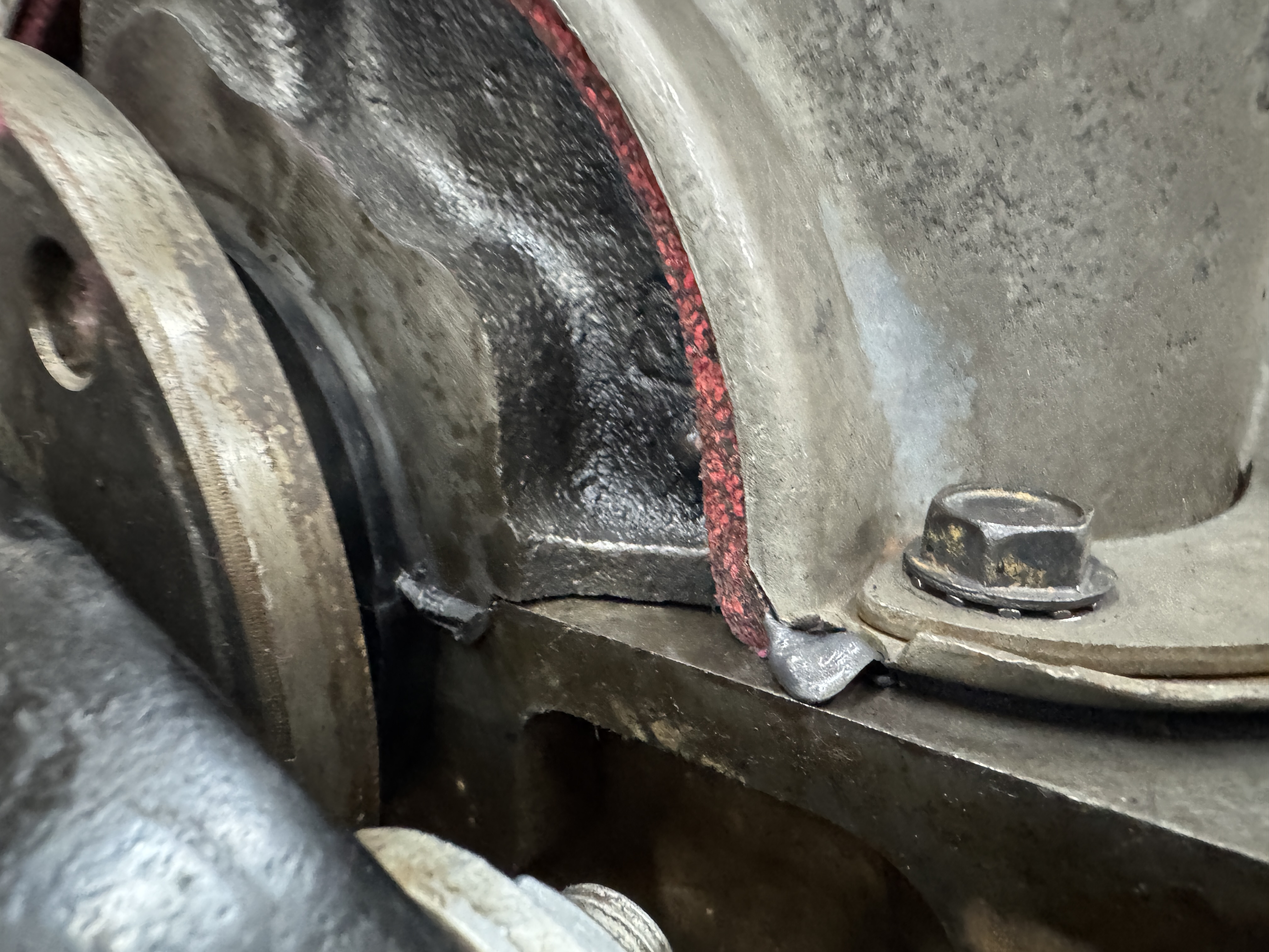

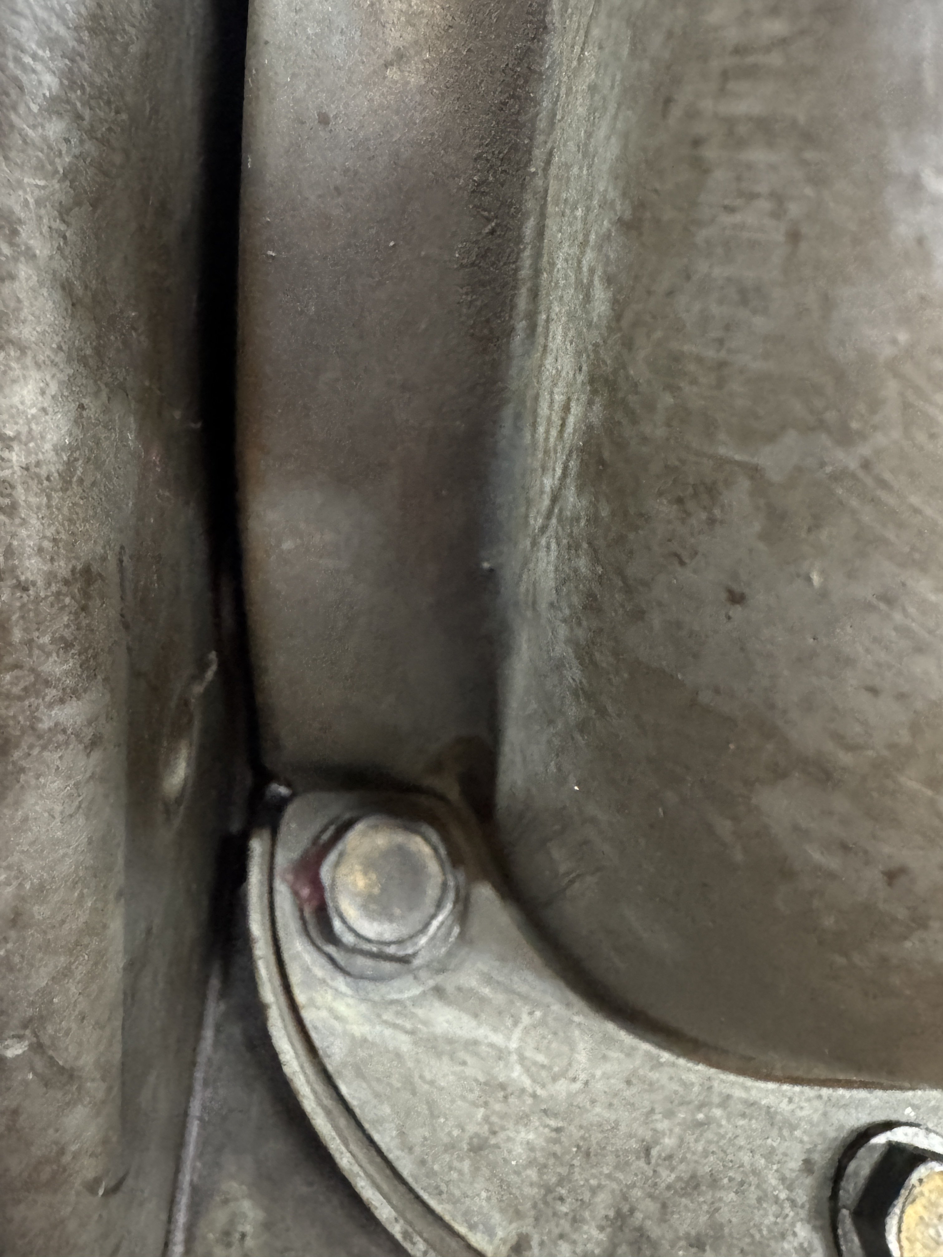

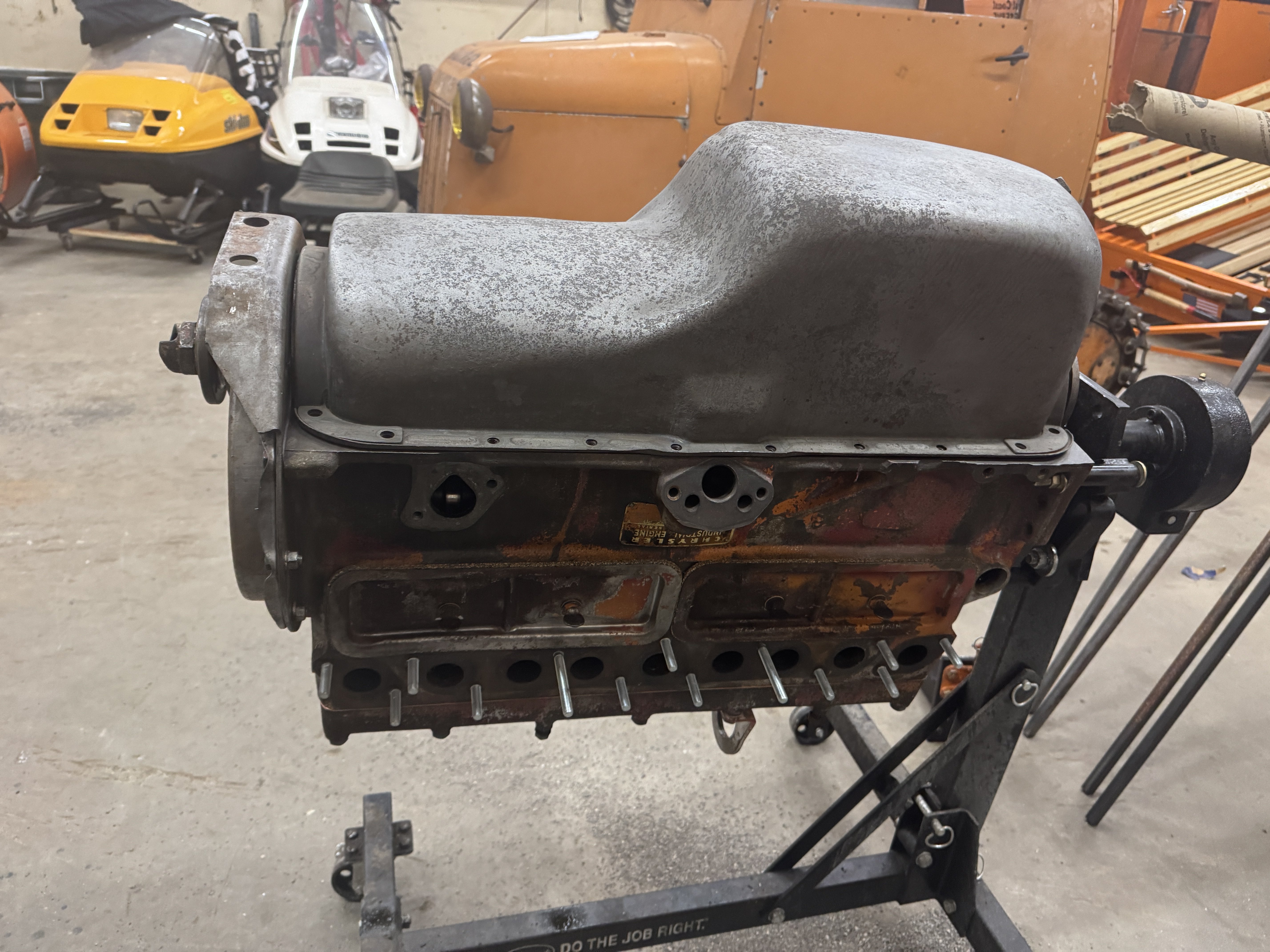

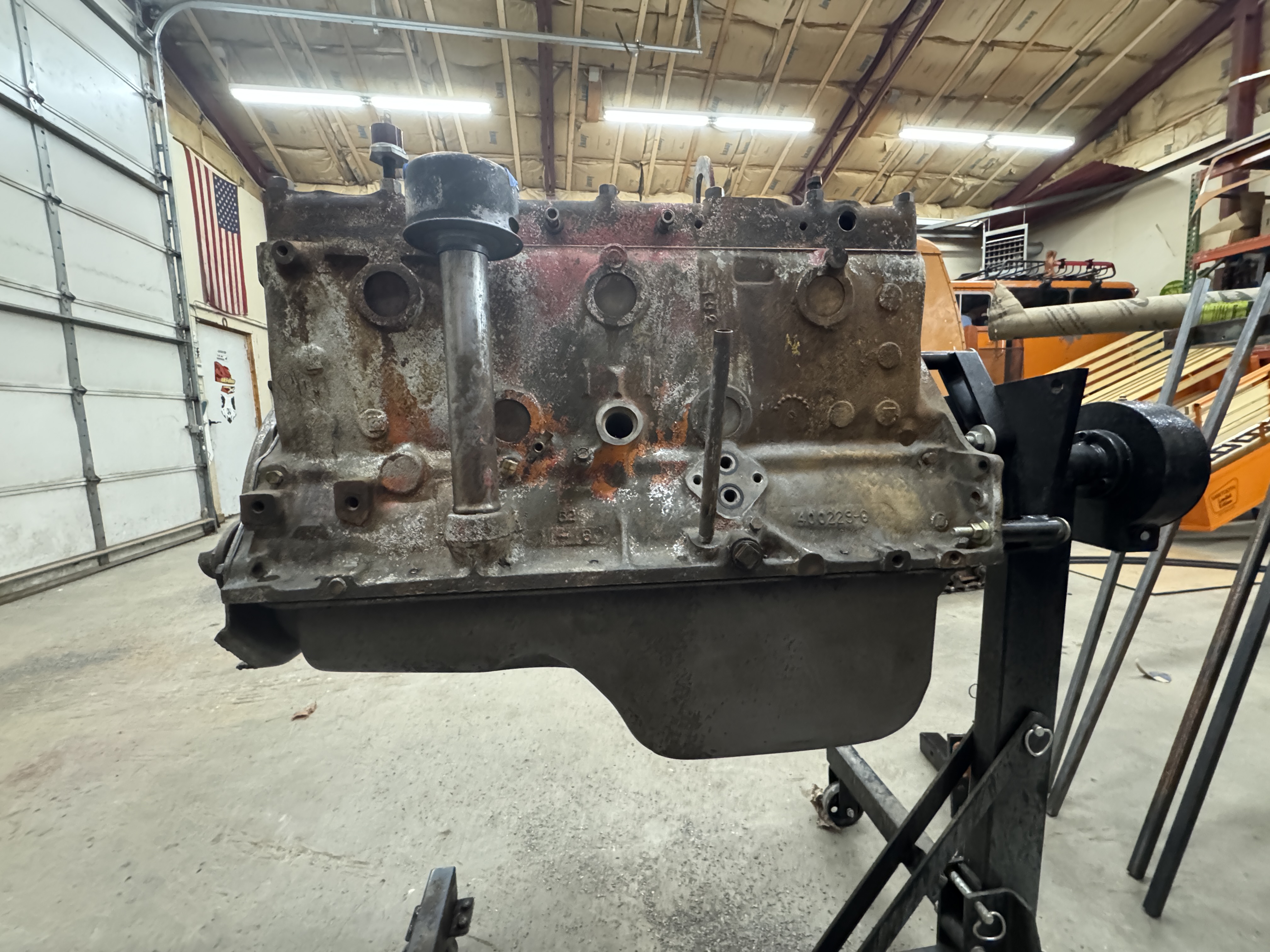

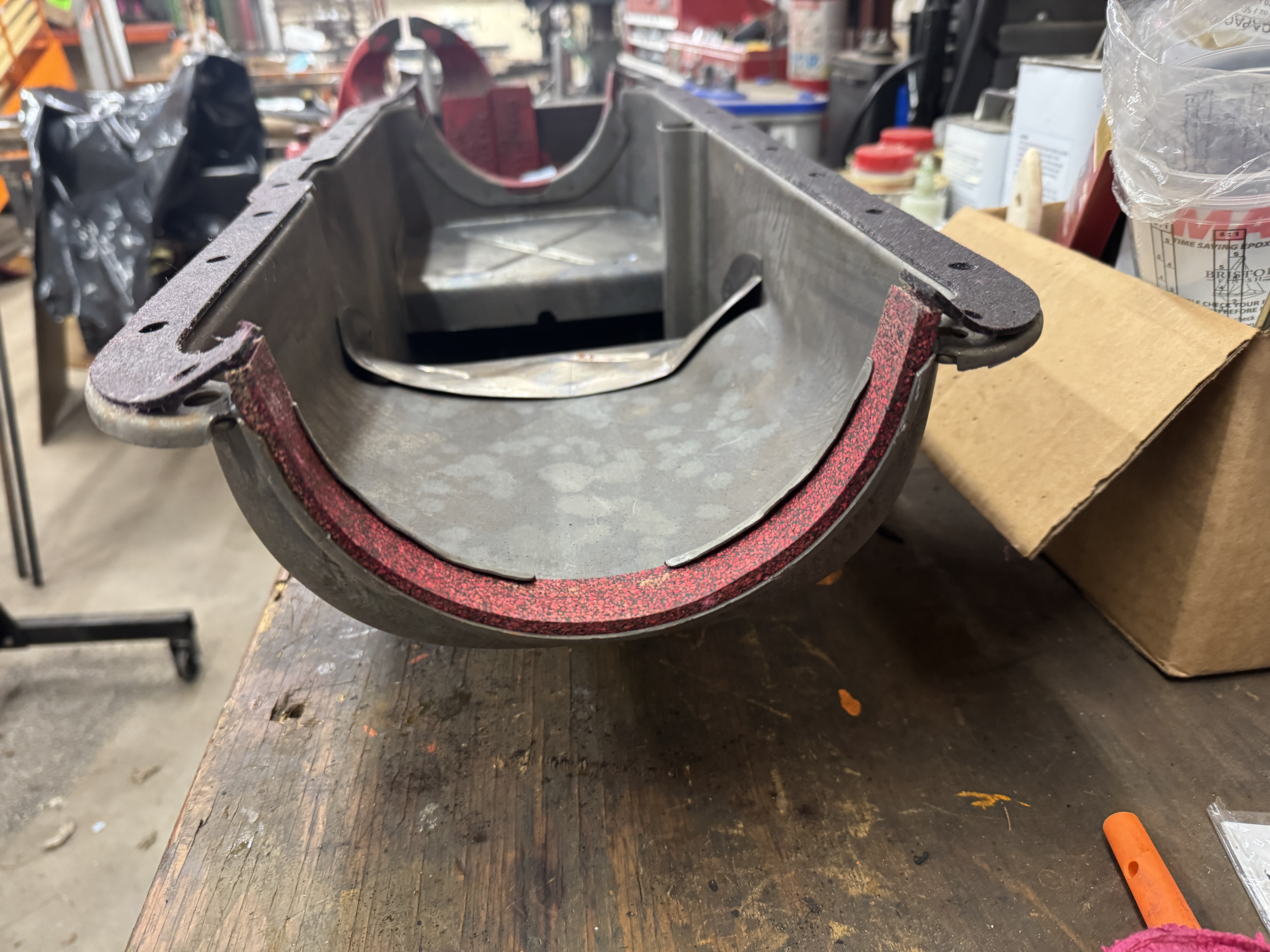

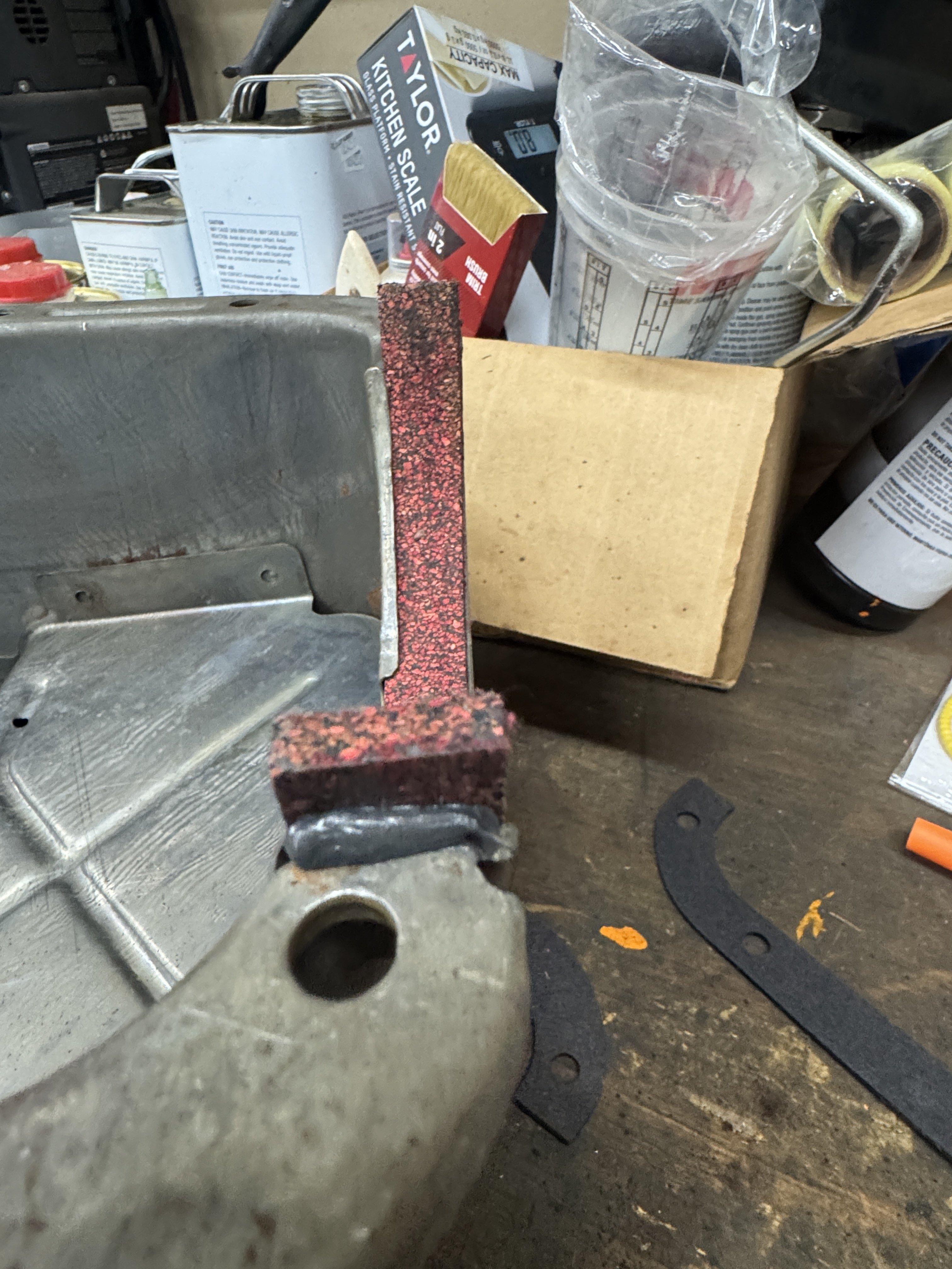

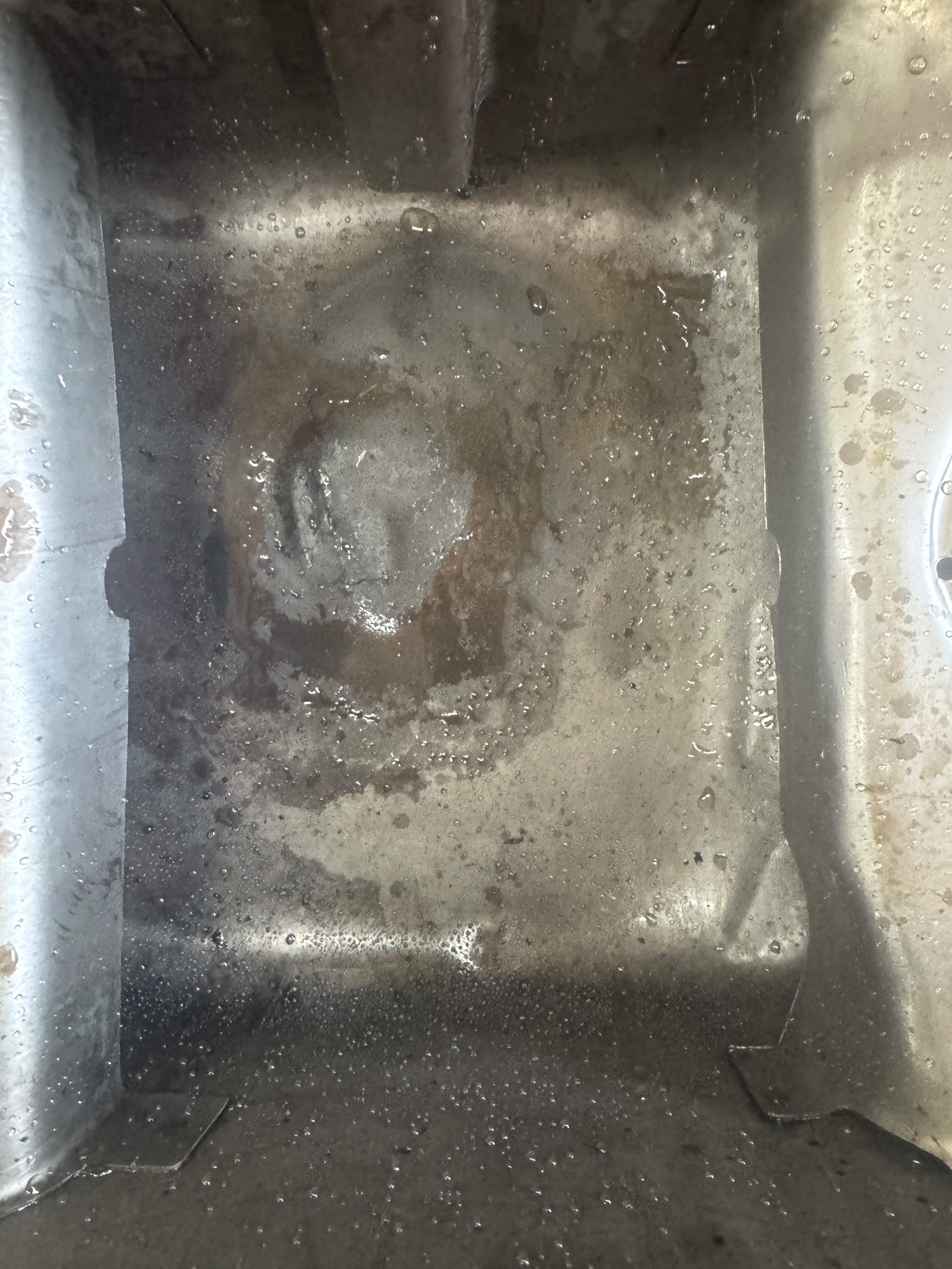

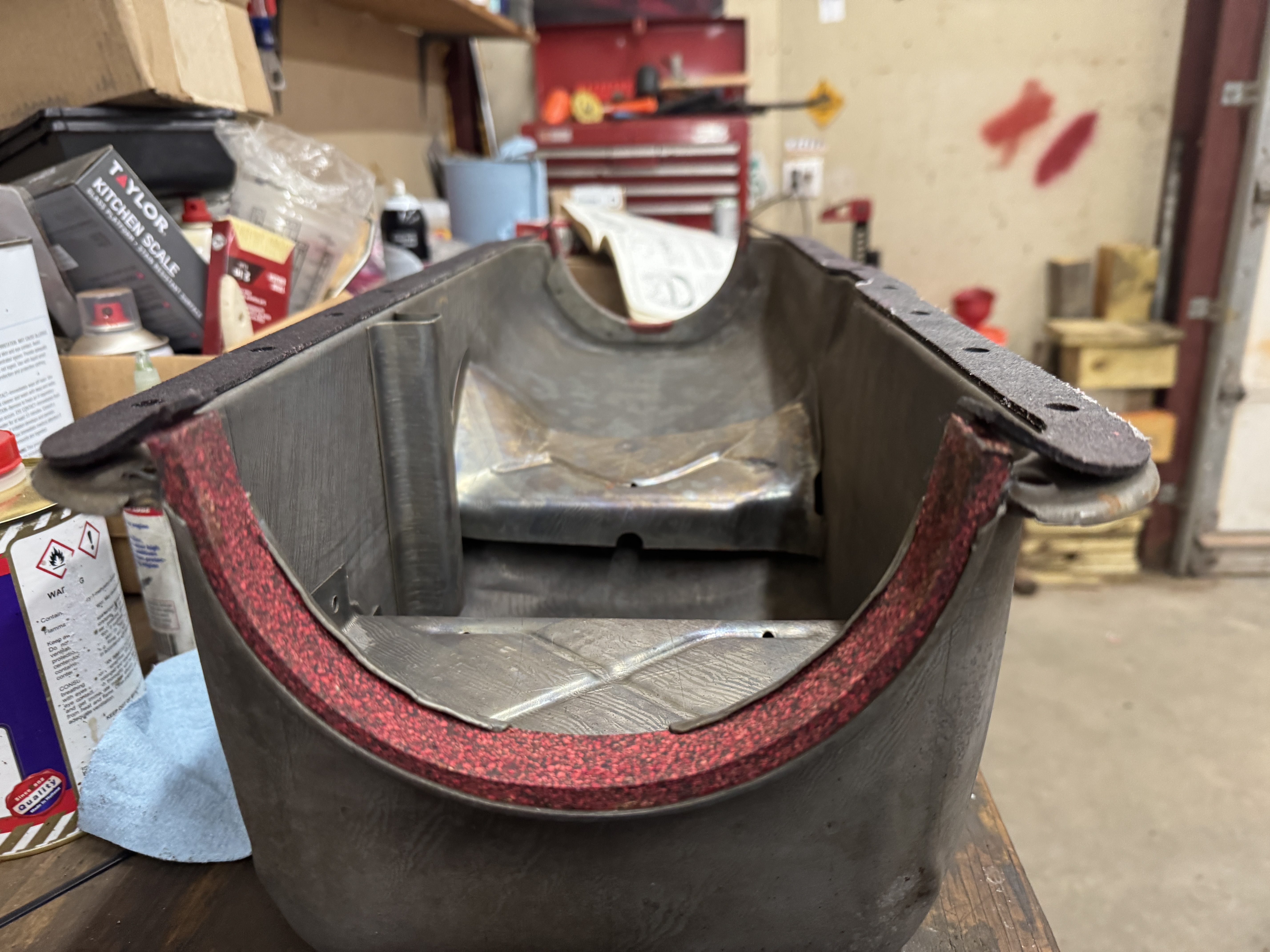

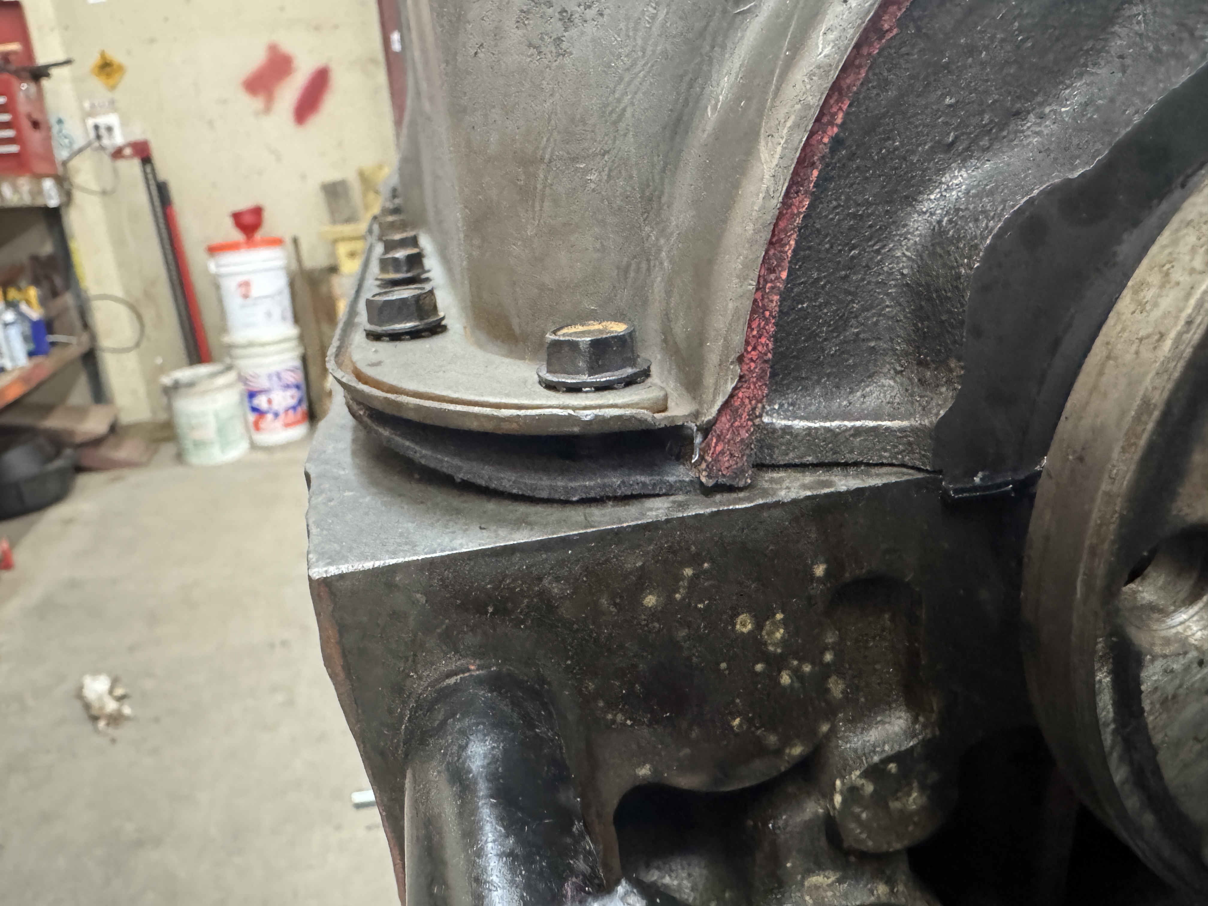

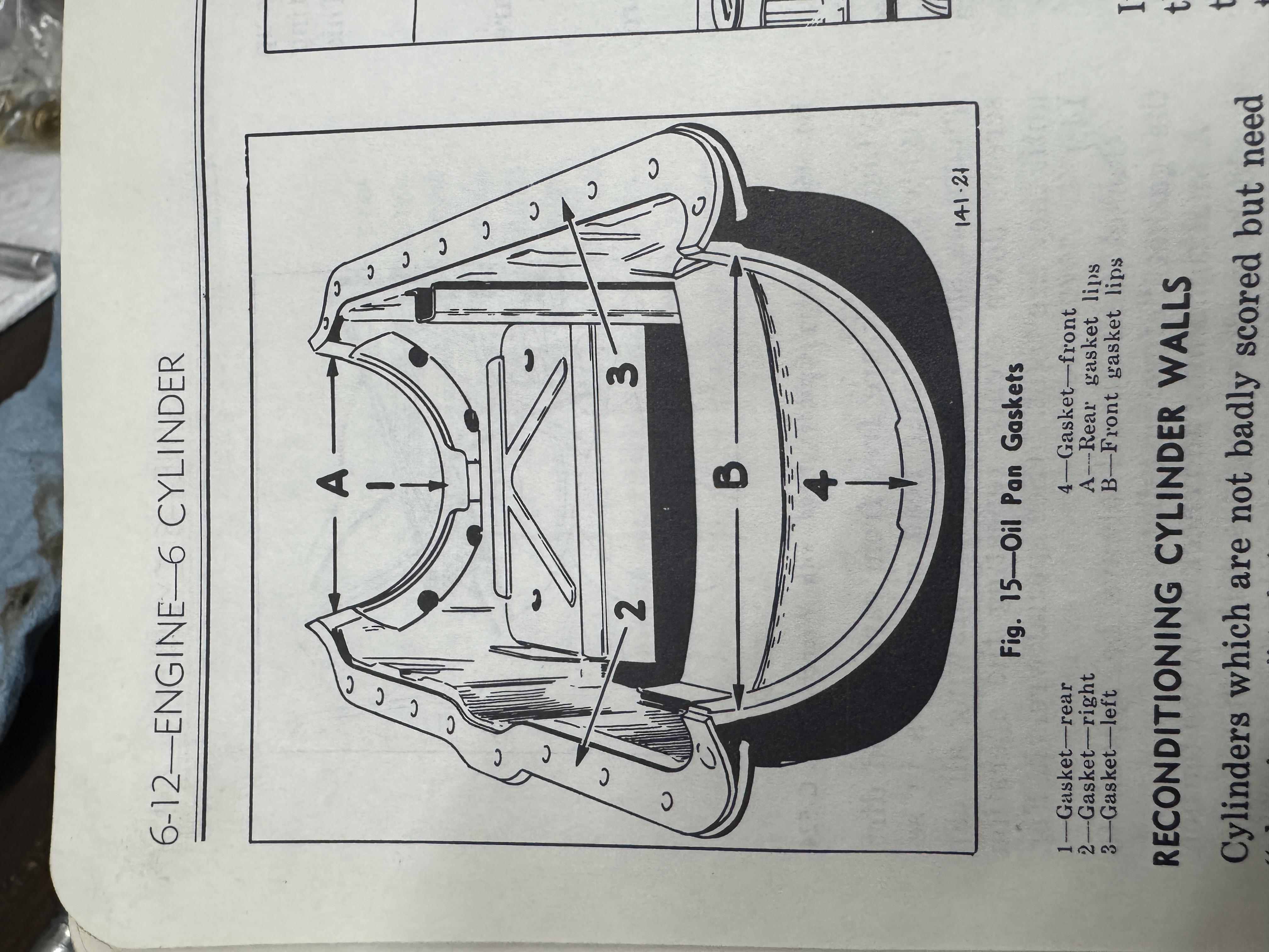

Oil pan install went smooth. The way the gaskets lay on seems odd but that is the way with the sides proud and the sides on top. Doesn’t seem right but once the pan is layed on it all makes sense.
I little 3M 77 spray on just the pan side to hold the sides in place and Black RTV in the known leak areas at gasket mating locations before install. The end bolts on both sides need a little finesse when installing but went smooth.
Manual doesn’t spec a torque pattern so slow and even working around inside out by hand then 15 ft/lbs torque.
OE drain plug swapped out to upgraded magnetic and oring plug torqued 35 ft/lbs.
Panned out real nice on the patina finish!

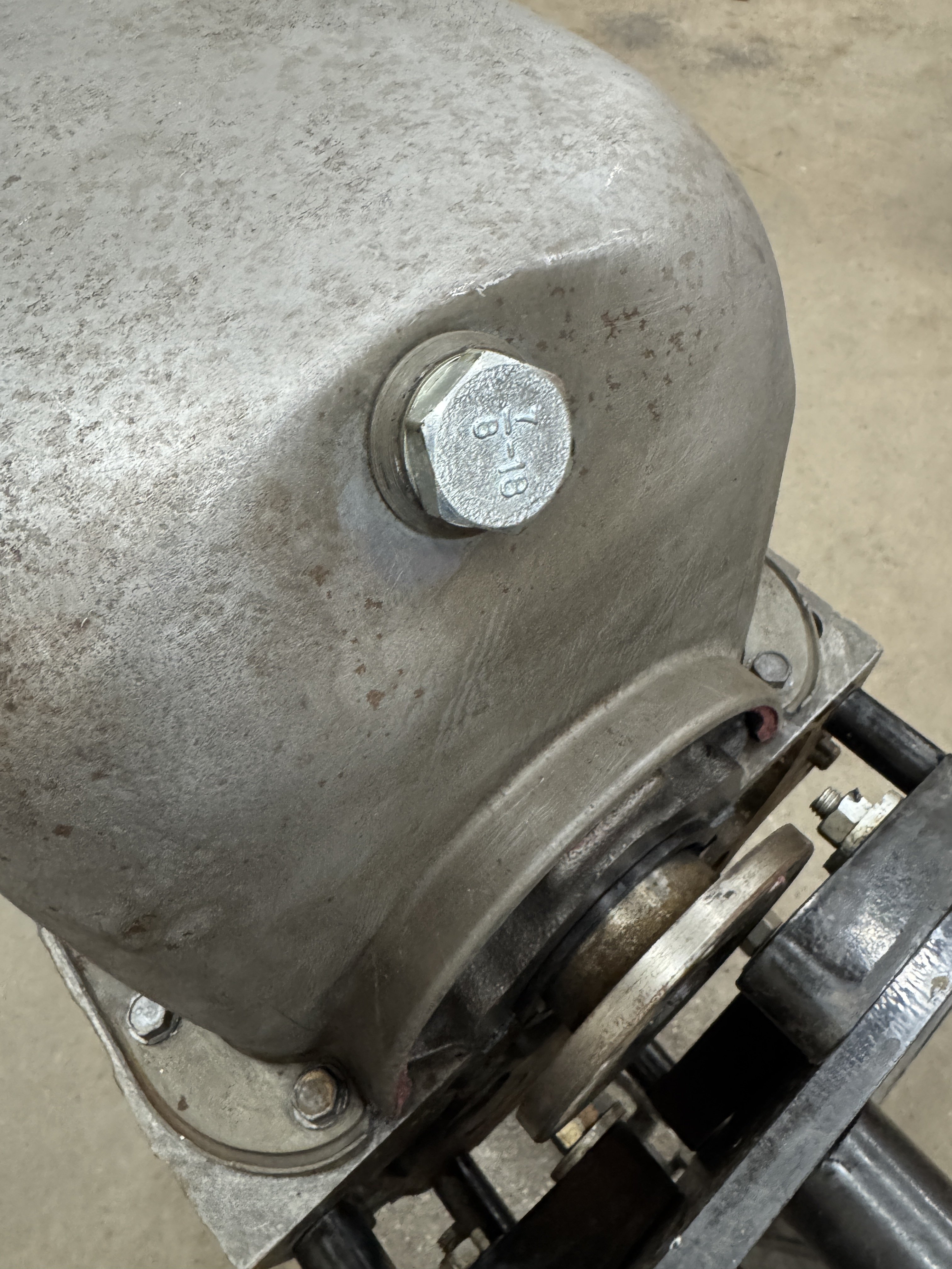

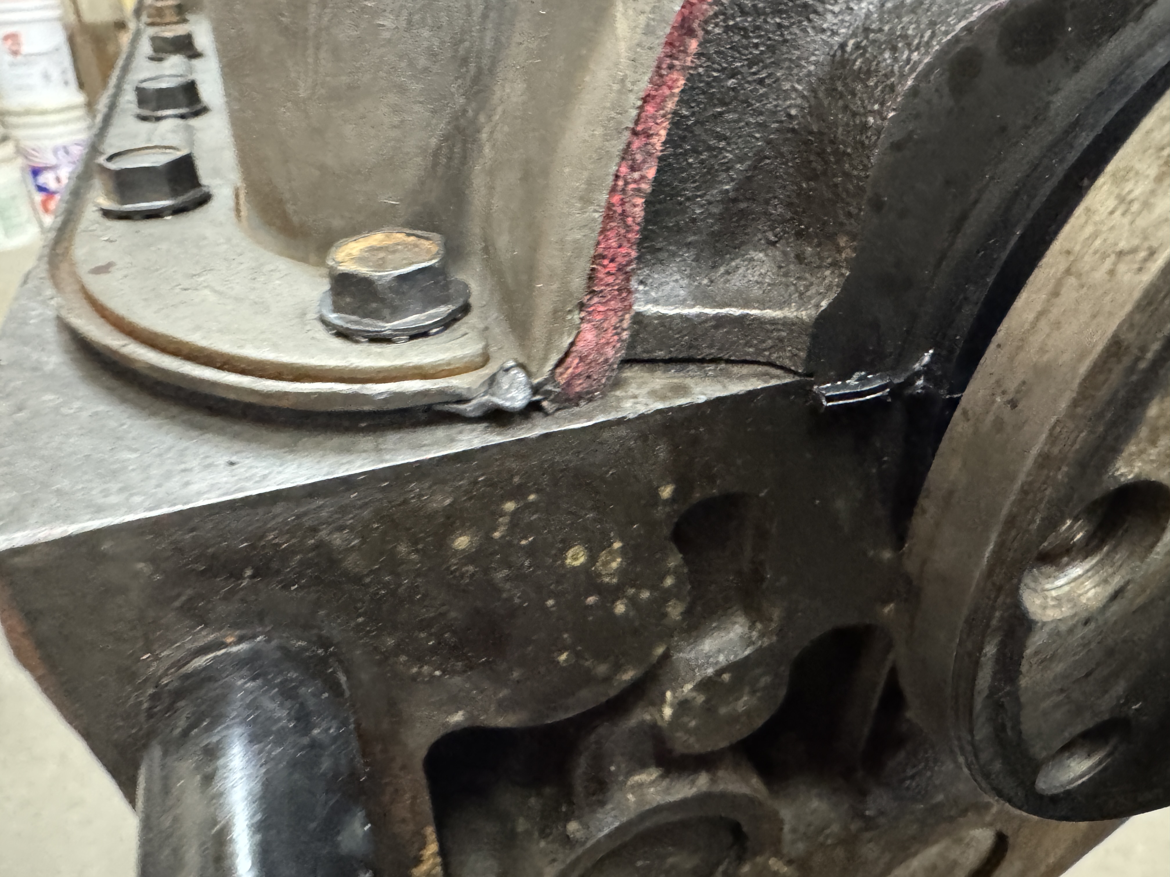

Thought the same thing when resealing my oil pan. Thought I had the wrong gasket set for a bit, but after some research and install no issues. The previous person doing the install must have thought the same, and then trimmed it. After it started leaking, the solution was a tube of silicone.

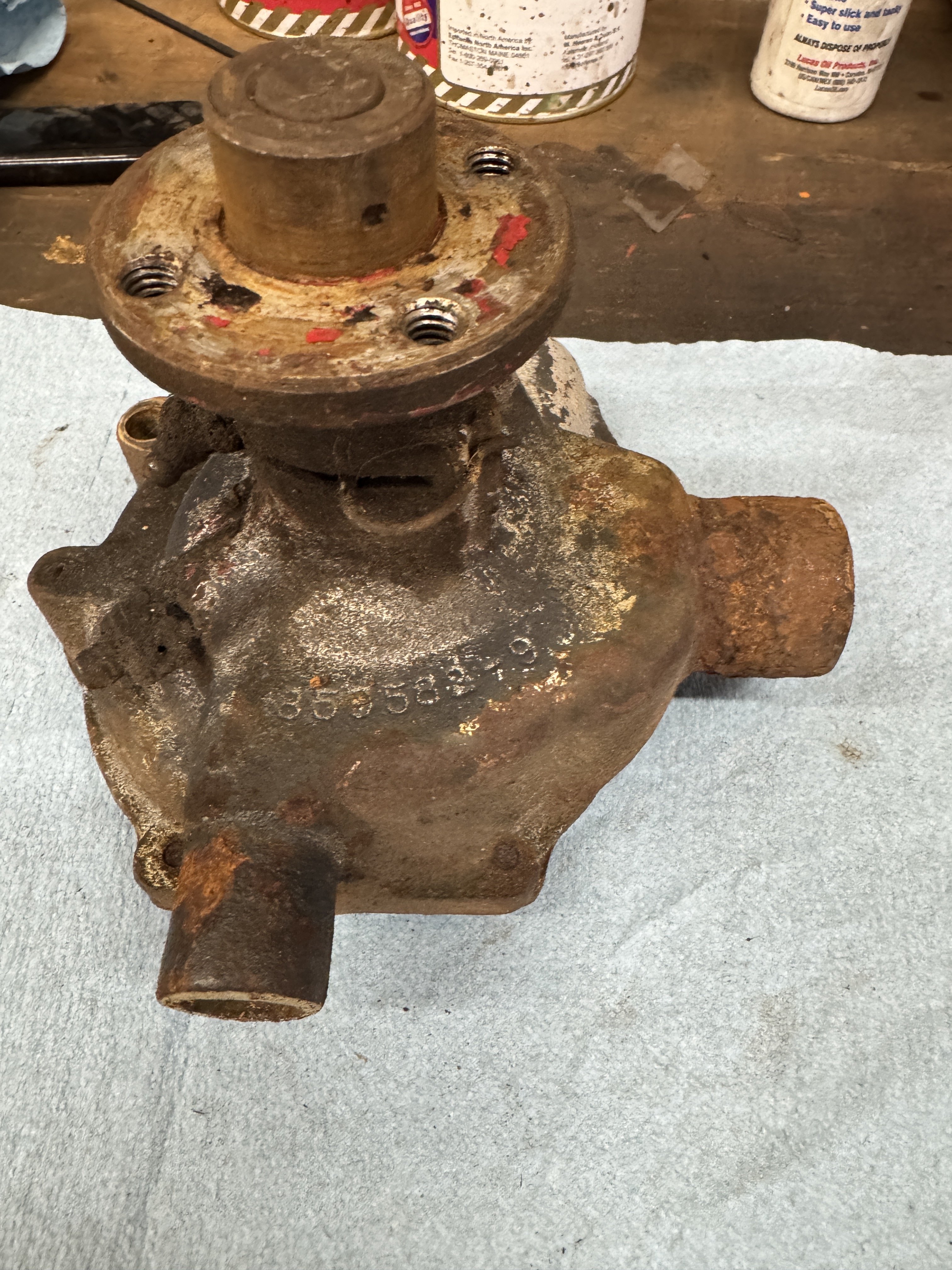

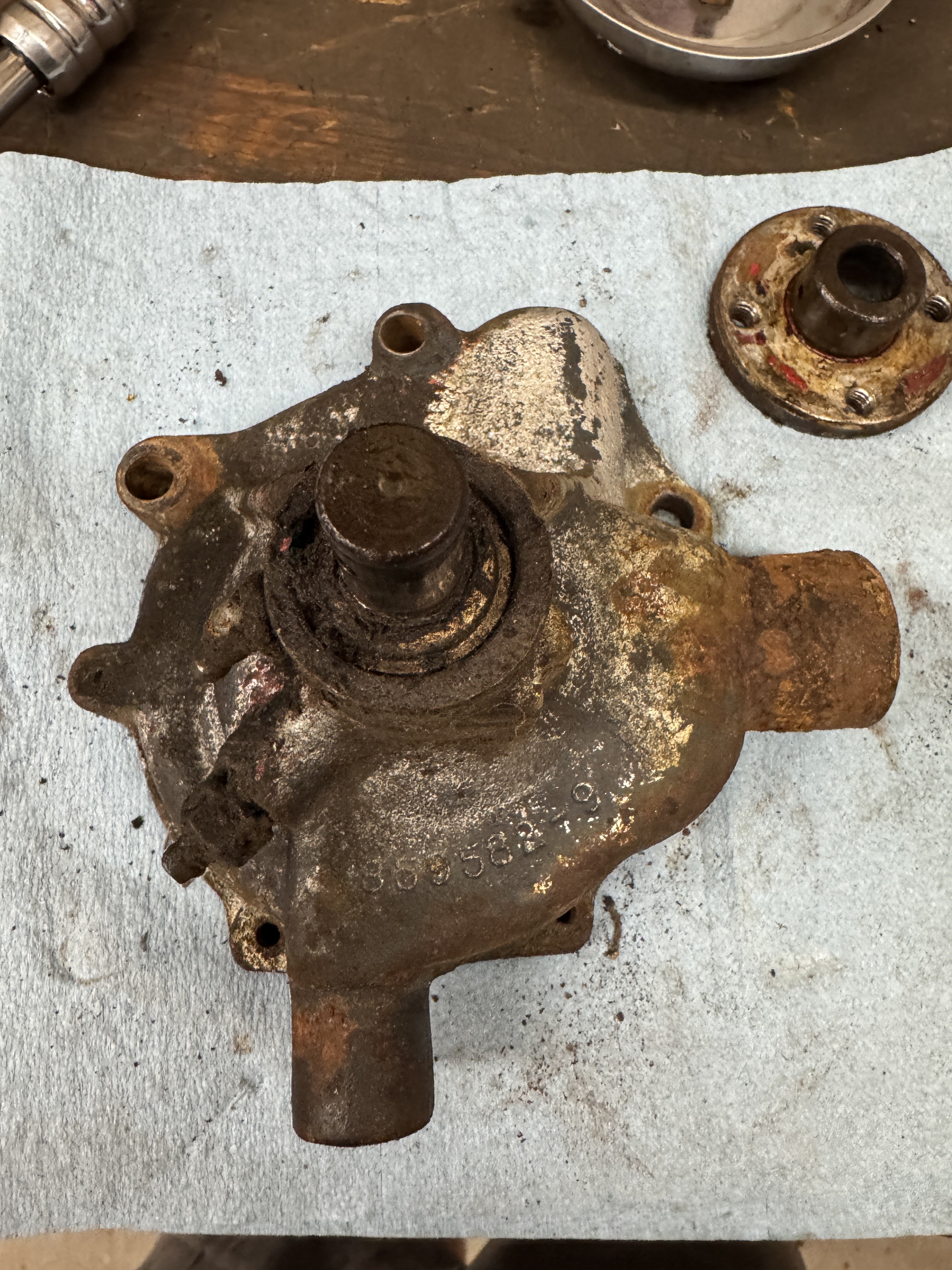

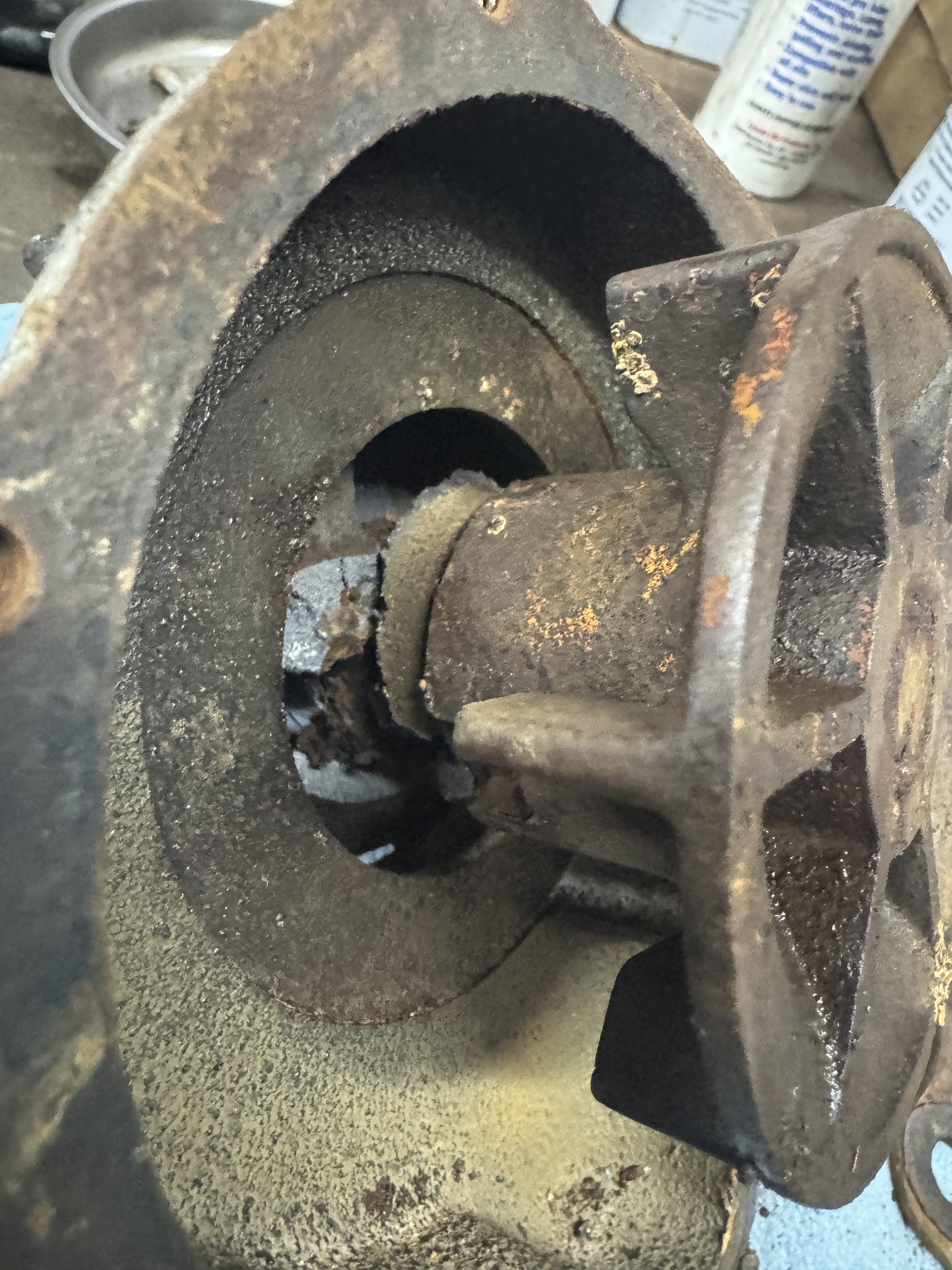

Attempted a water pump rebuild which was pretty crusty and expected the outcome to be sourcing a new pump which proved true.

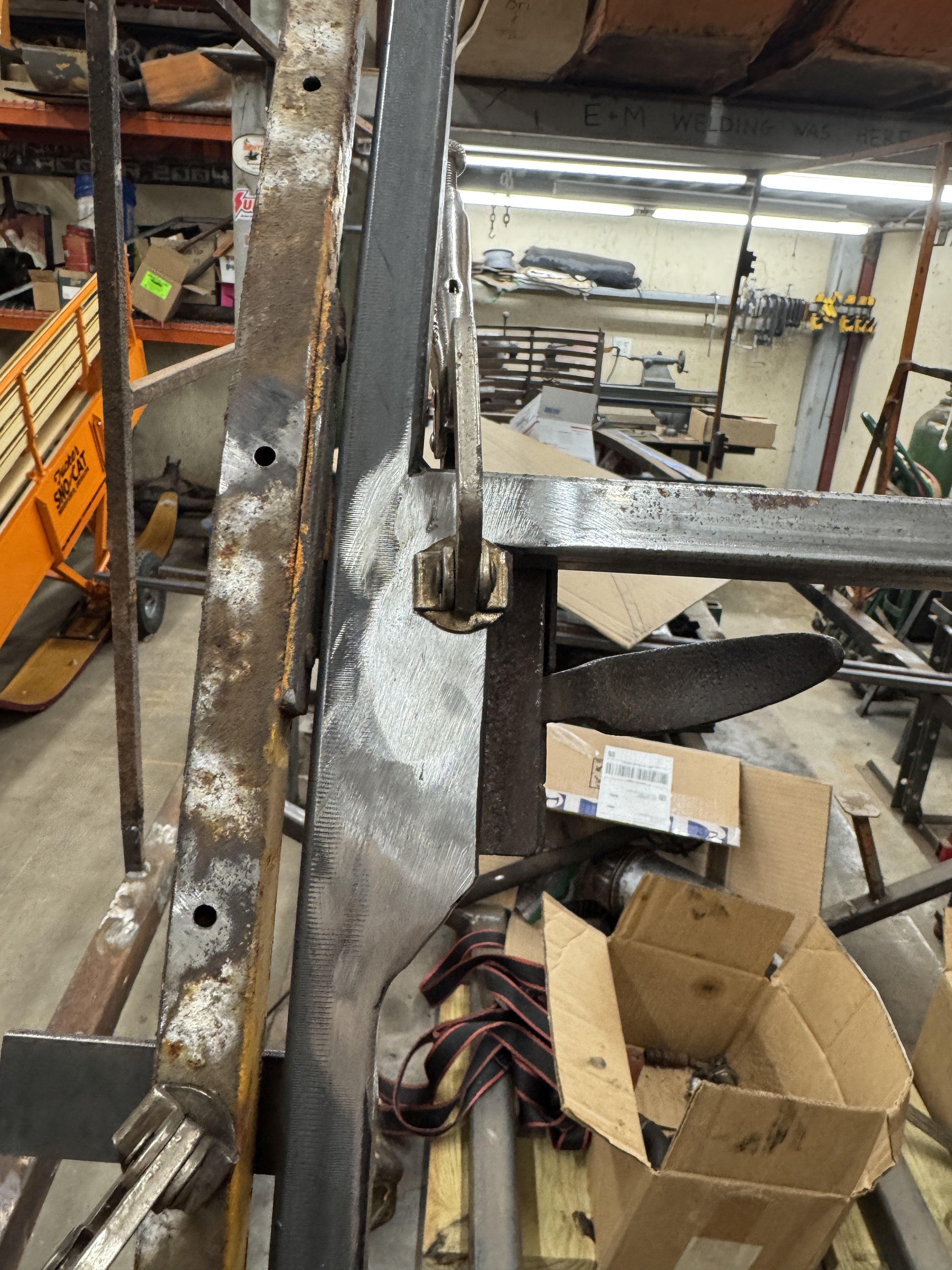

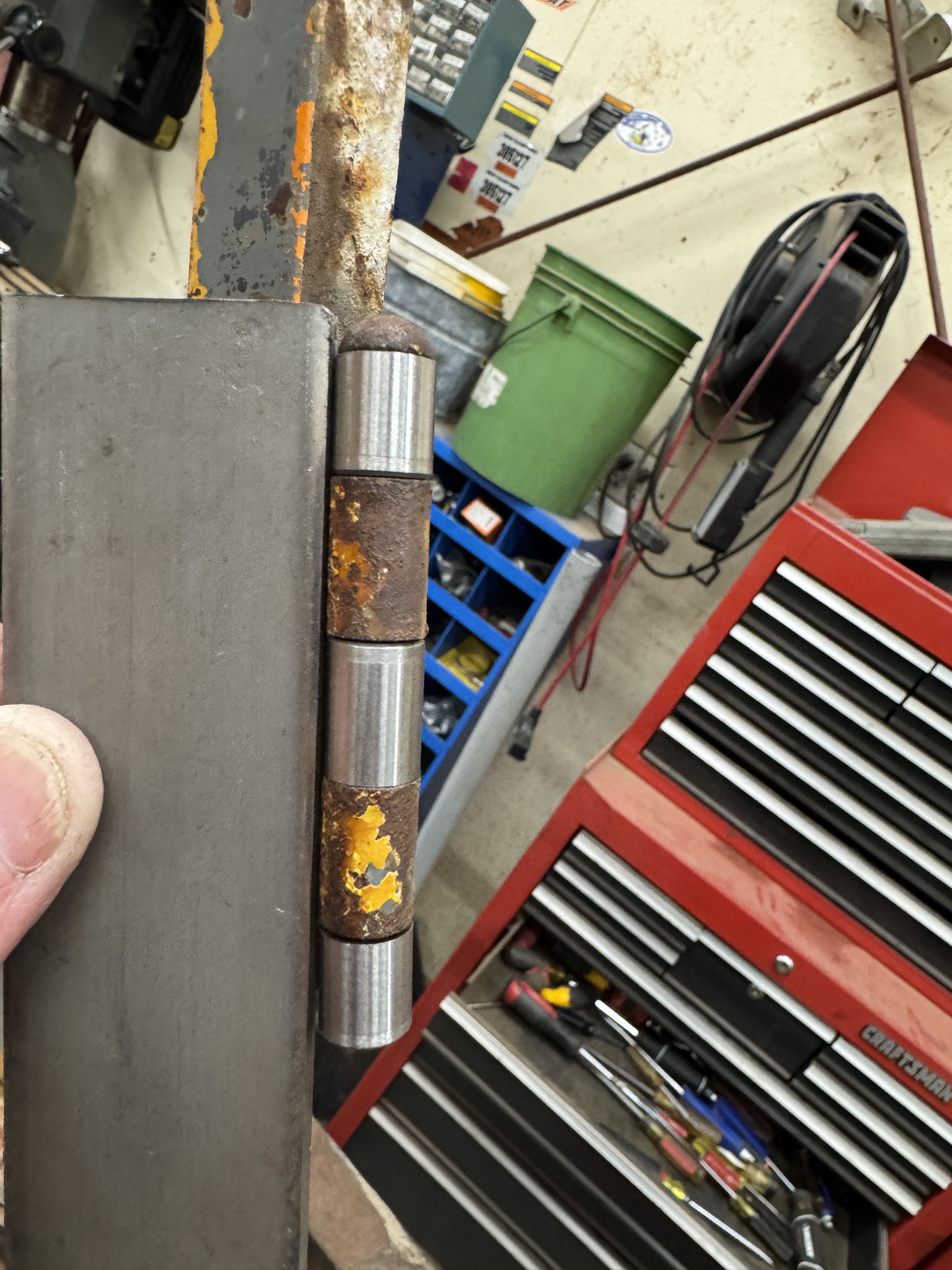

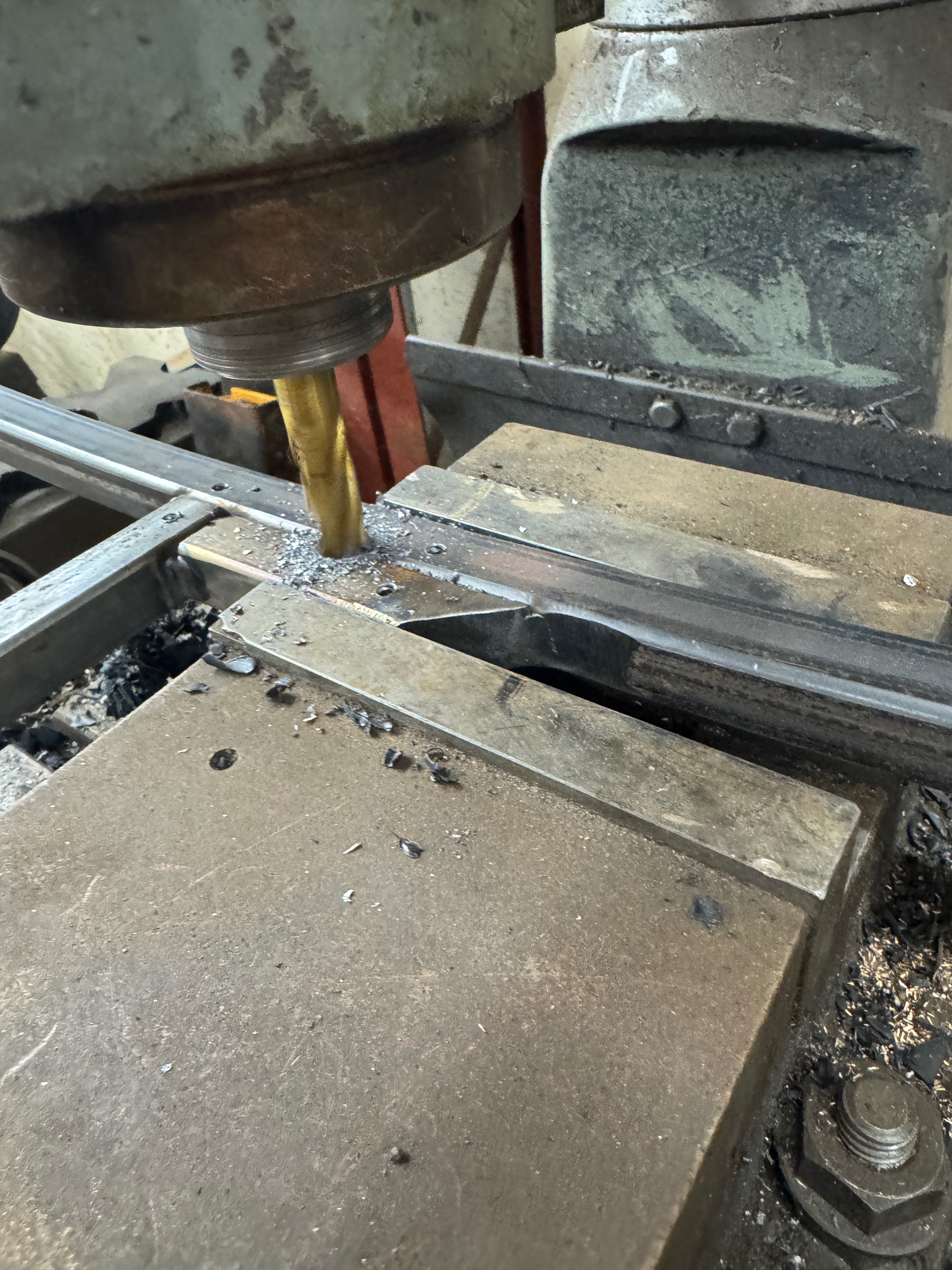

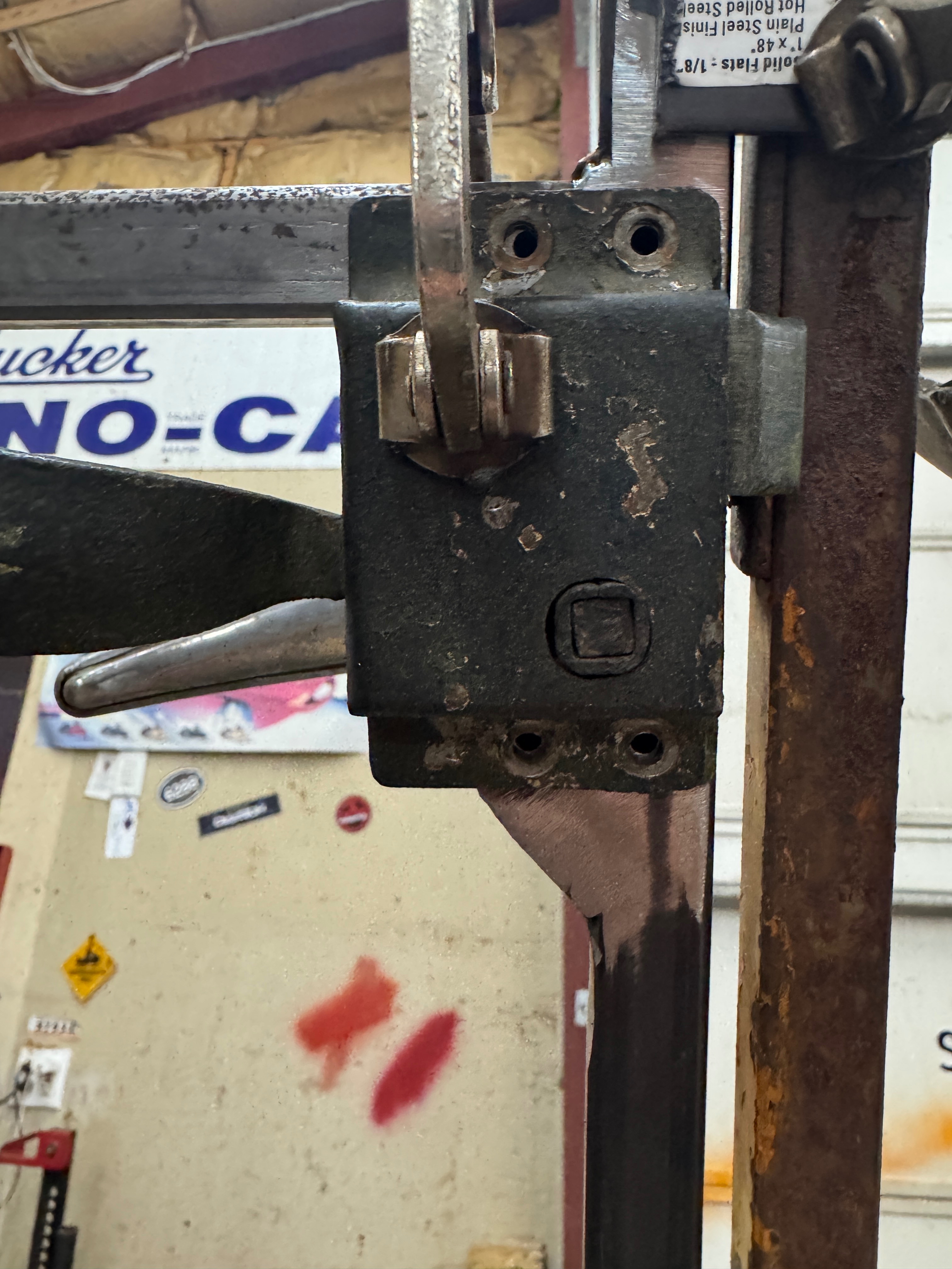

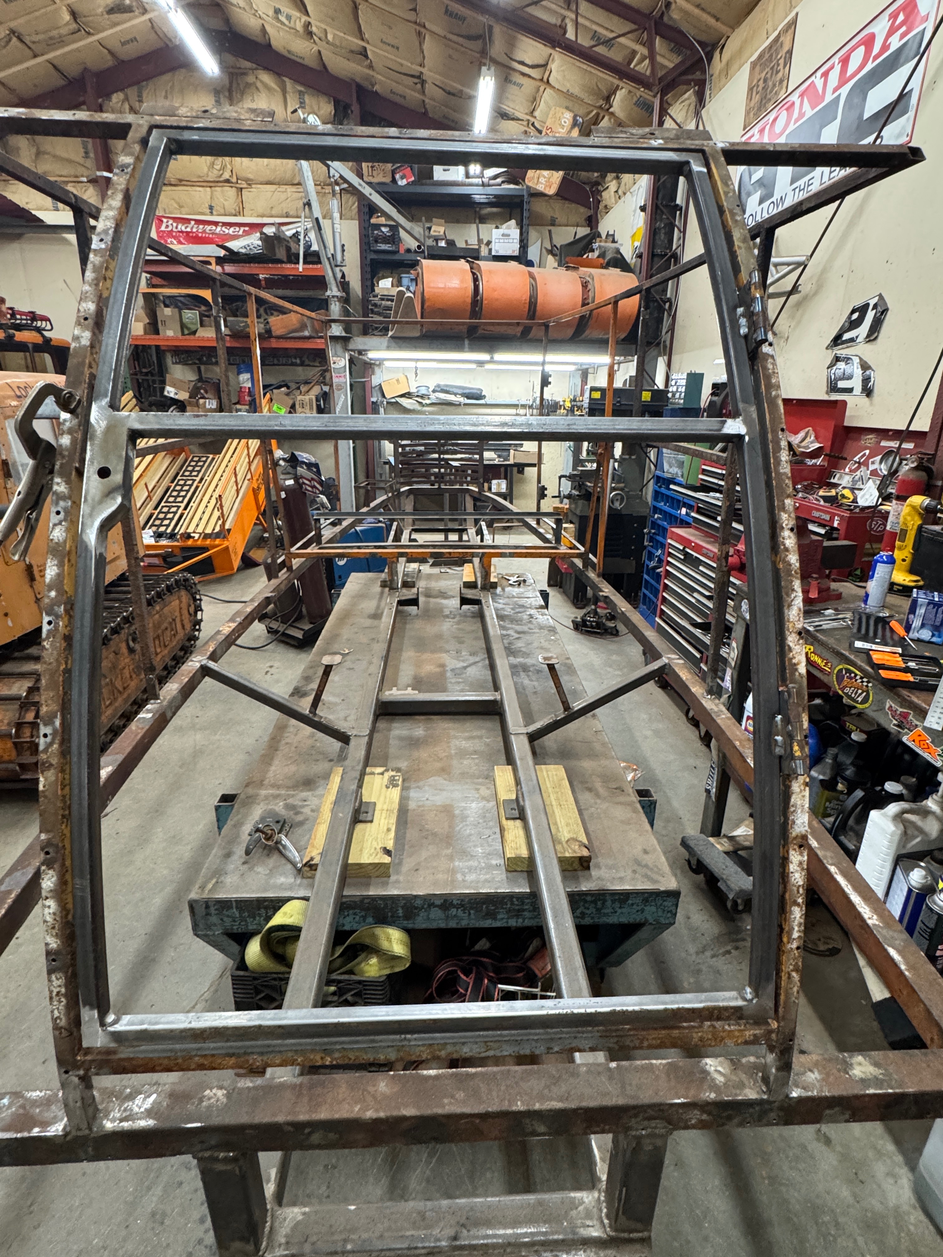

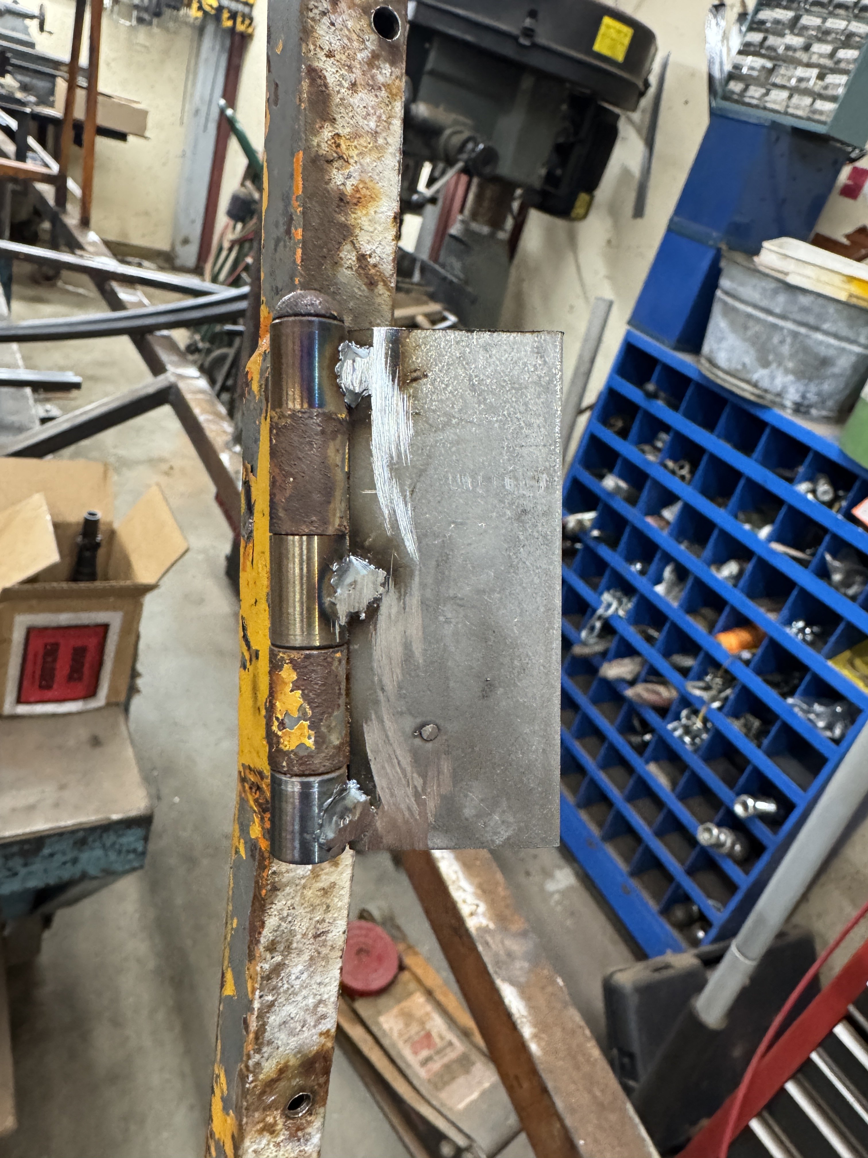

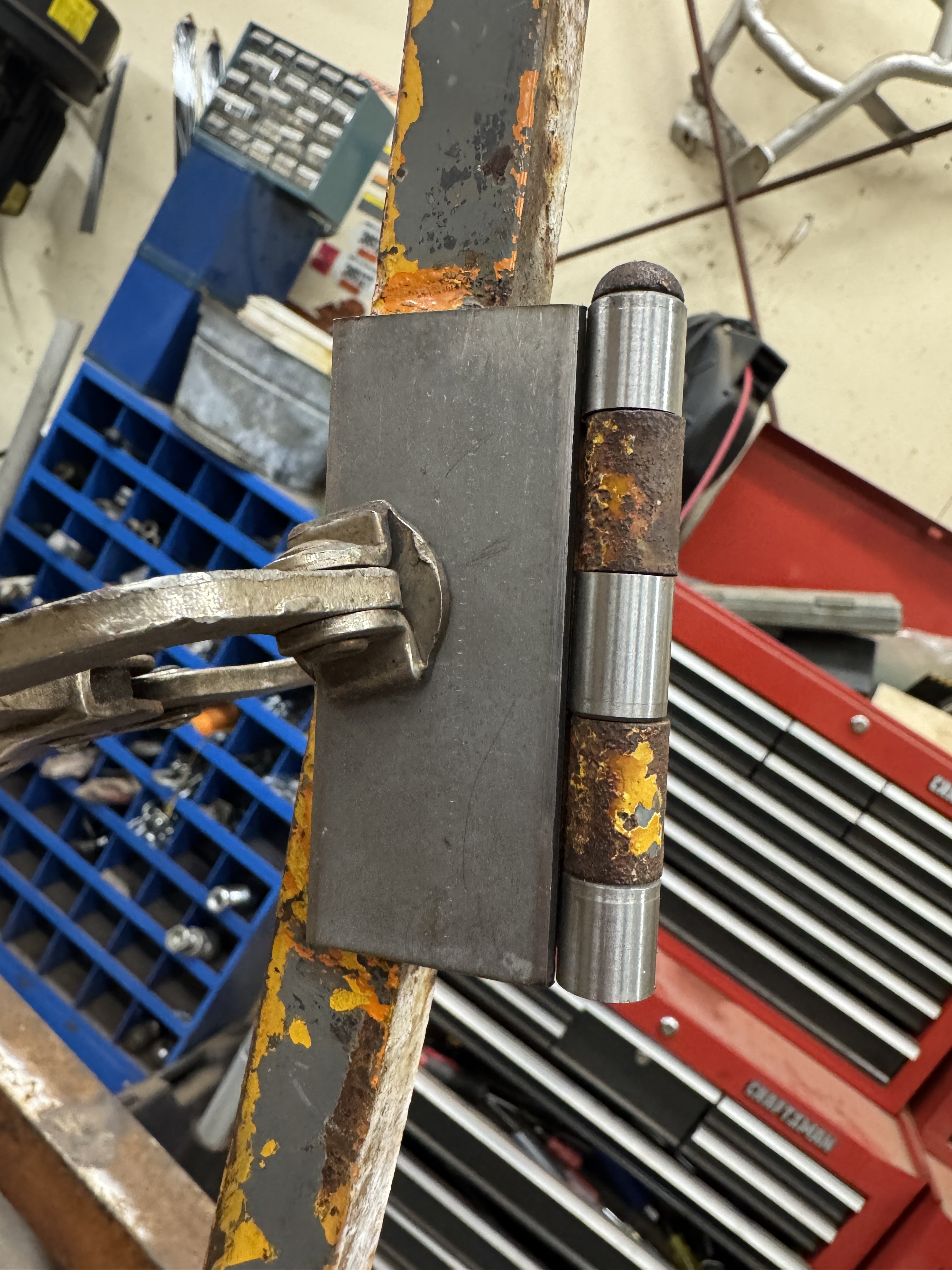

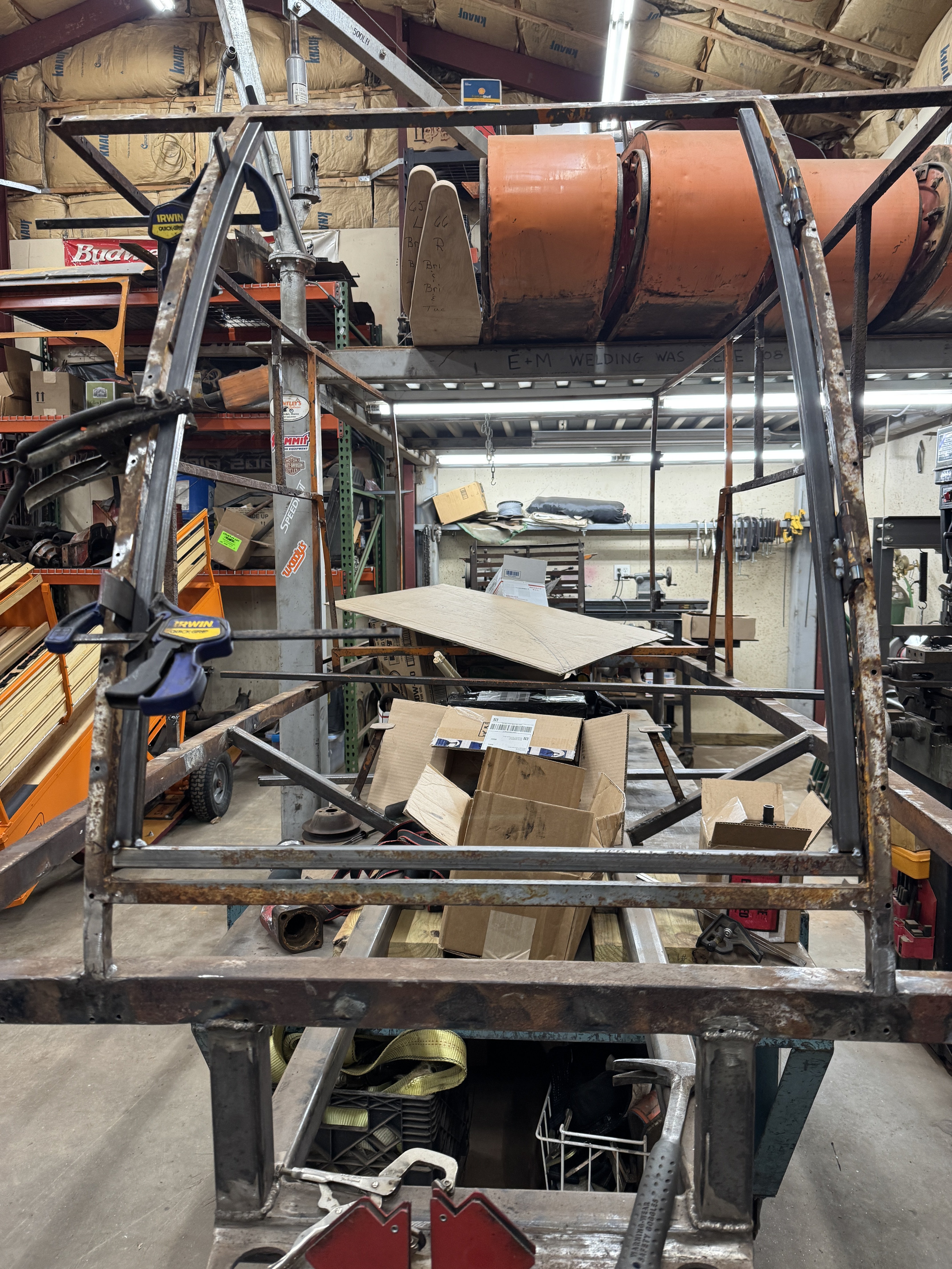

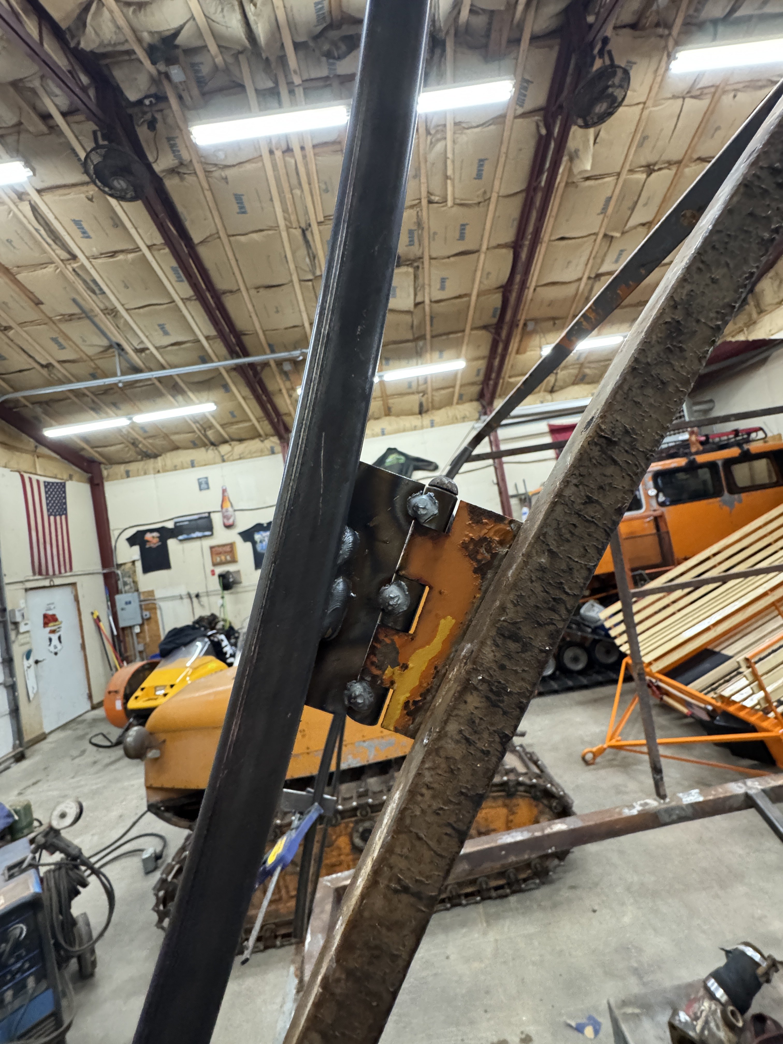

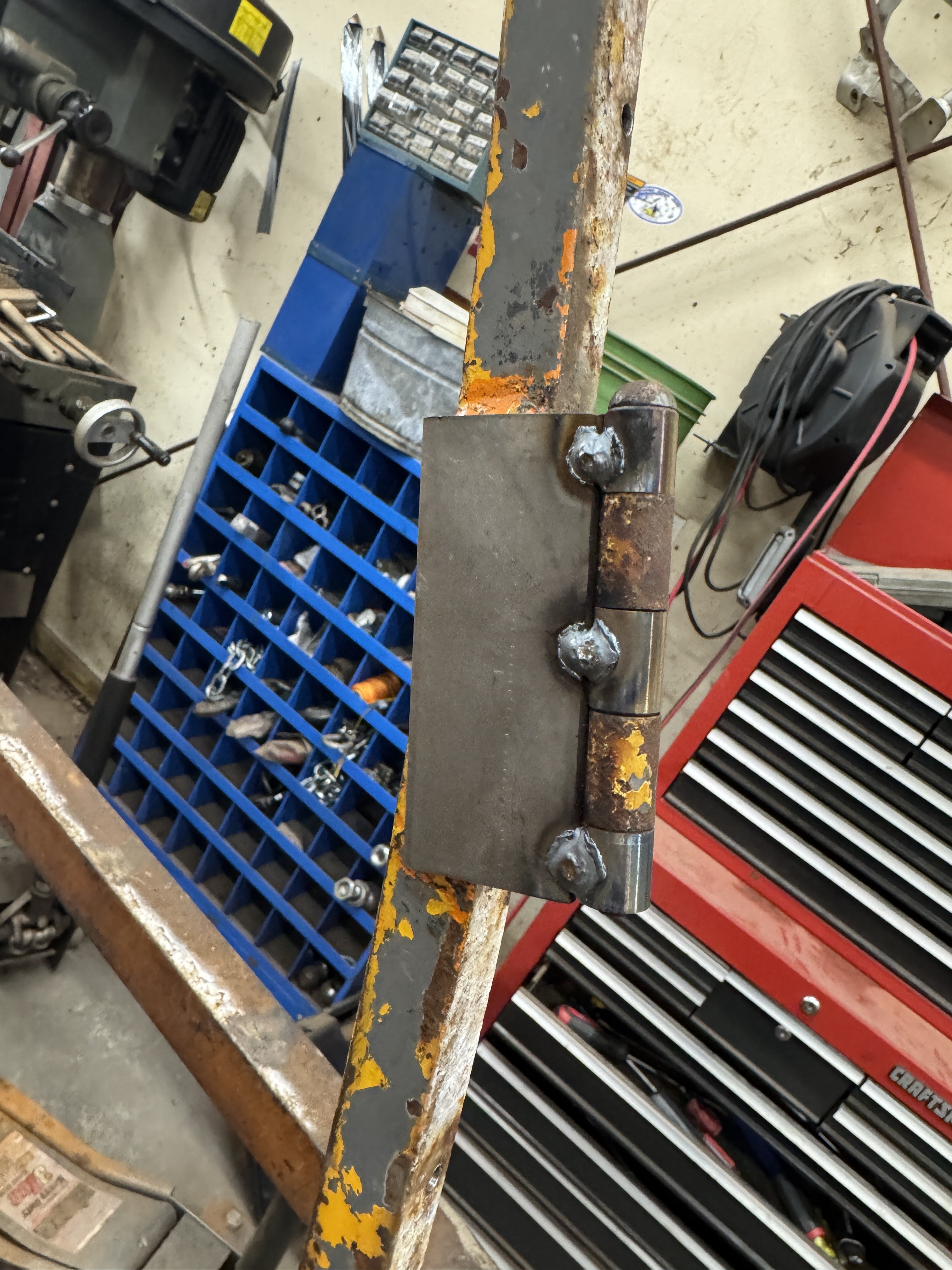

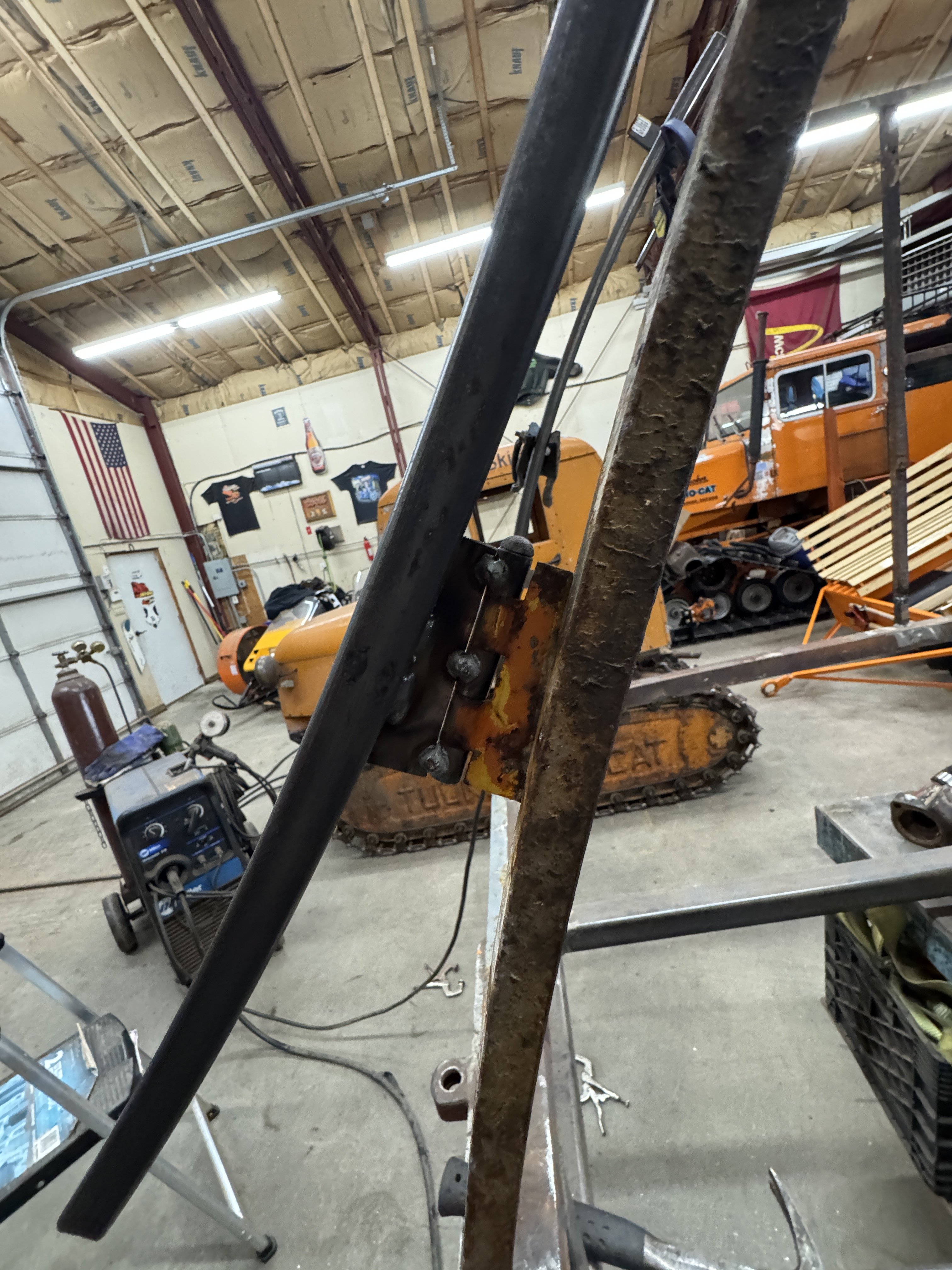

Mock up of the rear door starts with the missing hinges.
Sourced drill bushings to get the length/od/id right and will fab up brackets to match then weld in place pinned for alignment.

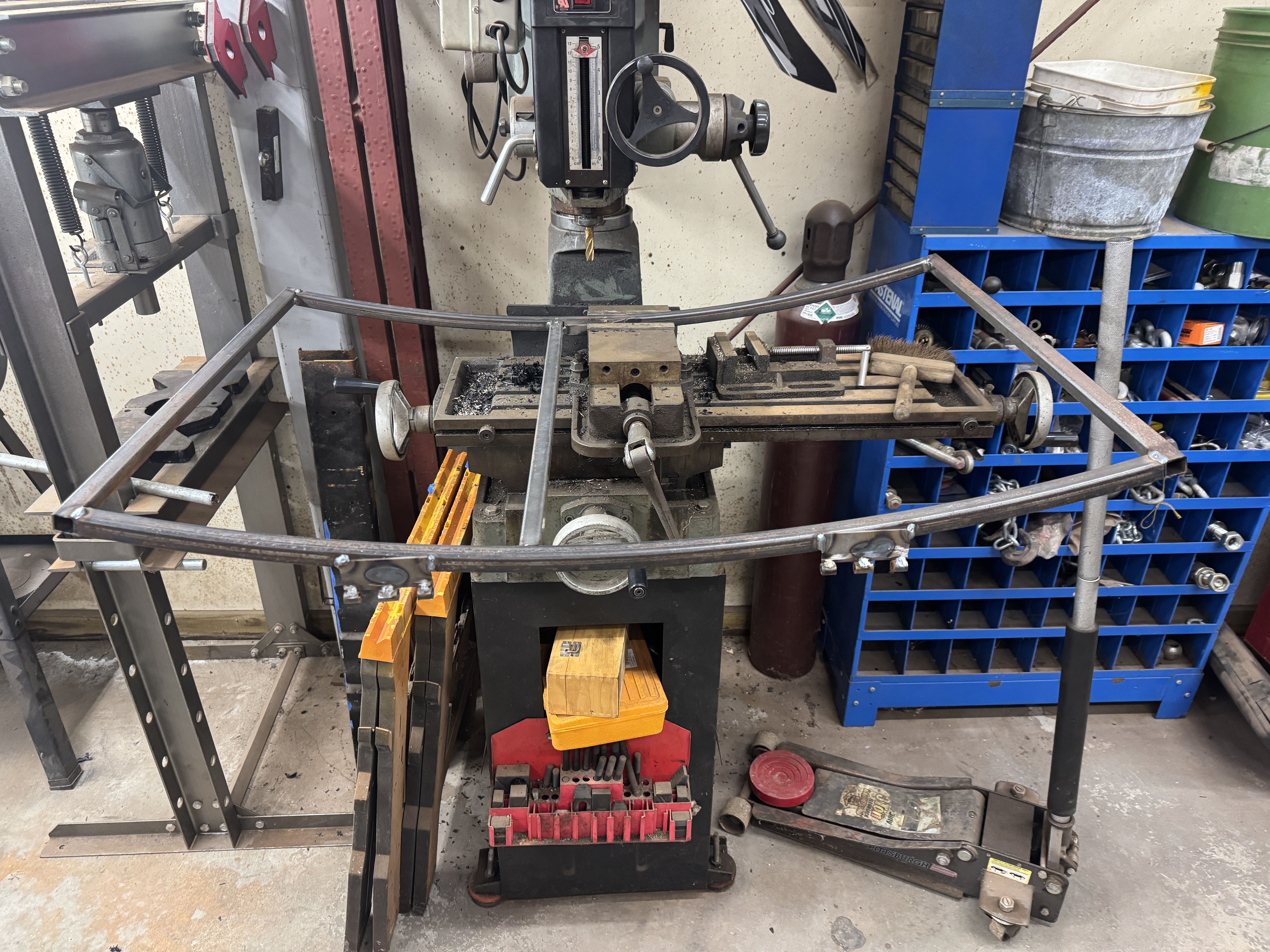

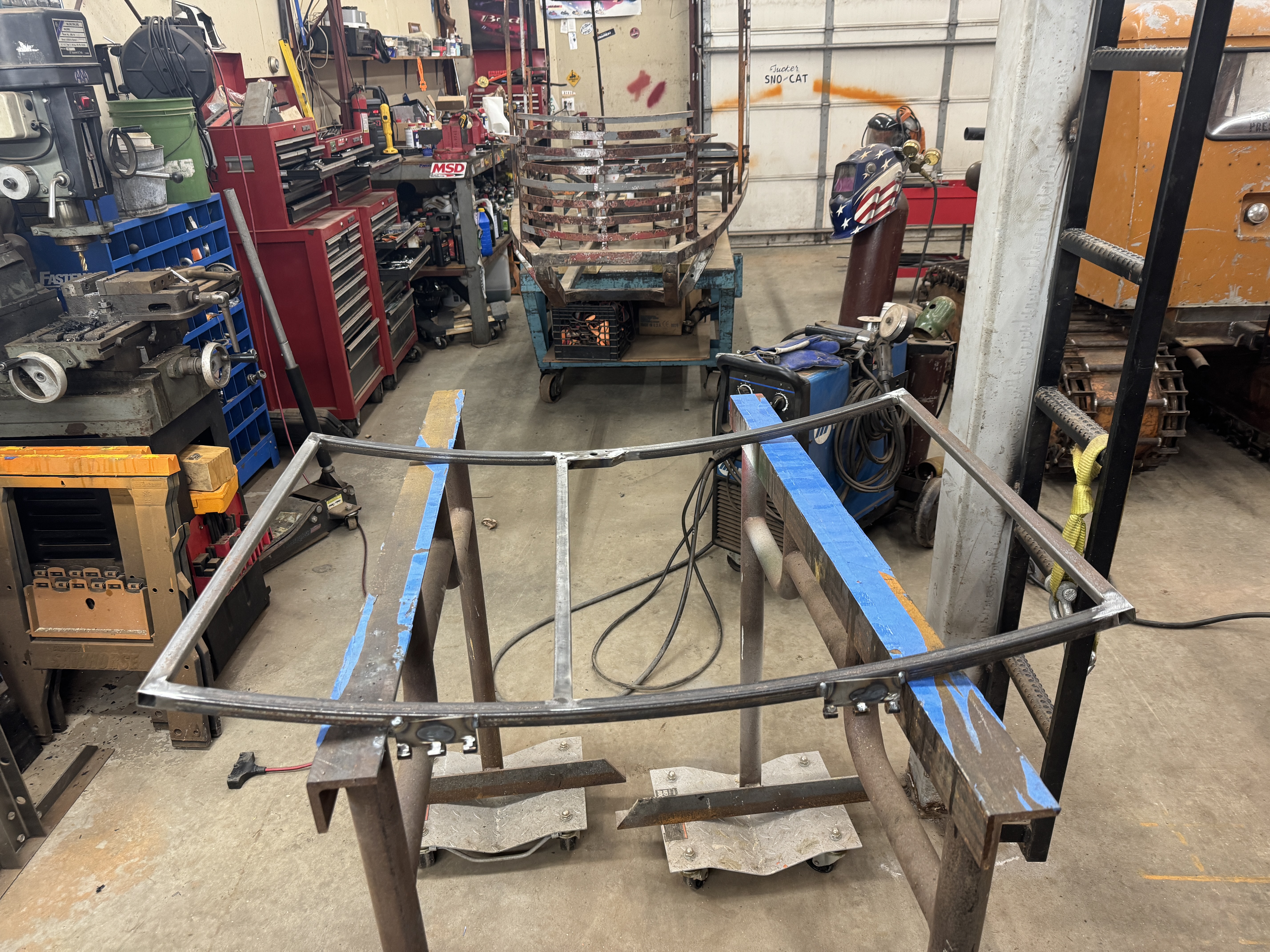

Hinge fabrication tack up and hinge side curved frame tack up went smooth.
This sets the base for the door alignment all within Tucker tolerance!

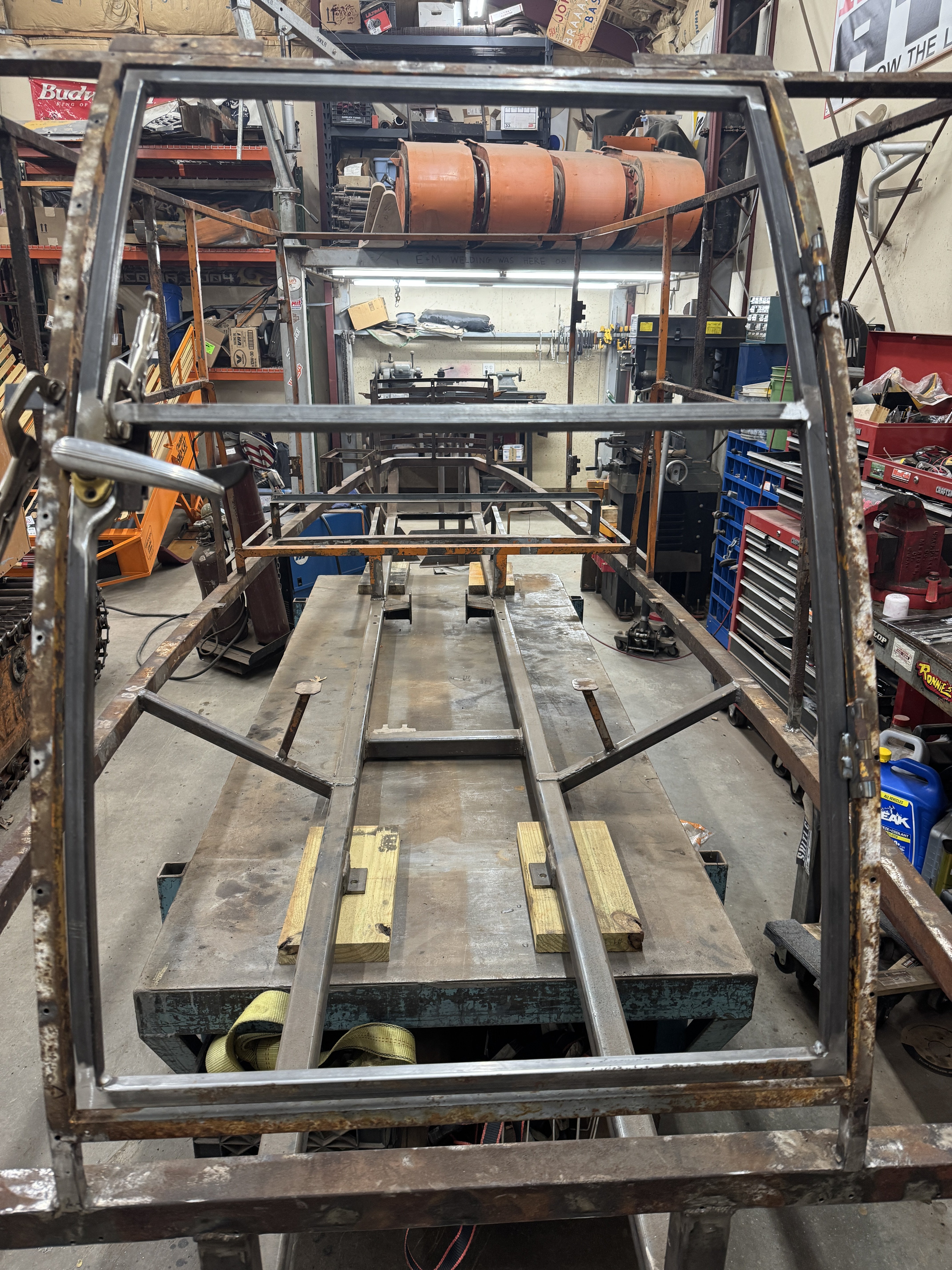

Happy to report Marty is back to a proper 443 with the door frame tack up complete! Used pictures and other Tuckers of the period to figure out the frame.

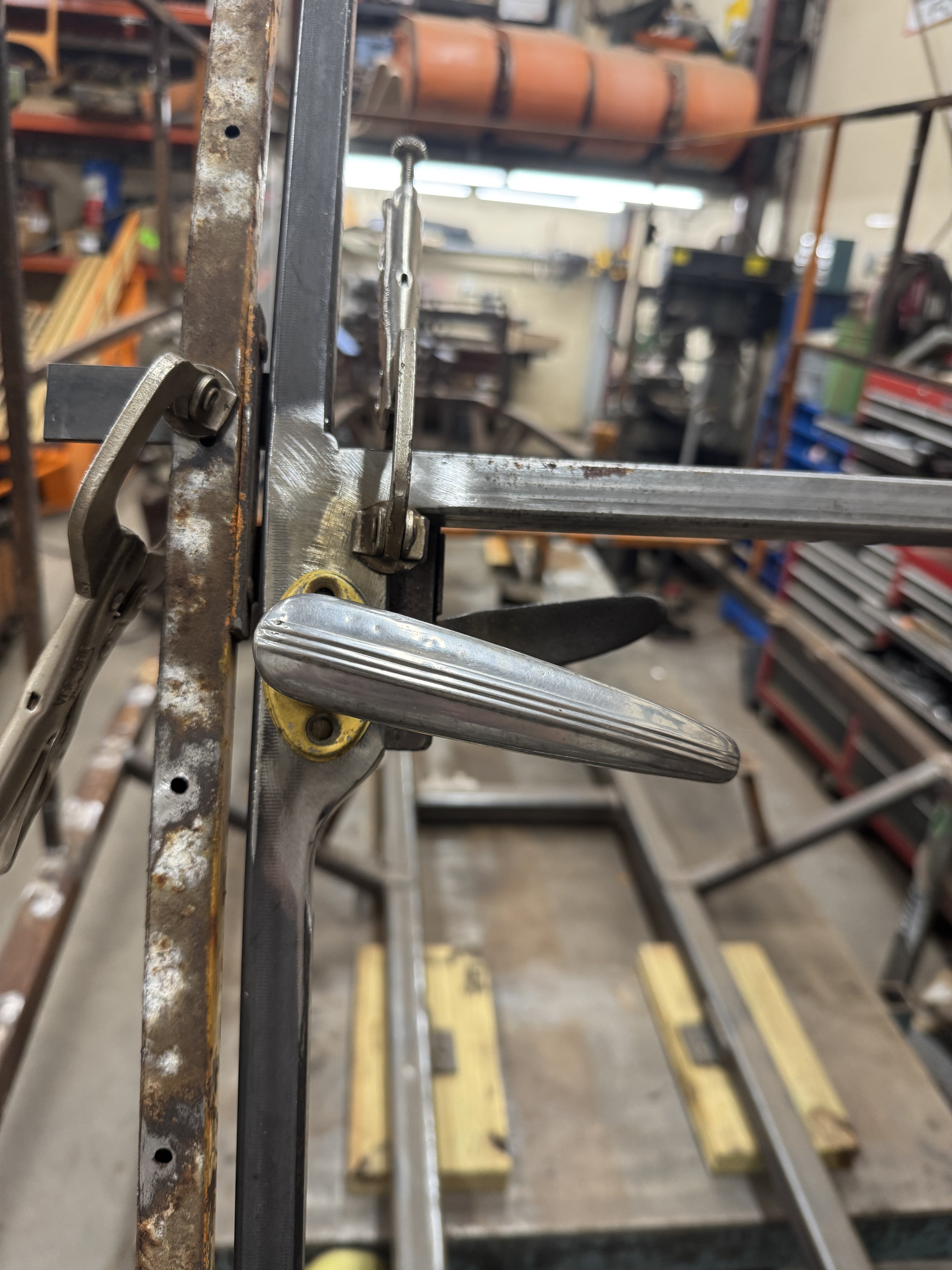

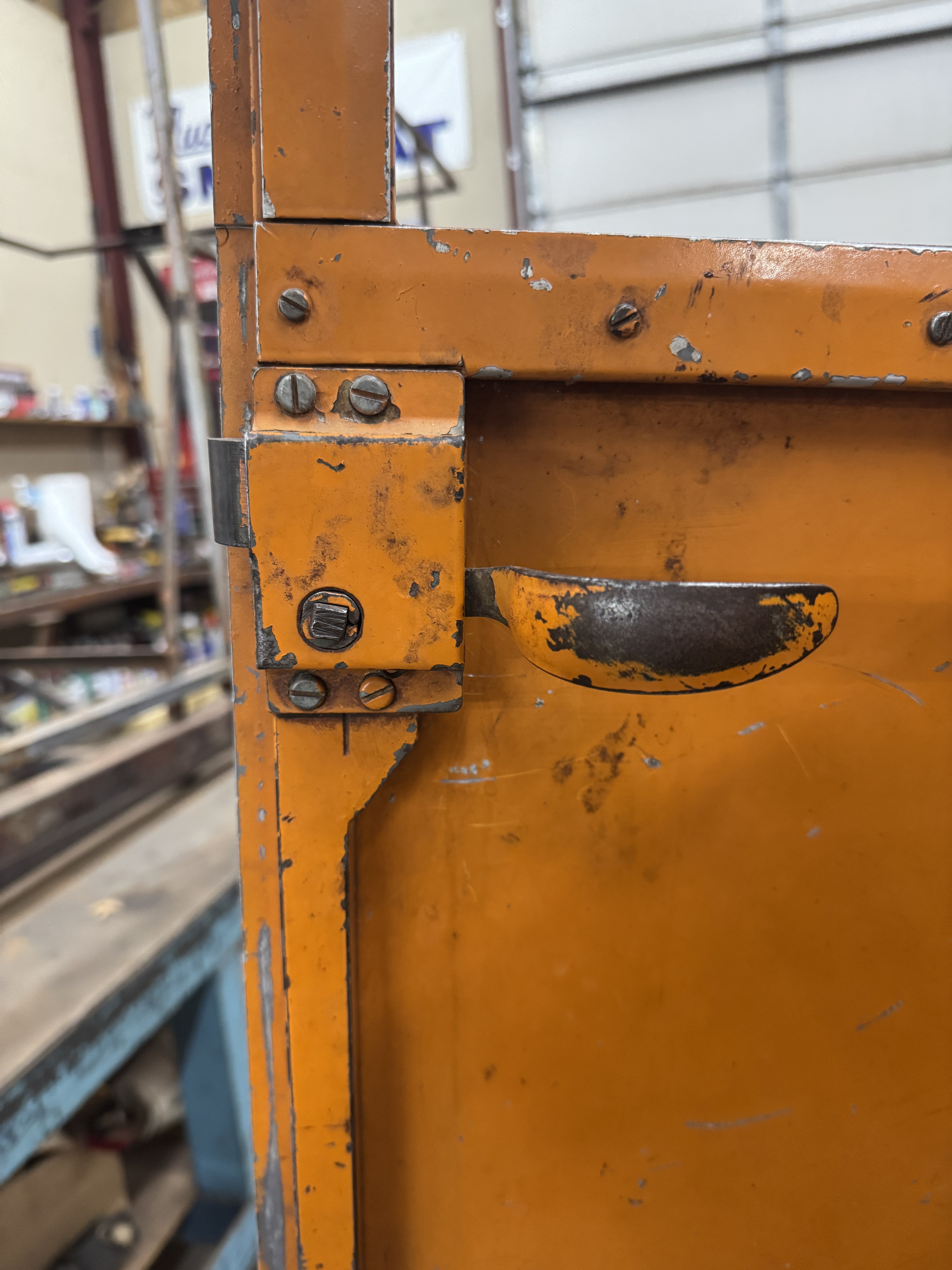

Using the front doors as a template, i’m assuming the rear was the same. This pic is the 58 Kitten but the 53 doors in storage are the same.
Will need to mill a hole for the handle square stock but looks to be within Tucker Tollerance.

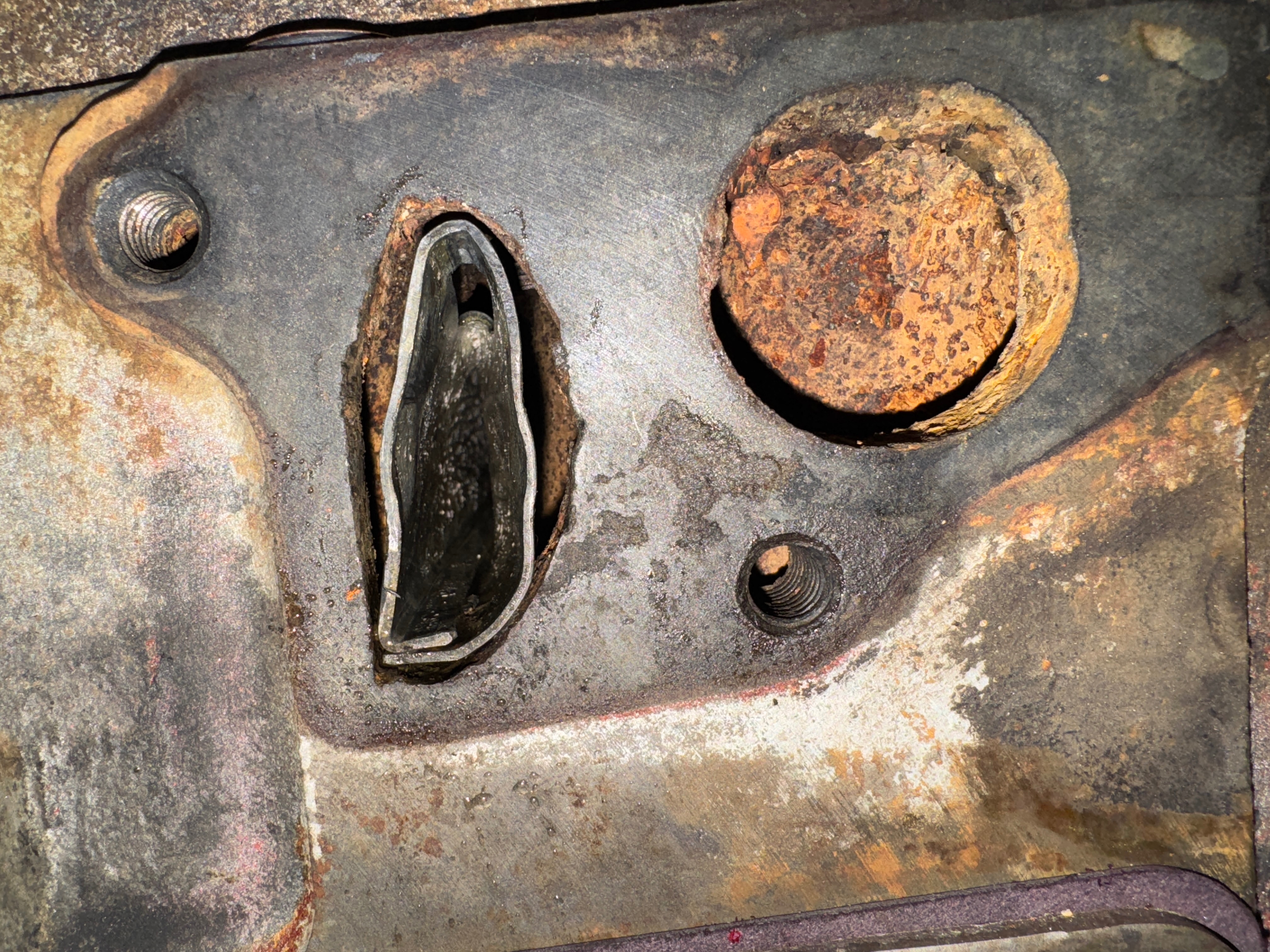

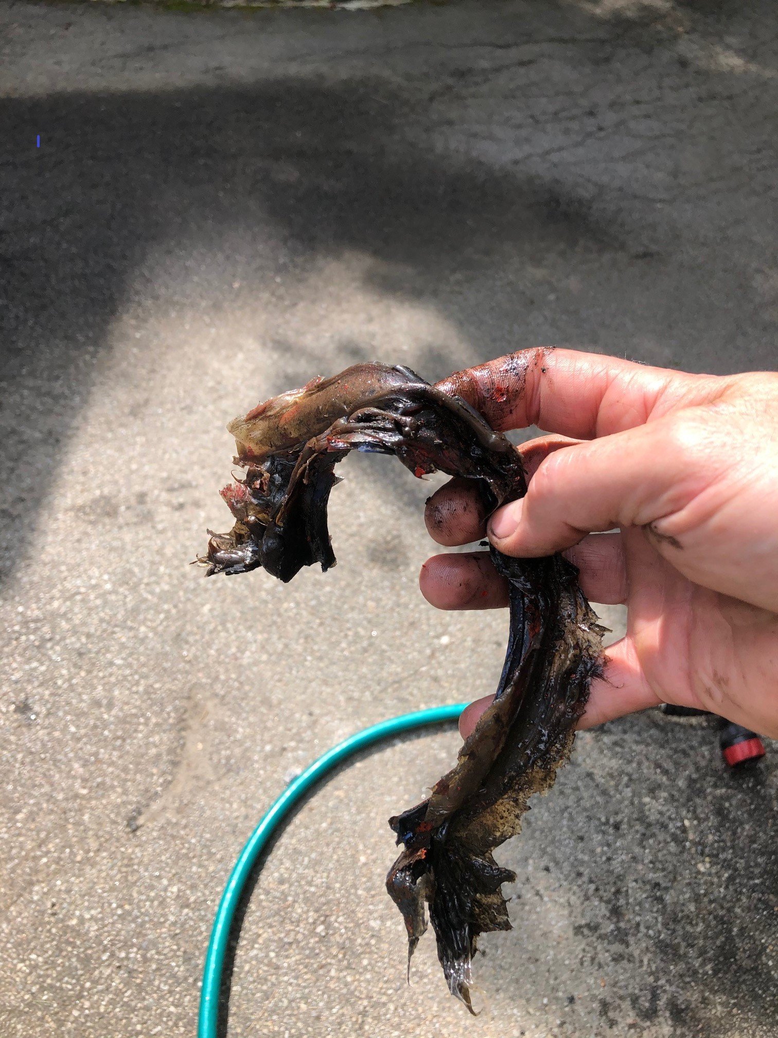

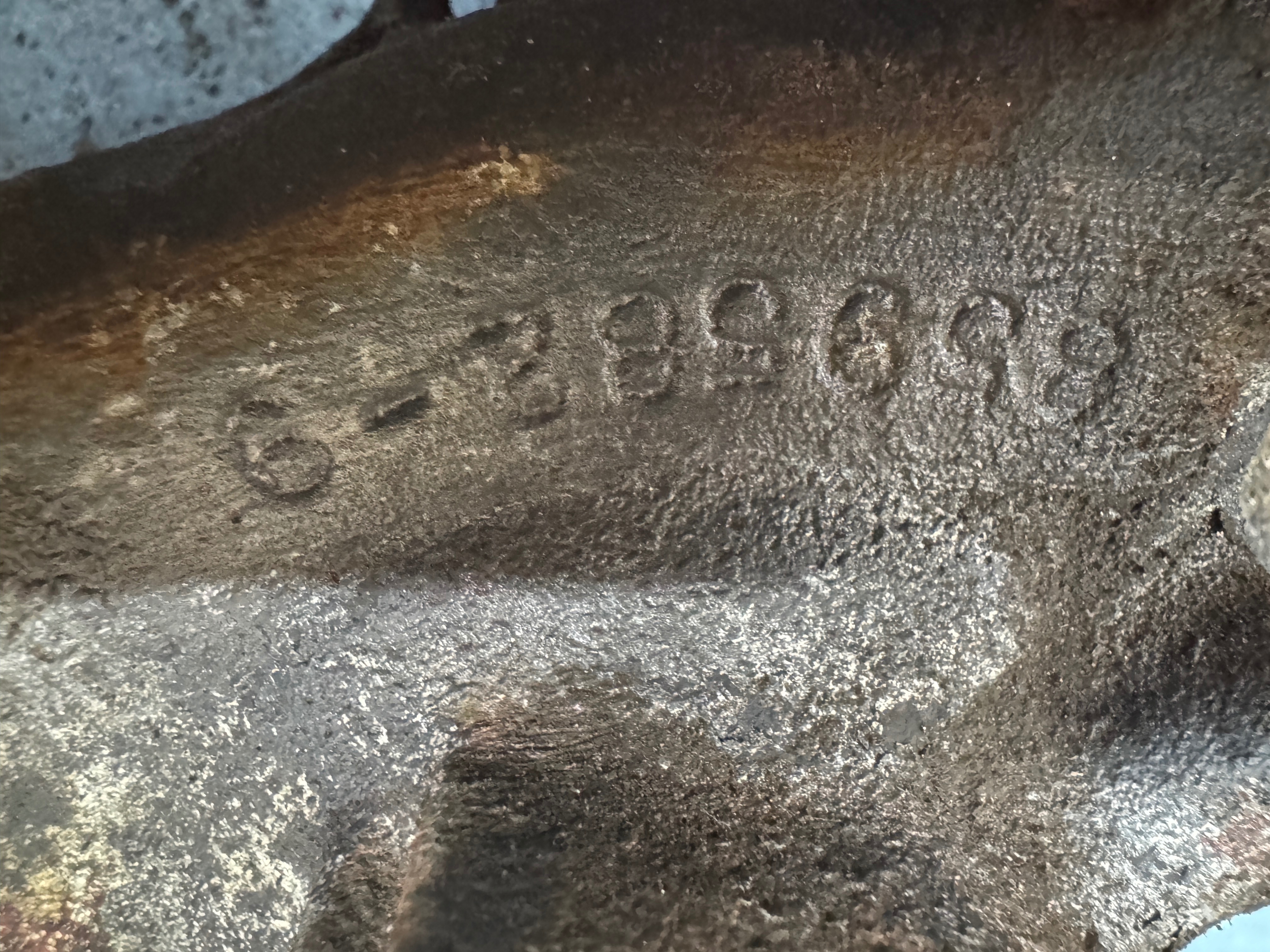

Water Distribution tube looks better than expected and came right out with the tool. Will be replaced after block flushing. 25” block is difference than the 23”. Canadian built, Desoto, Plymouth 25” is the model to search.

Was able to reuse the water distribution tube!
Either this has been replaced or Marty has the fountain of youth. My hunch is a correlation between quality antifreeze vs water in. the dirty south. Replacement options are either a dissimilar metal or thin gauge. Some lucky folks might find a bronze tube in their 251.

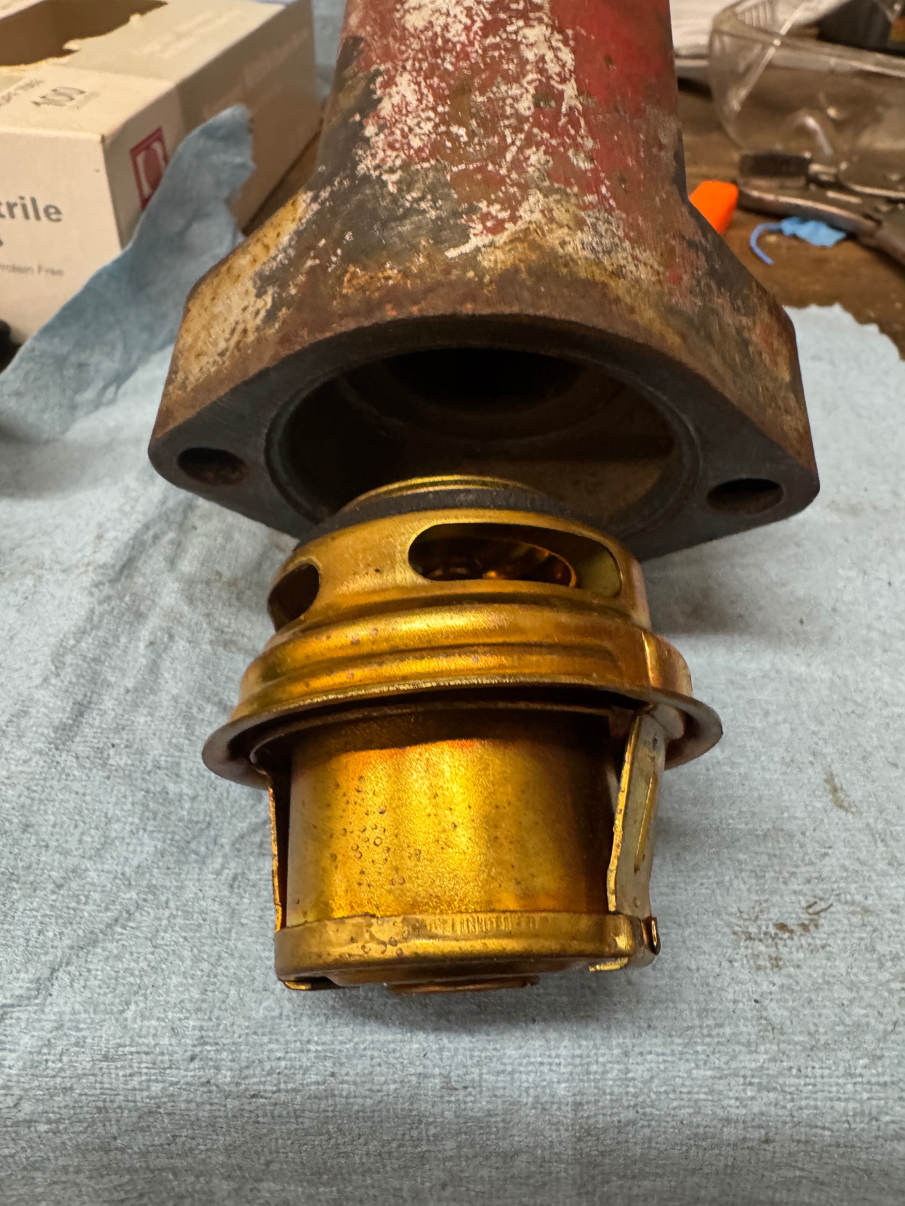

Water outlet, thermostat, gasket installed and torqued to 30 ft/lbs.

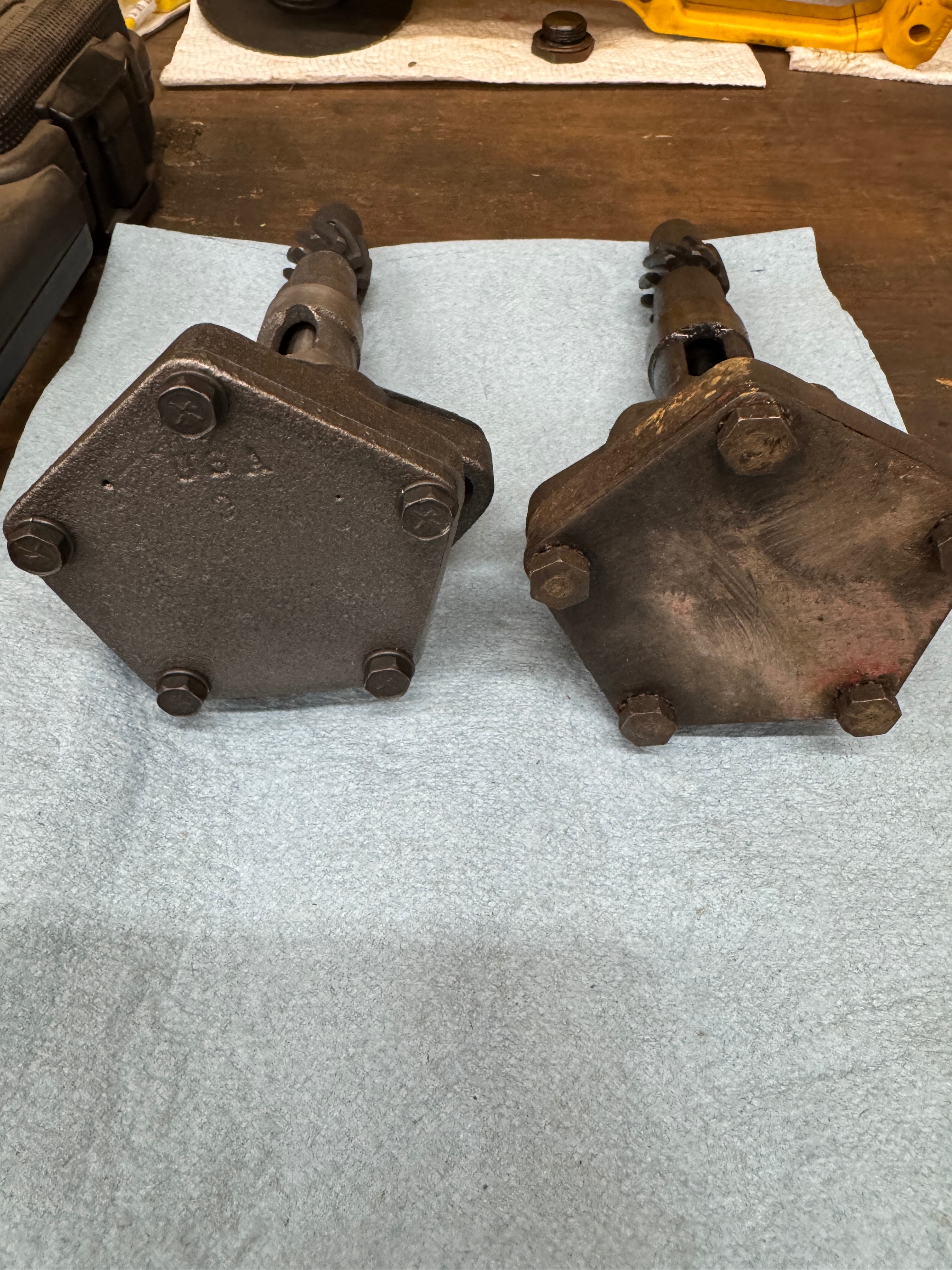

After the slant oil pump experience, sourced a new replacement pump from Andy Bernbaum experts which looks to be a melling. Temp installed but needs to be indexed and primed prior to firing.
Coolant system complete. Found a correct rebuilt pump to keep it OE.

Make sure to use gasket sealer on the water pump cover both sides and the block to pump both sides. Known leak point. 15 ft/lbs on the cover bolts, 30 ft/lbs on the pump to block bolts.

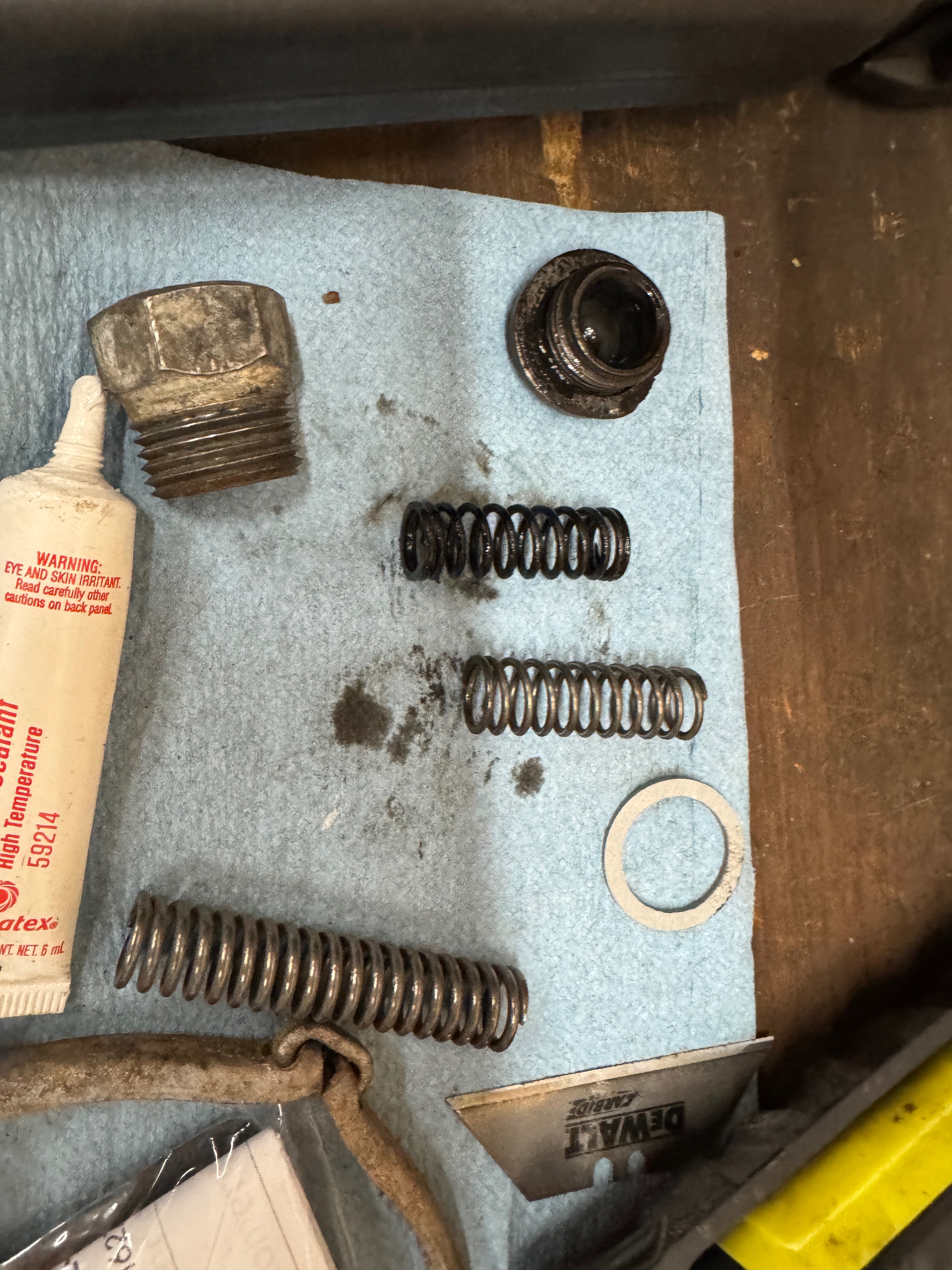

Replaced the oil pressure relief spring . These get weak over time. This kit contained both sizes that could have been used. Plunger is good to go!

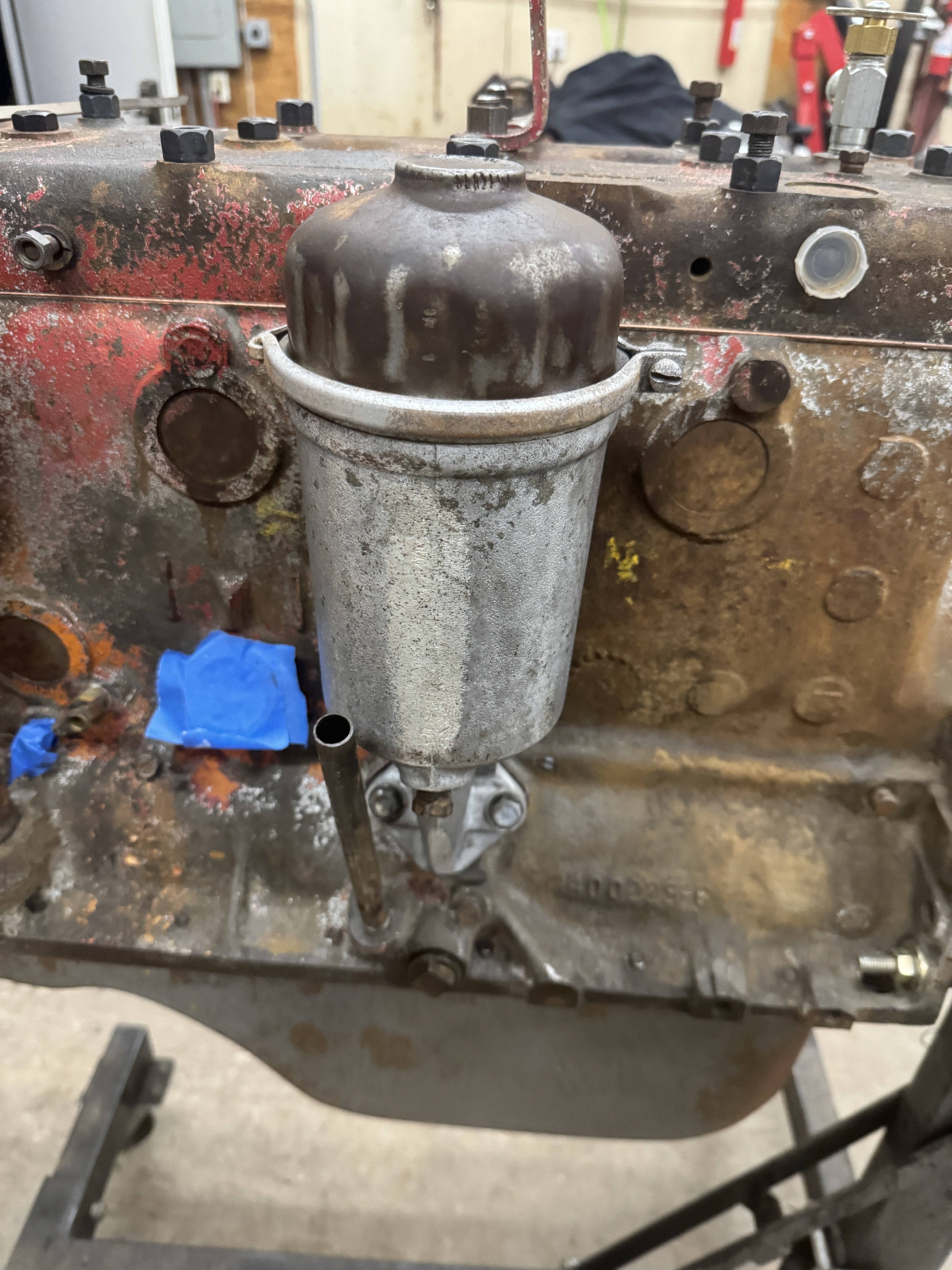

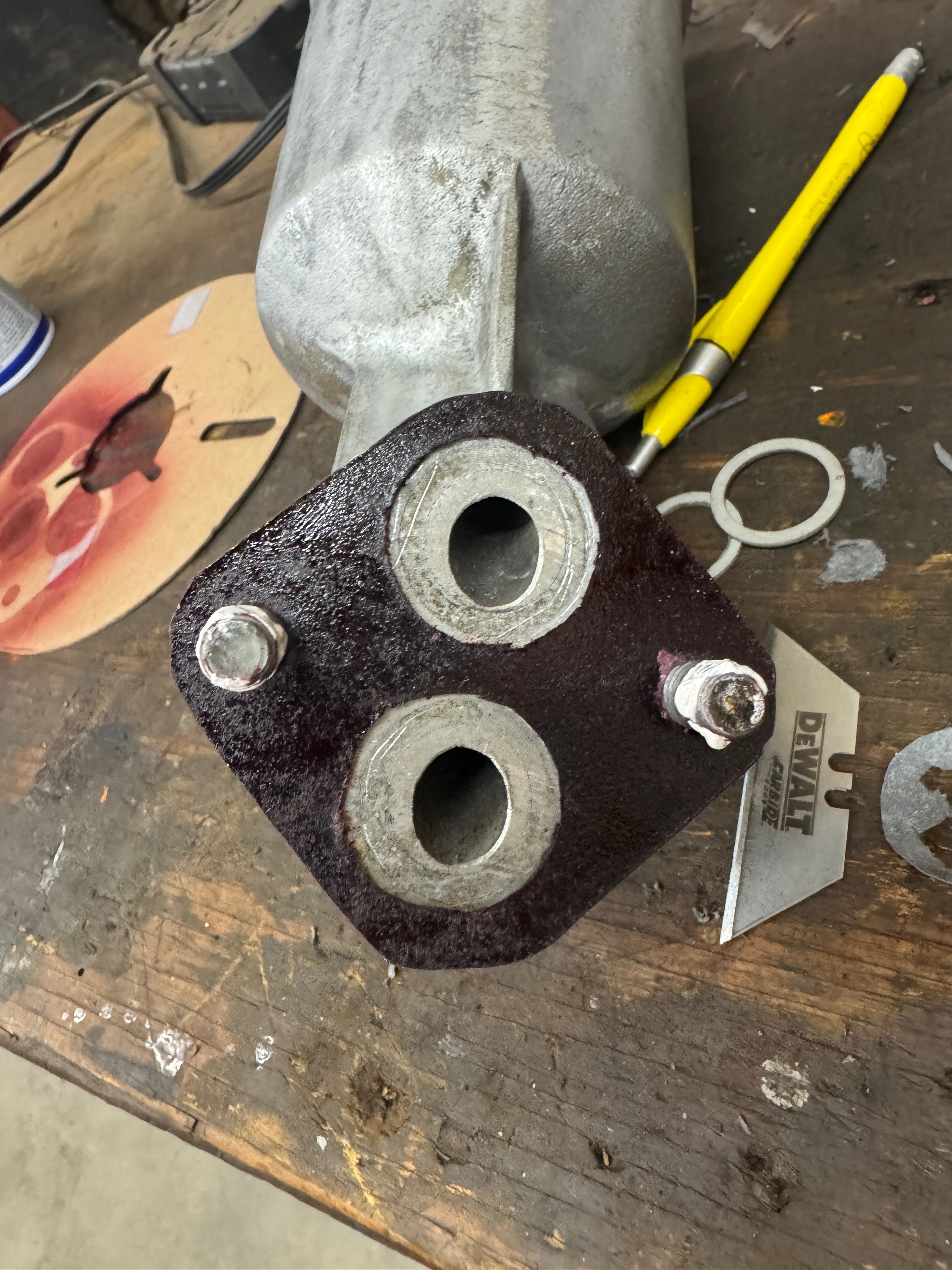

Marty’s Chrysler Flathead has a full flow oil filter setup. My understanding is 251 and 265 blocks could accommodate the 2 bolt design but not many passenger vehicles had them. Later hemi’s had a similar but 4 bolt design.

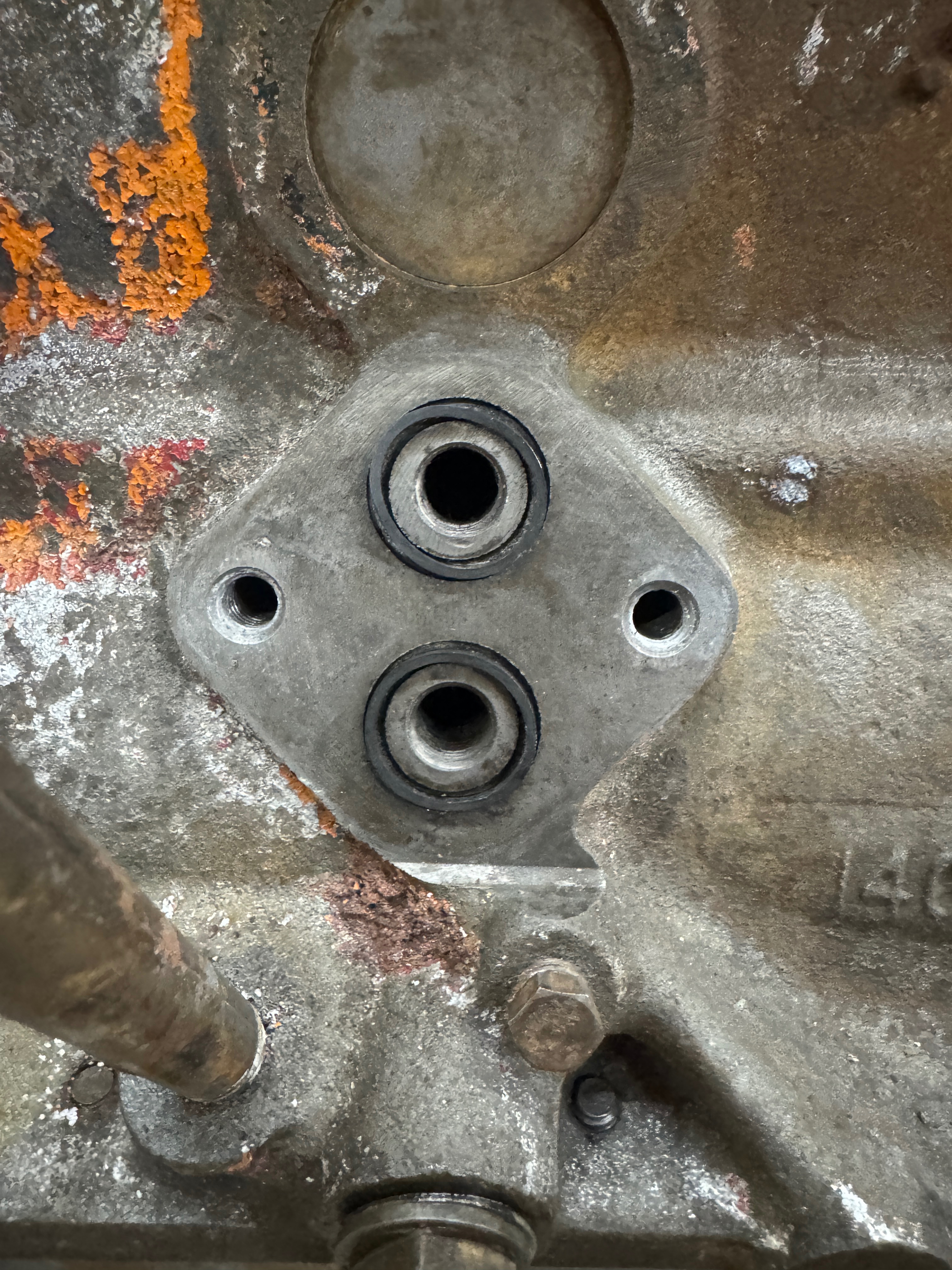

The oil ports use a flat oring design I chased back to Mopar #1138119 NOS still available from Andy Bernbaum and others.
The surfaces seal with a gasket that is a mystery so using thin 1/32 Felpro oil/gas material we fabricate our own.
