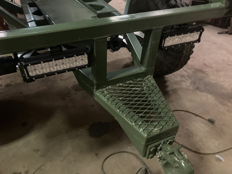

I am pleased to report all the LED lights are finally installed and tested! In my best R. Lee Ermey impersonation: HooRah!
A pic of the backup lights installed.
And illuminated.

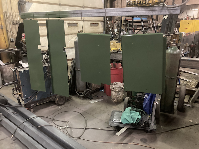

When we originally did the painting, the front seat floor pans had not been media blasted, so they weren’t painted and one of the footwell side panels was damaged by one of Scott’s employees. The original side panels had some minor damage during previous ownership, so this was the excuse to make new ones and replace them. But now we had to spray these panels prior to installation.
Here's the previous damage. If you look at the bottom center of the panel you can see it probably had some grouser contact at some point.
Here’s a pic of the newly sprayed panels curing.

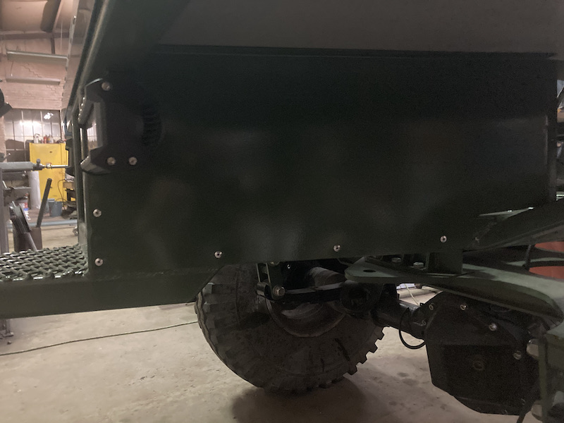

After the panels cured we set about installing them. In our opinion, fewer panels are better, but Tucker has the opposite approach. If my memory is correct, there are 18 individual pieces that make up Putri-Zilla’s floor. While on the one hand we would like to start from scratch and do a proper job, the time involved is significant, and we are under a time crunch to get the machine done. So the original ones get reused, except for the two we had to replace. However, the piece that “fits” around the steering column is so pathetically awful I strongly suspect we will replace it with a part that fits a whole lot better. I’ll have to take a photo of that and include it in the next update. Yes, it really is every bit as bad as I’m describing.
Here are the rear area panels installed. If you think the rivet spacing is wonky, we agree, but that is Tucker factory work. "Just put ‘em wherever” seems to be the factory’s method.

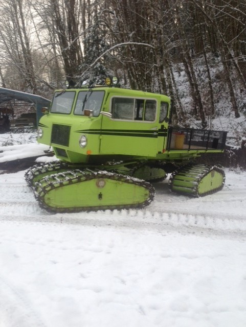

Unless I am color blind, What color is PP's Kitten? Something about the pot calling the kettle GREEN. You have been outed PP. See, there is not even one snow catter that doesn't do green.
Sweet Wbj1 we will settle the finances later. March?
As I recall, Mr. DAVENET, you had something to do with the picture?
u
for clarification, the kitten was owned by the USFS and NOT responsible for what color they painted, fyi, under the damn ugly green is factory tucker Orange.
I did not paint the kitten GREEN...
it is a sin against the snow cat GODS to willfully paint a tucker GREEN, so help your soul, sweet one
