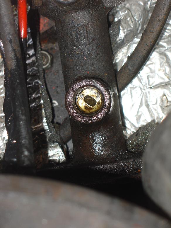

The problems on the brake system are:
a) in the master cylinder ( the Gommet rubber plug seal is broken)
b) The right rubber hose to the wheel cylinder (this part in years became a solid part)
so the rubber lines in the both sides of the drums didnt works.

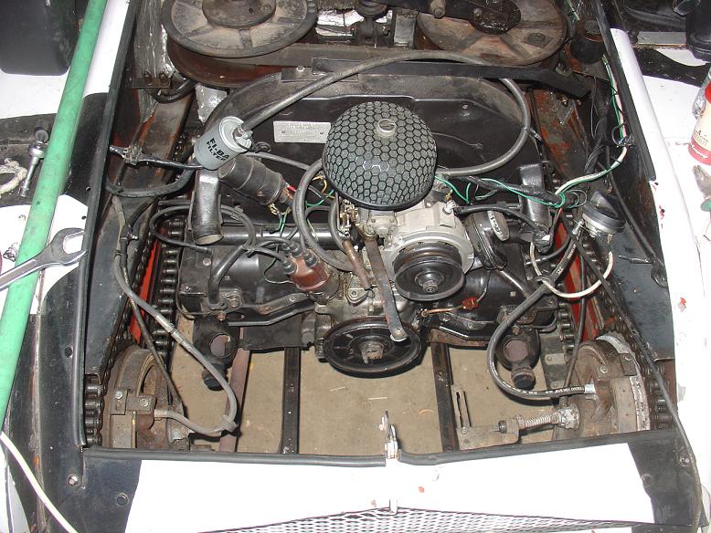

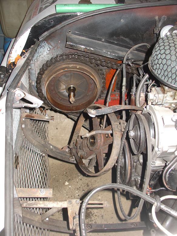

a) I remove the Skid pan from the bottom, and the plates - the firewall panels fits in front of the engine on the ST4.
b) Then the Muffler.
nikos

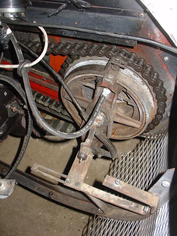

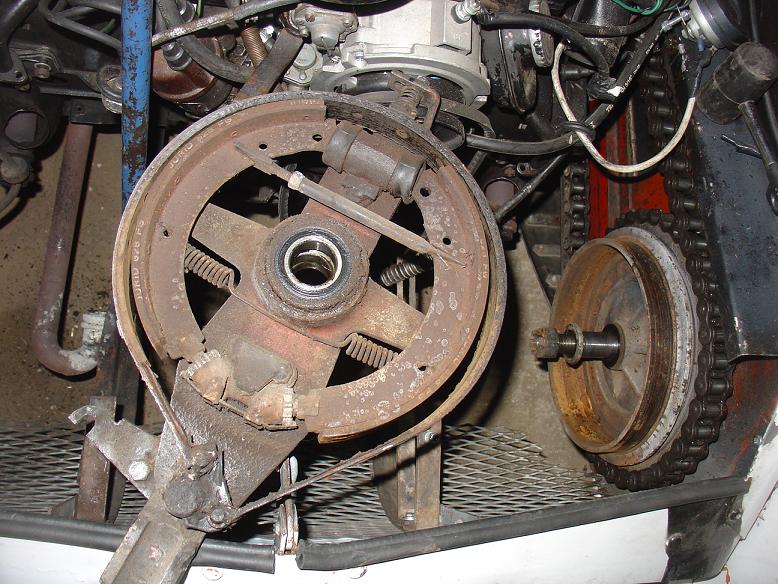

The left Brake centre, with the brake shoes, the brake lining in good condition.
I dont know what about the brake cylinder and the rust Push rod screw.

Then the right brake centre.
The only problem was the right castle nut,............. but with this type of wrench Number 32, its ok.

From the beginning we decide not to move the Pulleys and the variator belt, so we started to remove the parts behind them.
The most difficult part was the spring, how to remove it from the master cylinder.
Then the base of the Master cylinder. There is no space between these parts. You have to remove first the base and then the Master cylinder.

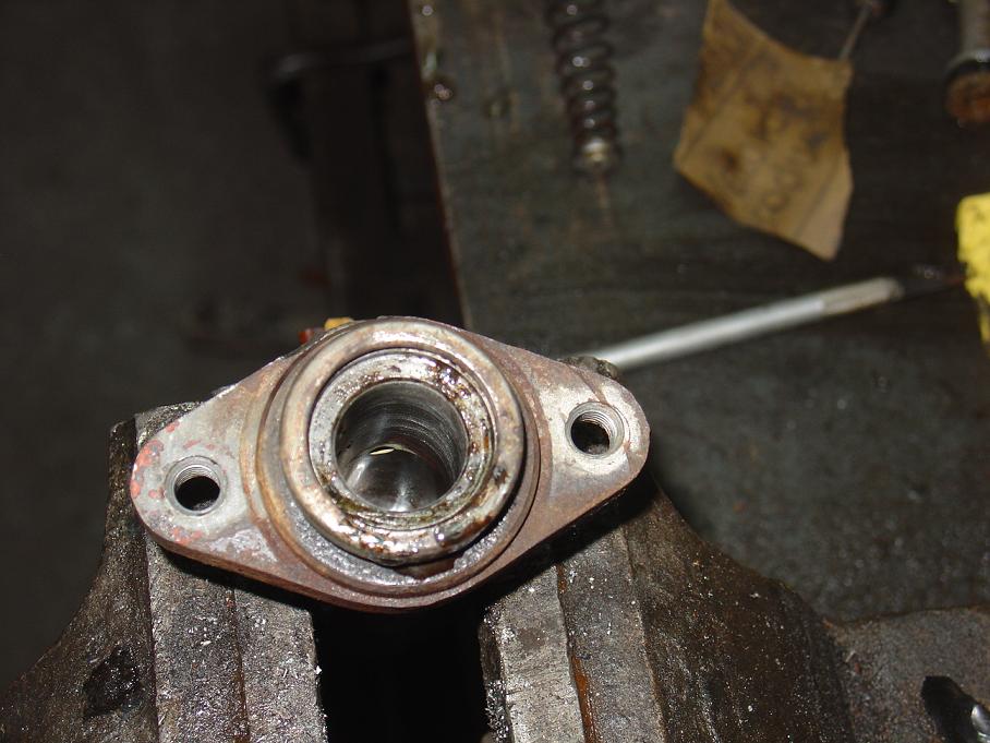

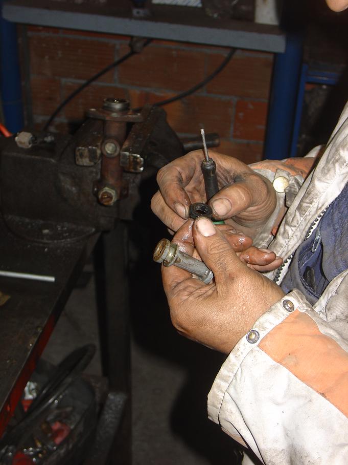

In the workshop, before i started to order the new spare parts, i decide to check the condition of the master cylinder and also the brakes cylinder.
The results of this meeting were very interesting.
1) The master cylinder was not in great condition. We removed all the parts and as you can see, :
A) Return Spring
A1) Check Valve
B) Stop Plate
C) Lock Ring
D) Piston
D1) Secondary Cup
E) Washer
F) Main Cup
G) Washer.
Except the dirt inside the housing, we decide
1) to replace the Main Cap,
2) to Fix the Check Valve
3) To replace the Secondary Cup on the Piston.
4) and of course to clean the Housing.
After that treatment, the brake cylinder works like new.

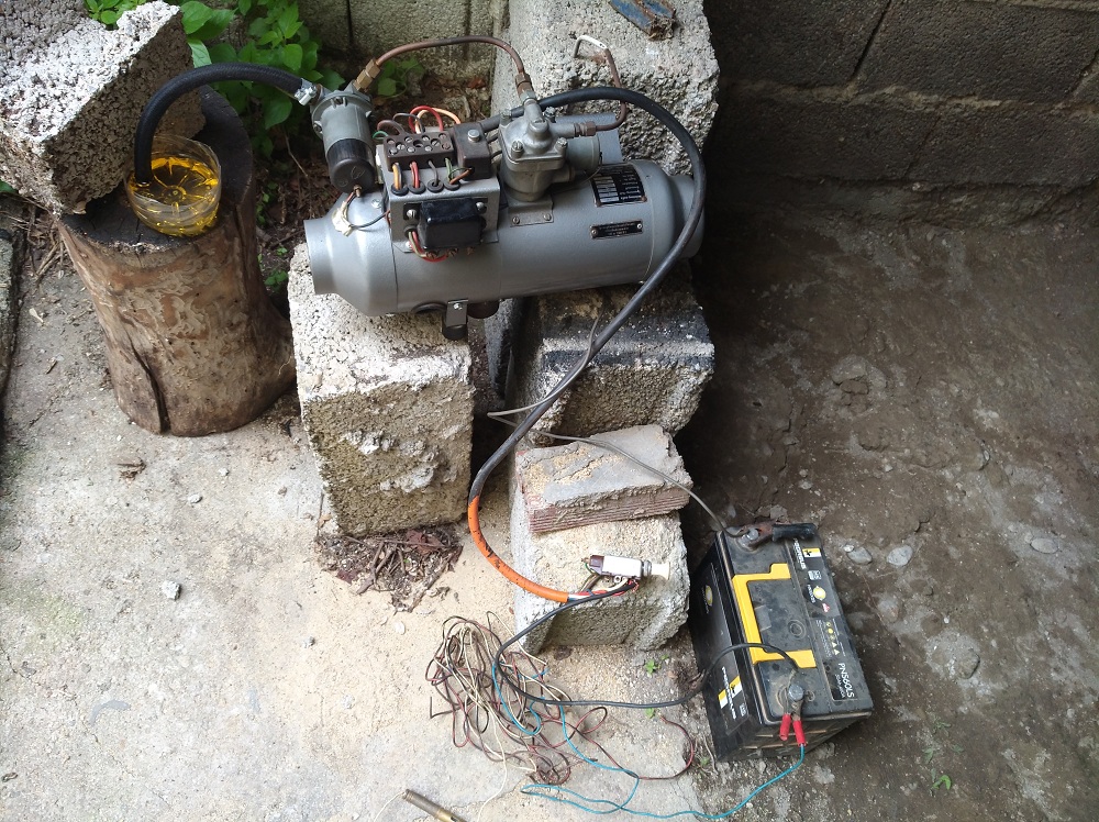

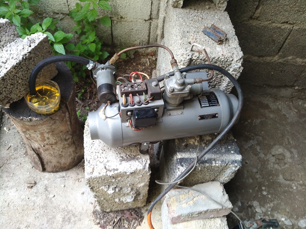

The electrical Fuel Pump. It works pertect, but i need a new selenoid valve.
The Webasto Heater. Today. Thanks to my Friend Sakis. I hope to find the right missing part for the fuel pump in the next days, weeks or months.

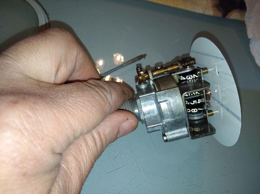

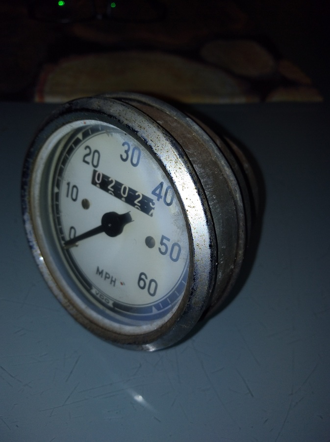

The Problem with the OMG VDO Speedometer in my Snowtrac.
My Odometer has stopped working (Since Last Year) but the speedometer still works.
I had to remove the VDO from the dashboard, tried to understand how it works and then to find the failure.
You can see the Removing parts (Retaining outer Ring, The housing, the odometer drive with speedometer mechanism, the drive shaft the metalic worm gears and the worm wheels).
After that i realized that the main failure point was the on the metalic worm Gears (B) even it works fine, it doesn,t connect and turn the worm wheel D the drive shaft of the odometer.
I fix the problem with the screw A that hold the Worm Gears B and C, and also lubricate the wheels and the Gears.
Yesterday i place the VDO on the dushboard and everything works fine.
Nikos
