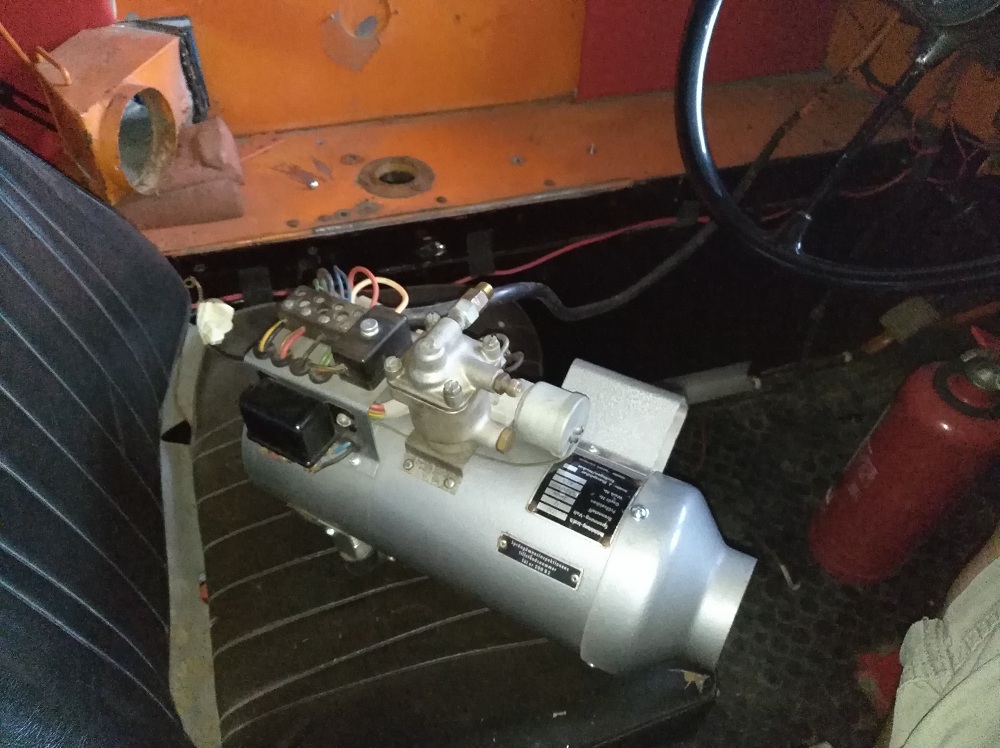

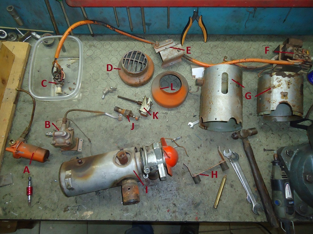

The parts of the Eberspacher Gas Heater.
A = The electric Fuel pupm Hardi E57.
B = The Fuel covernor - Fuel regulator with the fuel electro - magnetic valve.
C = Control Switch.
D = Front Envelope.
E = The cover of the overheating switch.
F = J unction box with the Fuse box.
G = Casing - Outlet Hood.
H = Base
I = The Heat exchanger, the electric motor with the air blower,
also the intake pipe the exchaust pipe.
J= Heater plug.
K = Thermo switch.
L = Rear envelope.

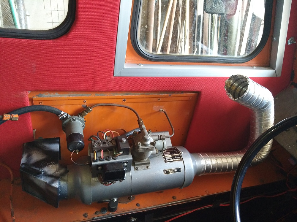

Thanks to my Friend Sakis the heater is now Fanctional. I am very Satisfied of this restoration, even it took me 1 and 1/2 years to find the right diaphragm for the fuel pump. As you can see the other parts of the Eberspacher Heater are in good condition. (The Fan , the heater plug, the electomagnetic valve, the swithes of the housing, the compustion and the precondition chumper in the casing, works fine.)
I Know this type of Heater has techology and design from late of 70s, and it has nothing to do with the new models llike Webasto 12 - 24Volt heaters, that we can find in the market.
When i bought the Snow Trac in 2010 -11 The eberspacher Gas heater was there inside the cabin. Today is still there, but it works now.
Nikos

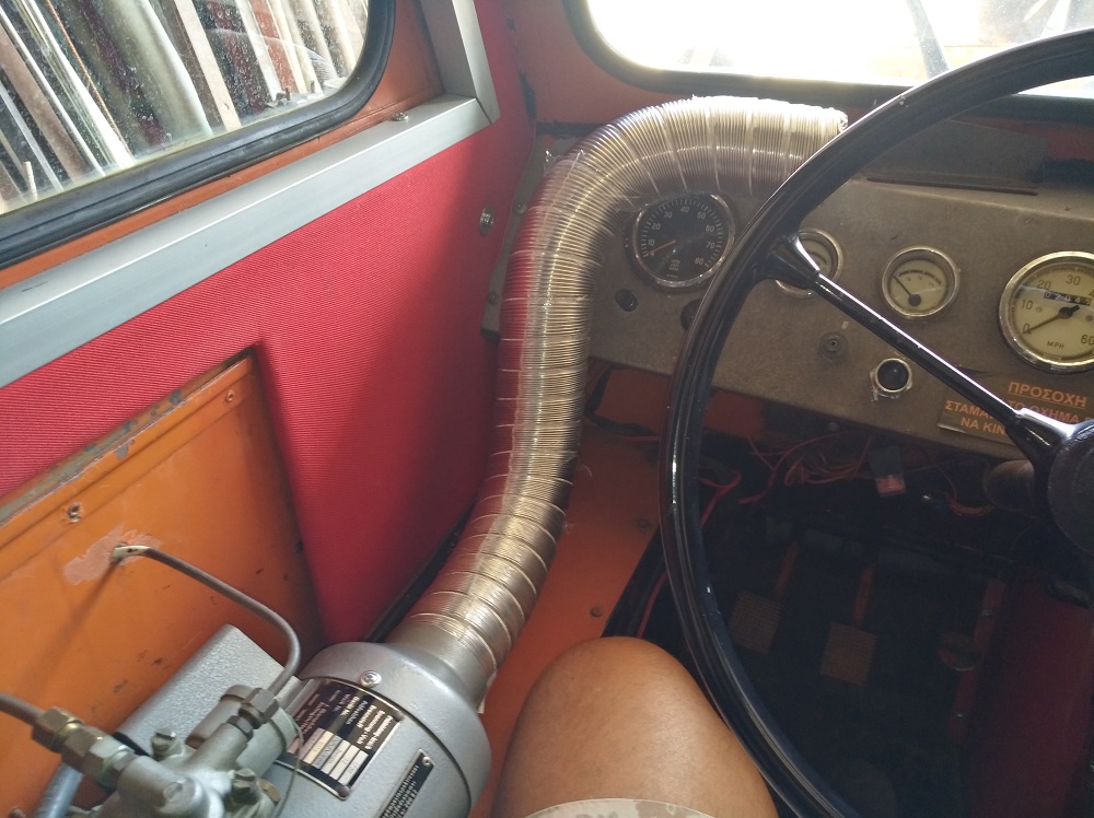

The Heater installation inside the ST4 Cabin.

.....and of course the Shield ( fom the hot fumes +-130C of the eberspacher exhaust ) under the left fender.

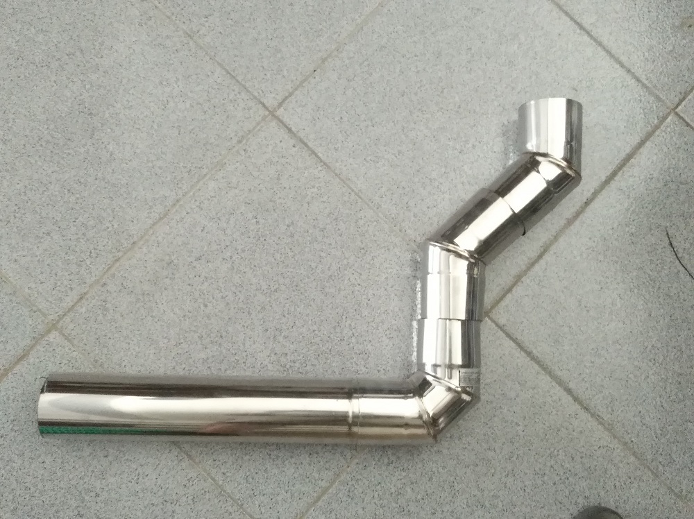

I am thinking.
Stainless Steel Flue Pipes or ...........
Nikos

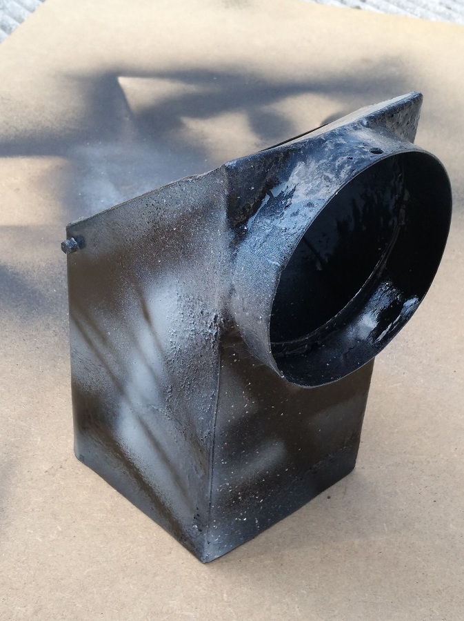

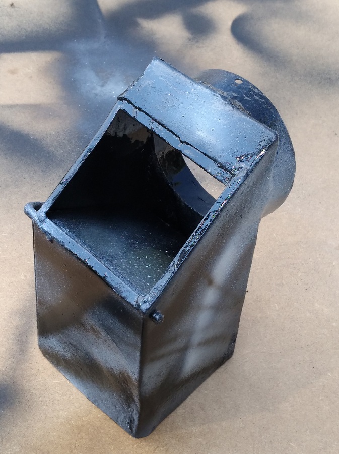

The Air Sheet Metal Duct of the Eberspacher Heater Before / After.

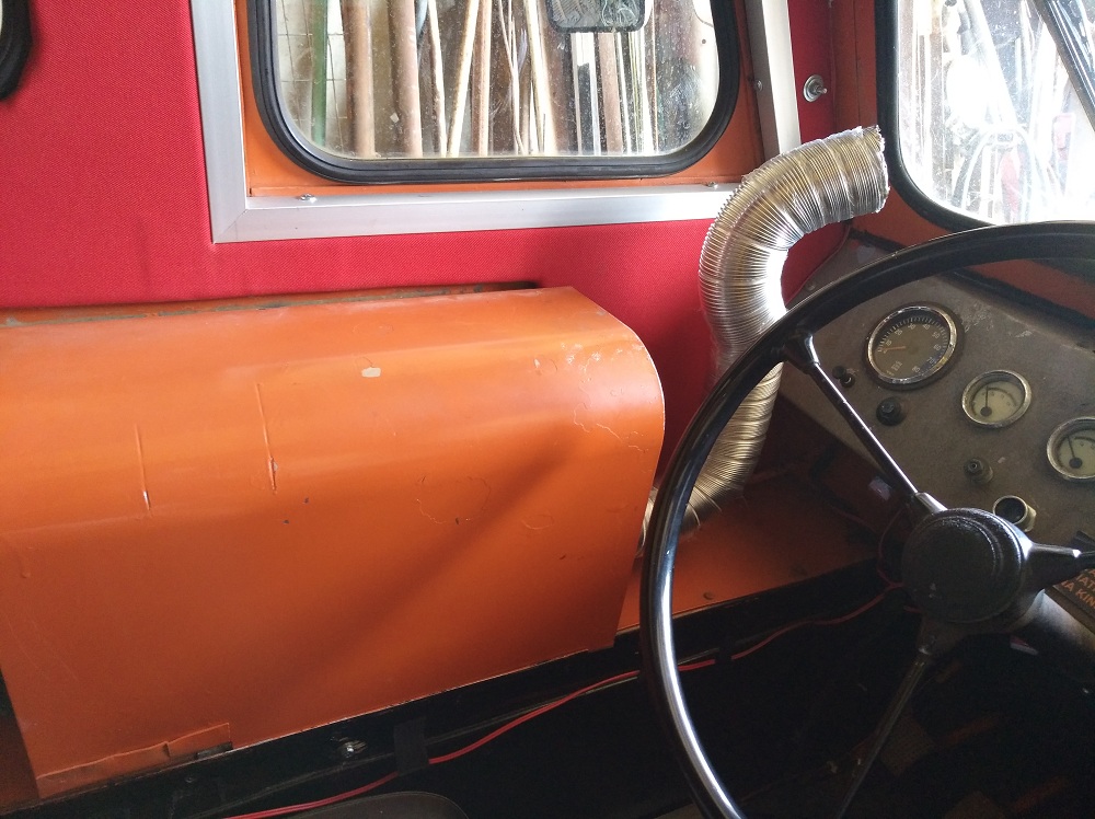

An Extra Air Outlet Pipe.
I'll cut the pipe, its too long and also i have to adjust at the end a Rotating Ball Type Air Outlet.

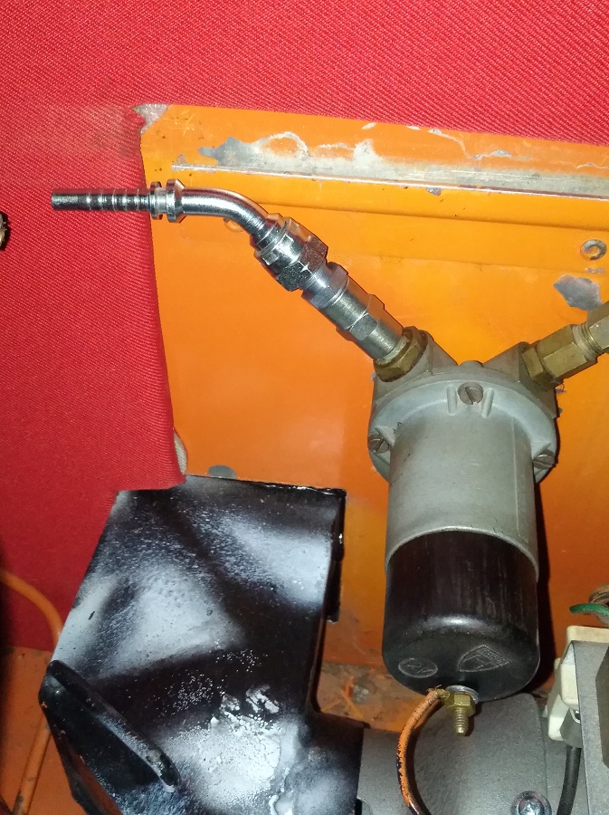

The Project (Heater Eberspacher ) is still in progress.
A) An Extra Steel Gus Tank 3 Litr
B) A new Fuel Line (including a Fuel Filter, a Fuel tank Robinet, and Some Swivel Hose End Fittings. Just in Case ).

Looks great....
I love the little heater unit....
The should be quite adequate to make the cab toasty warm
About the Heater, it works, and makes the cabin too warm.....Well at this point ....

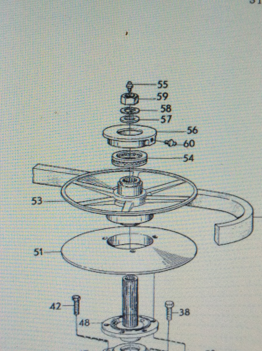

Few mounths ago as you can see above in the fotos, i checked the left ballbearing 51110 on the variator and everything was OK. Now i want to check and if is necessery to replace the right ballbearing 51110 N54 under the bearing holder N56 in the RIGHT side of the variator.
I want your opinion.
Which is the best procedure - method to do it
Just To separate the two Link arms (ST1033) N49 and to unbolt all the nuts, the bushings the split pins, and the washers......or something else
Thanks Nikos

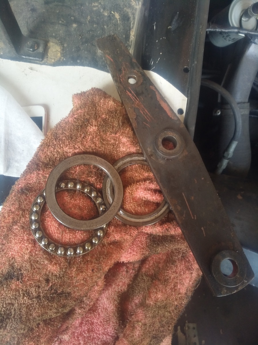

Thanks Thomas Williams, for the quick reply.

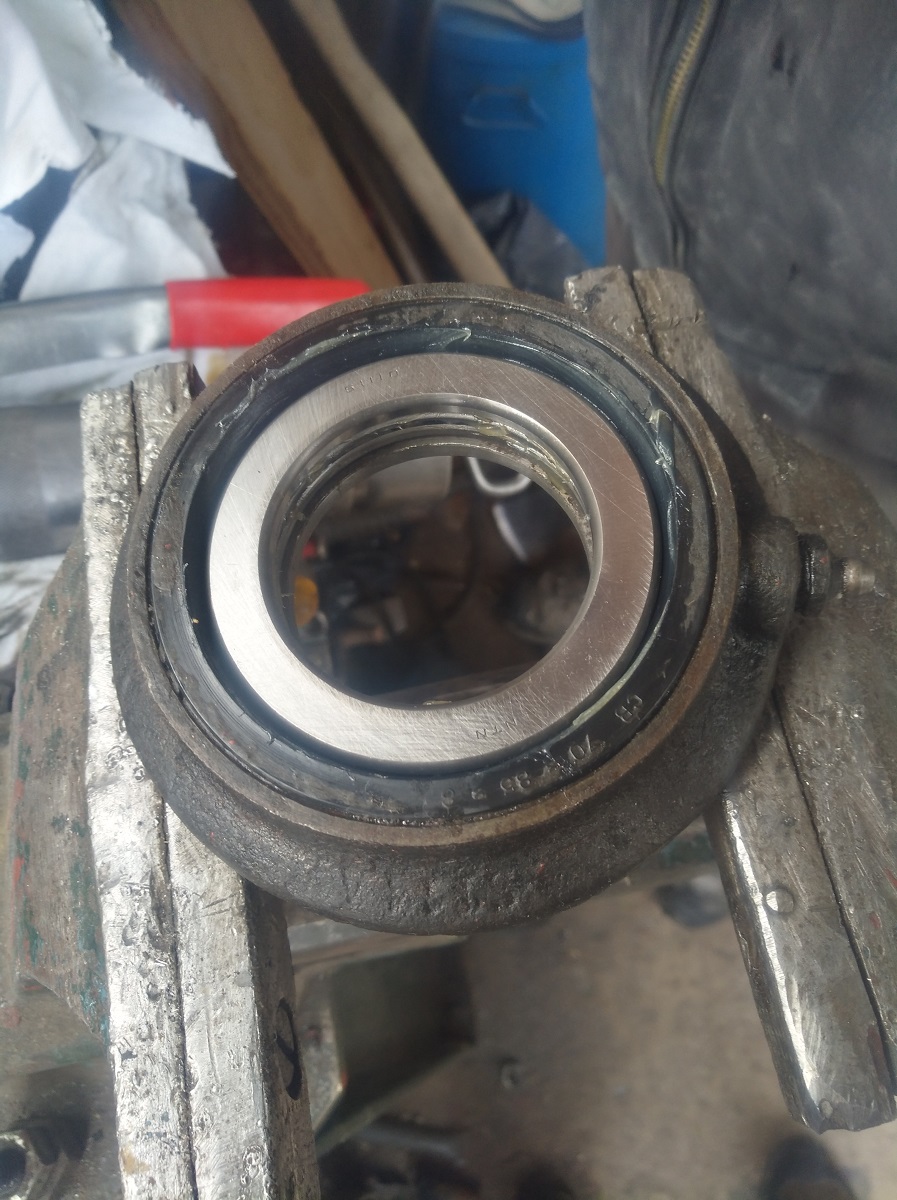

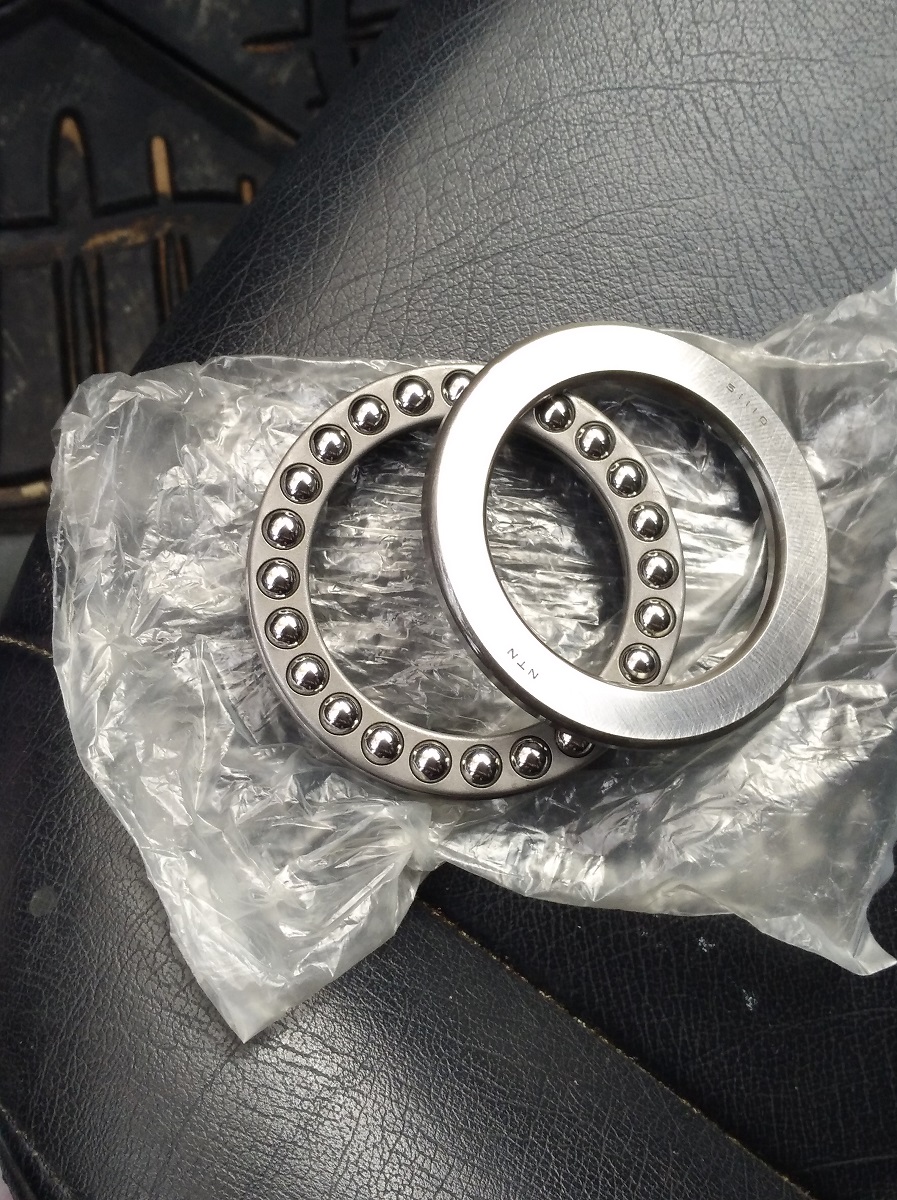

Thomas told me to remove first the pin 50 and then the others nuts, to separate the Link Arms.

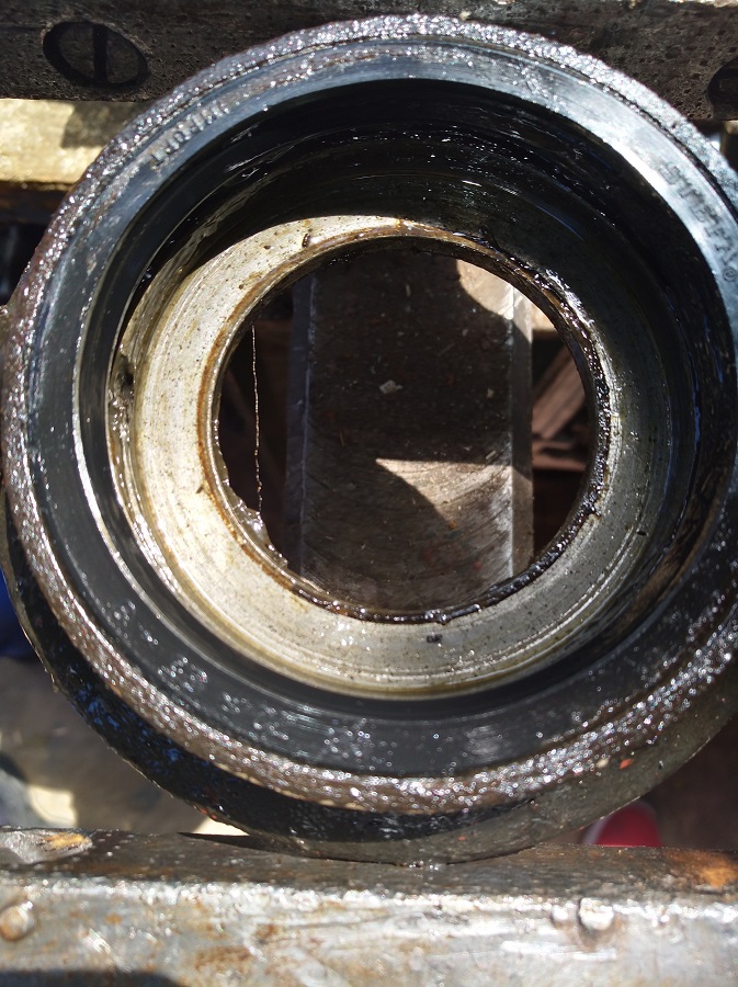

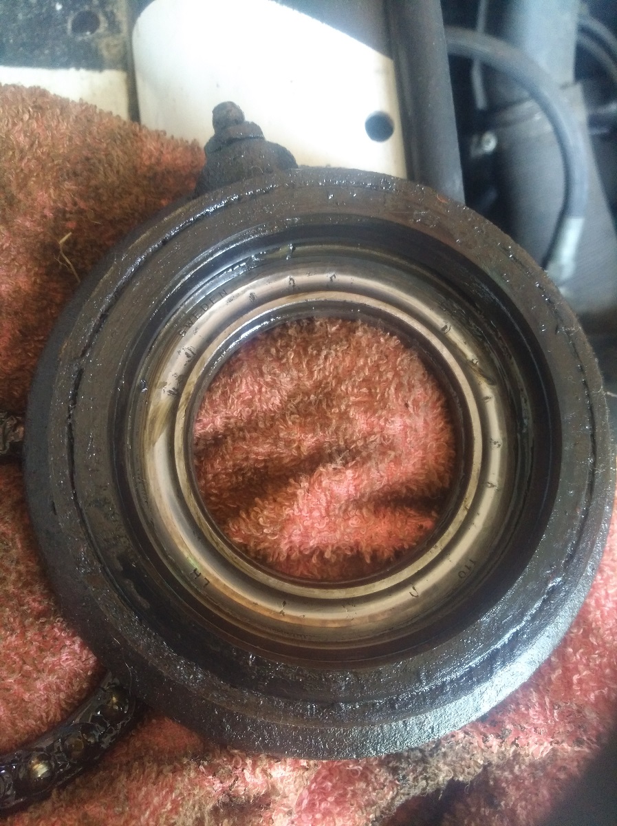

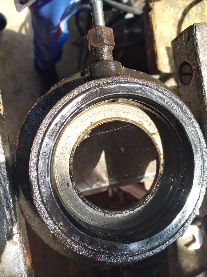

This part, (the right side of the pulleys) on the Variator it was the only part that i haven’t checked till yesterday.
I noticed that the Variator isn't working properly. I saw that the ball bearing holder, rotates along with the pulleys, and compresses the belt.
I sign of a damaged ball bearing ( 51110).

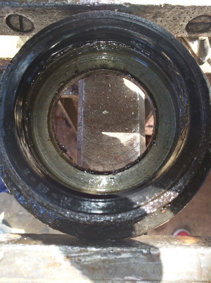

As you can see, (Foto n2) the race inside the ball bearing holder is a little bit abused from the rolling elements.
I used a propane torch to separete the rase from the upper variator pulley. (Foto n4 )

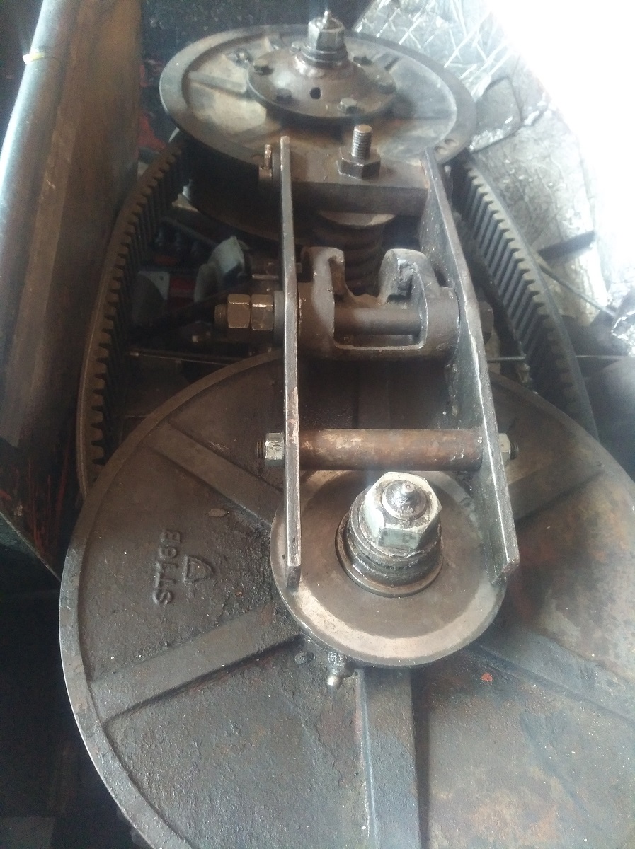

After replacing the new ball bearing, (51110) I cleaned all the parts, and installed them on the Variator as it was before.
(You can see the sign on the bearing holder from the Link Arms. - Foto n6 ).
Nikos.

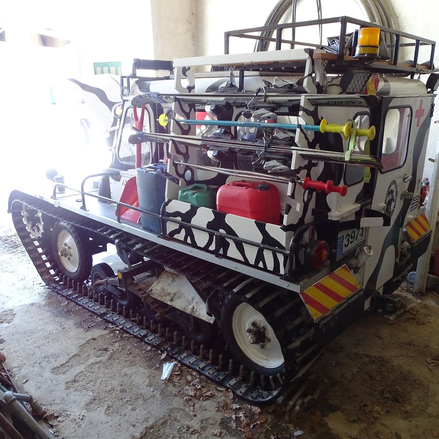

I am almost ready to hit the Slopes
The perfect Ski Rack for my Snow Trac.
The fotos are from last year.
Now i have another ski rack in the right side.
Nikos
Nice looking rack setup.
Looks like you have about everything you could want strapped onto the rack as well as Skis.
I didn't put all the nessecery equipment onto the Ski rack, like the Ski boots and some other things.
The fuels are more comfortable and safe there.
I have also the Roof Rack for use.
The Left side onto the ski rack is for the Fuels and the Right side is for The tools and the Phama Box -First Aid Kit
