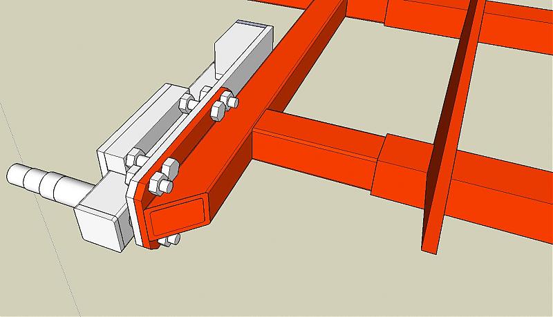

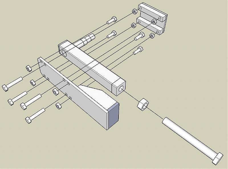

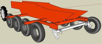

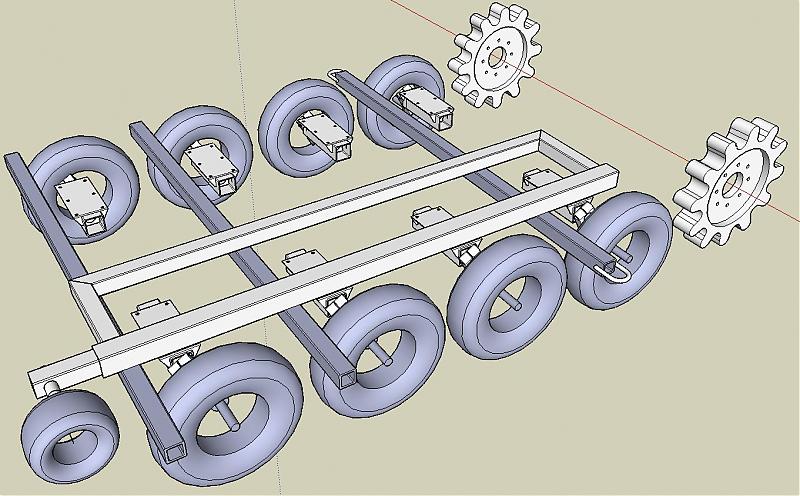

Here is a screen capture of my start on a torsion sub-frame. If I did not already have the torsion half-axles I would definitely be working on a design with full torsion axles like nutsster used.
If you can tell from this rendering, at this time I am showing a telescoping section to adjust the front idler and if I use a cylinder to pump grease in to extend like the Super Imp, it would not help in the event of a collision.

I'm working on a Bombardier SV200 and the chassis looks very much like what you've pictured. Perhaps my primary information source from the forum, "boggie", would have some advice.
Hi Snowbird, I looked at your posts on the Bombardier SV200 project, and your torsion half-axles are very similar. I see nothing lifts like a deer!

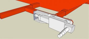

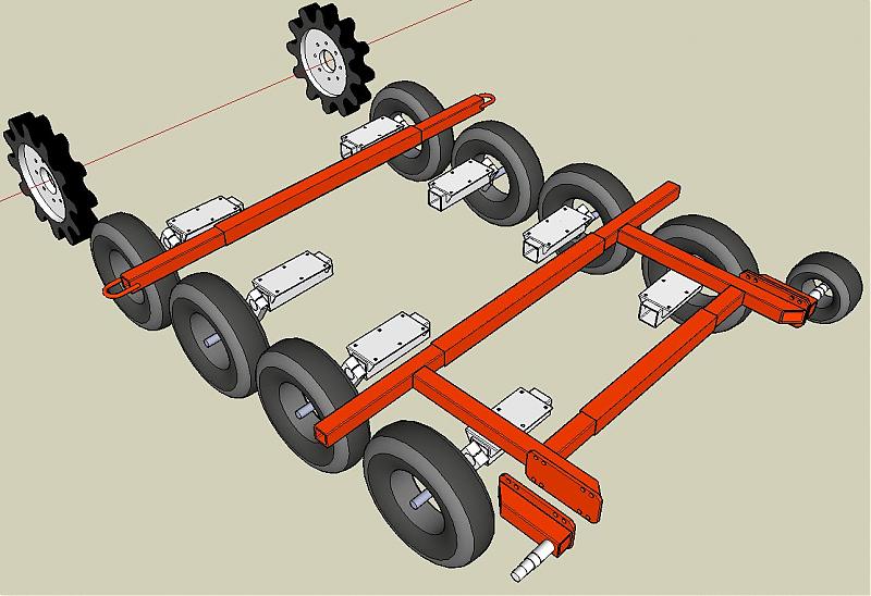

Here is one idea for a bolt-on Imp adjustable idler mount.
The mount pictured provides about 6" of adjustment, but there appears to be plenty of room for more.
Any comments would be appreciated.
If anyone is interested, I would be glad to provide dimensions and/or the SketchUp file.

Nice Job! I was just looking at the front axle on mine last night. I think your right on with the concept., use as much existing structure as possible. Going with a completely new front axle does present allot of issues in itself, that may or may not be worth the work and cost involved. If you can send me a PM with your sketch file, I have downloaded the program but have no clue how to use it yet.
I like your drawings and design. Your design is very similar to my track adjustment set up. My 1402 didn't have any forward idler adjustment, so I made a plate like your drawing only on a horizontal plane not veritical. You will run into problems with the larger wheels if you don't chop off the leaf spring axles.
I know that your trying to be able to go back to the orginal configuration if it fails to work. Just carefully plan it all out and make it happen. Like I said earlier, I would consider removing the forward idler and move the front torsion axle forward and make it adjustable. However, that's your choice and would make it a little more complicated if your trying to use the orginal tracks.
Another important thing if you go to the taller tires is that your going to need to raise the whole chassis. This will give you a few more inches of ground clearance too. The problem will be the need to lower the differential a few inches to match it up with the torsion axles. That is why I think it would be great to just move the differential back a foot and a half and go to the smaller sprockets. That would eliminate the need to lower the differential. I will need to check this weekend which tire size I used when I go up to the cabin. They do fit nicely in the guides of the grousers.
I gathered up all the componets and actually used them in place to check for clearances and geometry. Your drawings can help you a lot in this area too.
My 1402 was modified so much before I got it that I had no choice but to do what I did to it. It wasn't working real well the way it was butchered.
The rear differential was already lowered somewhat, but not well done. I had to drop the rear of it and angle it down ward to get it where I needed it. I'll try to get some pics of it for you to see.
I am very happy with it and the way it runs now. It is nothing like an Imp in ride or performance now. It's MUCH better! :thumb:

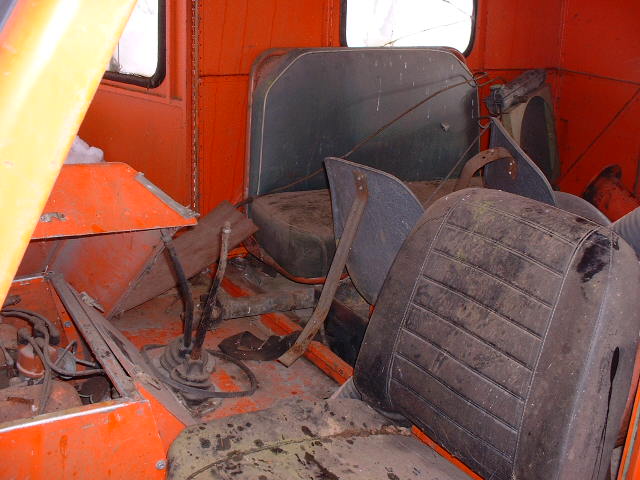

The shifters on this imp are nearly in line, laterlaly. Mine are in line fore and aft. What is the difference? Thanks.
The Super Imp Wide Track loaded down with 1,500 lbs of gear and two adults pluse 60 gallons of fuel performed beuatfully in the field for me. The floatation was great (Over 500 miles of unbrocken trails and deep powder in the last 5 weeks!)! If I was going to use it again I would go with the same setup but with an enclosed rear cabin to keep our gear out of the weather, but I think its still a bit small for me and all our gear. Now that the rims are getting a bit difficult to find (suspect BOGGIE will start stocking the parts after he gets them made) I would also go to a torsion axle setup just to have a common rim available. BUT as I said that may not be an issue much longer. The Super Imp would indeed be a force to reckon with if someone put some wider tracks on. BUT really I dont think there is much need if you keep the weight down to what I would normally carry into a cabin. I think right now the Super Imp Wide Track is probably the best cabin access cat one can get right now. As far as an IMP I believe the Torsion axle set-up makes good sense. I found and old Imp with no tracks (see pictures) that I think will be a great contender for the torsion set-up. I also found a brand new never used military Ford V4 Wisconson engine still in the crate and also the one in the Imp was rebuilt. I may sell the engines if anyone is interested. Anyway I would like to do a torsion setup on this little Imp along with maybe an engine swap?

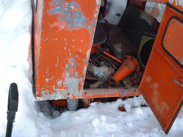

Looks like quite a project, sad to see the Imp got to than level of neglect. You got your work cut out! Good luck!

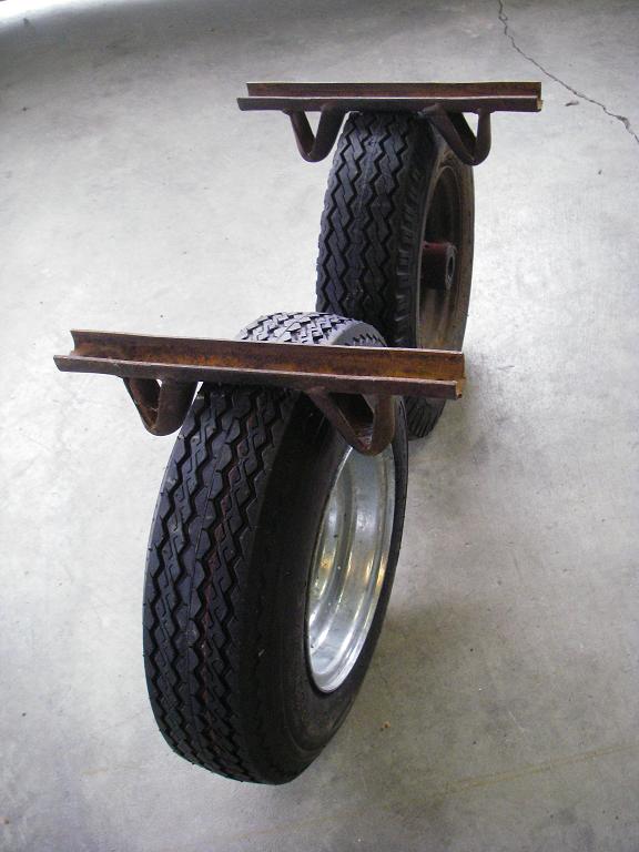

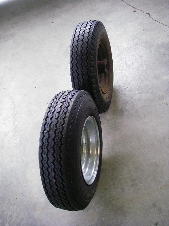

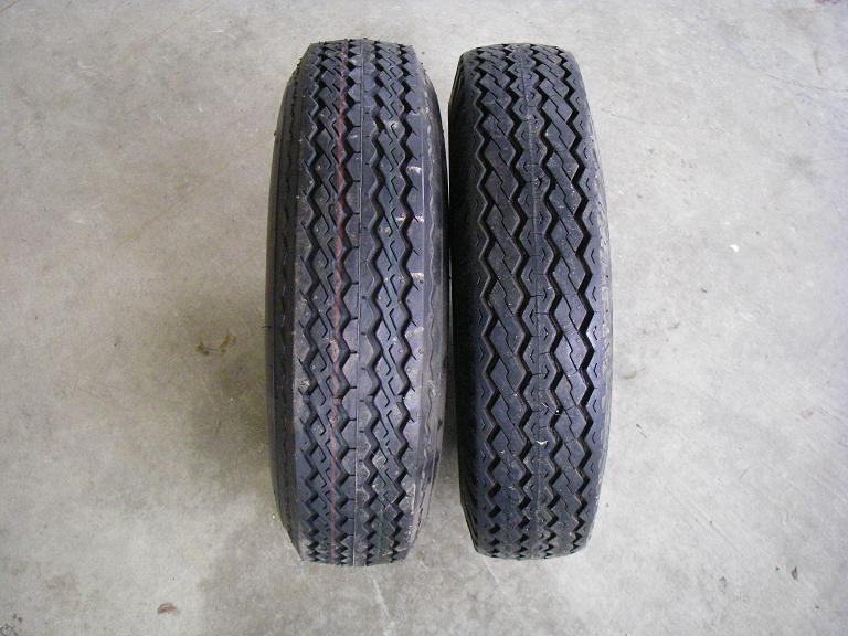

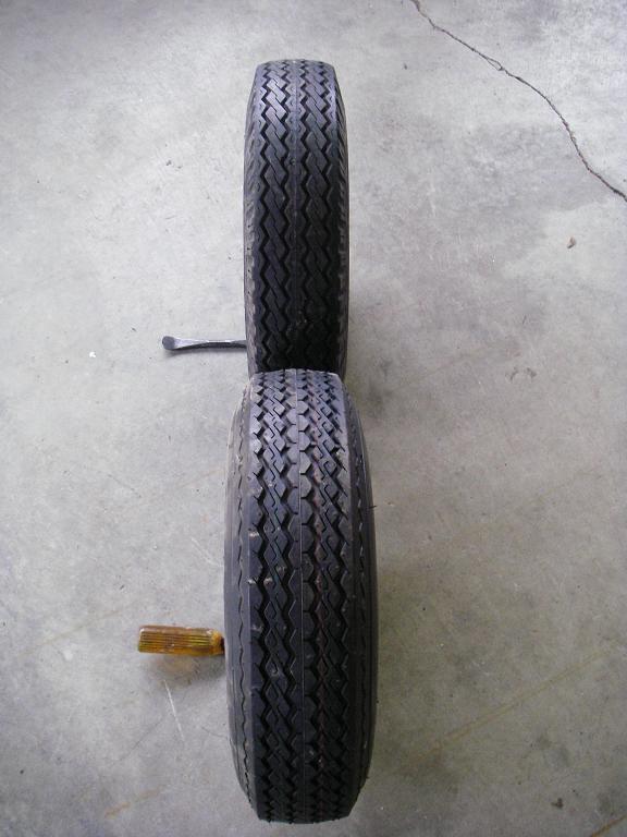

The 4.80 x 8" and 4.80 x 12" wheels I have found for trailers are 3.75" wide bead-to-bead.
The integral hub 8" wheels on my Imp and Super Imp are 2.5" wide bead-to-bead.
The same 4.80 x 8" load range C tire on a trailer tire (3.75" wide) inflates to 5" wide and will touch the springs on both sides unless they are moved apart.
You may be able to tell from these pictures that the tire guides are also very close to the rim with the wider wheels which makes them much more vulnerable when travelling on side hills or when the tracks are not flat on the ground.
Has anyone had experience using the standard 3.75" wide trailer wheels with the standard Imp or Super Imp tire guides?

Yes I do. I just installed one. What I have found is that you cannot use a regular inner tube. The sides of the inner tube get what looks like a snake bite. The "bite" is what happens when the track guide rolls into the side of the tire on any type of side hill use or when your moving at a good bit of speed and the tire compresses. This will result in a flat tire. On the fatter tires they really need to be foam filled to avoid flats.
