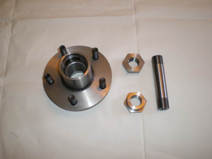

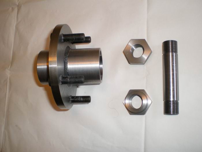

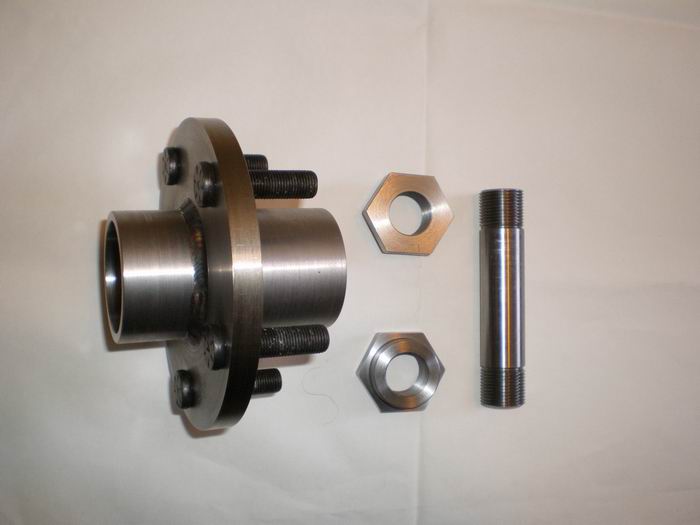

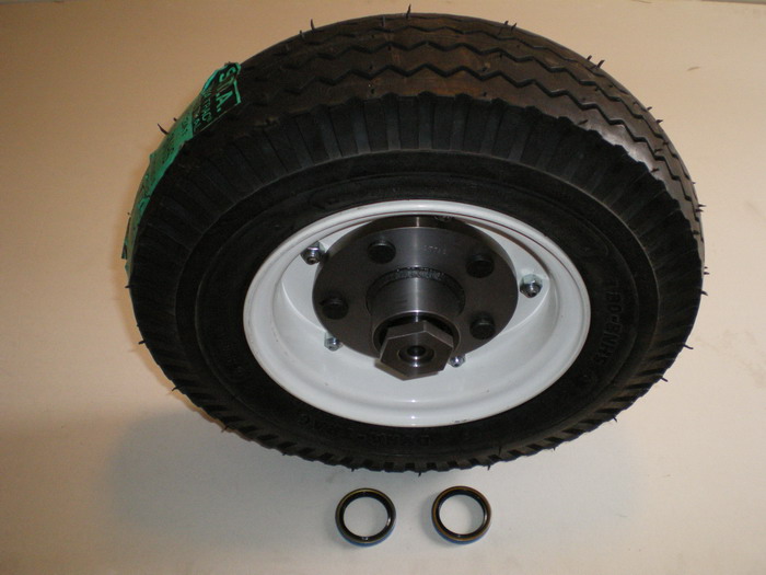

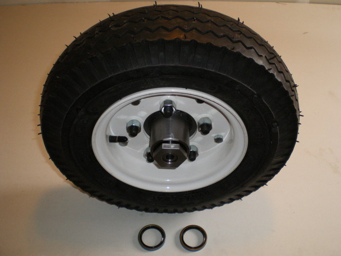

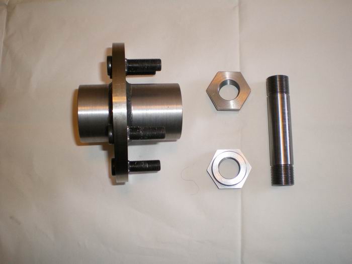

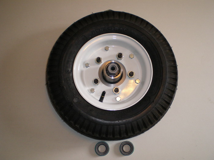

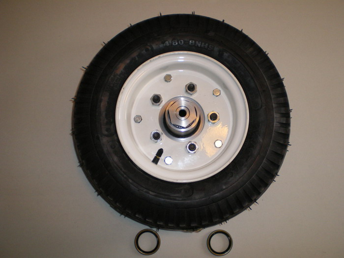

We've been working on the Imp bogie wheel problem and we have this to offer so far.
The first three pics are of a 1 inch Spryte Improvement hub, spindle and nuts. On it is mounted a Trelleborg 2.5 x 8 two piece wheel and an Alpine Guide 400/480 x 8 six ply tire and tube.
The last three pics are of a 3/4 inch Spryte Improvement hub with a used OEM spindle and nuts. On it is mounted a Sendel 2.5 x 8 two piece wheel and an Alpine Guide 400/480 x 8 six ply tire and tube.
The wheels are centered between the spindle nut with a spacing of 5-5.065 inches to match the leaf spring spacing and the OEM wheels.
The maximum width of the tire and wheel combo is 4.2 inches at the tire sidewalls which should clear the leaf springs by 3/8 inches or more.
We've made two proto's of each size, and are going into production and will have some pics on our webpage of the finished products with the bare steel painted and the seals installed. We are still working out some of the details concerning the choice of 1 inch or 3/4 inch spindle/hub but for now we will be making both available. The assemblies are interchangable with each other and the OEM wheel assembly, and either wheel will fit on either hub.
We welcome your comments, its all about improving! We have pics of all the parts laid out if it might help. If we've missed something please give a shout.
