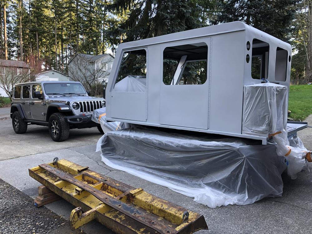

Much less filler being used than original. On the roof, I used Tiger fiberglass filler, really strong stuff. The scaffold is very handy for high work, much more stable than ladders for welding, grinding and sanding.

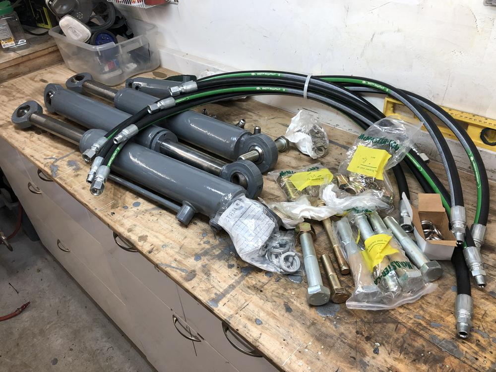

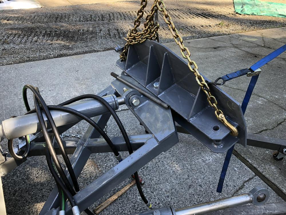

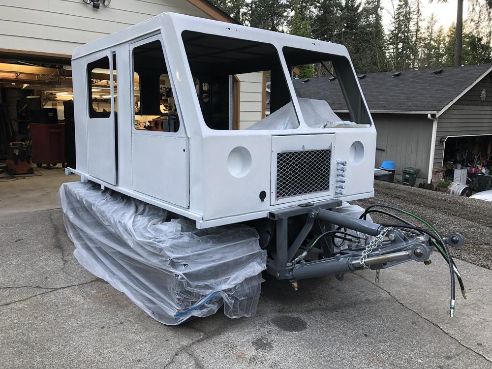

Finally a sunny day, so I spent the morning installing the blade frame and actuators. Ran them in and out to bleed the air out, working good, no leaks. Later I got a couple coats of white epoxy primer on before the sun went away.

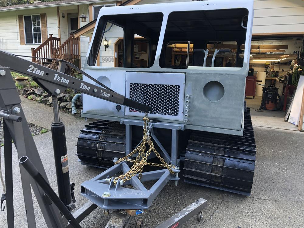

Plow frame looks fabulous! Would it be too much trouble to get the dimensions of it from you as I have to build the same thing for mine? Thanks and keep up the great work!
For the frame that attaches to the cat axles, probably best to bolt the various pieces to your cats frame and tack it up. Do you have the plow blade and carriage? If not, you’re in for quite a bit of fabrication. You’ll need the actuators as well. Maybe Boggie at MTN Outdoors can provide some parts?

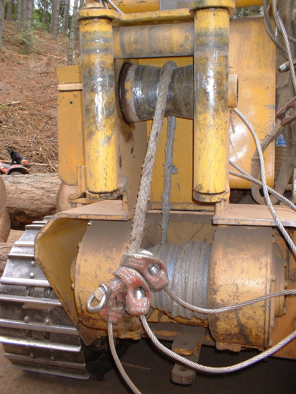

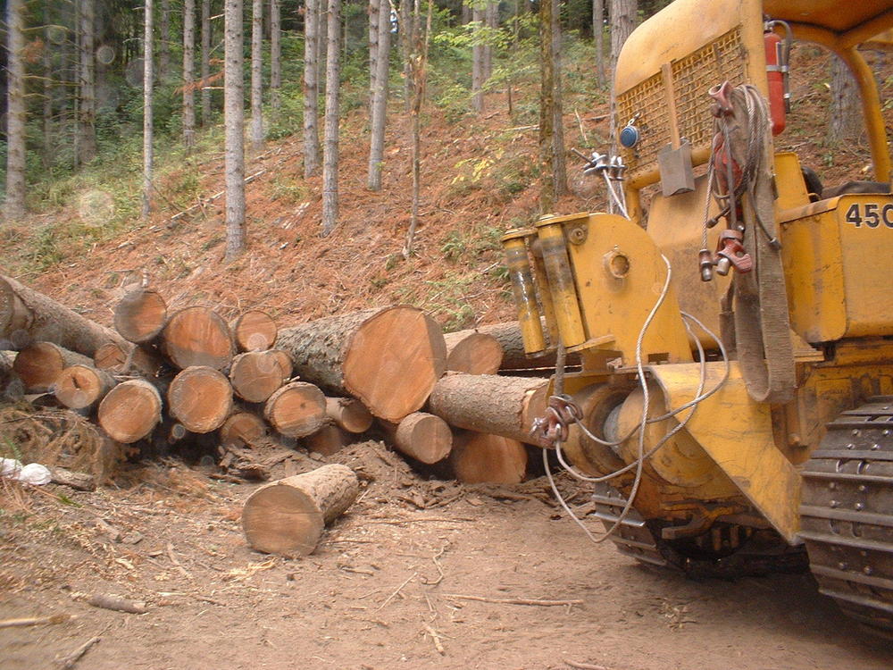

This is the first winch I've owned with a kevlar rope. (Spectra maybe?) I'll never go back to wire rope.
I have used Bluesteal synthetic for logging for 15 or twenty years. The 5/8 rope is about the same strength as regular wire rope. 100 feet weighs 10 #, no jaggers, and the best part is it doesn't bind when sucked down in the spool of wire. Easy to pull out by hand as opposed to tying off to a tree and driving off. The down side is it is easily abraded pulling over sharp stuff. I had to add another fairlead roller to the top of the arch. Note that the paint is still on the rollers. Also easy to splice, it is braded like Chinese finger cuffs. See the eye splice next to the bells.

That’s impressive that you can use it logging, that is about the toughest environment there is...I think you just made me a believer!

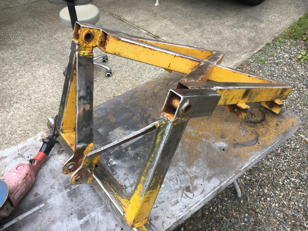

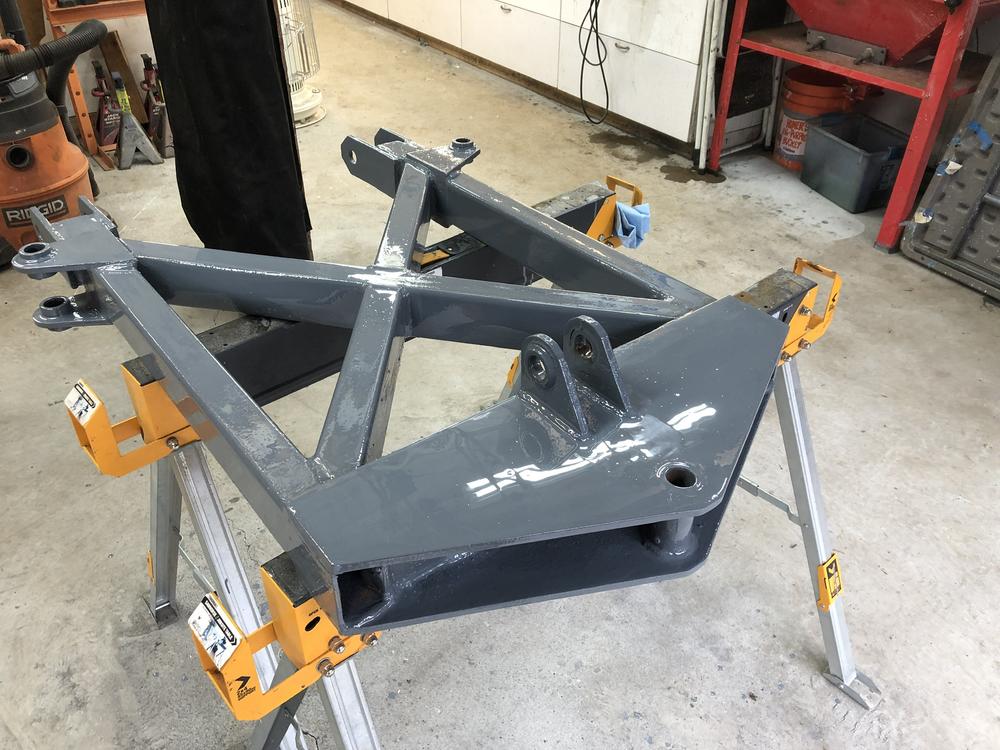

Rained Saturday so started in on the blade and its carrier. Sanding, grinding wire wheeling, phosphoric acid and three coats of gray POR, today was sunny, so I hung the carrier on the blad frame and put two quarts of polyester build primer on the cab. Next, lots of sanding ?

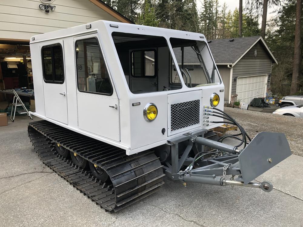

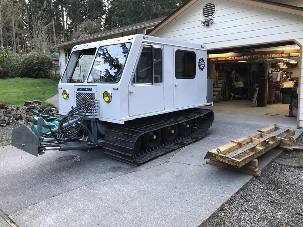

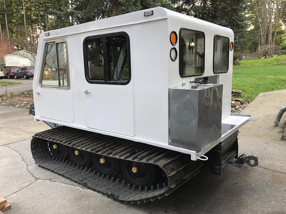

Got white paint on the cat finally, but not the final scheme as I have some large vinyl stripes I’ll be installing. Got lights, LED strobes and windows installed, need another 25 feet of windshield gasket to finish installing the windshield. Getting closer :smile:

Got one windshield in, and cracked it ☹️, two new ones on order now. Meantime, I finished wiring lights, new pentagrams wipers and put some logo decals on.

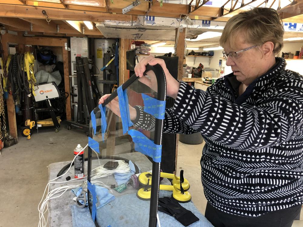

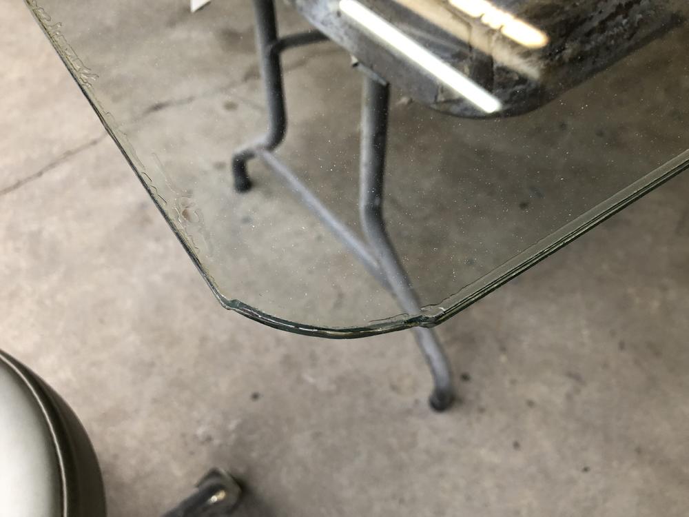

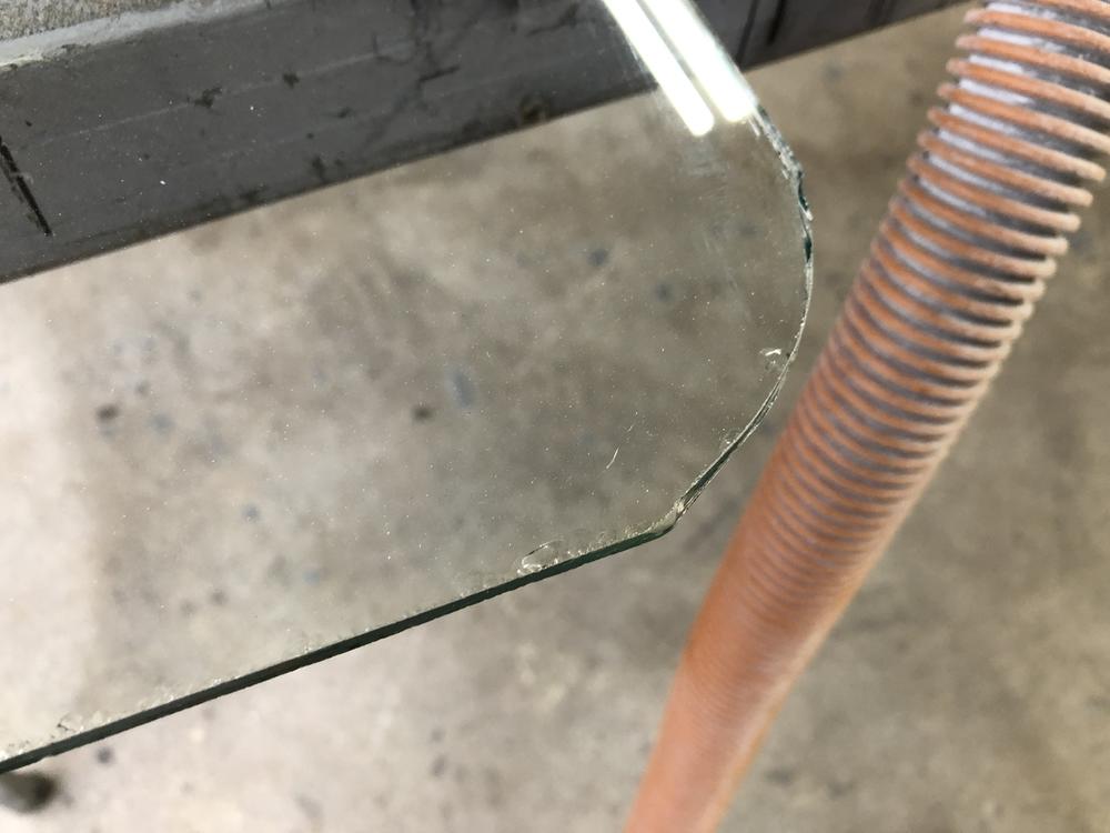

Glass coming from a local glass shop, it’s laminated so he’s ordered it 8n and making new pieces because the old ones were marginal. It appears the original glass was cut with an axe. Likely contributed to the crack, as well as delamination on the edges. Two new windshields, cut to size $219.
Seal from Amazon, 25’ long does both windshields easily. 25 more feet does all the rest of the windows. https://smile.amazon.com/gp/product/B00NL48P54/ref=ppx_yo_dt_b_asin_title_o04_s00?ie=UTF8&psc=1
The old rope trick works perfectly on this seal. Renee helps with the prep and installation, it’s a two person job.
