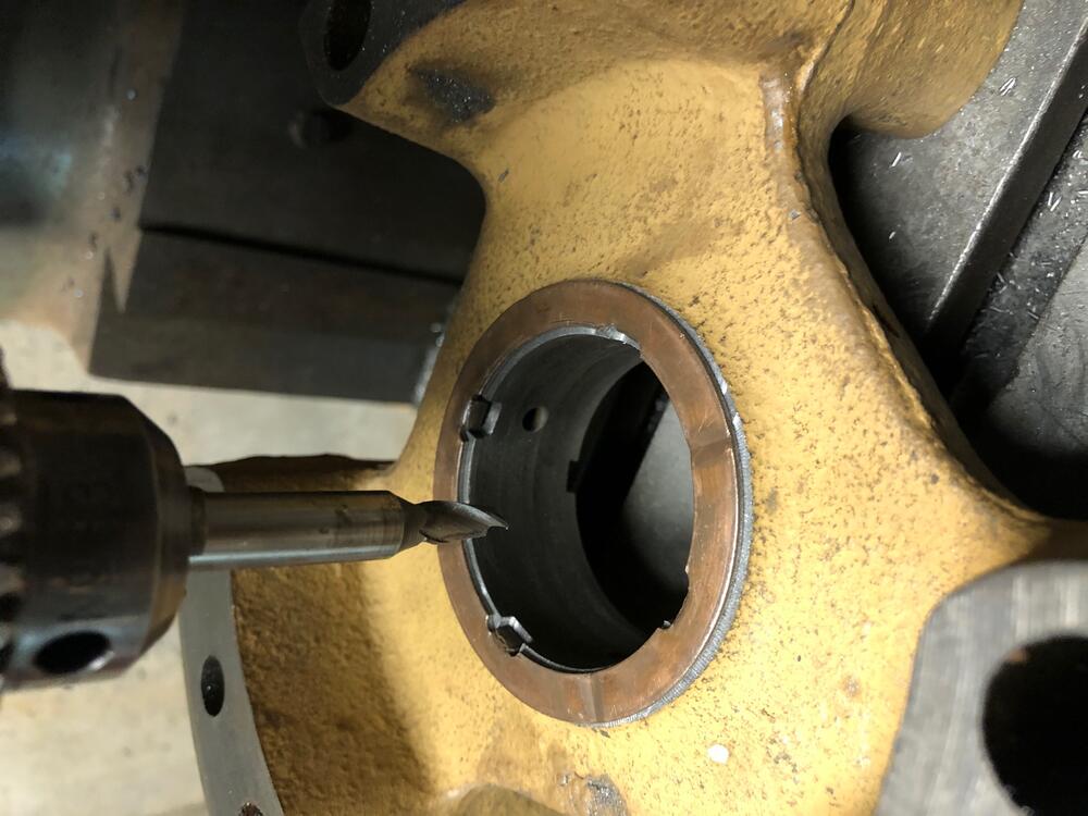

Today was used to attack the center compensator casting....specifically the thrust washers in the center of the unit where the axle stub gears are located...
I did some snooping and then frequented the local tranny shop.....
Picked up a pair of washers from a FORD....84GT7D428AA thrust washers
"Front drum to direct drum thrust washer" These are a 4 tang thrust washer that fits the inner gears sweeeeeeet....
I put the stack together and measured the clearance with feeler gauges.
The assembly is worn a bit off from side to side.....so the amount of metal to be cut off the center casting was not the same on both sides.
I WANTED .010" CLEARANCE....BUT WE ARE CLOSE
Milled the one side .022" and the other .037" to get things happy
Set things up to cut 4 little notches for the thrust bearing tangs to fit.
Got this all done....feeling real smug....then it happened.
Stacked everything together and dropped the thin washer between the inner gears and things are off by 1/4" or so.
OMG.....WTF

Looking good....I want to bolt the cases all together with 3 bolts to be sure the inner clearances are where I want them....
The little Ford washers really spiff up that area...
Plenty of bearing area, and these washers are meant to be rubbed on....
No mods needed to be done on these washers....right out of the box...good to go.
They are .062" thick....
Pics of the machining of the hub area as well as the tang notches.....
Almost looks factory...:thumbup:
I wonder why the factory used such crappy washers.

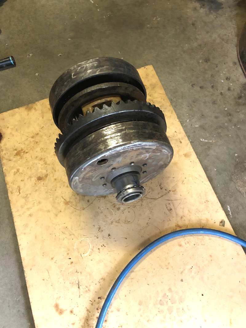

OC-12 question
Are the ring and pinion a matched set? I have a center section from what I think is an OC-12 but no case/pinion and has one drum with a big chunk missing. :hammer:
My gears were what came out of the machine and had been in use.
The pix really show the ugly that water can do if left for a while.
I suspect this thing has sat with water in it for several years.
I had to put a wrench on the pinion nut and a 5 foot bar to get it to break loose when it first came home.
Yes..R&P are made as sets and need to be run as such.
Sitting here thinking about all the broken stuff I found when tearing into this thing.
First the RH axle bearing was broken up.
Then heading on in, the upper bearing in the drop box on the outside had the cage broken....all the balls were still in the bearing.
The ring gear had a couple teeth with some small nicks....nothing bad...buttttttttttttt???
The Compensator gears appear typical of a well used unit, but the teeth are fine....no undo wear on the teeth.
The case was marked with witness marks before I got in there.
The comp case halves show the inner pinion gear wear into the case.

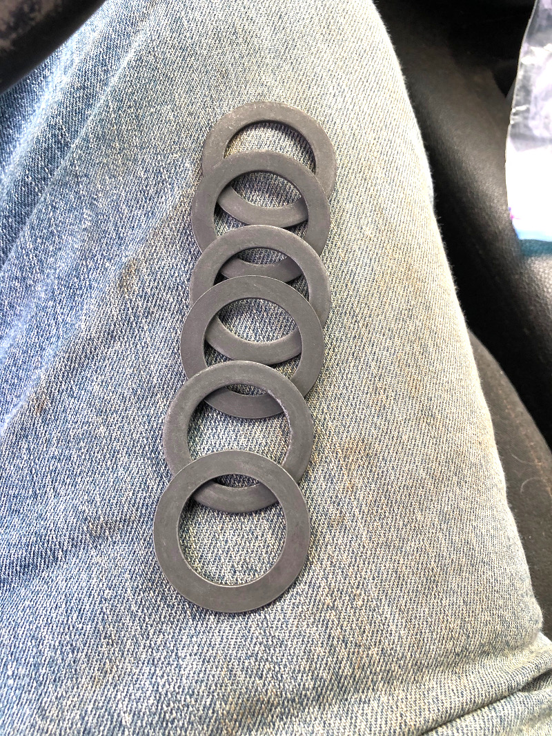

The outer compensator pinion gears fit the shaft well and the key had not chewed the washers....
Washers were rusty and generally SHOT
Took some snooping online...but found some nice heat treated washers...

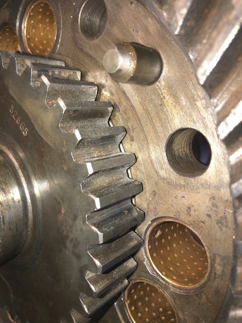

One scary thing through....one of the dowel pins that pilot the left had side of the compensator case had worked inward and was lodged in the little hollow in the center case..... I wiggled it with my fingers and it fell out..
Had that bad boy fell out we would likely not be having this discussion....
It was obvious that previous folks who had been in there had try to STAKE the dowel pin holes.....but cast iron does not peen well and crumbles more than anything.
On the case side next to the ring gear the dowels are TIGHT...
I'm going to leave them alone...
The side opposite ..Not so much....all slip in and out easily.
I am going to drill the bosses and the pins and locktite a 1/4" Allen screw in those....
Sort of like what ya see in a 10 bolt GM spider gear shaft retainer bolt.
Very easy to drill and tap the holes to keep the pins in place.
Will also make it easier to get the pins out later if need be.
Sort of a MISSION CRITICAL ITEM....If a pins gets loose GAME OVER

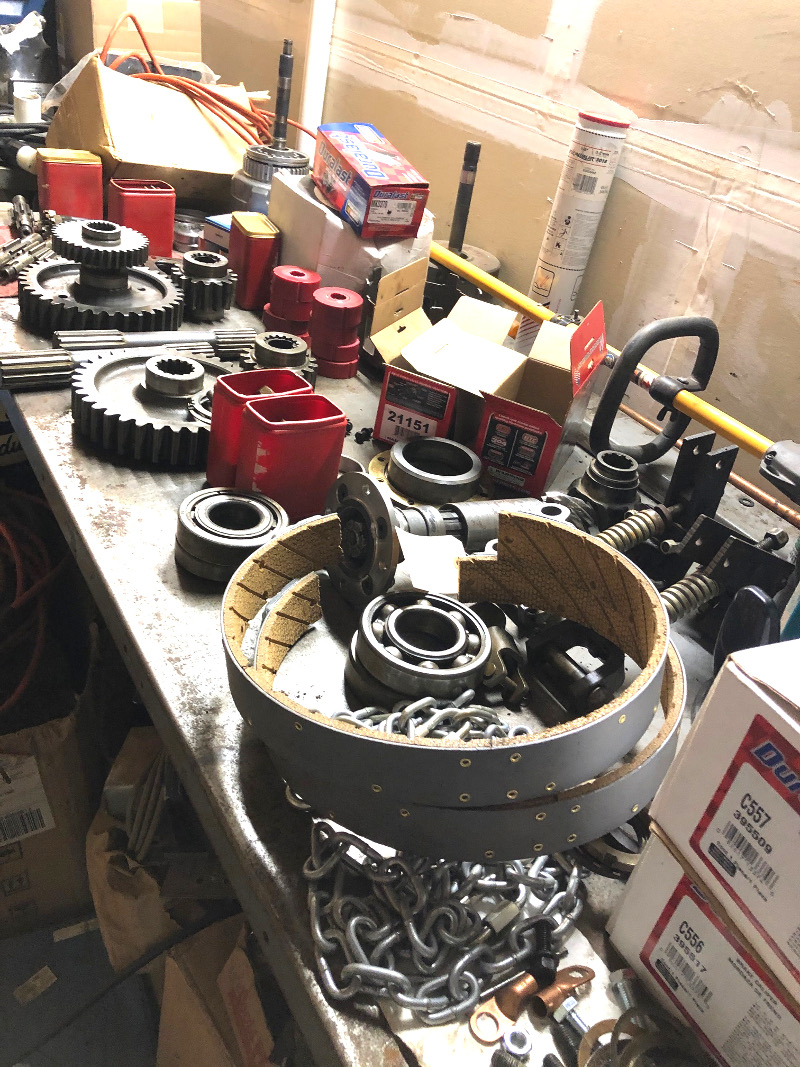

Cleaned up the bands outta the OC12 this morning.
Drilled out the rivets and ripped the old lining off...Yuck.
Got them done and ready to get new lining....
My neighbor stopped by to chat and asked if I had ever used "Grandpa's Tractor shop"
Old fella a couple miles away from us.
We tooled on over and had a chat with the old guy....
He knew exactly what the bands were from.
So we left them with him and he called up a couple hours later and said the bands were ready.
Sweeeeeeeet.

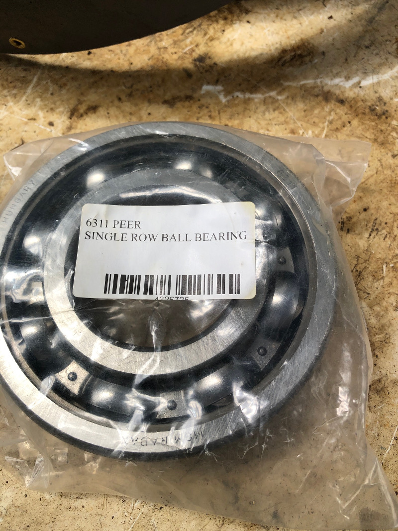

Bearings are starting to show up.
One of the carrier bearings showed up today....
The other one should be here soon.
I am pleased at how fast this diffy is coming along..
May be able to start stuffing the thing back together fairly soon.
I want to go through and smooth up the teeth on the inner pinions as well as the inner axle stub gears.
Crazy that these were left so sharp.
Once the final deburing is done I think this bad boy can go back togrther.
We shall see.....

Still need the 2 axle bearings and the 8 bearings for the drop boxes...

Stopped off and saw "Grandpa" at the tractor shop and picked up the bands.
Fantastic job.... Best part...almost a neighbor....
The second carrier bearing showed up today....
Coming together.......

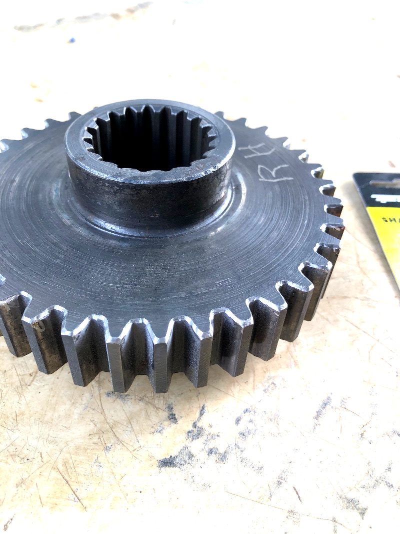

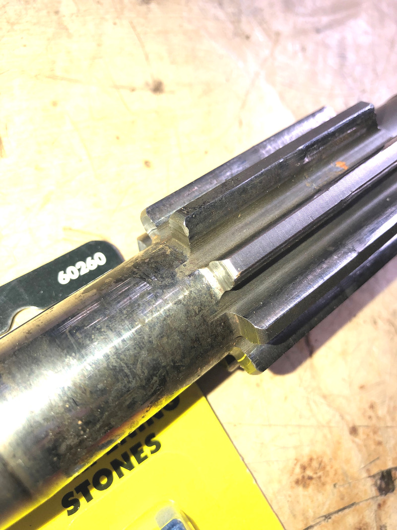

Got some time on the tractor mowing....more fun to work on the cat project....
Time to get after some tedious hand work.
The stuff that just sucks.
DEBURING THE SHARP GEAR TEETH.
A little die grinder is the ticket.
Some long stones designed for sharpening chainsaw chain work sweet.
Use the tip of the stone and when it breaks off...MOVE IN and go again.
One stone...one gear....
Really does a nice job of cleaning off the super sharp edges.
These teeth actually resemble a milling cutter and are hard...very hard.
The case is soft cast steel (Soft by comparison)
Tomorrow we get after the skinny pinion teeth.....the end closest to the threaded end...
Same treatment as on the big inner gear.....
Nice and smooth.....:clap:

Went after the skinny pinions and got them all ready.

I currently have the following either here or coming
(2) 6311 carrier brgs (Here
(1) 1310 large pinion brg (Here)
(1) 6309 small pinion brg (In transit)
(8) 6014 drop box brgs (8 required 1 in transit) (Ordered one to look at the quality....over seas made.....I want "Touchy feely" befor I spring for all 8
(2) 5210 axle bearings (Will order these once the diffy is back in the cat..still need to finish machine the retainer rings)
Bands done and on the bench.
Compensator case all cleaned up, thrust washer issues dealt with, gears debured and parts final washed.....
Main case and drop boxes need to be finish washed.....Today likely.
Urethane diffy mounts need to be completed to be as close to original as possible (A guess as the stuff that came out had been thrashed)
All in all....I am pleased with the progress.....

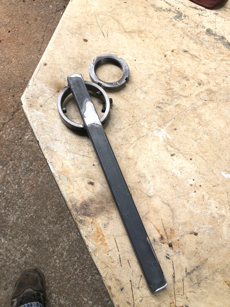

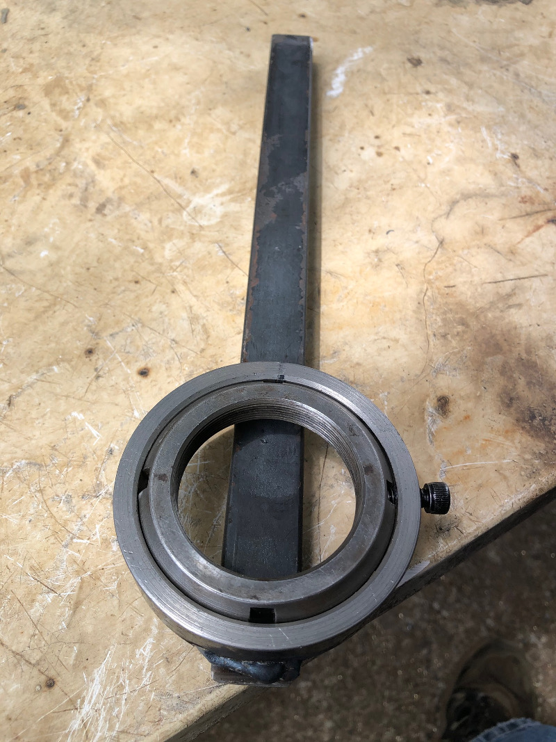

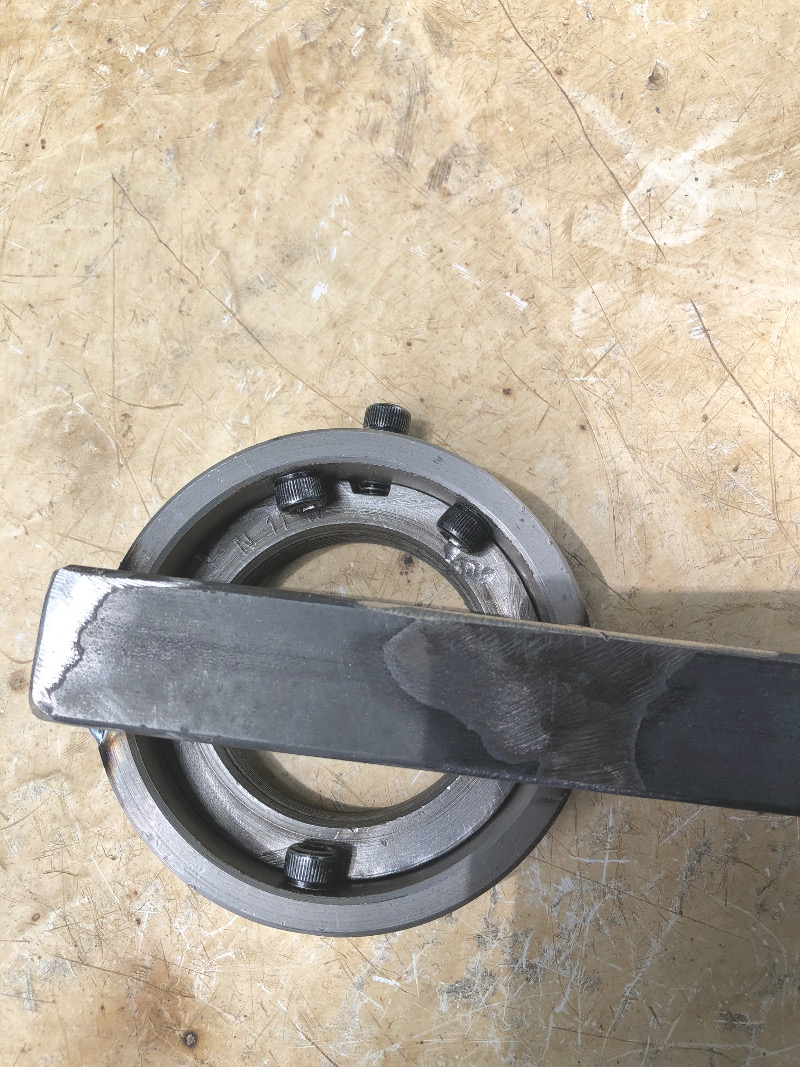

Yesterday I went looking for a wrench/socket for the N11 nuts that hold the carrier bearings on.
About all I got was the deer in the headlight looks... and whaaaaaaaaaaaaat ?????
Nobody had a clue.....
Found a kit with a bunch of the sockets $$$$$$$$$$$$$$$$$$$$$$$$$$$$
So....Made one today.
Piece of 3" Schedule 80 pipe and a chunk of bar stock....
Drilled and tapped some 1/4" holes...added 3 Allen heads to keep the tool straight....Welded on a heavy bar.....
Should do fine...Far better than a chisel and a hammer....
Thanks for the Isuzu Idea....
I will keep my ears open .
Maybe a GMC CAB FORWARD...

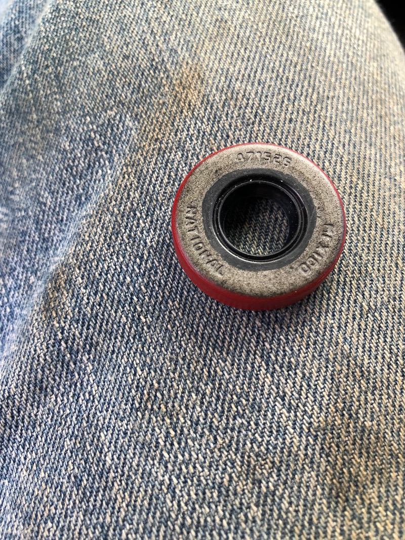

The outer pinion washers for the OC12 showed up and the steering band shaft seals.
With the washers here I can start getting the compensator case back together.
All the rest of the parts are cleaned up and ready to go.....

The original steering shaft seals were very thick with another steel piece in them to act as a rod guide,at the last of our running sprytes with the oc12 differential we double stacked the seals. The hole in the differential is deep enough to do it.
I have no idea the cost of a body but GMC and Chevy had some neat looking snub nosed COE trucks in the 30’s and 40’s Would be a unique look.
Loggah...
Mine was a mess (Entire thing was trashed by the previous crew)
The seals were mashed to hell....likely by an idiot with a hammer.
I can spin up some aluminum guides to fit behind the seal and help keep the seals alive??????

Today the diffy compensator went back together.....(HEAVY!@#$%)
I do not have an easy way to lift that beast up on the bench....so put down a piece of heavy particle board on the concrete floor.
Worked down there where it's safe...:thumbup:
That sucker went together quite well.
Greased up the new thrust washers I added to the setup....got them all in.
Timed the skinny pinions and got them in.
Just kept adding parts until the bench was bare (Except the old thrust washers and used cotter pins)
Cut some exhaust tube to be temporary fillers in place of the carrier bearings..
Wanted to keep the drums from falling off.
All nuts tight...just need to get a box of cotter pins and get 12 of those bad boys in place.
The unit turns very free all the way....
This is not my first Rodeo on one of these....just never did this big of one.
Last one I was in came from an Oliver HG (About the same as the C4 used in early Spryte)
Before that I did an OC6 crawler and an OC3.
But this was when I was in my early 20's.
Same game pretty much.....
I am going to be very happy when this bad boy is hanging back in the 2100.
Tomorrow the case gets washed out.
Still gotta order the gaskets from Snow cat Pat....
I can get the gear set back in and the drop boxes on....
Still need more of the 6014 bearings to finish the beast.........
WHAT A MESS THIS WAS.
Happy that it's usable is about the best thing....
A couple pix....
Gonna roll that sucker into a big plastic bag to keep it clean for now

Cleaning up the drop box covers and the axle tubes this morning
The threads in the drop box cover are in bad shape on about half the holes
Some threads there, but not good enough
Going to countersink the holes from the inside and thread in flat head Allen bolts and locktite them
This will make a very sturdy repair of the area
The other option is to Helicoil them
