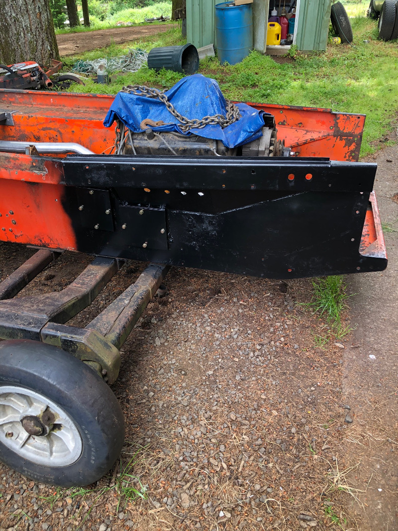

Went after the grunge on the sides and washed things down with prepsol.
Gave the front section where I have been welding a nice shot of satin flat black paint.
That will keep the rust away...
Flat black outside and a light gray inside...
Nothing at all fancy....as most of things will not be seen.
The van will cover most of it.

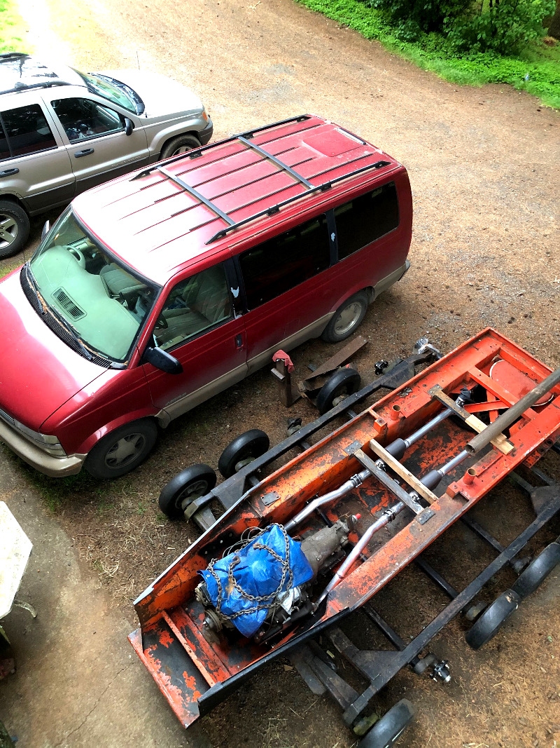

Once I get the remainder of the stuff on the engine and such ready....drive shaft cut to length and mounted and then the OC12 done....All the hard part is done then.
Mounting the van is pretty basic stuff
Very little to do of major consequence from then on.

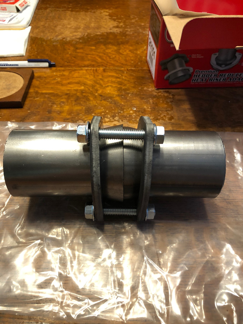

The proper exhaust parts showed up a bit ago..
Now if we can get the weather to behave we will be golden

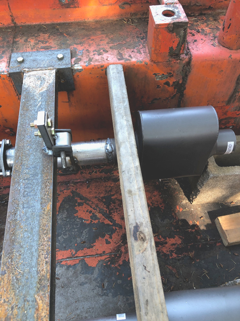

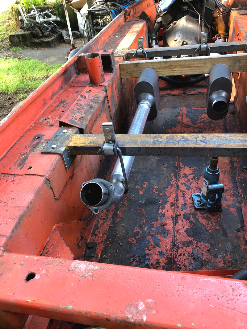

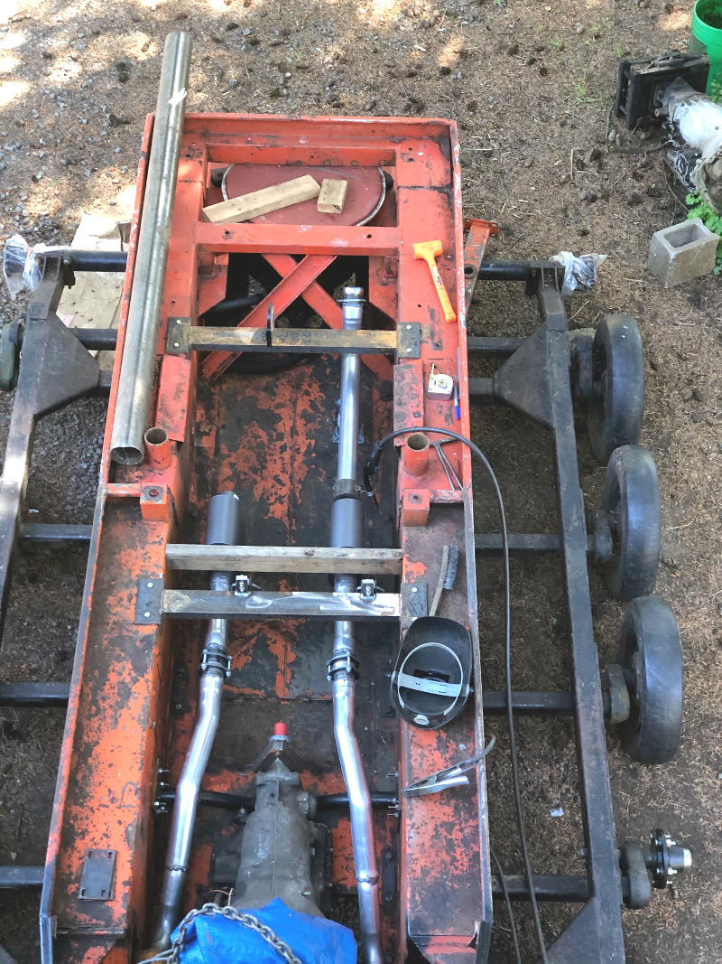

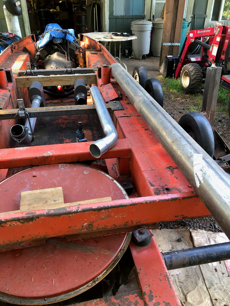

More exhaust work today....
DO NOT BUY A HAND OPERATED EXHAUST PIPE EXPANDER...JUNK
I tried in vain to expand the intermediate pipe enough to insert the ball and flange units for welding..
Ended up taking the pipes down to my buddy's exhaust shop and he expanded them on his hydraulic exhaust tube machine.....
Got everything all assembled and leveled up well and started tacking the pipe sections together along with the ball socket sets.....
Formed the hanger unit and made a bolt block and got it welded to the cross member.
Tomorrow the LH side will get cut and expanded....then welded together.
Looking long and hard at things late this afternoon.....bringing the pipe under the rear cross member (New channel bolt in unit) and up at a 45 degree angle is the ticket me thinks.
Weld the ball flange on and attach a hanger just behind the cross member.
Next the last piece of pipe can come across the top of the tub frame from the rear and angle down into the ball flange.
Thinking strongly about adding a 2 foot long 4" pipe on the 2-1/2" and finish it with 45 slice at the rear of the cat.
I have some BIG flat washers that will fit the 4" pipe and can be bored out to allow the 2-1/2" pipe to adapt into the 4"
The 4" will give a really deep throaty sound....
The additional tube frame that will be the attaching point for the van will be high enough off the cat tub to allow the exhaust to protrude out the back over the OC12 AND STILL ALLOW ACCESS TO THE DIFFY.
Coming together for sure.
Good news
My exhaust guy has landed a new building fairly close and will be moving in there in the next couple months.
I was glad to see him being able to stay in the area....
One thing for sure...

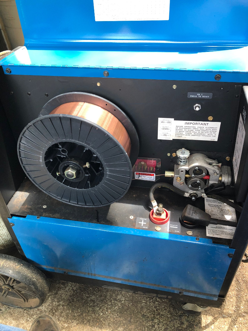

Welding the exhaust tubing is a real pain with OLD EYES AND TRIFOCALS (Variable lenses)
Light the mig and then try to focus on the right spot and not burn a hole in the pipe.
The heavy stuff is pretty easy...thin stuff......gotta move fast and try to focus quick....Arrrrrrgh

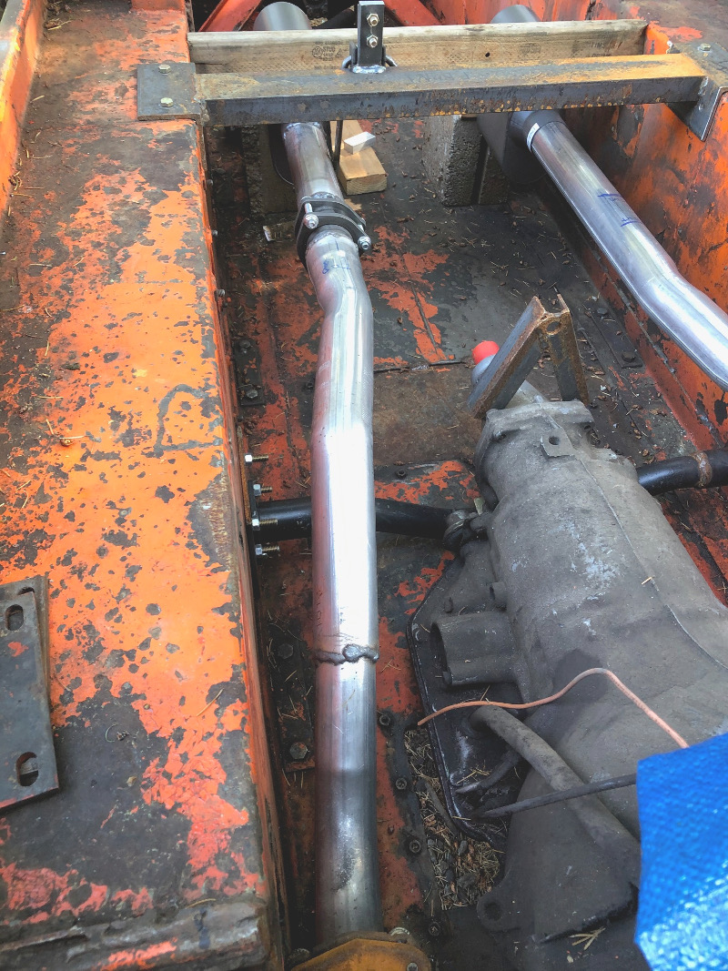

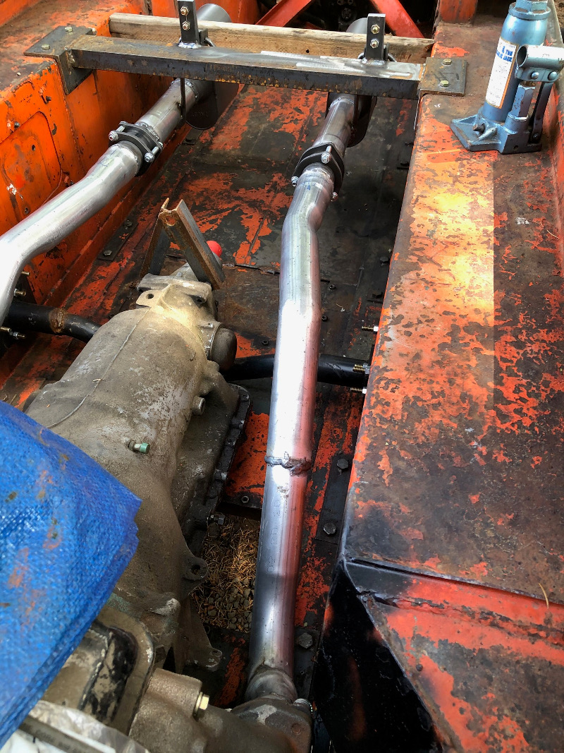

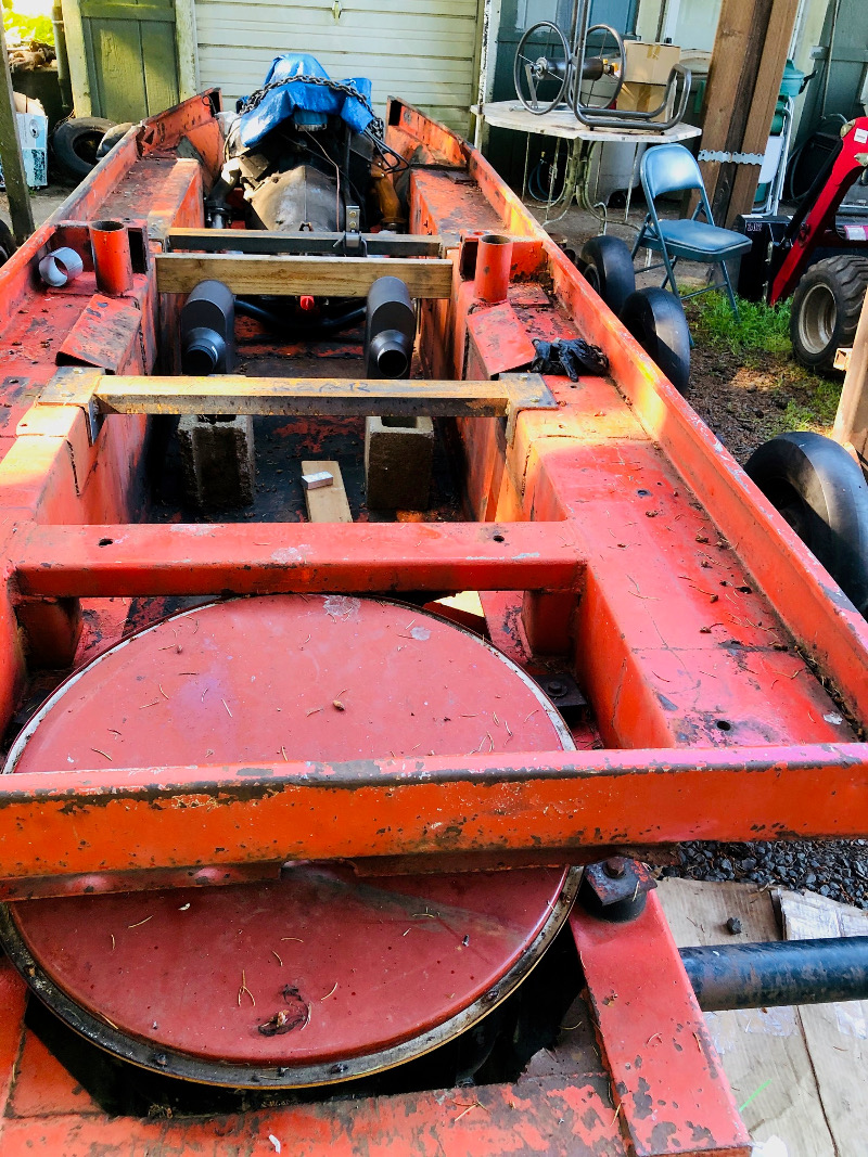

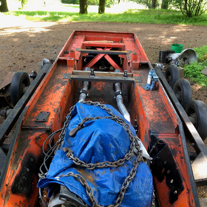

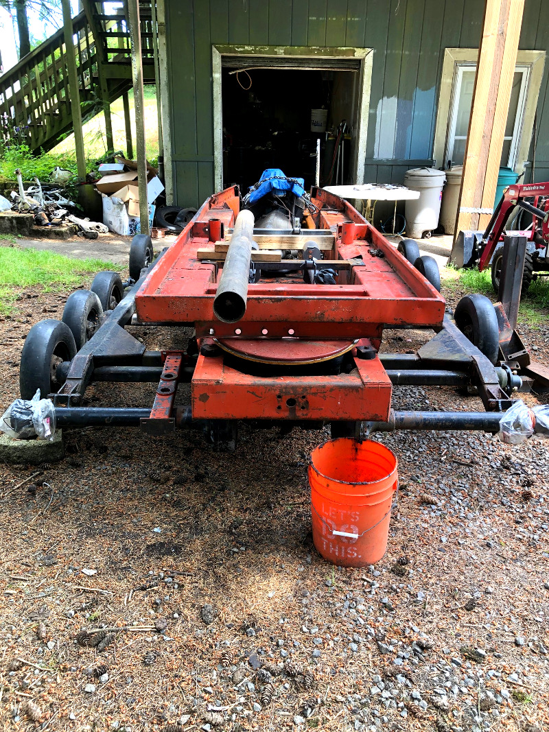

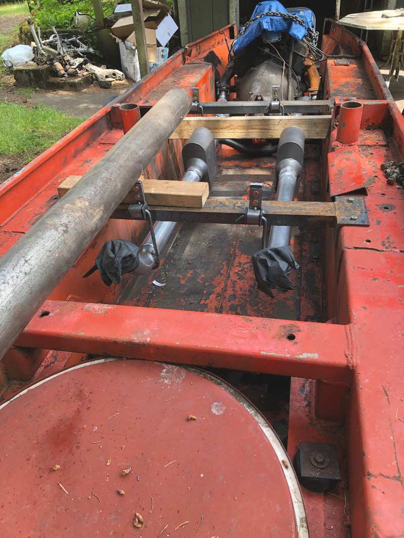

Exhaust done through the mufflers.
Got done withe the last weld on the LH pipe and and the spool of wire ran out..
Been a long time on that spool......
Now it's on to getting the rear pipes bent and installed
One pipe from the rear of the muffler to just aft of the rear (New cross member) weld in the ball unit.
The last pipe goes up and out the back.
3 sections each side
Head pipe from manifold to the ball flange ahead of the muffler.
Intermediate pipe goes to muffler and out of muffler with flanges on both ends.
Aft section goes from rear ball flange up and out the rear through the "boom tube"
Easy to unbolt all the pieces to be able to work on stuff...or R&R the power pack as a unit..
This has been a slow slog, but is coming out well....should be a good set up....:hammer:

Got a slow start today.
Been having troubles with the welder....thought it was just old eyes and not much else.
I would pull the trigger on the wire machine and start a weld and was getting a crappy weld off and on....other than welding outside and battling wind off and on.
Yesterday things got even more hinky.....decided to open the welder wire spool compartment...."Maybe the spool is empty" ??????
Well now....then things got real crazy.
Open the side door and find a mouse nest.....and the mouse had been peeing on the wire.
Rusty piss coated wire does not feed well or weld good...not even.
Cleaned up the mess...cleaned out the feed drum grooves and also cleaned the liner in the feed cable assembly.....
Wow...what a difference....still does not make up for old eyes and trying to focus after tripping the trigger...

Measured and designed the rear pipes from the mufflers back to the rear most ball flange units.
Muffler shop was a bit busy today so I was not able to get going on the rear pipes until later this afternoon.
But did manage to get the LH side put together.....
Got some pix
Also scared up the 4" pipe for the tail pipe " BOOM TUBES"
One more set of pipes to get bent that connect to the rear ball flange and go over the tub and out the back.
I need to get some good measurements on the Van from front bumper to rear bumper and see exactly where the van will sit on top of the 2100....and how long to make the "Boom tubes"
Once this is done I can figure the length of the last 2-1/2" pipes to get bent.
A 45 degree bend....to get the pipe aimed out of the belly..... then machine some big washers to allow the 2-1/2" to fit inside the 4" pipe.
Just hope this beast sounds halfway decent :ThumbsUp:
Looks like there is just enough 4" pipe in the chunk that was in the corner... :smile:

Got busy and finished the exhaust back past the mufflers and to the rear ball flange.
Just need to work on getting the last bent pieces so the big boom tube tail pipes can be fabricated.
Ahhhhhh...just and FYI
The welder is working fabulous now the wire is clean and free of mouse pee and rust.......
Only Caveat is the working outside and the wind blowing the gas off the weld...
The "Rice Crispy syndrome"........Arrrrrrrgh
May get a bit of time today before the weather turns ugly....if so I will get the last two pipes figured out....
I hate exhaust work......not hard, just not handy when ya have to run to town for every little tweak and bend....Luckily the shop is close....(6 miles)
I am getting some nudging from a couple buddy's to start thinking about scaring up a small block 400 for the kitty after we get the bugs worked out....
Nice part is EVERYTHING that is here now will all bolt right onto the 400....
"Plug and play" or "JUST LIKE LEGOS" :thumbup:
Brought the van around late yesterday and snuggled it up close to the cat to get some real time ideas on the best length for the tail pipes.
Thinking about extending the big pipes out to withing a foot of the rear bumper of the van and then add a 5" chrome tip to extend just beyond the bumper.
NOT TOTALLY SURE YET......:hammer::hammer::hammer::hammer:

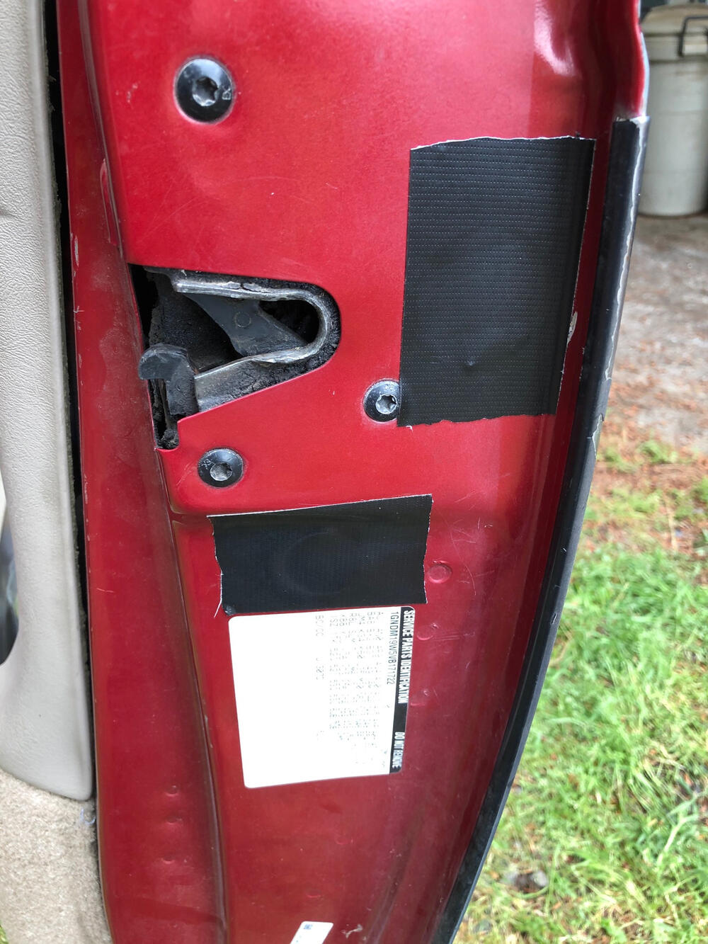

Yesterday the Right Front Door handle on the Van came apart as I went to open the door.....Arrrrrrrrrrrgh
FOR ANYONE WITH AN ASTRO OR A SAFARI
The outside handles can be replaced easily without tearing the door panel off and ripping the guts out of the door.
There is a plastic plug in the door by the latch.....THIS GAINS ACCESS to the lower nut on the handle.
The top nut is the Booger.
The picture shows the two black Gorilla tape patches.
The upper hole location can be located by looking at the handle and using a sharpie to mark the location.
Drill with a 1-1/4" hole saw
You need to leave about 1/2" or so of material between the outer edge of the hole and the edge of the door lip.
Be aware the latch mechanism will stick out into the hole....SO DON'T CUT MORE THAN THE DOOR SKIN.....
Debur and life is good.
The nuts have a wide washer built onto them..
Carefully remove the lower washer.
Stuff a piece of paper towel into the upper hole to keep the nut from falling into the door.
Box wrench gets the upper nut loose...
Wiggle the handle out of the hole in the door and pry the little actuator rod loose from the old handle.
Now life gets interesting.
Place the new handle in the open position and put a suitable object between the part you pull and the mounting plate that fastens to the door.
This keeps the little lever that pulls the rod in a position that will allow the new handle to snake back into the door and get around the lock rod.
Once the new handle is in the door and sitting properly replace the lower nut and snug it up......
Now wiggle the latch rod into the lever and replace the keeper.
Some handles have a plastic part with a snap over retainer....others have a metal clip that you press the rod into and it snaps in.
Once the rod is in place check the function of the door...
Now..
Stuff paper towel back into th top hole and pack it such that the top nut can be put on the stud.
I used a medical gripping tool (Forceps) to grab the washer on the nut and insert it in the hole and onto the stud.
Hold the nut with a finger and slip the tool off carefully..
Gently turn the nut with an open end wrench or as I did used a small screw driver to gently pull on the nut flats to get it started on the stud..
Once the nut is started on the thread things are golden.....
Snug up the nut and the job is done.
I ordered up some rubber plugs to fit the large hole.
Hole ends up at 1-1/2" after it's cut and debur'd.
The lower hole came with a plug but mine was cracked...
Gorilla tape is fine for now.
Removing the door panel is nasty on these old rigs even with the proper tools due to the plastic being brittle and prone to breakage....

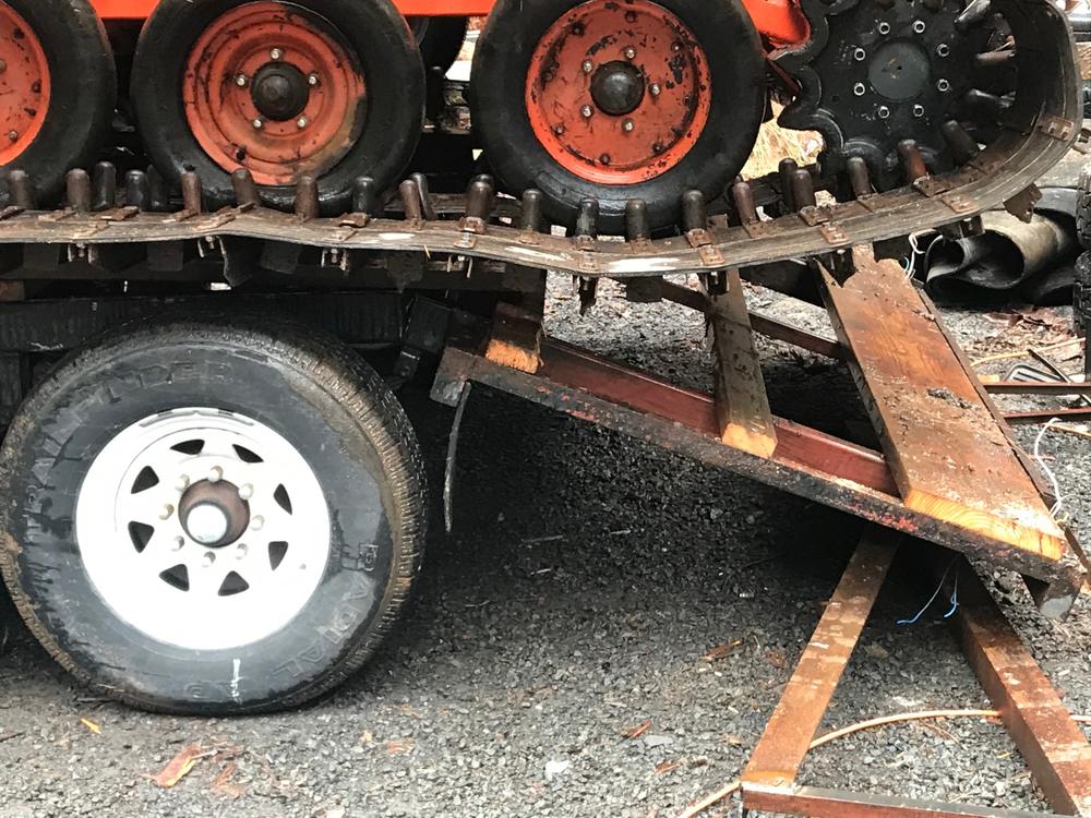

Here is a closeup picture of the tracks, tires and wheels on a 2100.
I am not sure where the interference between the wheels and tire guides is going to happen ??????
Running a tire flat can and will trash the wheel rims as the edge crashes into the tire guides.
About half of my factory 3 inch wheels have the edges of the wheels dinged up in many places.
I wondered how that could happen....flat tires....
Also a piccy of a 2100 with a flat tire.
Use 5.30 x 12 tires to get as much sidewall as possible....Foam them suckers to help stop flats
The cat with the flat tire belongs to our member "THE FATSQUATCH"
Pat...you have solved the mystery of why my wheels are dinged up
I wondered how the previous clowns beat the wheels all to hell....
Now we know
With tires inflated and or foamed the issue of thrashed wheels and track guides should not be an issue.
Checking the tires should be a standard procedure before taking off on a run and post run walk around me thinks....
Looking closely at the bottom picture the flat tire has dents in the rim right behind the one guide....
