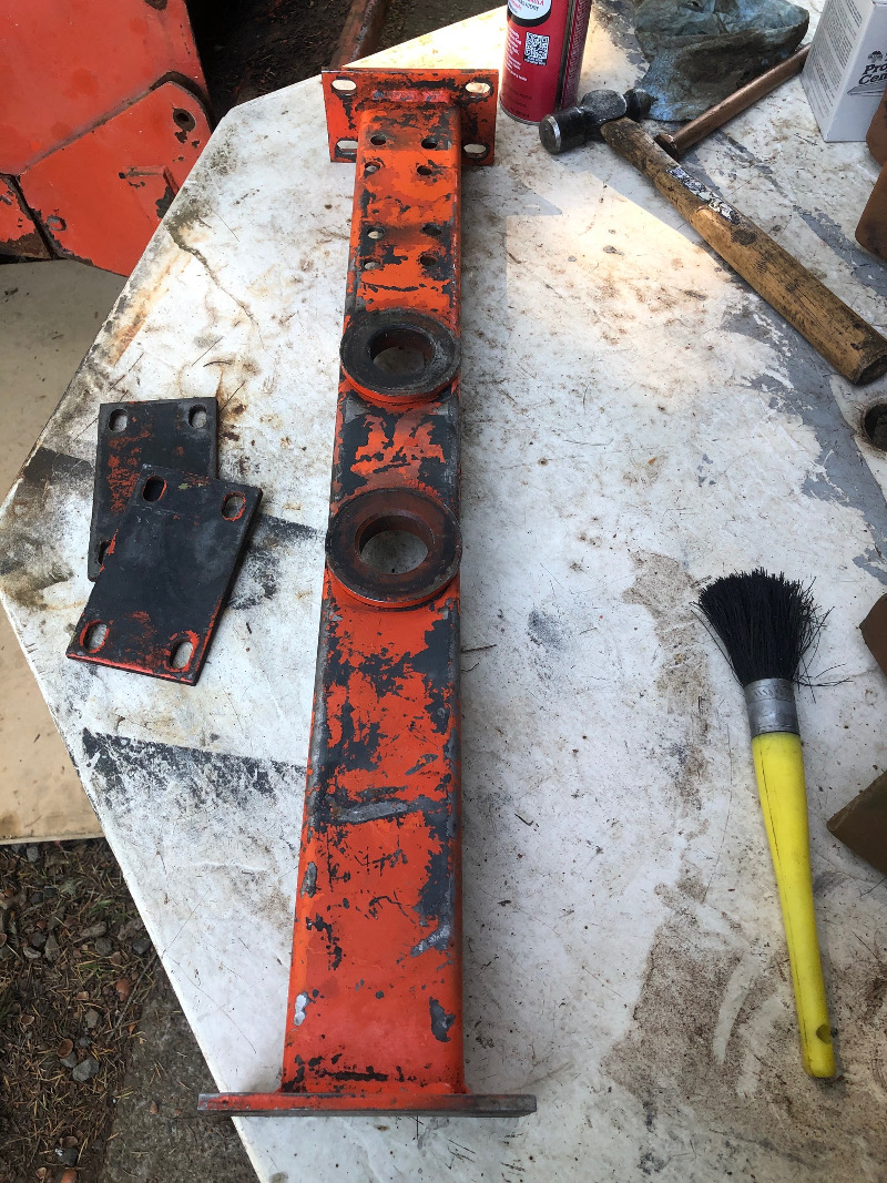

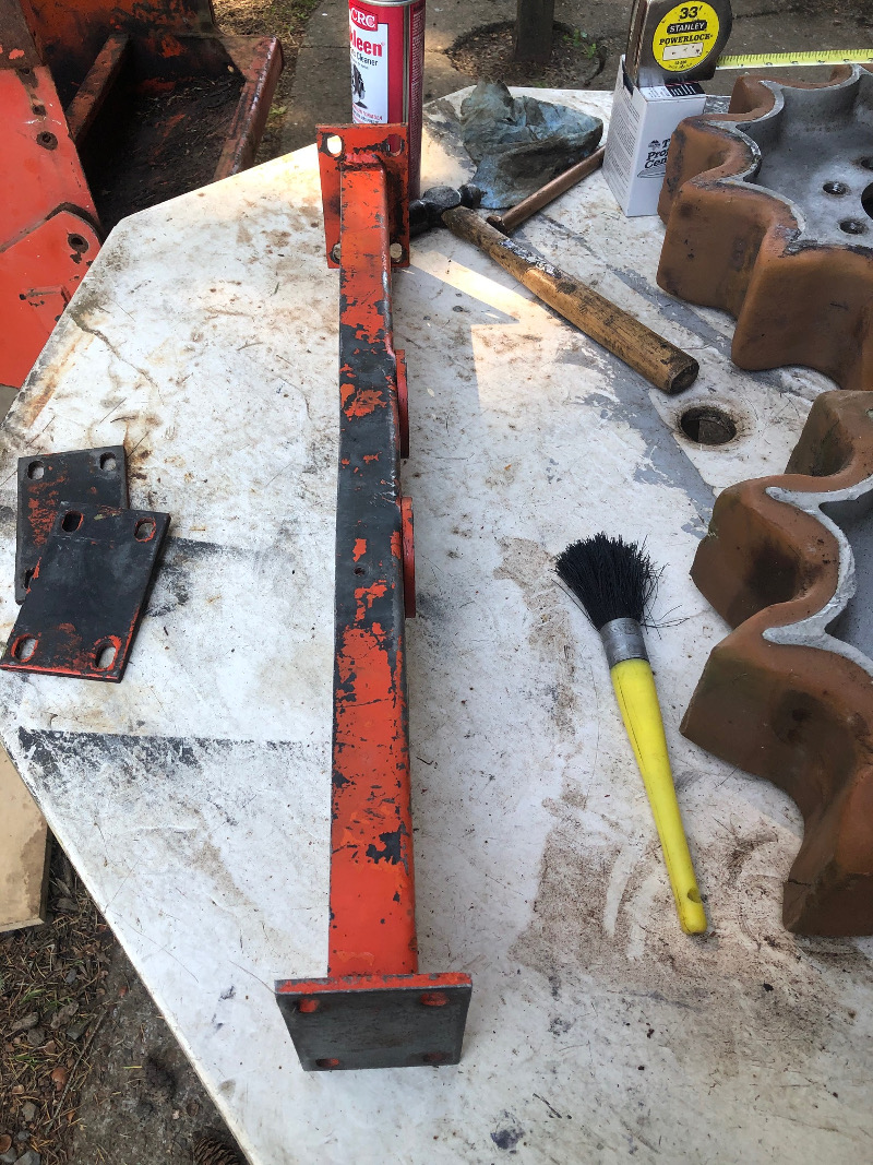

Removed the transmission cross member as it looked bent.
Yes it was bowed down in the center at least 1/2 inch
Took it to the press and shoved out the old rubber mounts and tossed them in the garbage.
Got a straight edge out and checked the mount....yeah buddy...
Did some shoving on it and it is now straight again.
I intend to reuse this mount with the new engine and tranny....
May have to modify it some to accept the Chevy rear mount....but we will see as soon as I get the tranny.

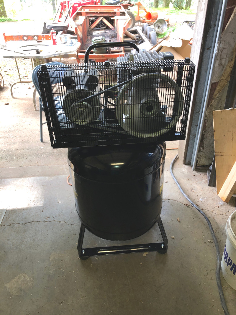

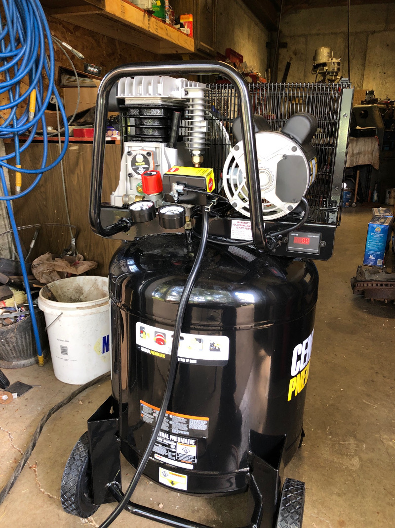

While I am cleaning up the hub my air compressor starts making bad noises......
By the time I got into the shop the beast it shedding pieces....
40 year old machine...been run hard and put away wet too many times.
So cat work stopped and compressor work started.
Compressor shot.
Got a pump only over at HF and now I gotta make it fit.
Bolt pattern is not the same, air piping needs to be moved.
Arrrrrrrrgh
I do not want to buy a new compressor (Complete) as I put a new motor on this one and a new pressure switch last year......
Some plumbing to do for sure.
But I need my air tools to get back to work on the project.....
And so it goes.
All back in the saddle.
Said ~!@#$ it and took the replacement pump back to HF and picked up a complete new compressor set up.
Got their 29 gallon unit on wheels.
Always something eh ???
So now back to doing meaningful work on the cat.
One possible good outcome with this compressor issue..... I need an air tank for the Cat and the old compressor tank is a perfect fit across the inside of the tub to the rear of the tranny.....At least there will be a use for the old tank...... Another lease on life :thumbup:

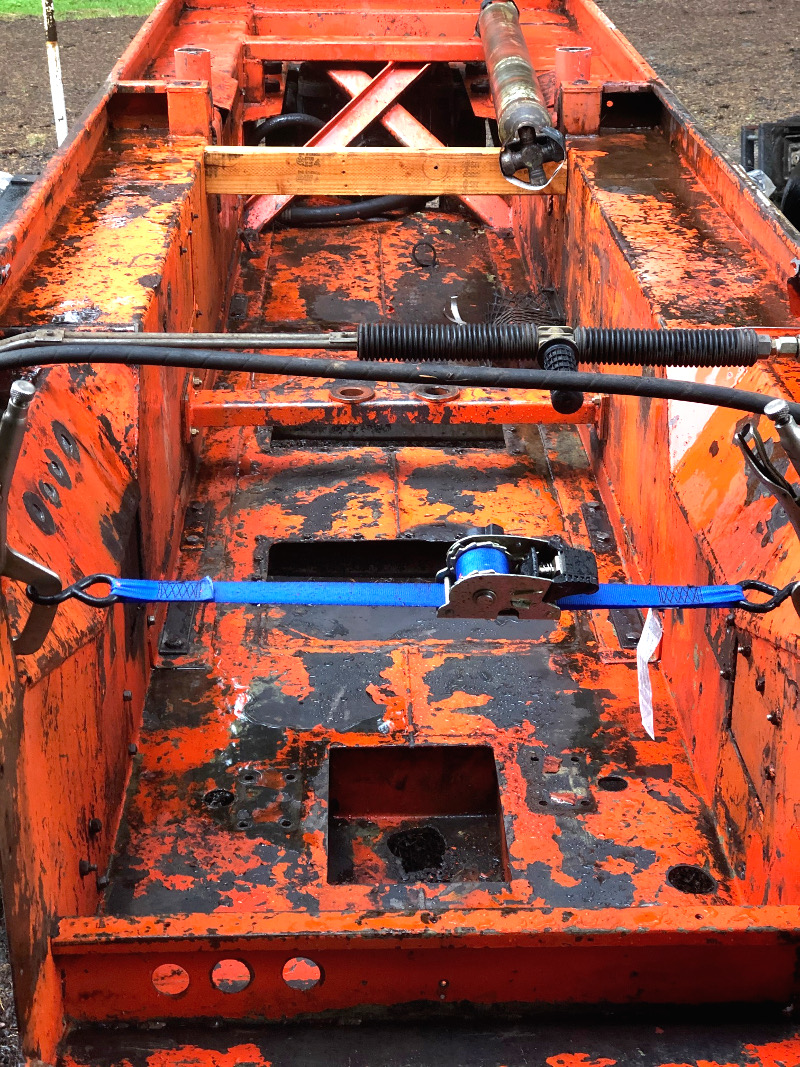

Well...not much to report.
Dropped off one of the half way decent tire/wheels off the cat at the tire shop and had them get it off the wheel.
I want to wire brush the inside of the wheel really good, polish up the rim edges and then paint the sucker with some decent rust inhibiting paint.
I chose a gray color to match the alloy front rims.

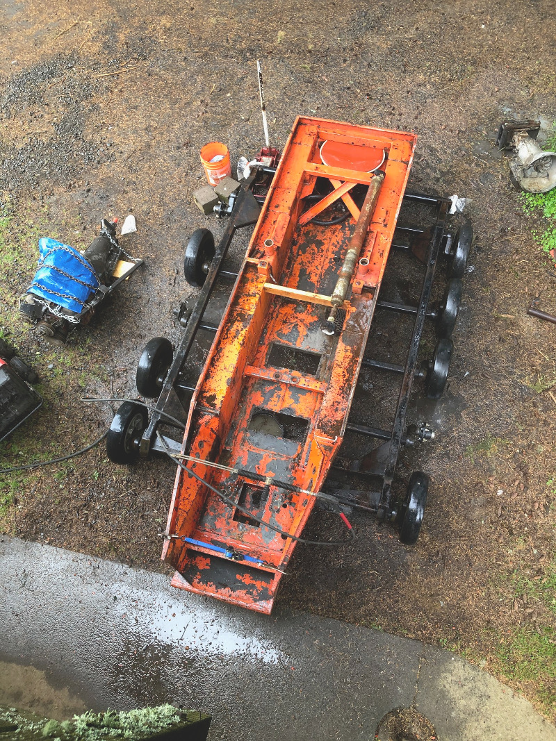

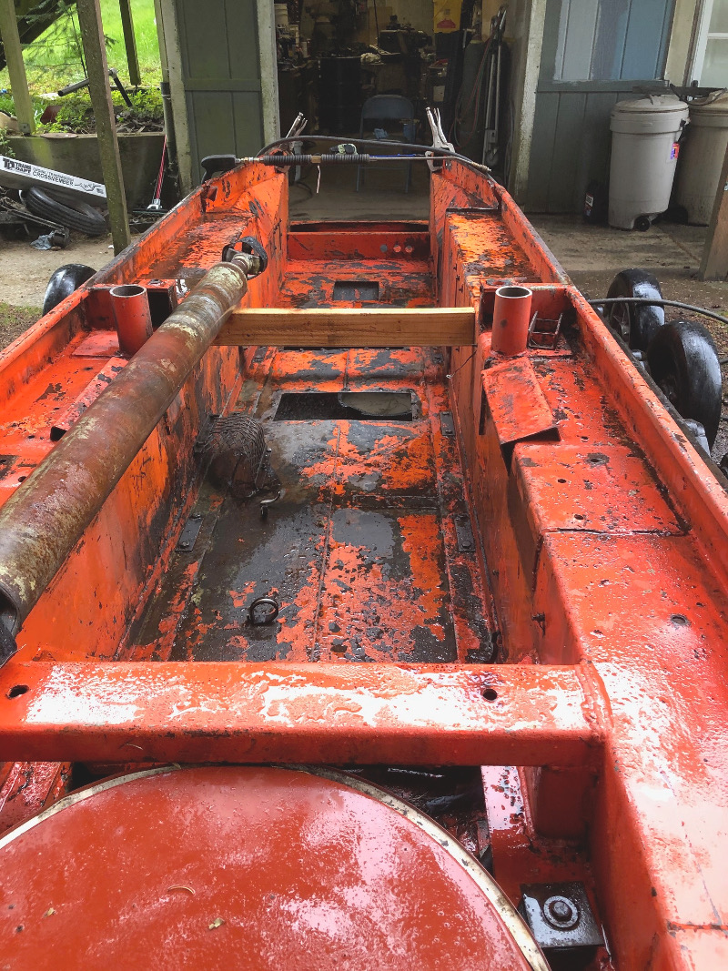

Took a good session with a big azz putty knife scrapping more of the crud out of the tub.
Just about as good as the scrapper is going to get it...then its time for the hot washer.....
So much fun... :hammer:
Life is good.

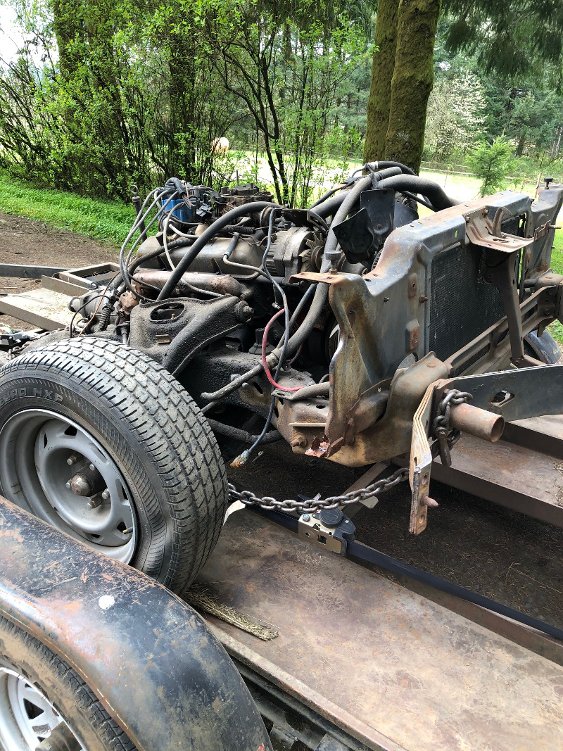

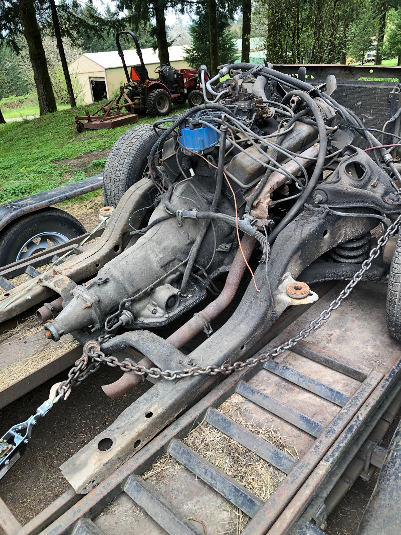

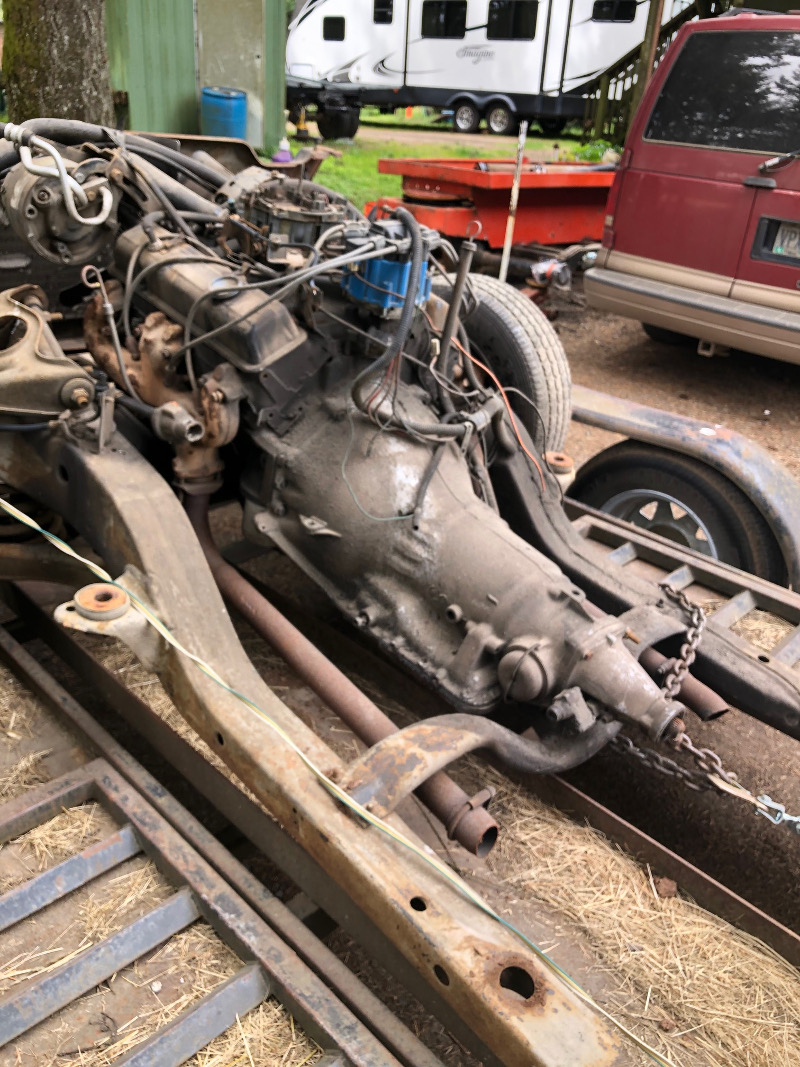

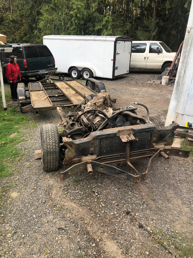

Got a call yesterday on a Craig's list want ad I had running.
I was looking for an engine for the 2100 van cat.
A fella had the front Sub frame off a 1977 Camaro with a Chevy 305 and a TH 350 Tranny.
Runs and seems fine.
It looks like it has a story to tell too.
The block is indeed a 305.
Block is blue, heads and Valve covers are black, timing cover is Chevy Orange, pan is blue....
Somebody been into it.
Complete from fan to tail shaft and pan to carburetor.
Starter, alternator, water pump....pulleys....
The Fluid in the TH350 is nice and pink too...
Eventually I will get into both of these units.....but for now a washemup and that's gonna be it.
I need to make some lifting brackets for both the tranny and the front of the engine to allow me to pick the entire package up level and sit it in the cat with the skid steer.
We wiggled the critter up onto the trailer with a chain and a come along.
The driveway was on a pretty good decline, but one flat tire kept things from getting wild on the downgrade.
So.....Kitty got's an engine and tranny..
Took some pics and tossed the frame on Craig's list
Someone is in need of a Camaro sub frame that's in good shape....

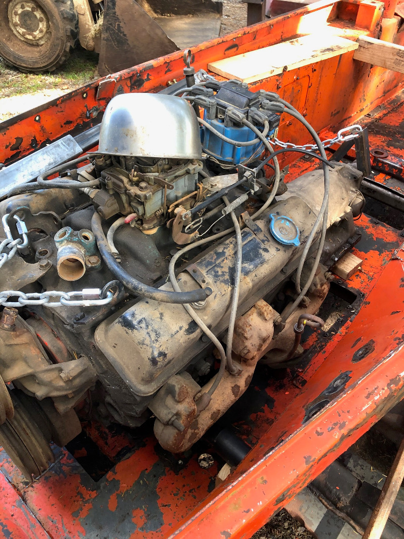

Took a bit of time l;ate this afternoon and started pruning all the crap off the engine.
The carb is an old Q jet and pretty sad looking.
I am thinking about a Holley Spread bore with electric choke.
The engine has the old mechanical fuel pump...
I love it.
Will remove the electric in tank high pressure pump in the van and convert things to a simple suction tube...Probably add an inline electric pump to prime the system......
This setup is gonna require the power pack be removed to do any work on some stuff....
The starter should be removable through the 2100's starter access hole in the RH side of the tub....may have to make the hole a tad bigger ?????
Great deal on a complete power pack..
This engine is/was an LG4
305 4 barrel carb....It may have had dual exhaust too....but that cat is gonna get 5 inch side pipes....because I can.

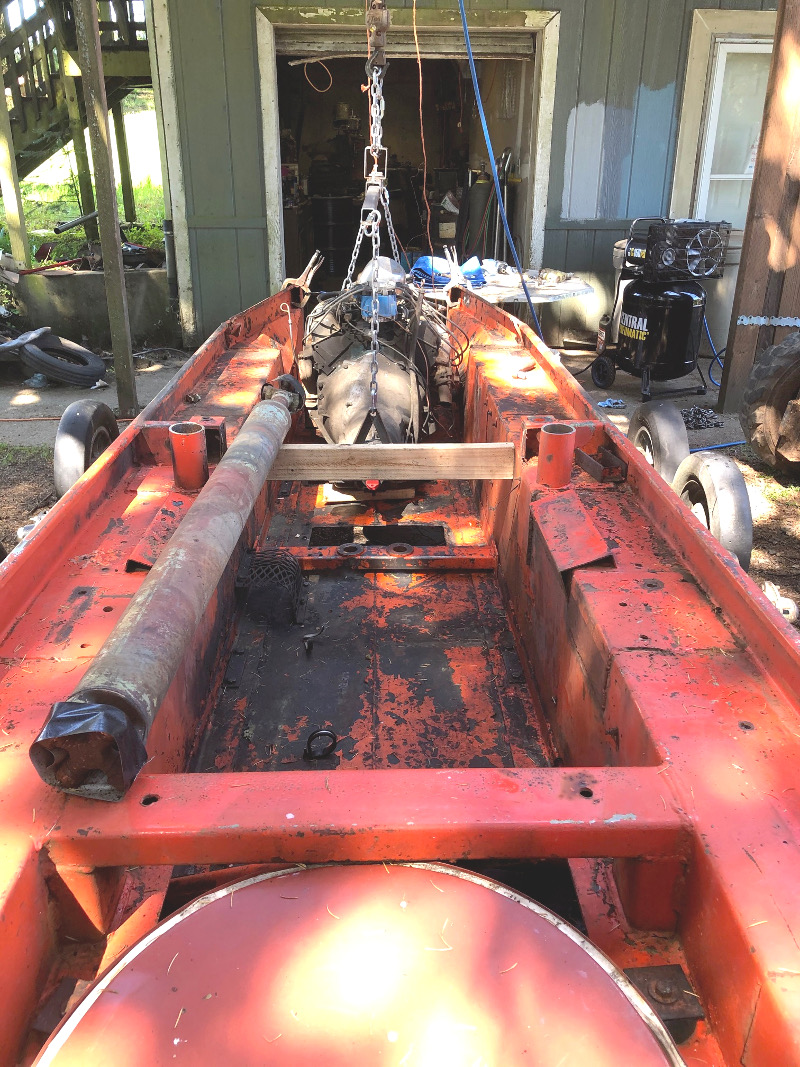

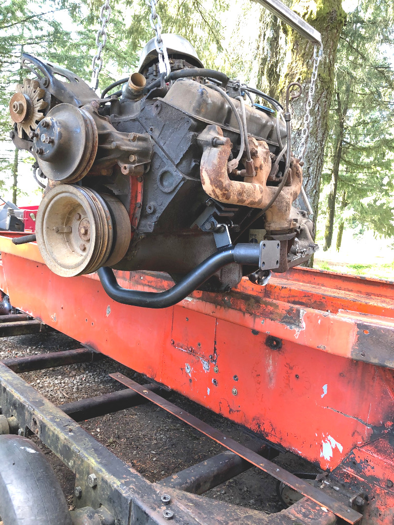

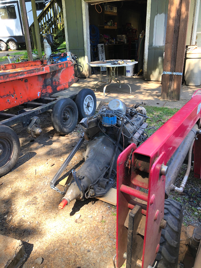

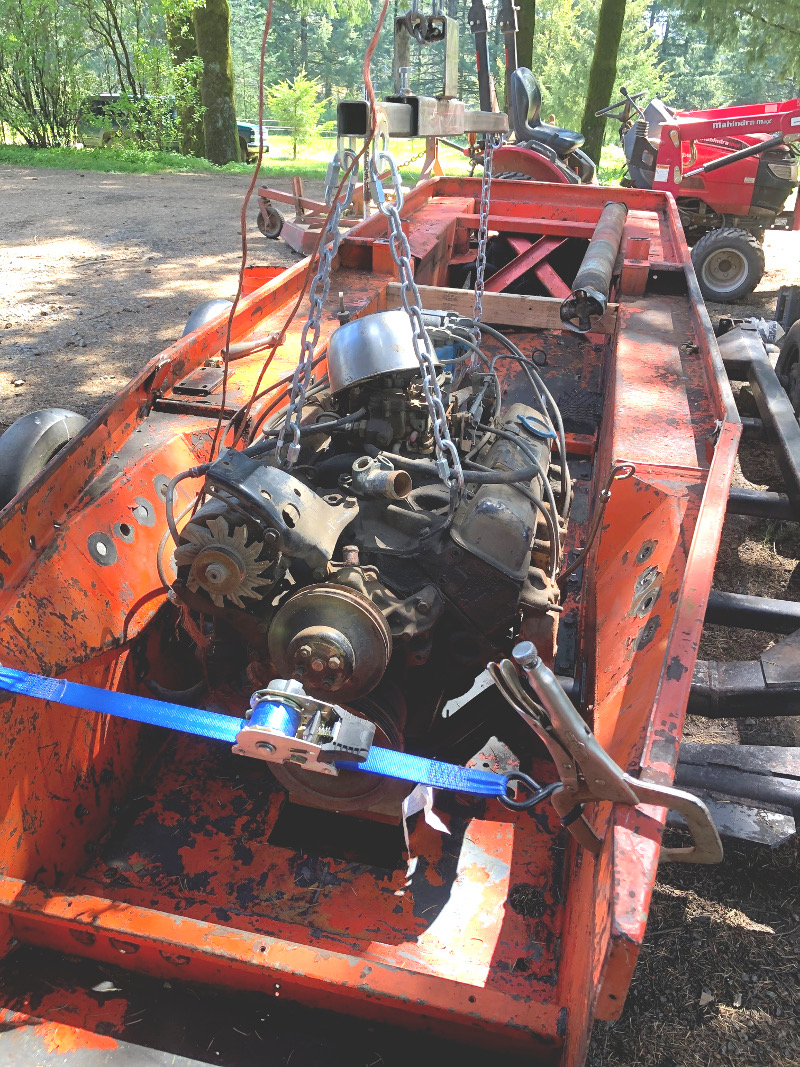

Yesterday I got the engine off the trailer and parked near the cat.
Ripped off all the extra junk and got the power pack ready to come off the cradle.
Motor mount bolts all out and all the wires and hoses are now on the junk pile with the crap that came out of the 2100...

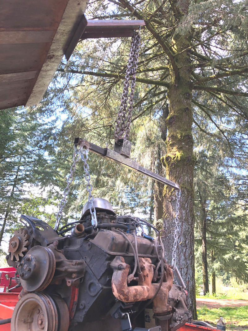

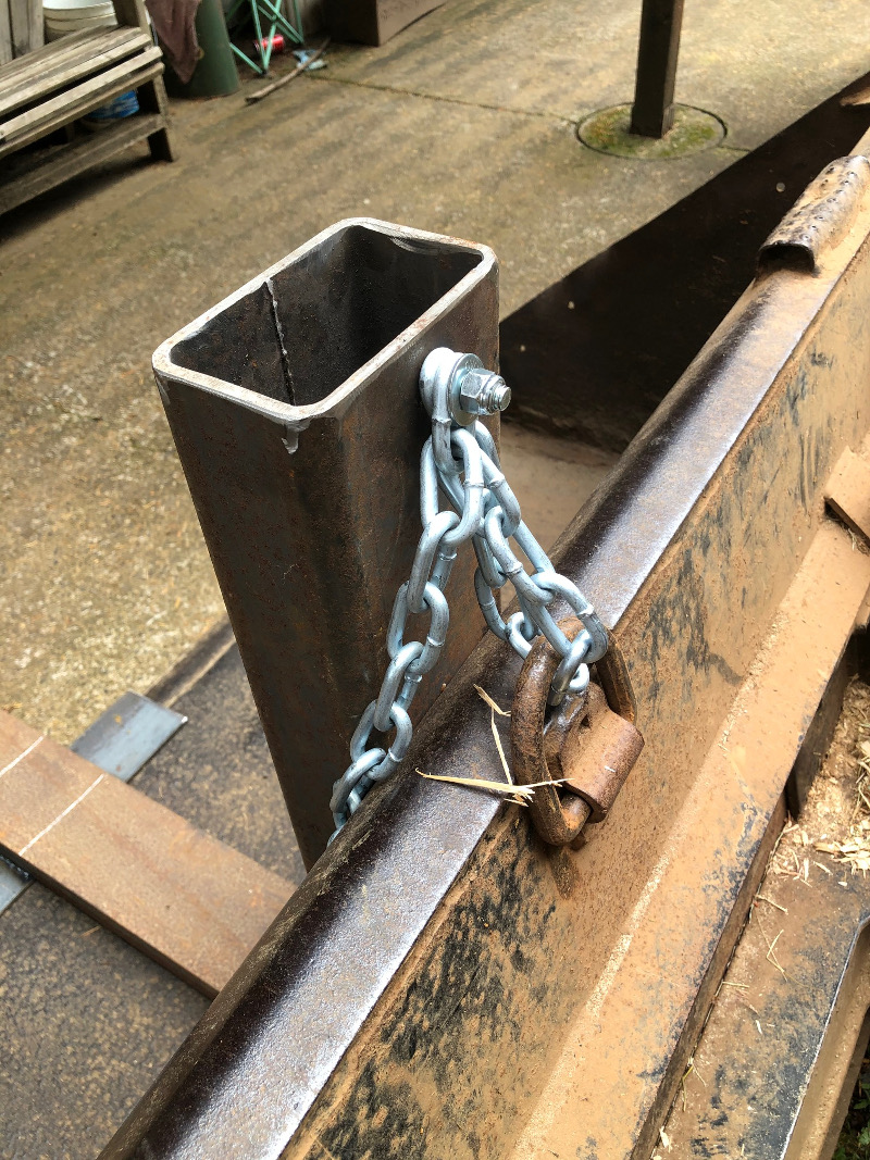

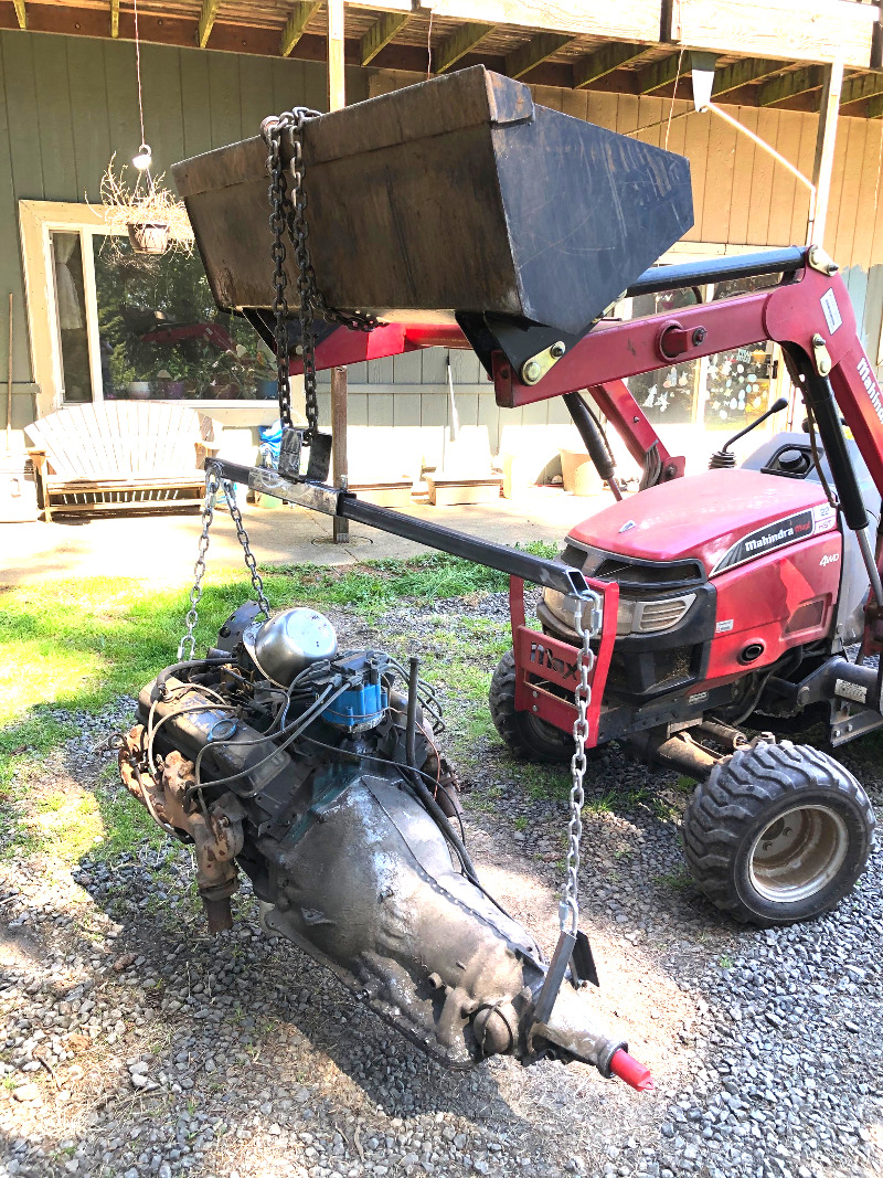

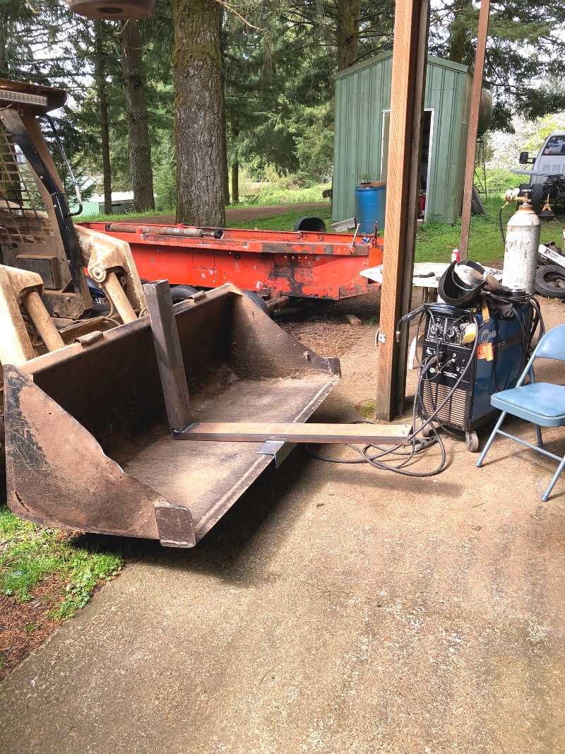

Figured out a nice lifting rig to pick up the entire package LEVEL.
Stopped off at the local steel supply and got some square tubing and a few things.
The engine had a single lift lug on the Left front top of the intake....headed to the U pull it yard and scared up one more to allow the rig to hook up at both front corners and the at the rear of the tranny.....
The new front mount I ordered arrived last night on the Little brown truck....:clap:
Here in a bit I will head down and get started on the lift rig.
Gonna add a slipper tube on the lift rail to allow things to be adjusted for a perfect balance.
This should make the install into the cat a walk in the park.

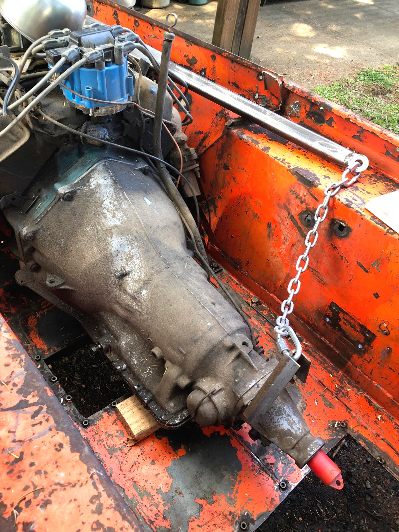

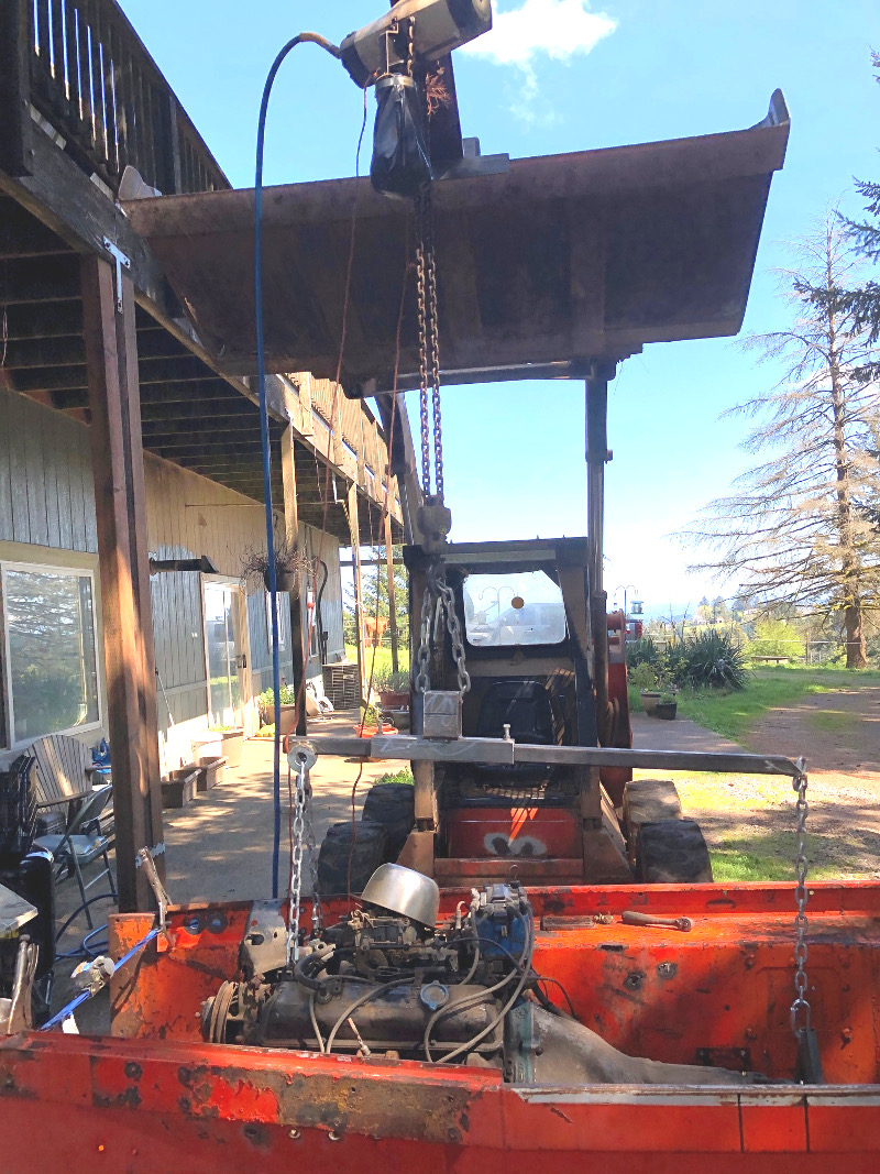

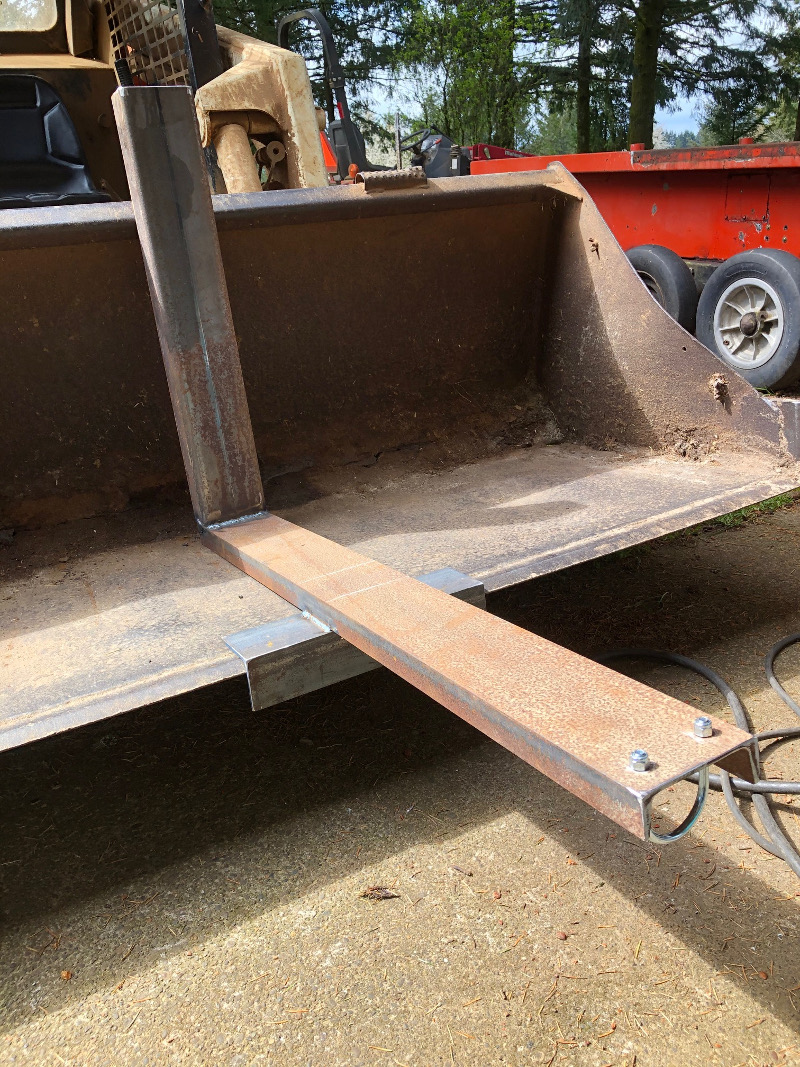

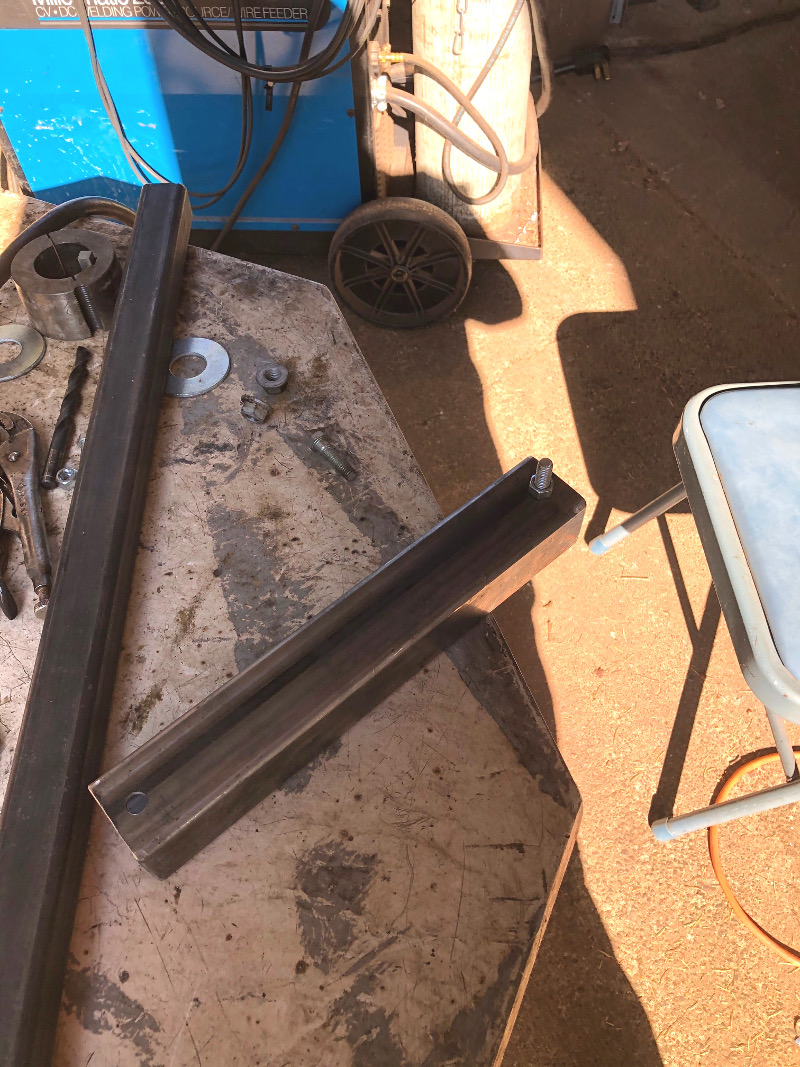

Got after building the lift rig for the small block this morning.....
A bit of measuring, cutting and welding...
Decided on an adjustable lift point to get things just right.
Took about an hour and a half to cut and fab up the rig, get the lift chains all cut and things hooked up.
I had the rig hooked on the tractor just to get things right, but decided to try a lift and WOW....THE UNIT CAME OUT PERFECTLY LEVEL.
Dragged the Camaro frame off and got it out of the way...

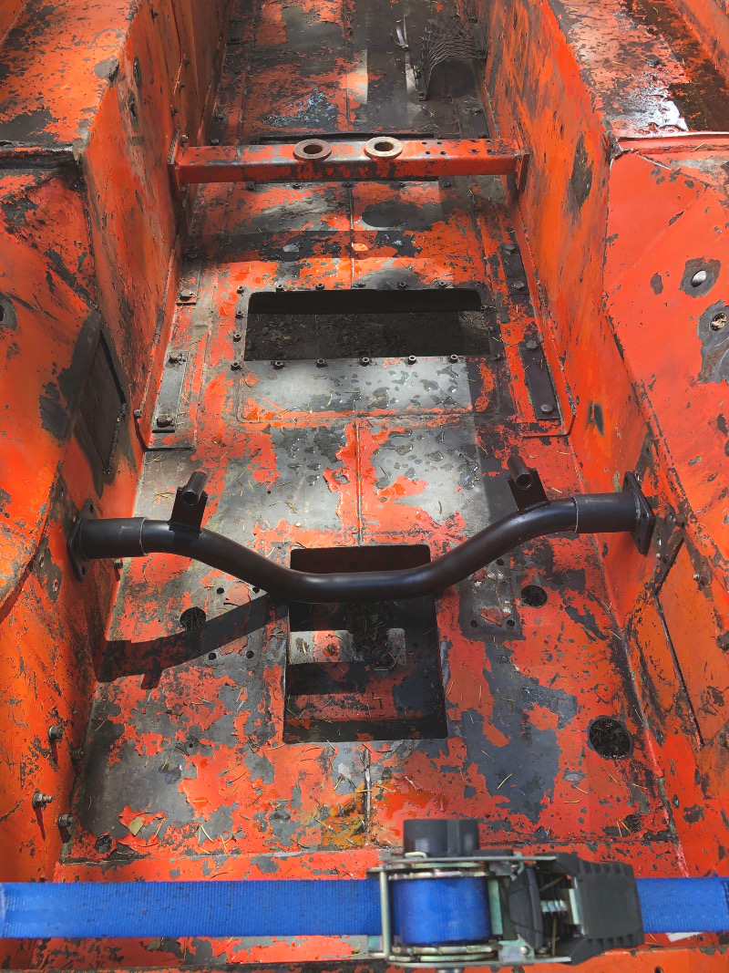

Opened up the box of goodies that came.....Nice stuff.
Measured things up and got ready to cut the mount to length....but dinner got in the way....YUM YUM Home made spaghetti ....:thumbup:
Reading over the paperwork that came with the engine mount....then after thinking about things....the rear tranny mount that came in the Cat is gonnna need to be modified.....Same company makes the rear tranny mount too.
Decided to just order one.
Be here in a few days..
These two mounts will make a very clean setup....
Just need to drill holes in the tub is all.
I want to get the tub washed out now while I am waiting for the tranny mount..
Once the mount is here the power pack can be dropped in and I can start getting the crankshaft angle set to match the pinion angle in the OC12.
I want the engine as low as possible, but the driveline angle has got to be right in the groove.

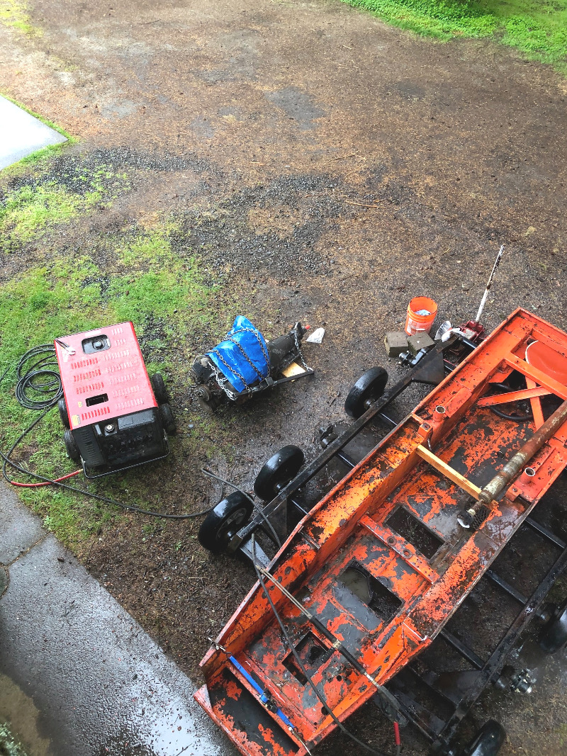

Weather is going in the toilet....so not sure what will get done over the next few days.
If the rain is not terrible....maybe drag out the big hot washer and go after the tub..

1995 Suburban 2500 4X4 With 454 power.
We call it "The big mule"
We use it to haul the trailer around and drag chit home...
Mostly we use it in the winter time to haul the trailer and the dumpster to get nut shells for the pellet stoves
3 YARD DUMPSTER ON THE CAR HAULER

Raining this morning...arrrrrgh
I pushed the big hot washer out near the shop door, and once this little spritz is over I'm gonna go after the cat.
Even after mucking out the tub with a shovel and then a big putty knife it's still yucky in there.
I really want to get the engine set in and figure out the locations for the two mounts and get them located.
While the diffy is still in the cat I have a good reference to set the power pack to.
I have a feeling that once the diffy comes apart it will be a while getting it all cleaned up and new bearings and such installed...so decided to get the basics on the engine/trans location done..
There will no doubt be down time with the diffy while parts are ordered and coming...
So I will be able to work on other things with the engine and such.
The front axle is tweaked and needs to come out and be straightened....more work......:hammer::hammer:
Surfer...
We are almost neighbors :thumbup:
I am about 15 minutes North of Newberg on Chehalem Mt.
If ya get down this way let me know....y'all are welcome to stop by for a visit...
Raining....wet out....great day to wash out the cat.
Dragged out the big Landa 4-2000 MG unit and went after the cat.
Cat is pretty clean....I am wet and filthy now.
All the dark places in the tub are where the 2000 psi @180 F water blew the paint off...or rusty spots.
Eventually I want to paint the tub in and out..
Likely use Rustoleum and call it good.
Not sure on the color.
Maybe a neutral color that can go with whatever color Van we end up with.
Something that makes it easy to see in the tub....
Definitely not a real fan of the orange for this cat.
Sure gonna be nice to not get coated with greasy goop every time I get close to things to try and do something.. :clap:
Likely not going to blow off the engine/trans just yet....I don't want to blow any water into the engine with the high pressure.
Depending on what shakes out...the bare bones minimum I am going to do to the engine is to clean it off well and replace the soft plugs.....
These suckers will no doubt be corroded inside and could be ready to leak.
Looking at the old trans mount and the idea that it might make a really swell mount for the center support bearing occurred to me...:smile:
The center support has to mount in the tub, and the old cross member will easily move back a couple feet....Drill some holes and bolt it in.. :hammer::hammer:
With all the stuff removed from the tub the poor thing is looking like Swiss Cheese with all the open bolt holes...
Ahhh well...... Custom stuff that's made over usually has extra holes.

Got the Skid steer up here next to the cat to see about hanging the engine in the tub for a quicky look see...
Nope...not gonna gitterdone....Cat is too wide and the skid steer will not reach the center.
OK....as I mentioned earlier...seems as though there is always a side project needed to make stuff happen.
Scrounged around in the shed and found some pieces of channel and tubing.
Put on my Rube Goldberg hat and went after an extension to give us an extra couple feet of reach.
Ended up with a pretty good extension...The chain and D ring secures it so it cant flip loose.
1 ton Yale air hoist is a sweetheart for sitting engines in rigs.
There is a piccy of it hanging on the Skid steer back several pages.
The hoist has a throttling valve to allow very slow up and down travel of the chain too....or fast up and down.....

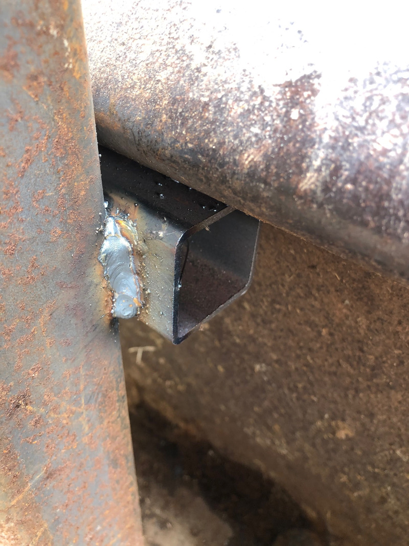

Got the new engine mount trimmed to fit in the cat...
Going to make a 1/4" shim plate for each side to allow the mount to be easily removed from the tub.
Once the engine is located the bolt holes can be drilled and the end caps on the mount can be welded in place
The trans mount is on order and should be here by weeks end or so.....lets hope.
In the mean time I think we can go for a test lift and fitting to see how it looks in the tub...
Should allow for some ideas to coalesce as to how things are going to come together.
Maybe now some real Cat work can happen..
I am thinking that the lift extension for the skid steer can help when removing the OC12 too......
May need a lift attachment to allow the hoist to hook on the Diffy.....
We shall see....
OK....Got some real honest work done on the cat today...
Rigged up the engine on the air hoist and cranked that bad boy skyward.
Sat the beast on the side rail and did a test fitting of the new engine mount.
I had given thought to modifying the new mount and using the original Camaro motor mounts.
An hour of fiddling with the mounts and looking at things and it became obvious that the new Trans Dapt mount was pretty good right out of the box....
Bolted that unit on the engine and then got busy getting the engine into the tub for the first time.
OMG.....SWEEEEEEEEEEEEEEEEEEEEET.
Plenty of room all the way around to get to things like spark plugs, wires, starter (Will need an access hole in the tub....make the one there bigger.
Got the engine sitting on blocks to allow it to be as low as possible without hitting the floor of the tub.
The engine mounts are very close to the original mounts that held the big Ford 391.
Got things spot on front to back and side to side...
Tomorrow I need to get the S10 2 piece drive shaft in the tub and see if the length is going to work right.
I have hopes that the shaft can fit in it's "stock" length.
That would save $$$$ and extra work.
If the shaft length is good to go then I will check the angles on the shaft to see if we are even close.
If need be the engine/trans can go fore/aft a bit to make things fit....
Once these items are in order the next thing will be to transfer the front engine mount holes with a transfer punch and then drill them.
I want to install a 1/4" shim between the end of the mount (4 bolt flange) and the tub.
The original mount holes are right around the new holes and the old holes can be drilled through the shim plates (Help add stability)
The old Packer has more damned holes in it than you can shake a stick at.....
Not sure what I want to do with all the extra holes.
Some are just going to get bolts put back in....others might get welded up ??????
Starting to actually look like something good is happening... :thumbup:
