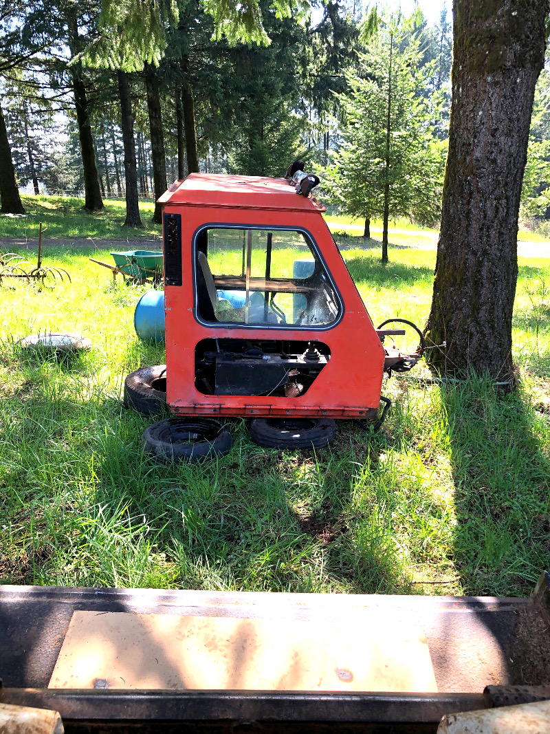

I was looking at the Cat yesterday and once the cab is off and the firewall/bulkhead is cut away...(Tilt cab 2100 has a bulkhead that the cab sits down over and bolts to...you can see it in the picture with the chevy mount) the tub will be wide open.

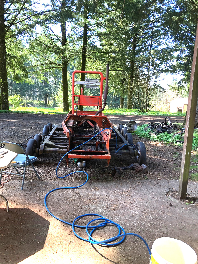

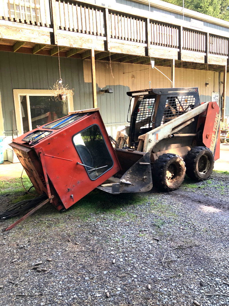

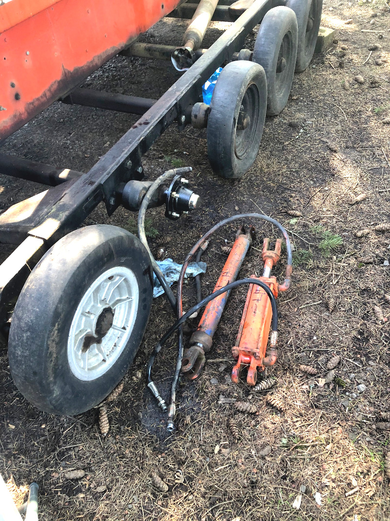

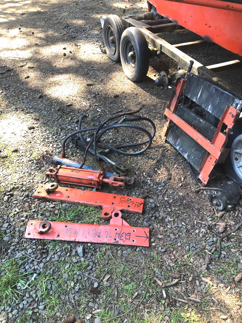

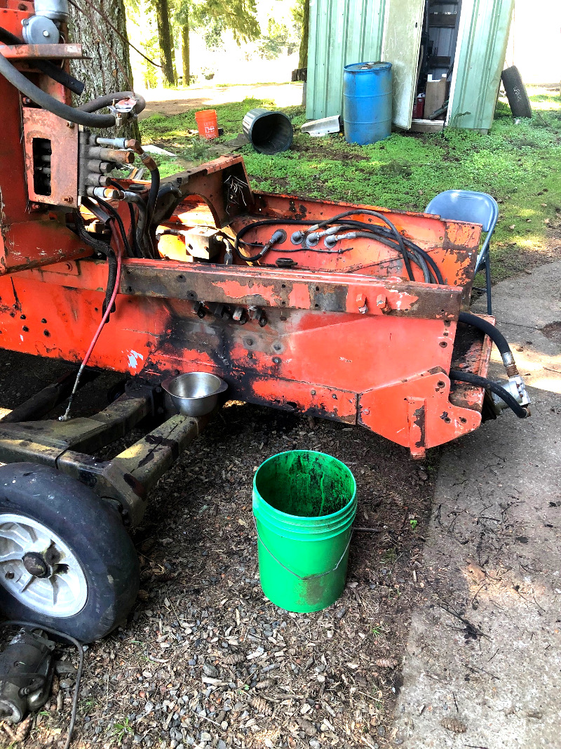

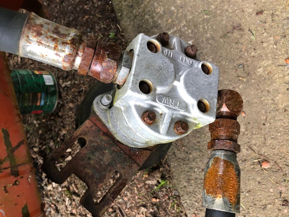

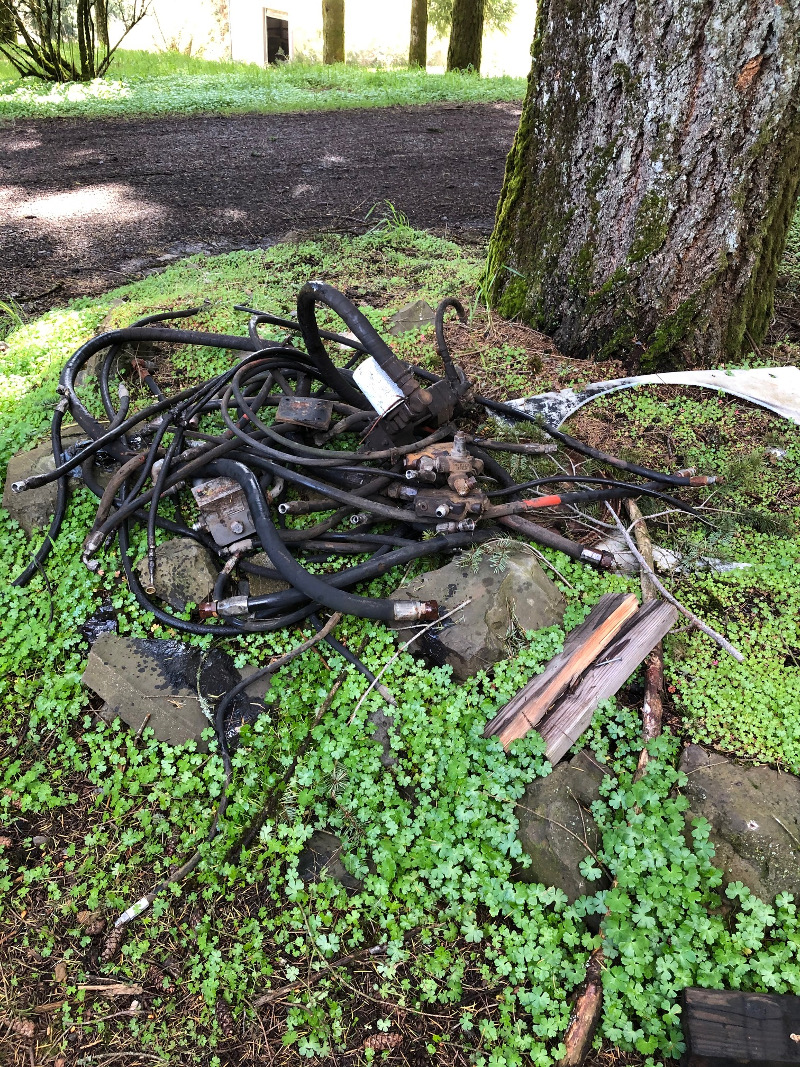

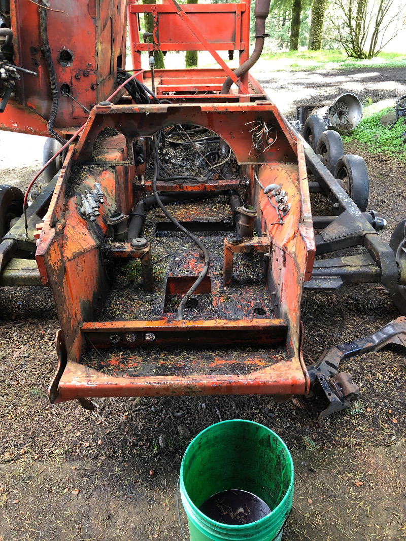

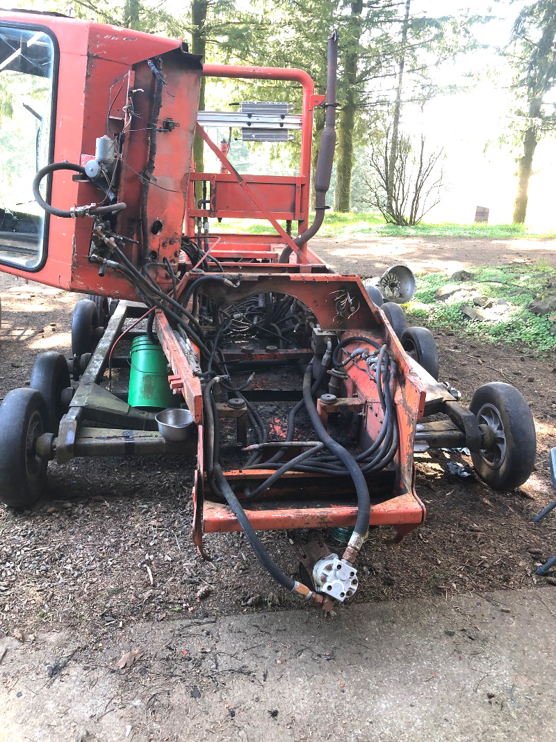

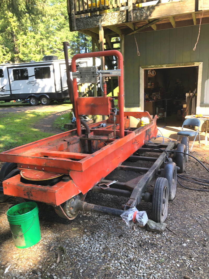

Got some actual CAT WORK done today.....
Ripped off all the blade cylinders and the brackets.
Hydraulic oil sucks too...
I was able to get most of it in a bucket.
I want to keep the cylinders in usable condition so I piled them up on an old disc out back with the hoses DOWN
I can get closer now....
Still a mile of hose in that beast.

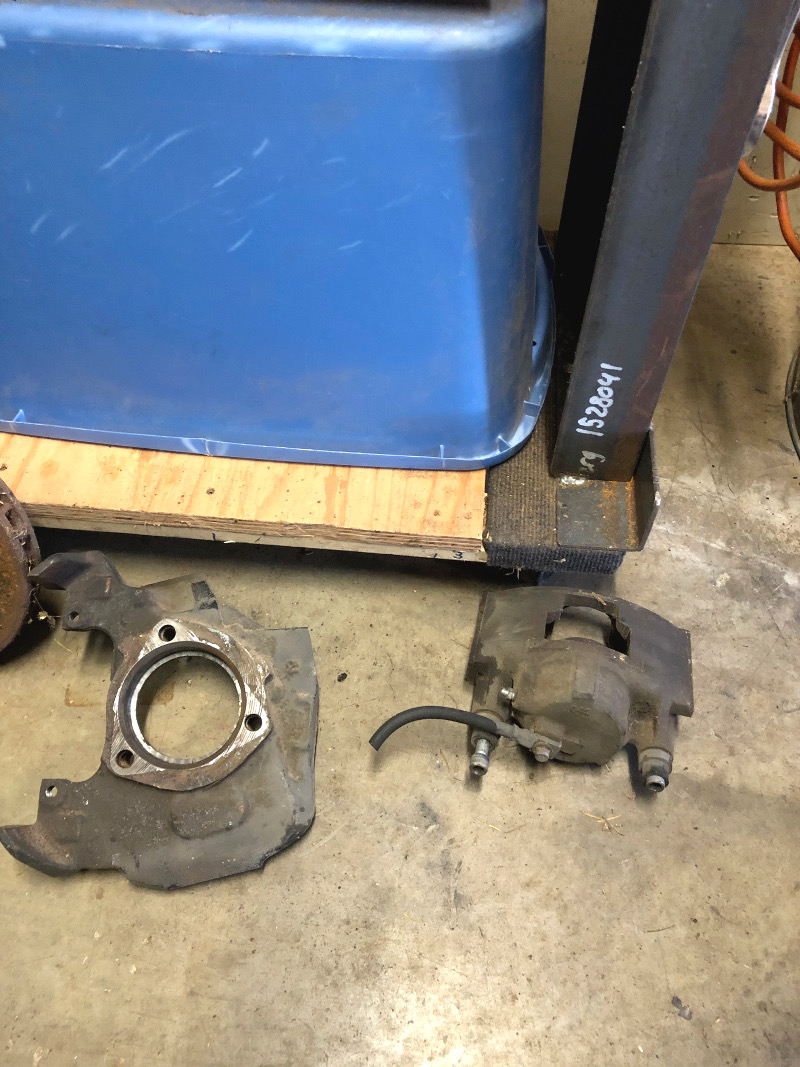

I am still concerned about brakes
AS long as the air is up your golden....lose the air and you are !@#$^D
The 2100 had a pretty herky drive shaft park brake.
I am thinking about ripping it off the C6 and having a look to see if it can be adapted to a TH400.
This is not a mass produced lash up...so whatever needs to be done to make things work is likely gonna be CUSTOM BY ME
The Ford output shaft is a different spline count than the GM TH400
Guess I will need to rip into it and see wasssssup.
I want to keep the factory Park lock in the tranny though.
Big trucks use a spring brake combo chamber for parking and for emergency
Lose the air and at around 20 psi the brakes come on and you are going to stop.....PERIOD
The drive shaft brake would be nice.....Just piece of mind....

Weather cleared a bit and I'm suffering cabin fever bad.
Grabbed the tools and went after the Cat.
I wanted to get as much of the hydraulics nightmare out as possible.
Fitting are in places that no sane person would dream of putting them.
A lot of hoses were started at one end and then the last clowns just built on them as they went.
I started up at the front and plowed into the beast.
Getting some of the hose fittings loose was a real nightmare to say the least.
But I am at the point that whats left is connected to the cab (Rear hydraulics only) so I am going to coil them up and tie them to the cab with the open ends down to keep water out....Somebody is going to want the cab....and having the controls usable.
Terribly sloppy gooopy mess
A bit more work and the cab can come off and we will be ready to muck out the bilge..
After things are a bit cleaner and the weather warms the OC12 can come out and come apart......
A few pics
One showing where I started today.
And the pile of hoses and other crap....

Need anything ????
Tilt cab
Hydraulic pump
Priority valves (3)
Electric emergency hydraulic pump
Complete disc brake on the rear of the C6
Differential oil cooler pump assembly with filter
Main hydraulic filter assembly
These items need a home
Also have most of the blade and rigging
Howdy Snowy,
What does the pump look like and the priority valves? Was the pump front mounted on the front of the engine crank pully?
Pump was front mounted driven by a cog belt
There are 3 priority valves in the cat.
The piccy is of the two that were on the LH side of the tub
There is one still in the cat, but with the cab tilted It's gonna have to wait until I get the cab removed (Soon as the weather improves in a few days)
Here are some pics of the parts..
The system was closed up until the other day....oil looked good..
The pump ports are plugged now to keep crud out.

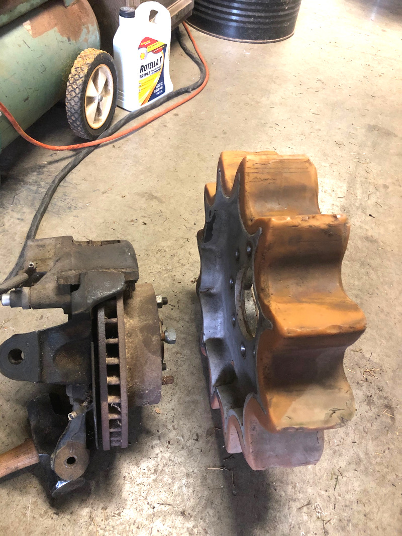

But.....I had planned on a set of rear hydraulic brakes and now was a great time to get going on building some of the parts.
One of our members "Snowcatcrazy" did a nice job adding outboard brakes to his 2100 based Chevy van
After looking over the pictures he had posted of his set up I decided to go ahead and use parts I already had sitting here on the shelf.
The Astro van has a lovely hydroboost brake system and simply rerouting the brake lines from the front calipers on the van to the rear of the cat is a no brainer.
The extra rotors, calipers and knuckle were just perfect to modify and mount.
Here is a piccy of What the other fella did....
I disassembled the suspension parts I had and got a plan going.
Tossed one of the knuckles in the mill and started chewing off the extra appendages that are just dead weight.
The cost of all new parts although not staggering is hefty....and the used materials will be just fine and using the front caliper from the van chassis will keep the system basically intact.
Today I need to clean up the mill area as it is getting to be a mess.
Then the knuckle goes back on the table and the last large bump comes off
The factory knuckle will work sweet to hold the caliper as these are non bracketed calipers

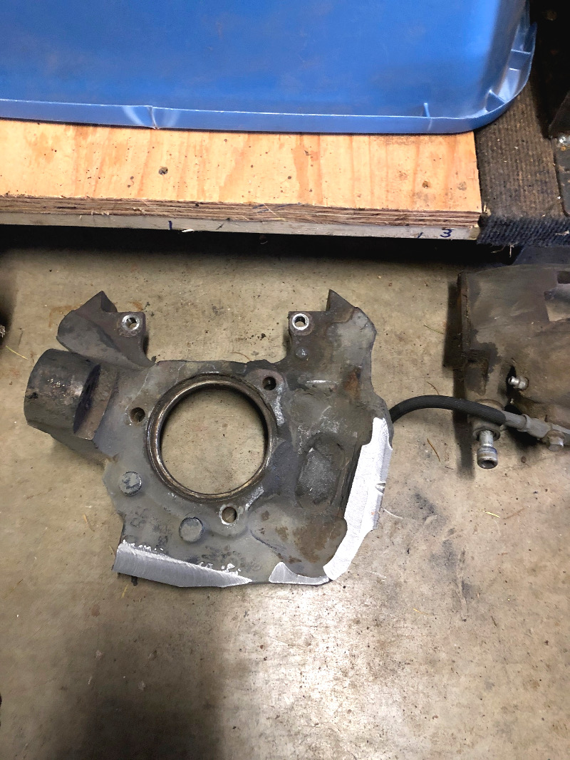

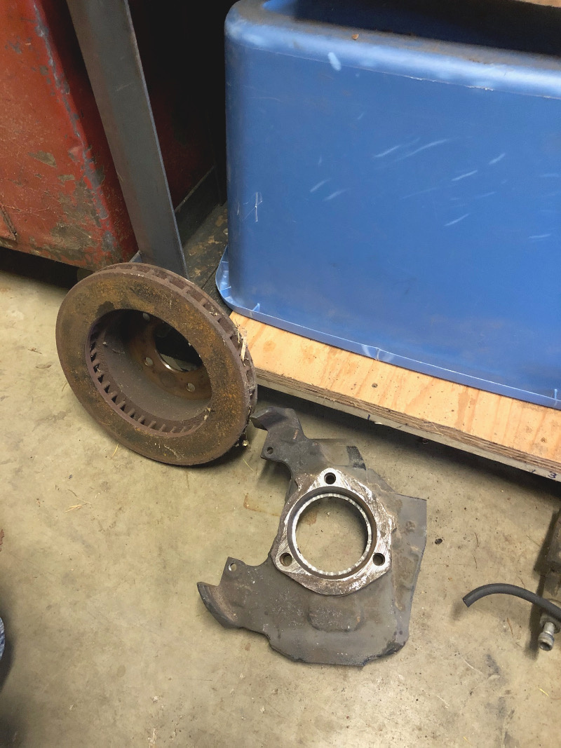

Yesterday was pretty mundane.....
Tore into the other brake knuckle and ripped off all the extraneous parts.
Got it all down to just the knuckle, caliper and the rotor.
I do not feel all warm and fuzzy about hanging the caliper on a bracket without support from the axle as the original does.
I am leaning towards adding a bearing into the original bore that the wheel bearing occupied to support the entire brake reaction assembly, and then adding the bar to the frame to vector the turning motion....
Doing this will take a lot of stress off of the reaction bar that fastens to the frame.....
Technical stuff.....nothing real fun to see or talk about, but now is the time to sort it out while there is nothing in the way on the frame (TRACKS)

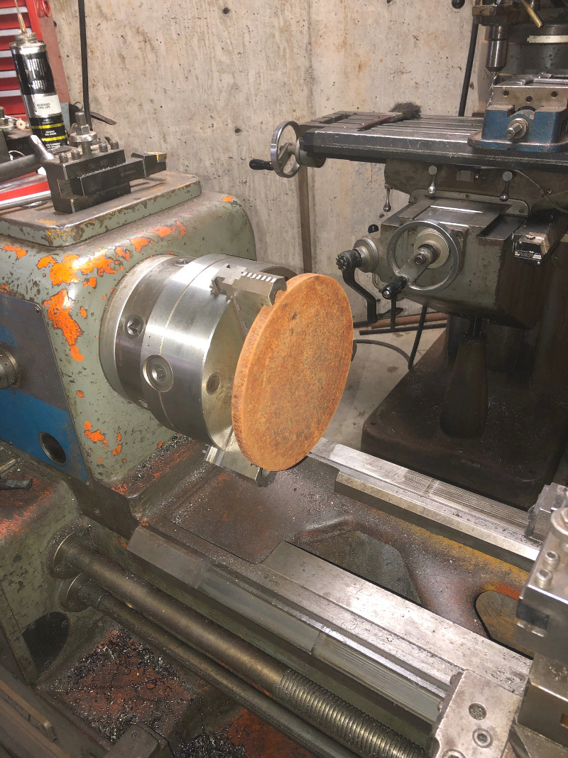

Update on the brake engineering...(Imagineering)
Spent a couple hours measuring and fiddling with the Brake hardware yesterday...
The plan is looking really good now.
I need to fabricate and machine (2) two adapters that will allow the 5 bolt Astro brake hub to bolt to one side and the other side to bolt to the 2100 axle (Piloting into the sprocket and using the original 8 lug studs...albeit we will need to swap out the studs for longer ones to allow the extra flange to fasten up)
I need a piece of 4" schedule 80 steel pipe and 4 round burnouts 5/8" thick x 7-1/2" diameter
The dimensions are looking good...just need to get a wheel guide off of a track to finish calculating the distance out from the sprocket to set the brake assembly.
It would suck to end up with the tire guides hitting the caliper :OhNo:
Lets hope I can get some materials today.

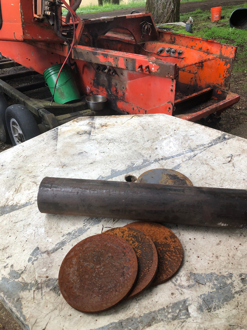

Well I called the shop in Salem...They only sell the 4 inch steel pipe in 21 foot lengths....I DON'T THINK SO////
Found a steel outlet closer to me that had the 4 inch schedule 80 pipe AND they had a huge selection of water cut rounds.
I got 2 feet of the pipe and four 1/2" x 8 inch rounds. $62 for all of it....
The water cut rounds do not tear up the carbide tools :clap:
I got some measurements off of the wheel guides and was able to get some good dimensions for the length of the adapter.
The plan is to torch the bolts off of one wheel guide and get it out and in my hand so I can be really sure of the offset for the brake units....
Some pics of the steel pieces and the brake unit sitting with the sprocket....
With the good weather I think tomorrow will be a day to work at getting the cab off of the Cat...
But .....with the steel parts I can start whittling away and build the brake units....

THE CAB IS FINALLY OFF
Got after the cab this morning and worried out the rusted bolts holding the cab hinge onto the tub.
Then came the tedious task of grinding off the welds that some clown slobbered on the hinge to fasten it to the tub???????
A bunch of 7/16 bolts holding the hinge on, so why weld it.
After a couple hours of careful grinding the cab was ready to come off.
Still gonna have to weld in and fix the gouges I put in the top rail of the tub.
No real biggy....just a Pain in the butt.
The skid steer made quick work of the cab removal once it was loose.
Tomorrow the plan is to start mucking out the bilge.
Got the little tractor handy to carry the junk off to the burn pile.
I am thinking that the next step is to jack up the rear of the cat and get the Diffy out and start getting it apart.
I know the drop boxes have water in them, much as the diffy did.
Once the diffy is out it will be a good time to hit the bilge and the rest of the cat with the big hot washer.
