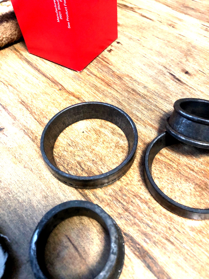

Did some snooping around for the bearing retainer rings..
Nothing....custom part only...

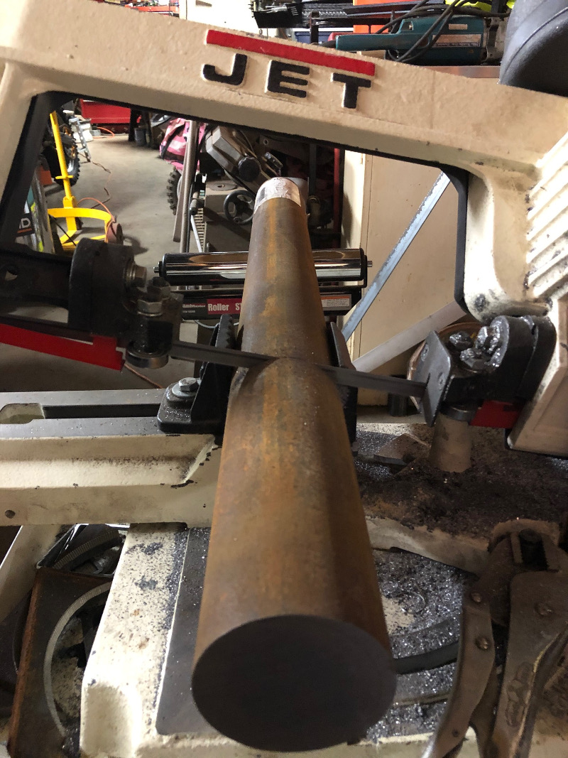

So I decided to go on the snoop for some steel seamless tube close to the right size.
Nobody had any short pieces, and one outfit had a 5 foot (Must take it all)
$370
NO WAY......I do not need 5 feet of that stuff laying around the shop.
Another big steel supplier did not have any seamless tube, buttttttttttttt...did have a 3 foot scrap of 3" 4140 round bar in the drop box
FREEEEEEEEE WAS A MIGHTY GOOD PRICE....30 MILES ROUND TRIP

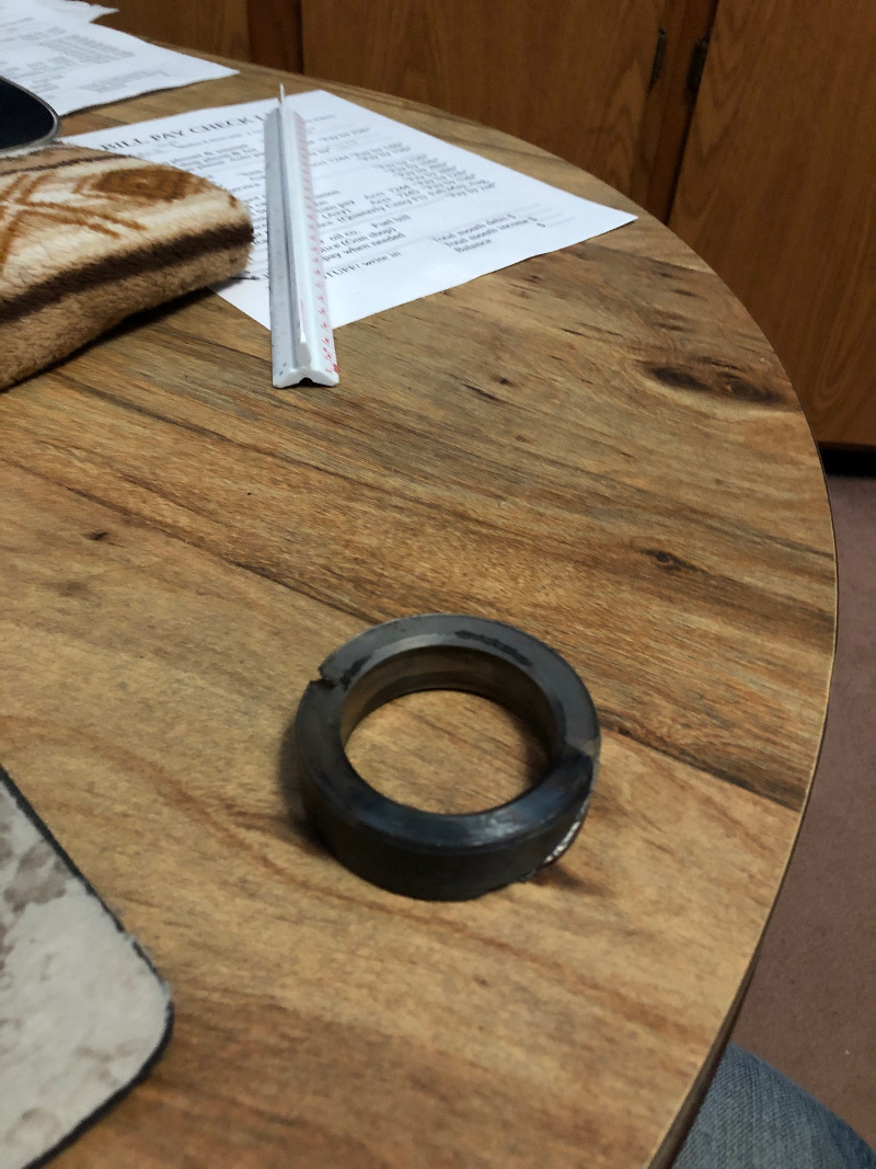

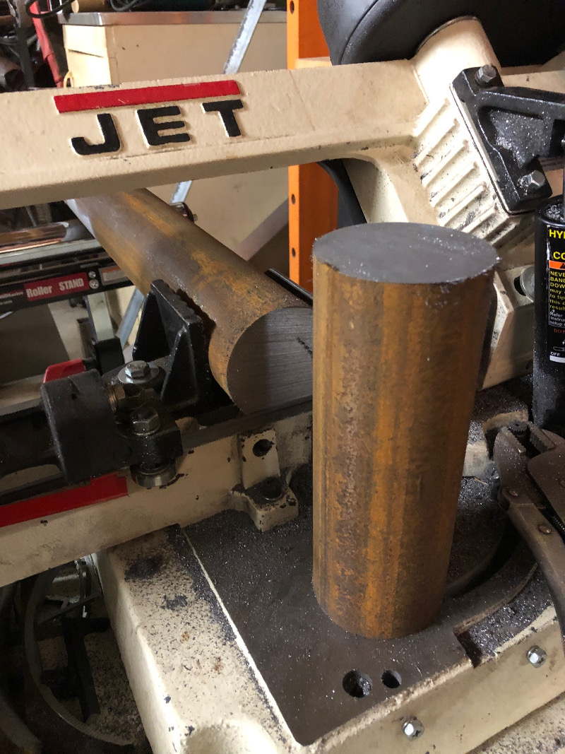

Gonna get that bad boy in the cut off saw and chop off about 10" . 4140 machines very nice, far better than regular cold roll or hot roll mild steel....some of that stuff is like machining mud....nasty rough finish...
That will fit nice in the lathe and then I can start whittling on it.
Wont take much to trim the OD down to 2-3/4"
Drill a hole in it....I think I have a 1-1/4" drill.....anyway, big enough that I get a boring bar in and get it out to size.
I am thinking about .004" to .005" smaller than the shaft size.
Warm that bad boy up with the torch and drop it on behind the new bearings.
Would have been nice to have a seamless tube, but ya know what they say about "GIFT HORSES"
I am very happy to get this chunk of bar stock......3 feet of this is HEAVY TOO.

After breakfast I'm going to get that big chunk of steel in the saw and chop off a piece to work with and get started making the new retainers.

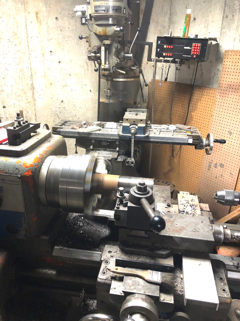

Be really sweet to have a CNC....But around here we have to do things the old fashioned way......
My little machine shop is cramped, but with the mill and the lathe many things can be readily whipped up..
Found the mill on ebay back in 2004 and grabbed it quick before I discovered it was in LA...OMG...ROAD TRIP
All manual 9 x 42 Max mill.....
I ran Bridgeports when I was in the mill industry, and this little clone is every bit as good......
The guy who owned it before me made Soap box derby car parts....certainly no stress on the mill.
Also, most old production machines will have the ways all worn out in the middle.
This one is good all the way across.....
So now it gets to make snow cat parts.
The lathe would be better if it had a longer bed....
I would love to have a rig with an 8 foot bed to be able to do drive shaft work..
Ah well....such is life.

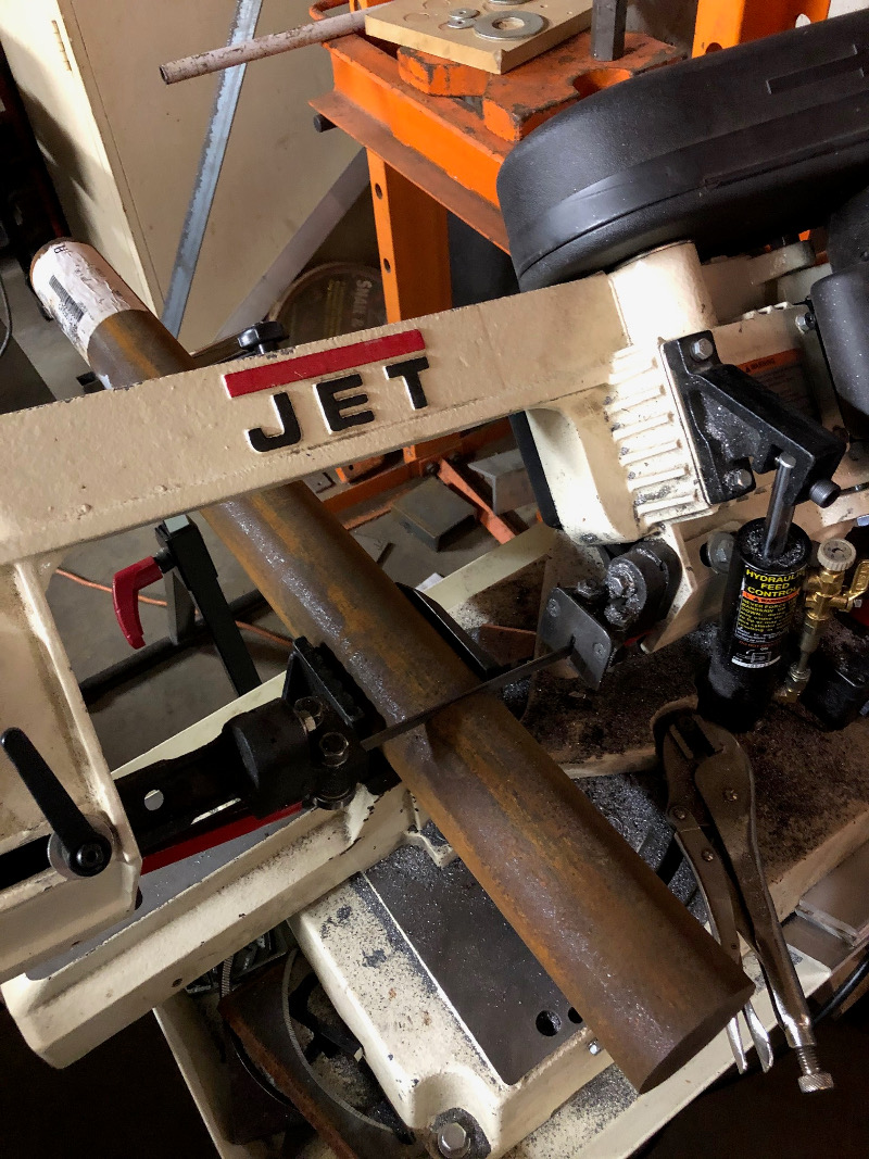

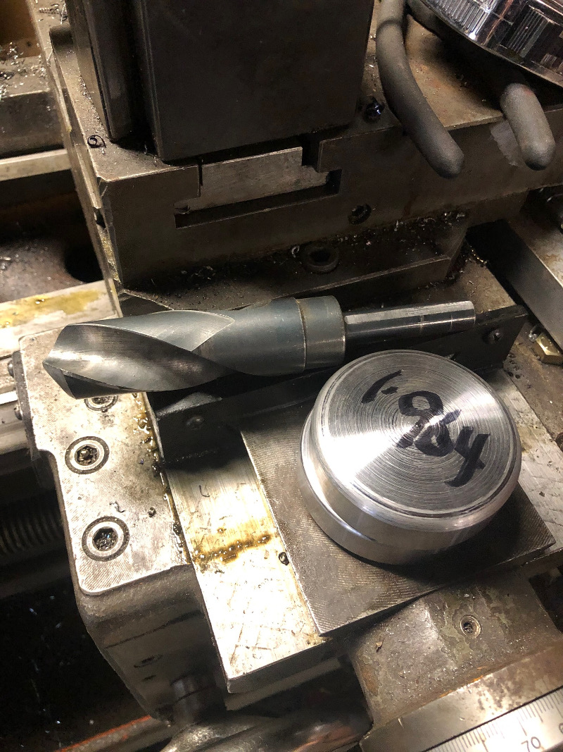

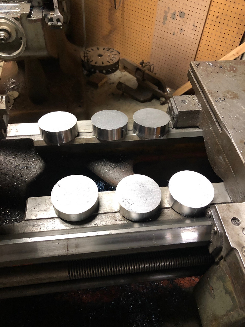

Got started making some bearing retainers
Got two ready to bore the center hole.
The little Jet saw is OK but it's not a production shop saw for sure.
Chewing on 3" 4140 took some time.
Two ready now for the center bore.
1.964" (Bearing is 2.9685 and the shaft is 2.968")
Cut six parts while I was at it.
Going to finish 2

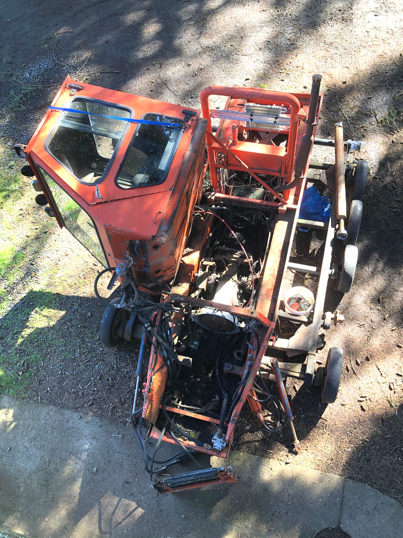

Good weather has graced us for a few days and it's time to get the cab tilted up on the 2100 and work at clearing out the junk in the belly.
The old C6 tranny is nearly full of water (Dip stick left out) so that thing is pretty much a junk pile.
It needs to go away.
Once the tranny is out that will open up a lot of room to start cleaning stuff up.
The belly is chucked full of oil soaked long pine needles and any sparks from a grinder or a torch would set the entire cat ablaze...
I Do not want to burn my prize to the dirt.....
I got the cab rigged with a nylon strap and ready to hook the "Li'l Red tractor to up to the beast and see if we can tilt it full over.
The restraining arm on the rear is still in good order.....so the cab should lay over easily.... I HOPE
After breakfast I will give things a go and see wassssssssup....
I will get some pix as this unfolds.
I gave the cab a tweak with a big pry bar and it seems to be free to move.
Some good skunk piss on the big hinge likely did not hurt things either.
See what happens......

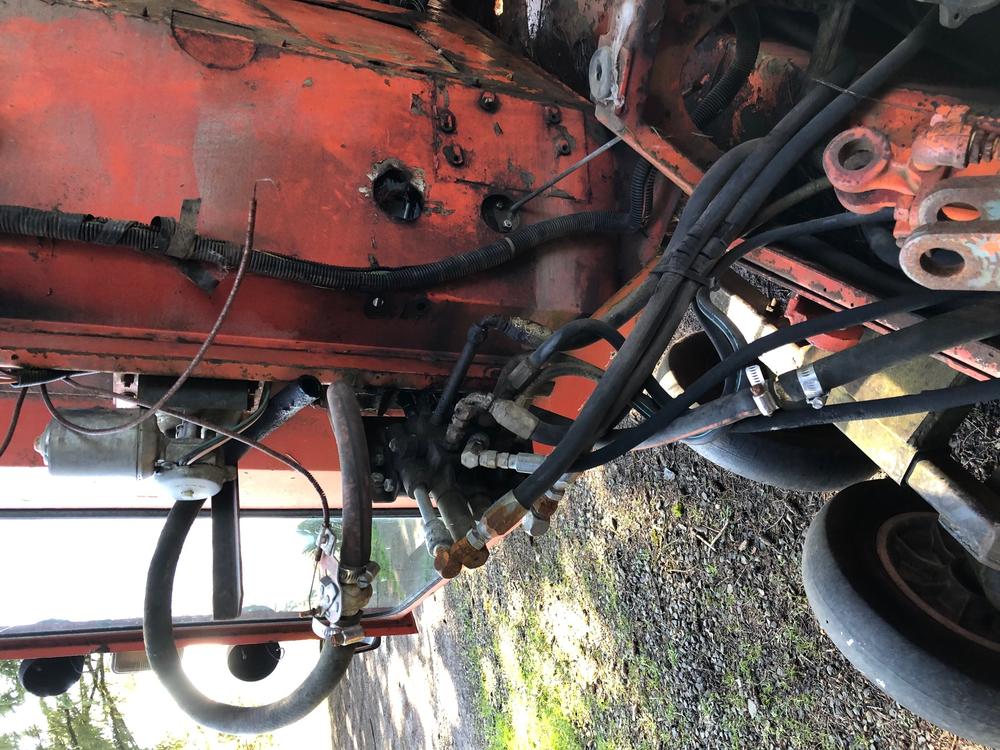

I need to try and sort out the hydraulic hose routing and such for the blade.
I have a fella who wants my blade and I want to make life as easy as possible so the routing of the hoses will go smoothly.
The entire belly is a mess.
The clowns that yanked the engine could have cared less about much.

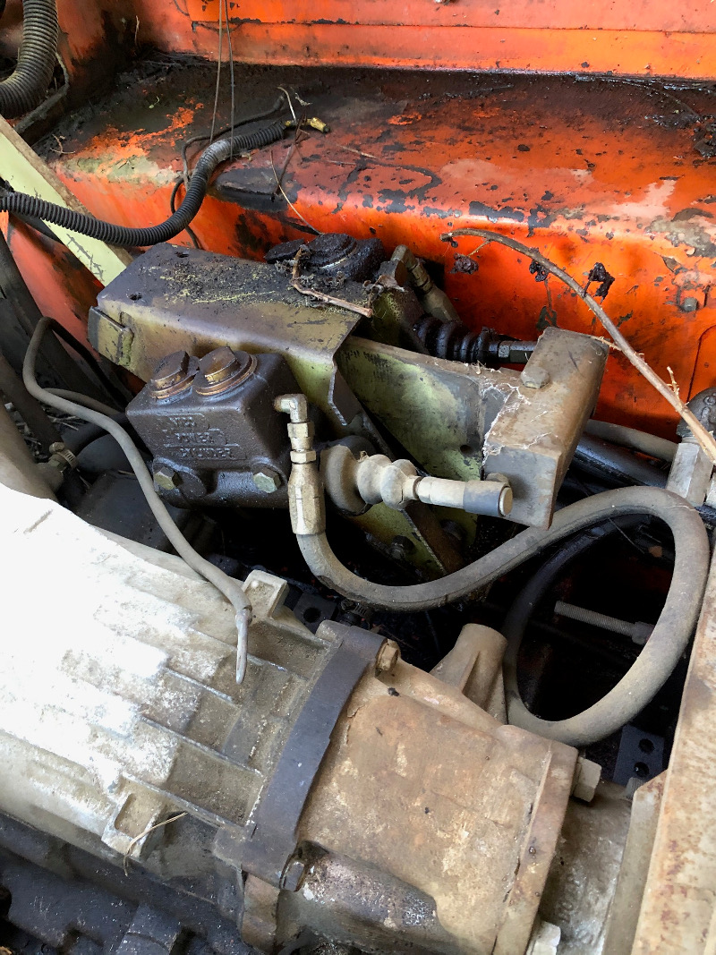

To get the tranny out I need to remove the double mico cylinder foot brake system..
Then I can get at the rear tranny mounts.
Unhook the safety brake cable, tranny cable, and a few other items and the gearbox can be plucked out with the tractor bucket.
Got the drive shaft out...looks good...someone will want it..
Same with the Foot brake system...
Got the fuel tank off as well. WITH THE BANDS IN USABLE CONDITION :clap:

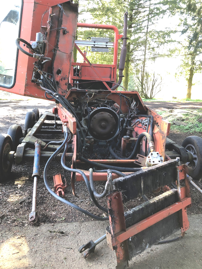

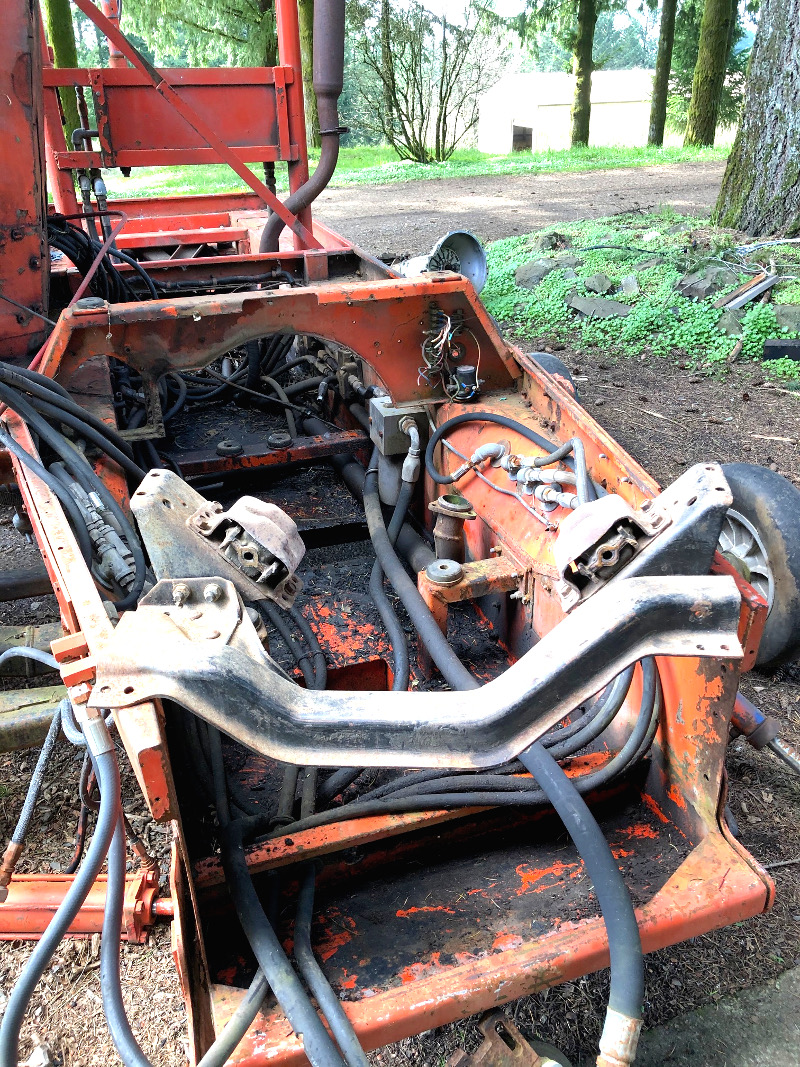

Today was another lovely day to work on the cat.
The plan was to get the dual foot brake setup out and then the emergency electric hydraulic pump unit out.
This cleared the way to to be able to lift the tranny out.
After digging into this cat.....it is becoming ever so obvious that this cat is A MUTT.
Way too many things have been modified and likely added to this cat after it left the factory.
The dual foot brake setup was one such item
No way would Thiokol have built such a cobbled up mess....
Looks like it worked, but the bracket was a mixture of things all bolted together.

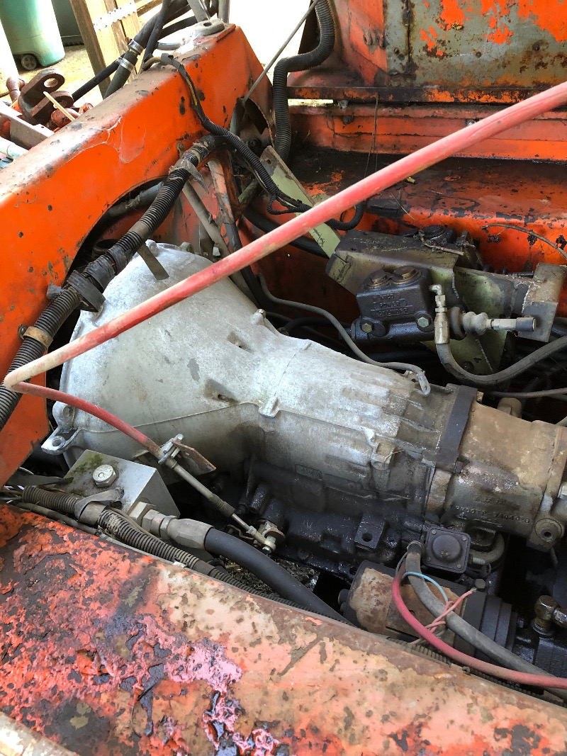

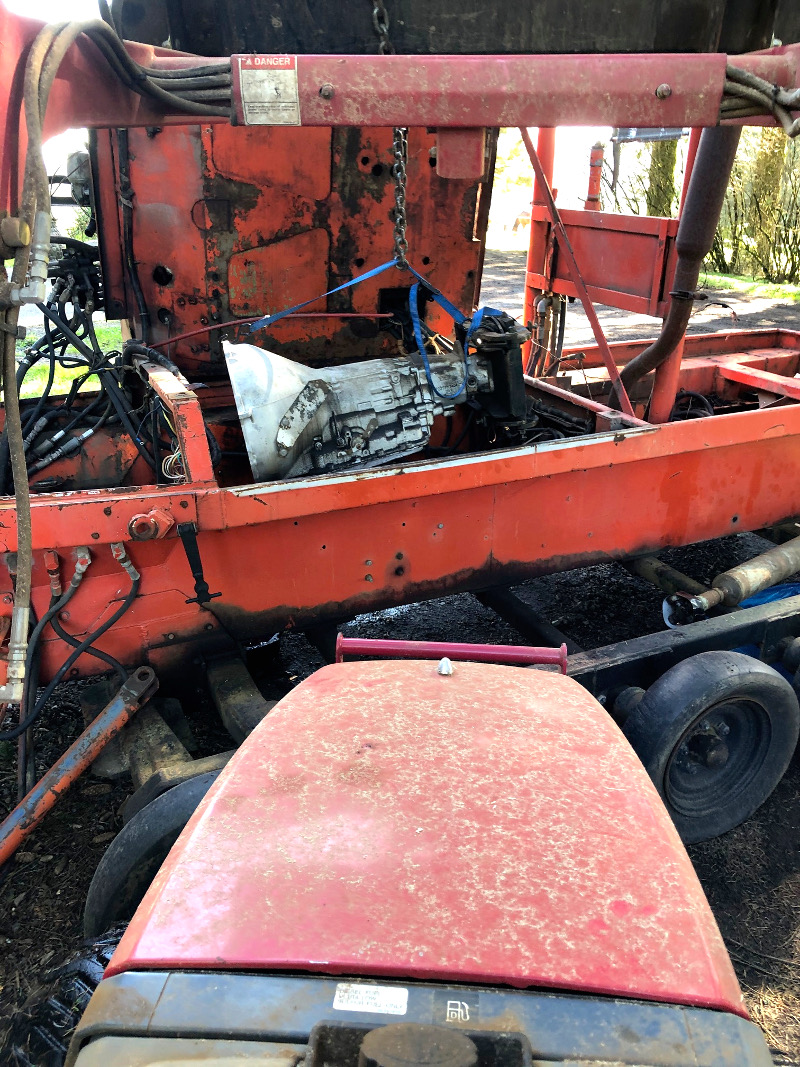

Finally got the goodies away from the tranny and worried the bolts out of the rear tranny mount..
With the tranny lose and the park brake cable unhooked it was time to get the little tractor up here and try a lift..
Bucket too short....had to mickey mouse a wooden piece to give us a tad more length of reach.....
Rigged the tranny up and it came right out.
A pix of the tranny with the added deep sump pan.
The park brake assembly added to the rear of the gear box is quite the unit.

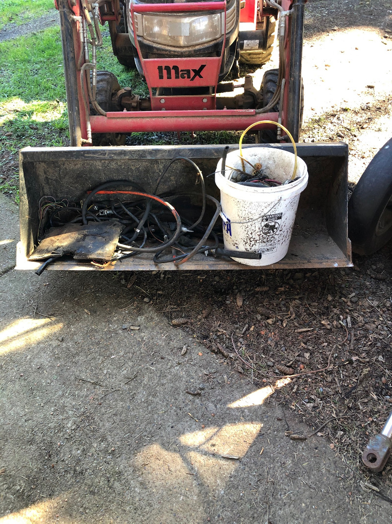

A shot of the special WIRE AND HOSE REMOVAL TOOL :thumbup: (Tree trimmers)
A bucket load of trash for the garbage.
Hauled away nearly a full bucket of crap out of the front of the belly pan.
And the booty.
Found a lovely little PROTO short double end wrench buried in the goop....DEEP
Used to belong to Alonzo....mine now...
I had scraped up a double handful of oil soaked needles and crap and tossed it at the bucket on the tractor....CLANG...Hmmmmm...went snooping and found the wrench...
Tomorrow will be time to start yarding out hoses.
Gonna be an oily mess.
I got pans and buckets to catch all the we can catch....
The one cooler up front was for the tranny, but had been unhooked and the POS hung on the head ache rack used..
The second cooler up from was from the Diffy cooler/pump setup.
That entire cooler unit is headed for the trash.
Looking at the cab hinge.....a bit of grinding as some idiot welded the hinge in a few places to the cab...
Once the hinge is free the cab can be lifted off easily with the Skid steer.
Some lumber in the bucket to shield the cab from damage and run a strap over the cab and tie off to the lift ring on the rear of the bucket..
Remove the hinge bolts and that bad boy will be off....
I am thinking about leaving the hoses from the cab controls hooked up to keep water out of the valves....
Starting to get a lot closer to what I need for the van cat......
Kitty and Li'l Red all tucked in for the night.....

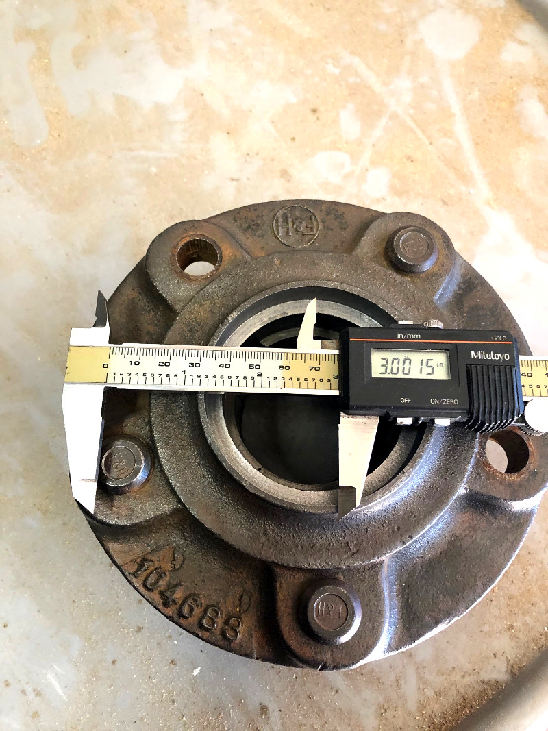

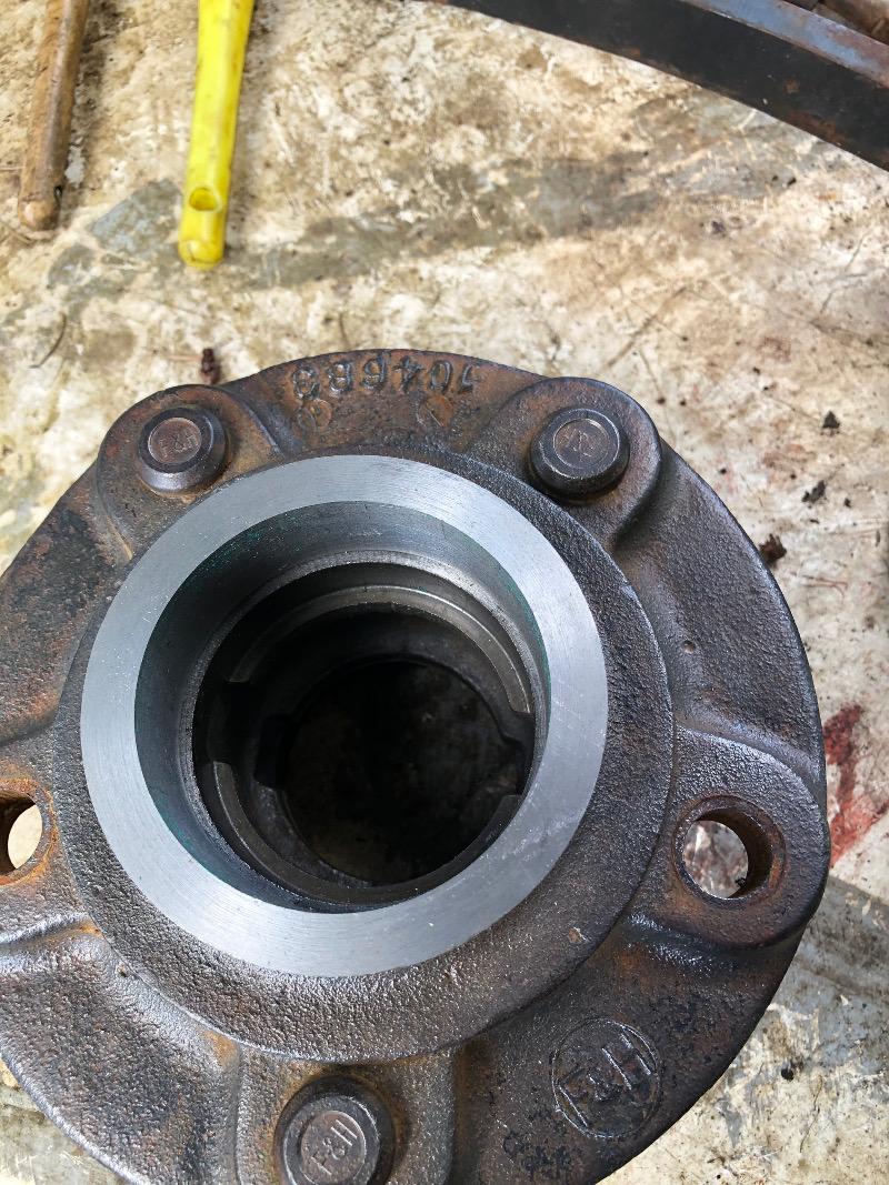

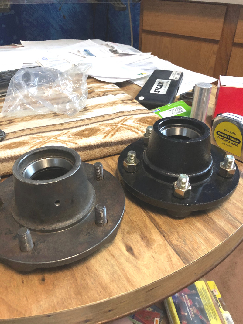

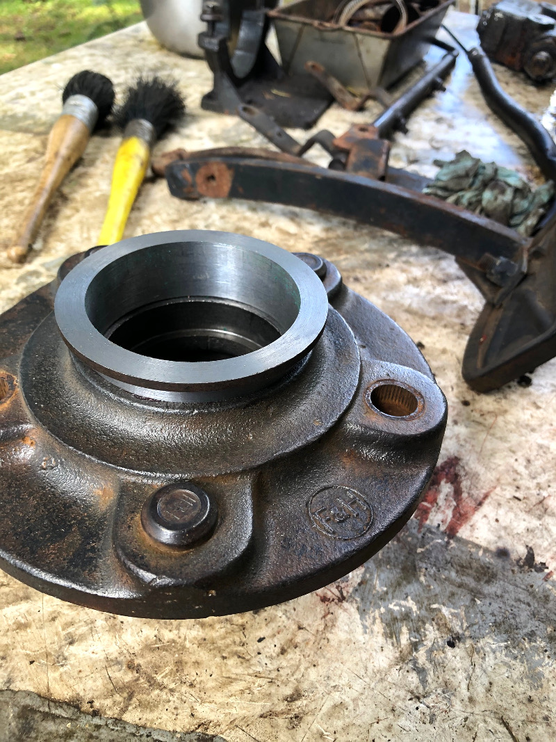

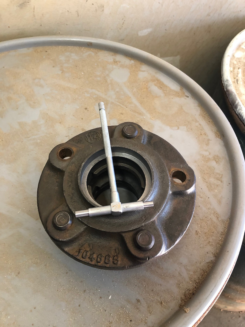

Got busy today and decided to clean up and have a look at the one axle spindle that had the hub laying loose when the cat cam home.
Lucky we even got the hub.
The bearing races were on the spindle and things are good to go.
Bearings were totally chewed to rat crap...
But the hub and spindle are usable.
The seal was a wadded up mess.

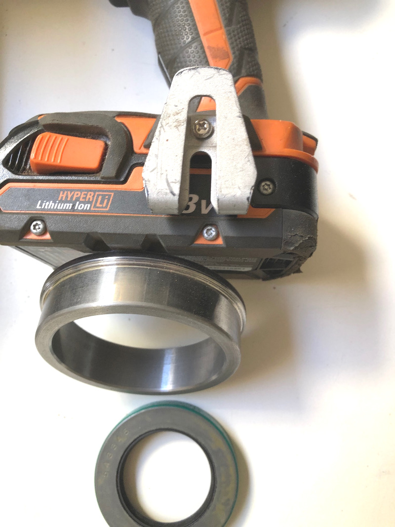

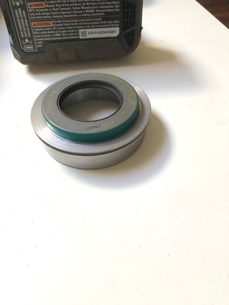

Took of on of the others to get the numbers off the seal

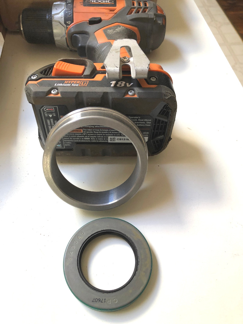

Factory seal C/R 17616 single lip seal.
I did some snooping and am going with a 17607 which is .438" wide instead of the .359" wide on the stock seal.
The 17607 is a double lip and should help keep water and crud out better.
The other hub I pulled off had the seal in there....but the seal surface rubber was gone..
Just the metal ring that holds it.
All the bearings are going to need to come apart.
I needed a dust cap too..
NAPA STORE HAD THEM IN STOCK 730-2411
I will likely replace all the old ones with new, as some are beat up from a clown hitting them with a hammer.
A tool to install these WILL BE NICE....ALUMINUM DRIVER RING SEEMS REASONABLE
The caps are $2 at NAPA
Using the thicker seal will get the seal onto nicer metal....and having two lips will help....

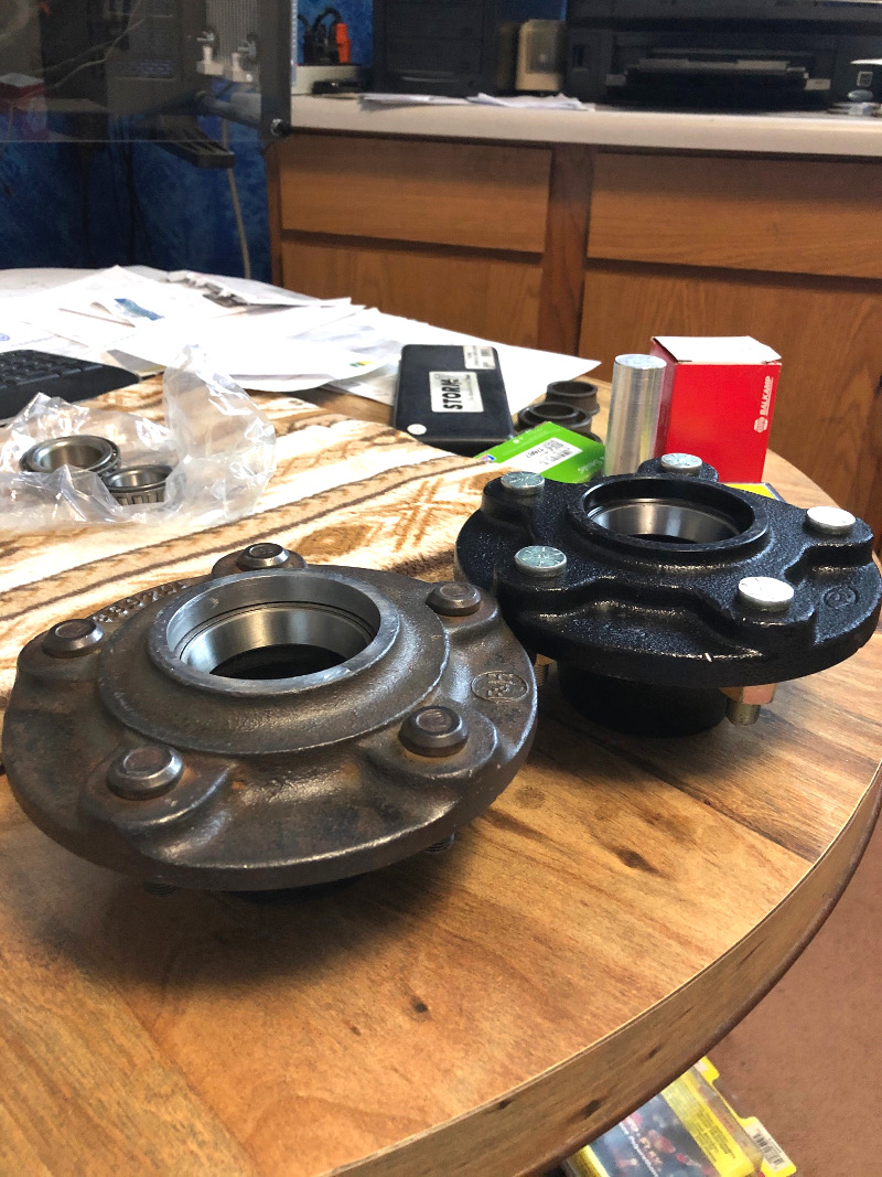

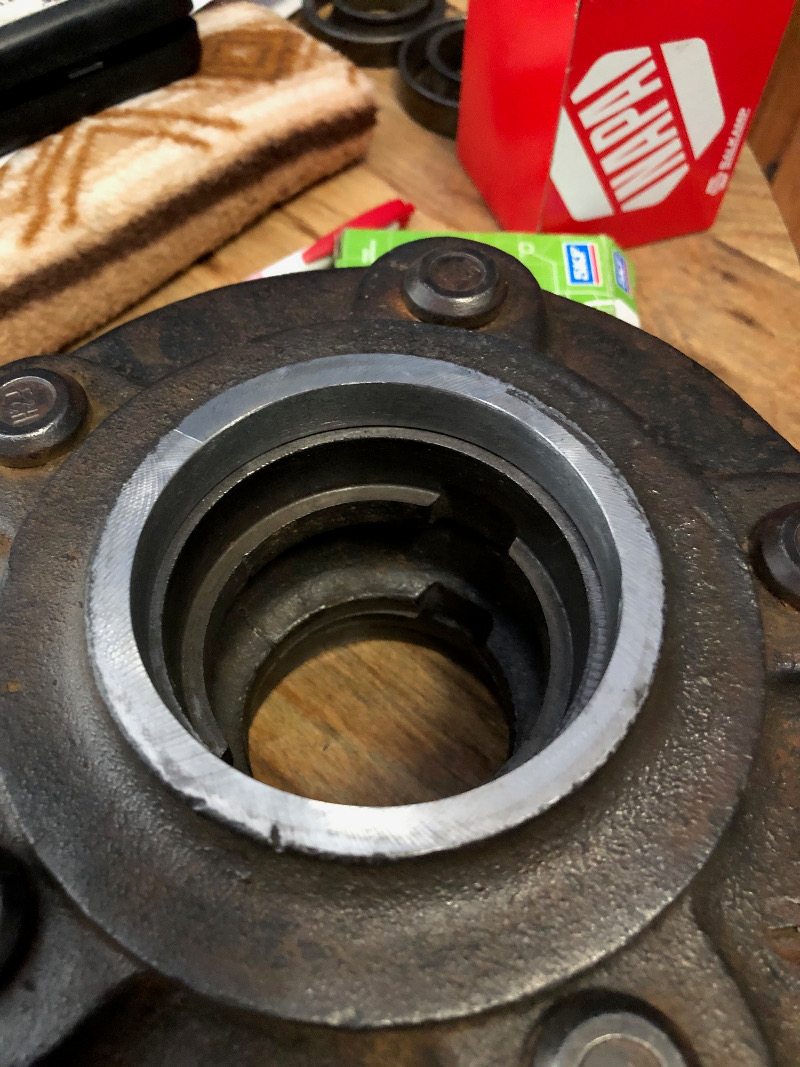

UPDATE ON THE 17617 SEALS
After doing more snooping on these seals...there is a difference in seals depending on who makes them.
The number 17617 crosses to several manufacturers and many seals that are the proper size are not the best choice.
The original seals were a heavier body construction and the lip could be aimed outward which would keep more crap out and allow the hub to be greased using the zirk fitting.
Installing the seal in this fashion will require making SURE that the edge of the seal surface on the spindle that faces toward the bearing is rounded slightly and smooth to allow the seal lip to ride over the spindle seal surface properly.
When I pulled the second hub off the cat to get a number I noticed that the seal rubber lip was gone.
This was likely the result of someone just slamming the hub on and not paying attention to what was happening....
The wider seal I am getting today has 2 lips...this may be a better choice BUT greasing the bearings with the zirk will not be an option due to the lip seal facing inward... THE SEAL WILL NOT ALLOW GREASE TO ESCAPE and pumping in grease could push the seal out..
Any of the seals the proper size can get you by...but water entry from being immersed in the fluffy snow (Melts and can seep into the bearing) can be an issue with the lip facing inward.. *****I think Thiokol had this figured out as further looking reveals two of my wheels have the lip seal facing out *****
MORE INFO TO FOLLOW AS I GET ACTUAL SEALS IN MY HANDS AND GET A GOOD LOOKY SEE AT THEM.

I got the C/R 17607 SEAL IN MY HOT LITTLE HANDS.
This seal has a nice outer lip to shield against water and the inner lip faces the bearing.
Pack these bad boys with a good waterproof grease and they should be good to go.
Just lube the seal and the spindle well and life will be good..

My hub is just rough enough in the seal bore that I do not want to try to mickey mouse it.
Too hard to see the seal once the tracks are on the machine.... and even more misery if it fails out in the field.
Snowed last night...cold outside...but spring like weather in a few days.
A few pics of the messed up hub.
Will be nice to have a new hub on that spot.
As the weather gets nicer the cab is coming off and the belly of the beast is going to get a super wash job.
One at a time each wheel hub gets to see a good wash job and either the bearings washed up and repacked (Or replaced) and a new seal installed.
Once the cab is off it will be way easier to get at the tub.
After a decent wash job ...then the head ache bar is getting the chop....
Once we are into more decent weather the OC12 gotta come out and get ripped apart.
Good weather will definitely make this far more enjoyable..

After finding a piece of 3-1/2" shaft in the corner I cut off a chunk and started whittling on a repair ring to fix my one hub.
I just could not stand seeing it sitting on my table in an unusable condition.....
I turned up the ring a bit heavy and finished the bore to allow the seal to JUST FIT with thumb pressure.
I will go ahead and bore the cast iron wheel hub out to give about enough room to accept a ring with a tad over 1/8th" wall thickness.
Gonna turn the ring down so we have .004" interference fit on the cast hub.
Gonna press the ring in and then machine off the excess in the mill.
Sadly, without a bunch of fooling around I can't grab the hub in the lathe.
There is not any finished surfaces that I can grab, and it would take machining up some plugs to press into the bearing bores and then insert a shaft in to drive the hub....Too much work.
Just mill off the excess....good to go........

I really want to get the old Hydraulic hoses yanked out of the cat and the cab pulled off.
As soon as that's done I can get after hot washing the beast up so things can move ahead.......

Got after the bad boy hub.
Drove out a couple of the wheel studs so I could tie the hub on the mill table.

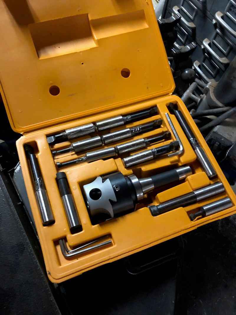

Got the boring head off the shelf and in the machine.
****This is an ebay special, over seas made boring head****
I have used the top end Bridgeport boring heads, and this little goody works as good as any of the $$$$$$$$$$$$$ Bridgeport tools....It was CHEAP TOO
Indicated the bearing bore in and locked the table down.
Started the boring head up and aimed at a finished bore of 3 inches.
Finished after it cooled at 3.0015" cooled off.
Decided to make a weeeeee change....so I machined a new ring and modified the dimensions a bit.
The seal was just at a thumb push.
Machined the OD of the ring to give .006" press fit.
I did press the ring in with the hydraulic press.
Tossed the hub back in the mill and trimmed off the excess ring.
(If I could have grabbed the hub in the lathe chuck it would have been sweet...
But that was not gonna happen....
So just cut the excess off with a fly cutter and then debur'd it with the die grinder and a whizz wheel.... Good to go...
Seal will drive in as it should now.....
A piccy of the ROTOPHASE (Gives me 240 3 phase power to run the machines..... Sweet little gizmo....
Used an easy out to dig out the broken grease fitting from the hub.
Aside from a bit of residual rust, this old girl is ready for prime time once again.

OK TROOP
I got one of the new hubs today.
Measured that bad boy up...
The critical dimensions are all good to go.
The hubs are a slight bit different if you look closely, but the inside of the inner bearing to the outside of the outer bearing (Cone) are right where they need to be.
The casting is a slight bit heavier and uses a tad longer studs....but these bad boys are a well made replacement hub....
The pilot register is a bit thicker height wise, but the diameter is the same.
I am going to slip the hub assembly onto the spindle tomorrow to get my final assessment of the hub with the bearings instsalled.
Here are some pix

Got the digging around done...
Found the GM truck engine cradle I went looking for.
It will need a tiny bit of trimming to fit into the tub.
A pair of steel angle rails down the inside of the tub will allow the factory Chevy mount assembly to drop in and be either bolted or welded to the tub
Not going to get real crazy on this right now.....I think it's best to wait until what ever engine presents itself to see what will be the best way to go.
The after market hot rod industry makes some very nice mount kits that are priced in the affordable range ($80)
The mounts are clean, neat and do not take up a lot of room, at least not as much as the GM factory piece
