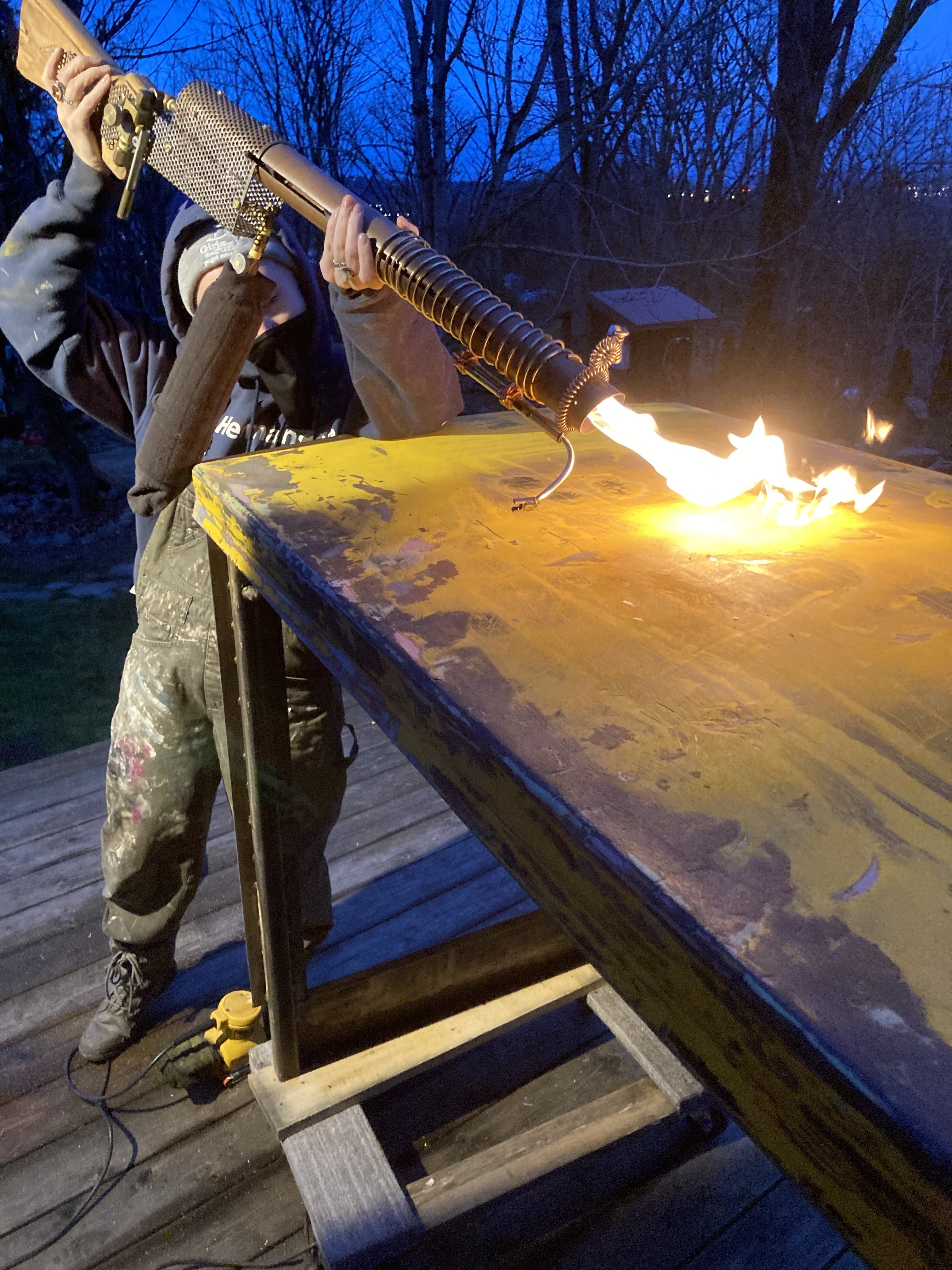

But first this sweet pic of my girl when we were poppin some big dents in the roof. One off flame thrower I built a few years ago that runs on map gas bottles. Never thought it had any use other than lookin cool. I was wrong.

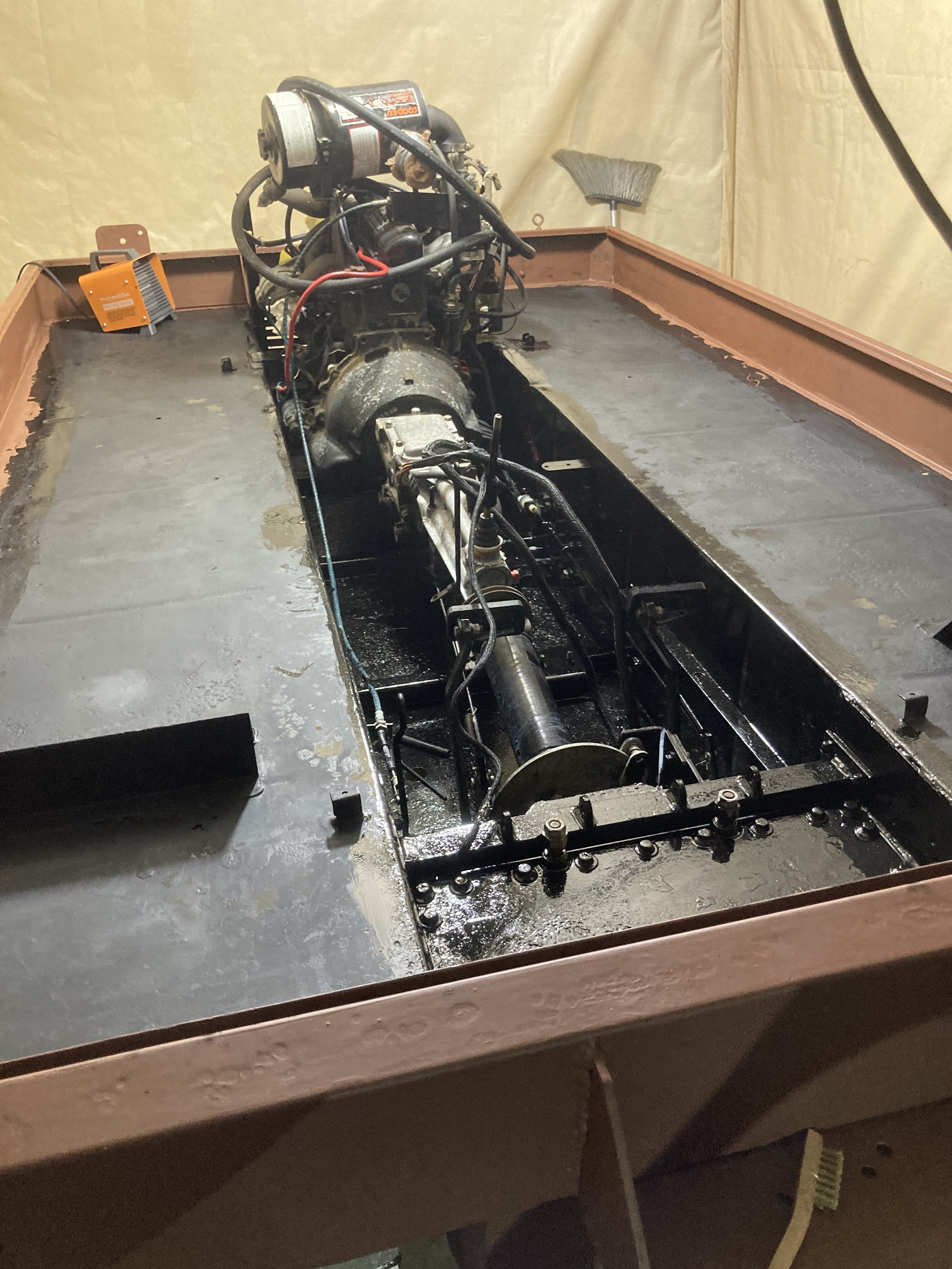

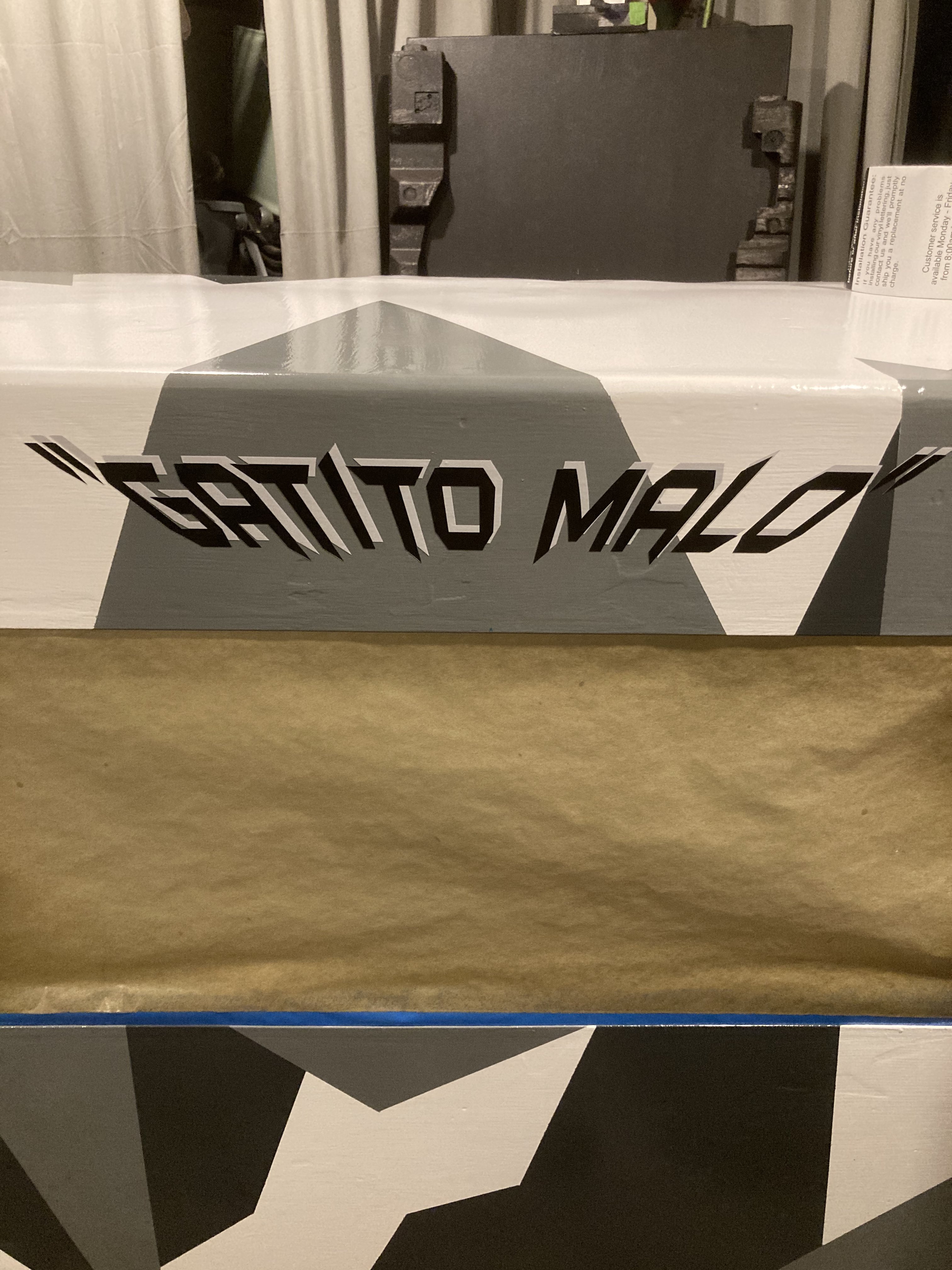

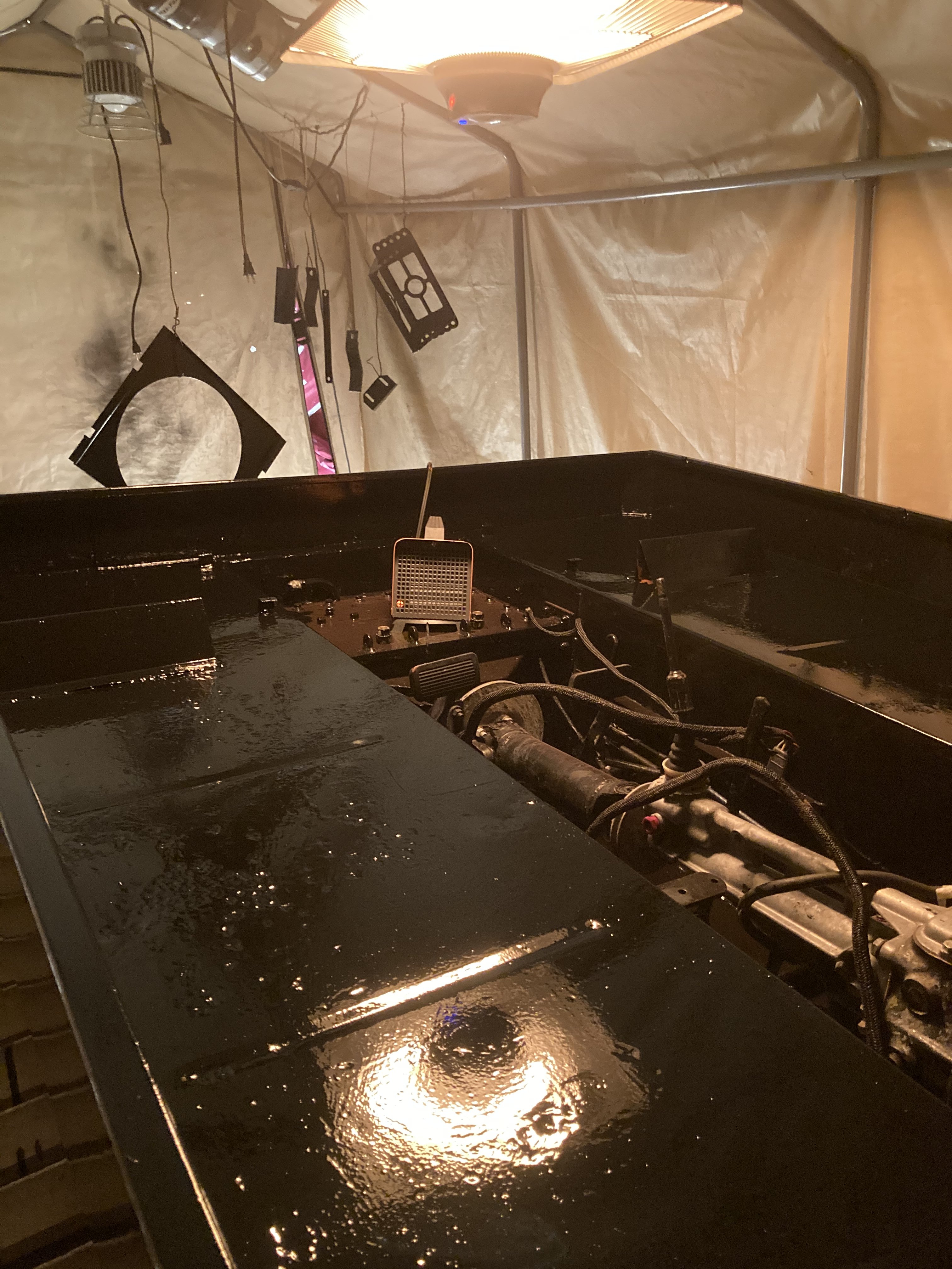

Man, painting..... I’m a painter by hobby and this was a lot of work. 73EB4D4B-B0B5-46D3-B084-D51545CF5746.jpeg
Had too!!! ?
por 15 base, primer and gloss black rusto. Would have looked a lot nicer had I sprayed the chassis but...... is what it is. It’s protected now and looks 10x better than it did

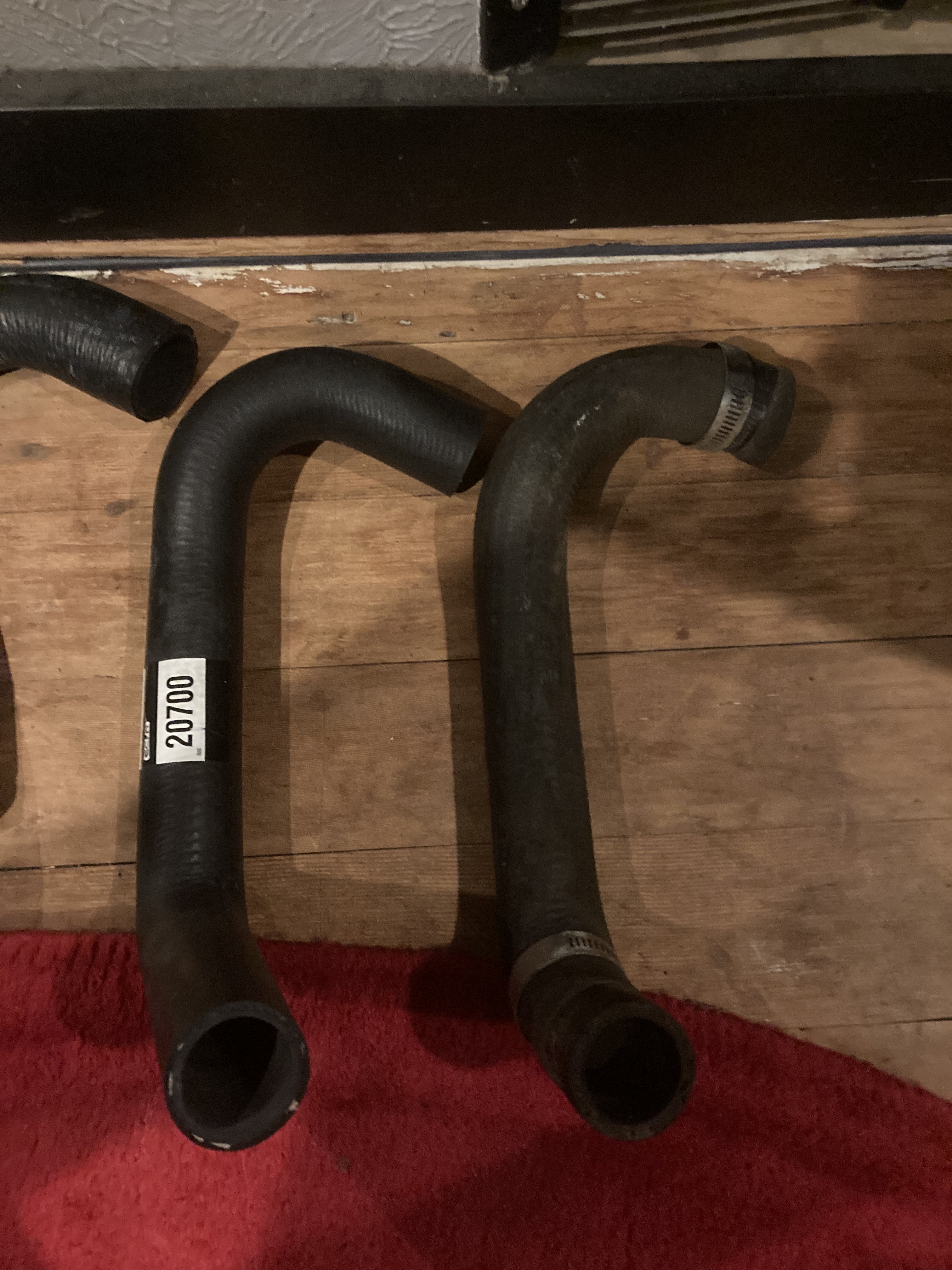

Hey @Bobcatbob got part numbers for the radiator hoses or do you typical just use the flexible make your own shape hoses.... wait let me guess, you didn’t have to replace those? man.... I paid too much for this heap. Well like a bad stock purchase, ride it til the green!!!

I tried to find stock replacement hoses for the Bombi...both odd balls. I ended up using the old hoses (which were in pretty good shape, though when I refurbish, I try to replace all rubber and wearables). I have a bunch of gates hoses I bought....just couldn‘t make them fit (that top hose is a Chinese noddle).

For the radiator hose, I'm gonna cobble something together. Saw a good video from NAPA actually on restomodding coolant hoses. They had a novel plan. Get the bends you need in rubber (preferably gates and not silicone) and join them together using straight pipe and clamps. I'll go this route. And yes that top hose is the most oddly shaped radiator hose I have ever seen.:ROFLMAO:

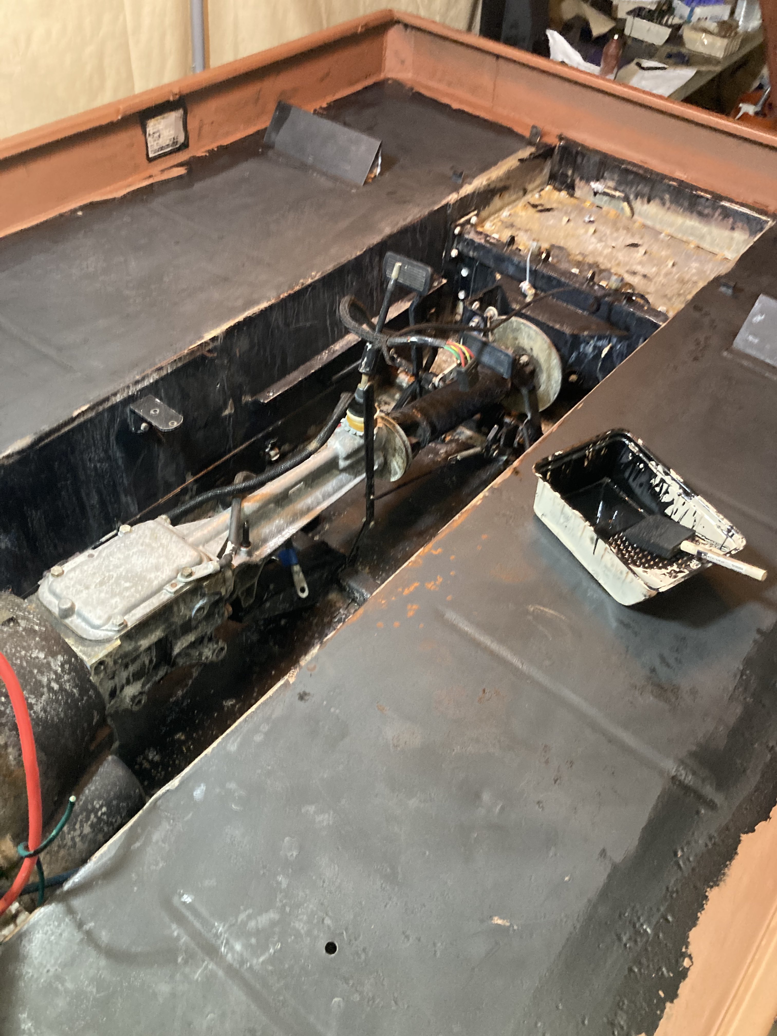

Chassis Paint inside done- Lesson learned.....Don't spend the time I did to only paint half
Gatito get fresh air for the first time in months.
New Battery tray- I couldn't paint, sand , clean or do anything under the old one and figured the next person that tore this thing apart would appreciate that I solved that problem. Bolt up! Too many things on this bombi that should have been bolt on. Like the foot rests...

BOB!!!!! I think I found the radiator hoses
I'm pulling the trigger 1973 pinto Gates PN 20700, 20701 WOOOOOOOOOHOOOOOOOOO:coolshade
You’re the man! Let me know how they line up. Really like the mufflers you and Hillbilt went with! (Is that a cherry bomb muffler? If so, that’s going to sound awesome!). That exhaust manifold should be a cinch to braze over (grind a flat/grove....good to go).

The hoses look identical including the flare on the top hose. Only difference is the bottom hose has some extra hose on it that needs to be trimmed otherwise it’s a perfect match.

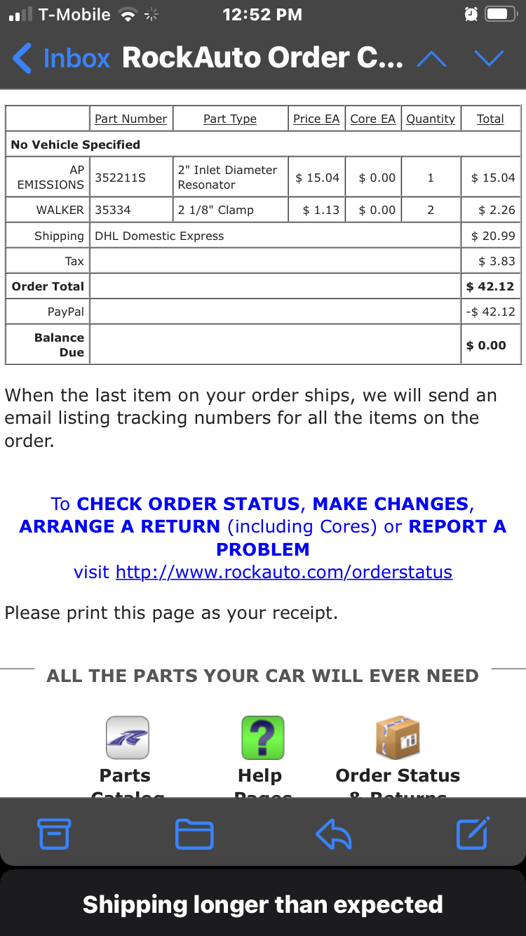

Part numbers for the exhaust.... don’t know if you guys order from rock auto but they are diiiiiiry cheap comparatively.
Bobcatbob
Rock auto is fantastic. If I need a dealer part, I cross it with Rock auto, then verify where it’s made (Got tired of going to O’reilly for parts, most made in China, junk). Napa still uses a lot of US made or Mexico made parts.
