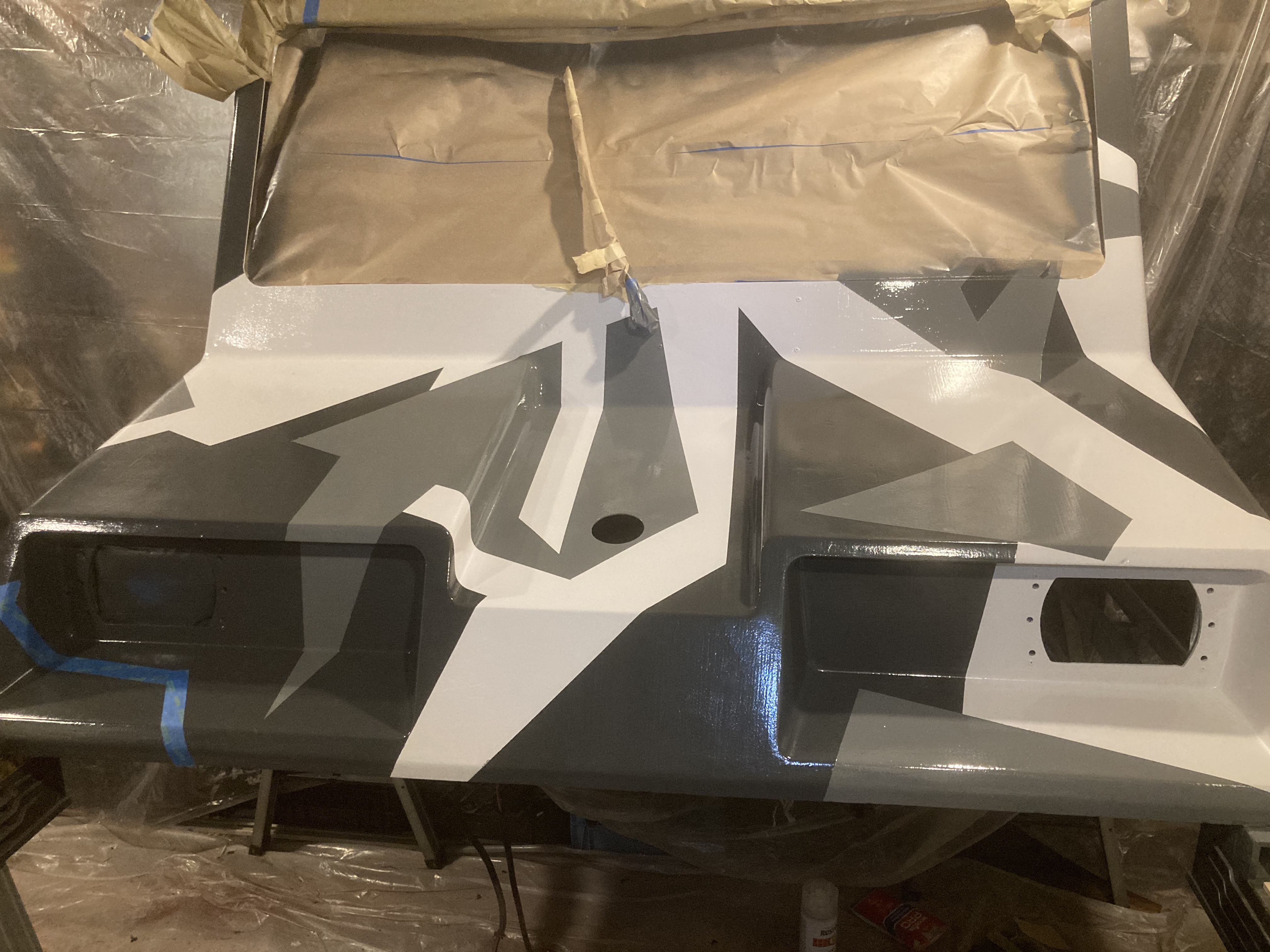

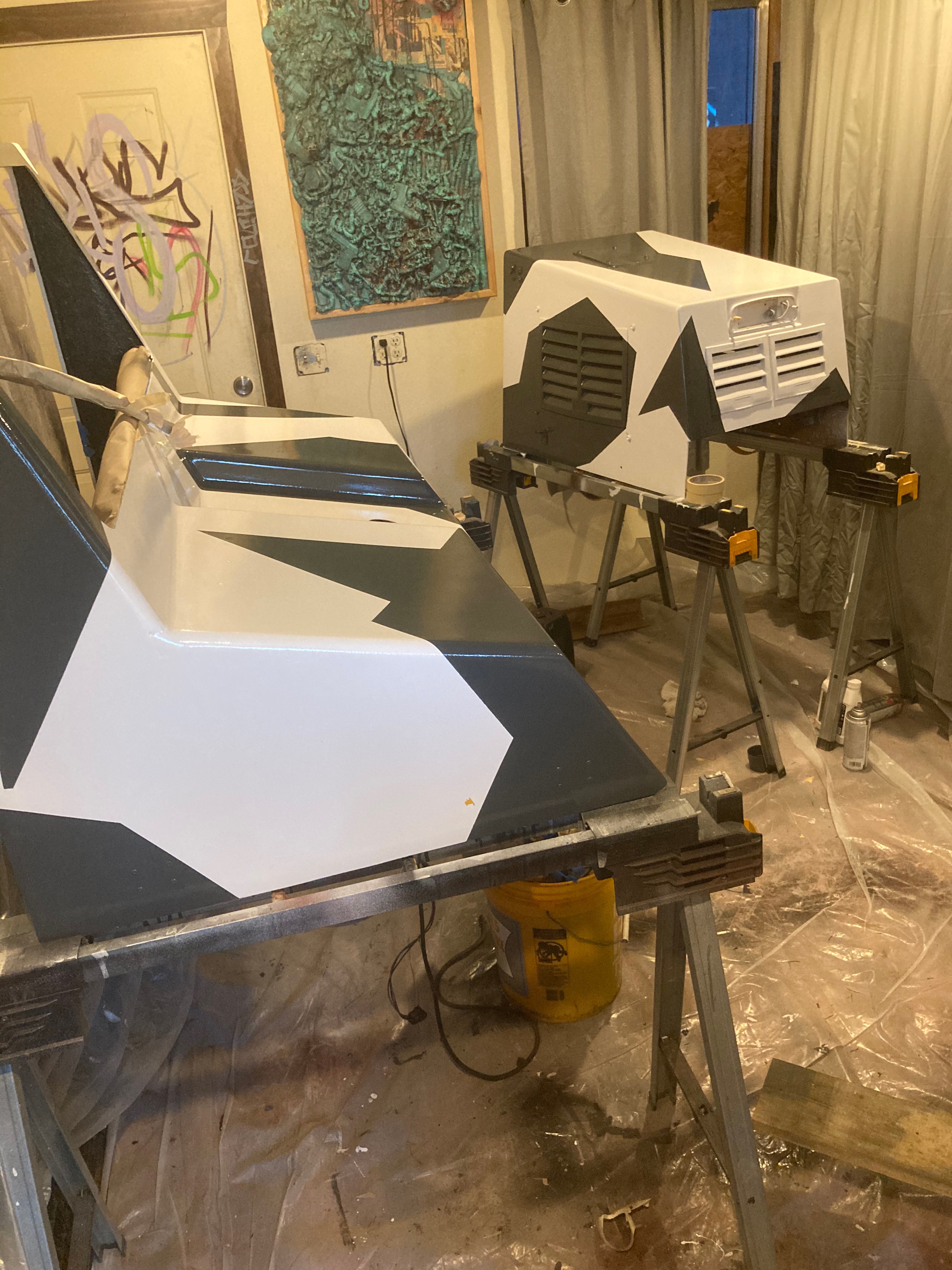

Seeings how here in Washington, it’s easier to beg for forgiveness, than ask for permission. I figured I better lay down the stealth paint job. And yes, it’s only a secret to keep y’all in anticipation of what it’ll be. ?hahahahaha paint scheme coming soon!
Here’s a teaser

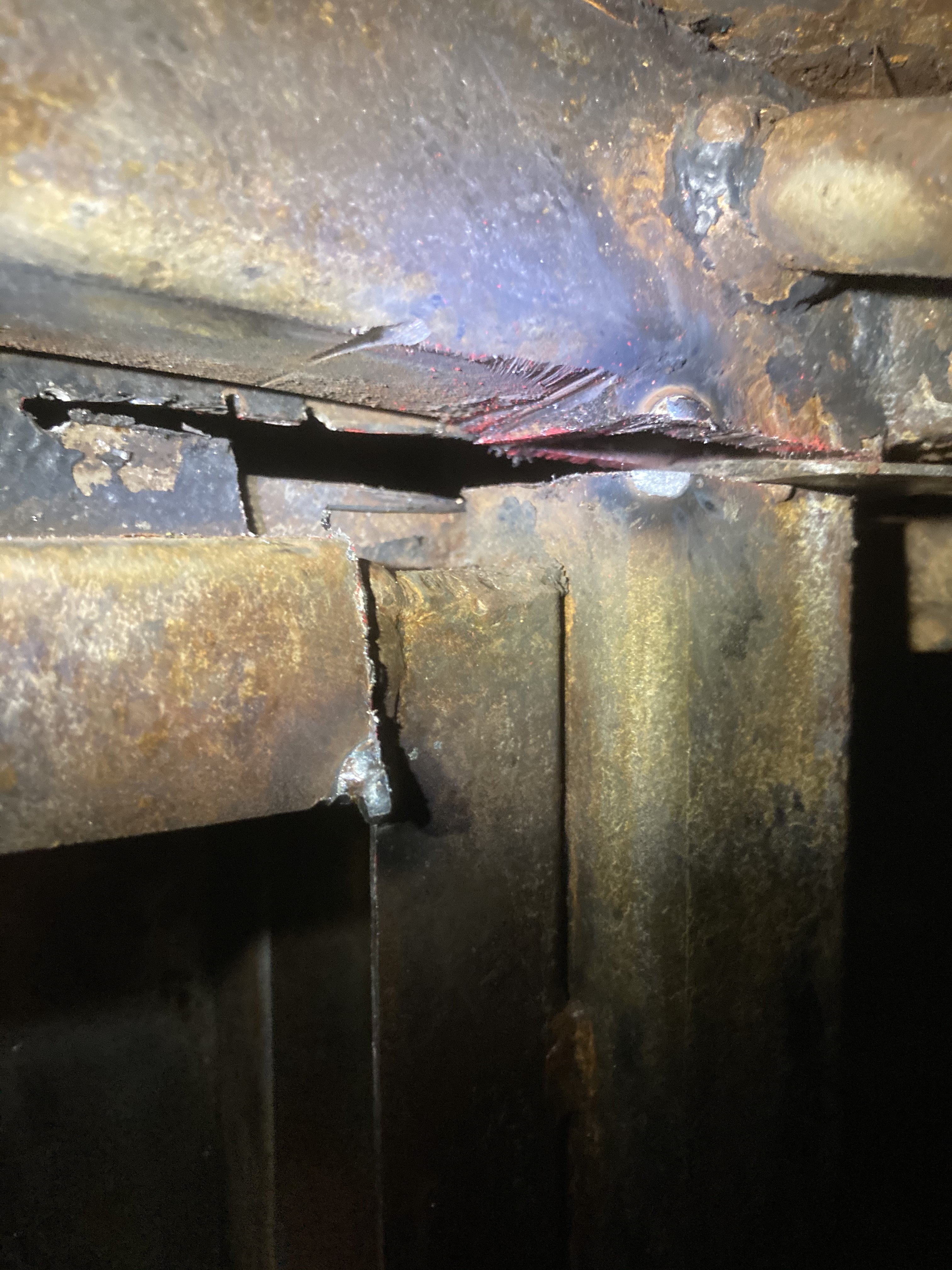

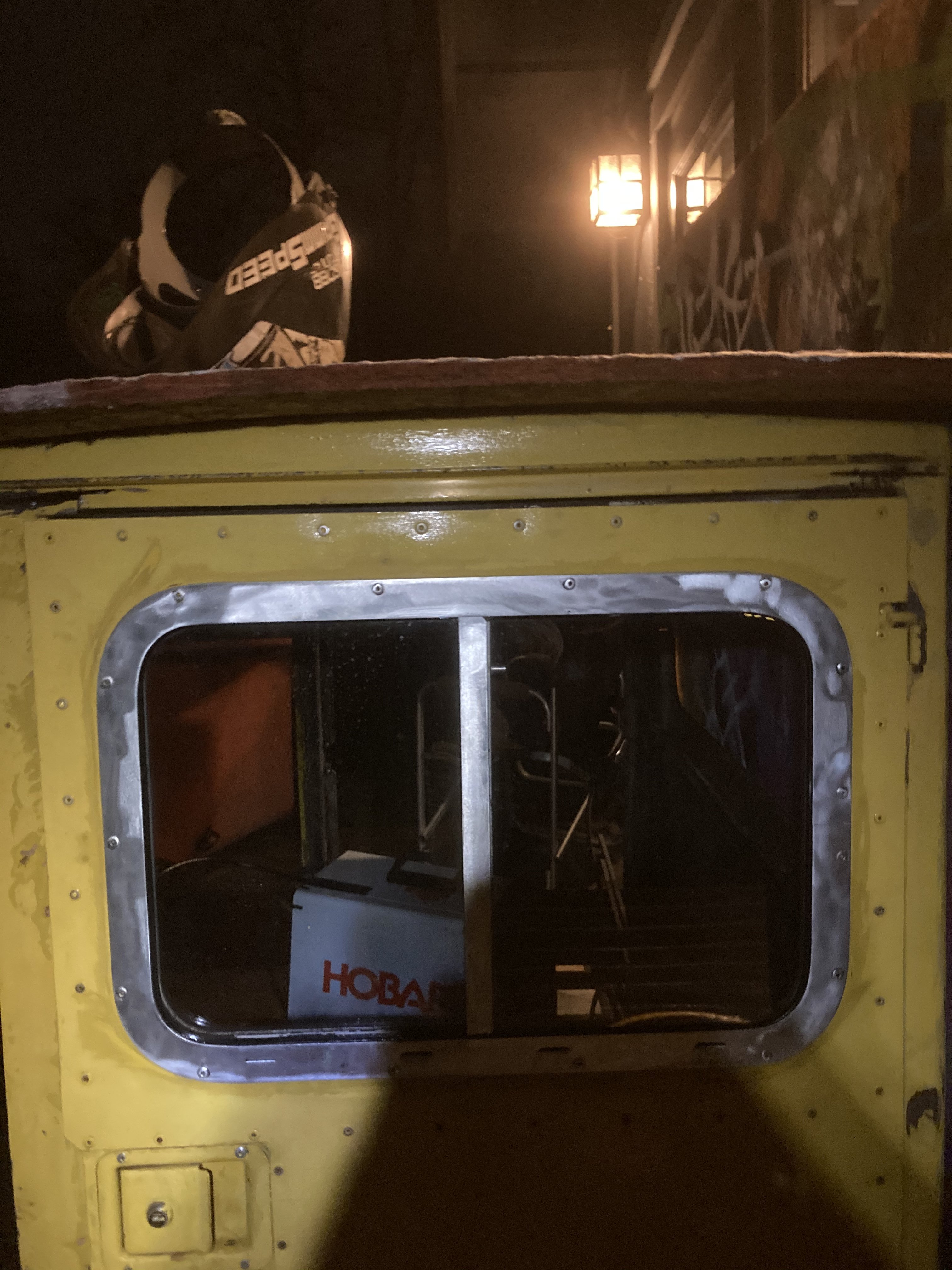

WTF! Never noticed this before but appears to be factory! this looks horrendous. Door rub on the bottom and top. The doors pretty close to square but the door jambs are off 5/16” in 2’. ???
Cab bent? Possible hinges can be adjusted to close gap?
Though I do like Cidertom’s analysis.
I wish I could adjust the hinges. I noticed maybe PO cut down original jingle to drop the door and stop some rubbing. The door frame was once square at least from what I can tell. After further analysis it looks like maybe it’s been dropped or impacted. Headed to go get my chain come along. I’m pullin it square. Been staring at it for 2 hours now wandering if I can live with it.....NOPE!!!!! ???

I appreciate the opinion and insight Tom. That was the first thing that came to mind was, If I "fix" this then what does this do tp its fit on the chassis. I will be happy if i can get to a happy medium. Because right now it's eating me. I'm a fabricator/pipefitter by trade and it's HARD for me to look past these issues. Once I see it, it just nags at me.

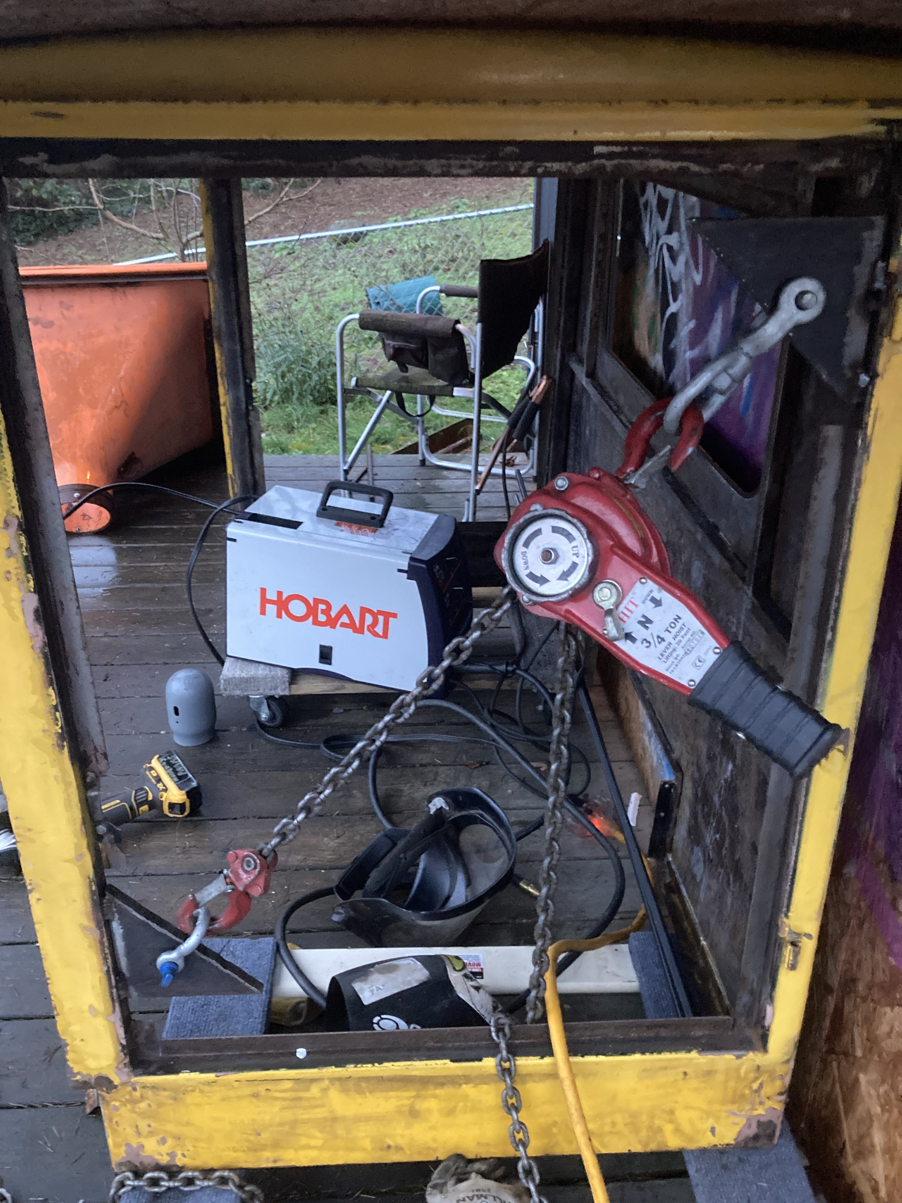

I haven't read much of those issues yet. As far as fitment, that it is. But, as you noticed in my lil rant earlier I did think that it could have came that way from the factory. And the floors on these things are pretty cheap (insert daydream of aluminum tube frame chassis:love:) It probably is a bit uneven. The issue I have and think I can fix is similar to when you square a box, a stud wall or any square object for that matter, corner to corner. its like its been pushed in. All measurements seem to point to that if I can tweak pull in from 2 opposing corners that I can bring the box into square. This may have been done at the factory. If so, F*!k the Bombardier welder that tacked this up:ROFLMAO::ROFLMAO::ROFLMAO:. We'll See tomorrow. I drilled and cut up some 1/2" plate tabs that I'm gonna weld on the 2 corners and chuck my lil tugger in there. might half to make some relief cuts in the door channel. But nothing effort can't fix. Down the spiral I go.

Buuuuuut, I just could resist!?I made some tabs outta 1/2 plate and stitched em to the tube frame and started cranking.
Wasn’t getting much. Everything was too bound up. It needed a release. So I whipped out the grinder and sawzall and started cutting. I trimmed through the upper pillars just leaving the last 1/4 on the outsides. BINGO! I got a little something. More cutting and an hour later, I’d tack and release. NOPE! Too much spring still.
Finally I after pulling tape and square for another 30 I chopped straight through the fron pillar. Slammed a 1/4” wedge in it and MONEY!!!! Almost perfectly square.
This is the 1/4” gap I now have to fill.

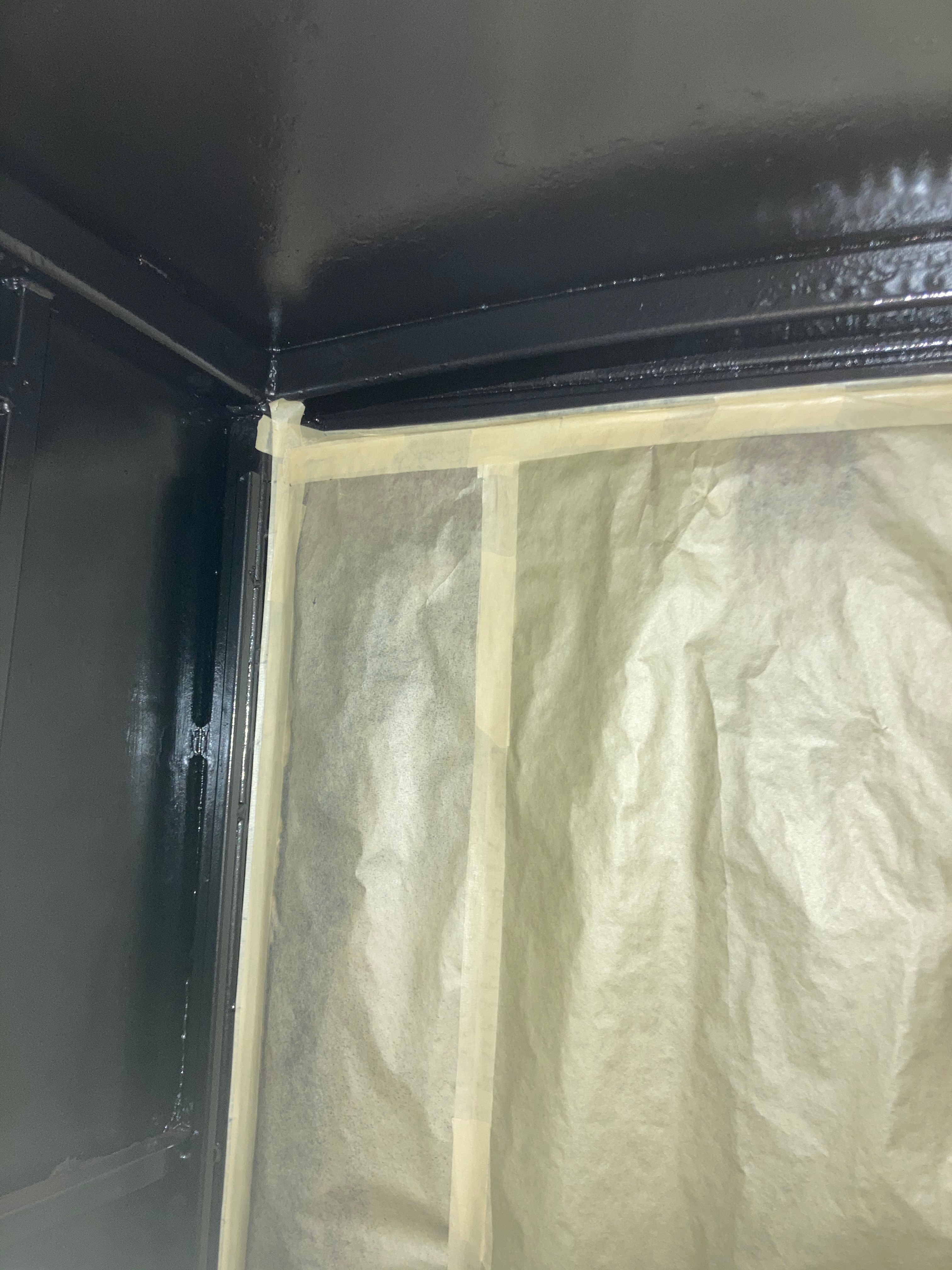

Shot of the inside of the cab. Used Hammerite Black gloss from rust and shot a primer base on top of the POR 15. That Por 15 needs the metal to 100 % free of oil. I had some spots that didn't take well but the primer covered it up. Not sure how I feel about the POR 15 yet. A lot of steps to it.

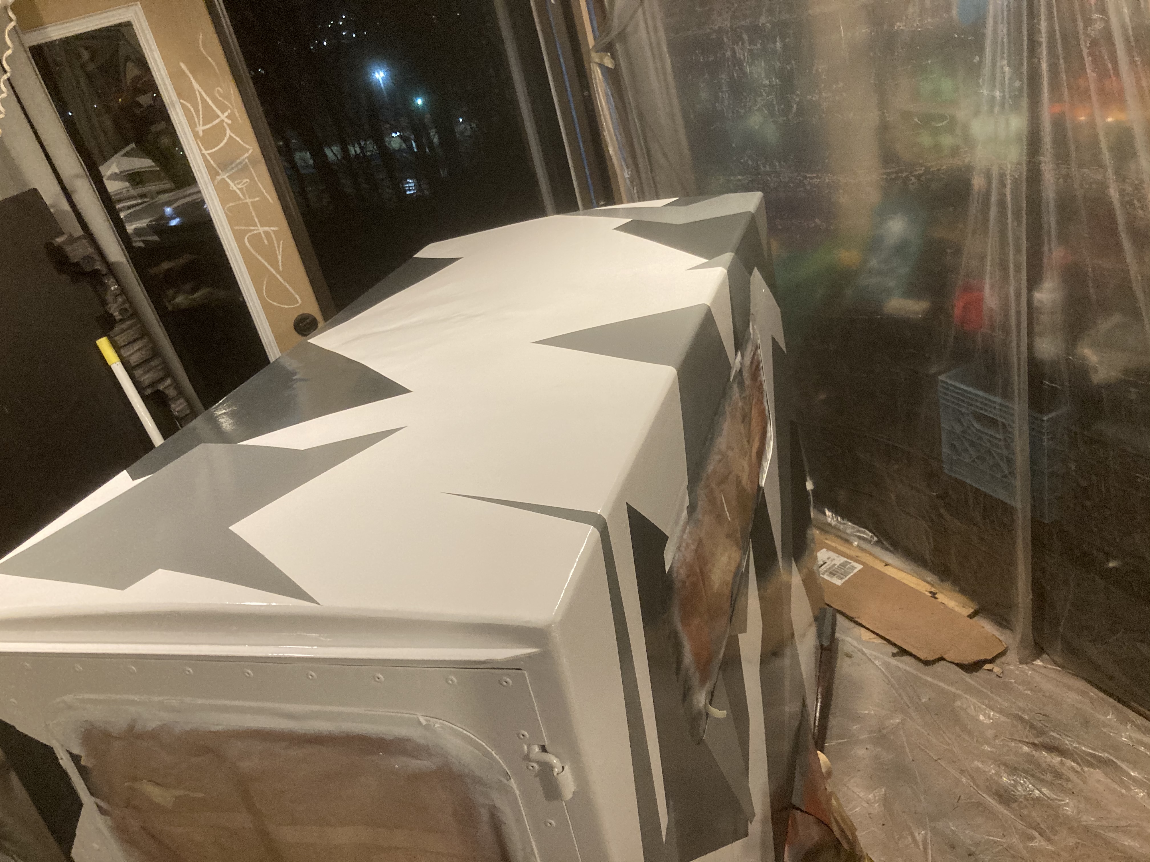

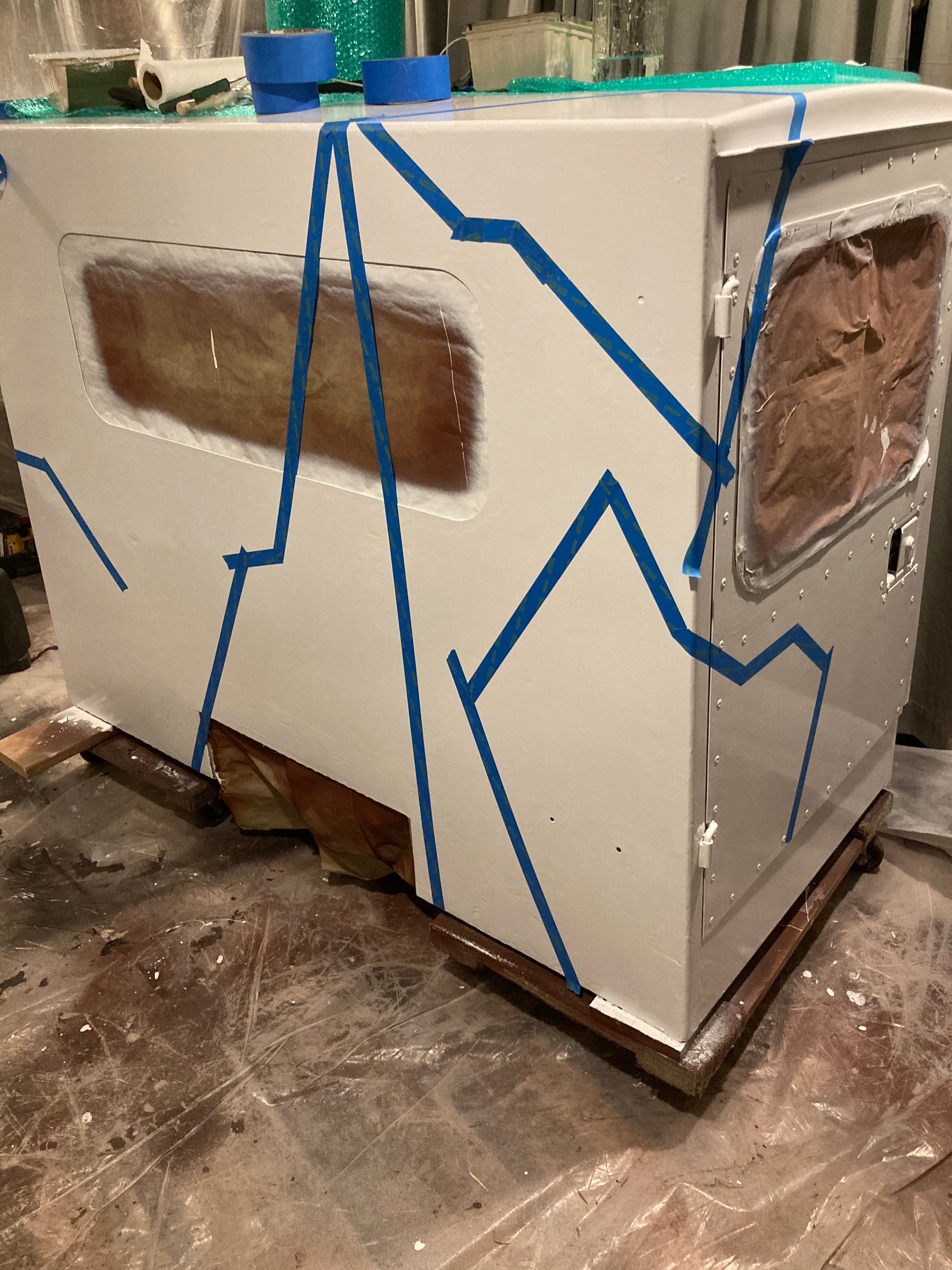

One more color to go. Gonna added a smoke gray to finish up the camo = ) really happy with the colors. My paint job was terrible. I need a paint booth and real spray setup but this will get by.
Finally got the interior as clean as possible and got it under the heat lamp and heater to warm it up enough to paint.
Gettin there. This would be a lot easier if I had a shop . But, I feel lucky enough to have a carport, a snowcat, and an amazing girlfriend that works as hard as I do on this thing. = ) Life is good
Looking great! POR15 is great stuff.....but like any paint, it needs a clean surface. It works really well with a light surface rust (POR = Paint Over Rust), but horrible if any heavy or flaking rust. Amazing how far a little can of that stuff goes. Get us a link to the video when ready...looking forward to seeing it!

Thanks 77! Paints done!!! Time for reassembly
