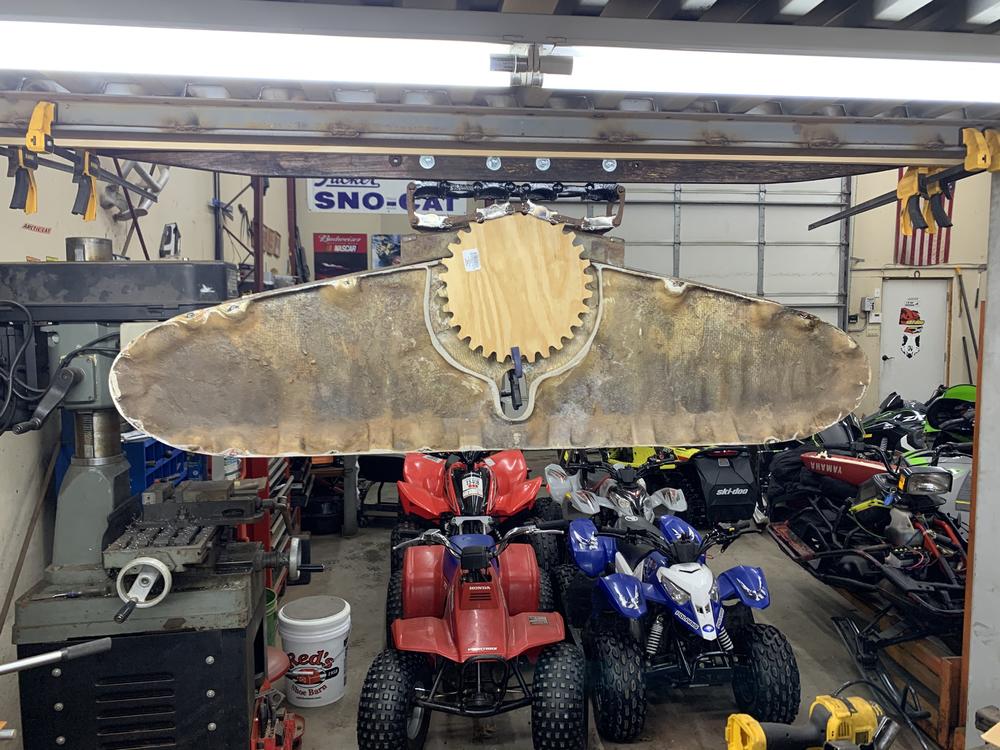

Here’s the mock up of my side project.
Still needs some adjusting/finishing then fresh orange and black.
Have just the spot for this one!

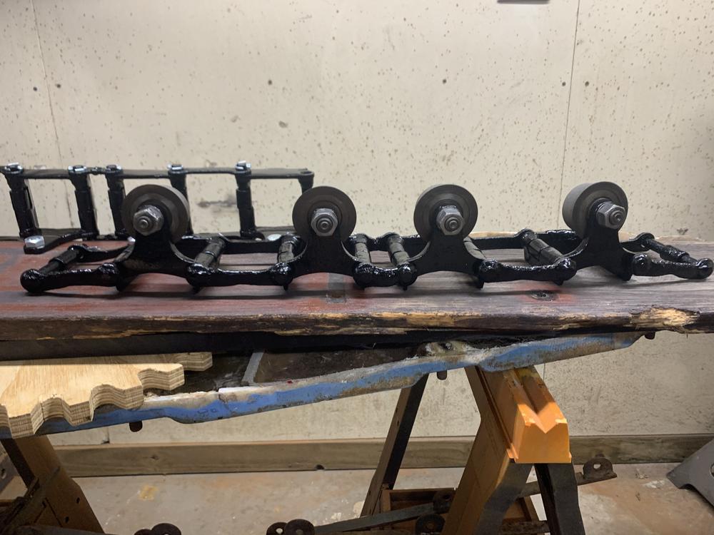

Trying to keep the spirit alive with shitty winter #2 on this thread.
Tucker Trivia
Are A models 1” rollers and non A model 3/4” rollers interchangeable on tracks?
Are A model and and non A model pontoons interchangeable?
Are A model and non A model rails interchangeable?
Are A model and non A model grousers interchangeable?
Is this roller part# a cost effective solution to the pontoon Tucker’s?

Tucker Trivia
NO
YES, if they have removable rails, and or you want to spent countless hours welding new rails in place, the basic pontoon are all the same, and you can mix and match steel and fiberglass pontoons of the same series.
NO
NO
only if you can cross reference it to the original manufacturer
tucker never made things easy...
Congrats! You won a trip to meet me in Sun Valley coming March 2020.
is that all expenses paid trip to meet YOU?
and FYI, the link pins are not the same on a 3/4 inch and 1 inch roller grouser, though, you could use a 1 inch roller grouser link pin on a 3/4 roller grouser...
Another true piece of trivia. The discerning Tucker aficionado may not like the optics of the extra play of those 1" links used but it will be functional. Might possibly cause the link retainer to wear a little odd.
