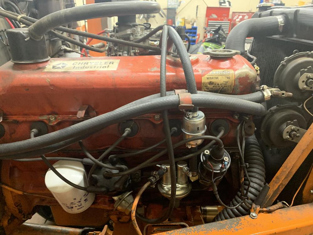

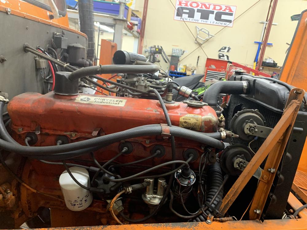

The camera angle might be deceiving, but the fuel filter position (at a higher placement, right after the fuel line travels past the hot exhaust manifold) might lead to vapor lock issues. I recommend some heat shielding to deflect the heat and/or making the fuel line shape an incline all the way to the carburetor.
Just a suggestion... not trying to be a wise-a$$.
Never gave it much thought but now that I looked at the setup I agree it needs improvement.

Here is the plan. Ordered some 3/8' Vapor/Heat Resistant Fuel Hose from Earl's performance as well as their hose clamps. Edlemann #822560 5/16 inverted flare 90 to 3/8 hose barb x 2. Wix inline metal fuel filter.
The filter needs to be after the pump. The fuel line currently takes a whimsical trip around the motor. Plan is to come 90 degrees alongside the PCV and vacuum lines down to the other 90 on the pump. Fuel filter will go inline above the pump vertically.
Thanks for the feedback and idea which always appreciated!

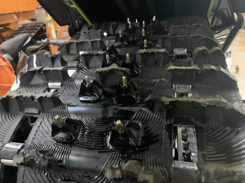

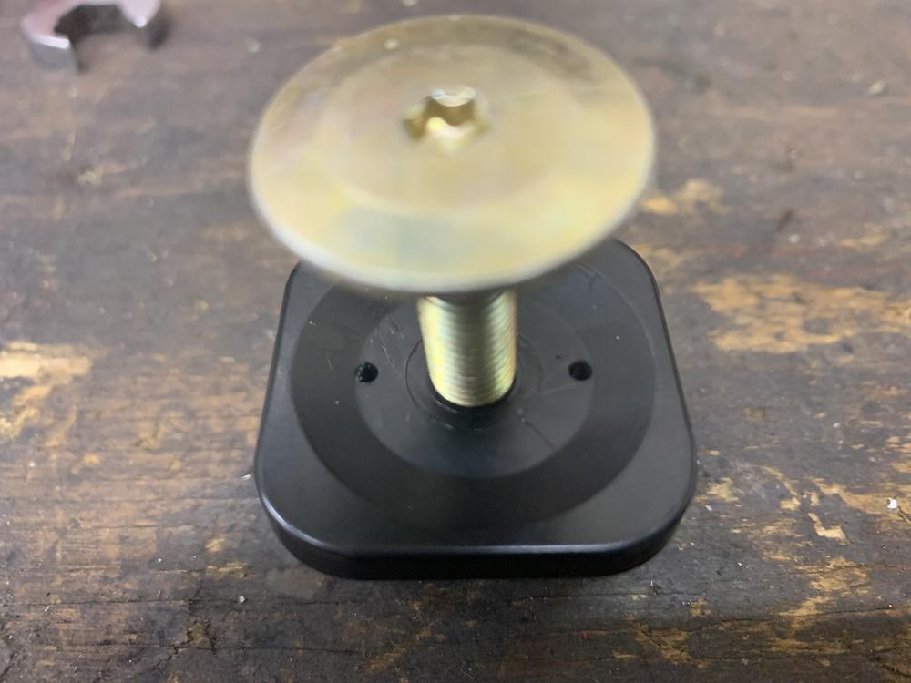

Picking away at another Track Addiction waiting on some Tucker parts. Any snowmobile people will enjoy the new tech we use here in the East ice luge hard pack trails.
Triple point carbides and new composite backing plates that the stud
self threads into. Traction has evolved quickly from the days of the T nut.
This setup you soak in hot soapy water and run in flush. Composite backer adds support and additional traction. The plastic is much like some nice tucker rollers I saw once.
Why not just install an electric fuel pump so the hose can be located far away from heat sources? Electric pumps make for long lasting starter motors too. If you are paranoid about it pumping fuel in a roll over, install a gravity shut off switch.
Your engine will love it too.
Sticking with the time tested mechanical. More wires and this single barrel doesn’t like much pressure so would need a pressure regulator.
This setup is much cleaner and should address the valid concerns raised.

Routing your fuel line between the heater hoses may be promoting vapor lock and after reading your posts showing you leg I never start my Tucker from the outside no matter how tempted to do so. Im sorry you got to be the poster boy on that one but will probably save someone else from the same fate or worse. Marty
Never had vapor lock issues to begin. Internet says mostly summer drivers in the old dodges. If anything this setup should be cooler than the previous. If I have issues I know where to look.

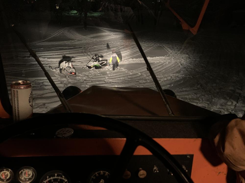

First Sno Cat rescue missions of the season. J. Tucker at age 4 doing well in his hand me down sled. Lots of stuck tonight. Checked the 5 miles of trails and the slant performed well. Quieter and more power. Thinking an upgraded ignition will be a worthy improvement for performance.
More inches coming tonight. Hope this is a good winter?
