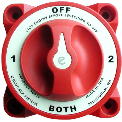

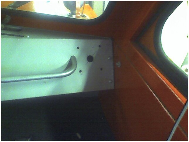

I have been using a Blue Top Optima as my primary battery, it is a deep cycle Optima coil battery. My new battery is a Red Top Optima, it doesn't have quite the same characteristics but is supposed to have greater cold tolerance, and more CCA power than the Blue Top. So I figure the 2 batteries make a good combination?
Below is a photo of the hole in the dash where the switch will be mounted, and a photo of the type of switch that will be installed.

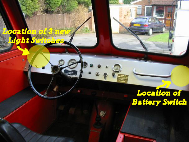

The final photo is a file photo that shows were the 3 light switches (link to Page 6 of this thread with switch discussion/photo) for the new lights were added on the left side of the dash and shows the location of the new battery switch on the far right side of the dash. BTW, the batteries are located under the seat area on the far right side of the cabin, so they are basically located a very short distance UNDER the location of the battery switch. This was done to keep the cable lengths to the batteries as short as possible. The battery switch location is also out of the way of everything.

I honestly don't see that my switch is really all that different. The switch allows for dual charging, dual discharging, independant charge, independant discharge, etc. The fact that I've got an alternator with an output that is greater than my maximum electrical draw should keep me in a situation where I always have charged batteries (at least if the alternator is working) and the only real time I'd have less than full charge is during the starting sequence before the alternator kicks in and while the batteries are actually turning the starter motor to fire up the engine.
SkiDozer may have designed an automatic system where my system is a manual one, but the net effect is that both essentially do the same thing. Granted his does it with a bit more flair, and might be fancier & automatic, but mine is simple and I can actually understand how/why mine works. I don't understand the solenoid thingy. If I understand it, the solenoid thing may automatically figure out that one battery is not quite topped up?
I'm not looking for a complicated machine when I am out cruising the woods and fields, I'm looking for something I actually can figure out. It is important to me that I can actually figure out what I have and make it work.

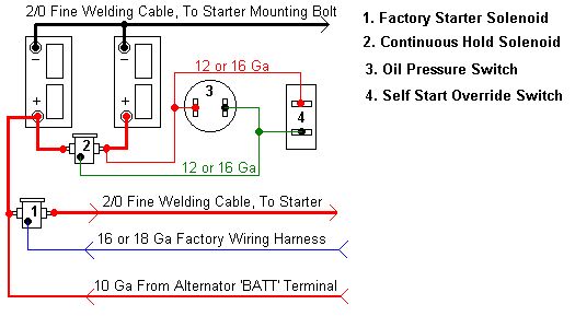

Bob, I am just using a different color lipstick on the same pig. We are both accomplishing the same goal. My unit will be driven by different people so this is the easier way for me, set it and forget it kind of thing. Attached to the second battery will be the winch, some outside lights, and a cigarette lighter. My wife chills easily and I have an electric blanket that plugs into the lighter for her. In this case, I know that the switch will not be left in the wrong position and find that I have dead batteries.
Attached is a diagram to show how I am going to go about this. I hope this clarifies my process for anyone.

:cool2: I like your thinking on this system as it takes operator error out of the picture completely......Nice schematic of how it is done....with a 12V solenoid control. Do you have a specific brand solenoid you use? Great idea and a different approach that is unique.....:thumb:
there are kits and components here
The relay/solenoid that he sells is different that what I like to use, but I cant find it at the moment
eric
The solenoid that I use I pick up here locally and cost about $30.00. It is made by, I believe, Cole-Hearse and is rated at two hundred amp. The Twelve Volt Guy that Eric linked to also has them however; he does not list the manufacturer of this unit. They look the same though!

Bob,
This solenoids use is to charge the second battery. If the alternator is putting out, say, 80 amps, then this falls way below the 200 amp continuous use. However, this 200 amp rating is for “continuous” use, not surge. Surge amperage is typically rated three times the continuous cycle, in this case 600 amp surge.
Now, a starter is the only piece of equipment on a vehicle that draws high amperage, somewhere around 300 to 350 amps but that is intermittent. A hi-torque starter might be as high as 500 amps on a large V-8. When I pull in the solenoid to “self start,” I am using the voltage from the two batteries to spin the starter. Again, I am only using 300 to 350 amps, well within the range of intermittent use even if the “starter” battery is completely dead.
Here is the skinny on batteries. Your batteries are 1000 CCAs per hour. The higher the CCA rating, the greater the starting power in the battery. Car batteries are specially designed for high initial cranking amps (usually for five to 15 seconds) to start an engine; whereas, deep cycle (or marine) batteries are designed for prolonged discharges at lower amperage. The CCA rating is the number of amps a new, fully charged battery can deliver at 0 Fahrenheit for 30 seconds, while maintaining a voltage of at least 7.2 volts, for a 12 volt battery. The battery is also used to filter or stabilize power and to provide extra power for the lighting, ignition, and other accessories when their combined load exceeds the capability of the charging system, i.e., when the engine is idling.
Buying batteries with double or triple CCA ratings that exceed the OEM requirement are a waste of money for hot climates. However, in colder climates the higher the CCA rating the better, due to increased power required to crank a sluggish engine and the inefficiency of the cold battery. As batteries age, they are less capable of producing CCAs.

SkiDozer302, you're doing a great job of explaining this...
Bob, think "Industial motor contactor" but for a car.
The relay/solenoid I use looks like this (ColeHersee.com). they come in dozens of configurations, but they all kinda look the same. I couldn't find the part # for the one I like, but its intended to be used on an electric golf-cart. continious duty rating is the key here. note: this one has 4 terminals...its probably not grounded internally...they can be had with 3 terminals..

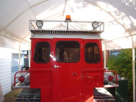

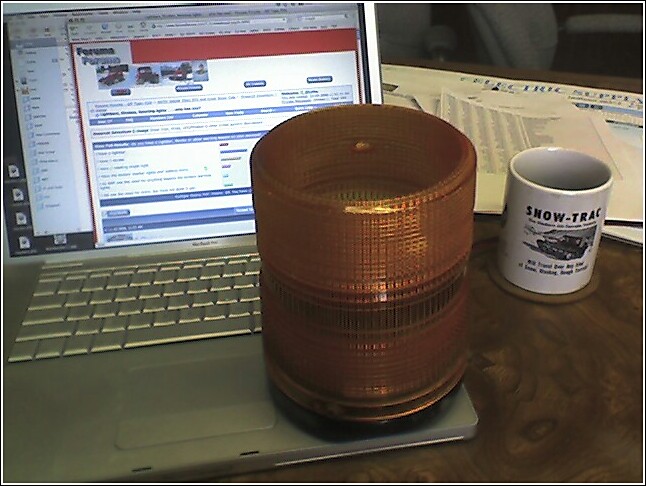

Ok here is an opinion question for all of you.
Do I put the amber flashing strobe on the front or the back of the cabin :confused2:
I just got the strobe in the photo below (Photo #1). It is about 7" tall. I'm thinking of mounted it in front of the sunroof near the front of the cabin. It would make wiring very simple and seems like a pretty logical place to mount the strobe. Gordon Robertson's Snow Trac has his strobe mounted in the same place (Photo #2). On the other hand, Arlow mounted his on the rear (Photo #3) which is also where I saw mtntopper mount the lightbar on the cabin of his LMC 1500. If I carry anything on the roof, front mounting it will obscure the ability to see the stobe from behind. However I don't anticipate doing a lot of carrying on the roof, it is just something to consider.
Thoughts? Like I said, I'm leaning to mounting it on the front.

We always put the warning lights as far to the front as practical so the cross traffic at intersections would have more chance to see them as the vehicle entered the intersection.
Don't know if this applies to snow cats though. Maybe you need one at the front and one at the back.
My experience is from 30 years ago but we didn't run the wiring feeding strobes with the vehicle wiring harness. The CD system in the strobe generates electrical interference and it would cause noise in the radios. The newer units may be better.
Jim
Now that we see power consumption isn't an issue, put one on the front and rear... :cool2:

Bob, I looked at mounting a similar strobe on my TracMaster. It appears to me the best location is on the roof above the drivers head. My initial testing showed it to be very visible from the back, rear and both sides with the vent roof closed or even open partially. Since we normally drive on the right hand side of both roads and trails that would also make sense for the LH mounting location to be most visible to other traffic. They also make a strobe that will mount on a piece of pipe and will rise above the obstacles on the roof, but it would probably stick out like a sore thumb and be tore off by tree limbs. Hopefully today I can experiment a little more on the mounting location.
Bill, I was looking a little closer at this again today. I'm going to try to stay close to the centerline of the roof, but probably offset slightly to the drivers side. The original Hella interior light is right on the centerline just forward of the roof hatch. So I'm thinking that the exterior strobe will be just to the drivers side of the center line so as not to interfear with the interior light mount.
