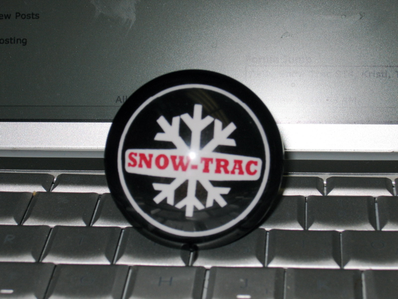

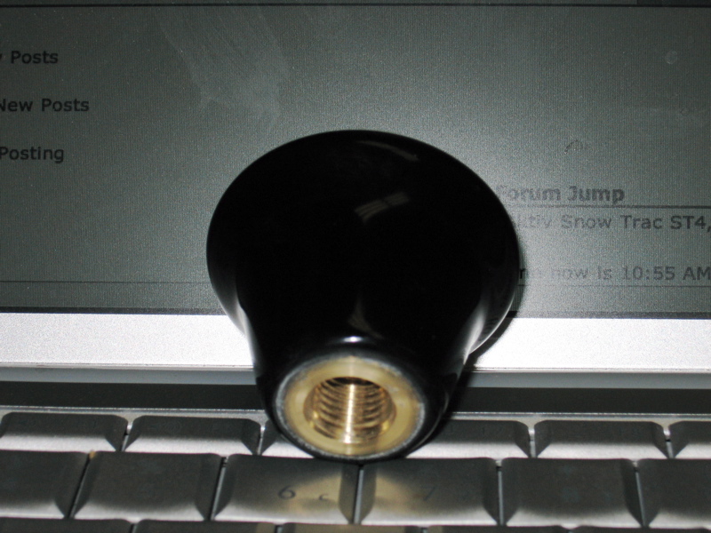

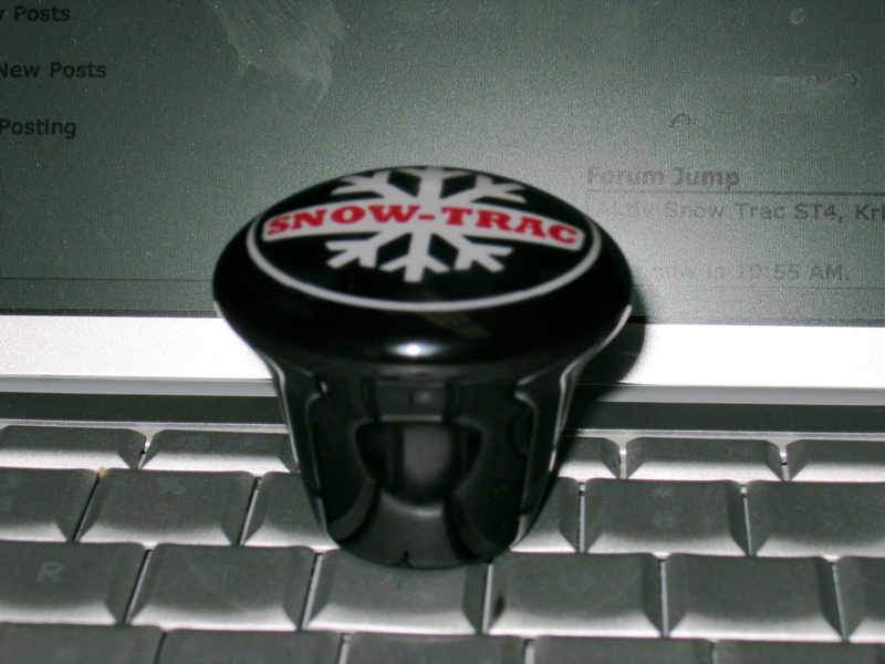

But in the mean time I got my new custom shift knob in the mail today
:cool2:
I've been working with a guy named Bruce Roosa, the owner of a small custom shift and dash knob company on this little project. Bruce is able to embed objects or photos into shift knobs or dash knobs. He offers a couple different shapes & sizes and will customize them to match your paint job, interior color scheme or whatever else you can think of. I made up a simple logo graphic, he printed it out, and embedded it into a knob for me.
I chose a "flair top" shaped knob because it closely matches the stock knobs that were on the dashboard. I also liked the look of the knob versus a standard "ball" shaped shift knob. He could have done it in any color I would have chosen, or even a swirl pattern, but I felt a solid black knob would best work with my Snow Trac.
He can do these for any brand of car, truck, or snowcat. Bruce already has the Snow Trac logo that I made up, so if you have a Snow Trac and want a custom knob, he can probably make one up in very short order. For other brands, you will have to work with Bruce to send him your logo or whatever it is you'd like embedded in your shift knob. If you are interested, you can contact Bruce directly via email. koolknobs@collinscom.net
Price, including shipping is going to be roughly $36.00 price may vary slighly for some options?
Bruce has a website you might want to look at: www.koolknobs.com Many of his pieces are fancier than what I got, with swirls or things in the plastic.

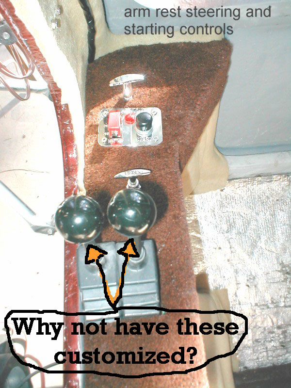

Don't you have two knobs that control your hydraulics?

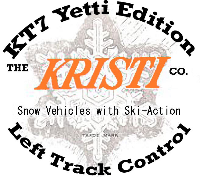

I've made up a simple graphic that could be embedded into the shift control lever. This one would obviously be for the left lever. It would be easy to modify the graphic to suit your needs, alter type colors, etc.

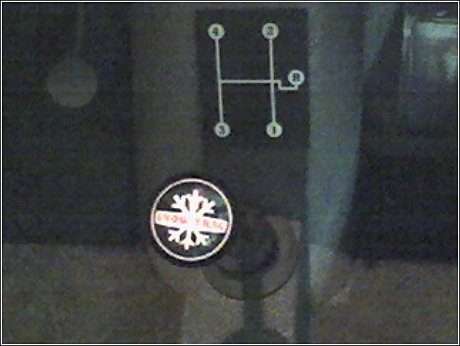

SHIFT KNOB UPDATE: OK the photo is a really bad camera phone photo, taken in the dark with only the light from the dome light inside the Snow Trac and some minimal residual light from outside.
Still the knob fit perfectly, looks great, is almost identical to the original in size but is a different shape. It looks good in place and the photo also shows the shift pattern decal that I had made and installed on a piece of black plastic and then mounted at the base of the shift column.
I like that alot Bob ,but the problem is my knobs are about 1" in diameter .
I could probably label one "right track" and the other one "left track" but other than that I think it would be hard to fit everything else on it . Or maybe just "forward<--->reverse" with a arrow in between .

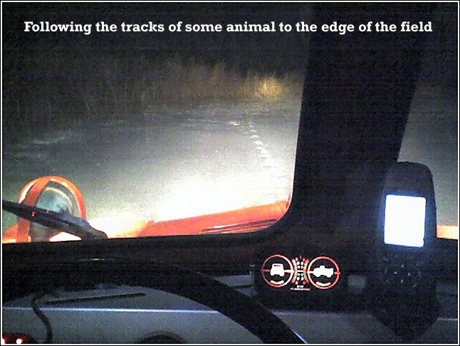

My goals for Friday evening are to mount the Clinometer and the GPS system, as well as to play around with the lights/ignition issue. Oh, and I want to watch Firefly on HDTV.
It took less than an hour, and all went smoothly, the Clinometer is mounted on the top of the dash and wired so that it lights up with the ignition. I had originally thought it would be best to mount to the bottom of the dash, I actually installed it there, but it was too close to the shift knob for comfort. Without gloves on, it wouldn't be a problem, but with gloves on I think shifting up into 2nd or 4th it would have been problematic. So I repositioned it to the top of the dash, ran the wire down the wire access hole and over to the new fuse block. Connected it up and used a 5 amp fuse to protect it.
The GPS unit fits, but just barely. It really would be better if I had a horizontal screen GPS instead of a vertical unit, but I really didn't see the need to buy a new unit when it really is not a needed feature. The mount is designed to tip the unit back and to allow it to rotate, but there really is not enough room on top of the dash for a mount that will allow it. The GPS runs off either battery or plugs into the 12-volt outlet so I've got dual power options. Its not a bad unit, but not as good as the more modern units on the market.
I also worked a bit more on the ghost starter issue. The problem was it fired up and ran flawlessly no matter what I tried. With or without the batteries turned "on" and with or without a variety of lights. And it is about 15 degrees colder tonight than it was the day I had the problem so I just can't figure out why it is working perfectly but I'm not complaining!

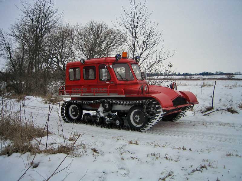

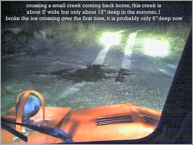

We don't have much snow but we have enough to go out. So I went out for a night drive, just about 5 or 6 miles round trip to check out the Clinometer and the GPS and play around more with the lights, check for the ghost problem with the starter, etc.
I did find out that you want to pay attention to where you are driving rather than mess around with a camera on a steep hill while trying to go down a slope between trees :o I sort of smacked the right side mirror a little bit with a tree branch but managed to make it down without any other incident other than dropping the camera and taking part of another branch off the tree and down the hill. I was just trying to take a photo of the Clinometer maxed out on its scale (it goes to 30 degrees) but didn't manage to get the photo. :( On the other hand, if you have a Clinometer, make sure it is a lighted one, most of the models I looked at were not lighted and I'm glad I found one that had lights.
The Clinometer works well, I didn't play on any side slopes, but I figured out first hand that the vertical climb & decent scale is not sufficient for the Snow Trac. The Snow Trac can easily manage hills steeper than the Clinometer can measure. I went up and down the same slope without any effort with the Snow Trac (my tractors have a heck of a time climbing that slope and feel very unstable).
I also went out along a river that runs behind the property and onto an adjacent farm just because I wanted to keep running along the river. Even in the darkness it was still a pretty drive.
Despite the 10 degree F temps, I had no problems with the starter using only 1 battery. I had no operating problems with the lights on, no electrical problems. So my ghost is still in hiding.

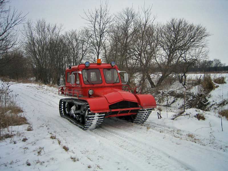

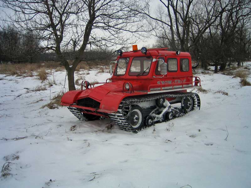

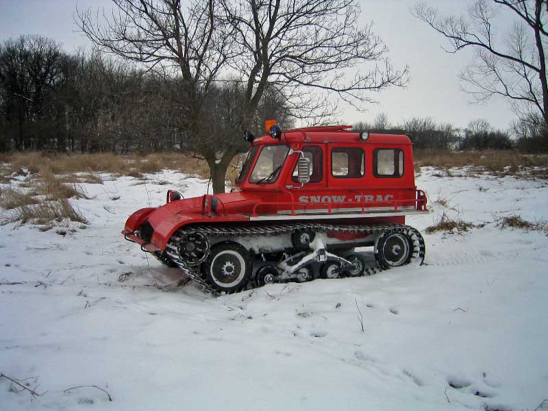

Just out for a Sunday afternoon drive :blahblah:
These photos are taken along the river (West Creek) that runs behind my home.
The drive was pleasant enough, but sunshine would have made it a little better. Probably did a 10 mile loop, or close to 10 miles. Didn't see any deer today.

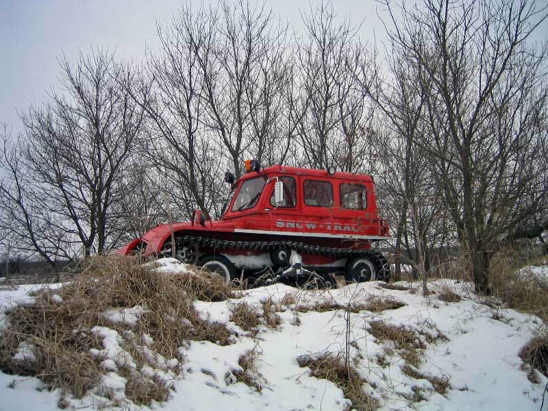

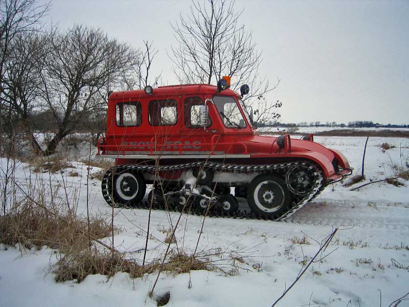

Too bad it is an overcast day! These two are also along the river.
Our 6" of snow is down to just enough to cover the short grass, but we are due for several more inches over the next couple of days :cool2:

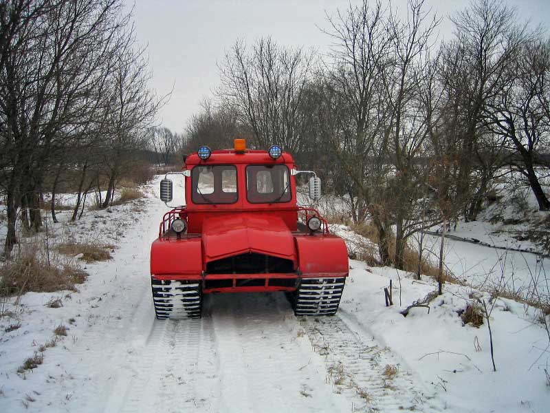

These photos were taken about 2 miles south of the prior photos, not too far off the river, in an area that is great for deer and bird hunting. In the summer the grass gets up to 5 or 6 feet tall and gives the animals great cover, but there are some hills and trees to hide deer stands.
