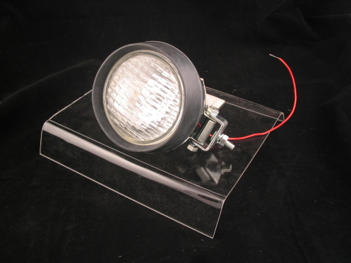

  • New PIAA headlamps mounted above the front windshields.
  • New Hella rubber armored side lights (one on each side)

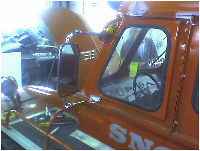

  • New exterior mirrors mounted on each side of the cabin.
Exterior mirrors? :confused2:
I would "think" that they wouldn't be much help on a snow trac. Between the terrain/bouncing and snow accumulation, I wouldn't think you could see out of them.
Re: 1972 Aktiv Fischer ST4 "Snow Trac"

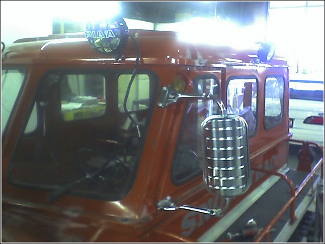

They are basically going to be used for backing up off the trailer, into tight spots, etc. I would not expect that they would be used for anything other than tight space use like backing it off the 4 post lift, etc. Out in a field or even along a roadway I really don't see them as providing much utility. But it is sort of a pain to see toward the rear and I think these will help. I've seen many others that had them and always thought they would be good idea.
OH, and ONE MORE THING that will be done. The brakes will get fixed!!!
:pat: I've got the Snow Trac up at my warehouse, before it goes home it will have working brakes (again).
I really need to get a new picture phone!!! Sorry about the terrible photos. :hide: I had some time to go play around and had my camera/phone with me so I snapped a couple photos.
The left side mirror is in place but not tighted up yet. The right mirror is not mounted yet, but it was a very easy job to mount. The top bracket is screwed into face of the windshield frame and the bottom mount is fastened under the wing window on the side of the cab. It fits nicely and is pretty sturdy. It will be interesting to see how much/little they vibrate under running conditions.

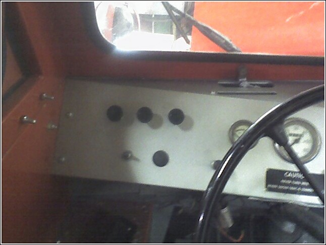

The first photo shows the 3 light switches, mounted into my dash.
The upper left side of the dash had nothing there and the 3 switches look just like they belong there. From the look of the switches anyone looking into the cabin would just assume they are factory originals :thumb: One of the switches controls the 2 side lights, one controls the 2 rear lights and one controls the 2 PIAA front mounted lights.

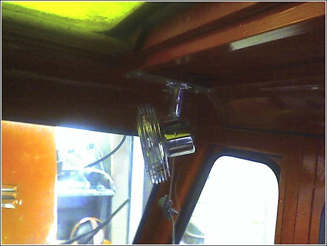

Photo #2 shows the new fan mounted on the cabin roof.
Because the Snow Trac cabin is uninsulated and just made from single wall sheet aluminum I mounted the fan to a small piece of scrap sheet steel that was cut into a rectangle and mounted to two pieces of box steel frame that the cabin ceiling is attached to.
I am not sure how/where I will switch the control for the fan. :confused:

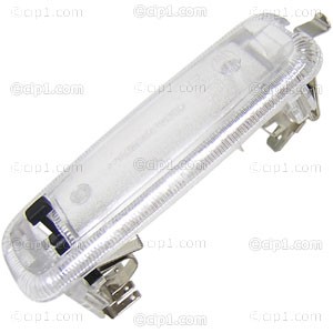

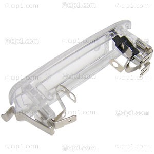

Bob post a pic of your fixture I dont know what it looks like but could you use a rubber mount 4'' white LED reverse light for a big truck, cheap and bright.
The light looks like this one . . . (picture is from a VW parts supplier)
It is a little over 1" wide and maybe 5" long.
