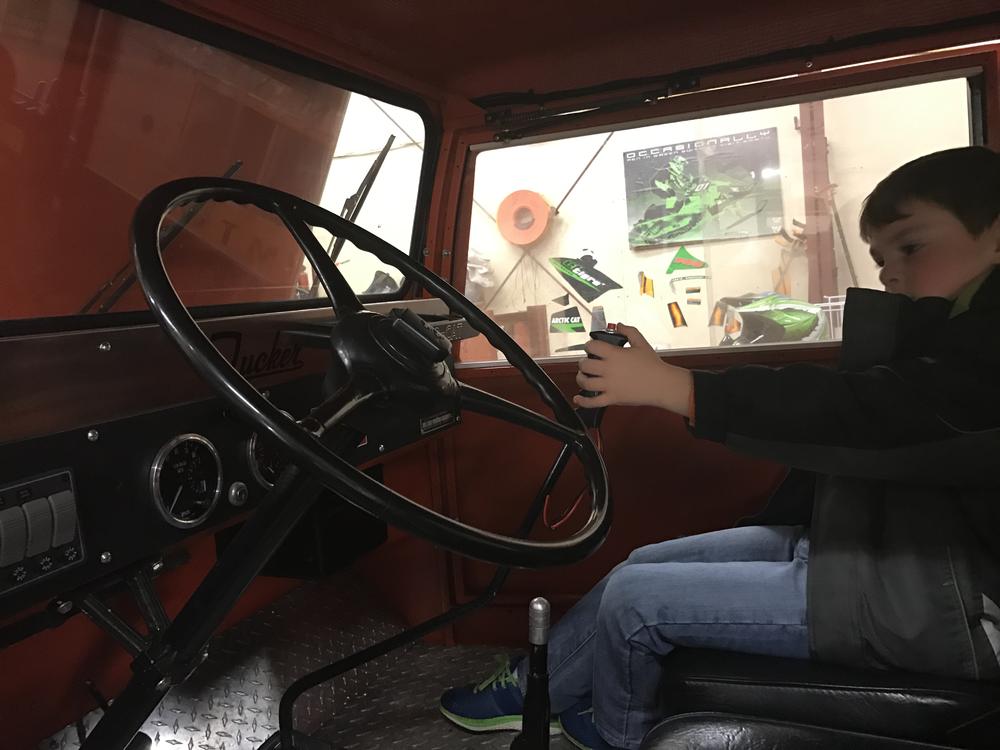

Got a little shop time after work today. Nice to be getting back out here.Brian Jr demonstrating the new starting procedure for the added layer of safety. Hand must be on key to turn and shifter button depressed. Tough to do outside cab. Like a nuclear missle launch now.
